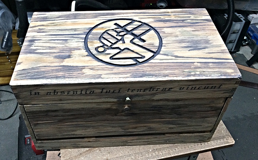

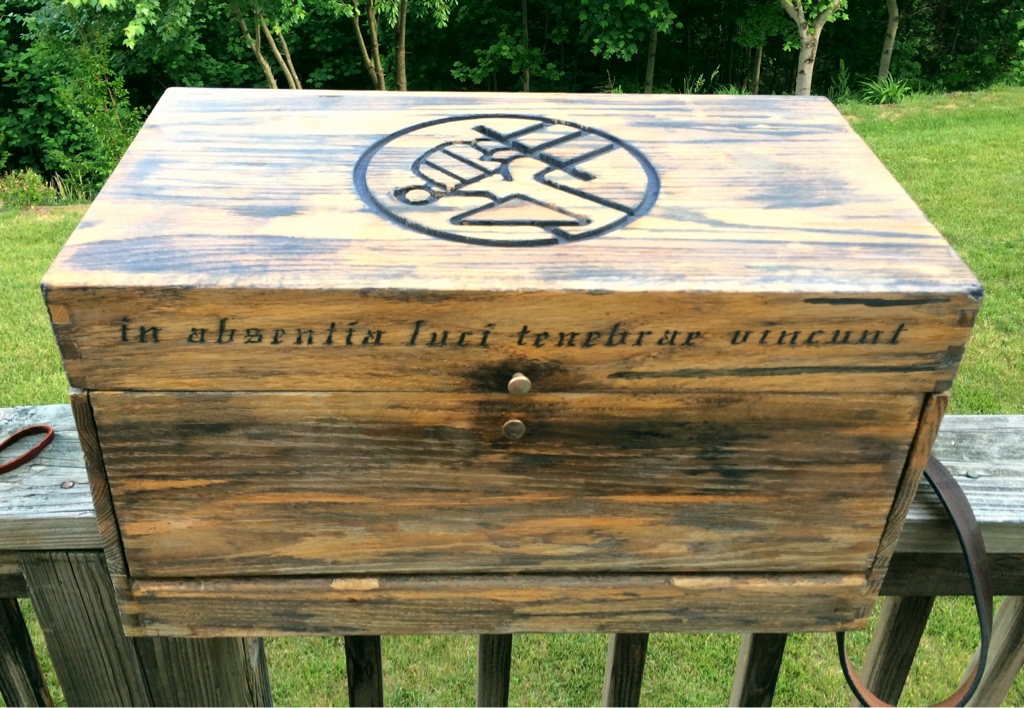

ahoudini Sr Member RPF PREMIUM MEMBER May 25, 2014 #328 Weathering of wood is well underway! More photos and step-by-step to follow... Attachments BB weathered.JPG 2.2 MB · Views: 212

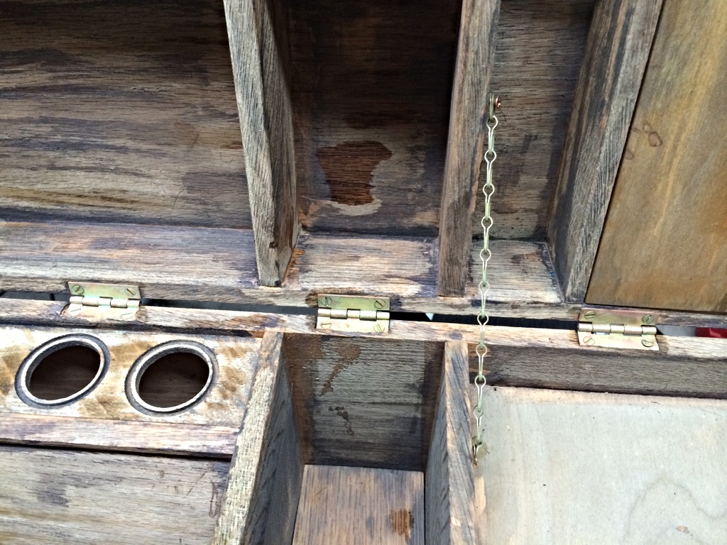

ahoudini Sr Member RPF PREMIUM MEMBER May 25, 2014 #330 Metal is weathered: I used Blacken-It and Patina-It, both from Micro Mark.
ahoudini Sr Member RPF PREMIUM MEMBER May 26, 2014 #331 Ready for wax and shoe polish: I am hopeful that the wax will even out the tones and add a little yellow. The shoe polish will add greasy grime on the areas frequently handled. Last edited: May 26, 2014
airhead Sr Member May 26, 2014 #332 Really cool! Looks like it's seen a hundred years of hard work. It's probably feeling like you've put about that into it. Great job! David
RobertH Well-Known Member May 26, 2014 #333 Exceptional! Rob Sent from [location encrypted]...somewhere on the Tharkside of Barsoom
Wayne Bakken Well-Known Member May 26, 2014 #335 this looks excellent. It will look even better with your polish and all the little accessories added.

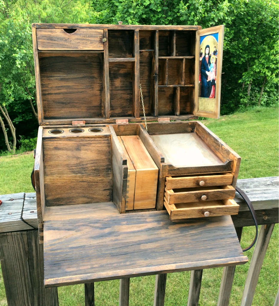

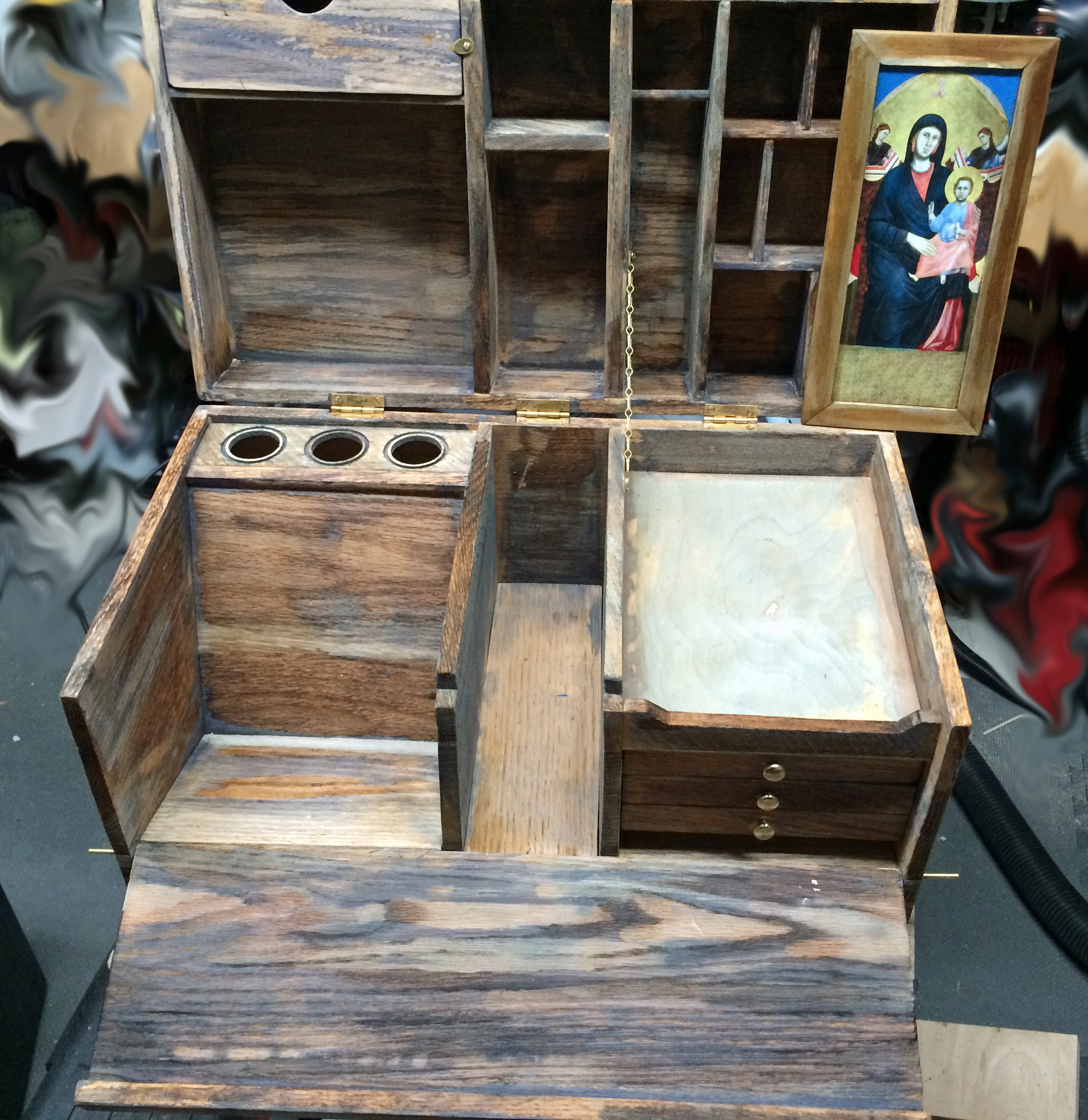

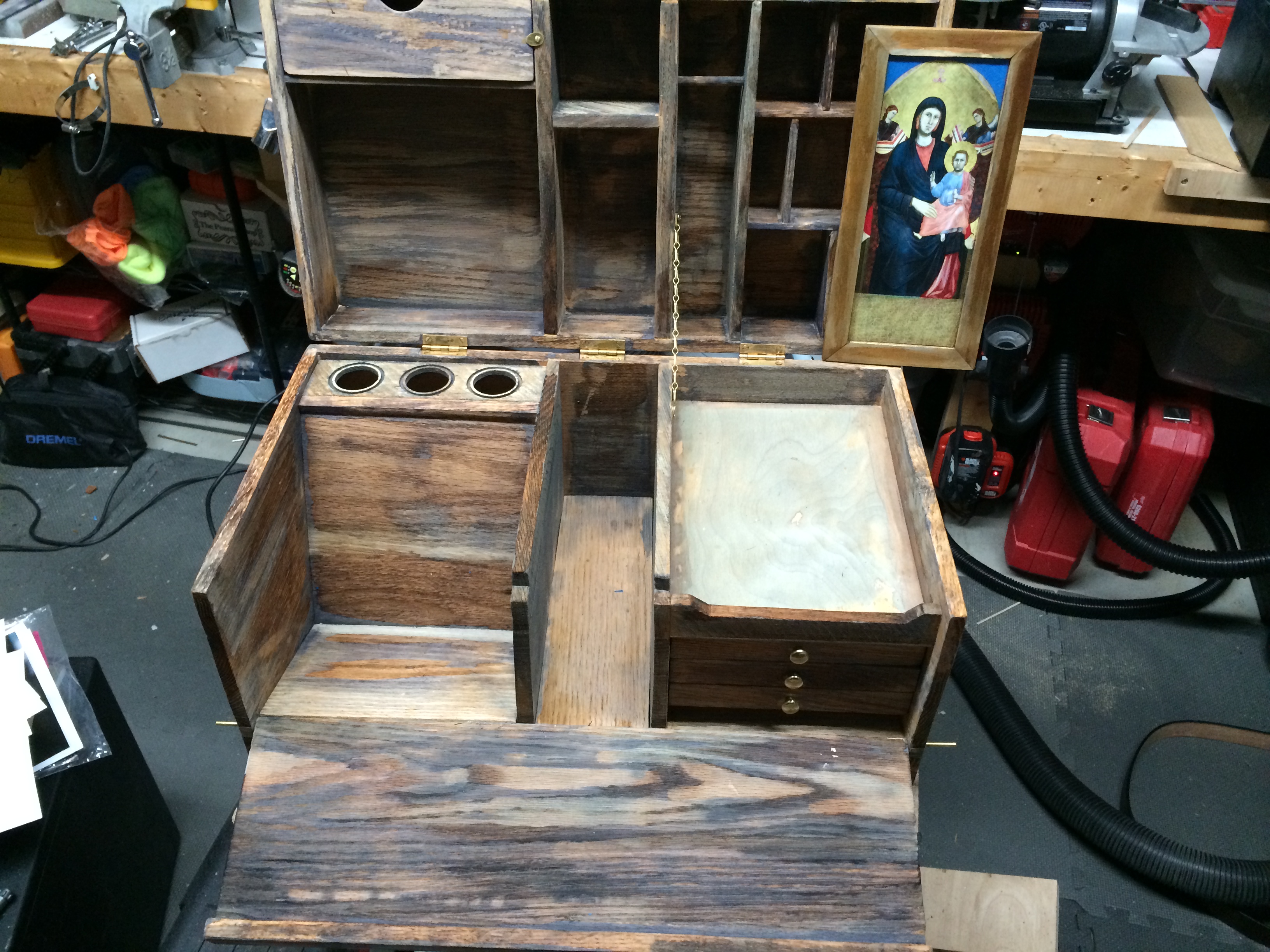

ahoudini Sr Member RPF PREMIUM MEMBER May 26, 2014 #336 Weathering is done. Went with amber shellac rubbed down with steel wool substitute. Now the fun part: collecting and weathering and adding all the contents!

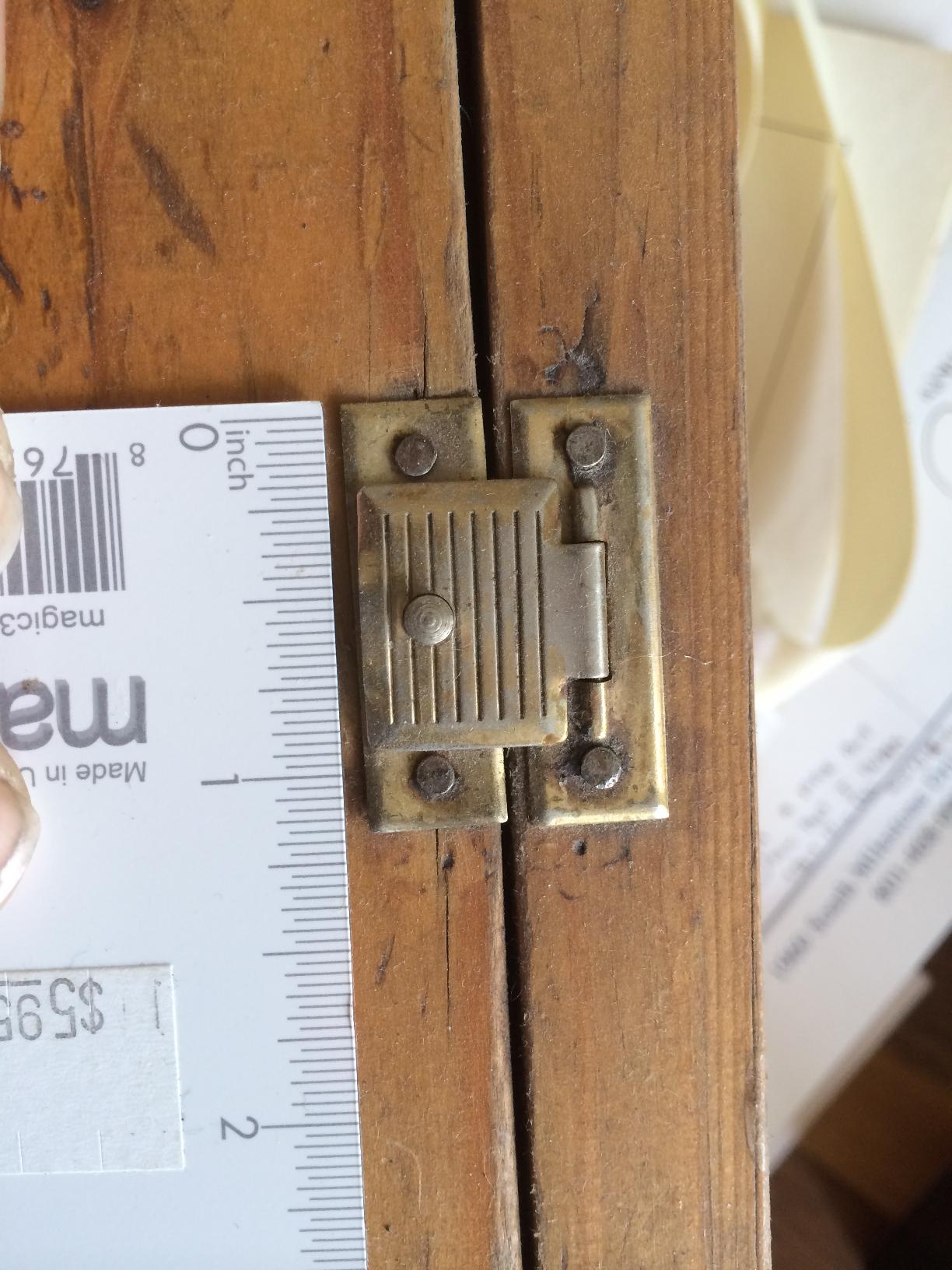

ahoudini Sr Member RPF PREMIUM MEMBER May 26, 2014 #337 If anyone has a lead on this latch for the box inside the middle compartment, let me know! Last edited: May 26, 2014
