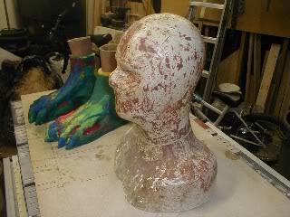

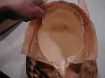

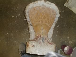

right or wrong this is the way I do it
after the latex is dry we open the back of the mold cut a slit in the mask and put the sculpting bust back in to the mold USE MOLD RELASE on the bust
add 2 part foam I hope this helps
Wow Jay you don't know how long I have been waiting for something like this. I know you said to call you about it cause you said it was very simple, but damn I didn't know it was going to be that simple. Two questions though once you pour the foam in from the back of the head do you put the back of the mold back on, and the other question is where did you get your 2 part foam from. Oh and just one more question lol any kind of specific mold release? Thanks a bunch for posting this.
