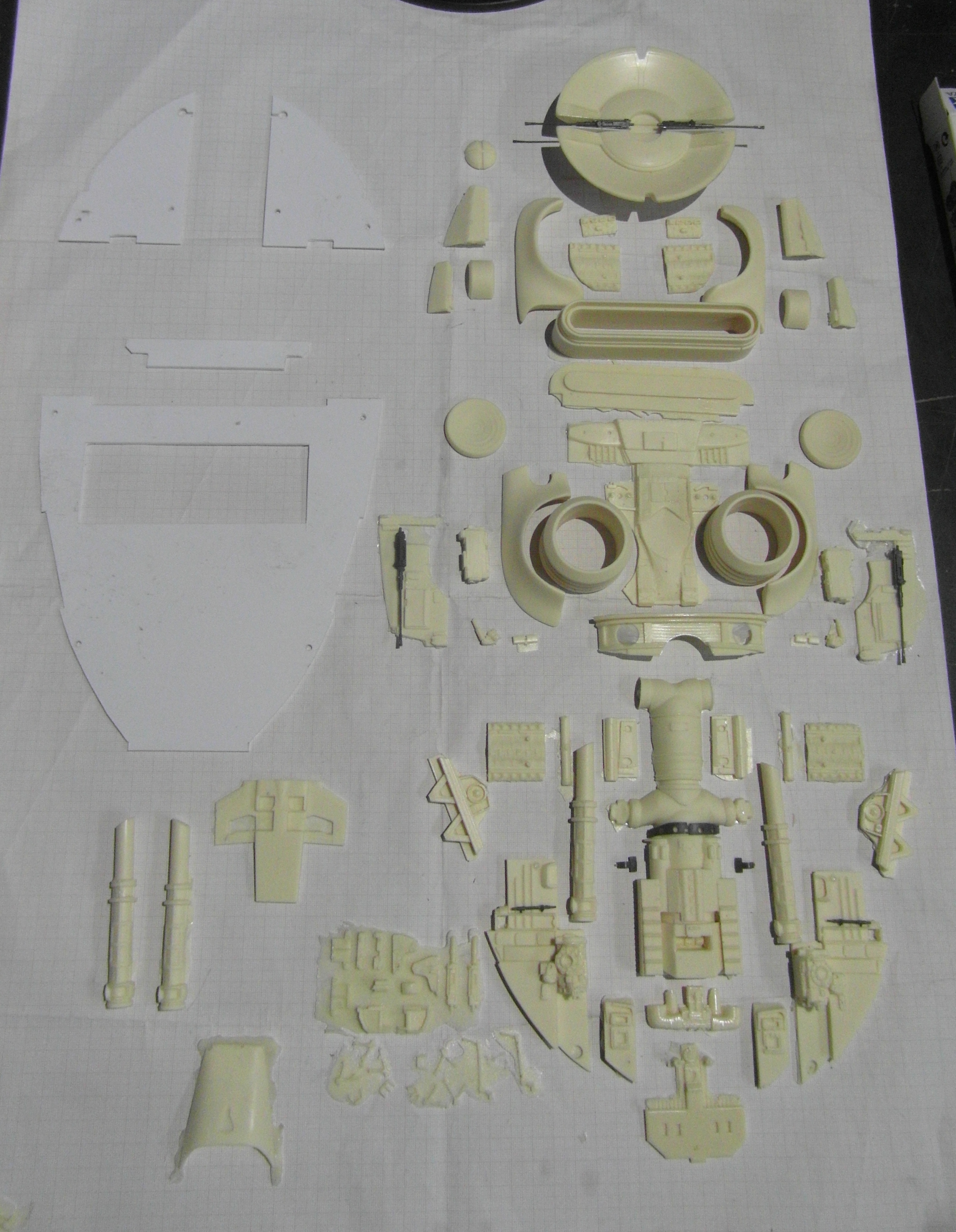

So without any more addoo, heres the final kit parts all laid out.
78 parts and a couple of spares in the tiny greeblies, just in case they become carpet fodder during your build.

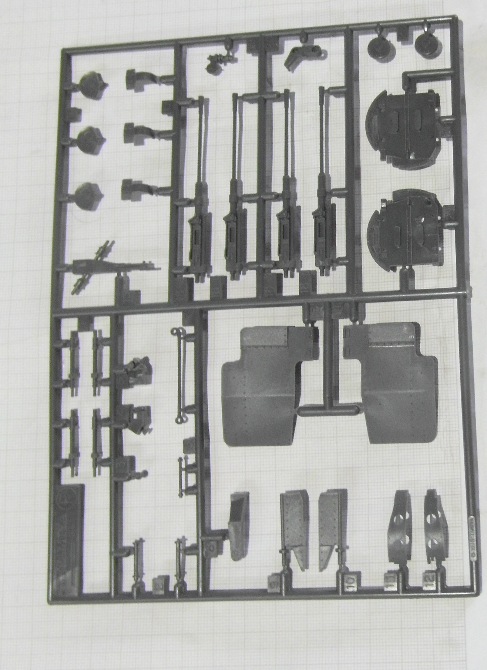

Please note the dark grey parts which come from this sprue from the Flak gun which you will need to source separately.

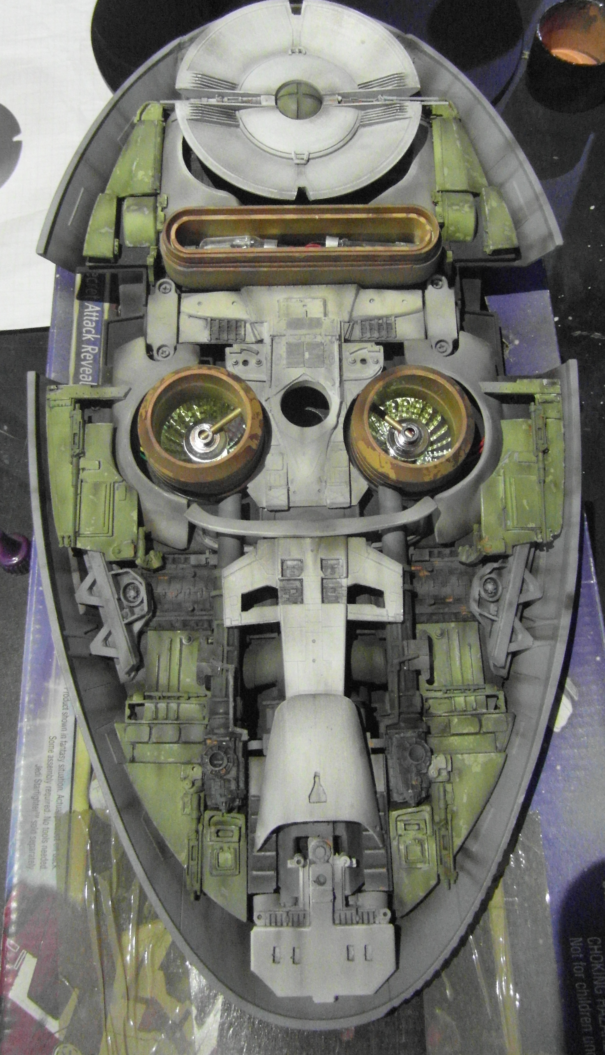

Ive added the final first pull of greeblies and painted them up.
Heres what the final kit parts make for you.

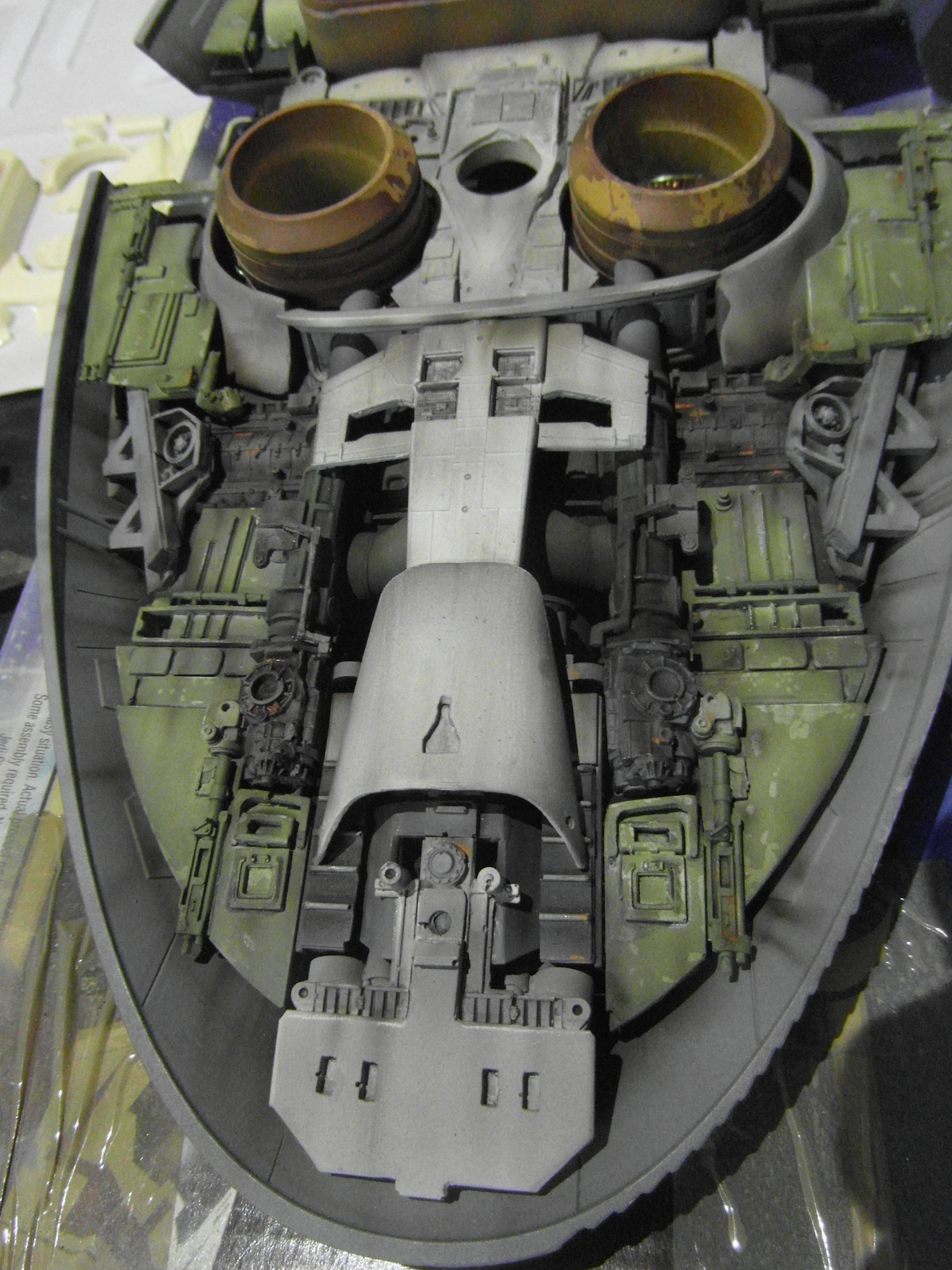

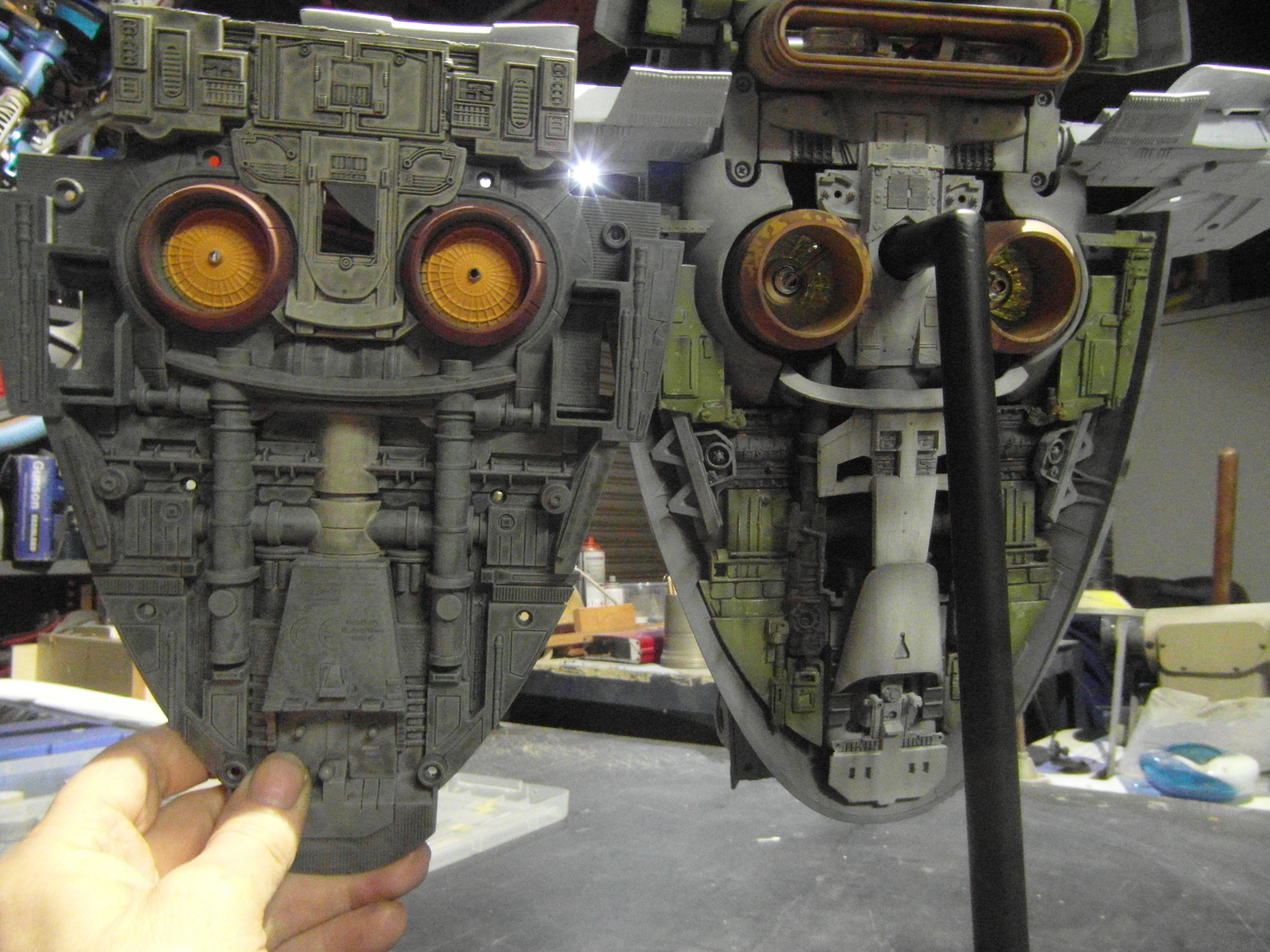

And heres a before and after comparison of the lower details. Left is the original Hasbro plate which is removed for this kit to replace.

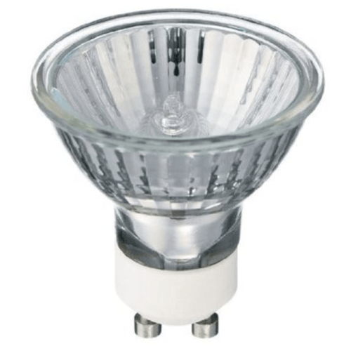

Looks like we need to also pick up the reflectors as well... where did you source those?
I tried to make the kit as simple as possible for a decent effect, but if you fancy doing the lights as well you will need a couple of GU10 halogen bulbs. I used dud ones from my kitchen spotlights :).
You can snap the bulb part out carefully with pliers, but taking the flat cover off is a bit sketchy (i broke one on my first attempt, and chipped one of the ones i have in the model !). Also available is a LED version of the GU10, but be careful to get ones with the complete reflector, As some LED versions have recessed holes moulded into it. I think they are a couple of bucks each from hardware stores. I think its best if you order a couple extra in case of accidents.
The top bulbs on the model were made from a clear biro (pen), im not happy with them as they are, but they will do for now. They will be replaced once i find a suitable looking replacement. :)

You will only need the tamia 20mm 1/35 flak gun featured in this thread for the guns and a couple of other bits if you fancy them. Everything else is with the kit.
To finish the look of the engines without the glass bulbs i have made small concave textured disks which fit inside the rings, which you can see on the image of the parts a couple of posts earlier. You can add metal tape and polish them for a similar reflector effect and save yourself all the dremelling and filler work needed to install the reflectors. Ill post an image with them here soon.
So to be concise ;-)
All you need is one refit kit
and one of these.
Tamiya German 20mm Flakvierling 38 Mit Sd.Ah.52 1/35 Scale #35091

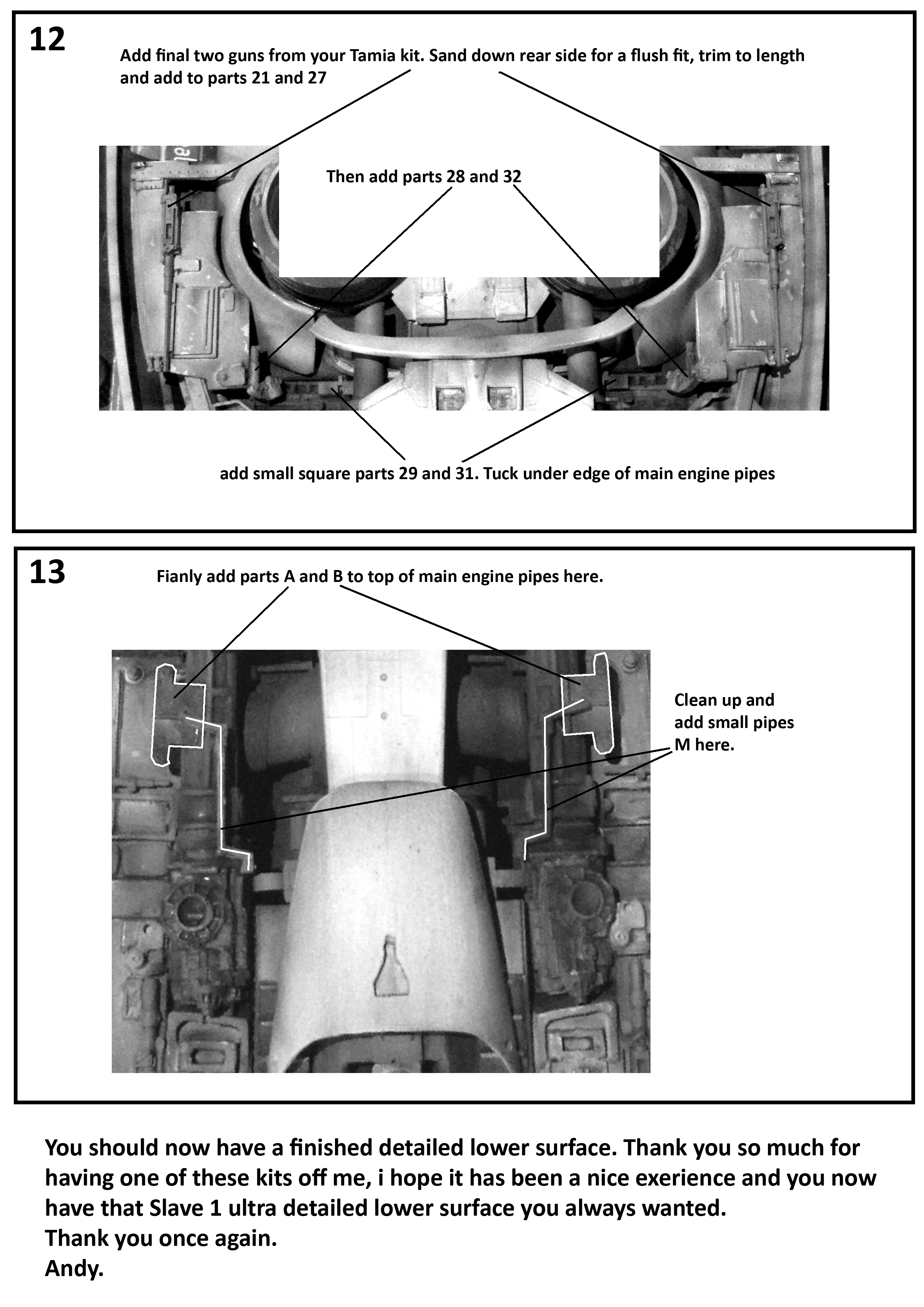

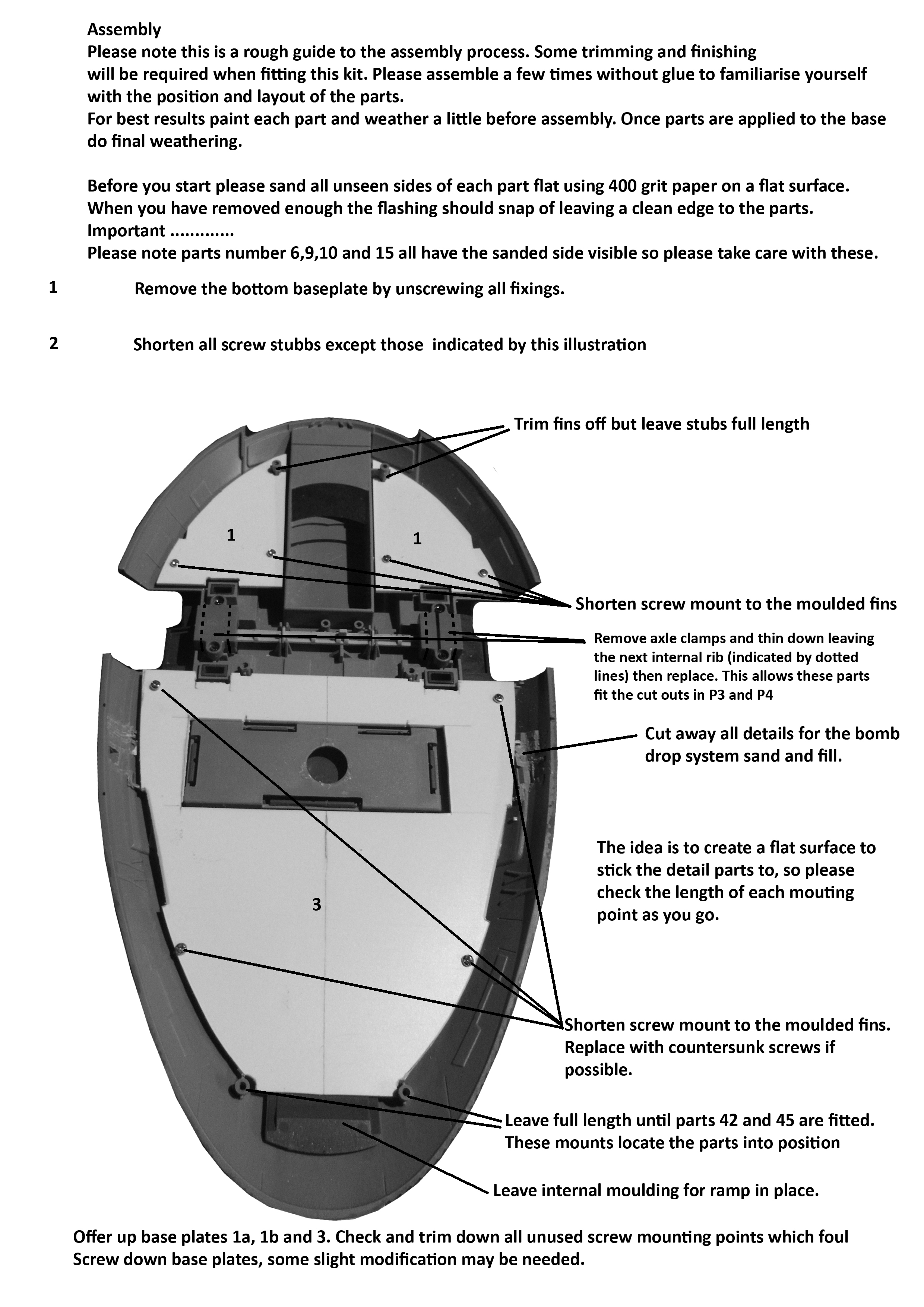

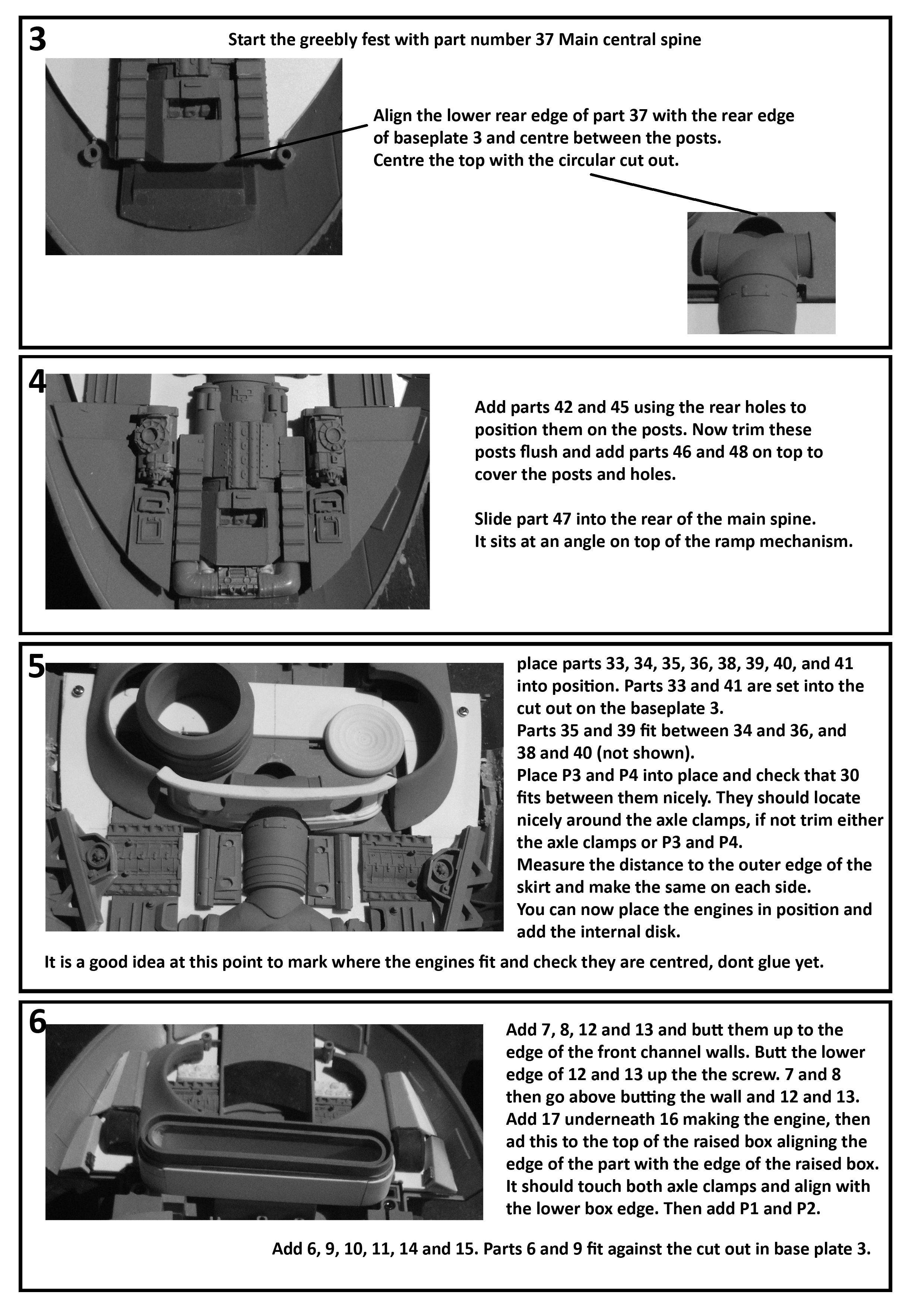

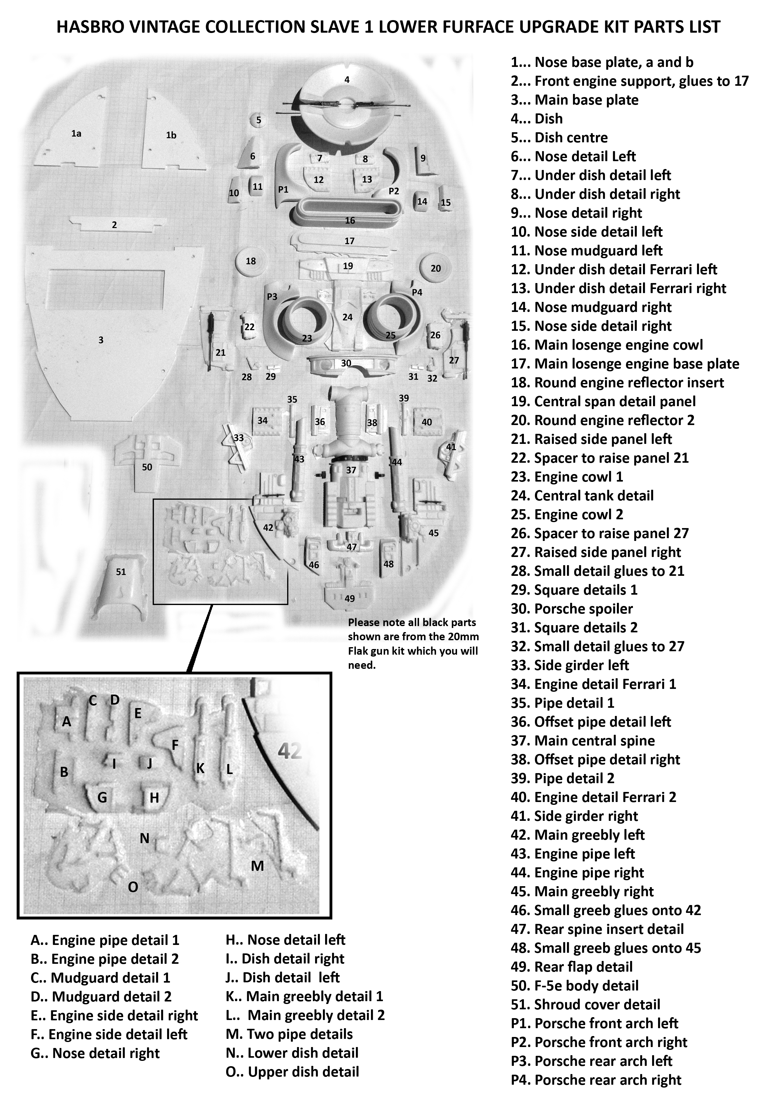

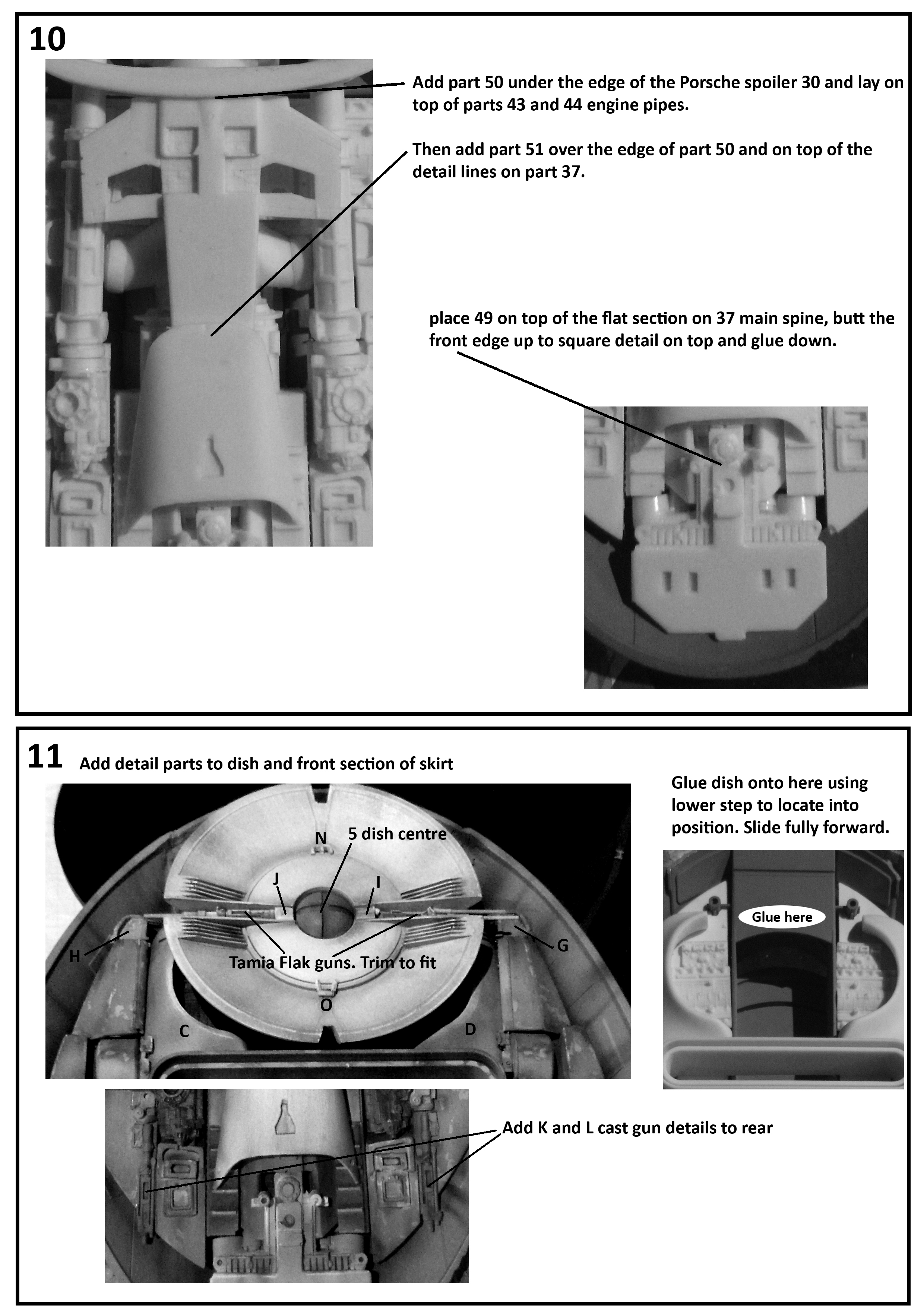

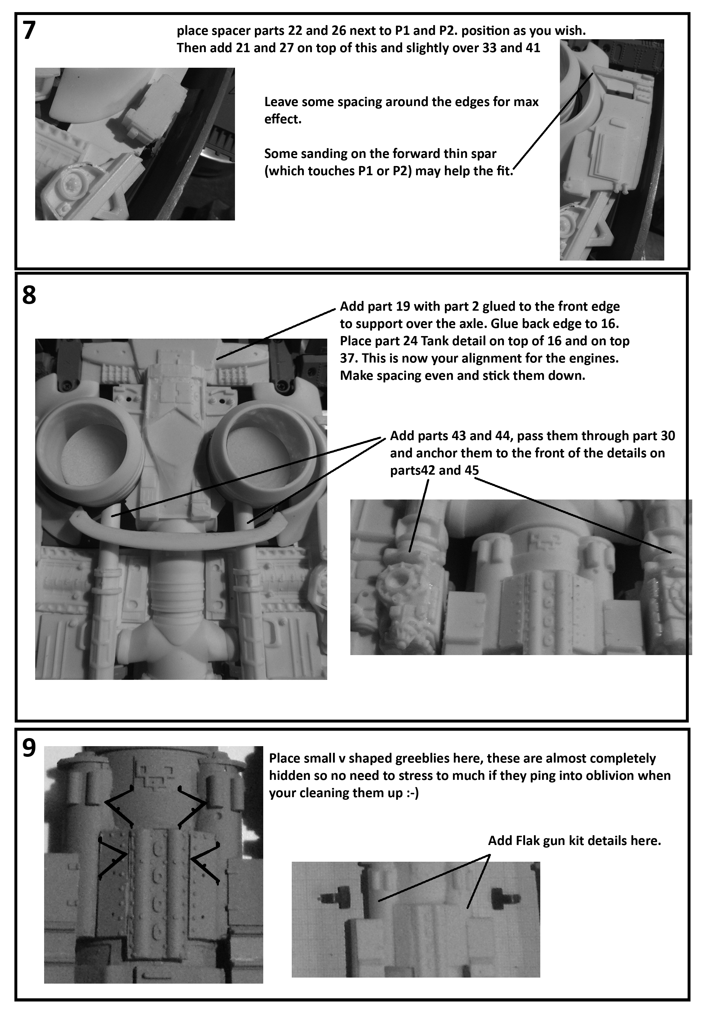

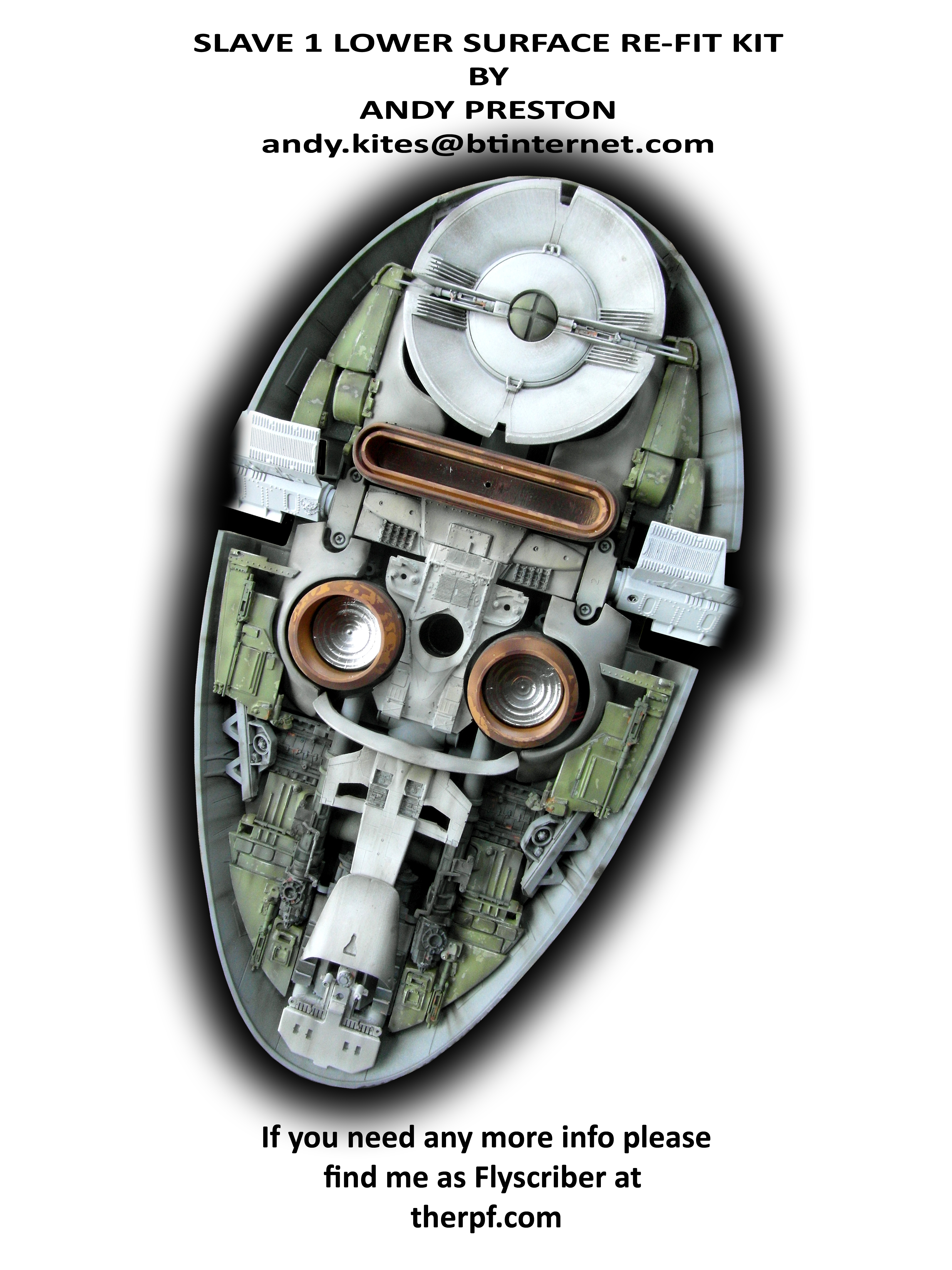

So ive spent a few hours sorting some instructions for the build of this kit.
Ill post copies of them here as well as supply them with the kit, as it much nicer to have them to hand whilst building instead of zooming in, opening the next page etc on a laptop.
So here are the instructions as they stand now. They could change in future, but i think theres more than enough info on here compared to any SS kit ive ever had. Try making some Studio scale Y wings with no instructions at all, it takes a while. So hopefully this will make it easier and faster for you all.

I may refine these as i go, and ill definitely redo the type o's :), but i hope this helps out.
