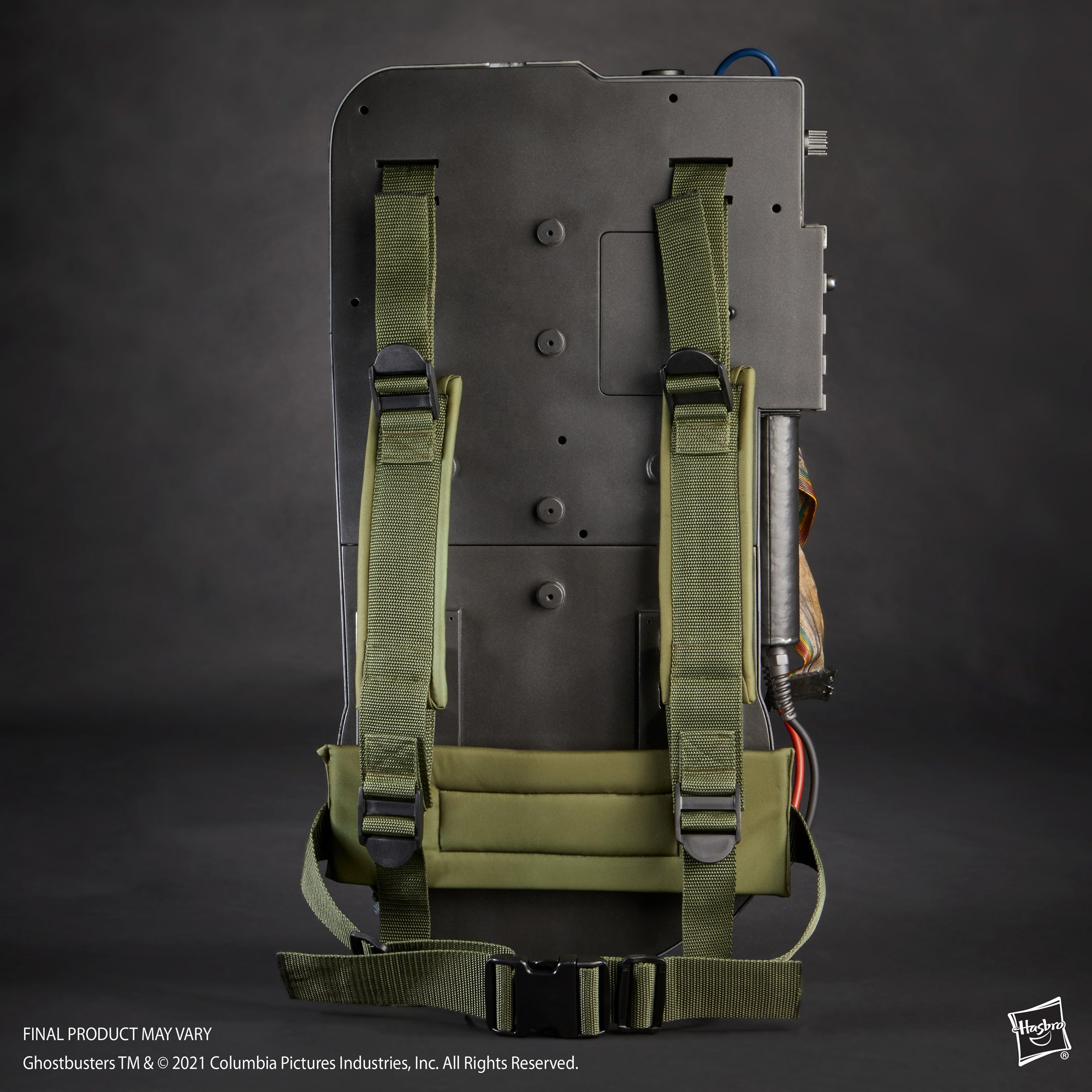

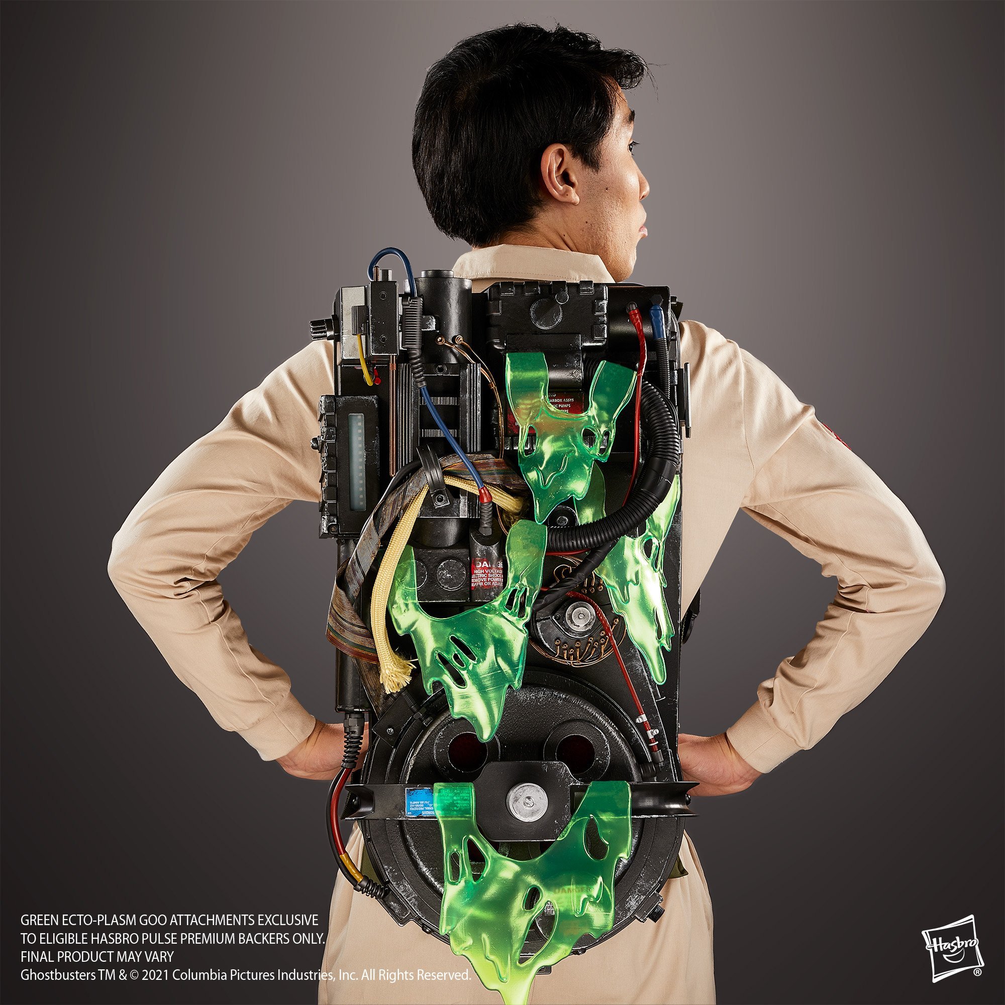

Honestly, looks a little small?
It does look kind of small. Maybe a hair bigger than a Spirit Pack
It could be the lack of a real ALICE as well, which could be why it looks like it's hanging a bit low on him.
It looks like they included screw mounts for a frame. Could also be that one of the stretch goals includes a frame.
Undersized? No Alice pack frame? I’ll pass. I’m perfectly happy with my heavily modified Spirit pack.
Not super impressed. A well researched purchase could get you the parts for a much more accurate kit at just a bit more cost and would include a wand.
Looks a bit to small to mod into a original pack, separate components look molded in and difficult to remove, and no attempt at an Alice frame. For $100 - $150. Would be a great thing to toss around but it’s just a bit much I think. Maybe I’ve just been looking at mine to long and the little things are standing out to much…

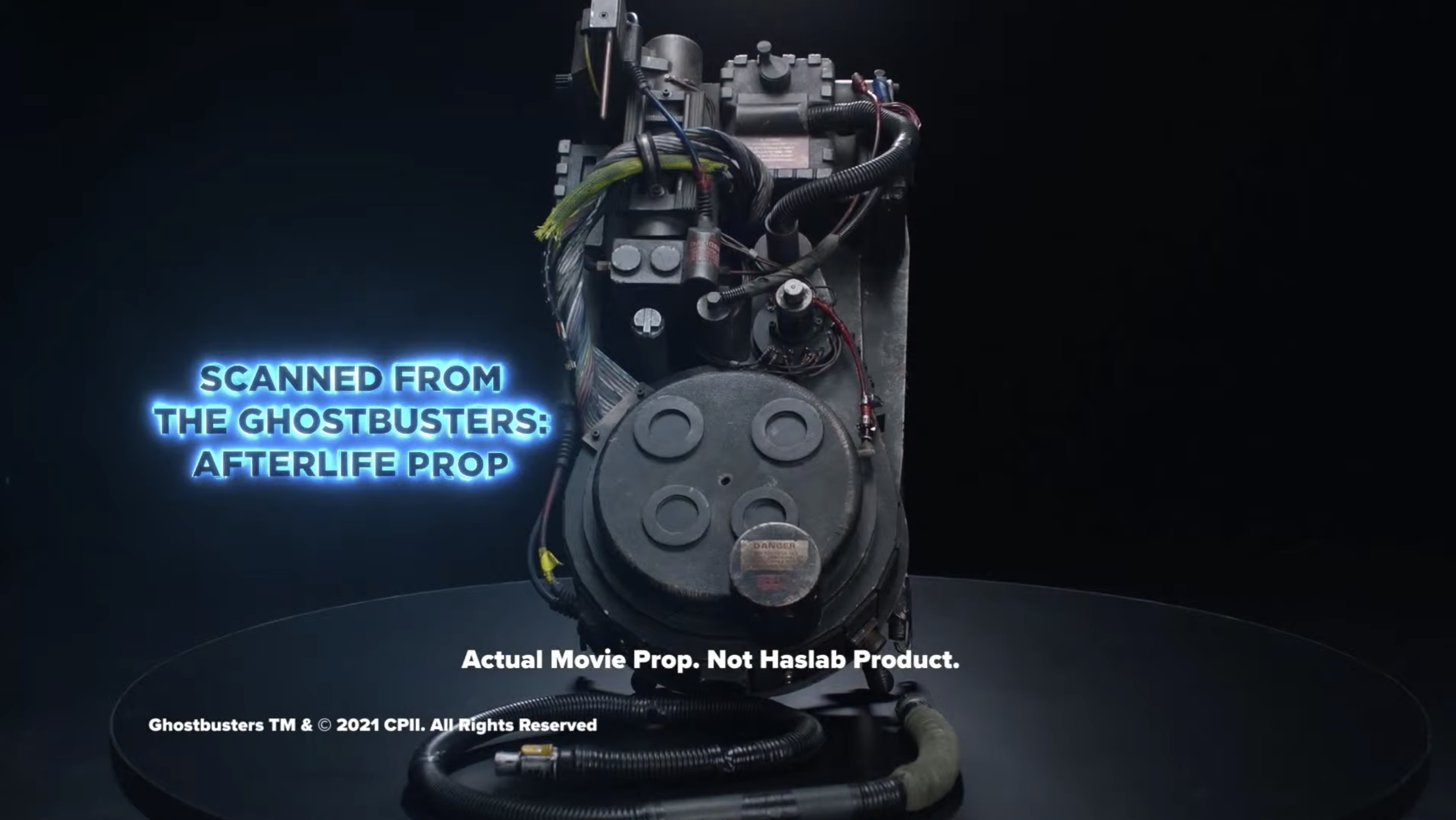

Did they scale it down after scanning the screen used pack? Or is the Afterlife pack supposed to be smaller seeing as its used by children in the movie?
