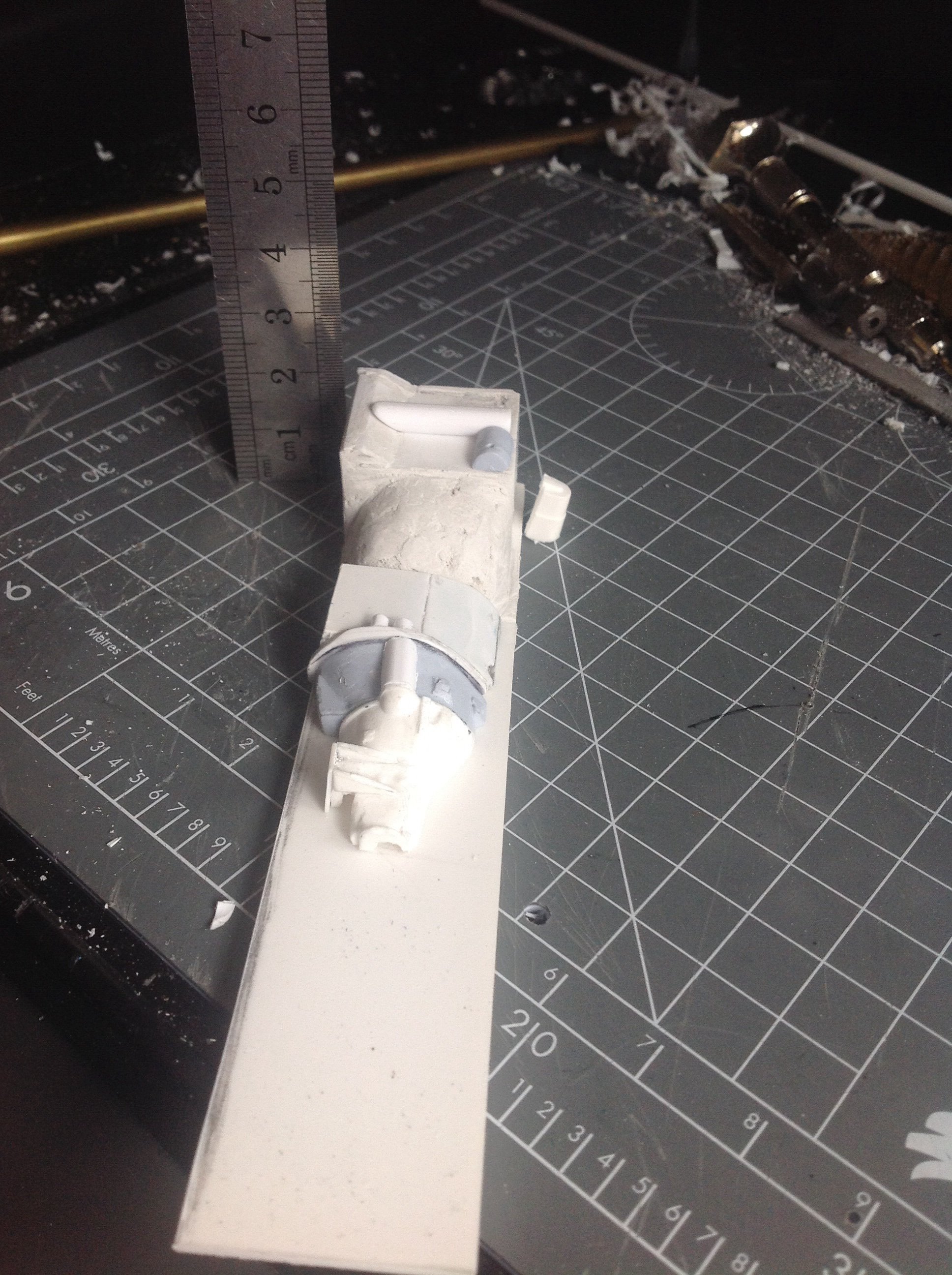

Help needed with getting a dimension from Entex Rotary Engine,

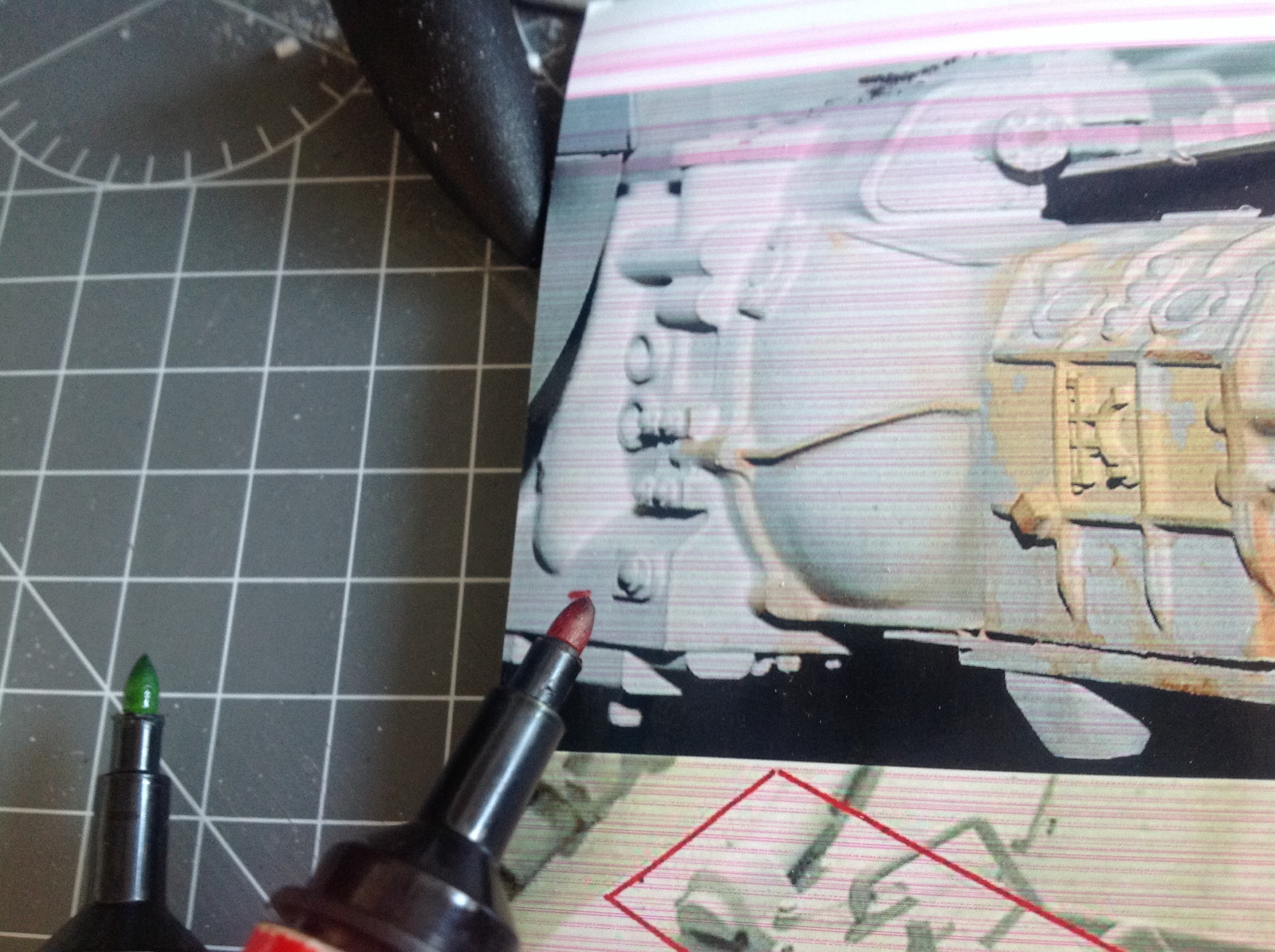

currently I am eye balling the depth of the case, but the rear looks too deep at the rear, if anyone has the 1/5 entex rotary engine can they measure the depth, see where I have the ruler against my scratch built engine,

Hi guy, I measured the part you mentioned. It is exactly 1.25 inches, where you show the ruler. That measurement doesn't include the detail pieces on the sides. Cheers,

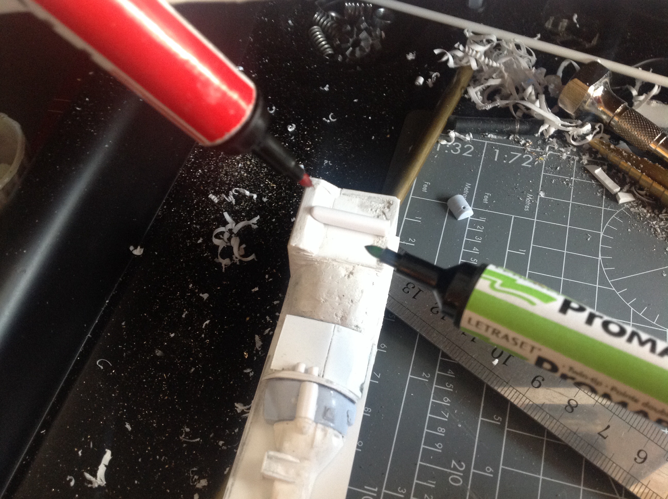

Joe,
thanks for that, just to clarify the 1.25 inch is where I have the green marker pointing to, if you can give me the depth to the lower lip where the red marker is pointing to I would appreciate it ,

Joe,

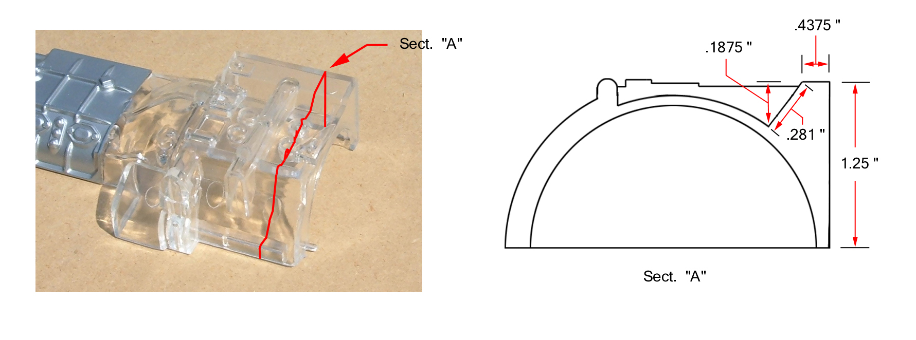

Hey man, Made up a little drawing. Hopefully I got the Dim your looking for. The drawing is a bit busy. Tried to squeeze it all in, LOL. Let me know if you need any other Dims, Cheers,

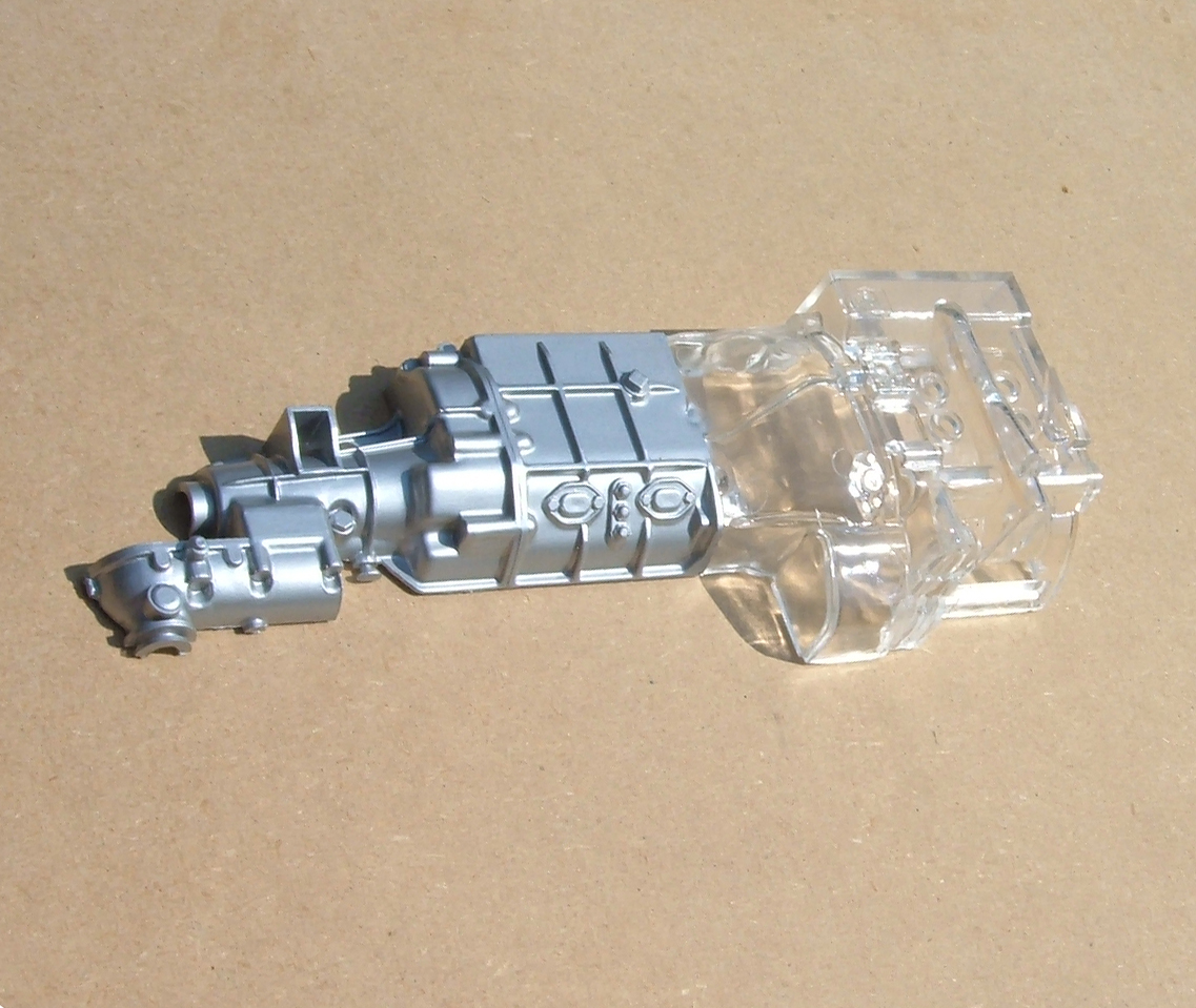

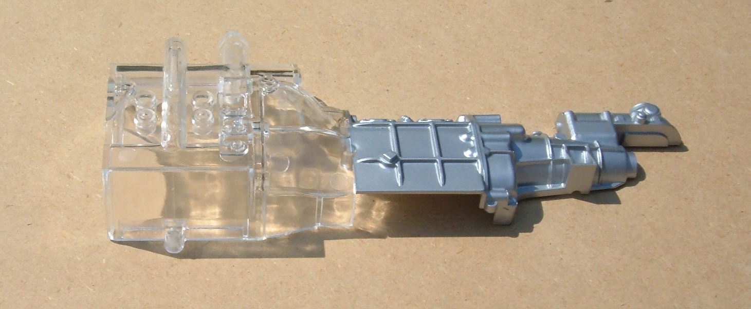

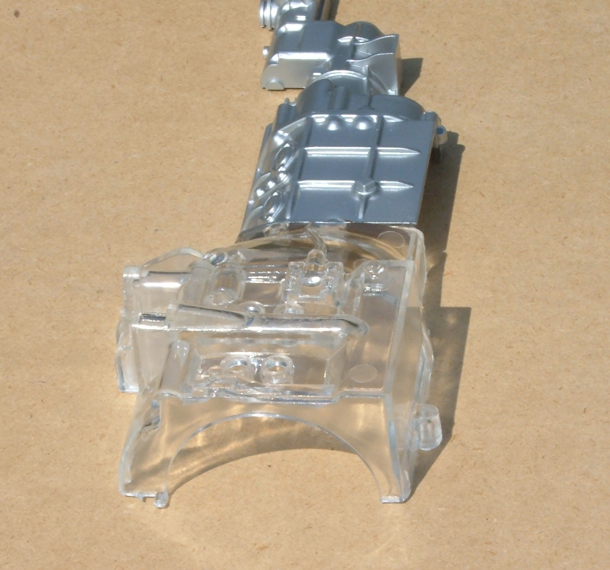

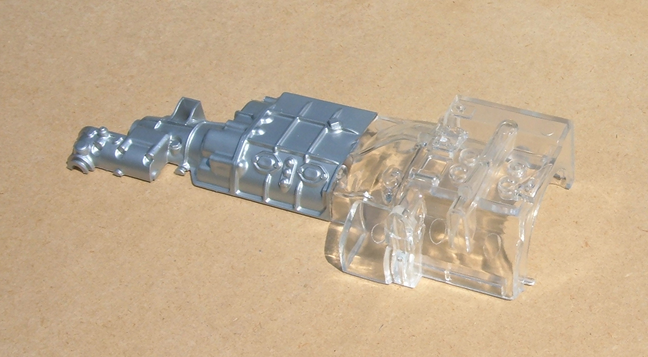

Threw in a few pictures of the part. Hope they help.
Thanks Joe, you went above and beyond there , thanks again. And the pictures from all directions really help understand the shape,I will cut up mine immediately with my new scaled part.
The one I had made would not fit between the cockpit and the wall without being cut, the original had nothing removed so I knew there was something wrong with my depth measurements.
Once its done ill offer the piece up and see how it looks.
Brian
Glad I could help. The part is a little hard to see since its clear. Can't paint mine though, because I want to cast it. I have a long way to go before I start putting parts on the five footer. I just want to get a "nekkid" shell built, to see how big this puppy actually is. I'll just pretend its at a Corellion shipyard right after being put together. Long before Han won her in that Sabacc game, LOL.
