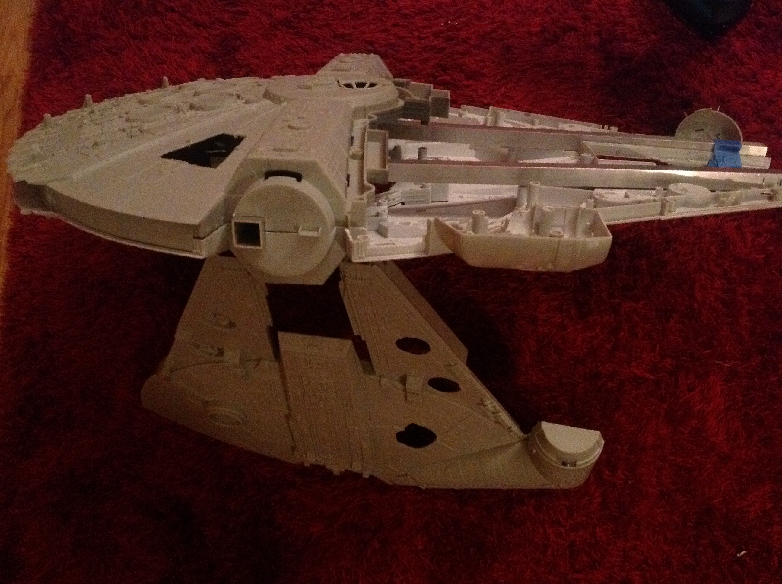

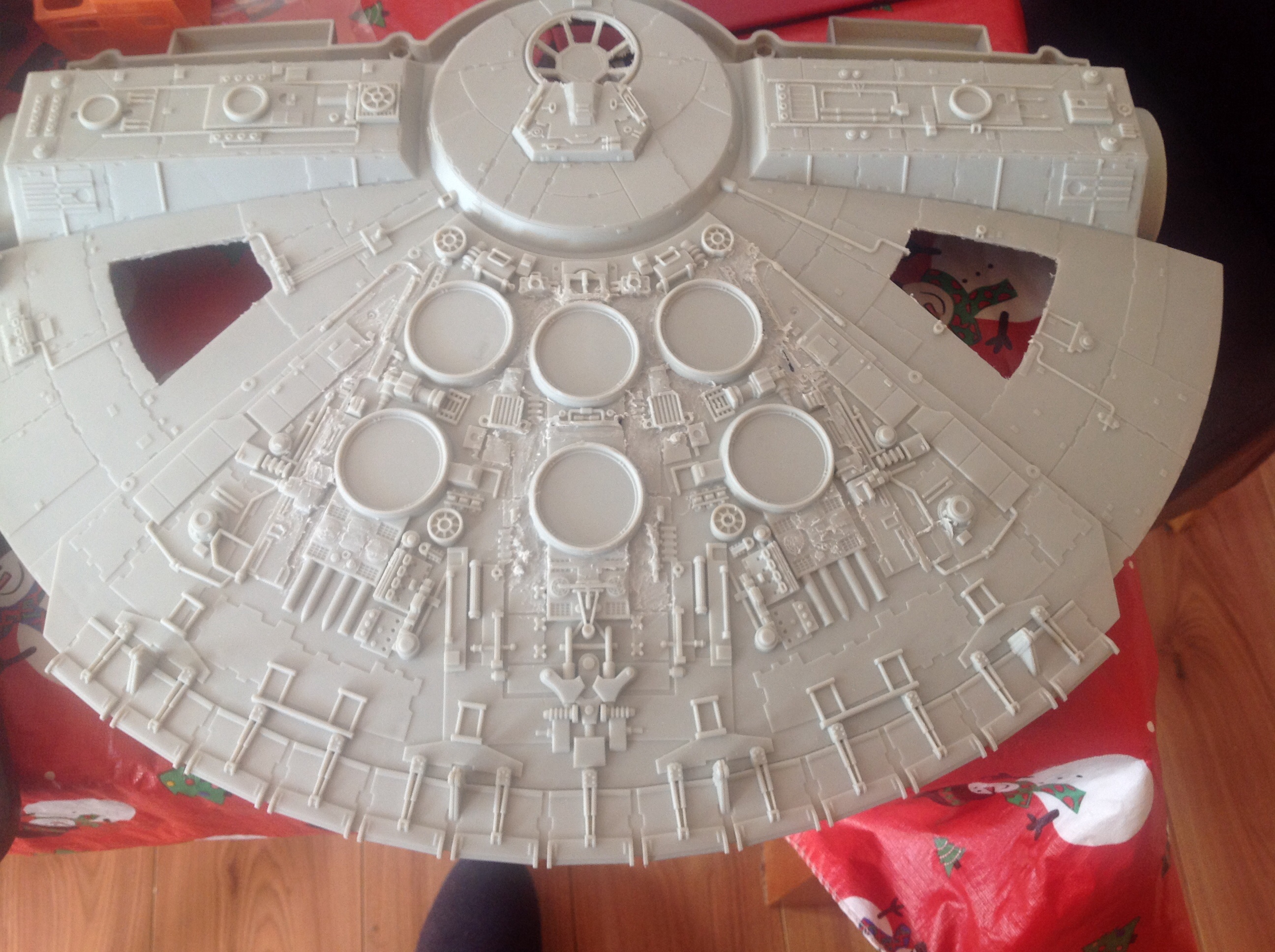

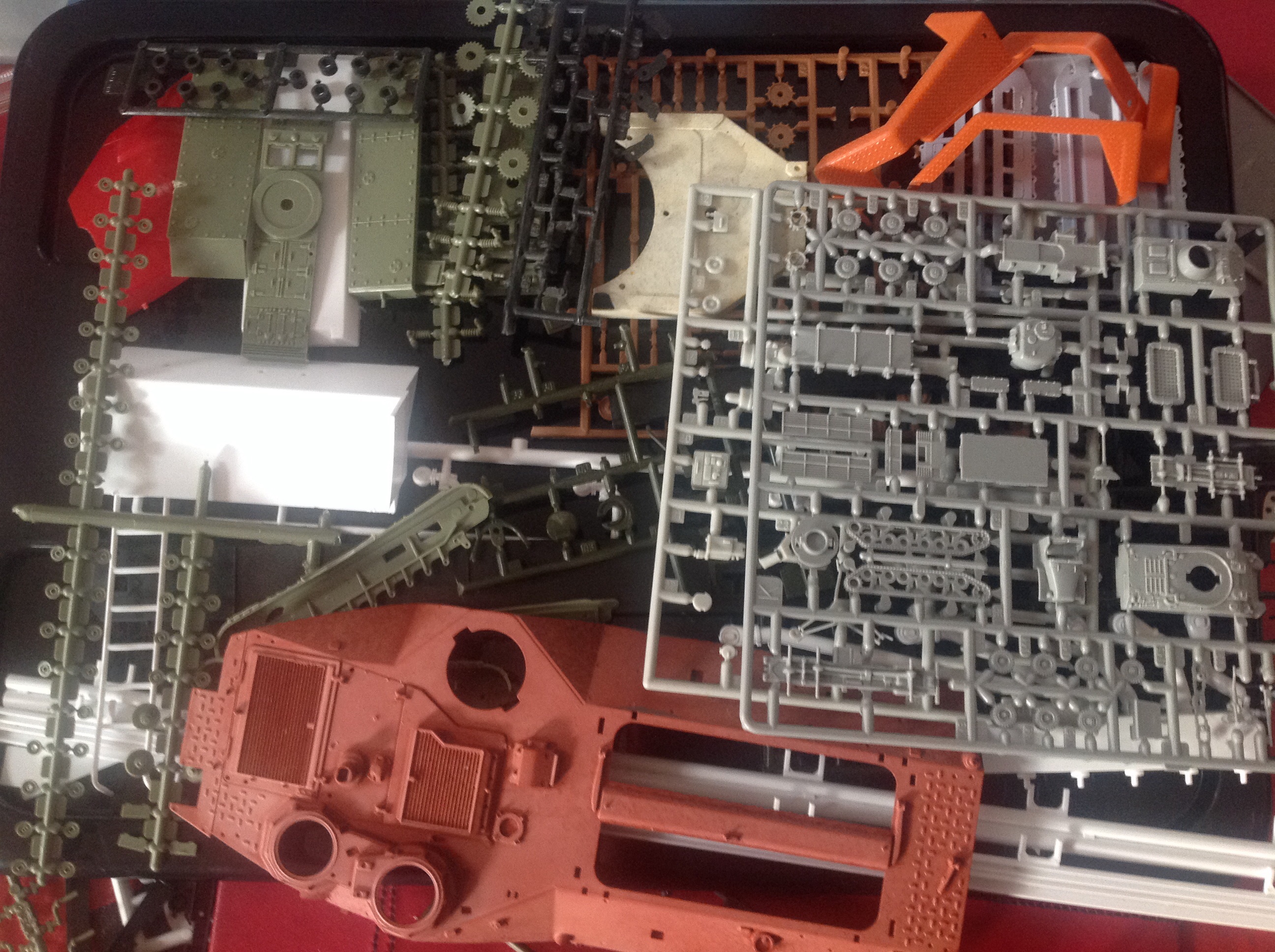

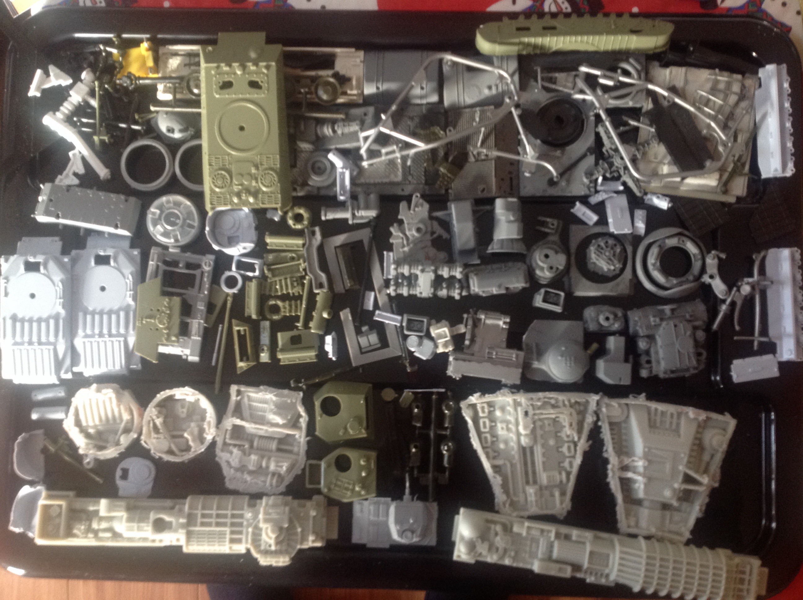

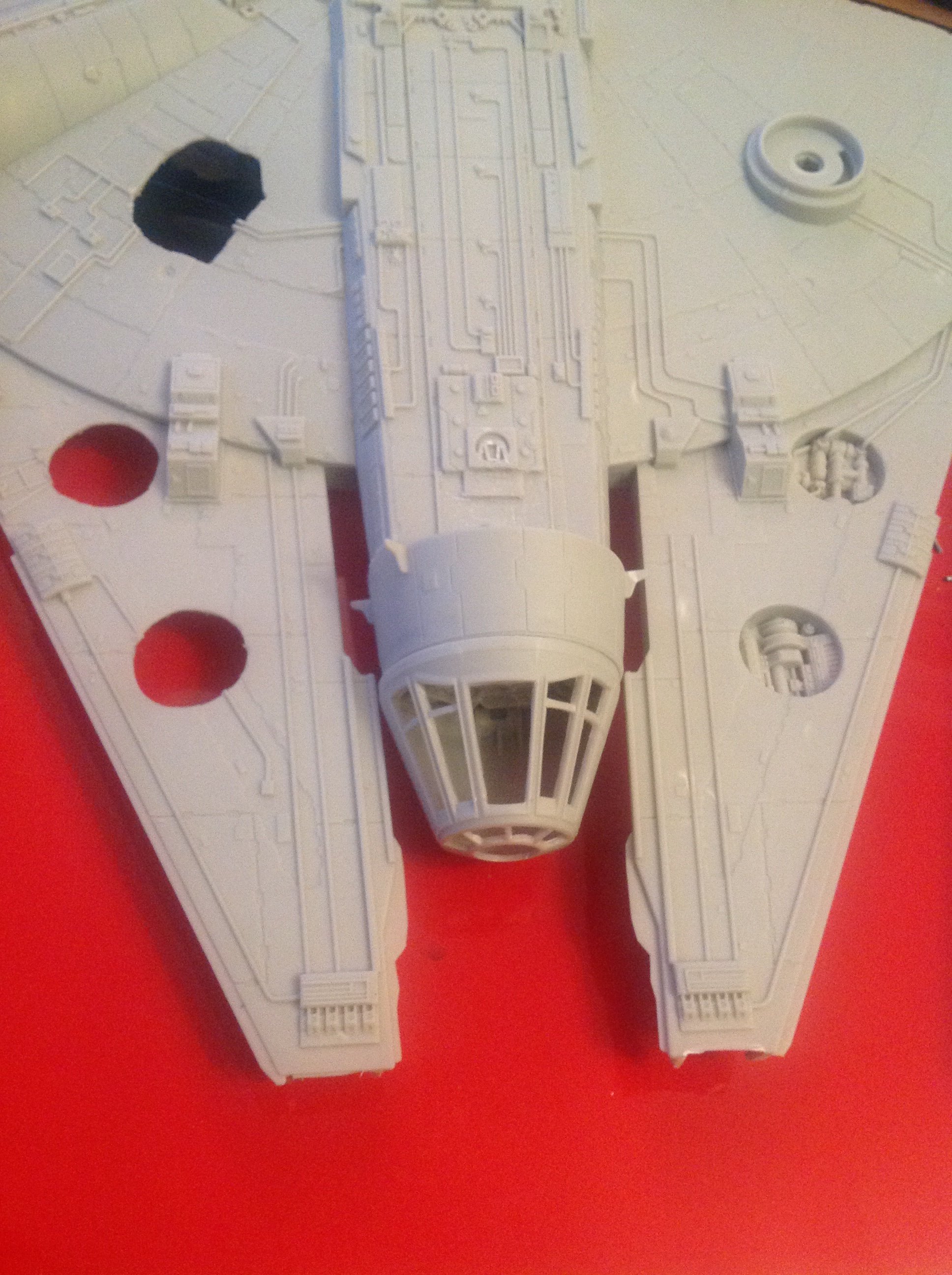

Cut out the recessed areas last night and attempted to remove items that should be pipe , I am still undecided about replacing actuators with brass tubing ,
areas are not as clean as some others posted here, I would say for anyone starting this alteration now chisels and scalpel are cleaner to pare the items down , I still haven't found a dremel tool that is clean with this material. And would appreciate any tips for sanding if anyone has had success .
now the fun part replacing the details , the ultimate jigsaw , the more time I invest the more I am considering buying more kits for key details

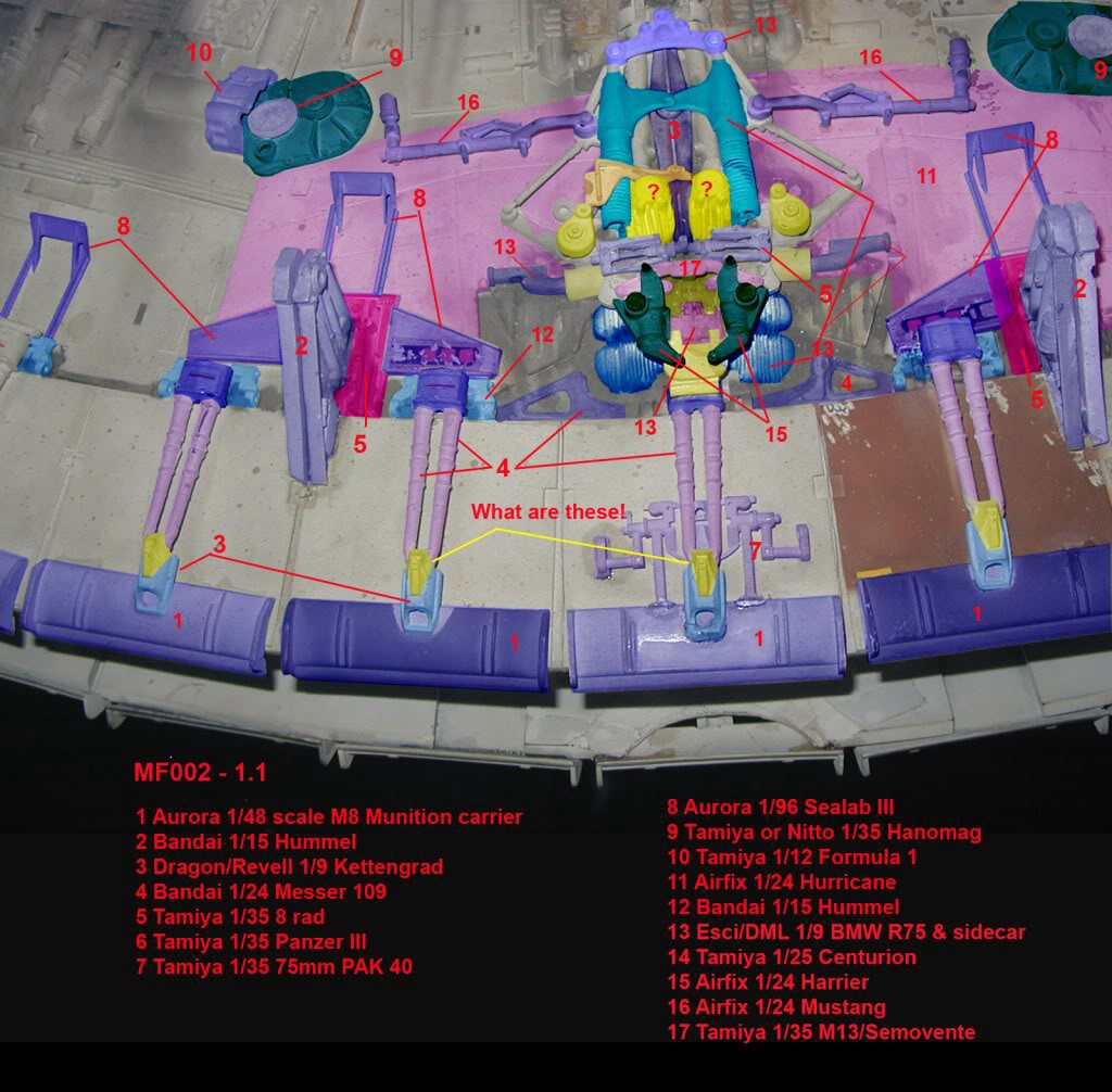

Sorry if this is covered somewhere but I am confused. The kit map calls out the piece as 8 rad , I have this kit but cannot identify which pieces they are , has anyone an idea ?
No 5 in the map picture , been staring at the sprues for some time unable to identify the 8 rad pieces surrounding the verticals , is it only the surround that is 8 rad component or is it also the pipe work/ landing gear items surrounding it ?

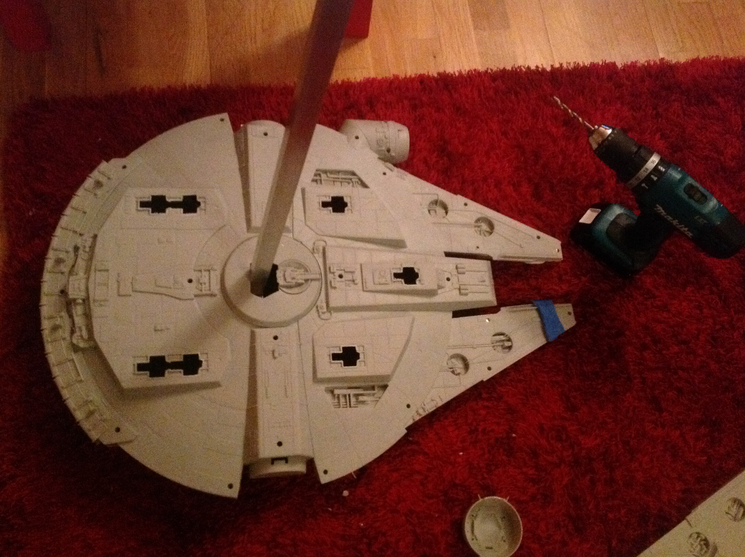

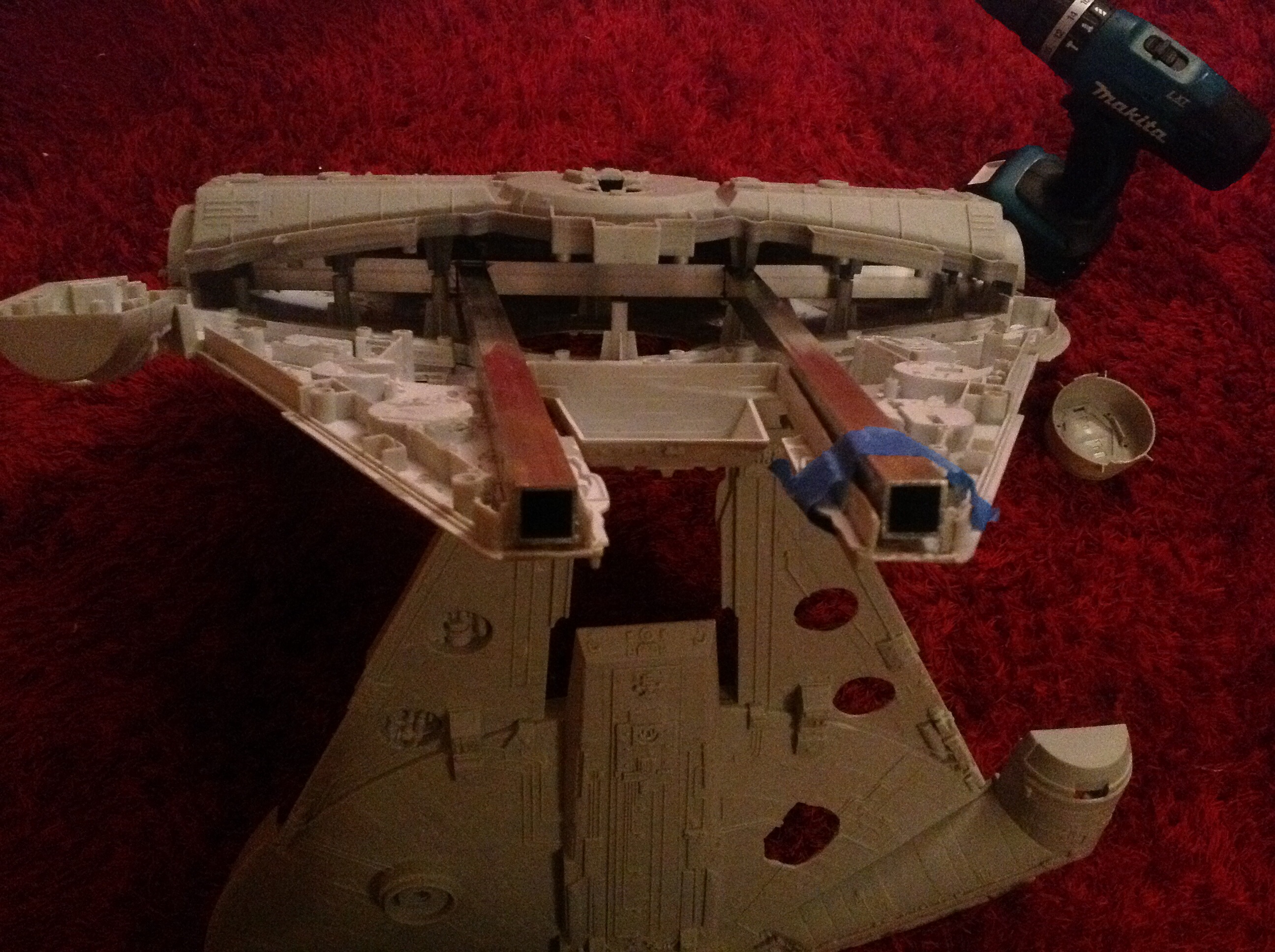

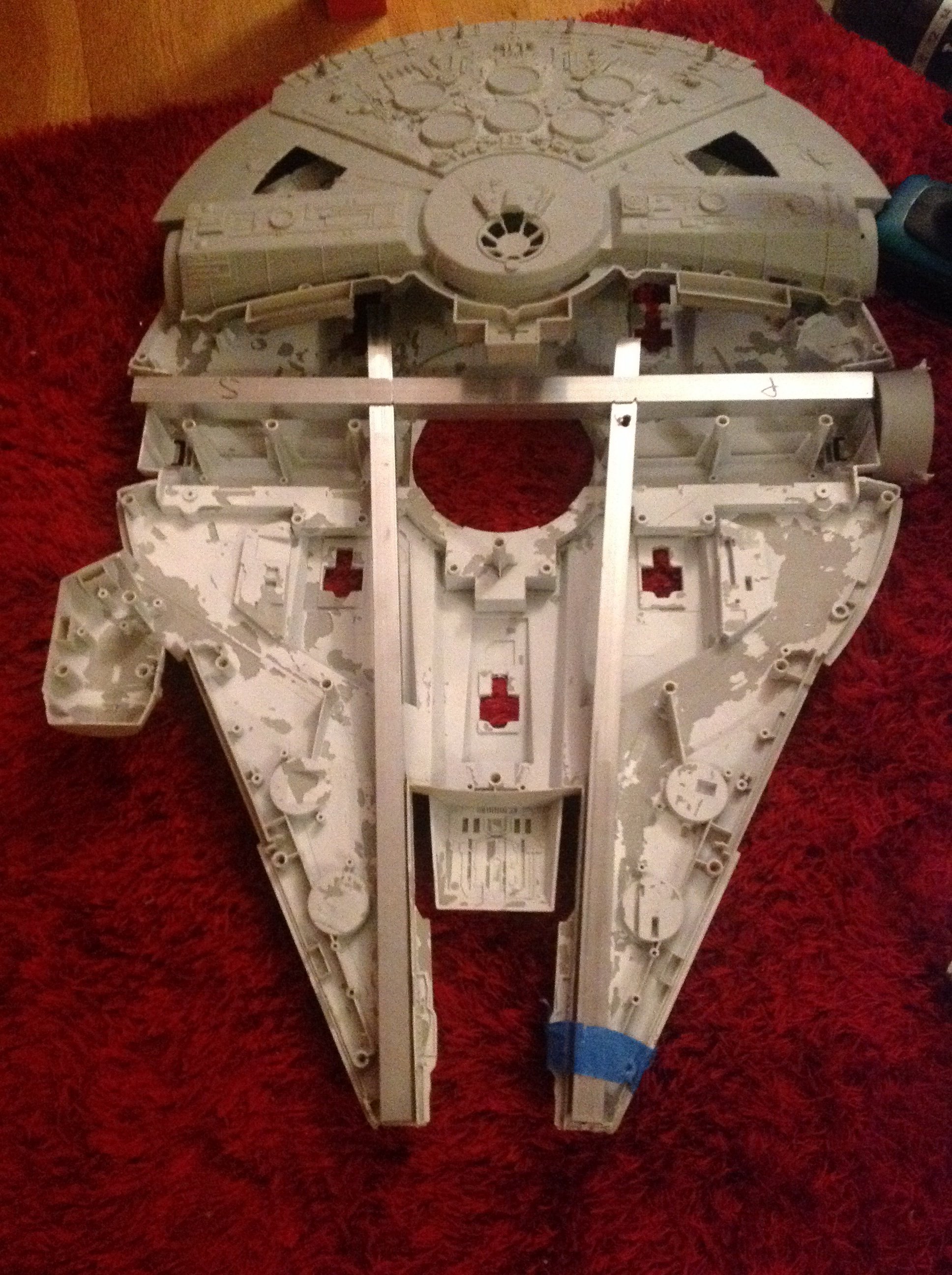

Aluminium skeleton nearing completion , this will aid structural rigidity , the ship should flex less, this will give the falcon 5 mounting points , I could do 6 but it will depend on how it goes over the next few weeks. I will fit docking rings , lower canon and mandible fronts to these docking points when not in use. Now I have something to attach my engine lighting kit assembly to :)

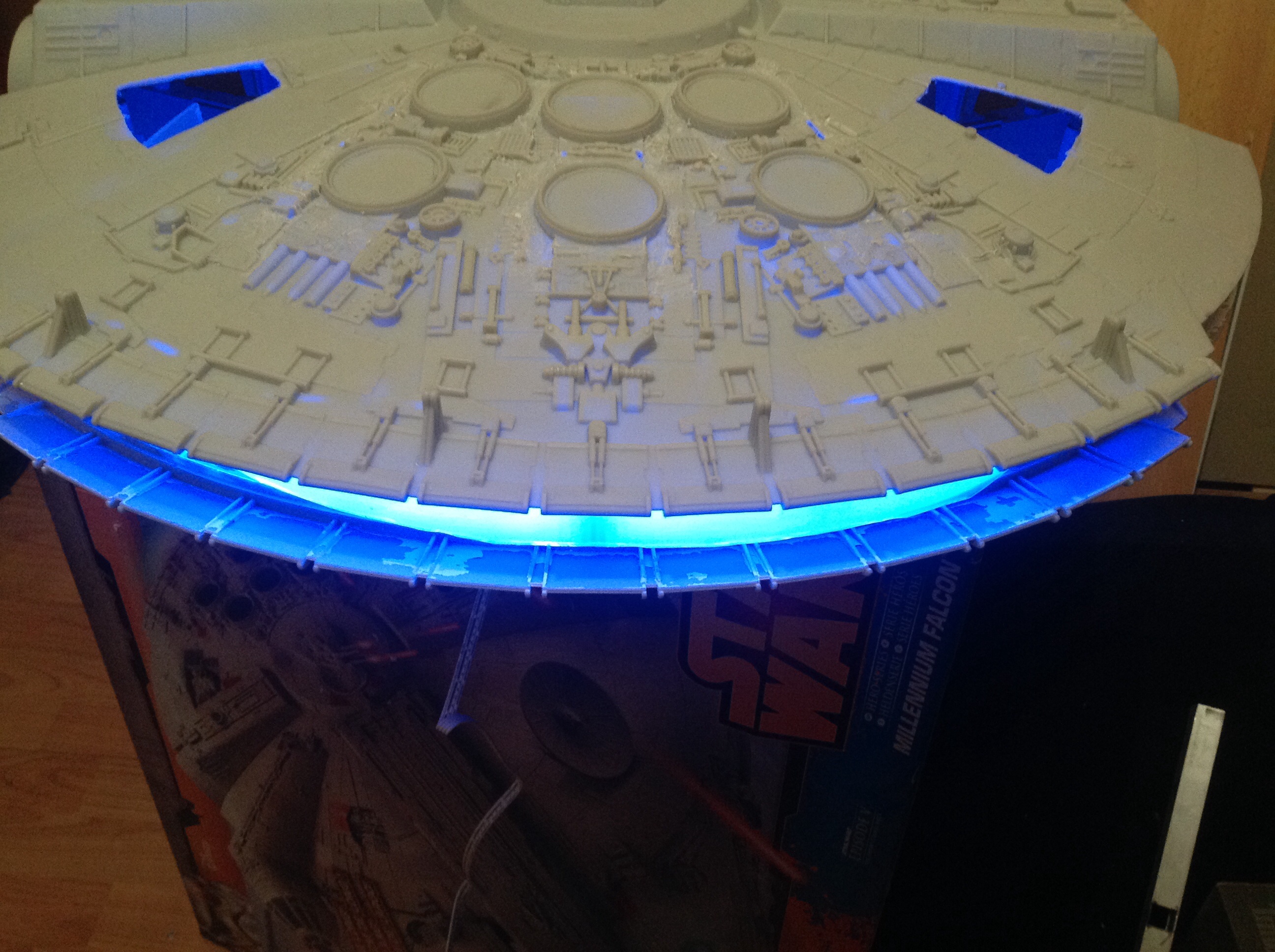

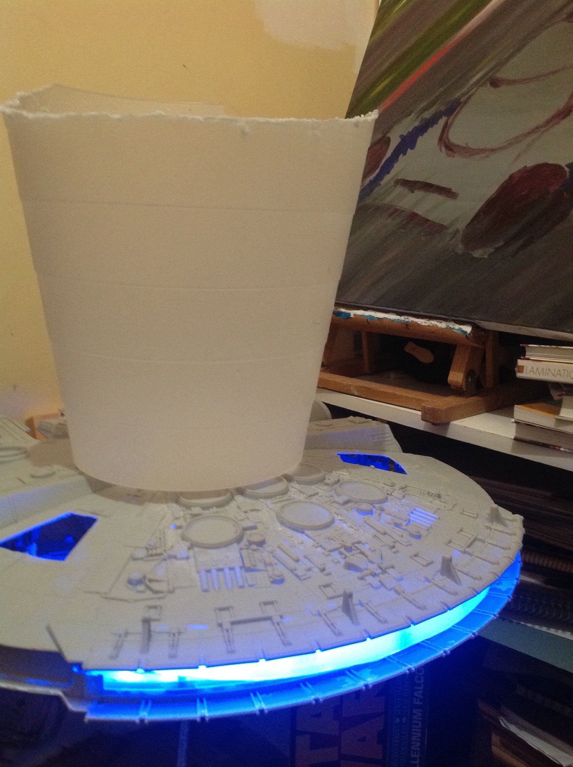

With this in mind I found a mass produced controllable led system that was flexible enough to suit my needs
the engine diffuser is as per a previous posters method of a waste paper bin cut to size.

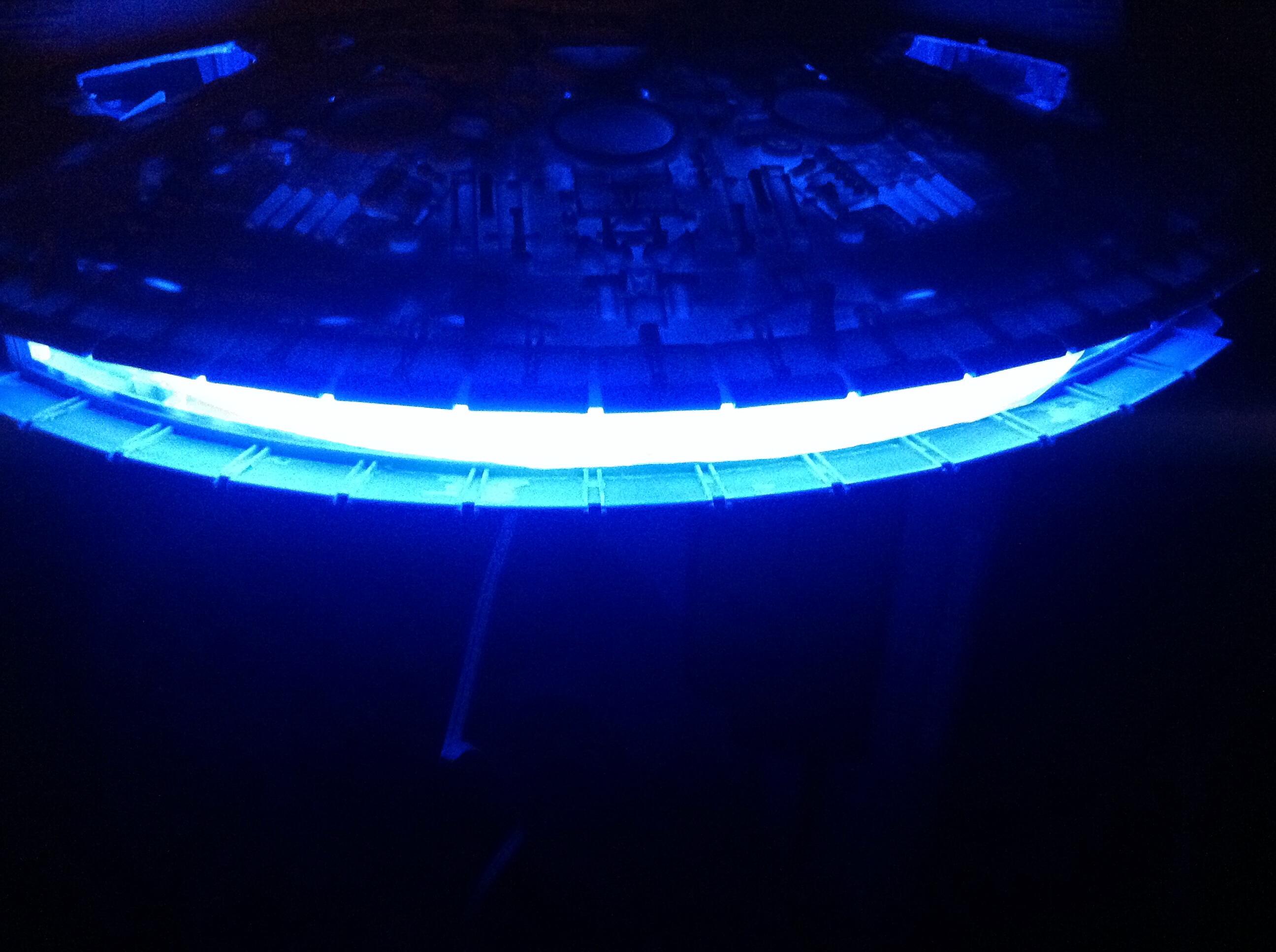

please see my test shots and see what you think, I am very pleased especially with the lights off, but also that with ambient lights on it's still strong.

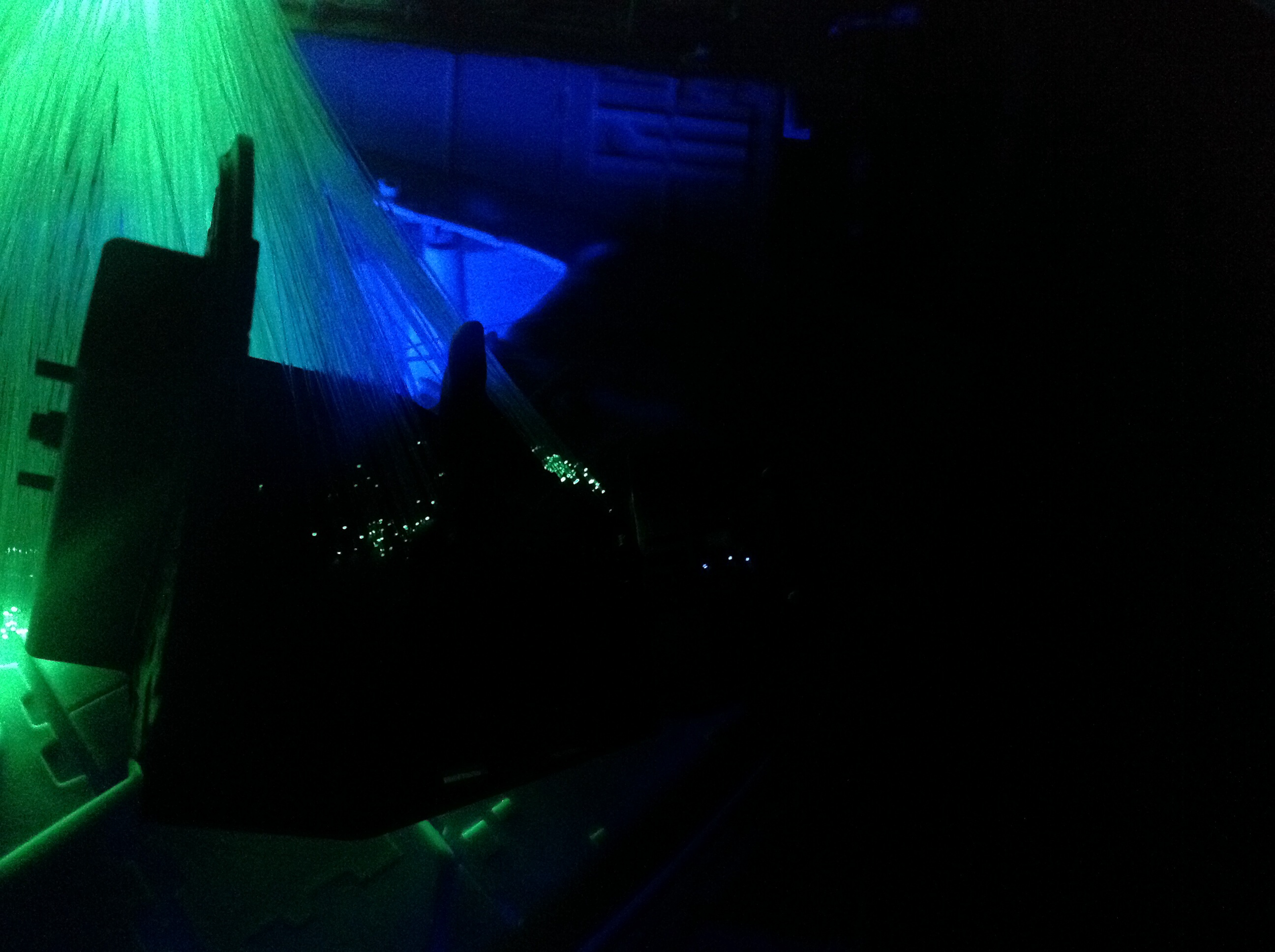

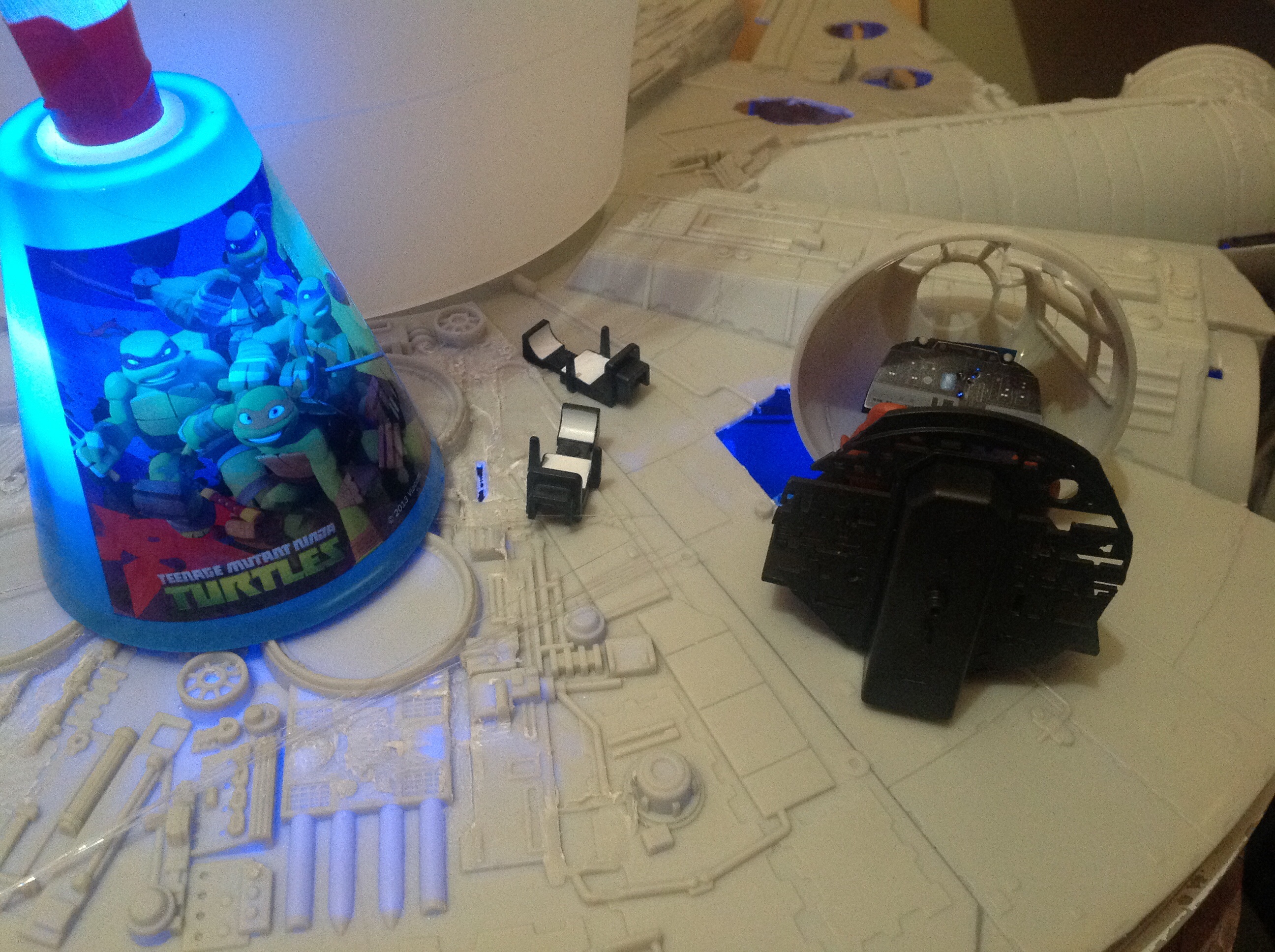

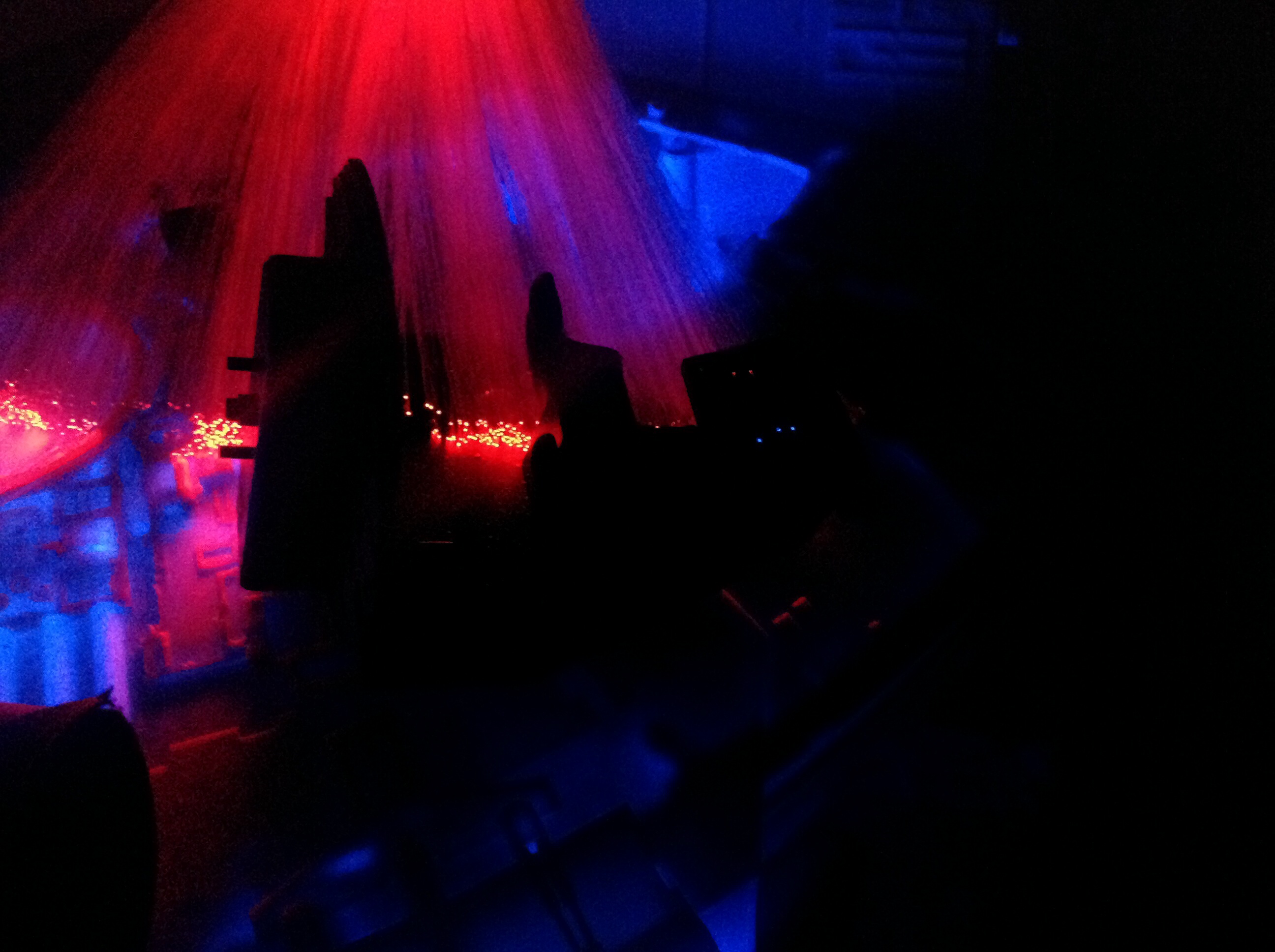

Another set of lighting tests I did today was for the cockpit. Over christmas my children received fibre optic night lights, the minion one is rubbish but the turtles is excellent. I hunted down one on sale.
the test shows the cockpit front panel threaded with 3 fibre strands being fed from the engine light, the remainder will be fed by the night light, when they are distributed around the cabin it should look bright and busy.
the third colour will be white fed from a dedicated white led or something else I am testing by hot wiring the engine lighting circuit ( more to follow)
In the test shots in the right you will see the blue feed of three strands from the engine while the changing ones are on the left. Not too shabby in full light either but being in the cockpit they should be in shadow the whole time .

Vac, love the engine lights, any hints where to get the LED system? Would be well happy if I could have an engine lit like this.
D
Hey Vac is the Sylvania Osram set up?
D
Hi it's IKEA Dioder system , multicolour straight led , very very bright 12v that you cannot look at directly in any colour
http://www.ikea.com/us/en/catalog/products/50192365/
i am planning to combine them with other LEDs for the cockpit , I am playing with some white from Ikea , they have another system with round lights that could be great for the large x wing or blockade runner , althought the cost would be prohibative for 11 engines , but could be done.
Once Iam ready to mount in final config I'll post
As an aside the bin was also IKEA very cheap :)
