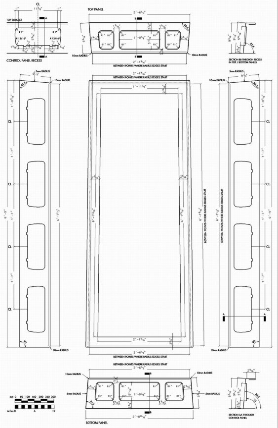

I was referring to some reference material that I have seen. Others have added an extra interior angled backing to the panels to give them a more significant slant. You can see here in these drawings in the lower right corner what I mean:
Here's a bit closer view:

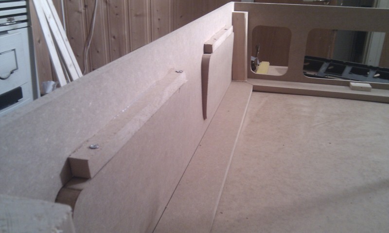

Here's a photo that another builder posted of the incorporated angled backing:

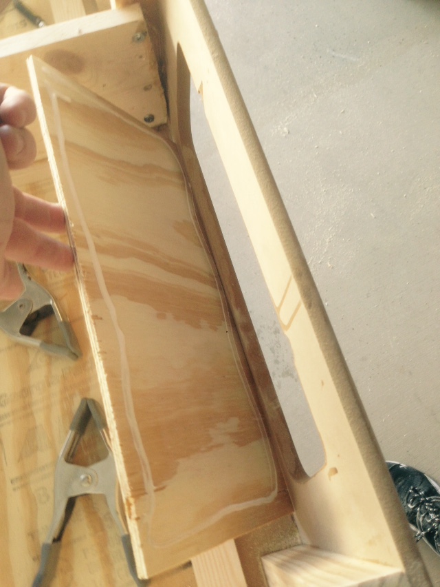

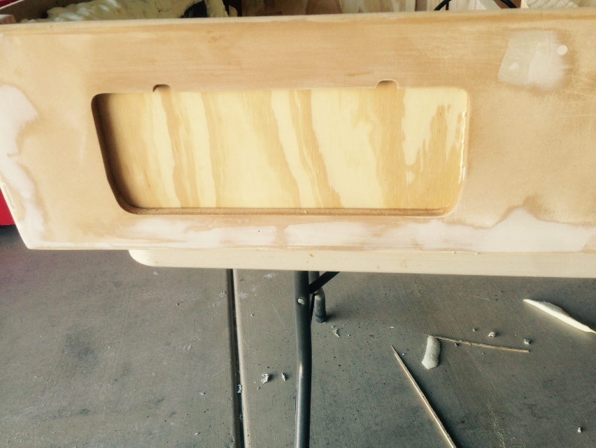

Since I ordered the box kit from Zenix, the panel holes were pre-cut and did not include the cut out pieces. I didn't think I had the wherewithal to cut and match the cutouts exactly with the tools I have on hand so I elected to just screw and glue some thin plywood pieces behind the holes to offer a flat back.
Here is mine:
Photo Feb 18, 3 30 09 PM.jpgPhoto Feb 18, 3 30 25 PM.jpgPhoto Feb 18, 3 30 45 PM.jpg
I didn't think that it was a big enough alteration for anyone but me to ever notice so I went with the flat back.
I think I see - technically your panels are sitting on the wall at its angle, when the original prop mounted them on a surface perpendicular to the back wall?
I think so. I think the original just decreased the angle slightly. I'm not sure why. I decided to skip it.
In that drawing, it looks like they removed .5 degrees from the angle to make the panel protrude evenly from the side wall all the way around. I think I kind of like their surface being at a steeper angle than the block's wall, the way you've done it! It kind of puts the panels on display more from the front.

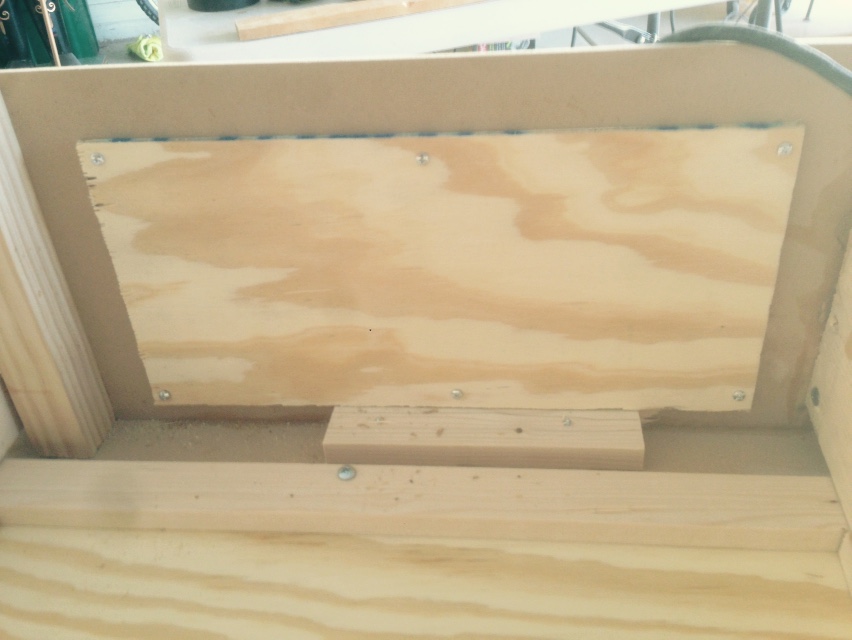

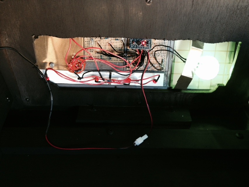

I'm preparing to move this beast inside and I took a couple of "behind the scenes" photos. I had to cut out the panel backs to accommodate the wiring so that it would not get smashed or crimped and potentially cause a short. I know the cutouts are not as pretty as they could be, but since no one will ever see them, I don't mind.

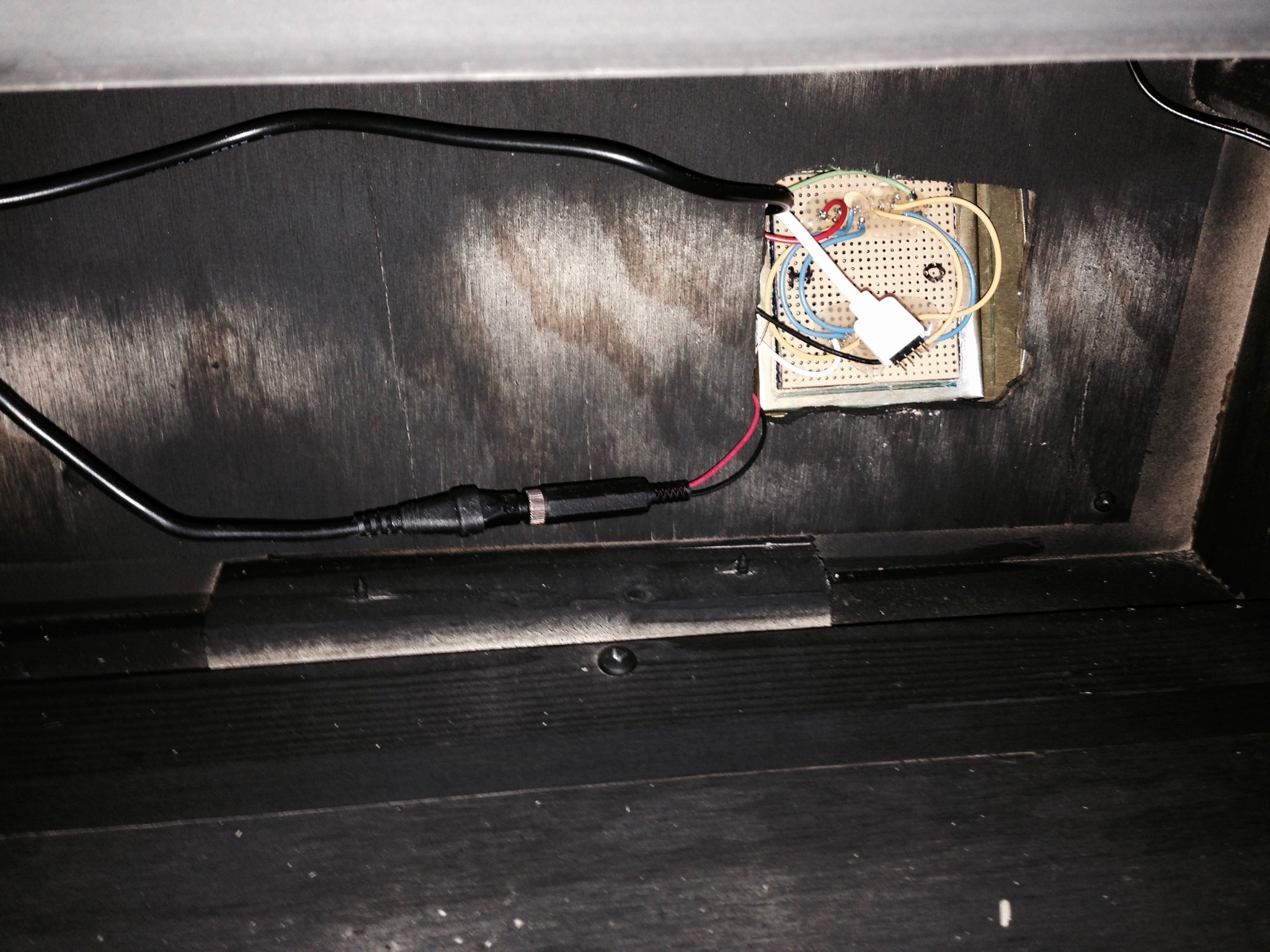

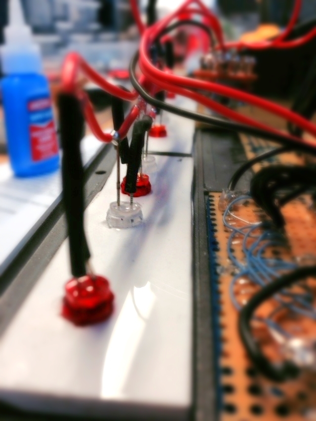

The white lights on the Hero Panel suddenly stopped working. I did some extensive troubleshooting and couldn't figure out what was happening. I finally realized that a single drop of super glue had hardened between the two leads of one of the LEDs and caused a short. I scraped away the glue and it's good as new. You can also see here the "sign white" plastic backing that I used for the LEDs on this panel. I got the sample sized squares from "Tap Plastics". It was just a few dollars with shipping and I didn't have to buy the more expensive, larger squares.
I imagine that is what the hero HIC looked like from the inside as well. How in the world did you ever find out it was a drop of superglue shorting the circuit? Good eyes, man.
I quite literally tried everything. I was monkeying with my exact-o knife and a spare LED I had lying around and realized the leads were getting power right up until they reached the dead LED. I scored the base of the LED and realized there was some glue residue there and I removed it and viola! Pure dumb luck. Of course I congratulated myself on my electrical engineering skills and did a Wylde Stallions air guitar to celebrate.
