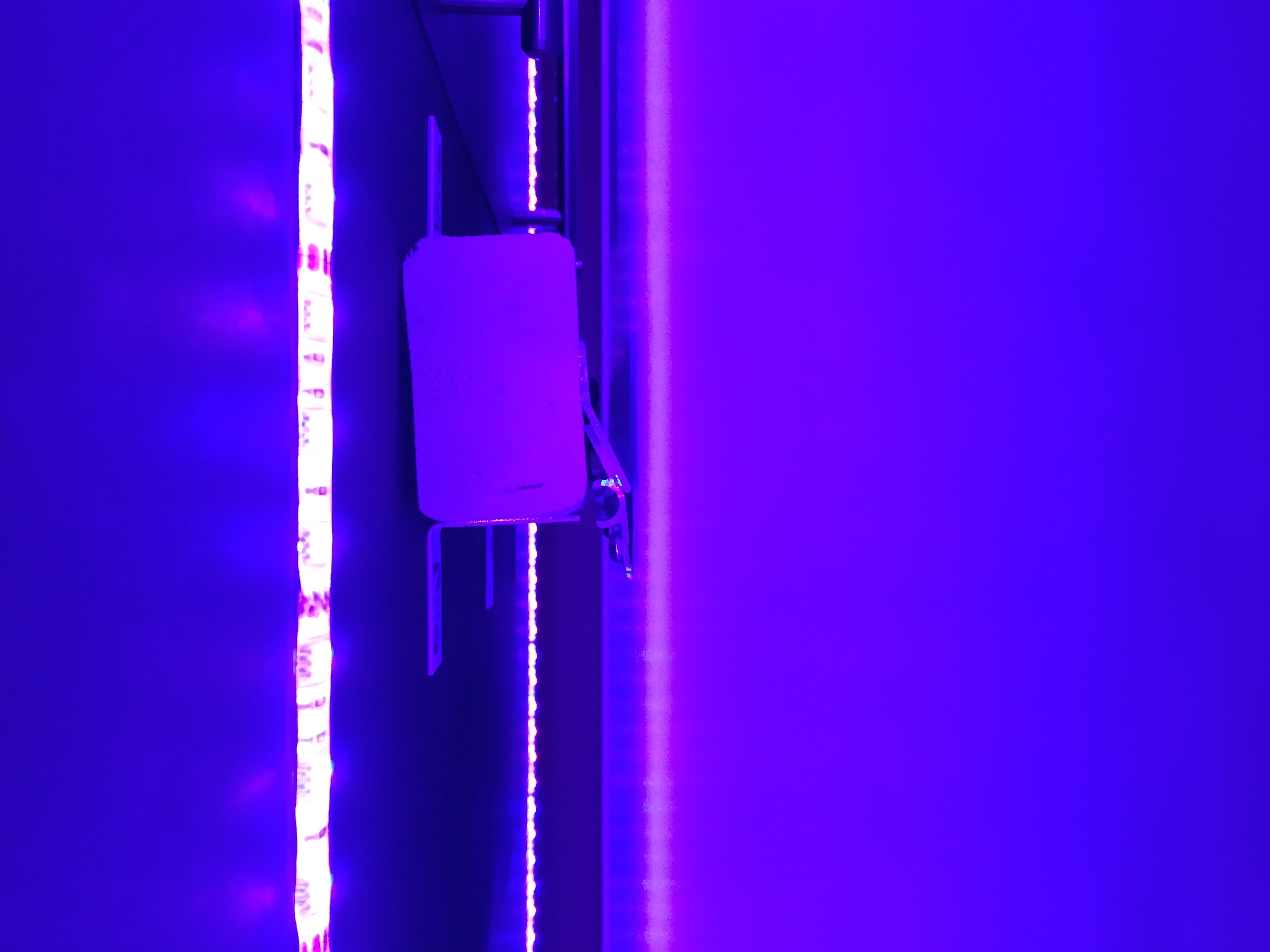

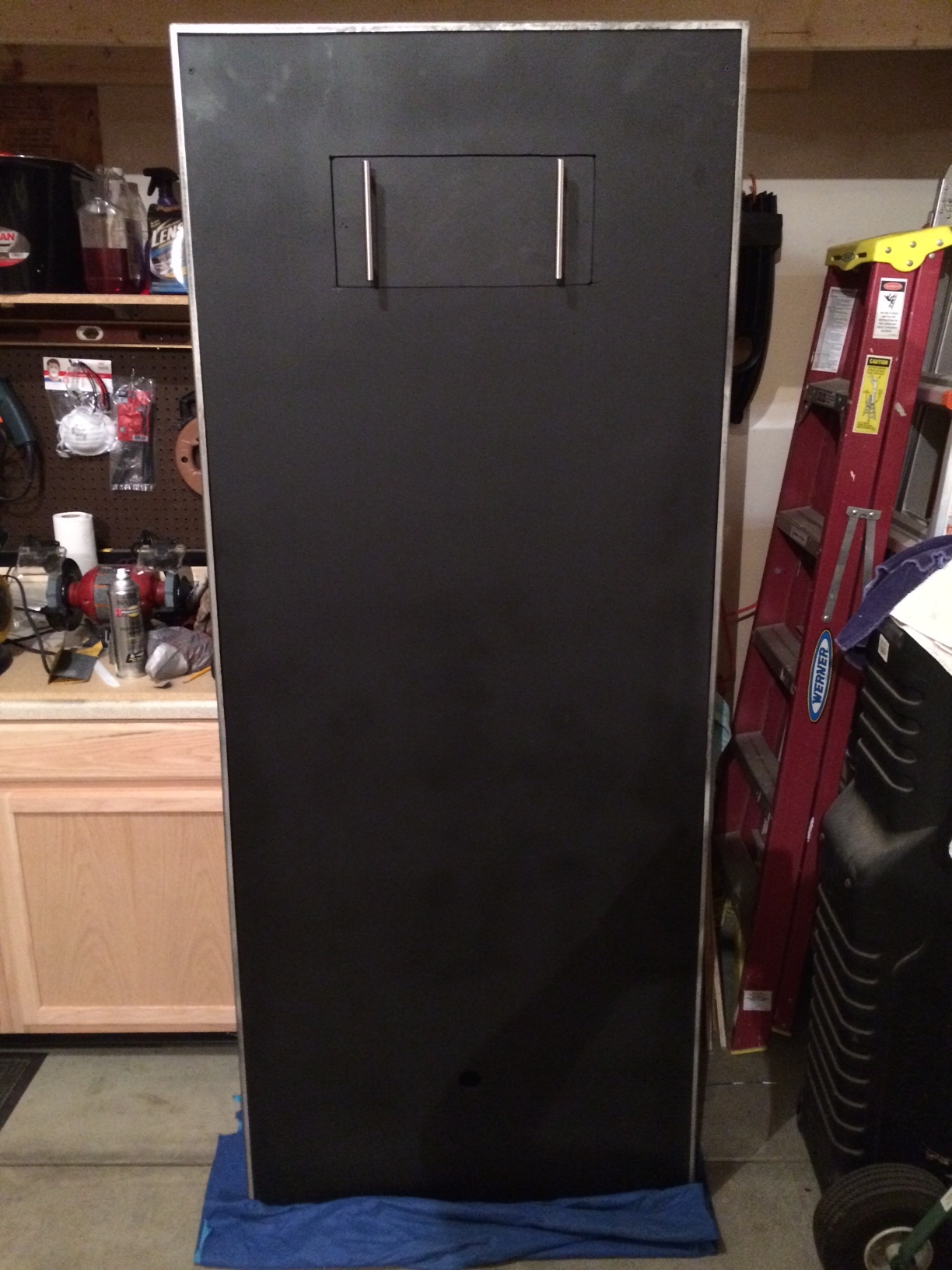

For what it's worth at this point, I was able to hang my HIC on drywall with simple 200b rated toggles. I used 5 of them to mount a french cleat to the wall. I then used a 2x3 and L brackets to secure the cleat to the HIC. My HIC has a solid plywood back but I'm sure your bracket system will handle the weight just fine. My HIC weighs in at 119 lbs. The 3rd pic with the LED strip is a side shot that shows the cleat on the wall attached to the 2x3 that is bracketed to the back of the HIC. Your hollow mount should definitely work especially if you were able to screw into the studs. If not, then I would recommend the toggles. I have metal studs so I had to rely on the toggles handling the weight.

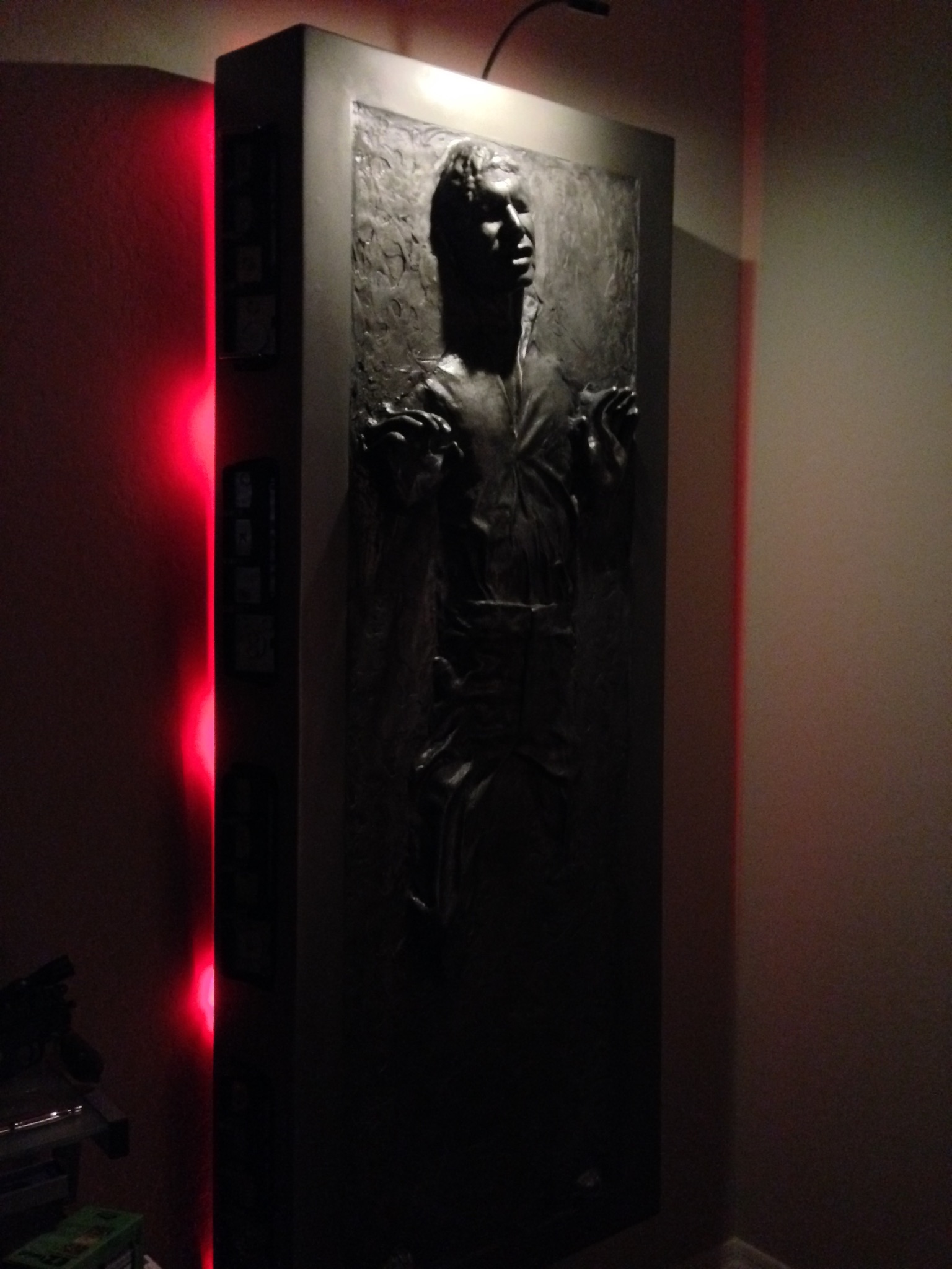

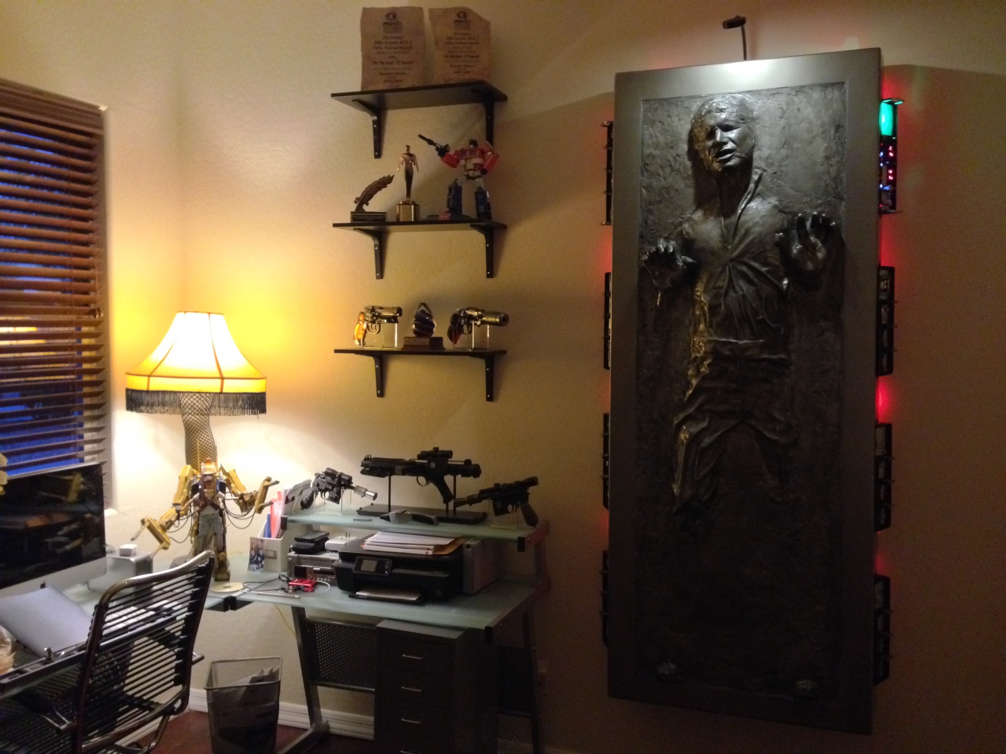

Thanks for the compliment and ideas. Yours looks amazing! The solid back is fantastic.
The TV mount worked out great. It took the weight and was super easy to install. The top of the box is at a height of 8'-2" and the bottom is about 17" off the ground.

It looks like a great learning experience for sure... I'm about to start the build and appreciate your trial & error so much! Between your orange backlighting, the panel electronics and the overhead lamp, you've got such a gorgeous and impressive display. The licensed iterations of this prop look like such clumsy toys compared to what you've put together! You must love it every time it catches your eye. It's really something to be proud of!

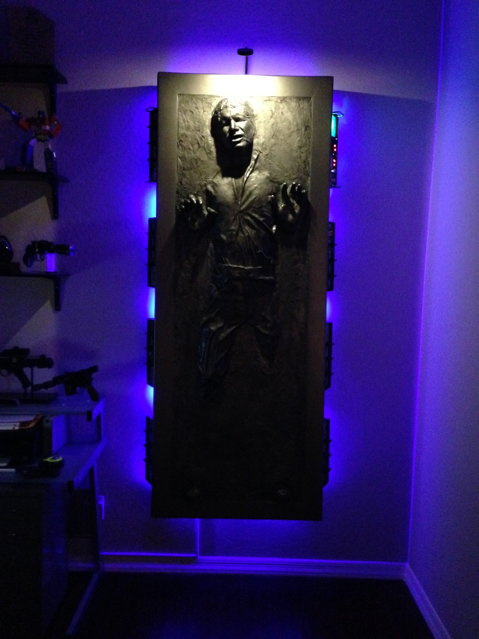

i love the tv mount idea! the back lighting is awesome as well!
Thank you! The one I used is a "Cheetah" mount. It was less than $30 from Amazon and it seems to work great so far. I was originally going to use a more expensive mount but I wanted to try something a bit more budget minded. I like this one because of its slim profile. I'm sure there are better solutions and better mounts, but this one worked for me.

I love the effect the USB light has on it. It might as well be hanging in the Hutt's palace.

Thanks, man! I like that feature too. It's attached in a way that I had not planned on, but the attachment point is in a place that is impossible to see so it doesn't bother me that I had to drill into the top.
