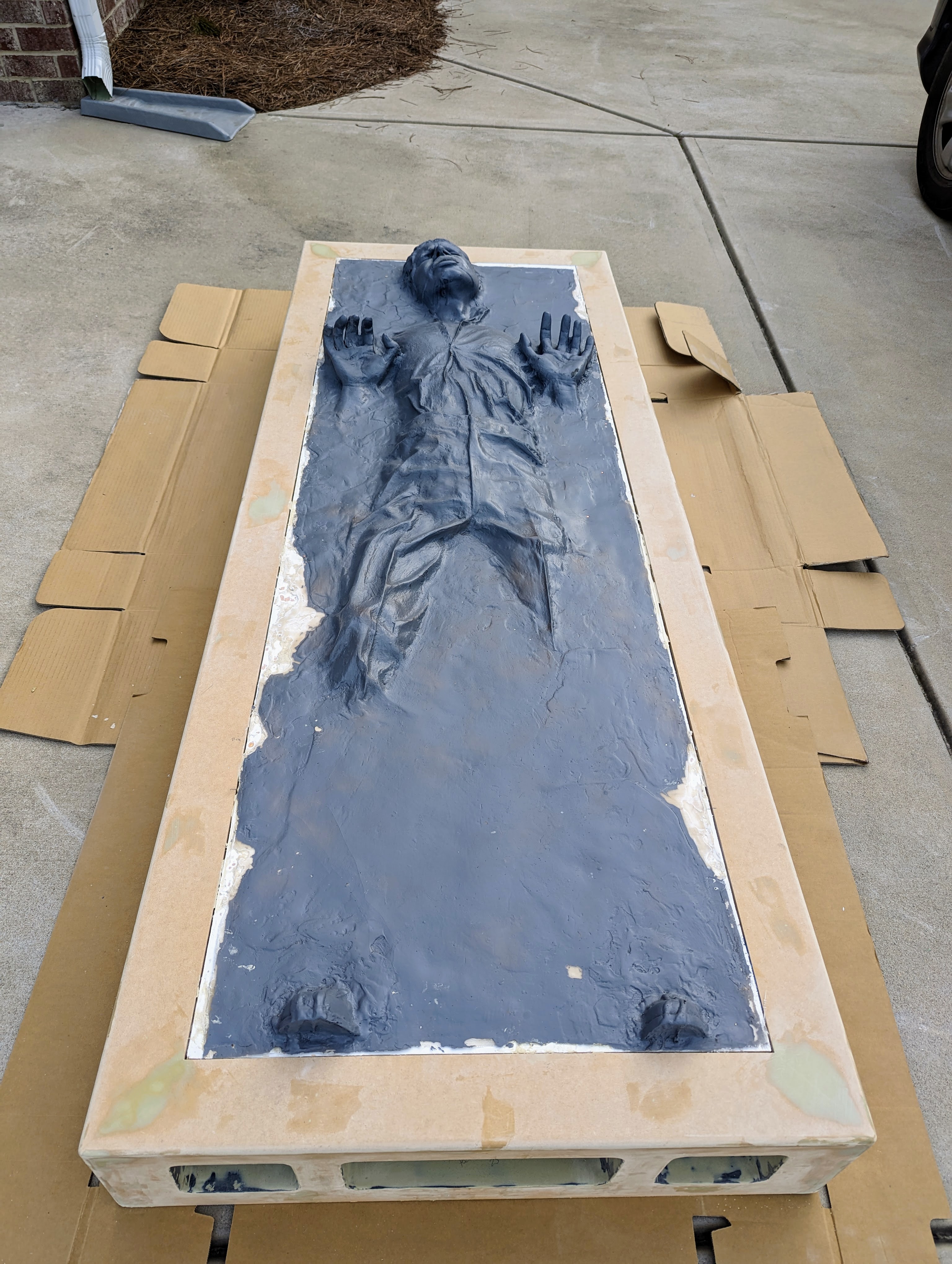

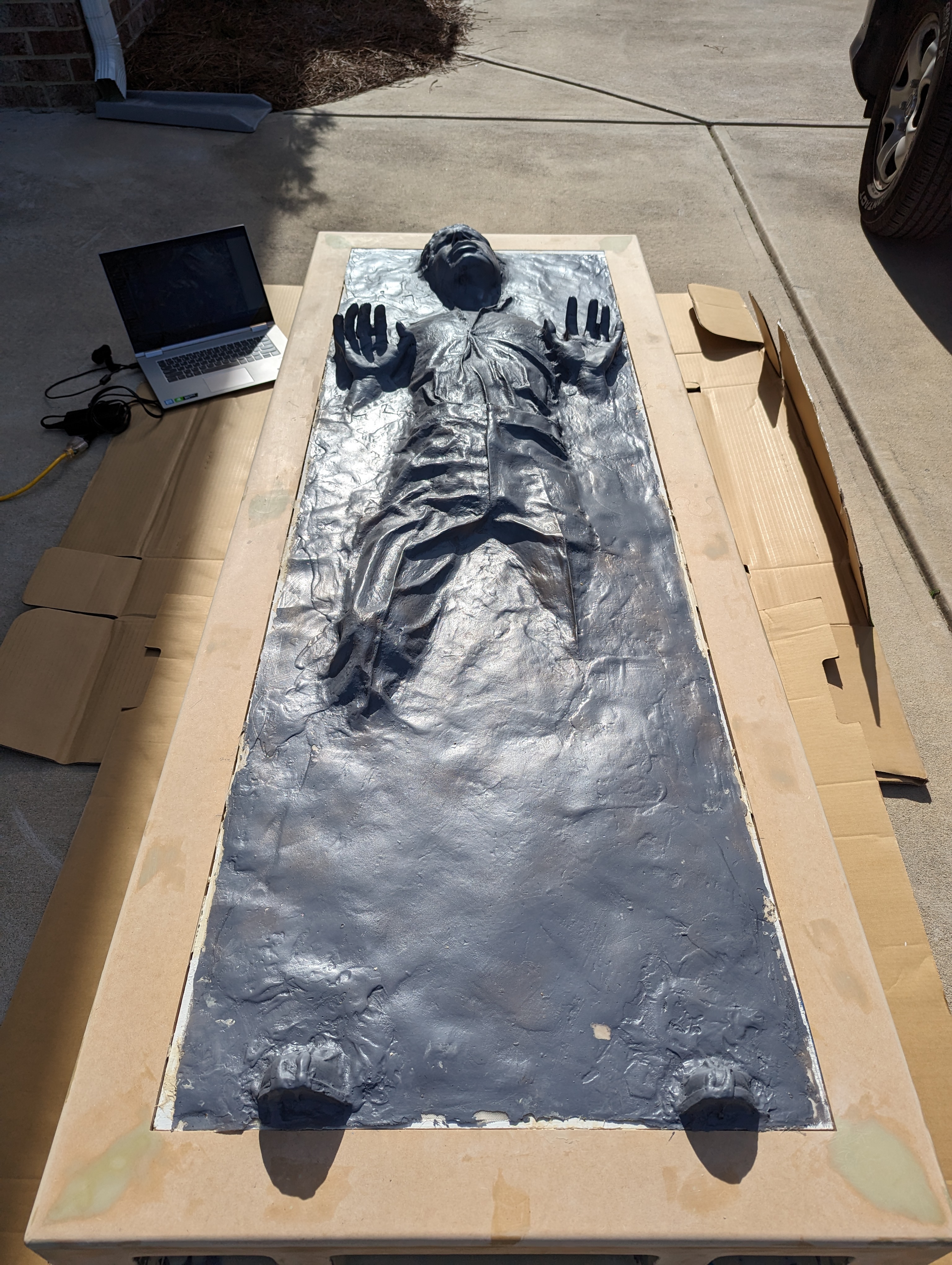

The weather was good today and there was work to be done. Prior to this, I had glued down the fiberglass mold to the box using industrial strength Liquid Nails. In my anxiety over getting it right, I didn’t get a chance to take pics. What you missed is me putting down the mold, checking the position multiple times, and then using a pencil to draw a line across the fiberglass to the frame so I could easily realign it after applying glue. Once I put the glue down I was running around trying to make sure it was in a good position before it dried. By this point, the glue had dried and the mold was one with the box.

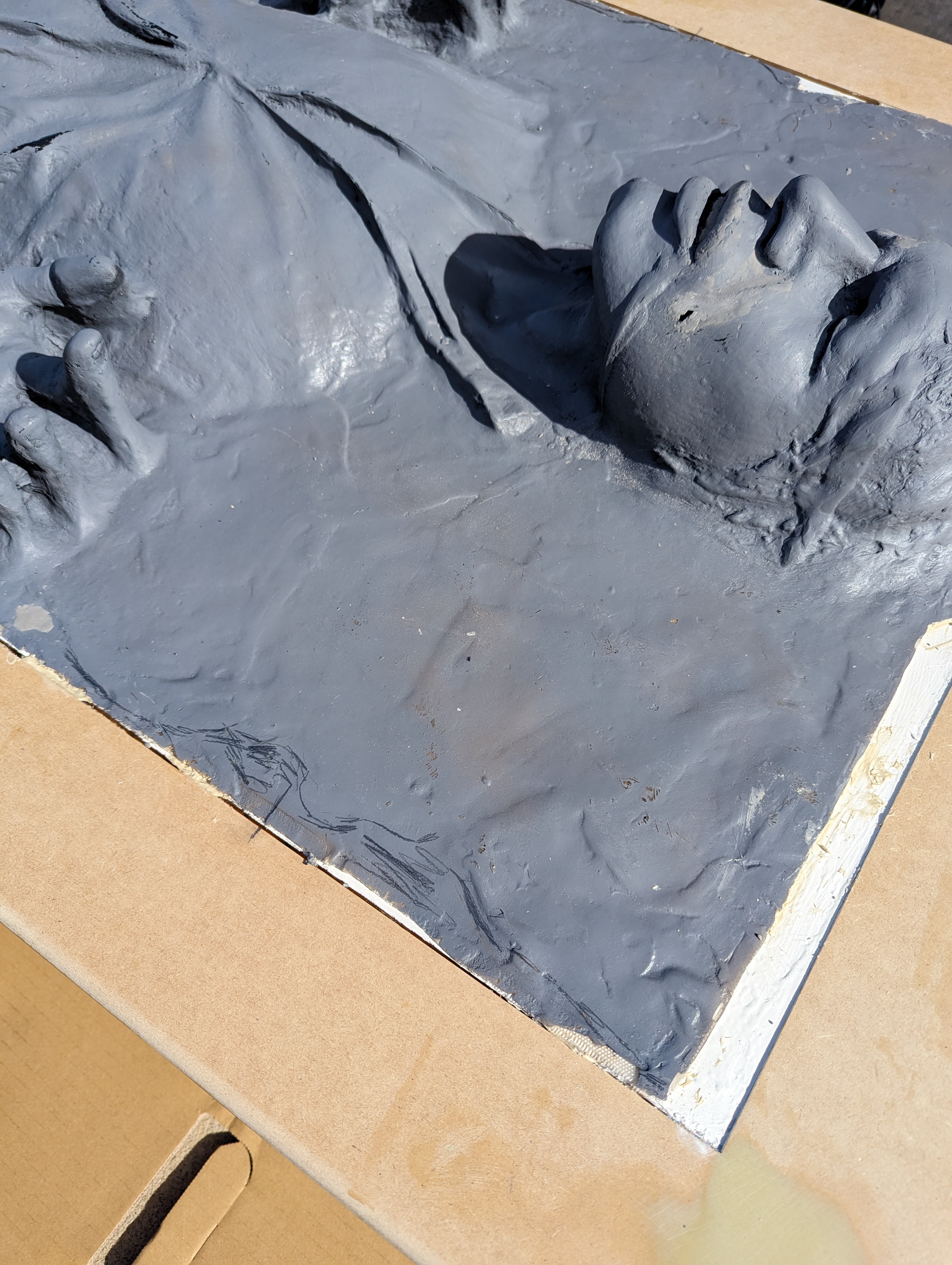

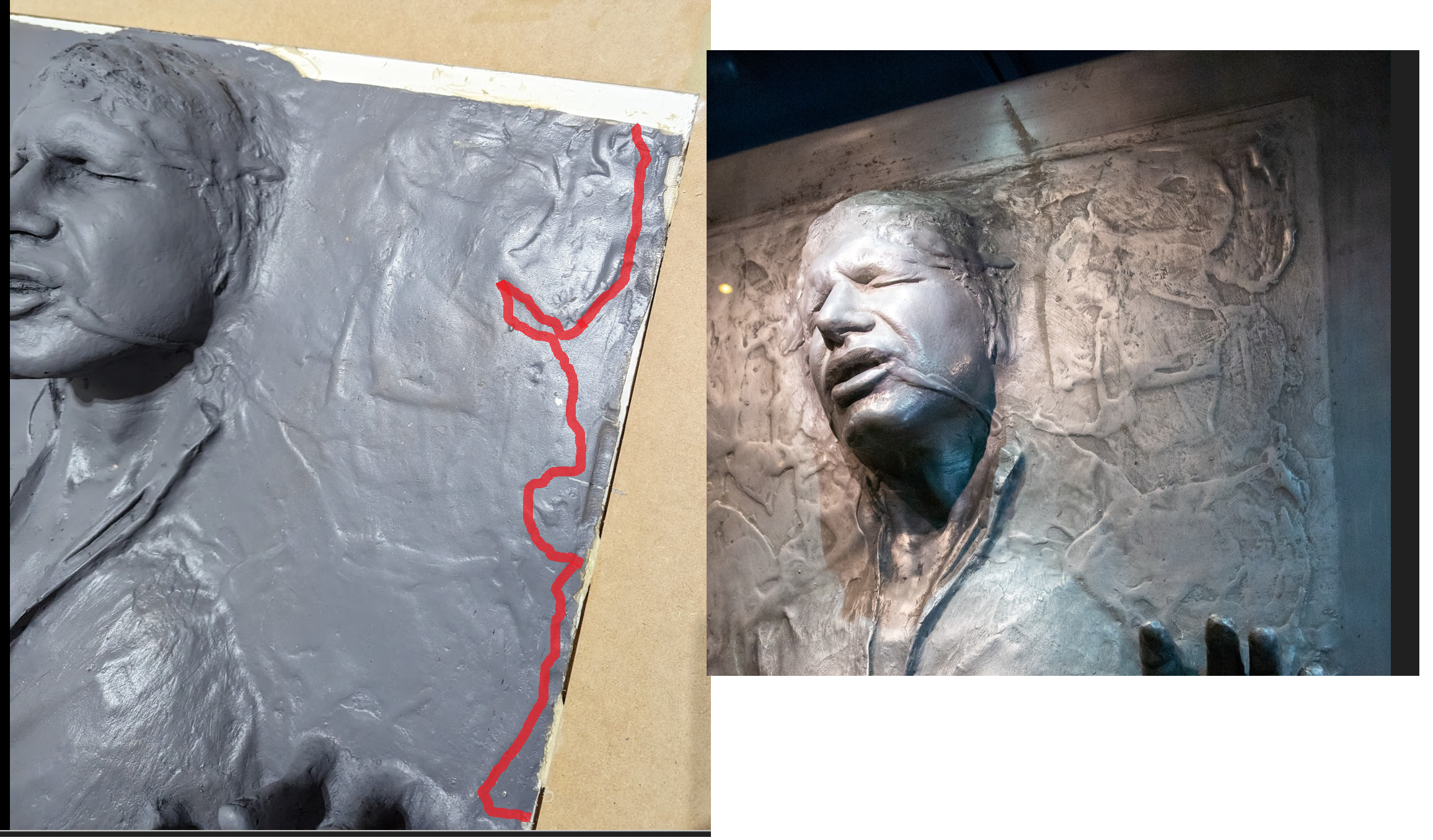

When looking at pics of the original prop (primarily from the Star Wars Identities collection and the photos that came from Loanstar/Germany) I had noticed that there were essentially two parts to the carbonite. There was the part that has all the characteristic lines/bumps/swirls etc. that takes up the majority of the front. The other part is the outer edge of carbonite that meets with the frame. This part is smooth and at the same level of the frame. I wanted to do my best to preserve this detail so I first mapped the texture and compared the major landmarks with my own. The mold from Wes Coke is so good that this was an easy task.
Here, you can see where I took a pic of my mold and comparing it with the prop, outlined some areas I wanted to clean up a bit. I did this with the entire perimeter.

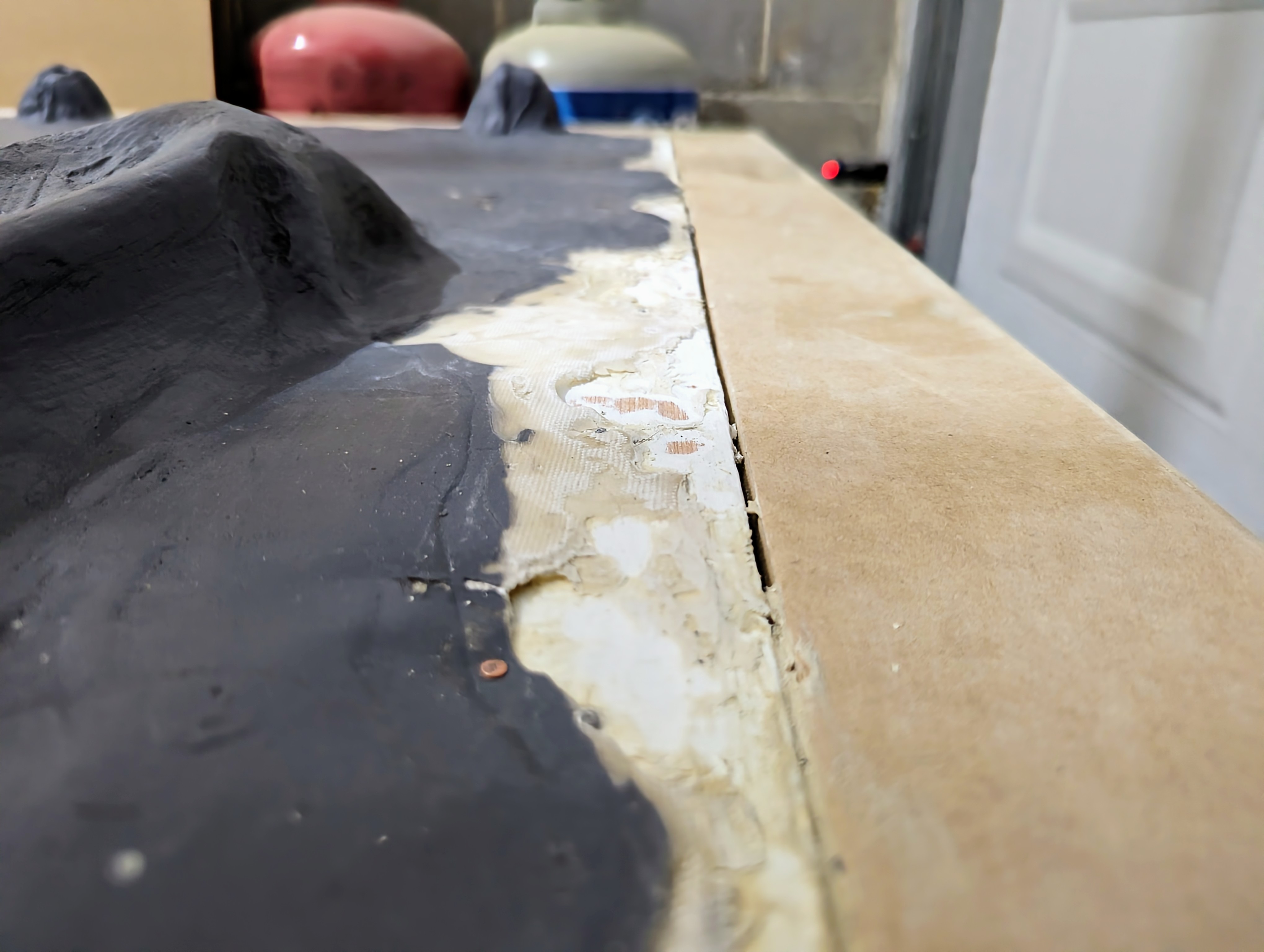

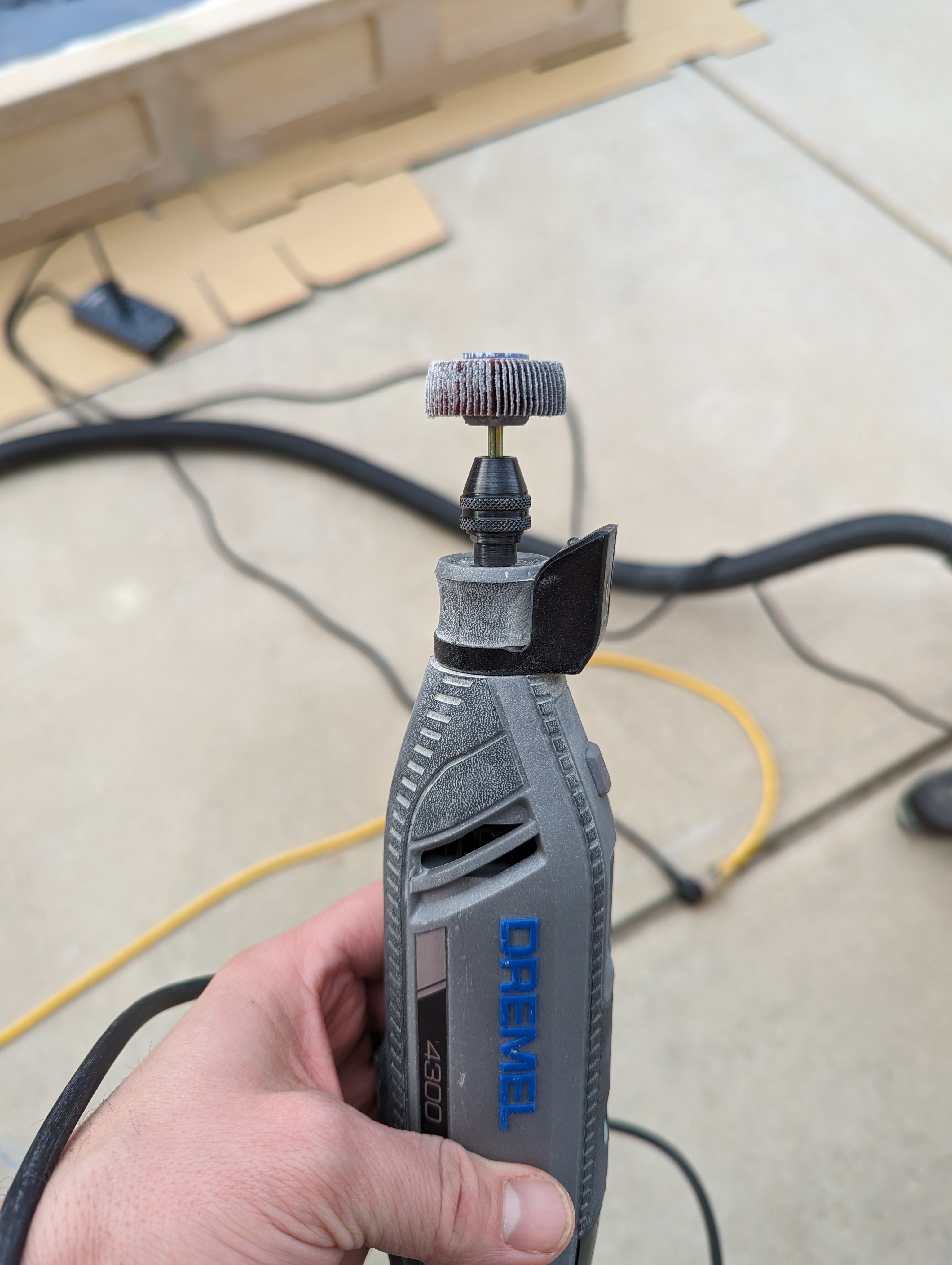

In this picture, you can see where I used pencil to mark off the portion that should be cleaned up a bit for a seamless transition with the frame. You can still see a line I drew from the frame to the mold that I used as a marker/alignment when gluing it down. I used my Dremel and a 120 grit rotary sanding tool to remove portions that I ultimately will fill back in with fiberglass resin. This rotary tool allowed me to contour lines around the fiberglass and maintain good vertical transitions from flat fiberglass to texture.
Here is a quick pic of some portions of the panel removed/thinned. They just needed to be lower than the frame so I could fill them in/level it later. These are still “work in progress” pics and this gets further cleaned up later.

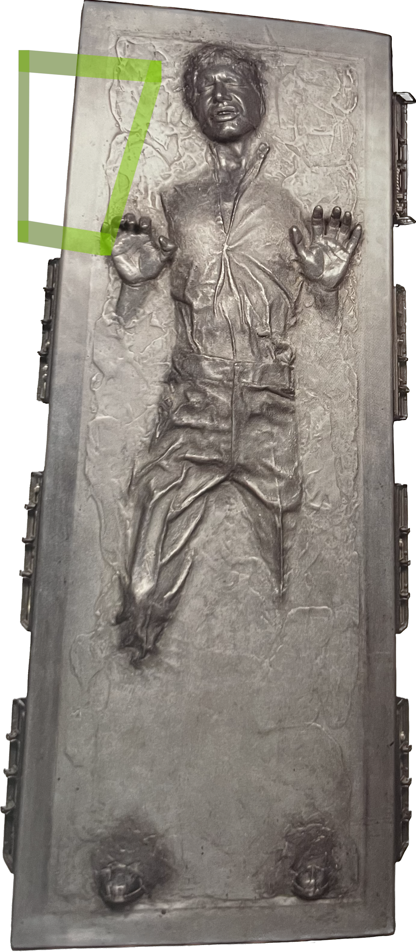

I'm from Argentina, started with my HiC, less the block, all the pieces and Han printed in 3D (FDM & SLA).
ALLEY why in the pic you posted the block don't seen or don't have the top panel in left side (front view)?
Thanks in advance, regards

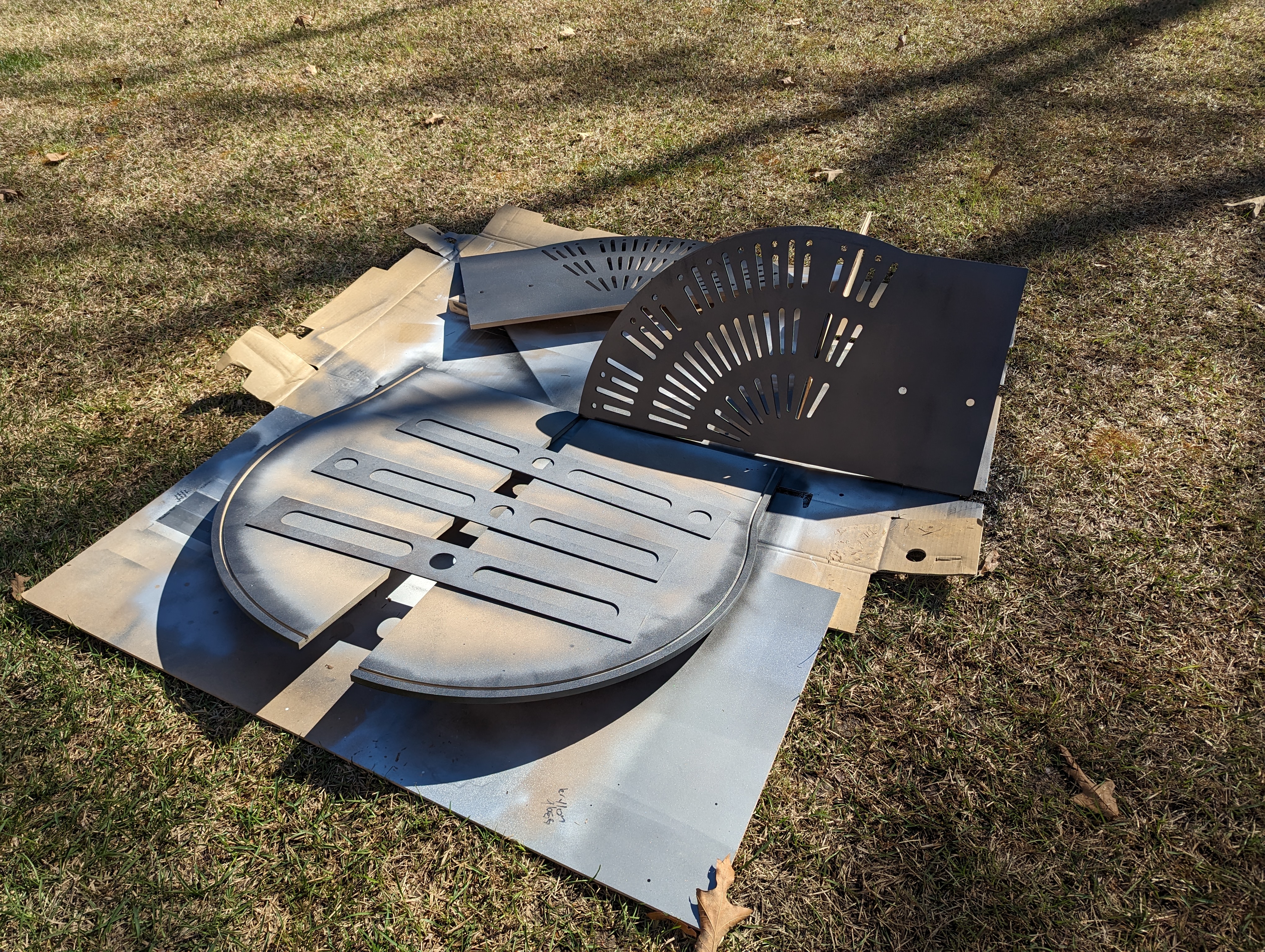

Alright, I'm back! I wasn't quite happy with the color of the box. The color is great but wasn't a good match for the silver of the carbonite. I decided to have another go at it so I masked the carbonite region and removed the panels. After looking back through my color files, I decided to go with Dark Steel like SirCharles' build.

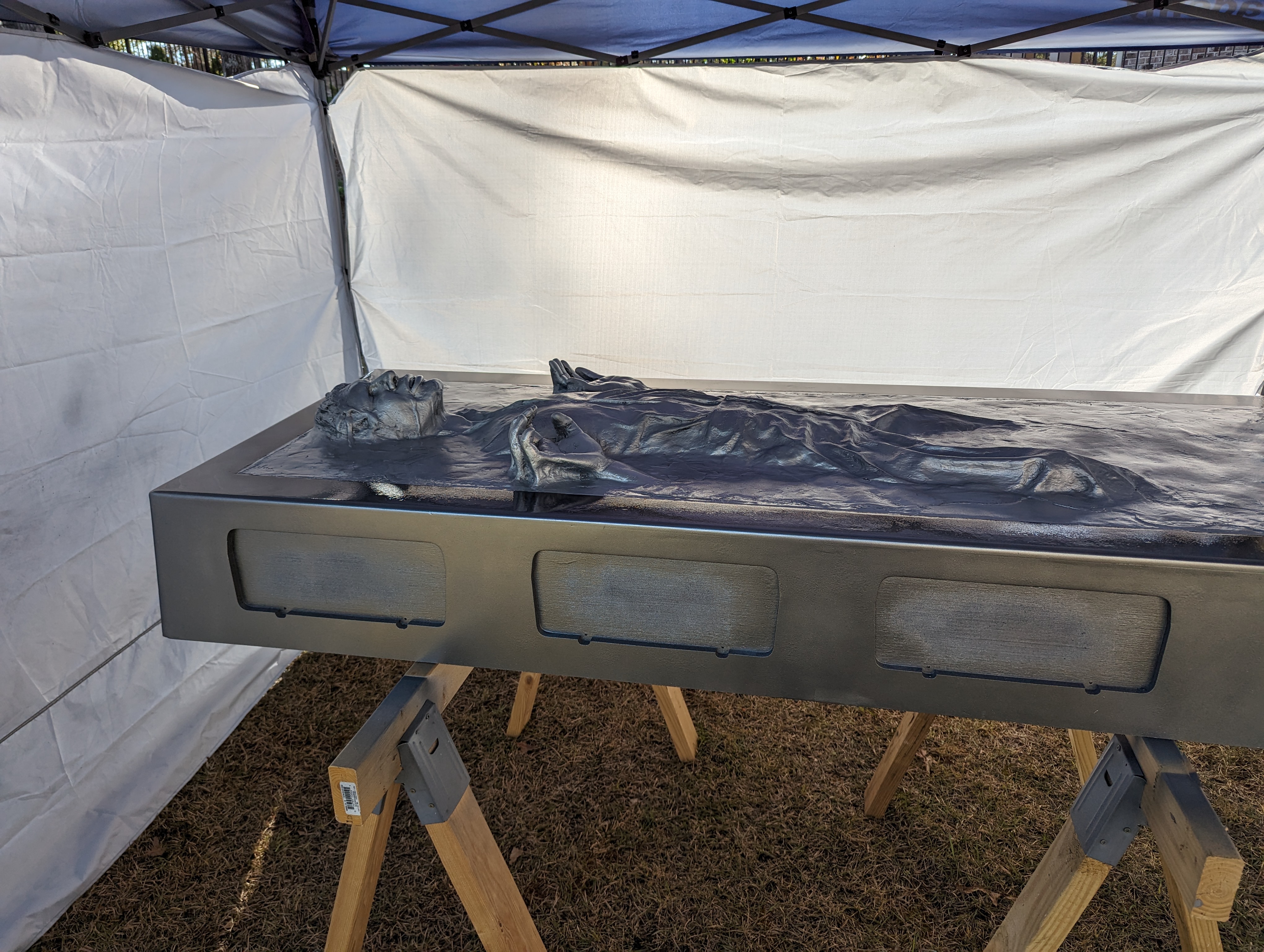

Pollen is pretty bad around here, and I didn't want to paint in my garage, so I set up a tailgate canopy as a painting tent.
In addition to changing the box color, there were a few other details I wanted to address. The first of which was the contrast of the box/border. Originally on mine this was very monochrome which isn't in line with the prop. It is also much glossier in the movies than what I had. After repainting the box with Dark Steel, I needed to find a way to darken the border of the carbonite.
Adam Savage recently posted a Adam Savage's One Day Builds: Han in Carbonite! and on his HiC you could see the darker border surrounding the carbonite. I wasn't sure of his technique (possibly airbrush vs Streaks n' tips?). As meticulously planned as my other steps were, for this one I winged it without practicing somewhere else. I grabbed Gunmetal Grey and started spraying the masked portion just barely enough so that the edge of the spray would bleed over to the box. I alternated between spraying perpendicular to the plane and spraying nearly directly at it but several inches away from the edge. I did make some mistakes but these were quickly fixed by covering up with Dark Steel.
You can see a bit of it here before I pulled off the masking.
Here is how it turned out before the gloss. It looks pretty nice! I was happy about this because during the last step, I had Dark Steel in the left hand, Gunmetal Gray in the right, and I was just spraying and fixing mistakes, then spraying and fixing mistakes.
I don't know for sure, but I would assume someone just got a picture when that panel happened to be off. In ESB, you can see that this is a hero panel (like on the top right). However, somewhere along the way it switched to a normal/non-hero panel. Maybe this picture was taken during the change?
The picture is taken from the famous Best of the Lucasfilm Archives book, from the late 1990’s.
The lack of the upper left-hand (facing the block) panel could be due to the panel being removed, or from poor photographic cropping.
I think they moved the hero panel to the left side for the corridor scene to add some interest for the close up. In all the other shots the full hero is on the right side (Han's left).

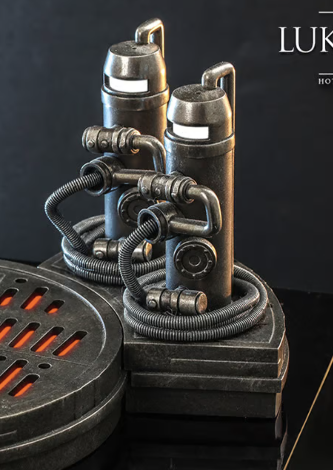

I kept looking and came across this item from a Sideshow Luke on Bespin sixth scale figure:
This, I think I can more or less do. I bought a bunch of PVC pipe, some hose, and other assorted items. I really liked that the round portion with the small domes on the circumference looked like the part from hero panel 2:
