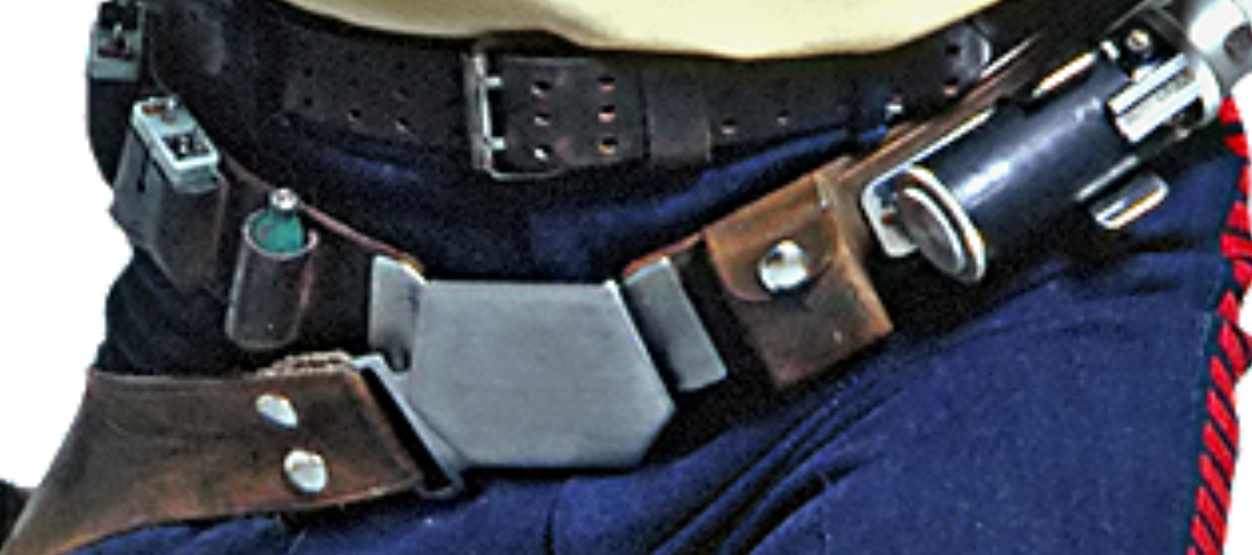

2. ANH belt in ESB?
Here is where things start to get a little wacky. First, there is no doubt that the sewn pocket version exists. We have photo evidence of it both as a prop and in the film. I don't think there can be much debate on that. What I am interested in are the details of the photos posted here.
We know that the Episode 4 belt did not have visible rivets on the hooks. In the photos posted, the one from the medical bay, does have rivets, whereas the black and white one does not. So, this means that if the Episode 4 belt was used in Episode 5, at some point the hooks needed to be replaced.
One might argue that they needed to redo the hooks to fit the rectangular buckle. If this was the case though, it doesn't explain the version without the rivets, but with the rectangular buckle.

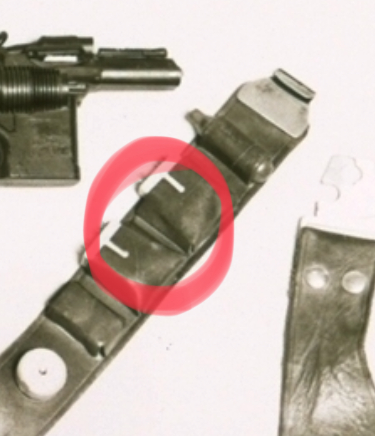

Hey Gang! I see a line on the top and the bottom of the ANH belt that makes me think that the entire belt is overlaid with a second strip/piece of leather that simply bumps up and has tabs that fold under the loops for the pouches. What do y'all see?
I am with you on this one as well.
I believe it was constructed by putting a groove in the belt along the entire length. Then, a single, very thin strip of leather was glued down using blocks or the props to keep the shape, then the bottoms and end were tucked under and glued.
This would have been a super fast way to create pockets without sewing or riveting. To me the evidence is that in multiple shots there is a concave - lighter - edge on the pouches. It looks concave to me in almost every photo except in the sepia one where you can clearly see the end was tucked under creating a strong shadow. If the pouches had been tucked under individually we would likely see very strong shadows under each one as they attached to the belt.
Secondly, we can see that there is a cast shadow on the bottom between the pouches. In some photos it is more evident, but to me there is clearly some depth to it. Also, to me it logically makes sense if you consider the canister greeblie.
If it was folded under and glued, it would create a situation in which there would likely not be enough surface area to hold the greeblie on that tight. Bumping the greeblie would likely result in it ripping off or it would "wobble" as the actor moved. If it were a single piece of leather, the left and right side would be so firmly stuck that there would be no way it would rip off. All they had to do was put in the greeblie and tuck the edges in as tight as they wanted. This could only be done with a single piece of leather.
It has been a tough sell for many on this forum, but I am 95% convinced that it is a single piece.
I should add that I do believe the button pouch was not a single piece but folded under on three sides and glued/riveted. There is a clear line of shadow on each side of that pouch indicating that the leather did not originate from under the hook as it does on the other side.

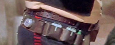

I am starting to think this belt rig project is just a bottomless pit sometimes. I now really believe that the latter versions are sort of a mix and match affair depending on the costume and location. The prop department was not overly concerned so long as it looked right in the long shot. If any of you have really worked in movies, you know what I mean ;) . But no fault to the original crew at all, they were making a movie and they had a budget to worry about also. It may come down to deciding which seen or location you want to build a rig for. That is a bit too detail oriented for me right now, so I will take the, looks right, is right, approach somewhat on this project, like the original prop masters seem to have.
For example my DL44 is based on an HFC airsoft Mauser M712 pistol so it has a selector lever on the left side and a removable magazine. The detail parts are from Todd’s for the ANH version but due to the fact I am in Canada and getting a Denix or MGC version is prohibited, the all metal airsoft version is my best option. Everyone I have
shown it to has not complained ( other than about the weight ) so it looks right, is right. Check it out, I posted a pic back on page 11( I think). Sure I guess it is more right for the newer TFA version but it was the best I could do at the time.
As for this belt pouch topic we are on, monsieur Murphy, you used the word “wobbly” and that got me really thinking….you are right, the prop department need them to be tight, you don’t want to go dropping your greeblies all over the galaxy…… :D and then I was thinking that other than using the driod caller
( that apparently had to be tied to the clip) you never see any of the other ANH greeblies in use, they stay in the belt….I now put forth that they are actually fastened to the belt :eek !
The "pouch” is formed by wrapping the leather around the greeblie and the whole lot is screwed or pop riveted from the back side and not going to easily fall off. This also works for the direction they were given to “hide the fasteners” or something to that effect. Yes on a costume belt having the greeblies removable is great and does present a challenge but on a non-functioning movie prop you want those little bits firmly attached.

Re: pouches being one strip of leather glued on.
If you look at the color pics posted above from ESB you can see that the area where the pouches meet the belt are a lighter shade. This could easily result from the wet-molding process of making that piece. Typically if you want to form leather around an object you get it wet, put it over the object and then use a stiff object to crease the leather where it needs to bend. This results in a nice crisp molding but also burnishes the leather sometimes making it harder for dye to absorb in that particular area leading to a slightly lighter shade of brown.
As a leather worker I can see that happening here, but it could also just be the way the belt was weathered.
But on the other hand (and I think this is where I stand on the matter) it doesn't make a whole lot of sense that they would make the pouches that way because you couldn't just cut an even width strip of leather. You'd have to leave tabs sticking out for the square pouches. That method would need considerable planning, would be exceedingly difficult to actually do, and would take a lot of extra time compared to other simpler ways.
If I were doing it, the easiest/simplest way would be to make each pouch individually and then glue or rivet them to the belt. Pictures can be very misleading and in my mind looking at practicality in terms of the prop department has to trump the way the light behaves in a few pictures. In fact, in some of the promotional shots from ANH that I just went back and looked at you can just about see the leather of the pouches curving back around and underneath in a way that wouldn't be possible of it were one strip molded on each greeblie. So the pictures seem like a wash one way or another.
Or....... I could be completely wrong too.........:lol

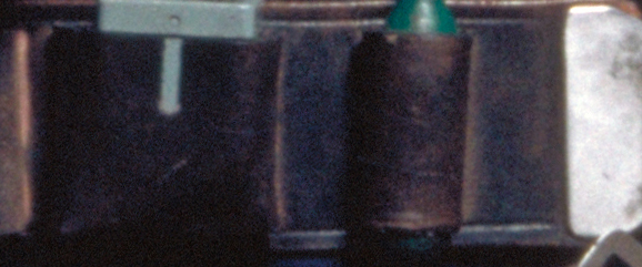

The only thing I'm not sure about is the wet molding causing the lighter spots. I think the belt was the lighter color when it was assembled and those areas are just were the darker weathering dismt get to
The more I look at the photos, the more I become convinced there's some kind of particle/wave duality going on here. It's like the pouches are both individual and a continuous strip simultaneously.
In the above photo I think I can see the leather curving back and behind/under the white relay greeblie. That would mean it would have to bend back on itself in what seems like an impossibly tight (to me, a person who knows nothing about leather) crease before heading towards the sparklet canister. There doesn't seem to be any reflection off the top of the leather strip between the first relay pouch and canister either? Presumably the strip would have to be the same thickness as the pouches it forms?
On the other hand, the leather doesn't seem to curve around the canister, it seems to hit the belt and then immediately turn back towards the buckle in a way which may not allow enough gluing/riveting material.
As an aside, I had to glue the canister in on my belt. I just couldn't get the leather tight enough around it. Or rather, it was a tight fit when first made, but quickly slackened off until the canister just pushes through and drops to the floor with the slightest touch. I'd argue the movie one was probably glued in too ... but then there's something different in (apparently) the same pouch/belt in ESB, so maybe it wasn't glued?
This photo:
Seems to clearly show an extra line between the empty pouch and the second relay pouch (counting the relay pouches from the buckle towards the rear). It seems to go:
Top of the belt.
Groove.
Strip of leather.
In short, I can see both a strip and not a strip depending on which photo I look at.
Which is annoying.

This is why I'm thinking it's impossible to rely on the pictures for this detail. There's just no reliable way to tell and a simple trick of light or shadow could give a completely different look.
I'm sticking by the idea that it must be individual pouches riveted/glued onto the belt for the primary reason that it would have been totally impractical to make it the other way.
I’m honestly not sure what I believe regarding the method of the pouches (individual v strip) but this area is what pushes me towards one strip. It’s a really strange way to go about it for sure, but stranger things have happened with these props. 2A111DC6-290F-413C-9A3E-665ABBC3C34C.jpeg
I’m honestly not sure what I believe regarding the method of the pouches (individual v strip) but this area is what pushes me towards one strip. It’s a really strange way to go about it for sure, but stranger things have happened with these props. View attachment 848078
Yeah, Occam's Razor rarely applies.
It could even be that the canister pouch is part of a longer strip which runs from under the buckle to under the first relay pouch. The two relay pouches are one piece, but might be separate to the canister strip. A separate strip which may or may not include the empty pouch as well.
