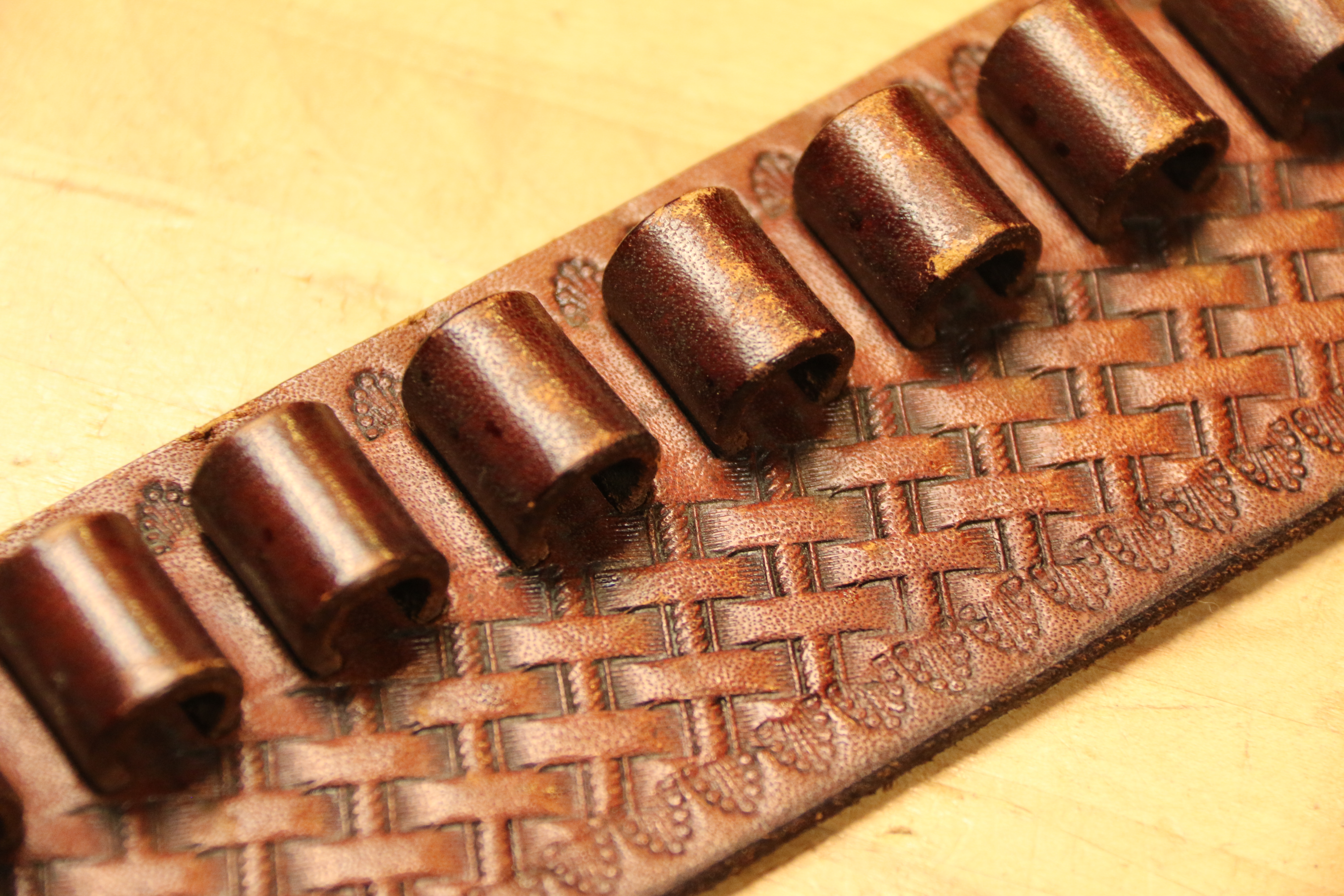

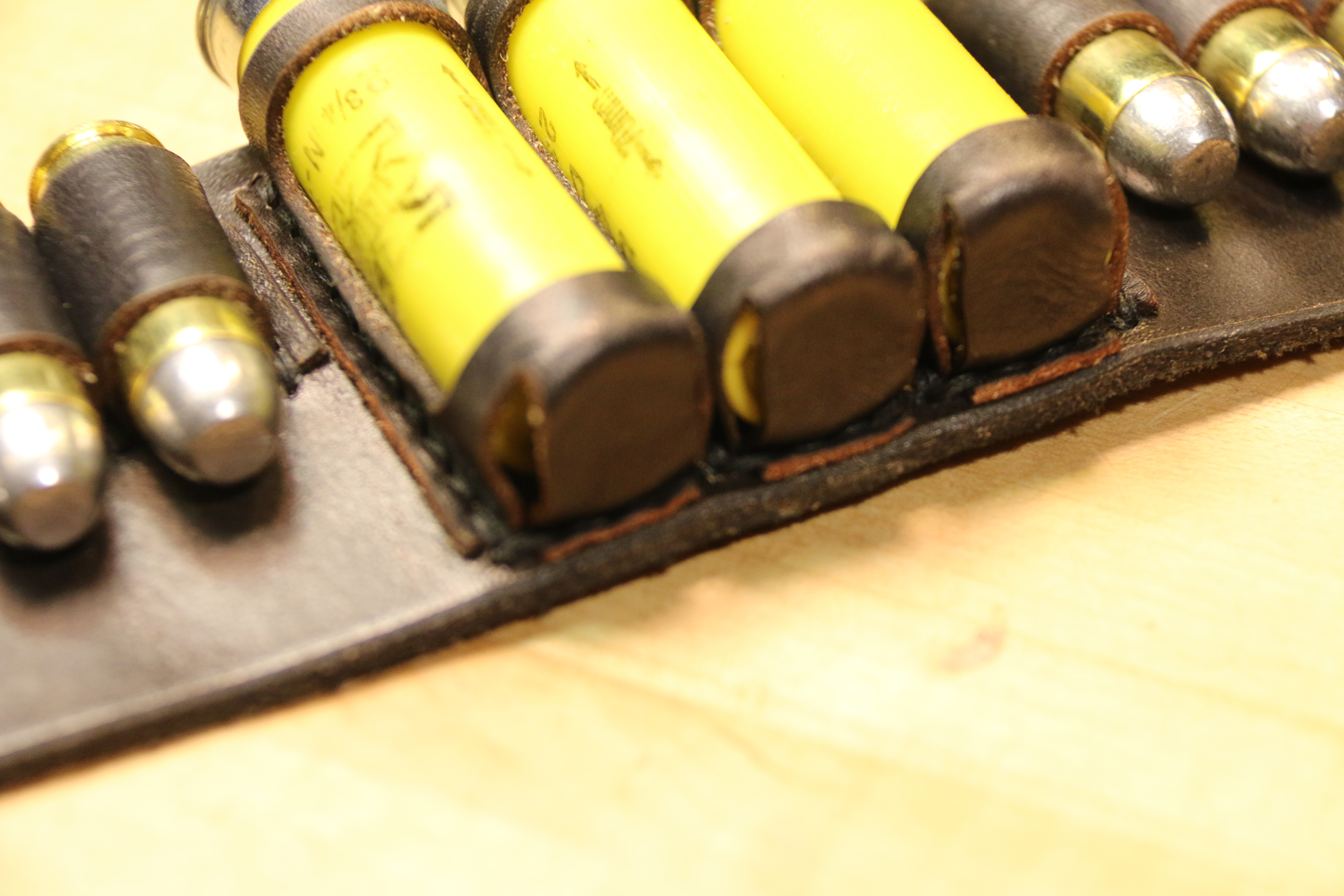

OK, here we go, here is an example of large 'pouches' (with the 20ga. shells) next to a separate run of loops (.45s), you can see the sides of the two pieces, and a small gap between the pieces.

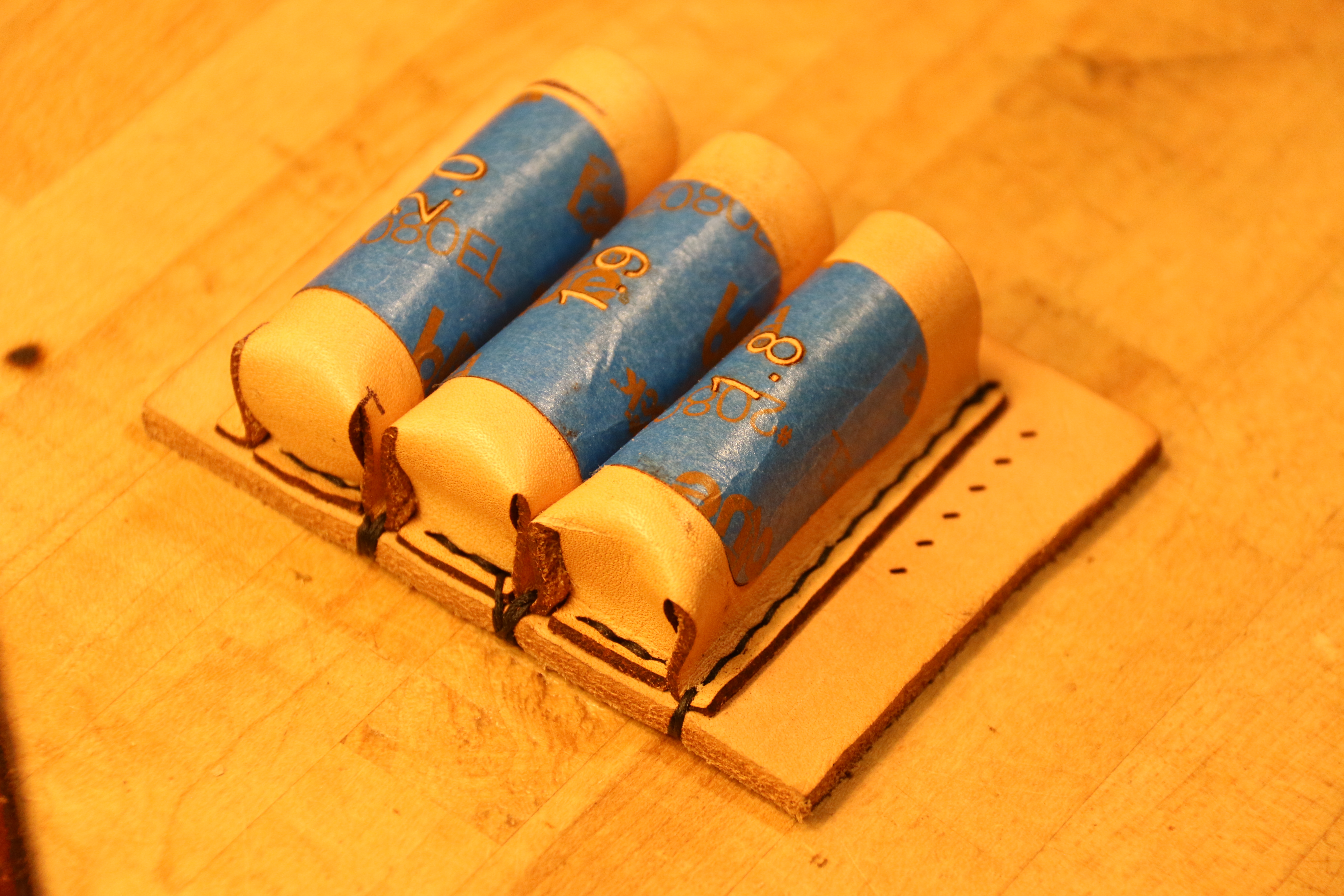

View media item 34301Next we zoom in on the bottom of the shell pouches, you can see that although the stitching is on the outside of the belt, the bottoms protrude downward to hide it (I'm using 2-3 oz leather, about 2mm thick)

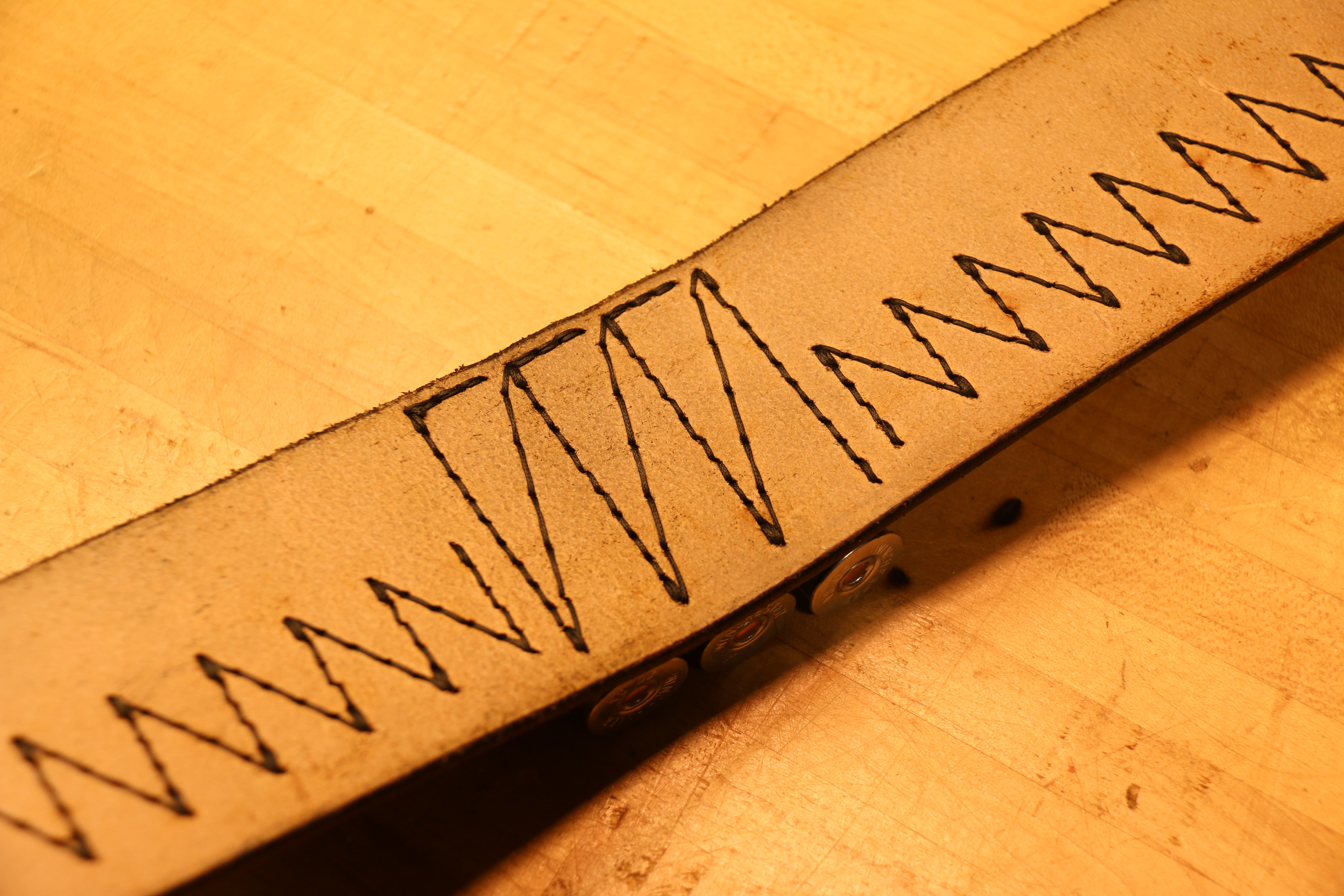

Here is the back of the belt showing the continuous saddle stitch between loops (the diagonal is hidden by the loop):

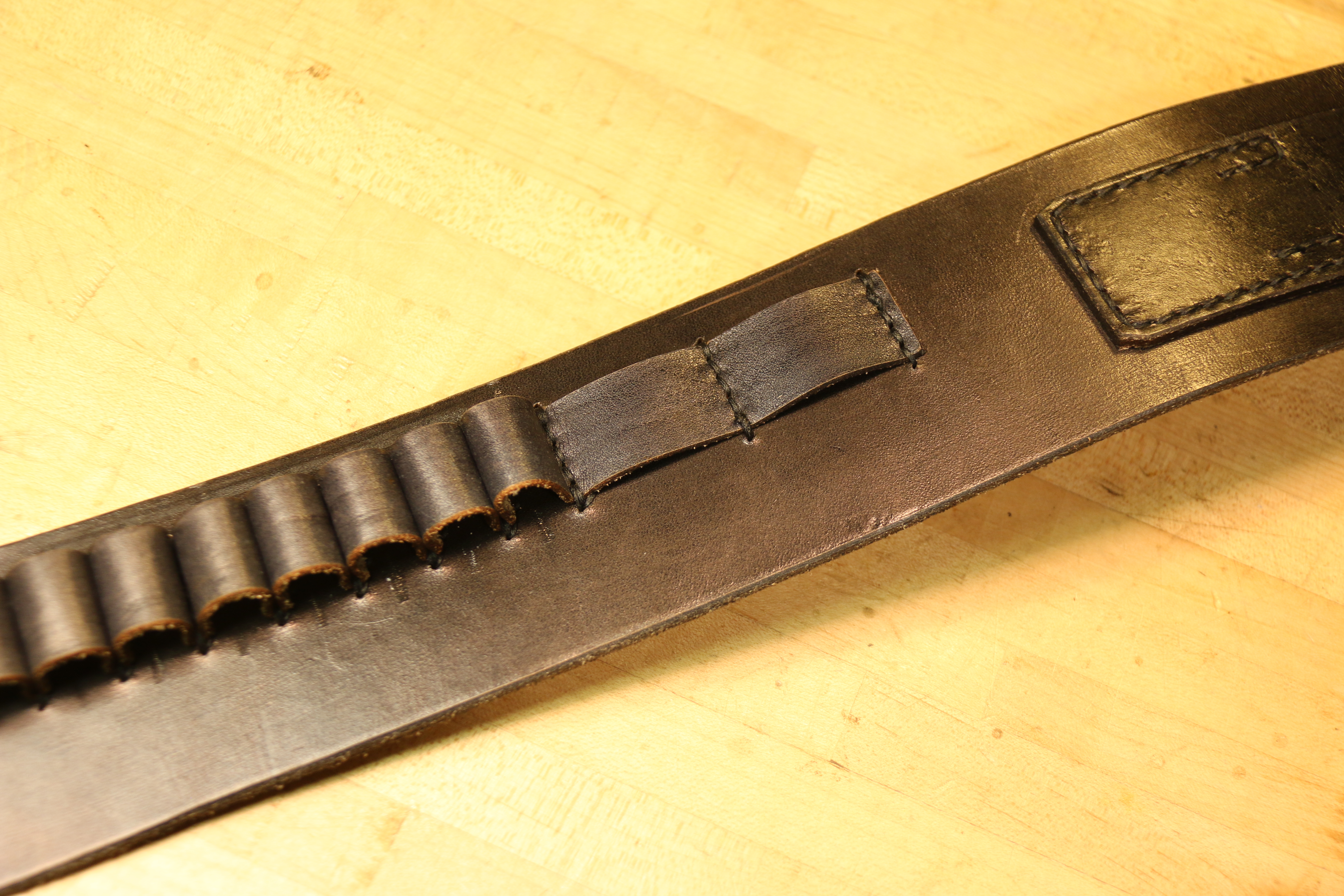

And, because one wears things like pistol holsters and Boye knives off of these things, whomever built the rig for the Man in Black did not run the loops all the way to near the end, but did extend the strip of leather anyway, and it looks like this (seen that anywhere recently?)(like between rectangular pouch #2 and #3?):

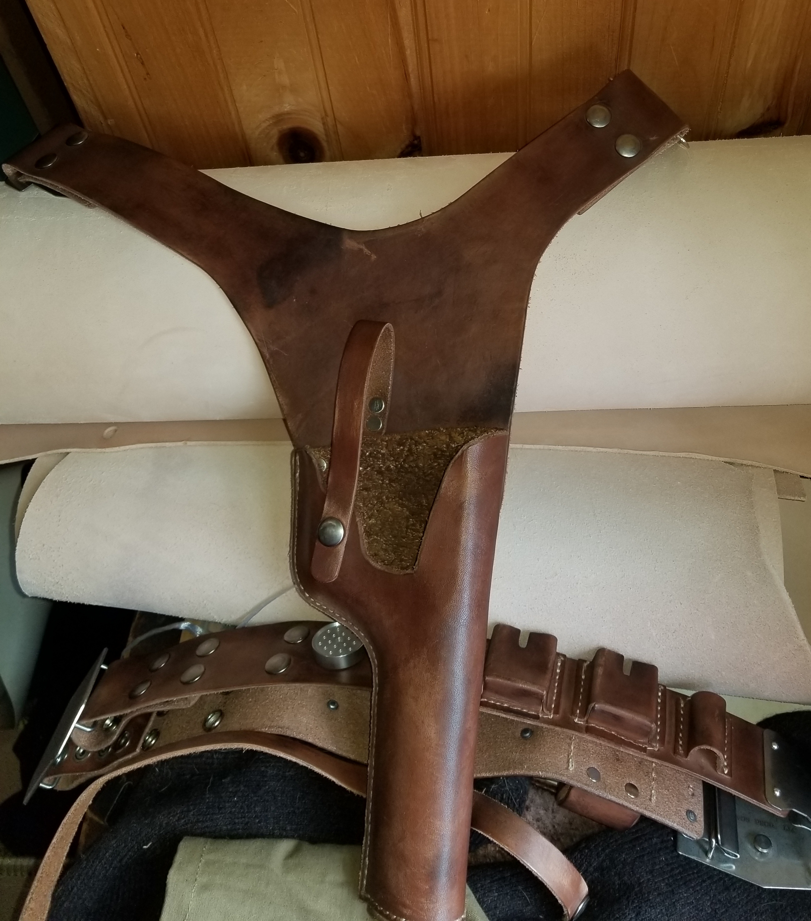

Not sure what's happened. But I'm pushing ahead with my own ANH style. I'm sure someone can put up a general pattern.
Meantime I'm reasonably happy with my ANOVOS for an ESB look.

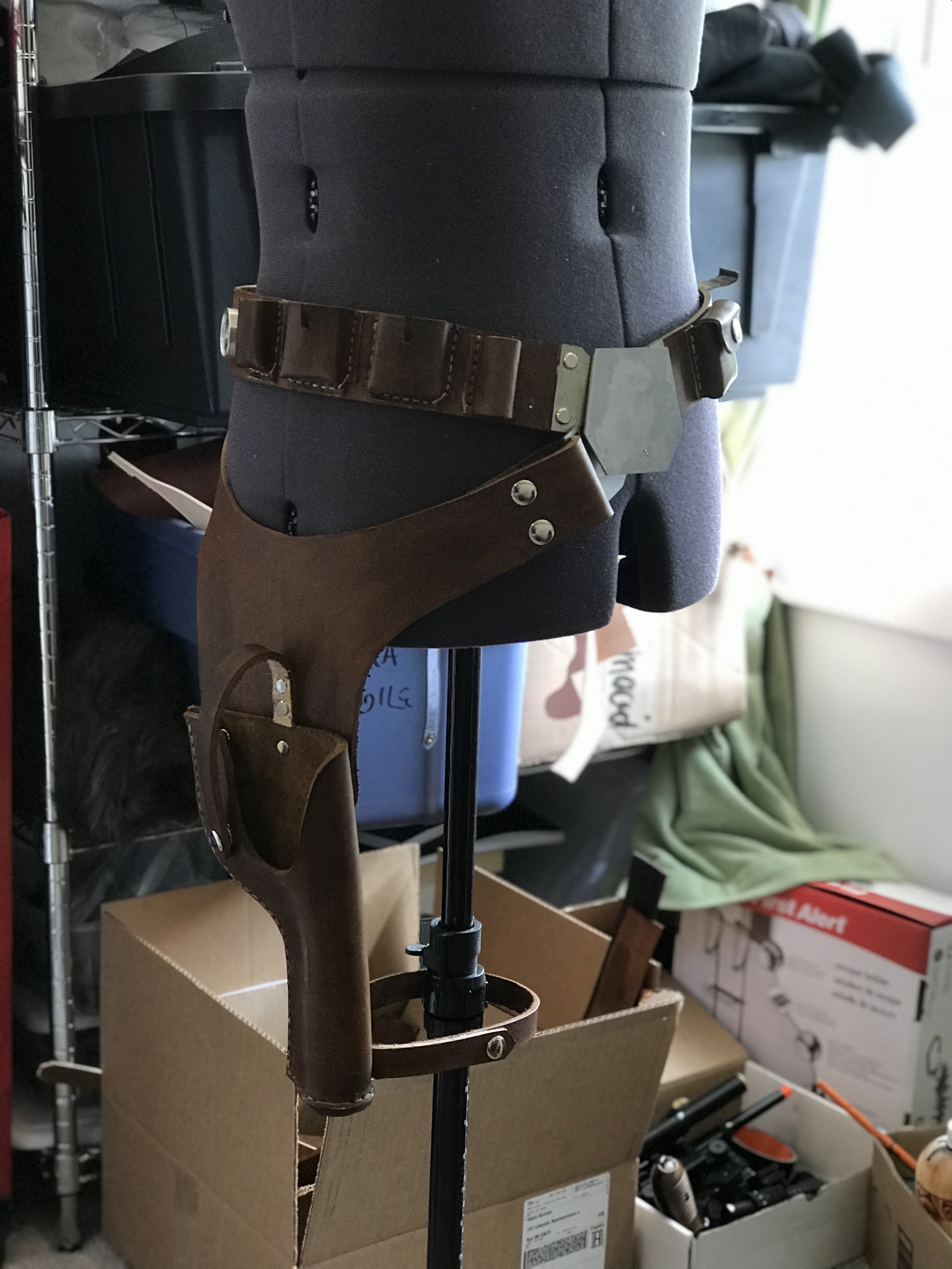

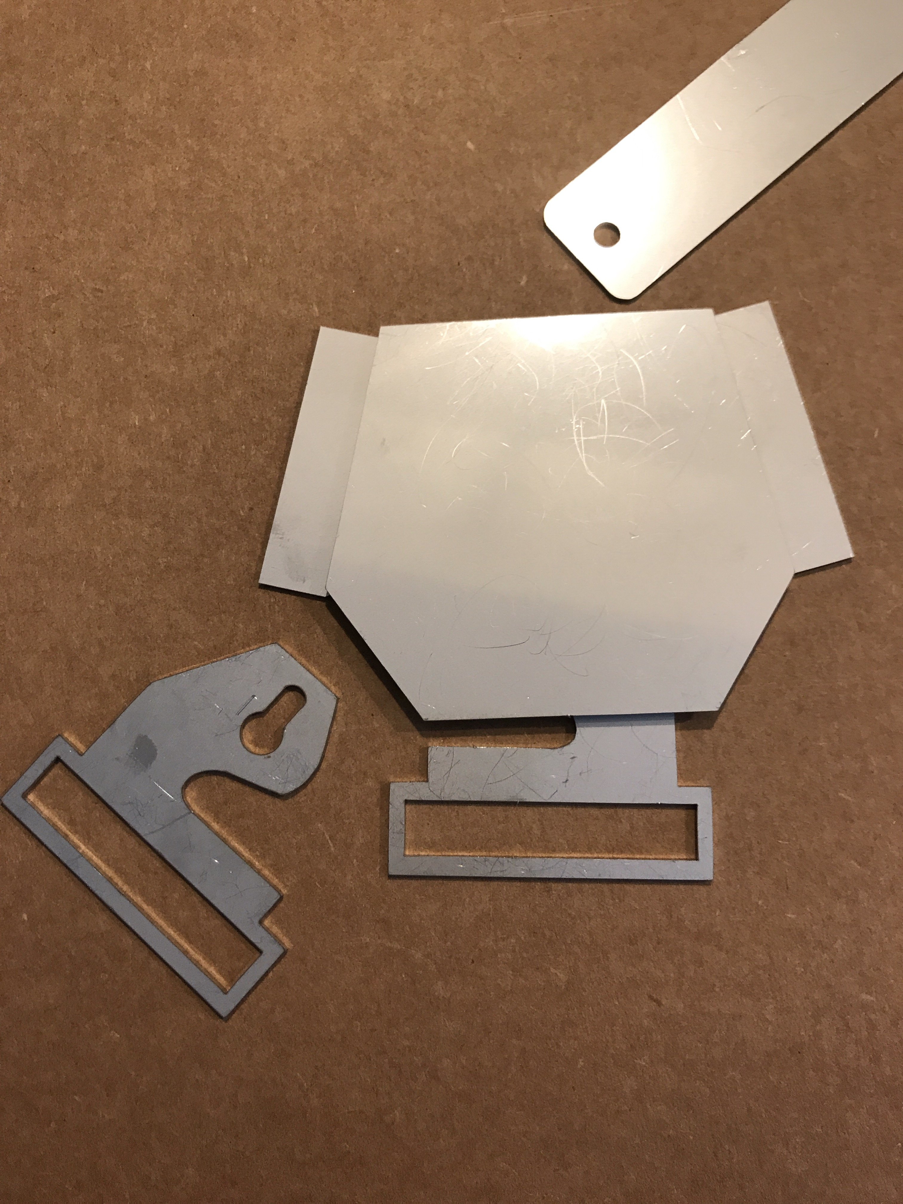

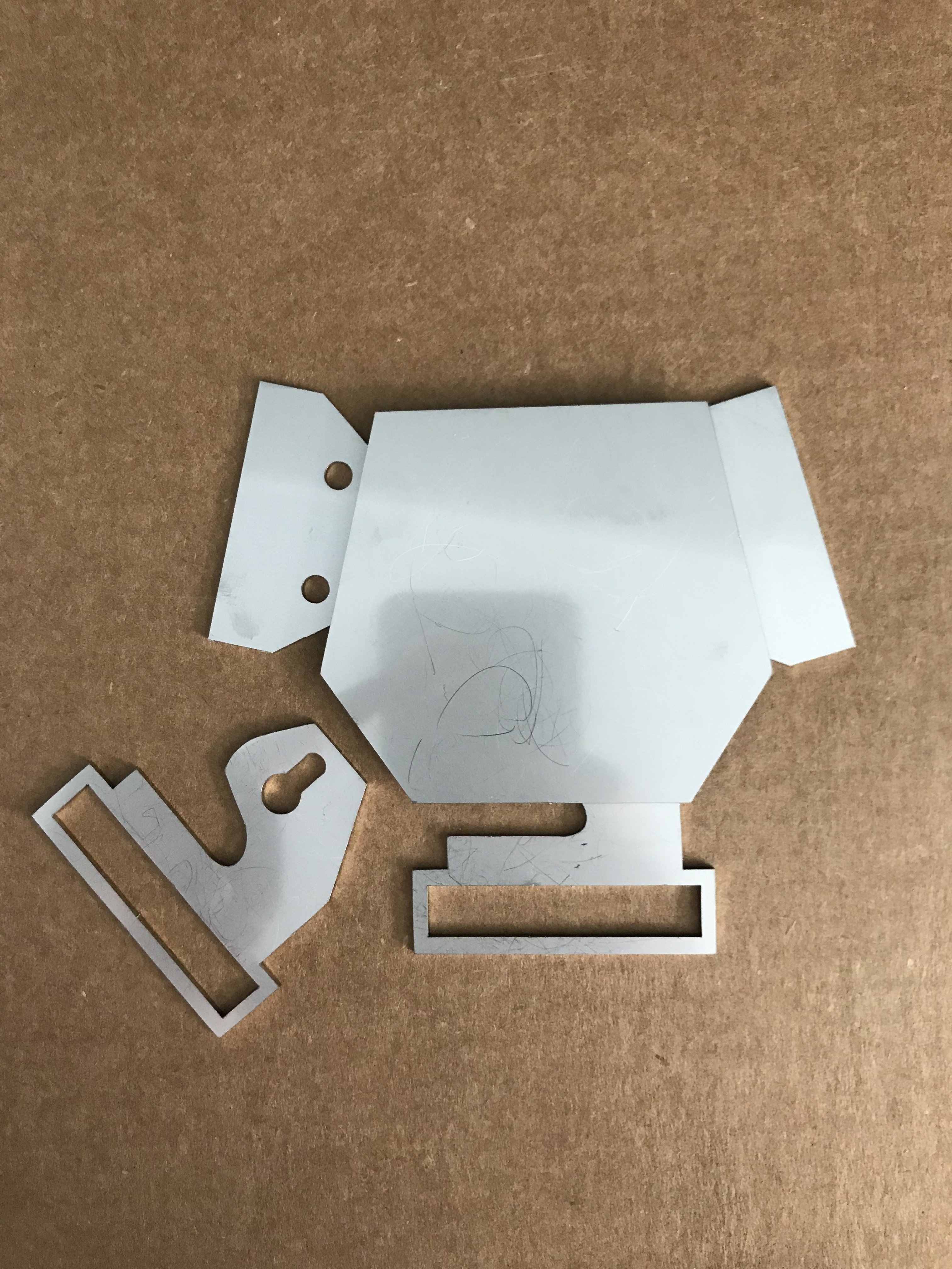

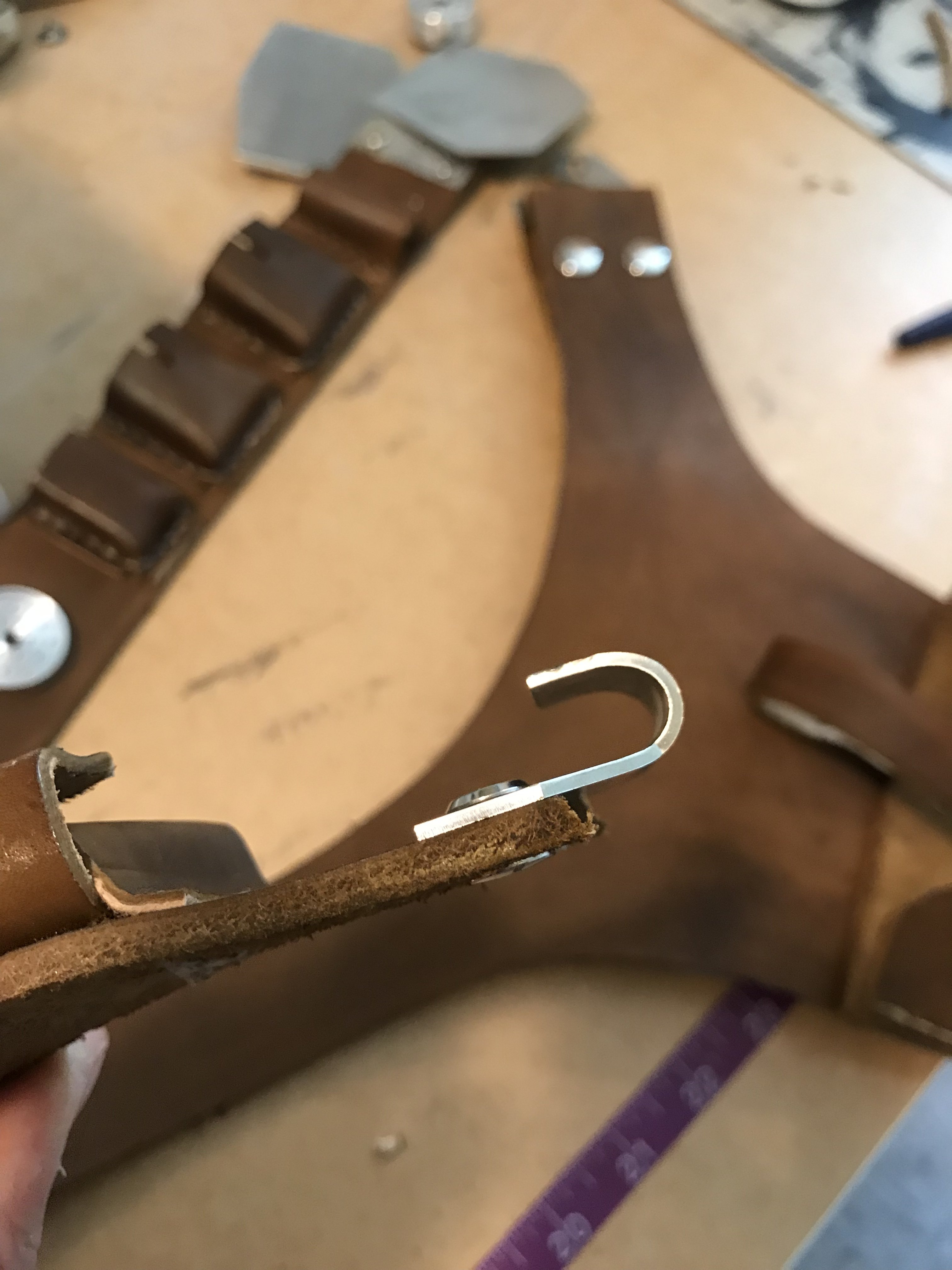

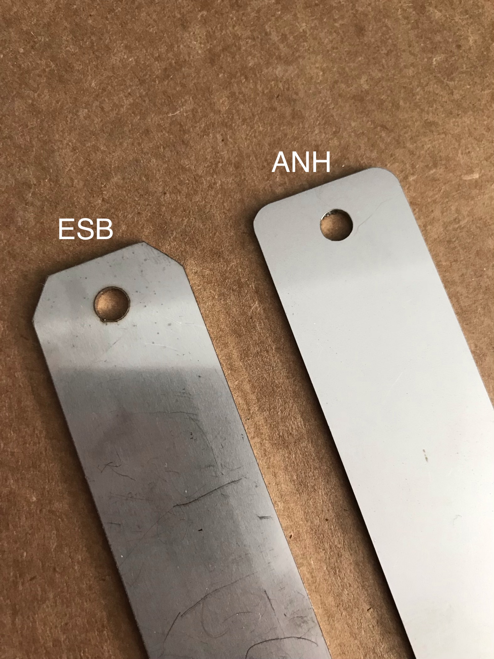

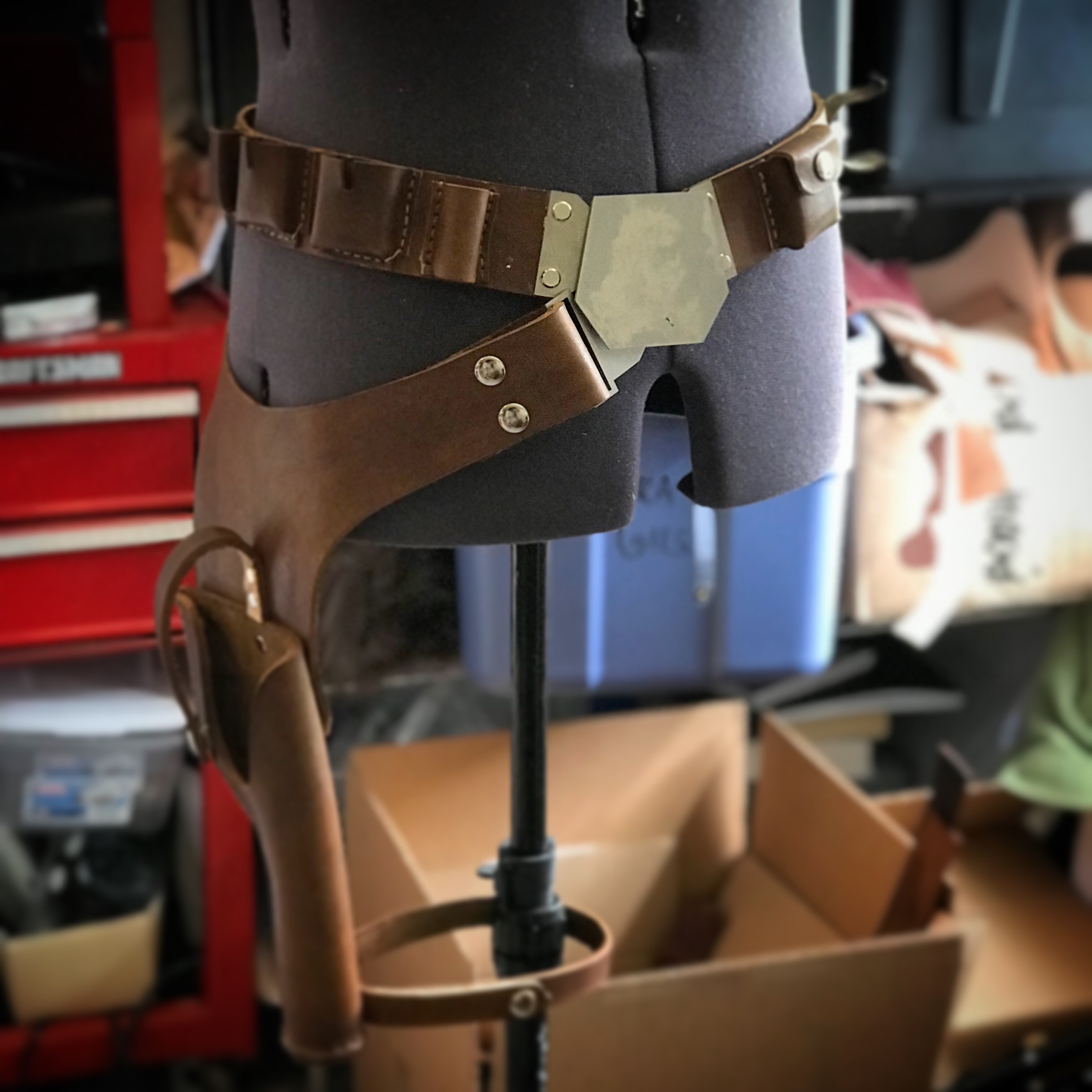

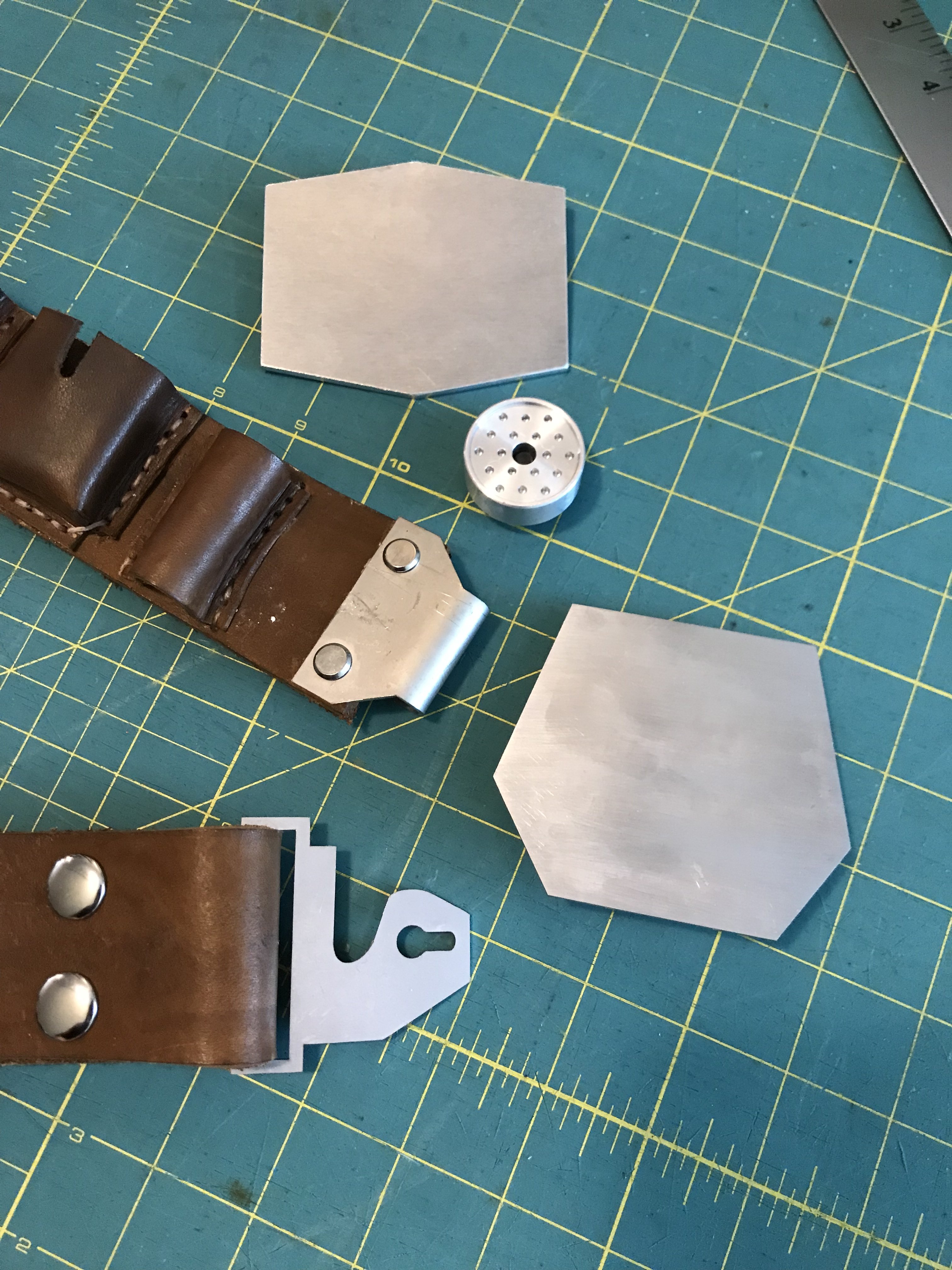

I took on the challenge of designing some Han Solo holster hardware with some of the discoveries made here!
I have been making a lot of belts, and was waiting a long time to get them made.
Now, I drew up some files for each film in Illustrator and had them cut.
Not sure anything will ever be totally screen accurate, but happy with my designs so far. I was able to get the ANH hooks to have a hidden fixture (like Solo) and have the droid caller clips designed to each film, and hooks designed for each (including the ESB Norway) film!

Egon, that is some great looking work, I agree that it "looks the part" and as I have mentioned before that is what is really important here in the end. There are just too many variations on the prop depending on the movie and even location, seriously Han must have had a closet on the Falcon just for belts and holsters :)
I also wish I had access to one of those tailor forms to fit the rig to while making it, very handy indeed. I really need to get working on my own now, just go for it, there is no perfect.
