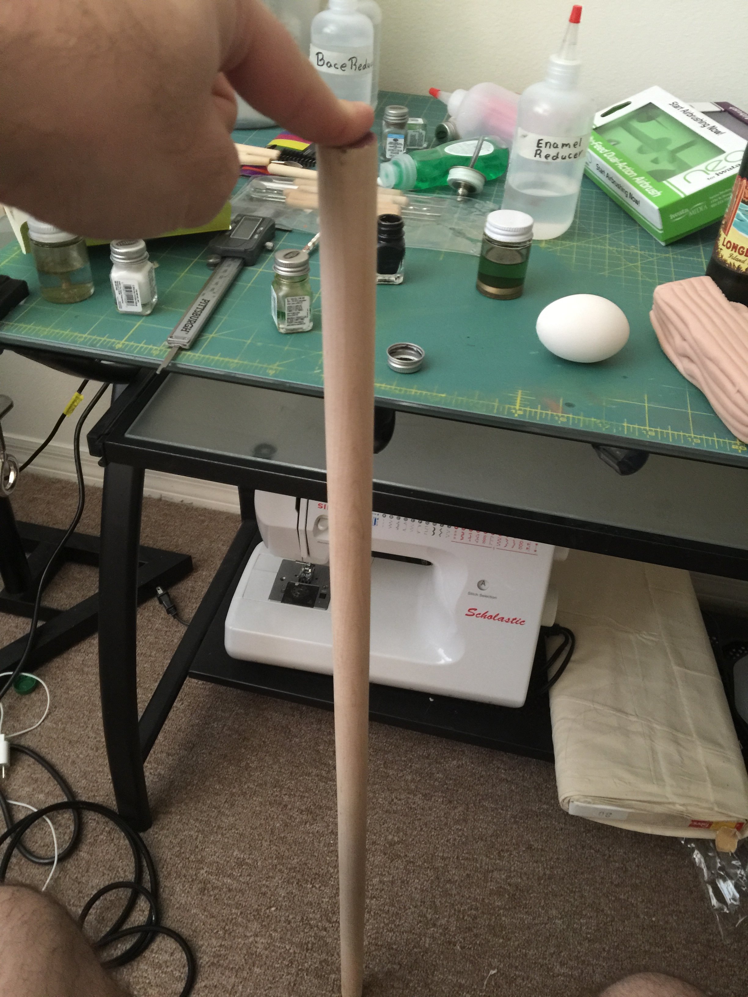

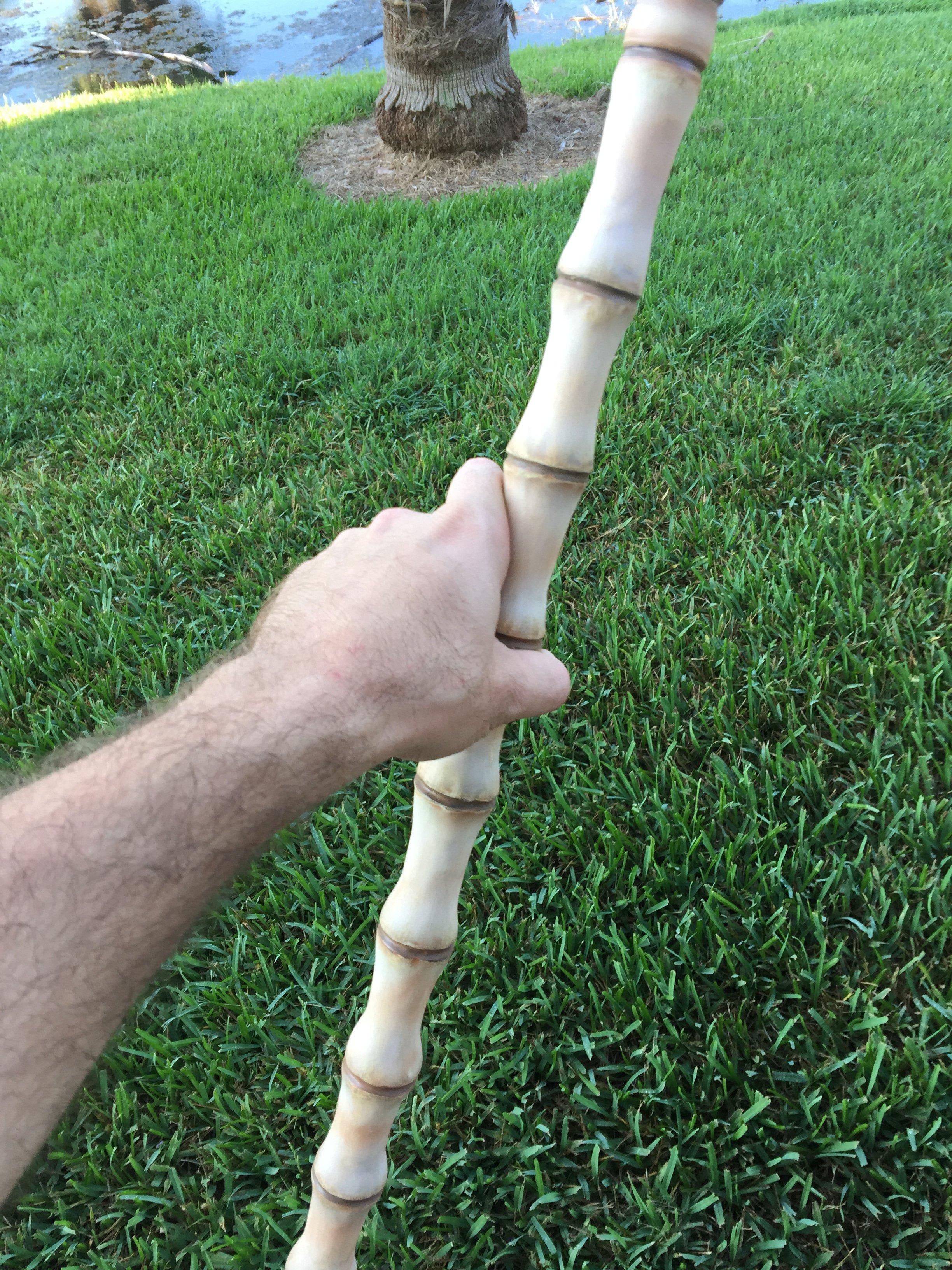

Decided to have a go at one of these canes. I started with a wooden dowel and moulded super sculpey around it. I have an egg for the size of the amber bit on top. I will be making a mould for the top bit, and I've been collecting crain flies to cast into them. I also picked up some clear casting resin and some tenting color for getting the amber color.
Getting ready with the dowel.

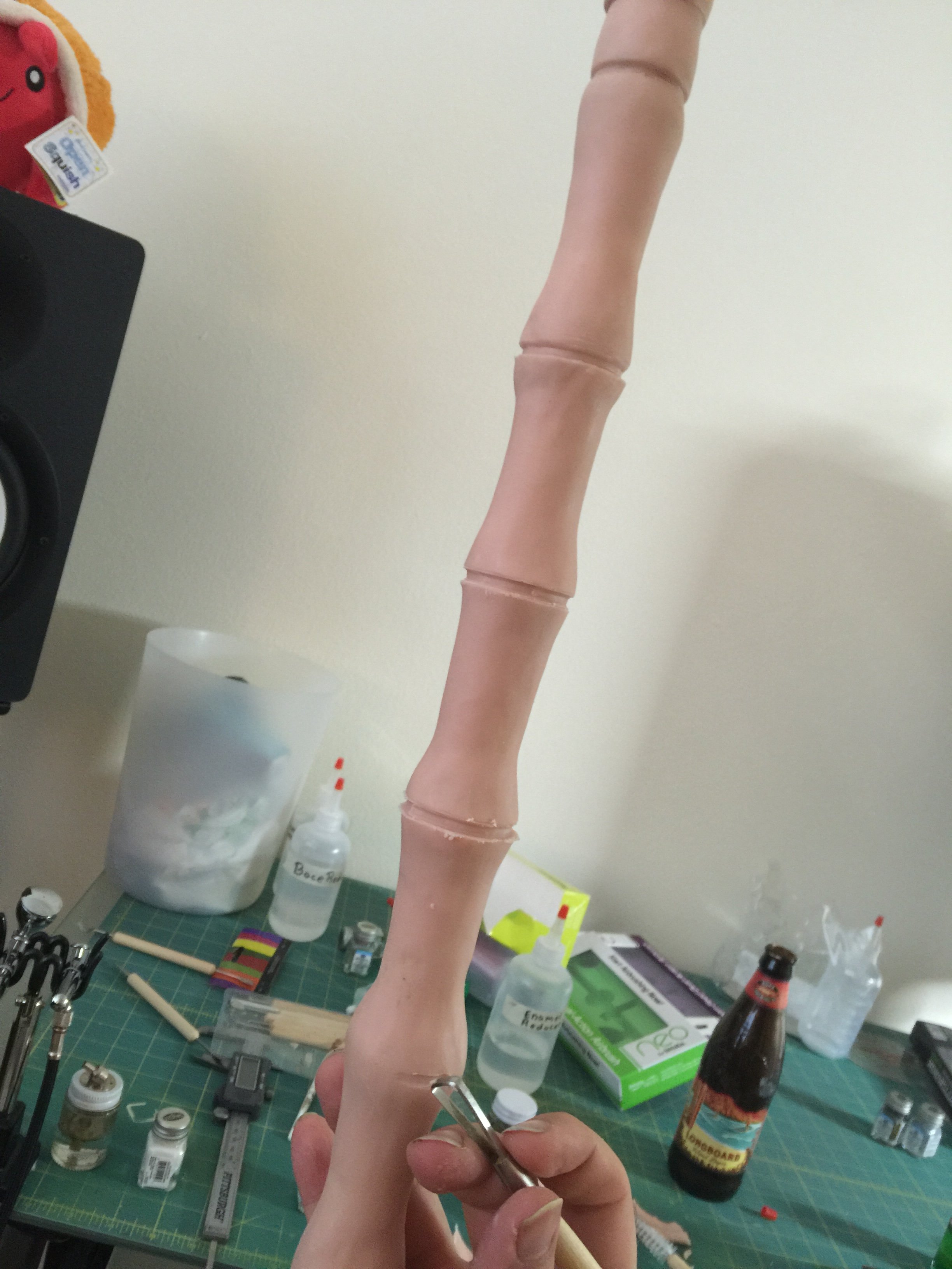

and with some sulpey it started to take shape!
shaping the connection between the vertebras.

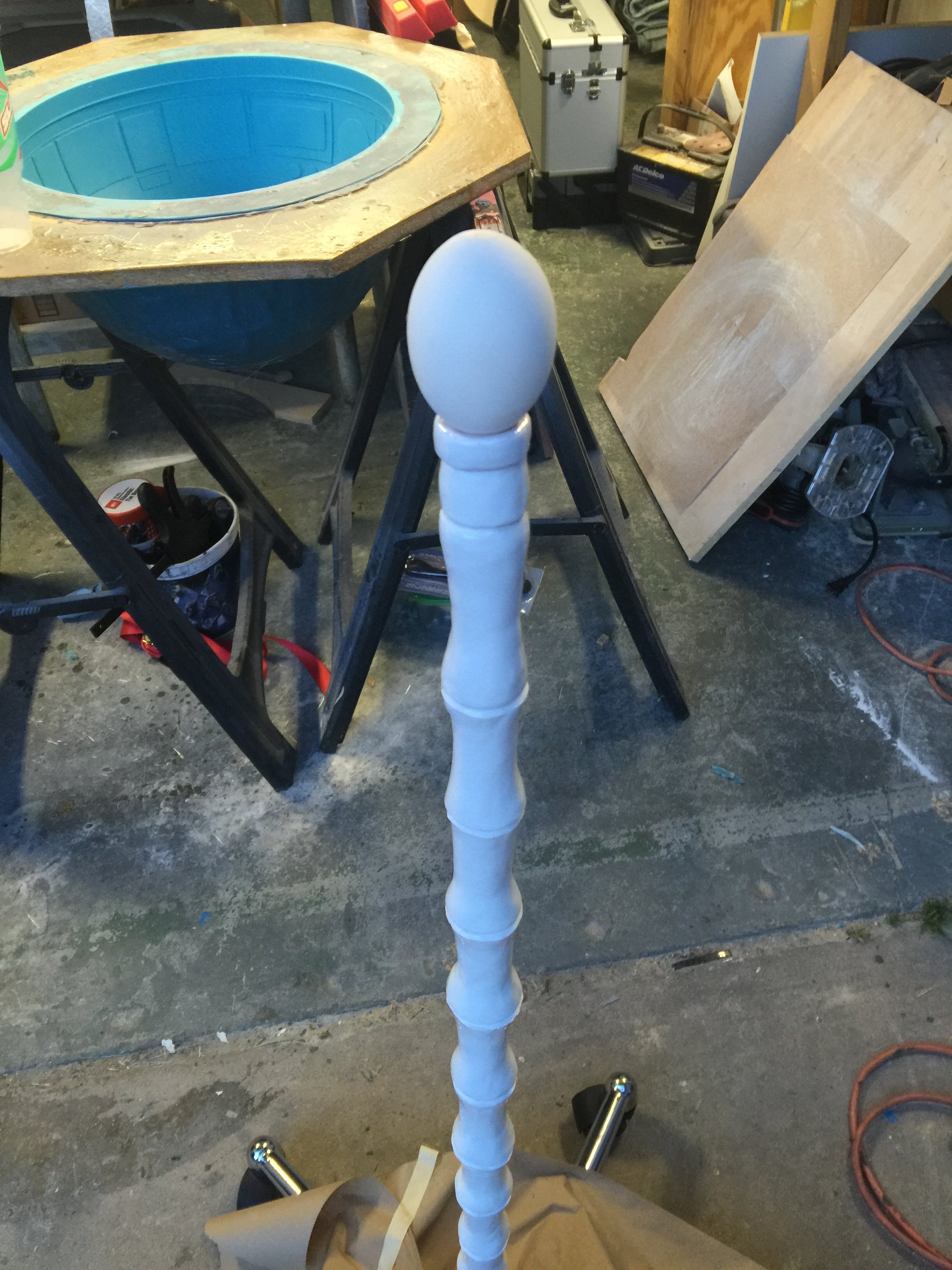

some white paint (I cured the sculpey with the heat gun)

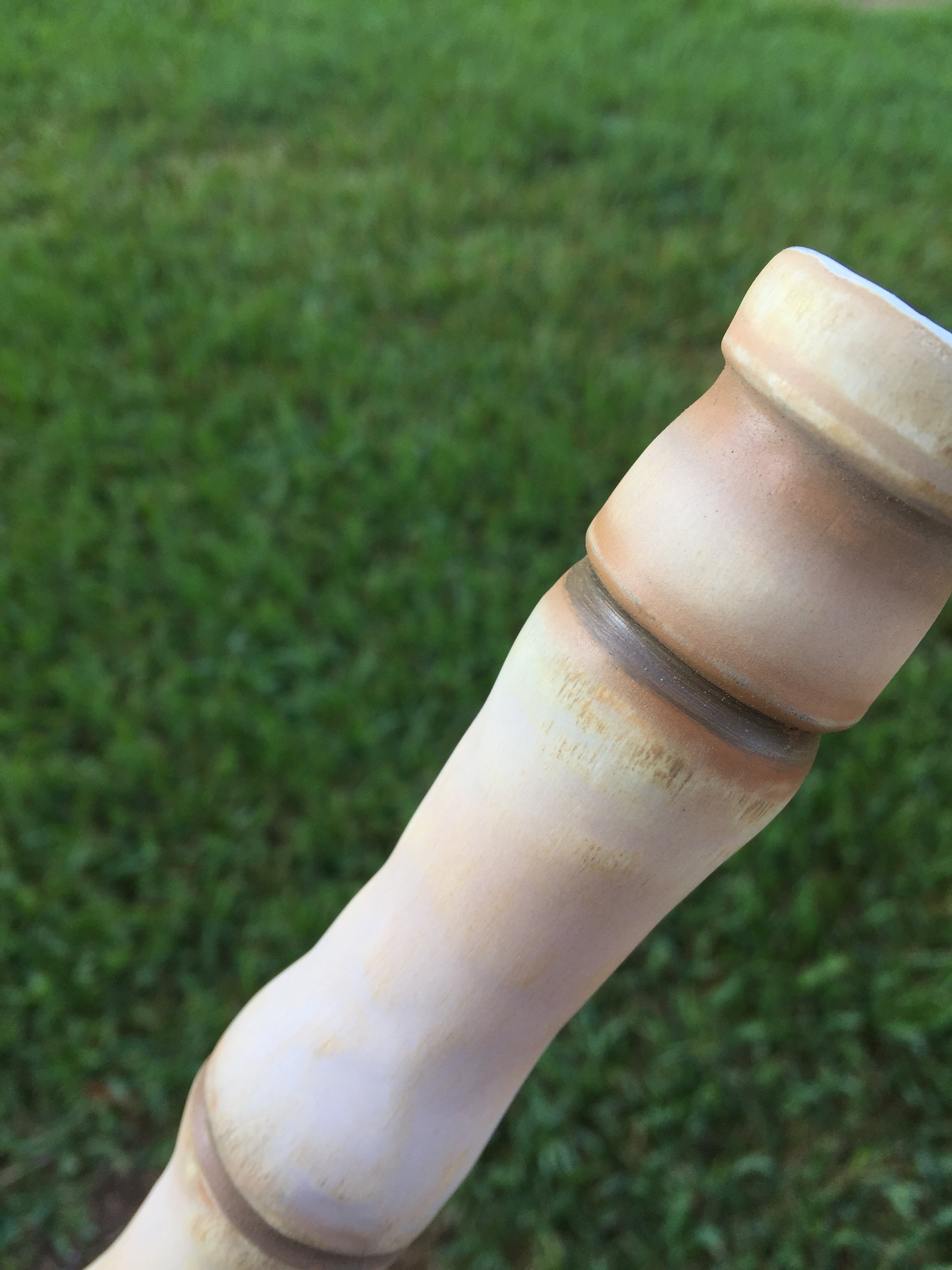

finally I worked with the air brush to get a bone like finish, basically layering different colors and lightly through them to bend.
Close up!

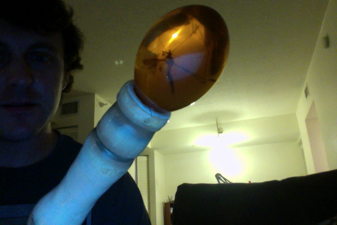

Ok so I made a two part mould of an egg, and put my least favorite crane fly in as a test. it came out ok. but I think the resin ether got too hot, or was disturbed during the curing. The amber looks like it has fractures in side it, they look like sheets of reflective areas, I'm gonna pull another today and use less MEKP so it should cure slower, and have less heat. I will use another crane fly, but I have one I;m saving until I get this right.
Looks awesome tho!
Not bad for a scratch build I started a few days ago, but I am gonna get a better pull for the top.

Looks like a great cane. Can you post some close up pictures of the topper like it is now?

I believe the fractures/cracks you're referring to are from heat. I've had some form before, the thing was, they always originated from some point on the bug.

ok did a new bug, thing looks awesome!
Yes they do come from points on the bug, it could be that the heat is causing moisture from inside the bug to escape and cause the cracks.
So ether less heat. of dehydrate the crane flies some how.
Oh and the old bug is at the shop. I will take some close ups of it for you.

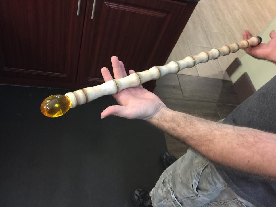

just a heads up, I just completed version two. This time I turned the whole thing from wood, and the whole thing is way more accurate. I'm waiting on more crane flies right now, but I will be posting photos.
