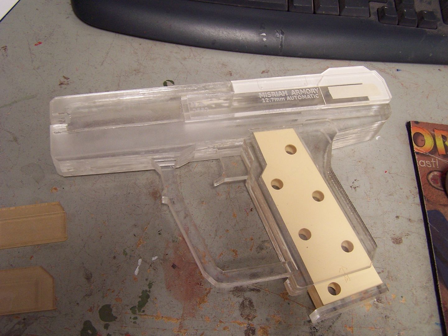

I started building Yesterday. Here is the slide.
The frame.
The Magazine and extra parts.
And a fresh layer of bondo.
Here is also a Video of how the laser engraves the details.
Laser Engraving
I have been doing a lot of fine sanding, and so far it is coming out very nice.
Here is the slide almost complete.
Thanks for looking.

I spent most of the week, doing a bunch of fine sanding, and am pretty pleased with the results.
Next I will add the final details. Hopefully by mid week I can start molding.

Huge update!
So I wanted to grip to have the raised circles on it, and wanted them to have a rounded look, but didn't want to sand or mold them. So I took the thinnest plastic I had and cut out a bunch of circles.
Then I filled an empty glue bottle with some latex black paint, and applied it to each circle. Enough to make it bead up and give it a nice round surface.
Once the paint was dry I could peel each circle up.
Then apply them to the grip.
After a few extra parts, and some primer, the base model of the gun is 98% done.
Now I get to work on the scope part, and the ODST suppressor.
Hope you enjoyed looking at this.

Update!
I made the scope from acrylic, and bondo. I used a belt sander to shape the scope. This was the only pic I grabbed.
Now it is completely finished.
Then comes the molding part. :D All of the mold boxes.
Molding the magazine well first.
And finally.
Just to give you an idea of how long it takes to make molds, I watched all 3 Lord of the Rings Extended cut movies during the whole process. :eek
I'll take some shots of a few pulls later. Thanks for looking.
