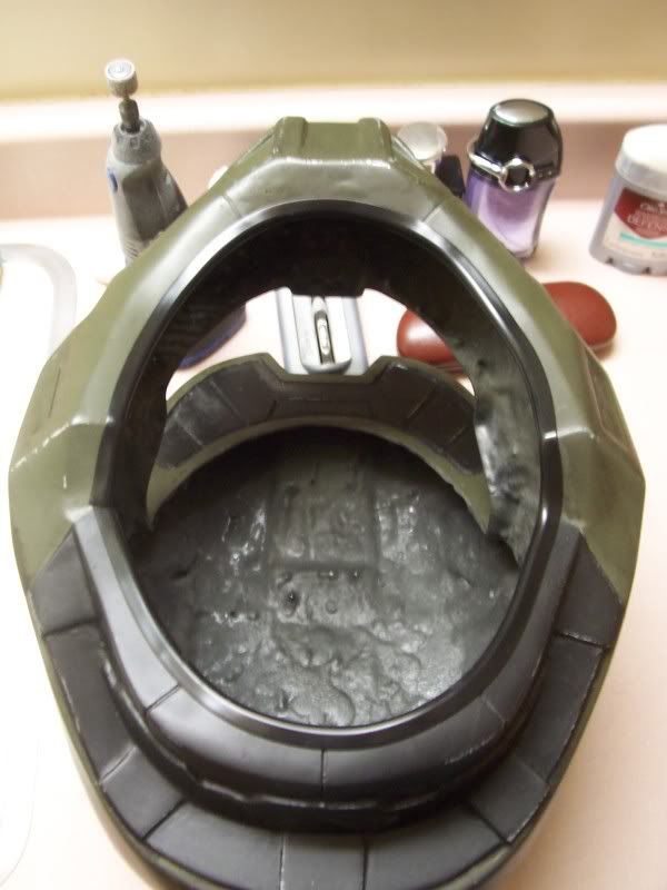

I also decided to do a small detail I think looks pretty good; I went out and got some car door rubber trimming to add to the inner edge of the helmet. I didn't get the sides that slant up only because the rubber would have looked kinda "off" and wouldn't bend the way I'd like it to, but I'm happy with it
Oh yea, and here's that "liner." I mean, I can use it, but I need to add foam underneath it and foam all around it. I really was expecting to get the whole sha-bang, but eh...

That would be great. I need to fill the top a bit just to get the motorcycle liner in there properly..the way it is right now won't do me any good. I was thinking about lining the inside of the helmet out of normal foam then do a "professional" looking foam over the filler foam.
Anyways, I decided to do some quick grinding and make the trim a completed portion.
