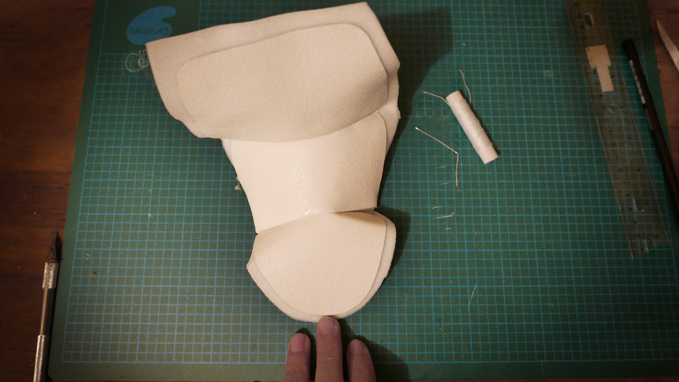

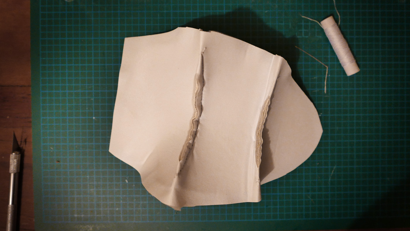

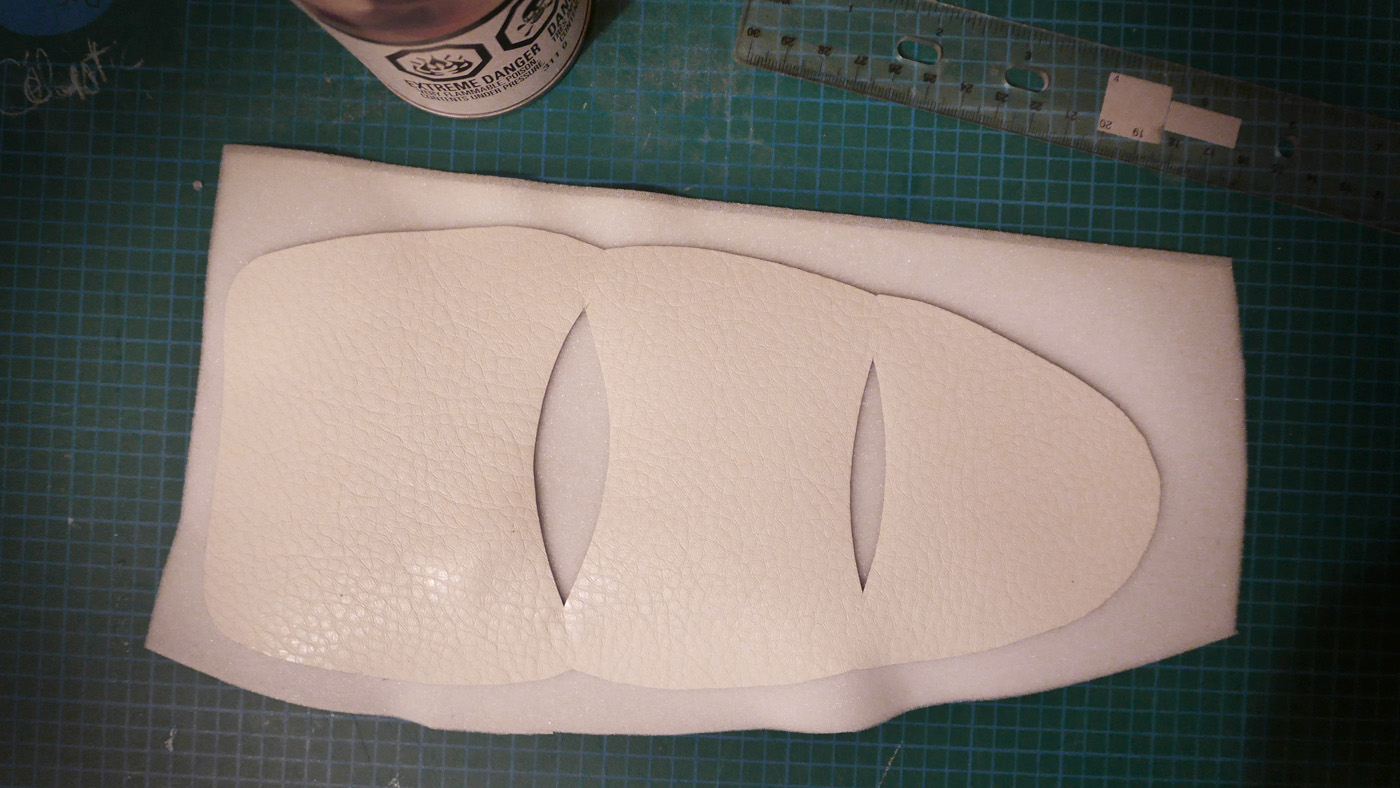

For the tongue, I used the patern of cavx but I've redesigned the sides to make them larger !
• Front : Fake leather glued to some foam :
• Back : The hand sewing :
• Overall shape :
I'll trim the excess foam and make a back and something for the edges later ;)

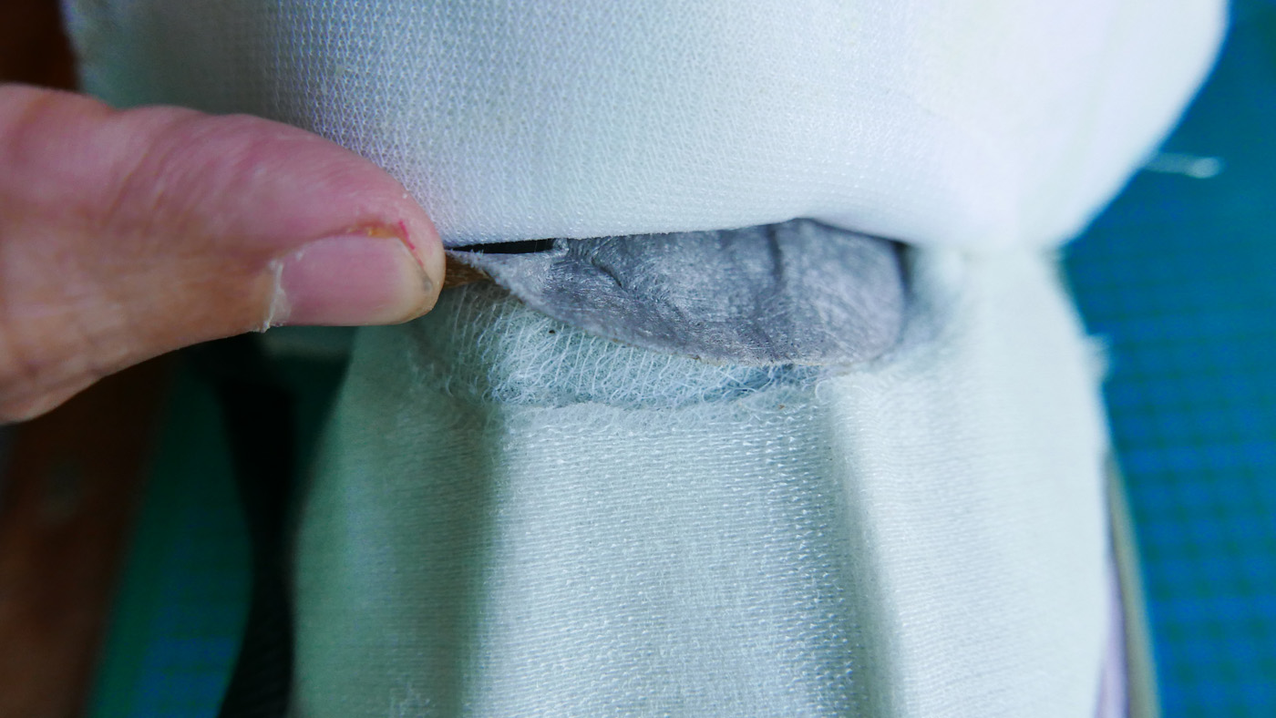

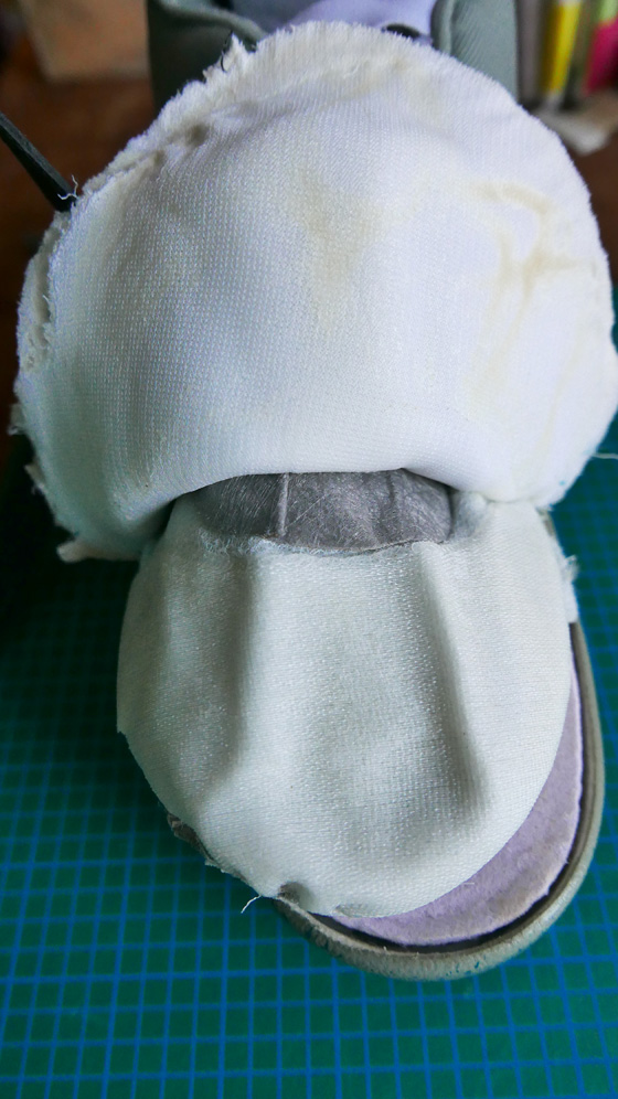

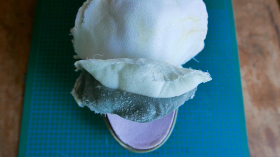

Some pictures of the inside of the HC shoe :
View attachment 558700 View attachment 558702 View attachment 558701
As you can see, there is 7 layers =
• Grey fabric
• Foam glued to the Grey fabric
• The toe box
• A white tissu that maintain the foam
• A grey fabric around the laces
• Another layer of Foam (Not as big as the first one)
• The inside Grey fabric
Wow that's a lot of layers!!! Didn't realise there was that much!!

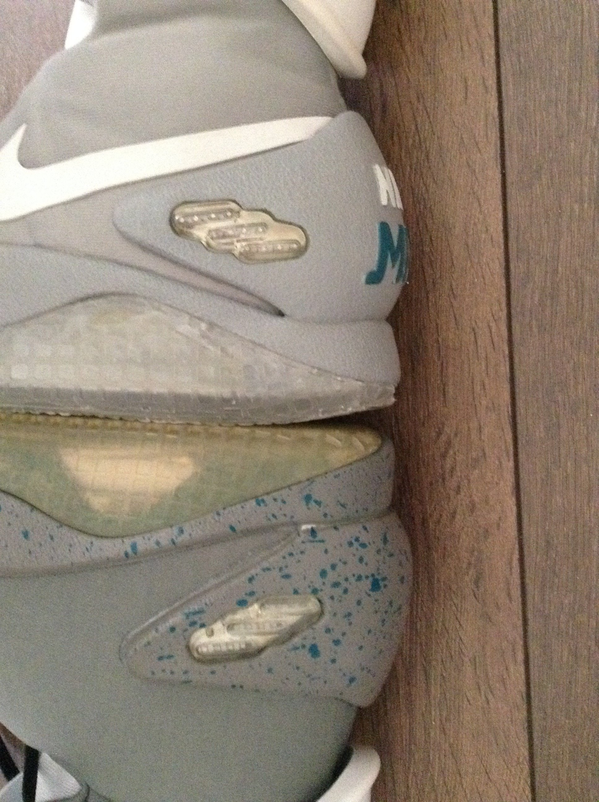

Is the heel cup on the HC a different shape to the one on the V2? The wings seem to sit high on these when people attach the SWOOSH.
It seems to be attached slightly differently or something. Perhaps it's because of the excess foam in the HC's, but the uppermost point doesn't seem to lean in as much, making the 'wings' come up (see attached pic) - thinking about that, pity the V2's didn't have more foam in the grey upper (not the collar)
