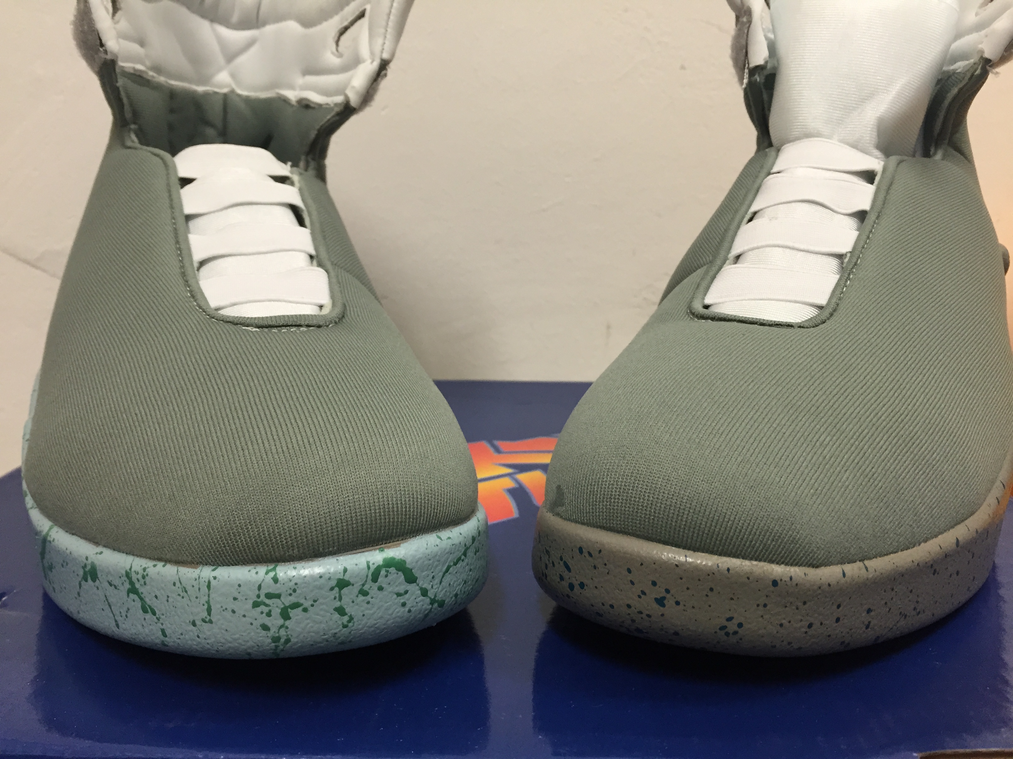

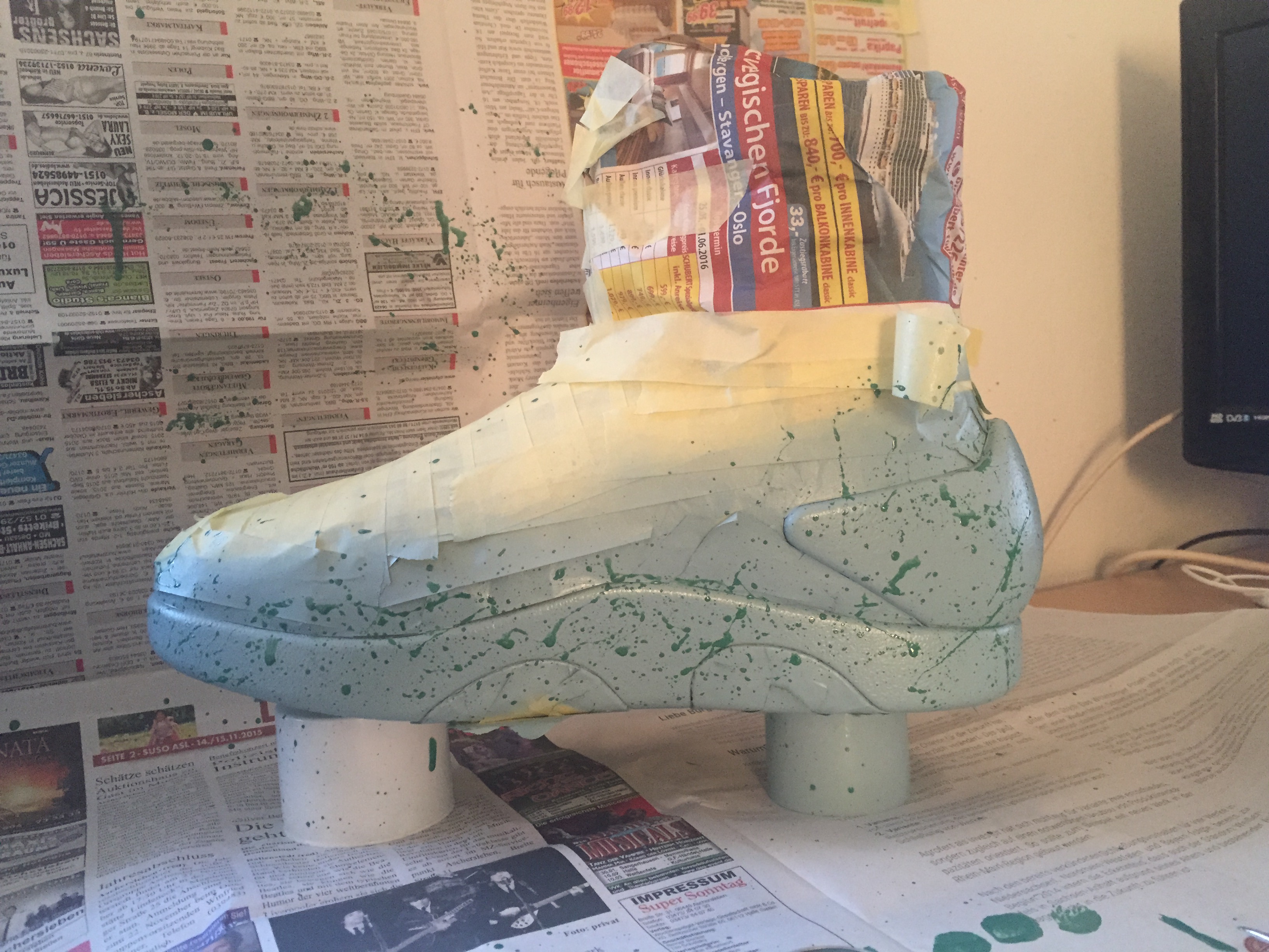

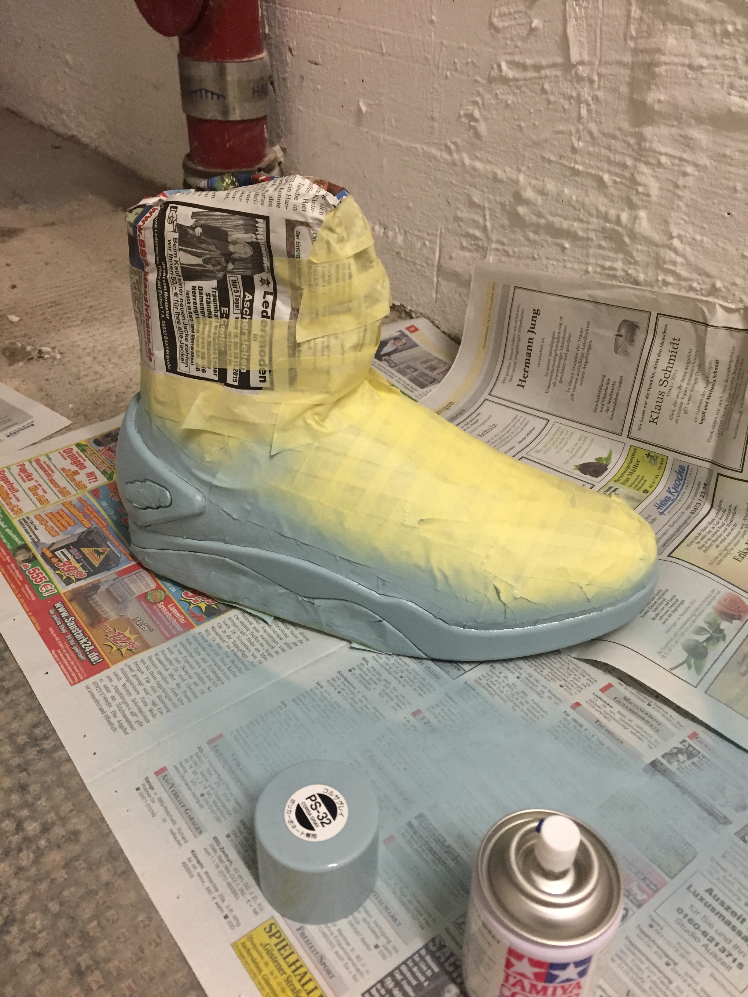

after a lot of reading and learning about the Air Mags here in this Thread, i finally started to mod my pair :)
i also buys Mark´s Decal & Lightning Kit - but first i wanted to change the Color in a more authentic movie paint.
sanded it with 400 Sandpaper and used TAMAIYA Sprapaint , its perfect for this type of rubber material

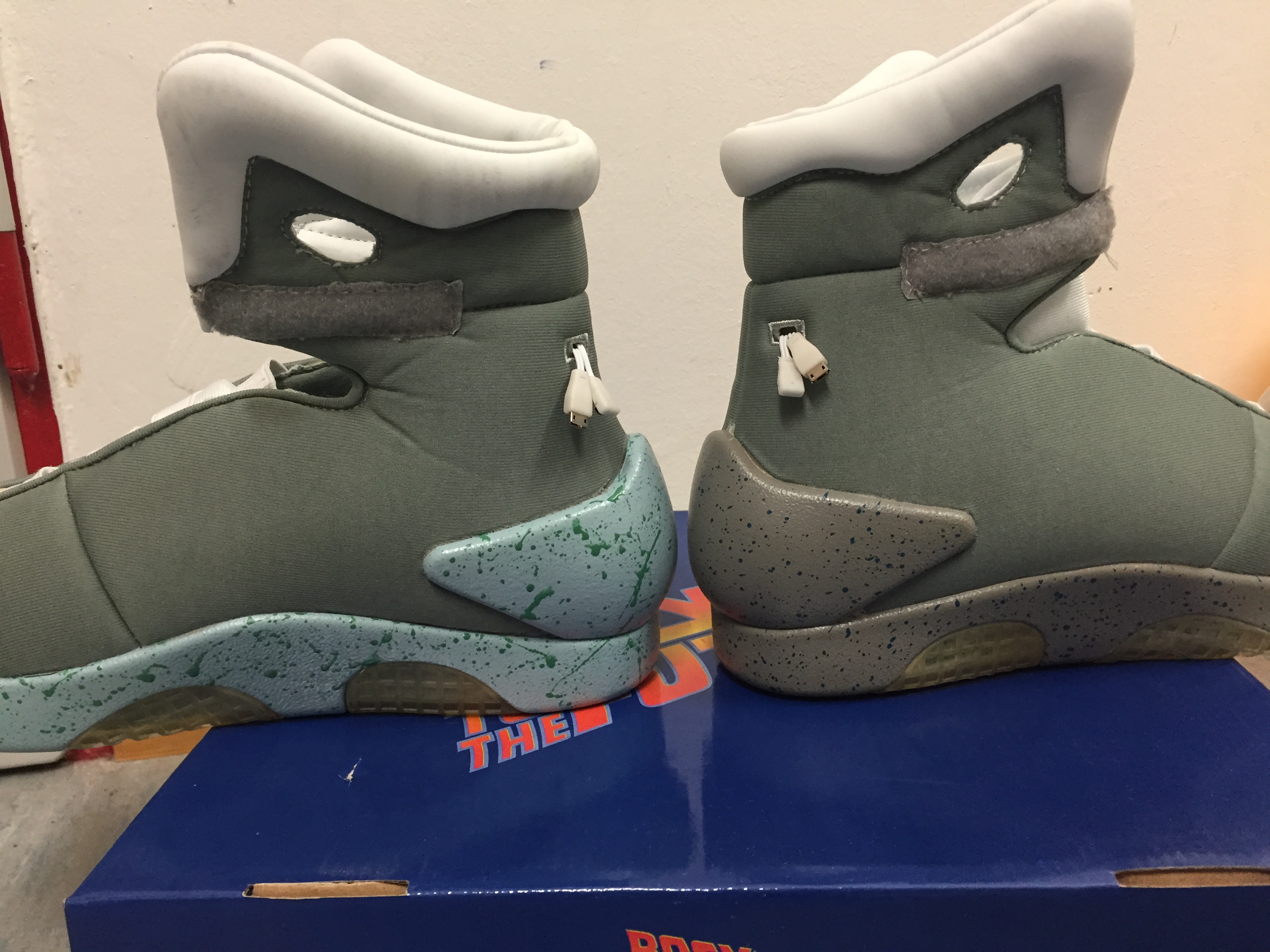

what do you think , does is look better with the new color and splash effects (made with my finger & short Brush)
Basecoat 3 times - then the Splash Effect - then Finish matte coat
original HC vs Custom Color
Done with the first one, already started the second :)

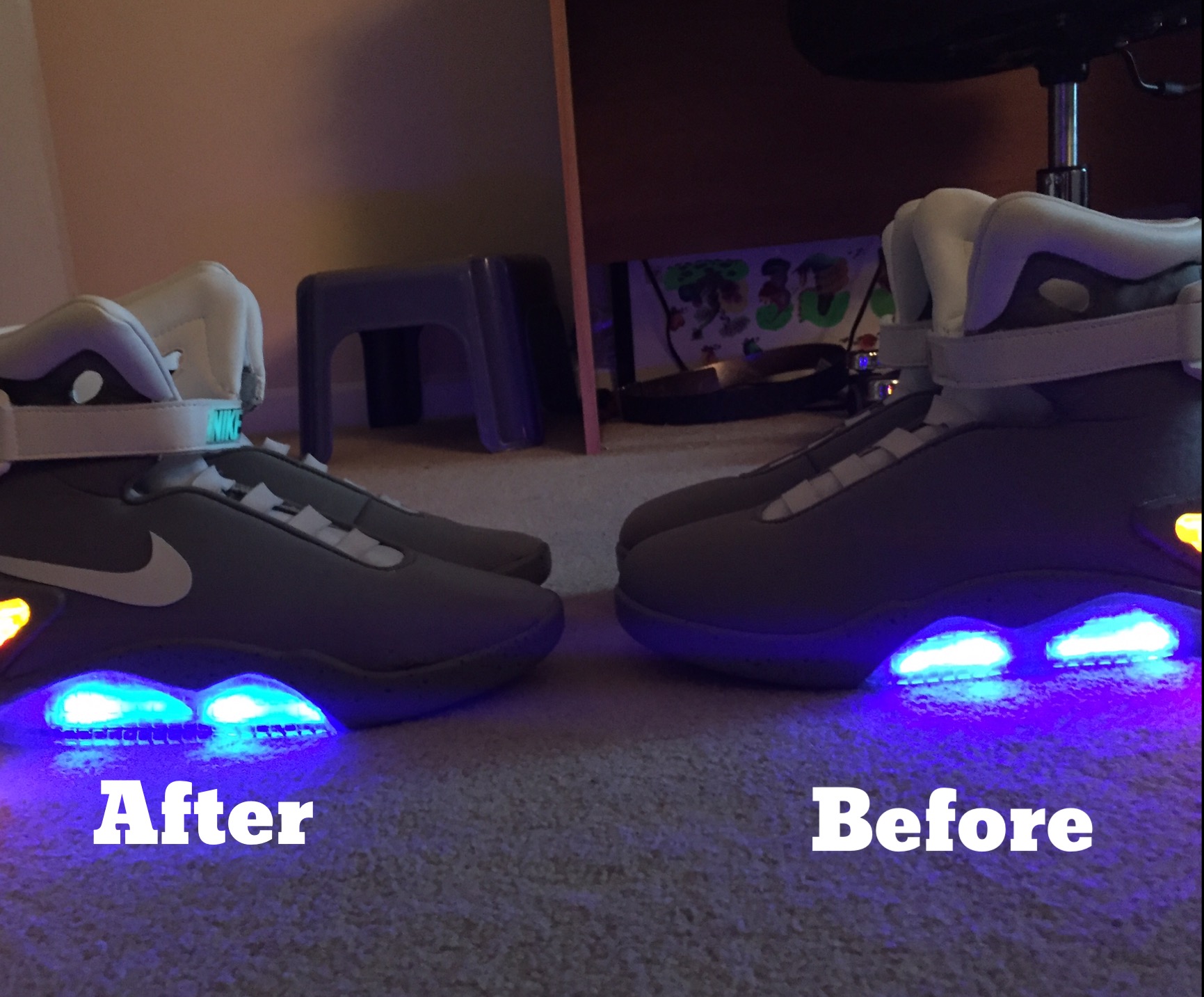

hi I kinda joined this thread late but I'm actually done modding my mags I used Cavx's clear sole and GITD straps and I also did the sock toe slim mod. I actually have a second pair and will do doing an el and led mod soon.:D For my sole during the day I use the default led that come with the shoe when it's night time I switch to the GITD stuff

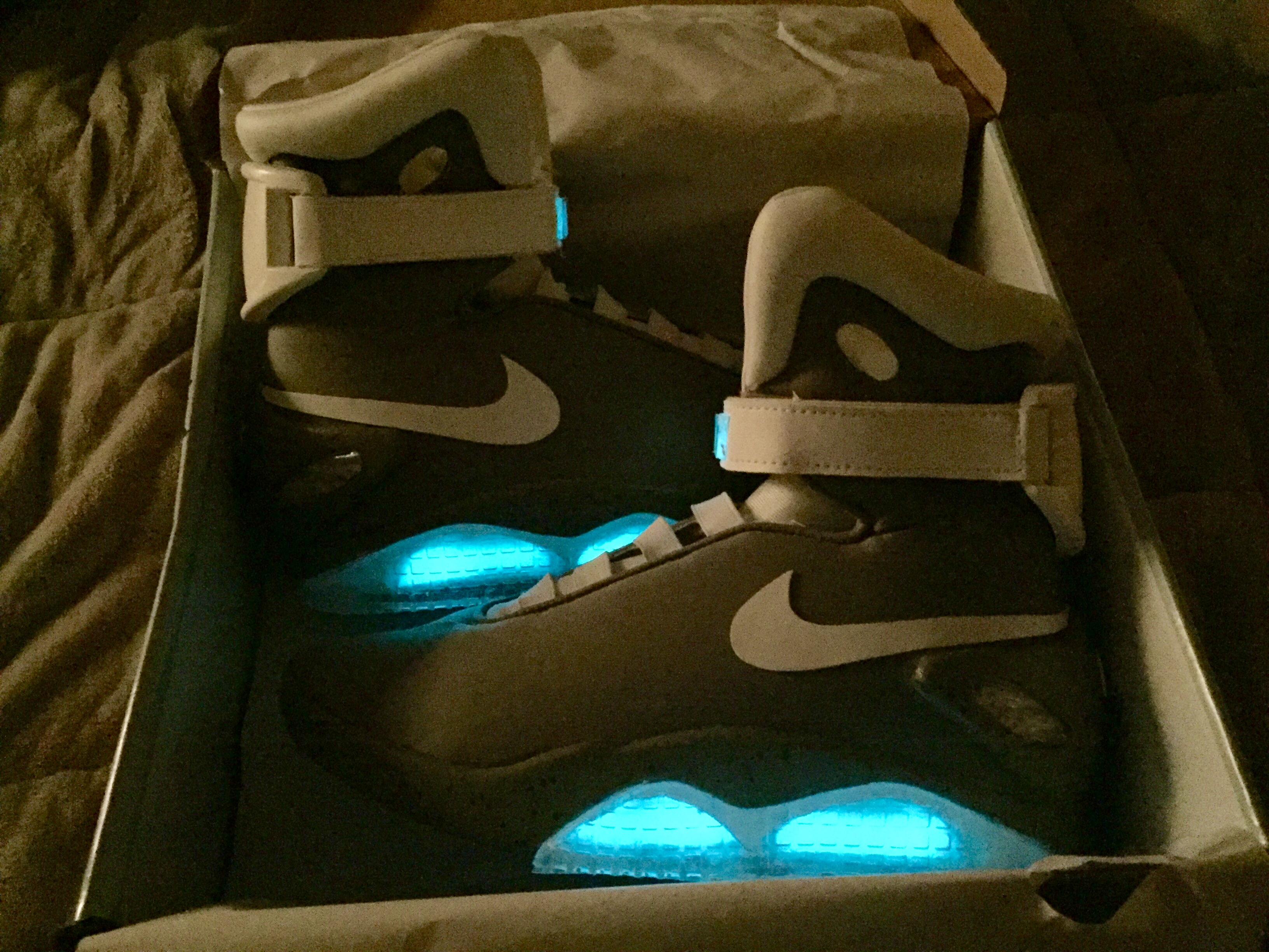

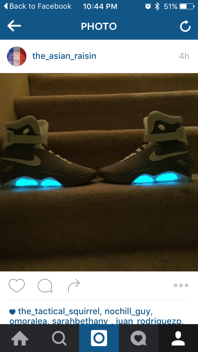

View attachment 557471View attachment 557472View attachment 557473View attachment 557474View attachment 557476
Wow, the new sole lights look great!
How exactly did you do that? Do you need a whole new sole? And where did you get the lights from? Love the blue colour much better than the standard one which looks too purple!

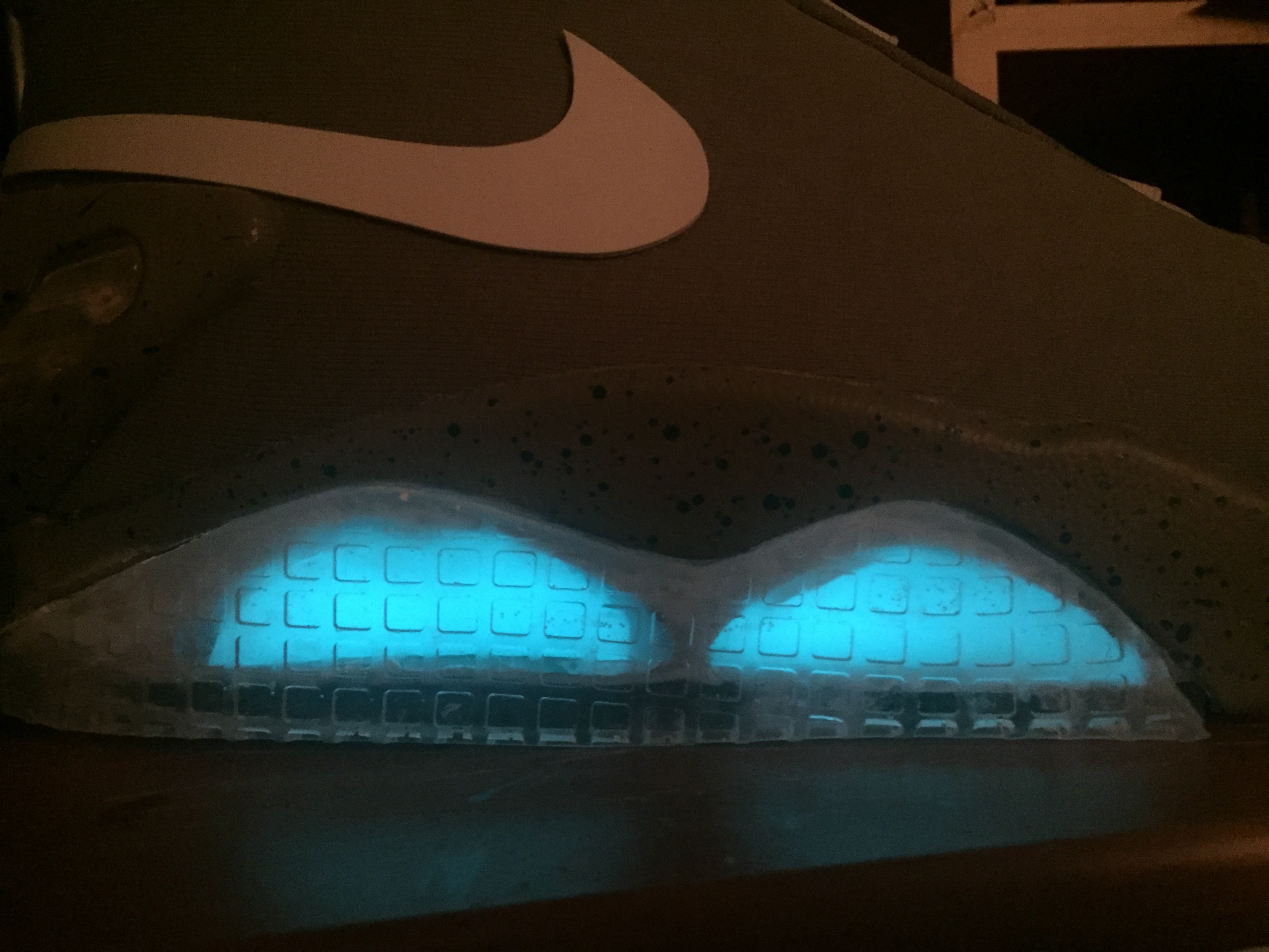

hi Kevzie the sole were done by taking off the old yellowed soles and placing on Cavx's clear soles and using the glow in the dark stuff Cavx sells with the soles. The main idea of keeping the old electronics to charge the glow in the dark. When constructing the clear soles I cut the glow in the dark material in an el shape ! I looks just like el but it's just glow in the dark material.

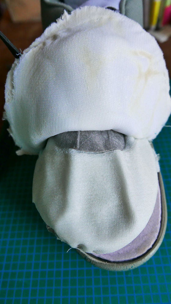

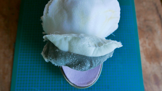

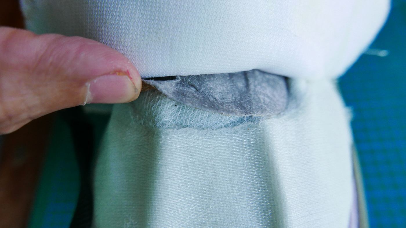

Some pictures of the inside of the HC shoe :
As you can see, there is 7 layers =
• Grey fabric
• Foam glued to the Grey fabric
• The toe box
• A white tissu that maintain the foam
• A grey fabric around the laces
• Another layer of Foam (Not as big as the first one)
• The inside Grey fabric

Wow, no wonder they felt so chunky. Goanna have to pull most of that out, I think.
