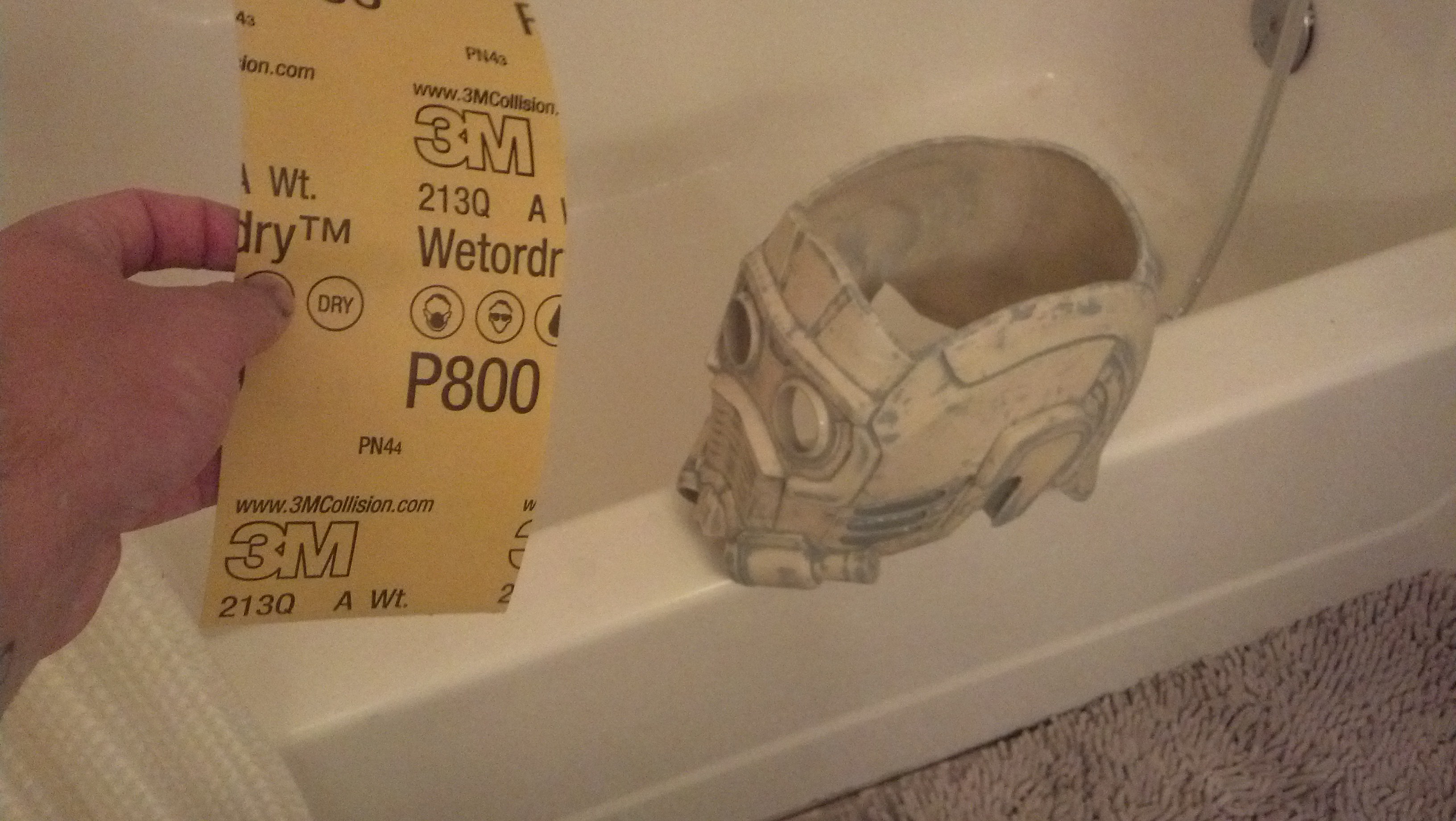

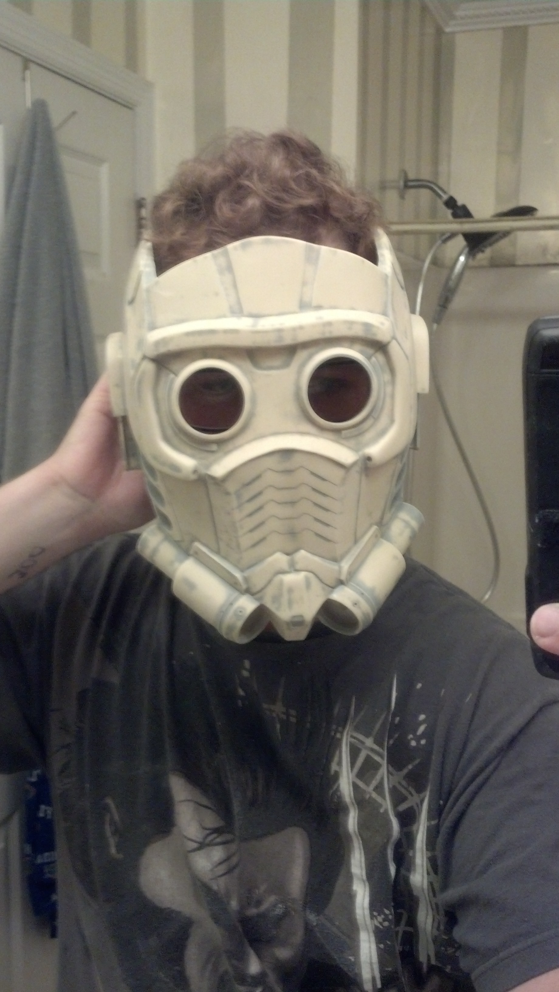

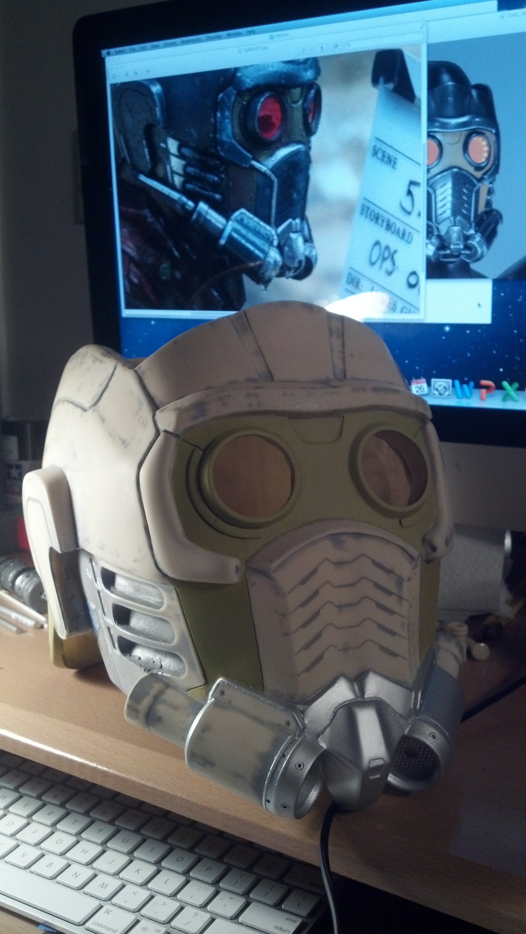

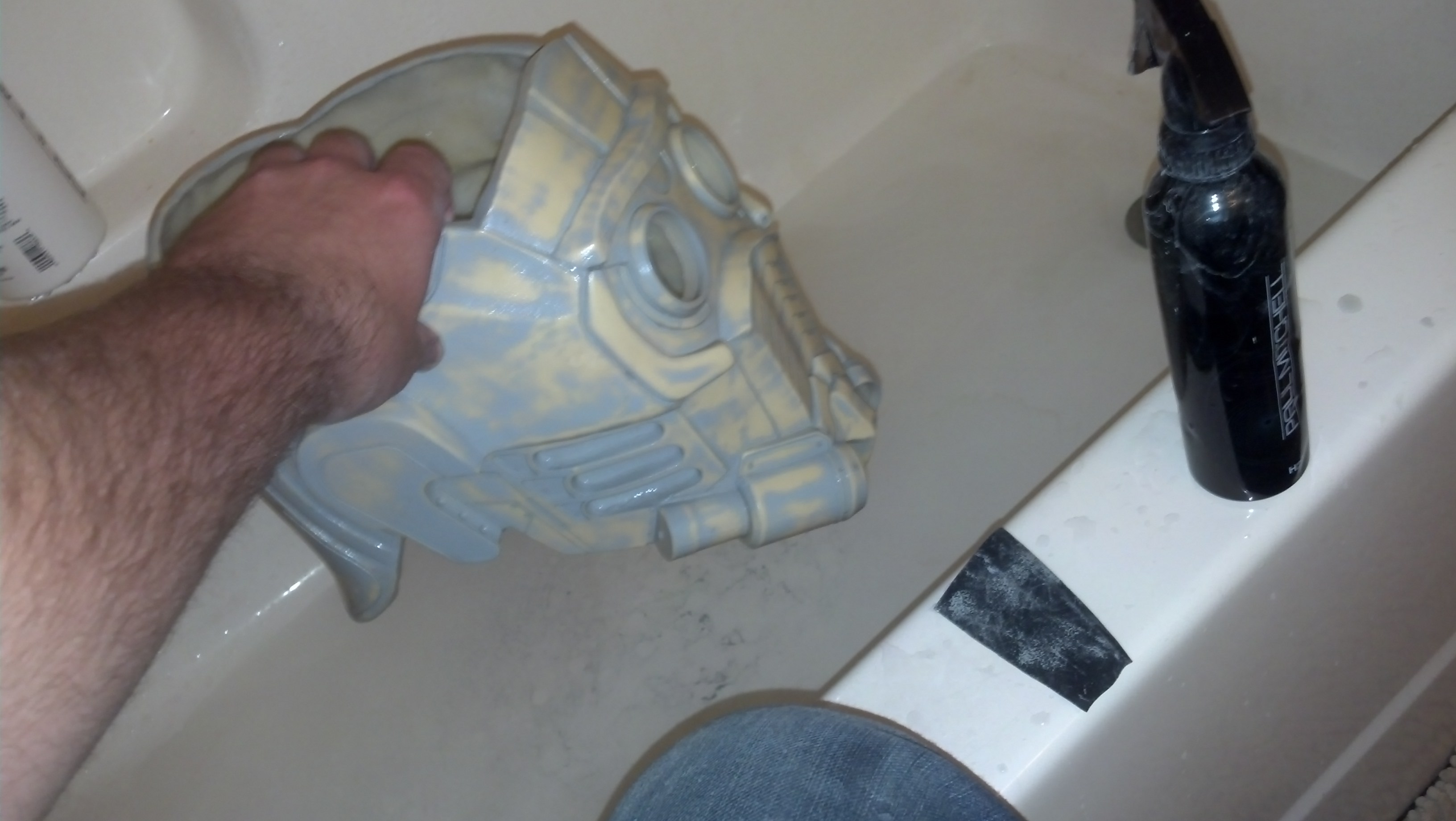

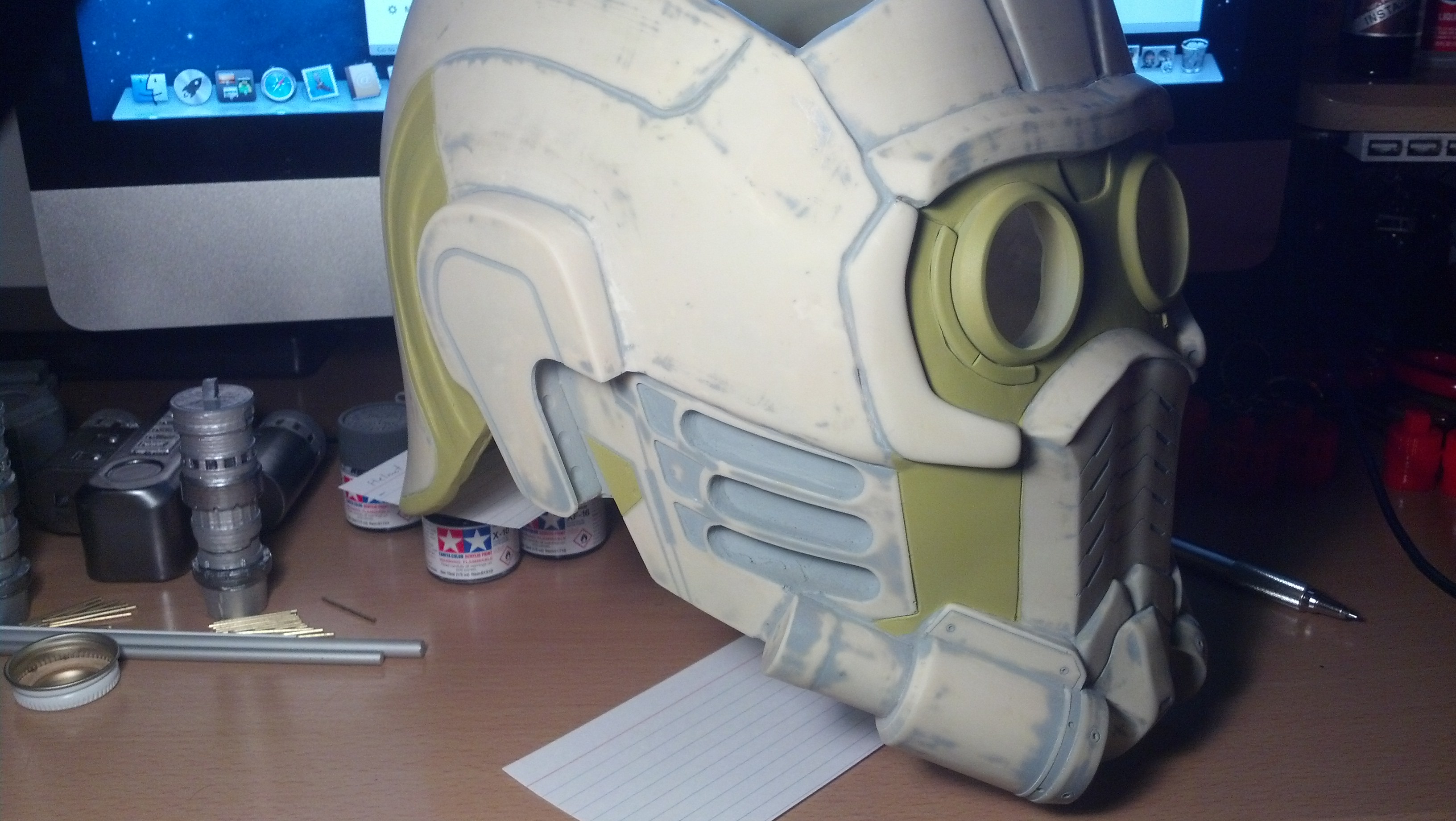

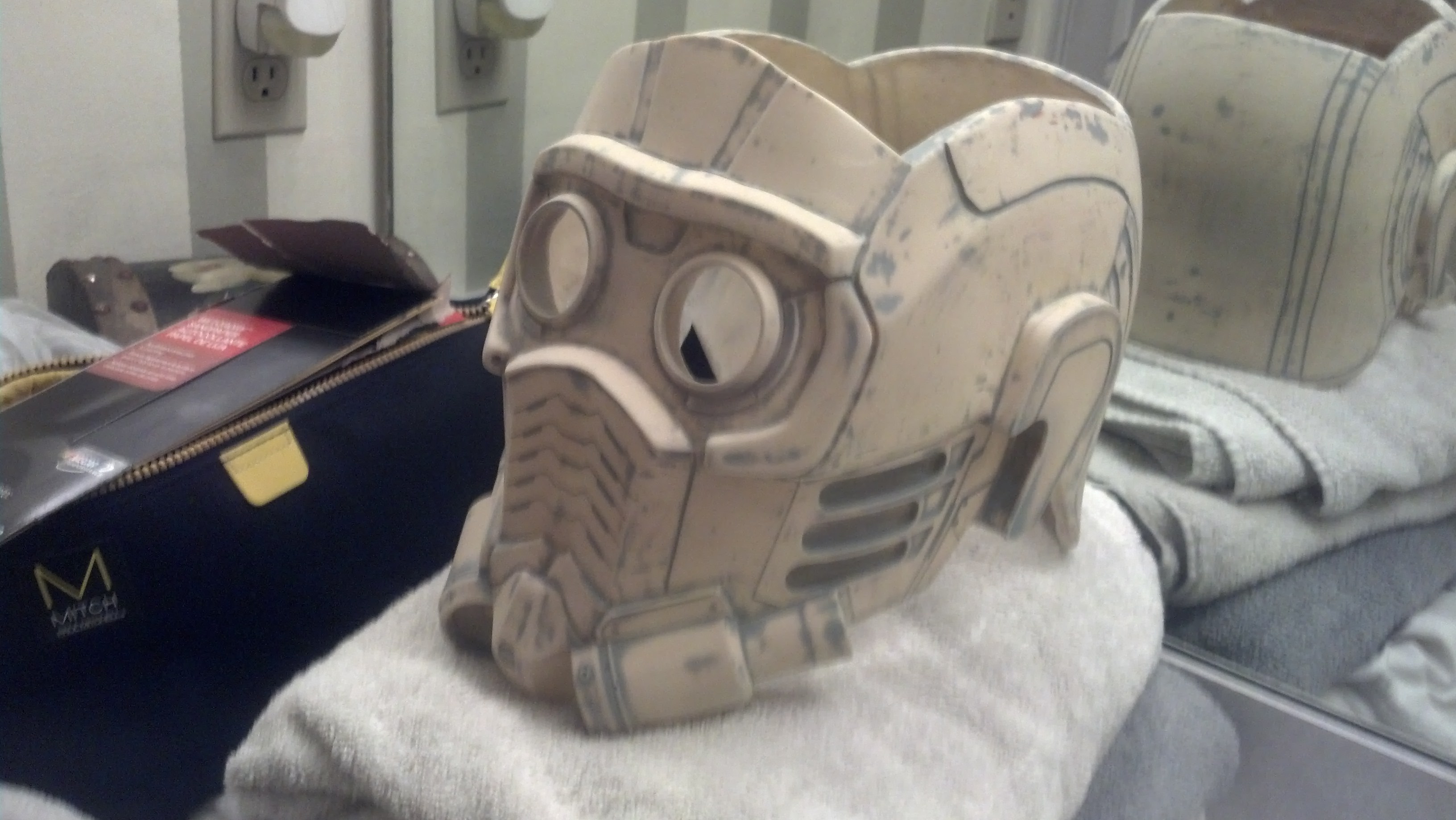

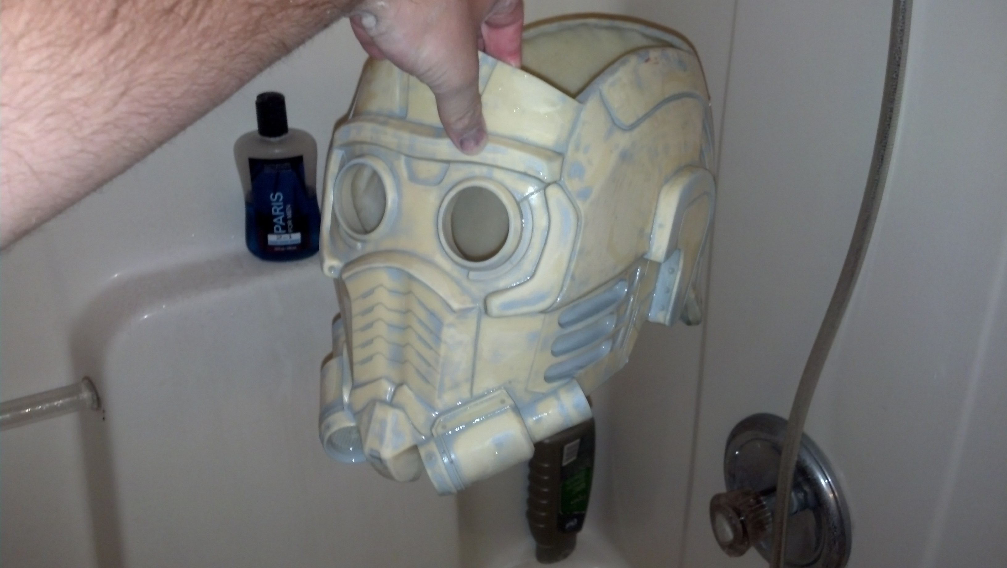

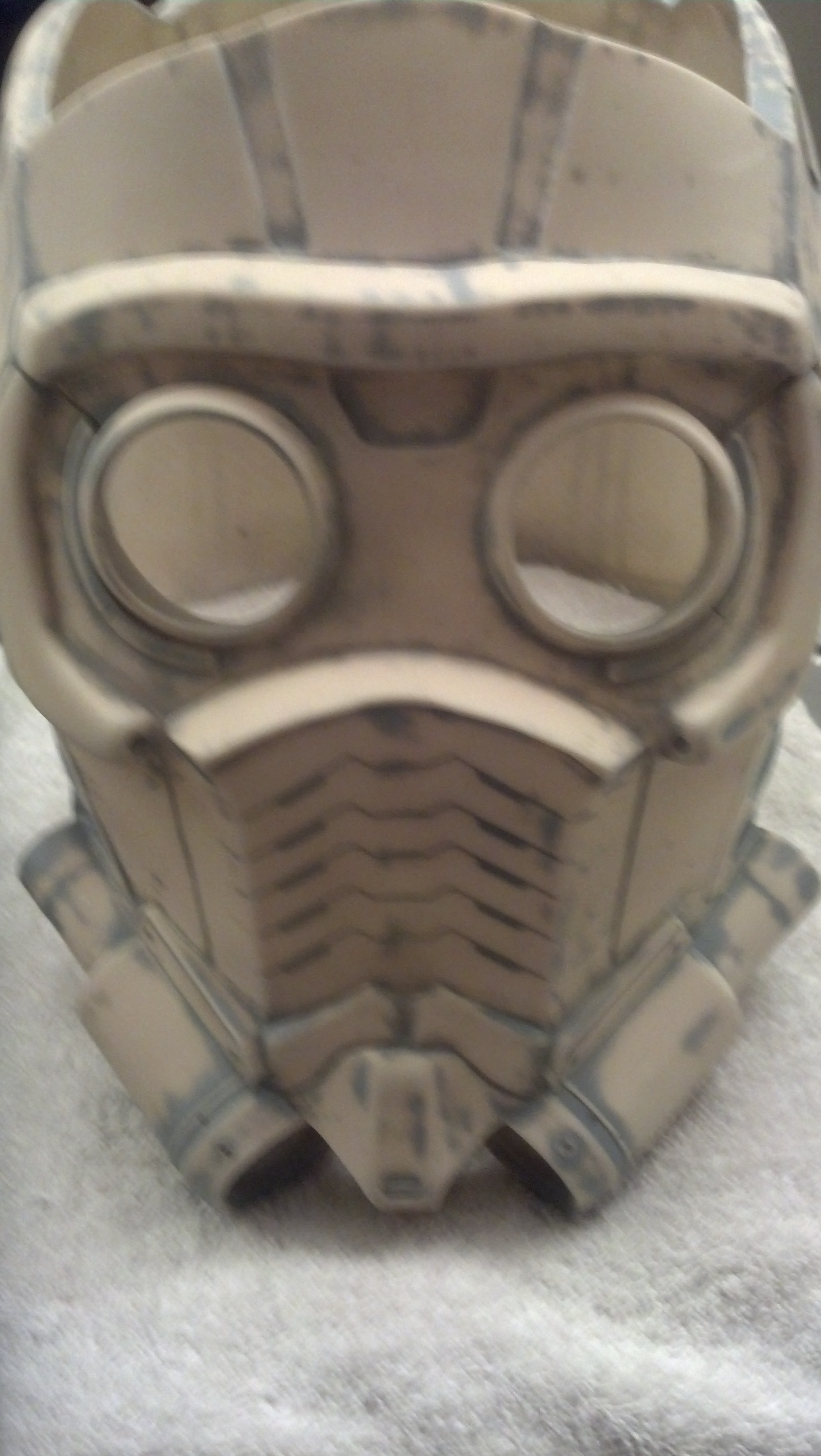

I figured I should post last nights work so heres what I got done.

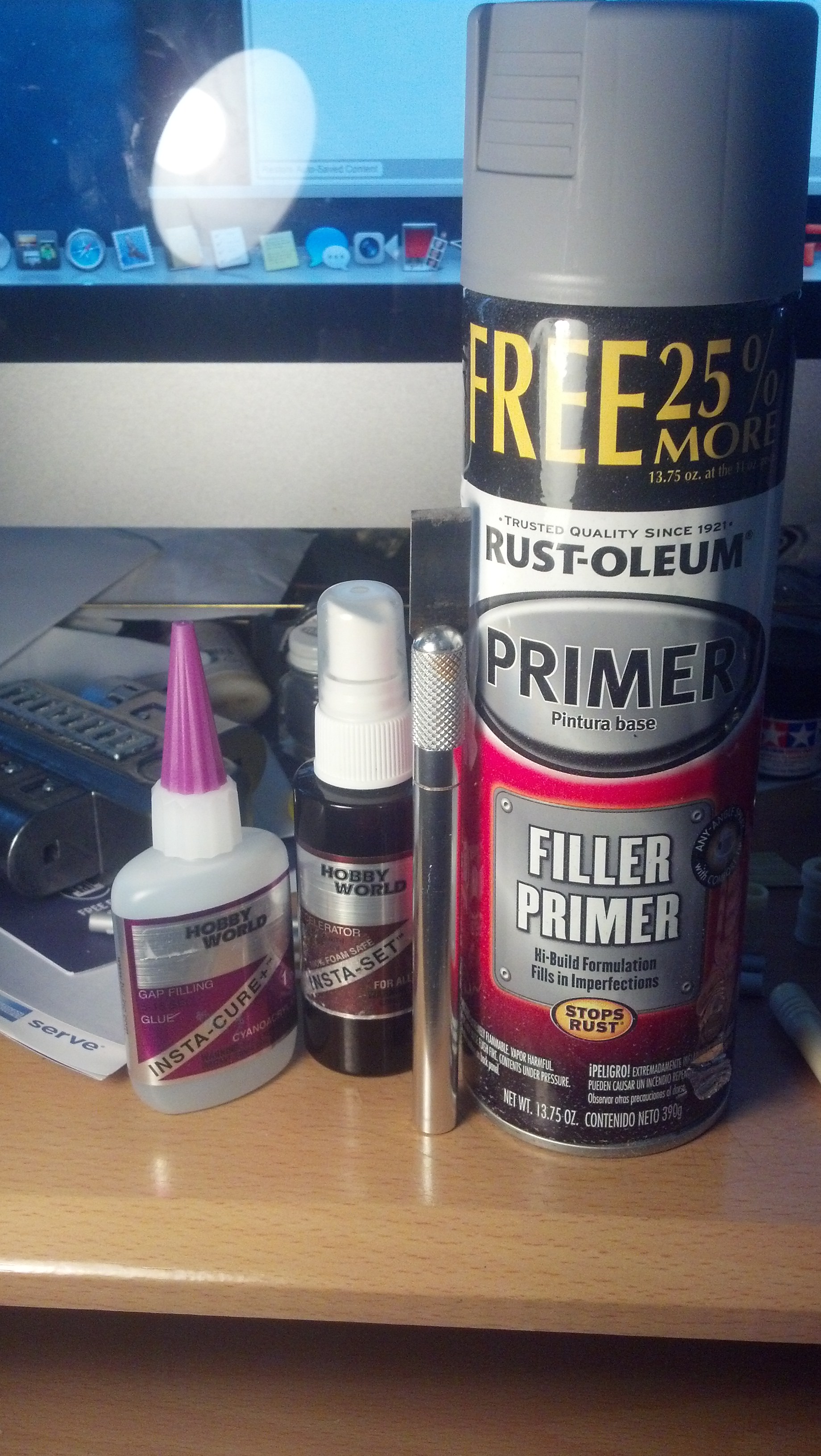

I did pit filling with CA glue and a flat hobby blade then painted with a filler primer.

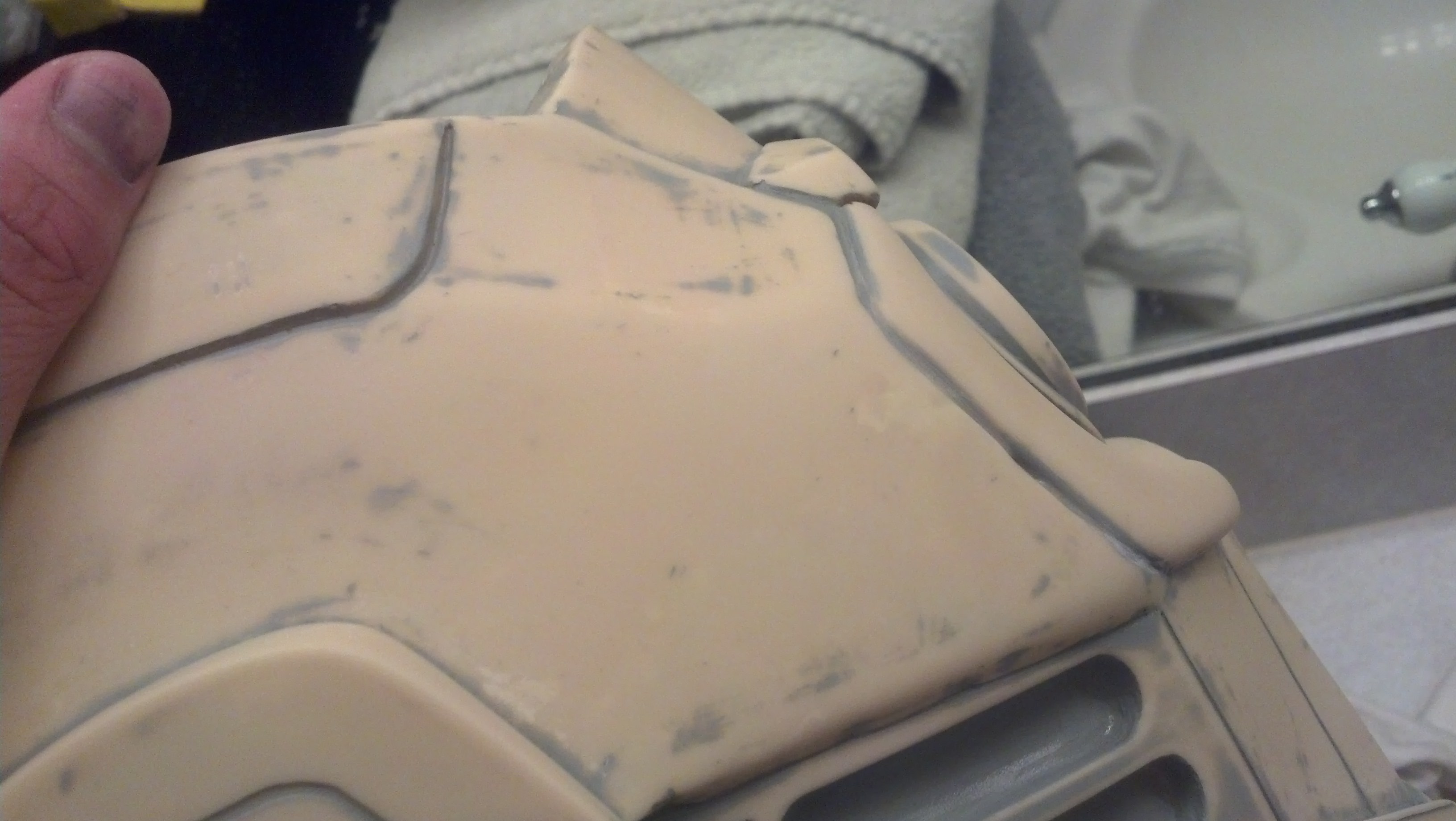

View attachment 352521After the primer dried I started sanding.
Istarted with a dry 220 grit and got all the rough surface of then started wet sanding.
View attachment 352522View attachment 352523
The sanding when as follows.

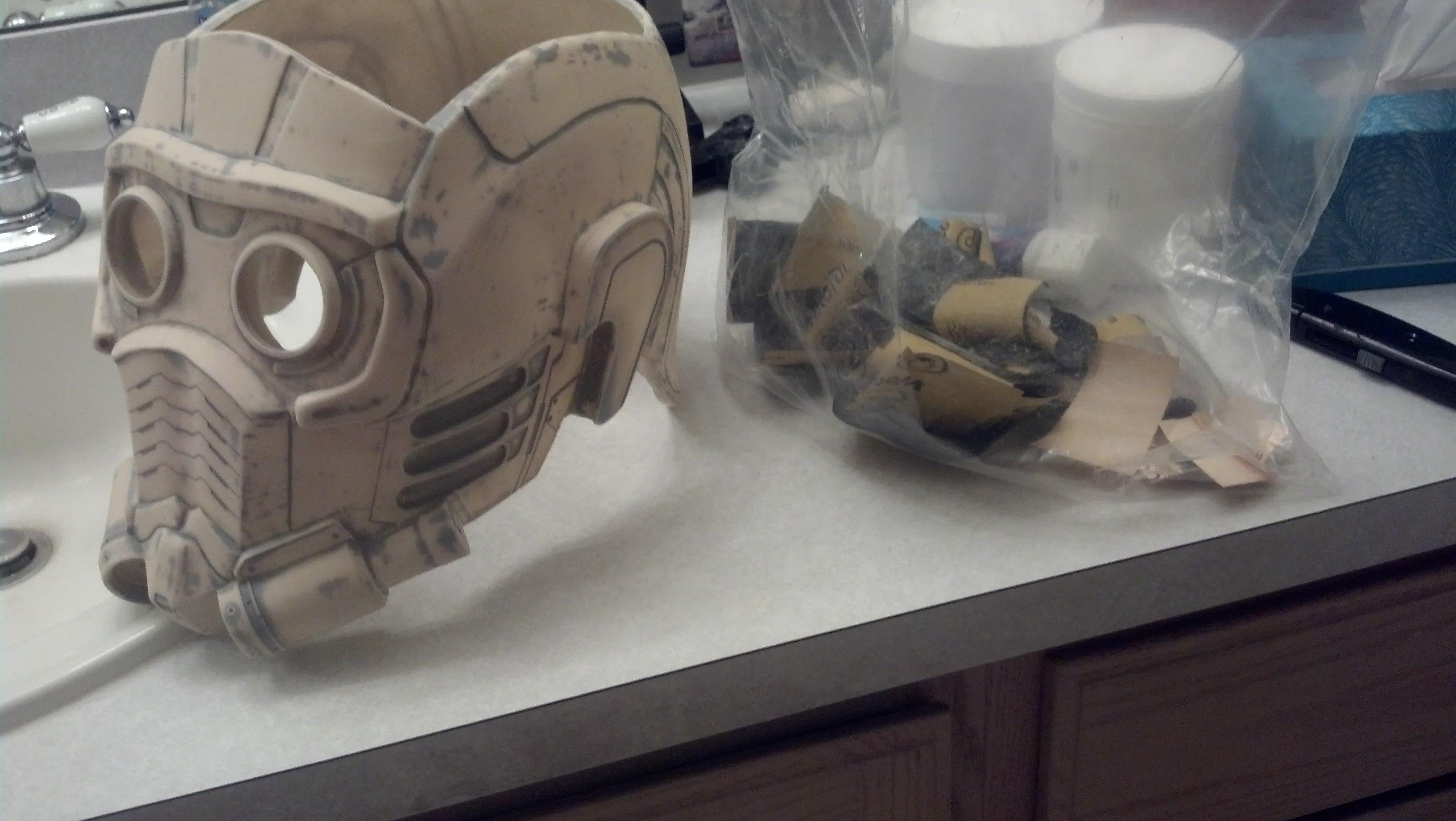

Started with a quick wet 220, moved to 320, 400, and I went up to 800.
View attachment 352524It took something like 2-3 hours of sanding to get the final finish.
I used a lot of sandpaper...:lol
The finish turned out great and I'll get more paint in the next few days to paint it. In the mean time I'll get all the little bits prepped and finish up the jets.View attachment 352526View attachment 352529

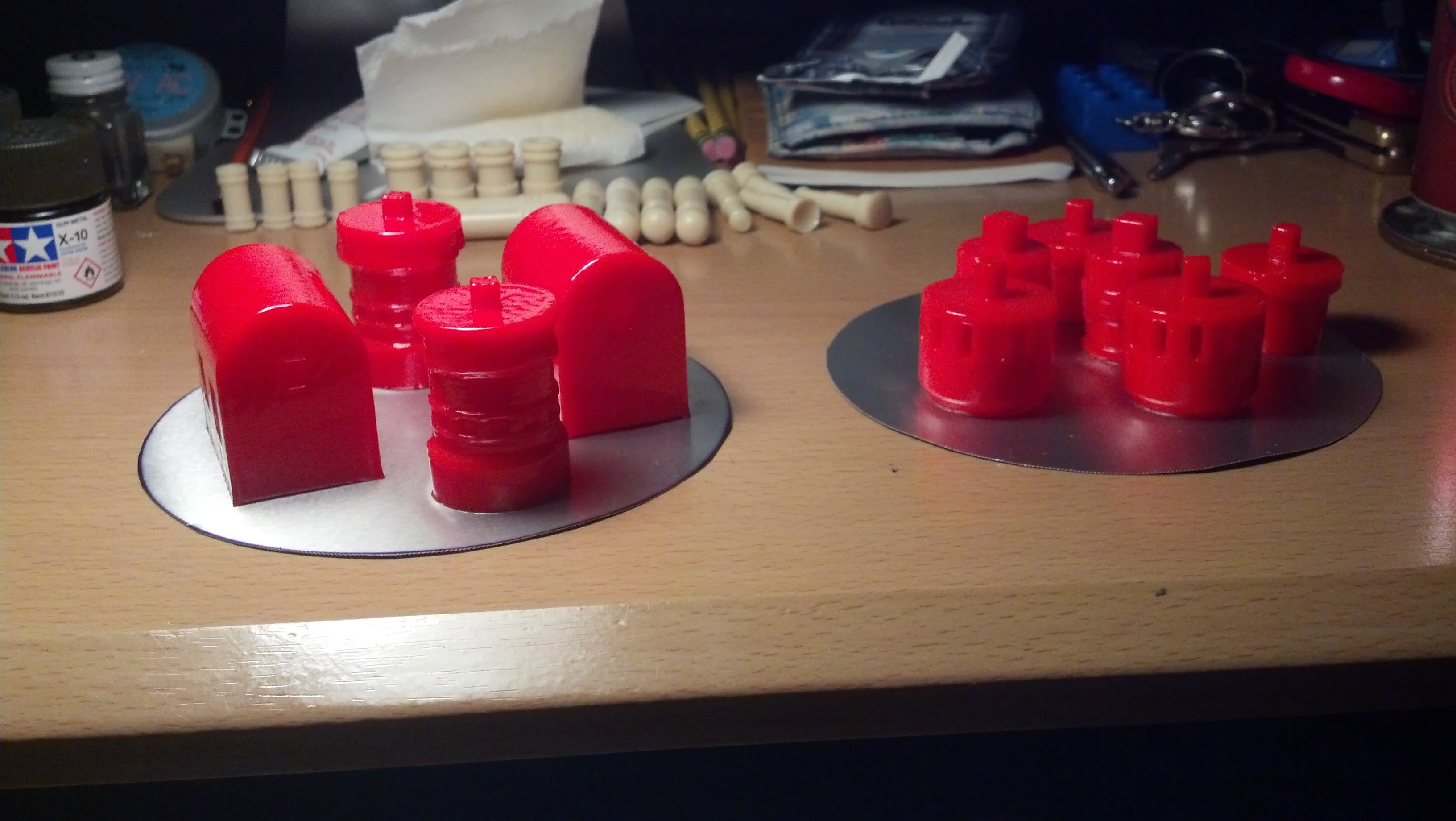

I got the kit from Kevin Gossett, he charged $40 I think. If you get it from him ask him to print in grey, some of my parts came in red and were a pain to paint over.

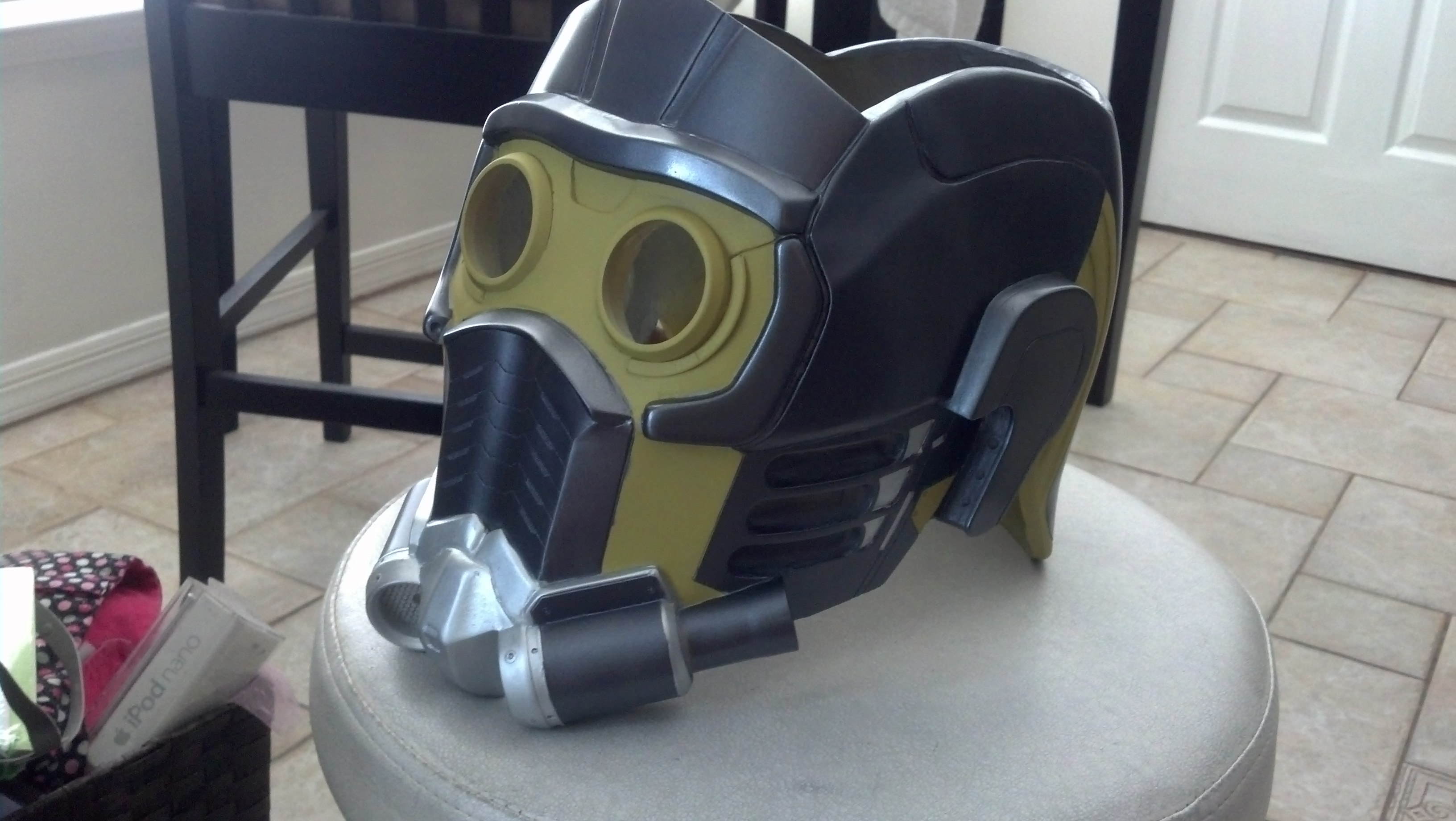

Below are pics of my "budget helmet". I'd like to spend more on it, but I'm waiting to see if the movie does well enough to pump in more money.
The light for the eyes are $1.00 party bracelets from Walmart in the kids section.
View attachment 308779View attachment 308780
Fantastic budget work.....looks great.

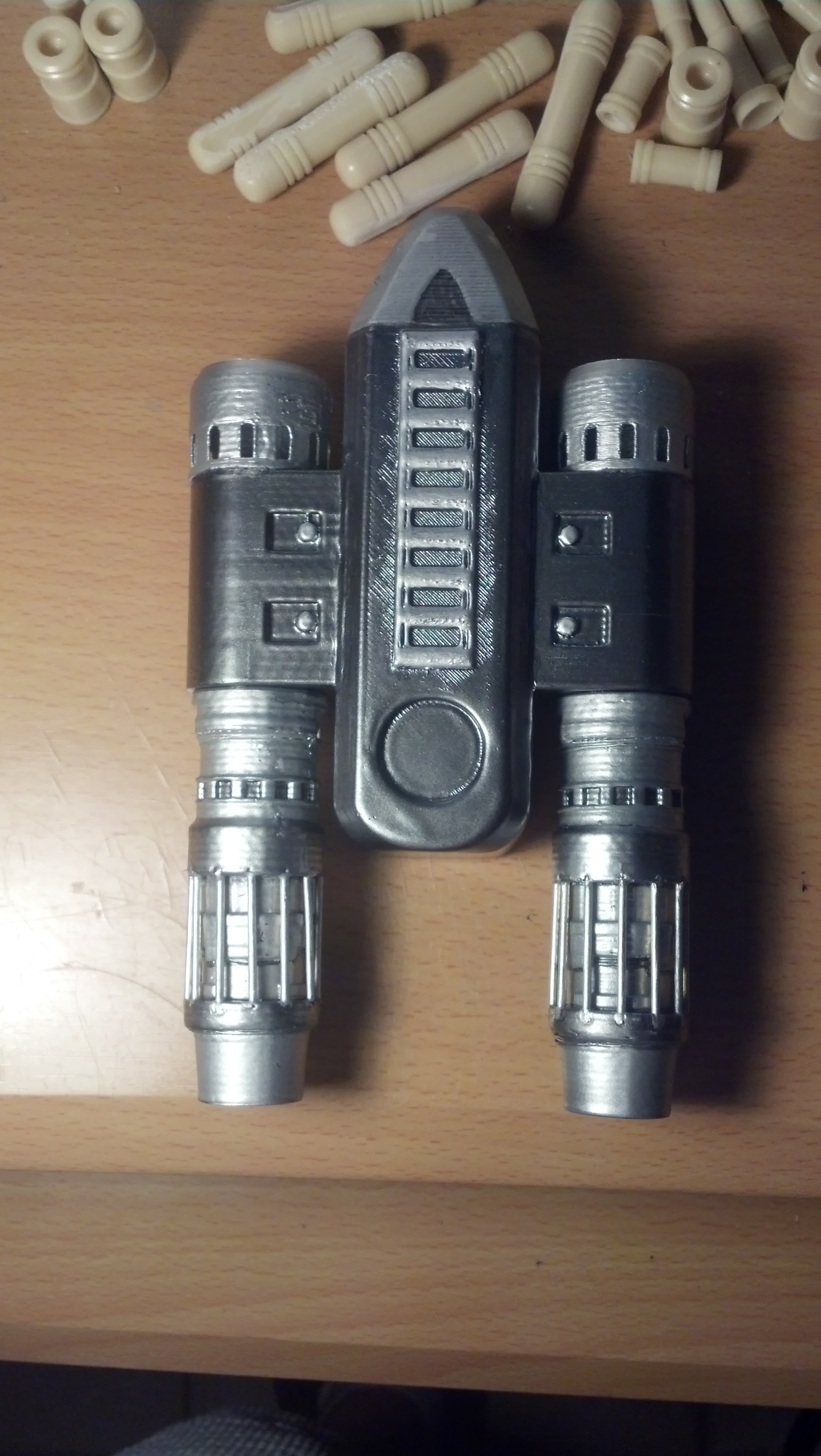

Its been a day or too since I posted progress because I have been working on it and keep forgetting to upload the pics I've taken :lol so here is what the past couple days and an all nighted have gotten me.

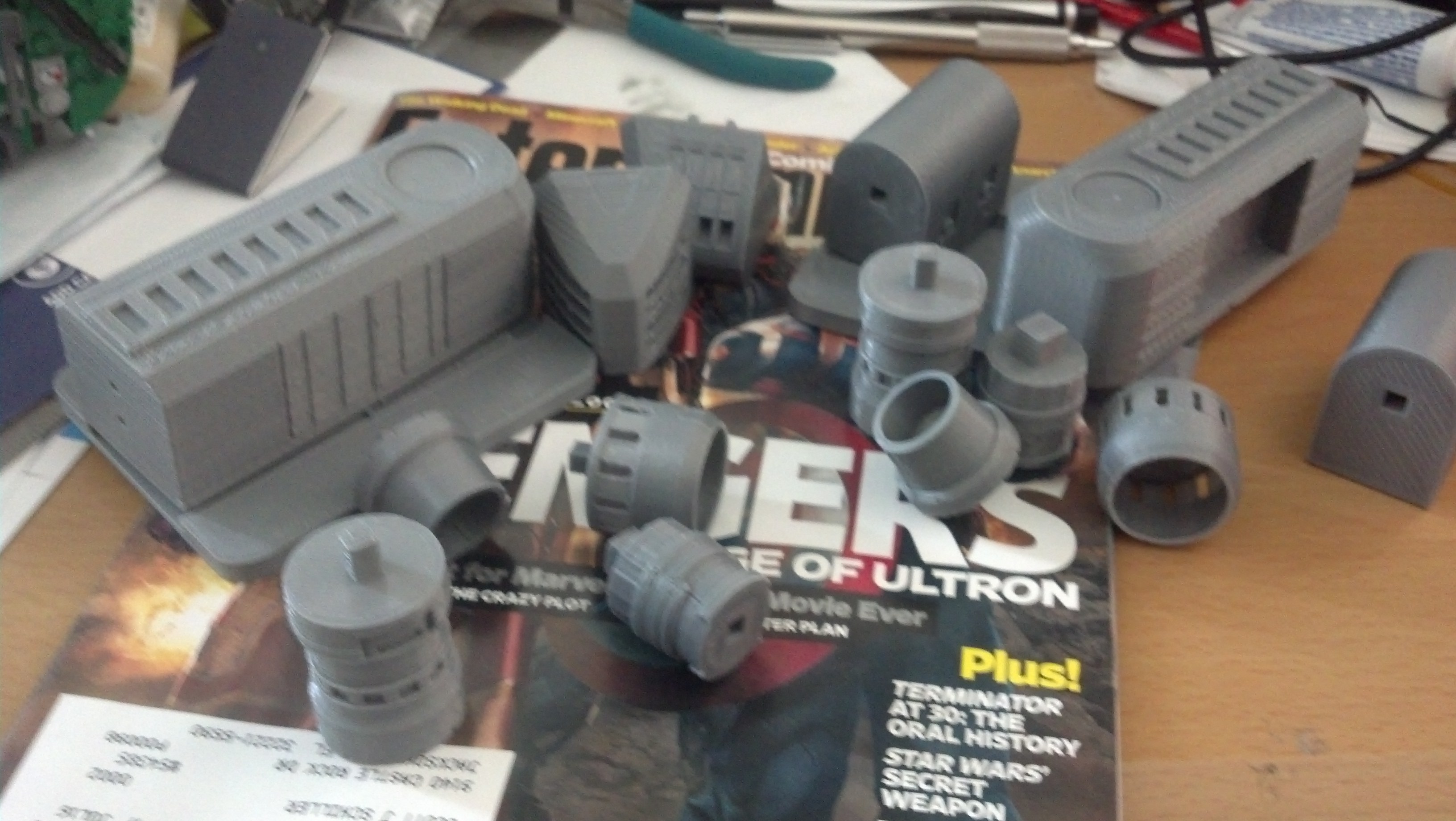

So to start I got the rest of the jet parts in the mail and acetoned them and started building them. I also finished the first one.
View attachment 354153View attachment 354154

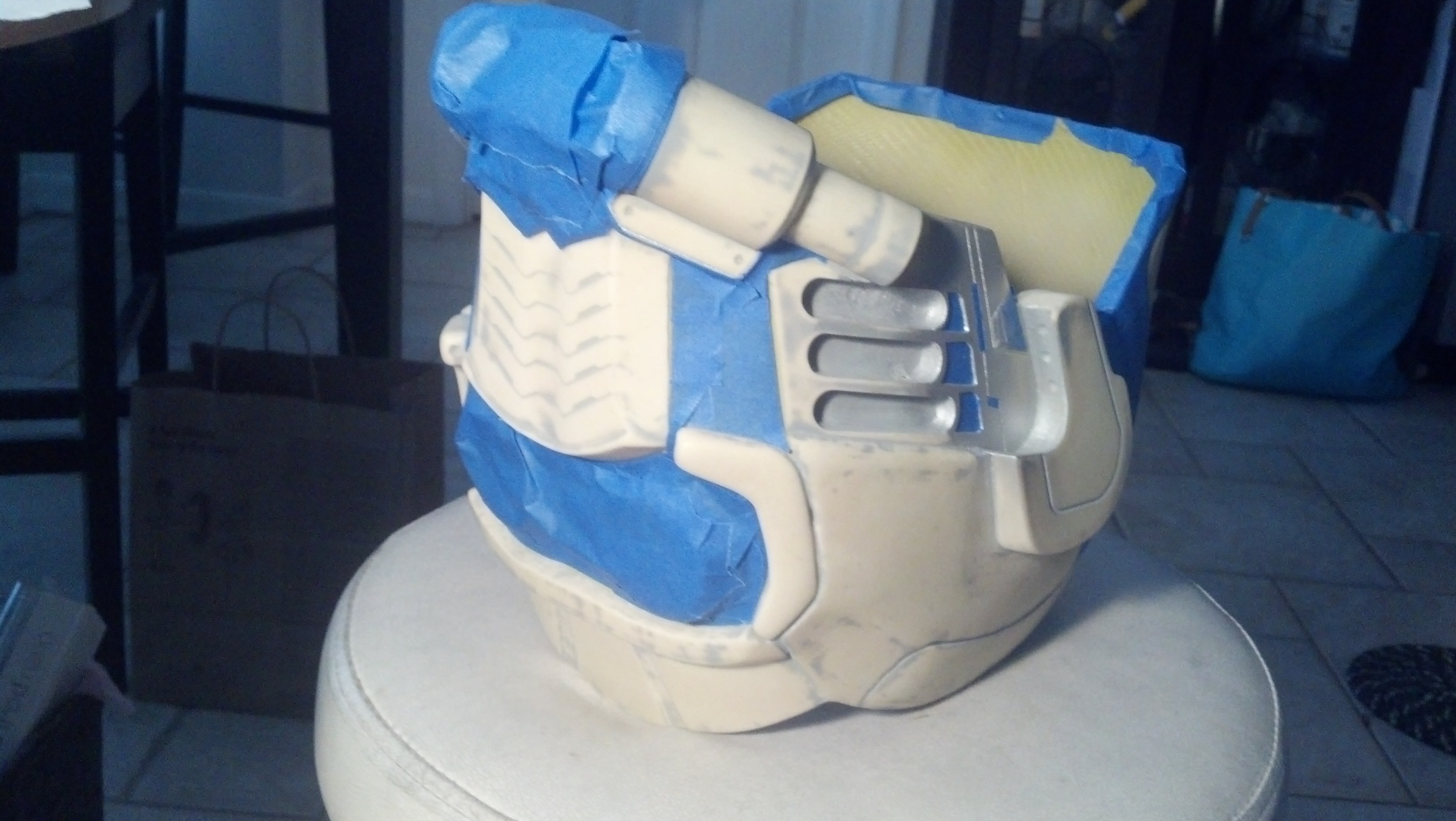

I also started painting the helmet and got a great color mix for the yellow.
Them painted the silver( flat aluminum)

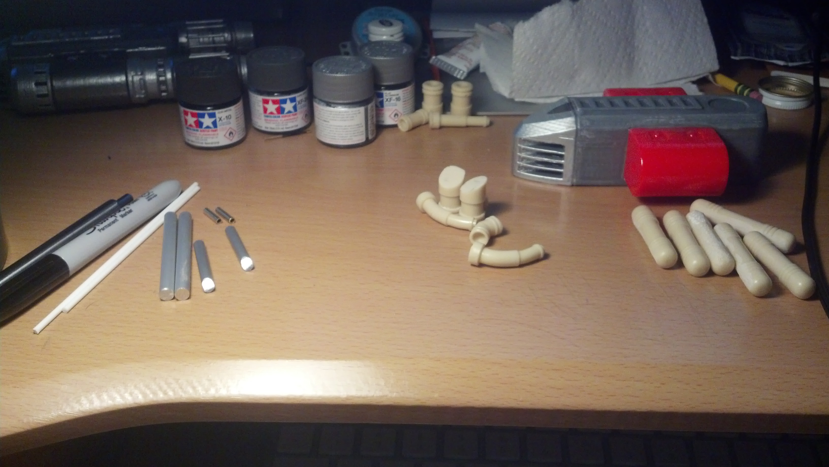

got all of the small detail parts ready.
View attachment 354157These things were a pain! I wondered why davy sent 2 sets of these small parts and I now understand why. I broke like three different ones. And I still had to use ca glue to fill cracks and gaps on the good ones.
So after a two hour tape job… I got something pretty great!
View attachment 354158View attachment 354159
It looks good but it still needs some touch up painting, the detail parts, lenses, lights, and padding. but I am really happy with it :D
I'll be finishing the last painting today and I'm going to let it cure for 24 hours and then apply an automotive clear coat.
What do you guys think?
