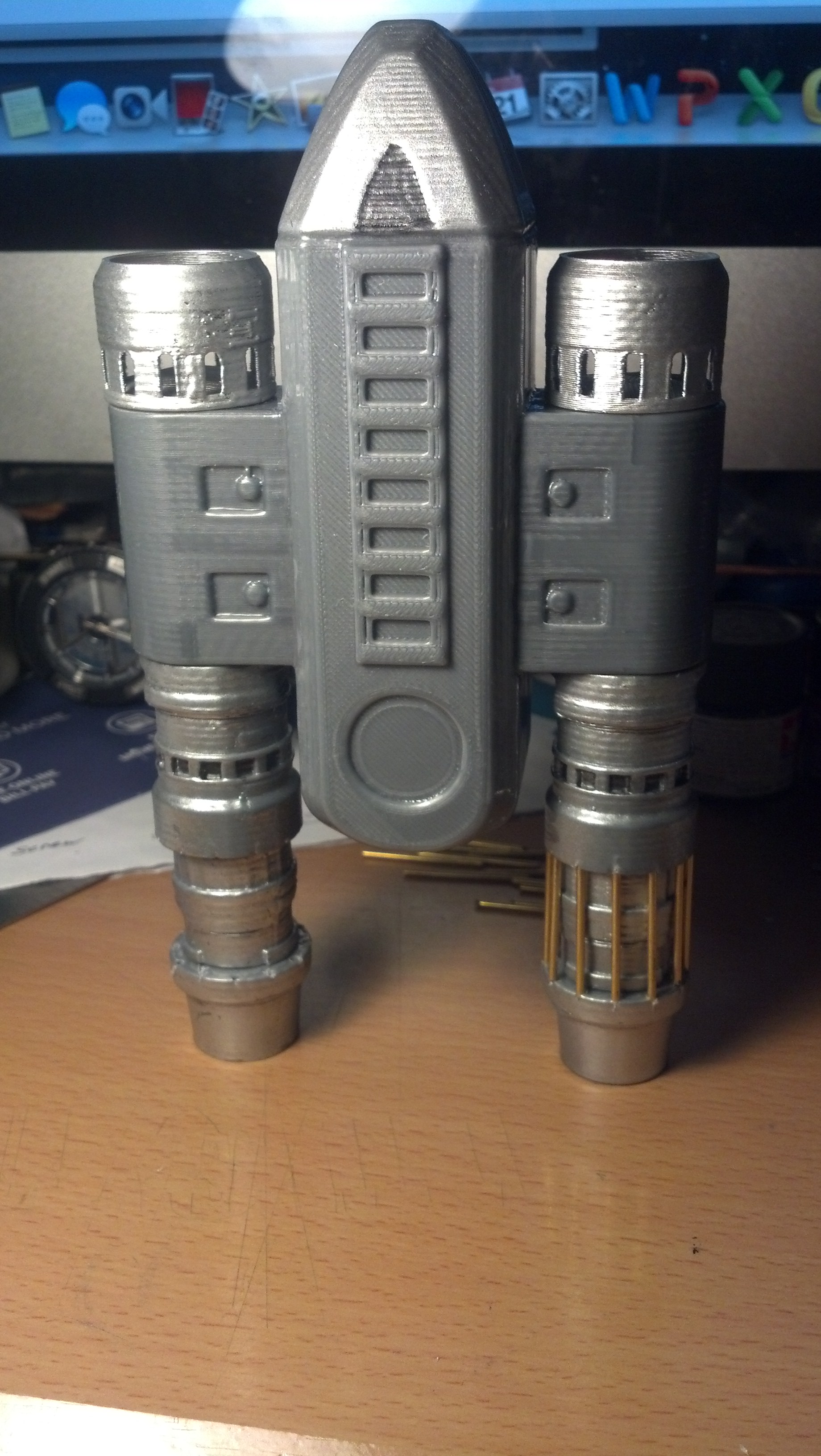

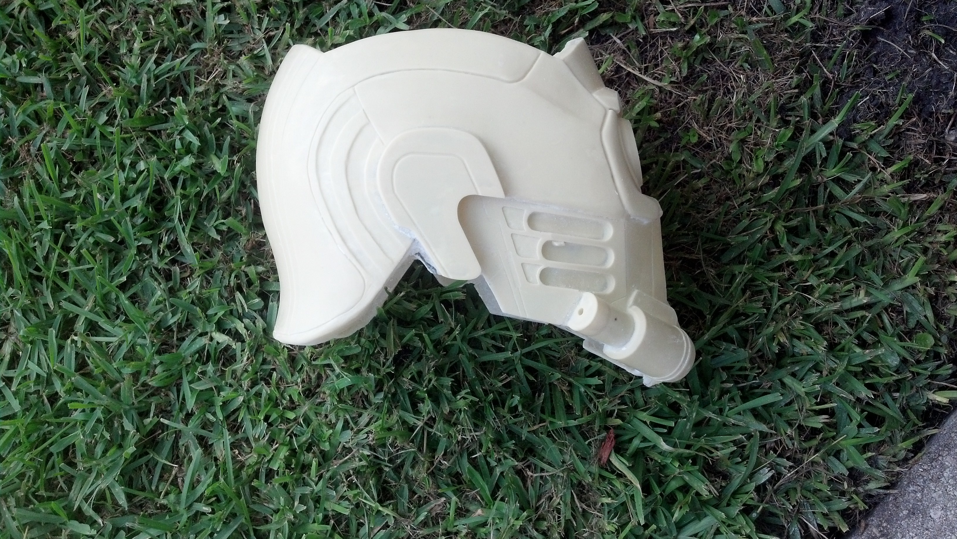

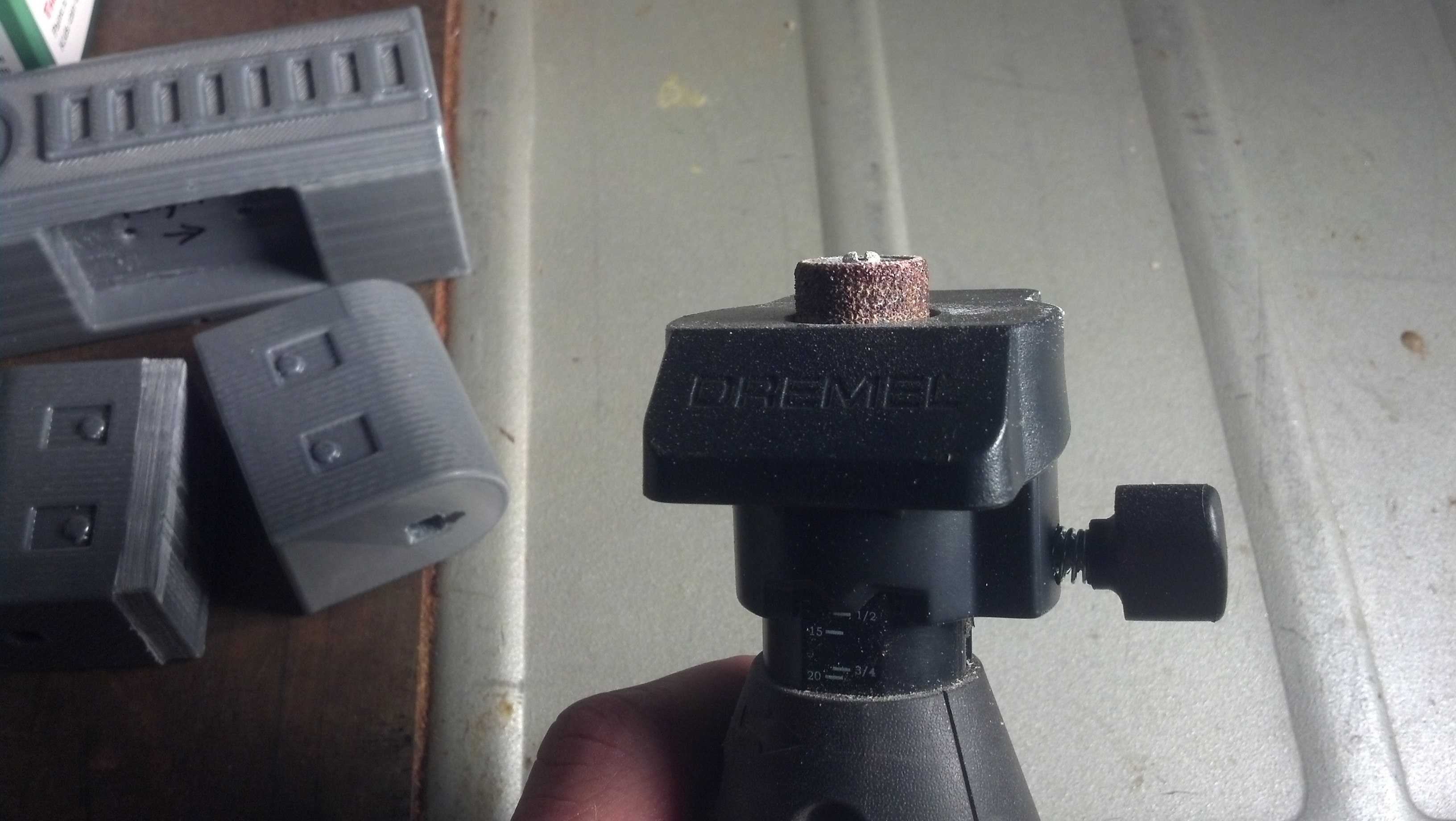

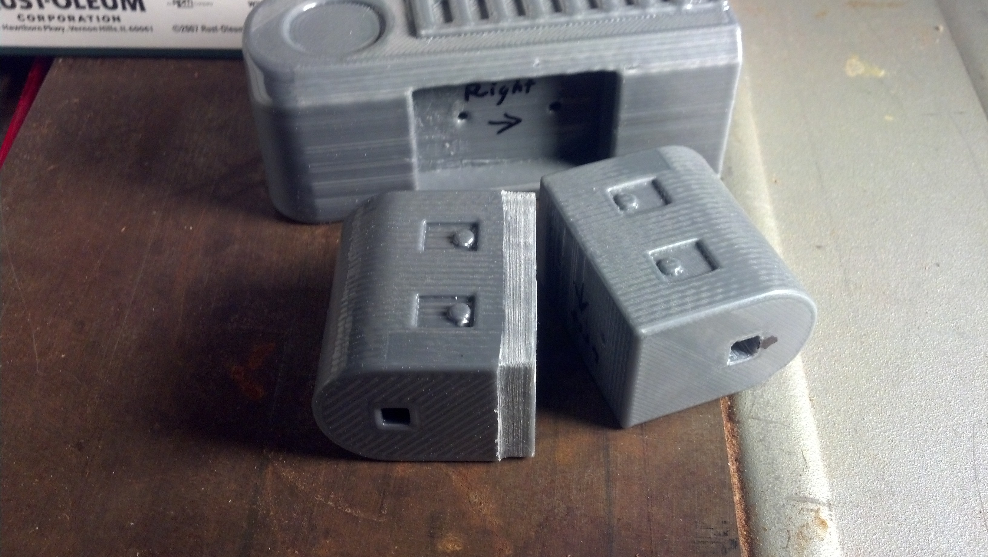

Since my air brush is out of order I figured I should get some other stuff done on the jets so I got the center pieces to fit properly. How I didn't think of using the dremel last night amazes me because when I started using that thing tonight on the parts things moved way quicker.

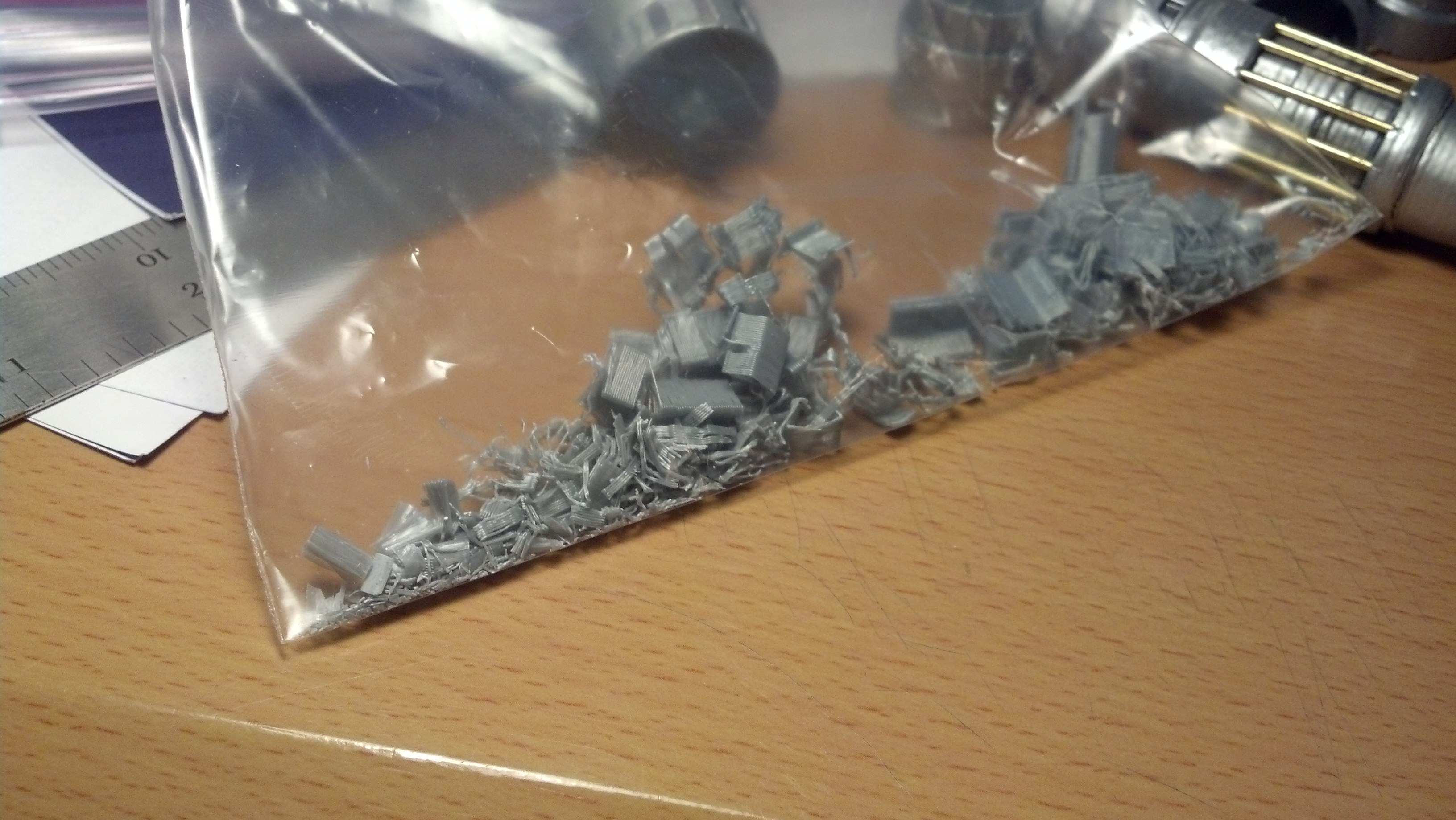

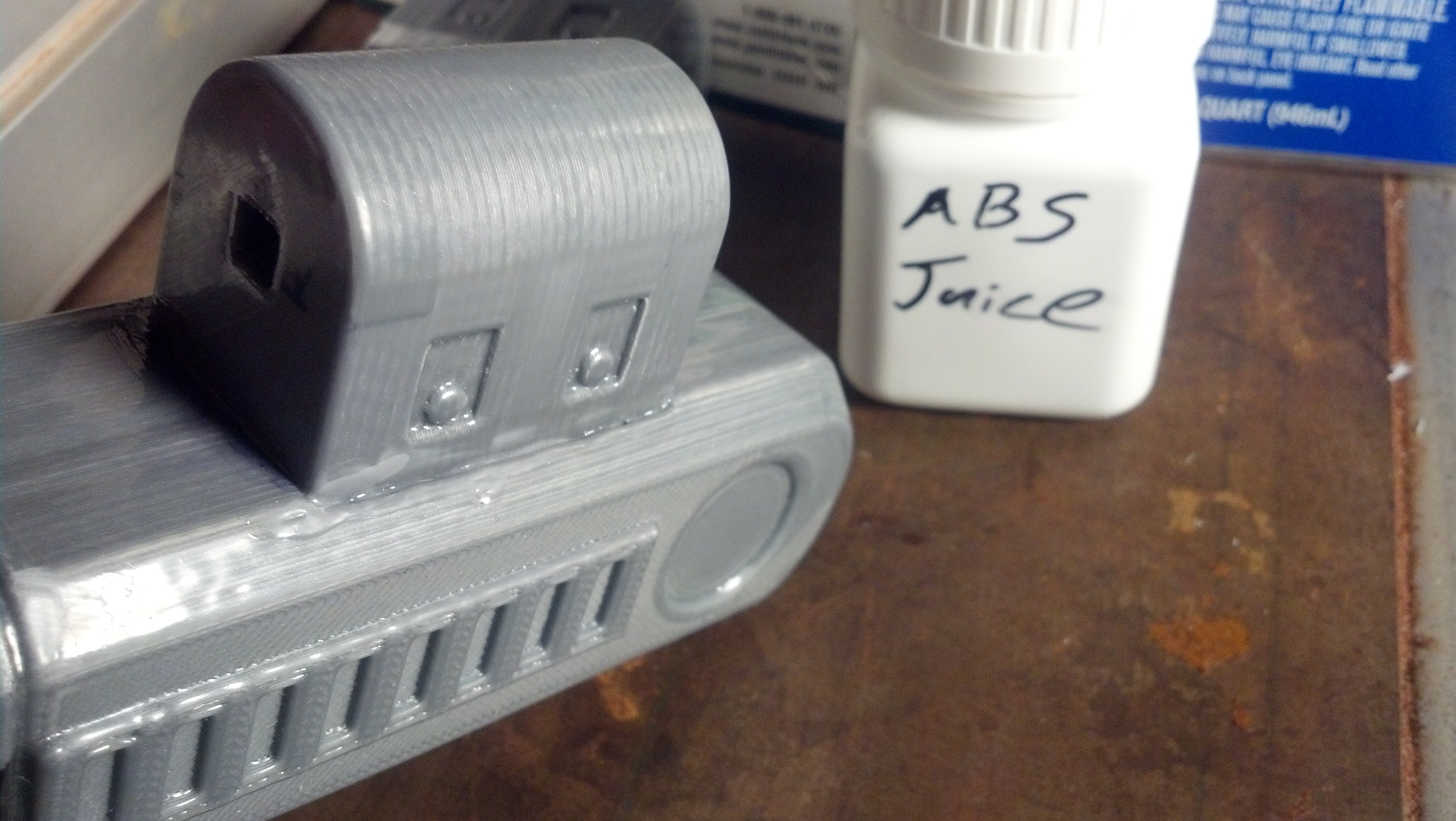

After both parts fit nice and snug I started thinking about the glue up. In videos I've seen on Youtube people were using action to chemically weld abs parts together. Thankfully I'm a bit of a pack rat and figured the support material and cut offs could be used for something like this so saved them in a bag and I had enough abs to made a acetone abs glue.
IMG_20140721_030246_219.jpgI put these bits into an old medicine bottle and poured it about a 1/3 of the way full with acetone and let it sit with the cap on for about an hour or two and the plastic dissolved. I got the parts of the main body together and used a small brush to quickly brush on the glue and then i pressed the parts together. The acetone melts both sides and bonds them together, so now its one piece. The cool thing about this abs juice glue stuff is it can be used to fill the small rounded areas/ gaps where the parts meet.
IMG_20140721_050213_445.jpgThis is definitely how I'm going to glue the hole piece together.
I got a lot done, but I can't move on till I get the air brush problem solved.

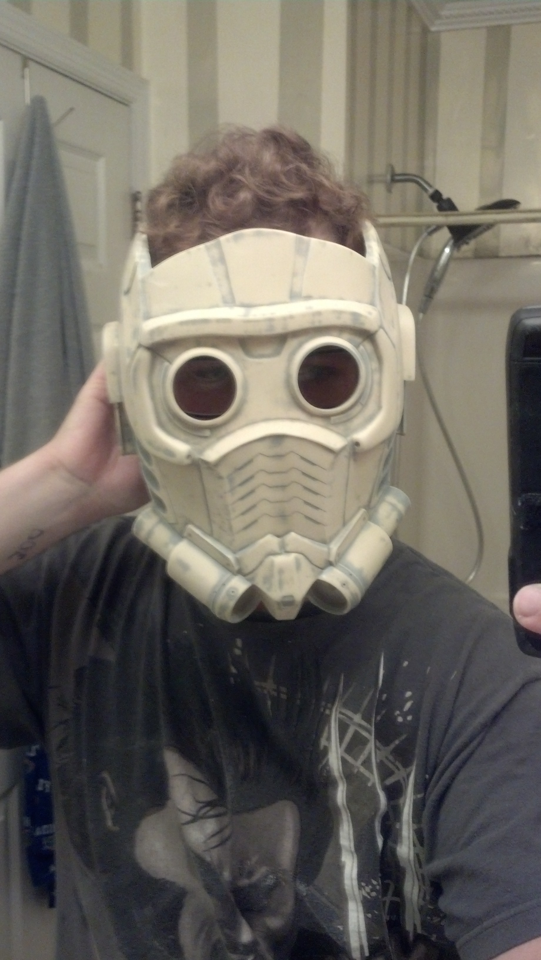

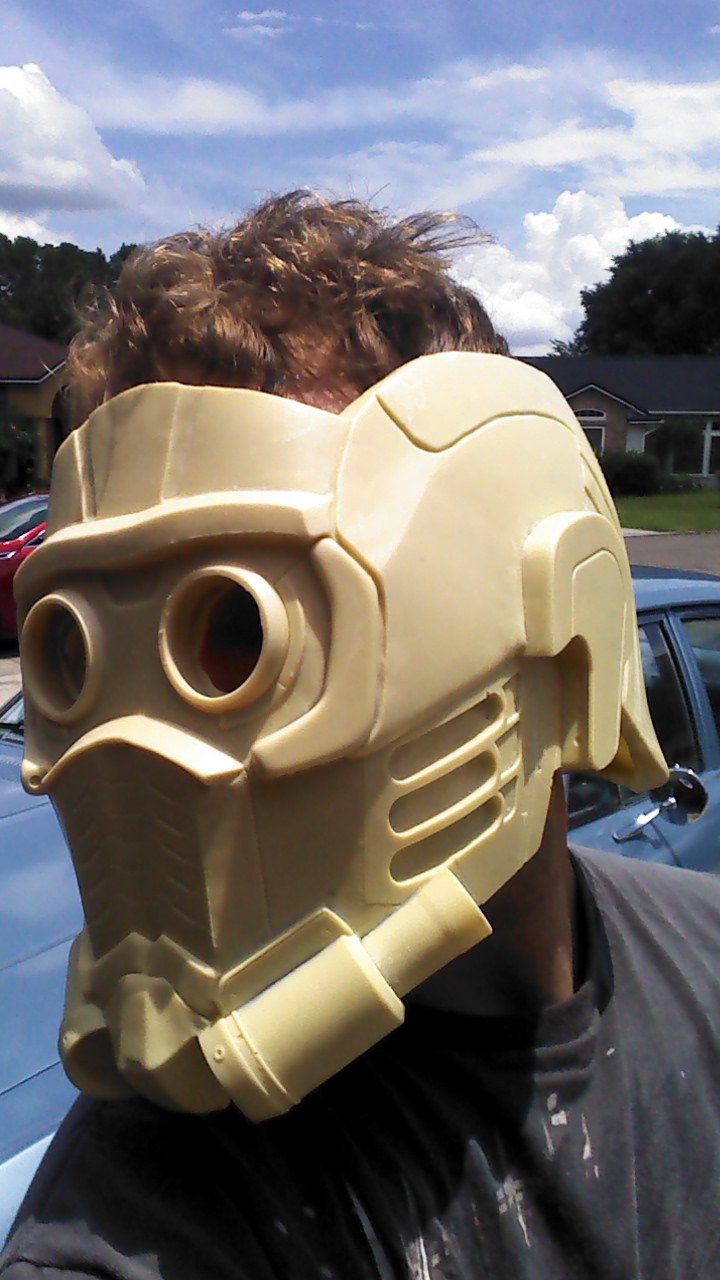

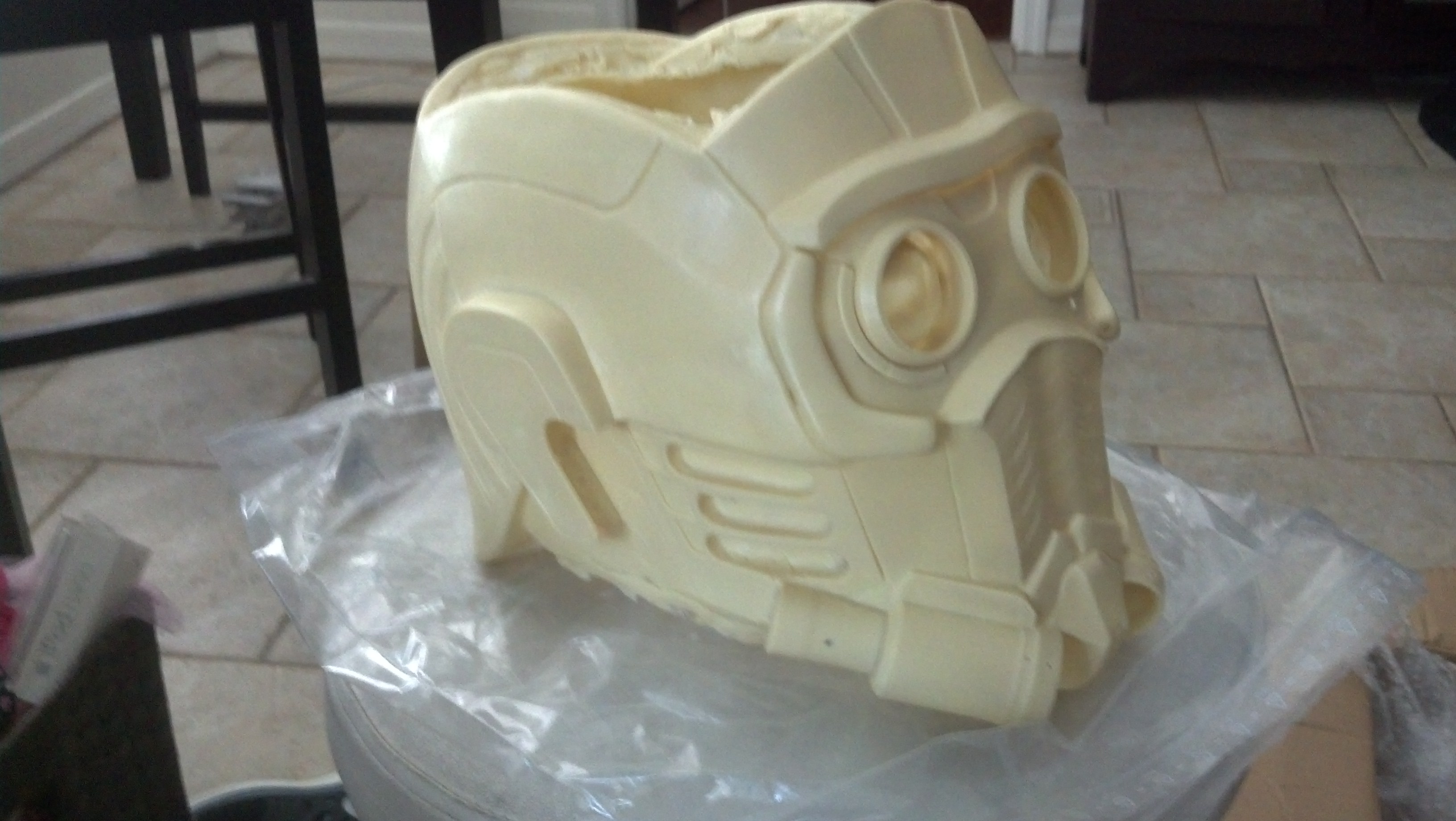

IMG_20140722_122246_862.jpgI got my Davy Helmet kit! I started working on it about five minutes after it was delivered :D

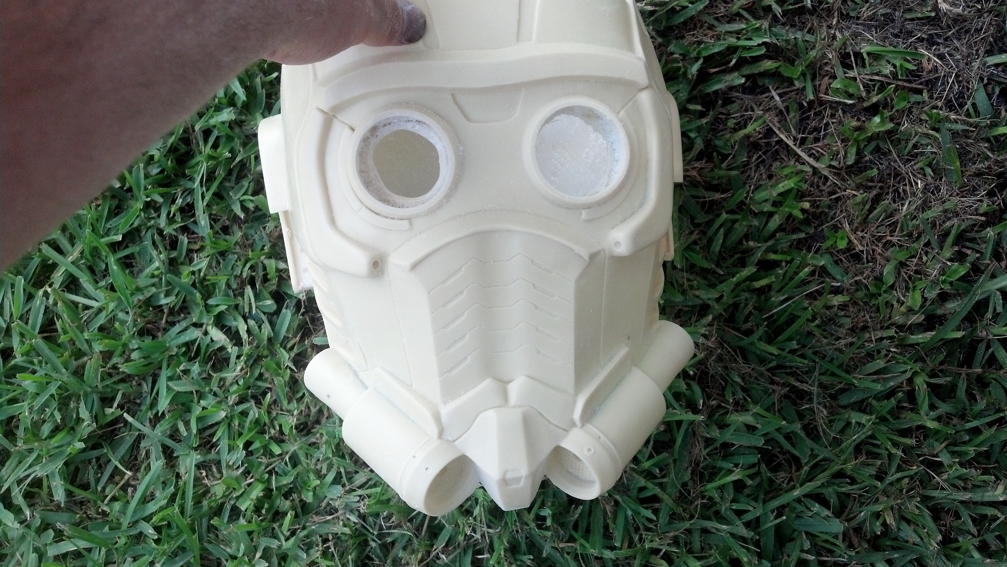

IMG_20140722_133240_241.jpgIMG_20140722_133245_908.jpgI started cutting the excess off with a dremel and got good results. The toughest thing to cut was the space in the ear section. To cut out the eyes I used a sanding wheel on the dremel and it worked awesome. The dust was really annoying, I'm glad I had a air compressor near by because the dust made it hard to see the lines I needed to cut so I used some air to blow it off every once and a while.
Now that I have all of the cutting and edge sanding done and it fits good I need to figure out where all the little parts of this kit go:unsure
All and all it will need a small amount of foam on the inside to get a really good fit, I'm just happy I can were my glasses inside of it, although it will only do so much since with the lenses visibility is almost nonexistent and will probably get worse with L.E.D.s.

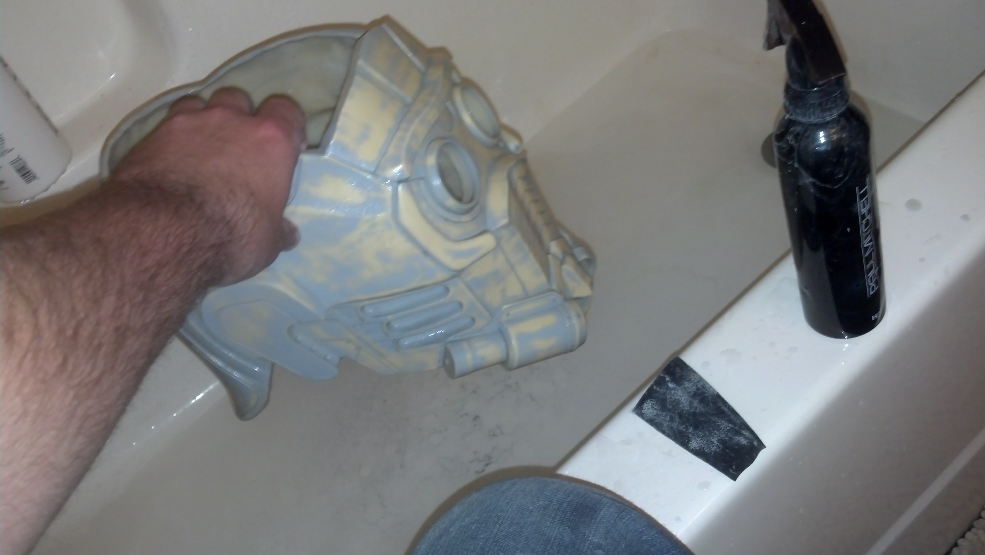

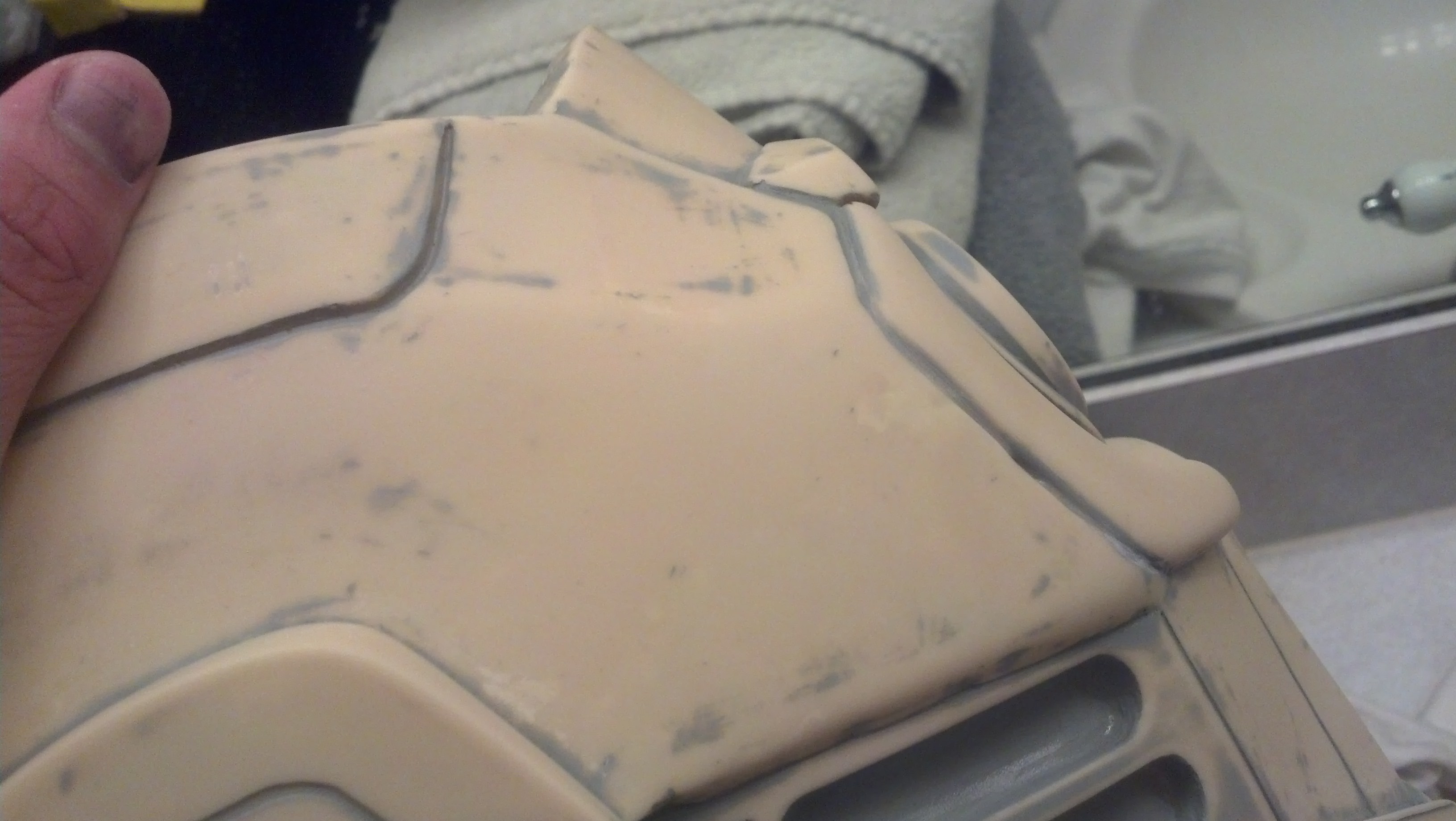

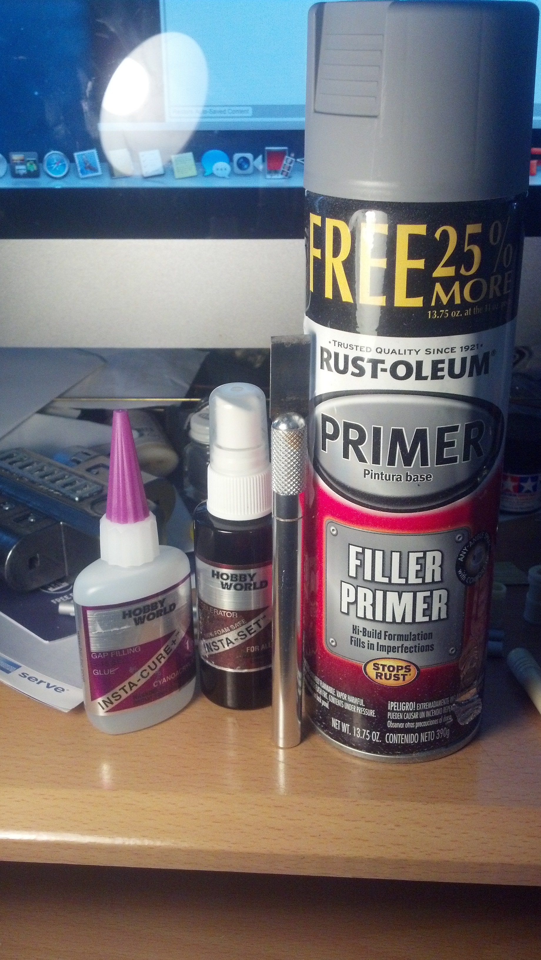

I did pit filling with CA glue and a flat hobby blade then painted with a filler primer.

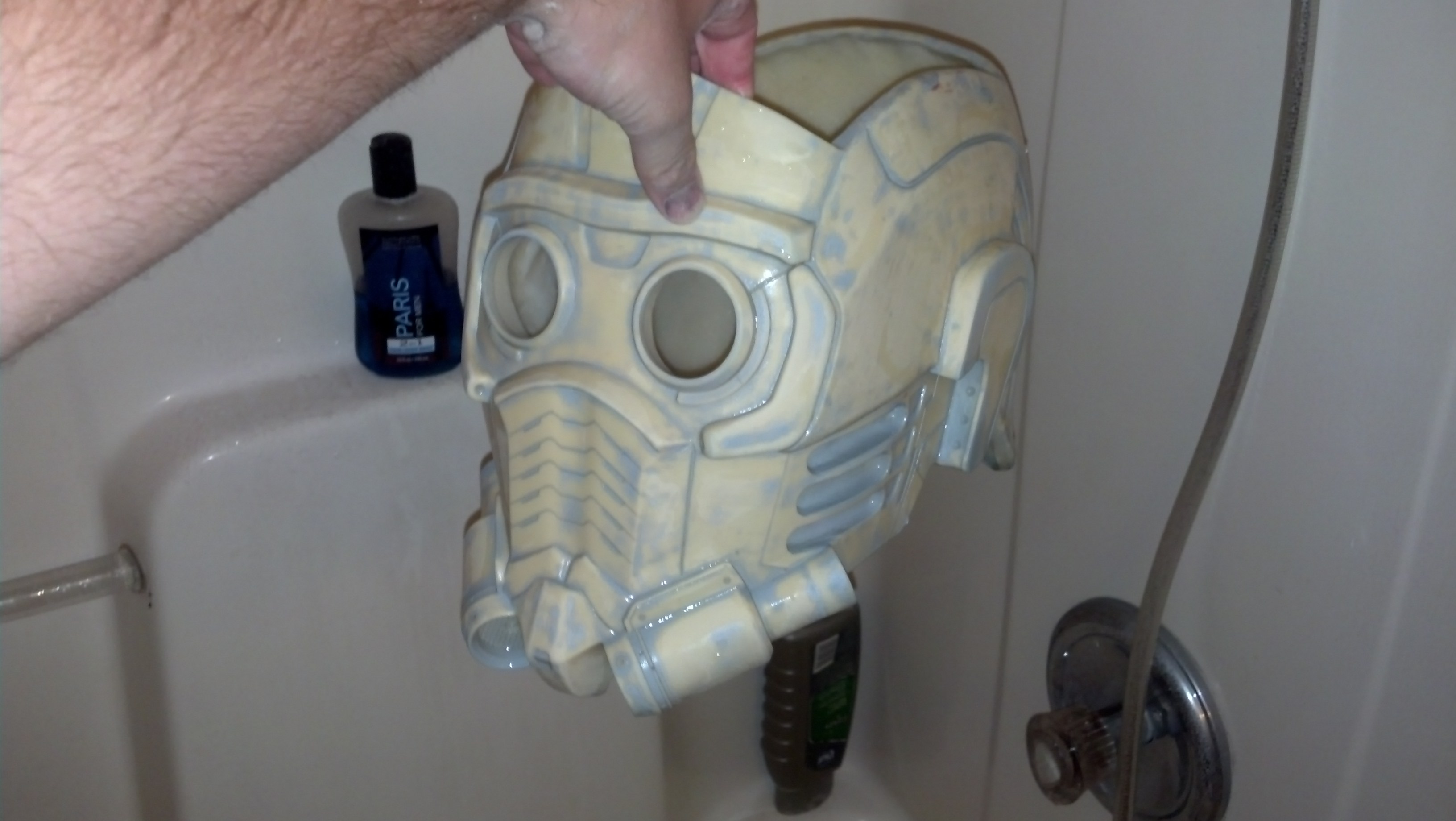

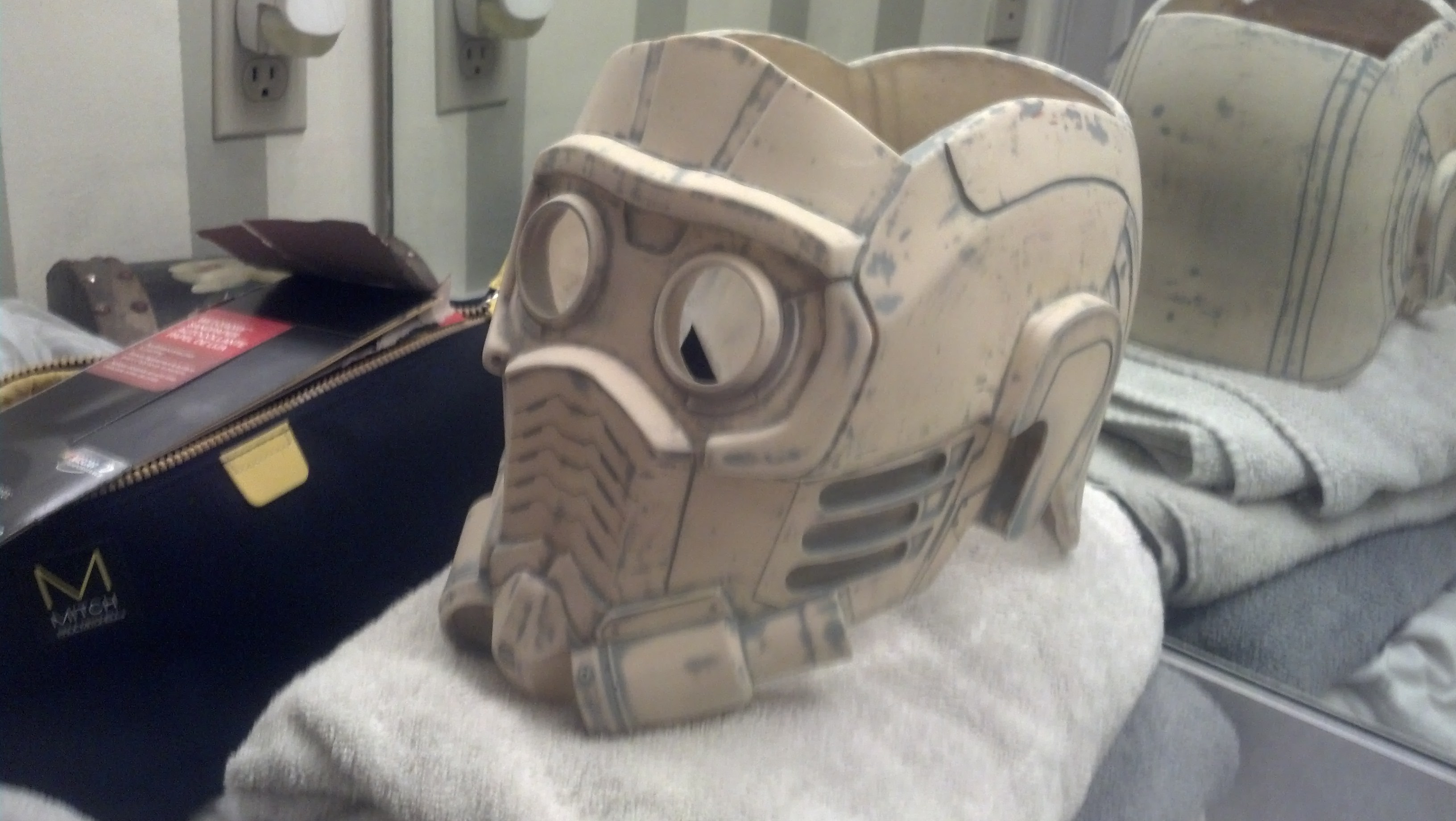

IMG_20140723_110914_949.jpgAfter the primer dried I started sanding.

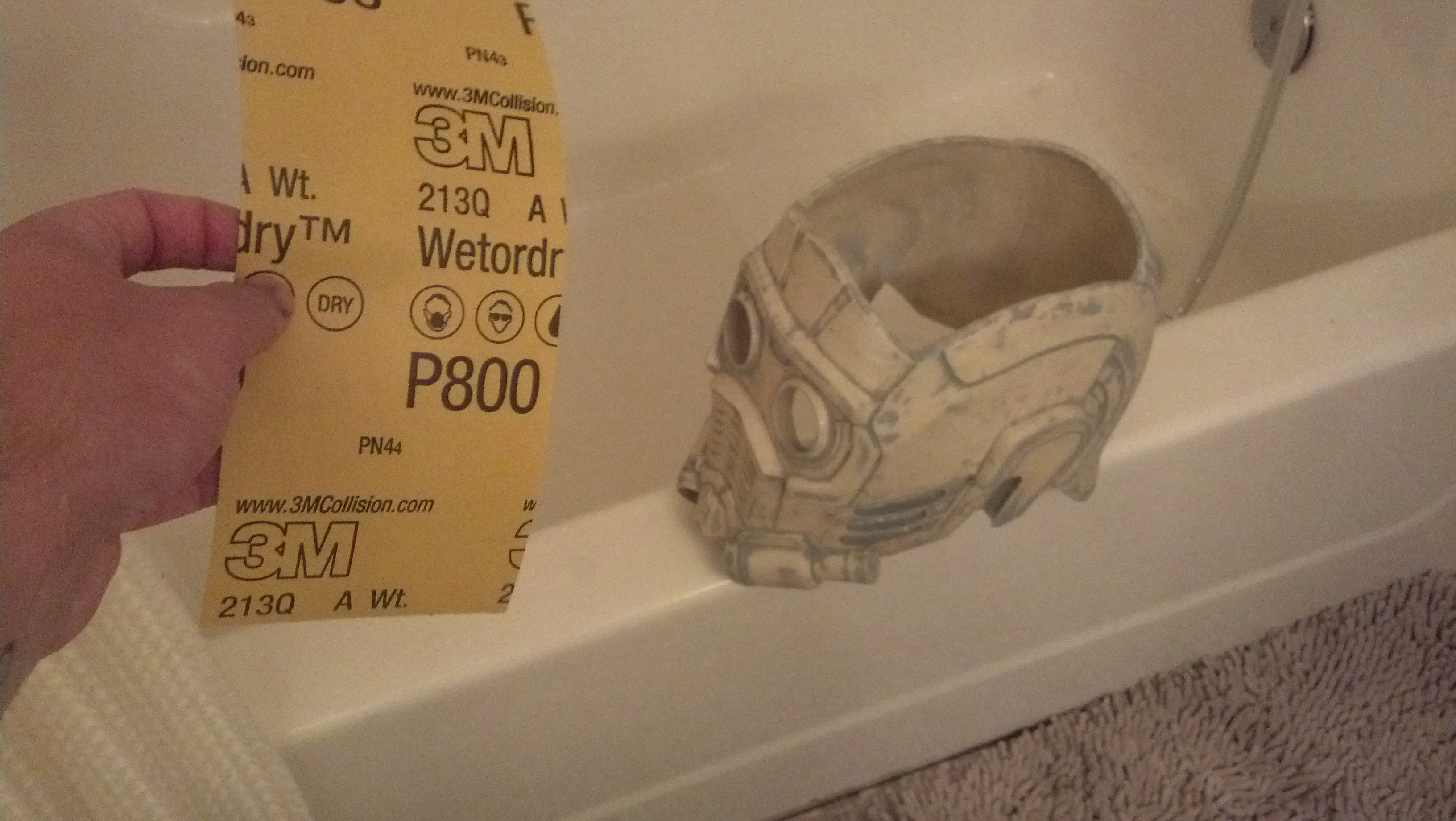

I started with a dry 220 grit and got all the rough surface of then started wet sanding.

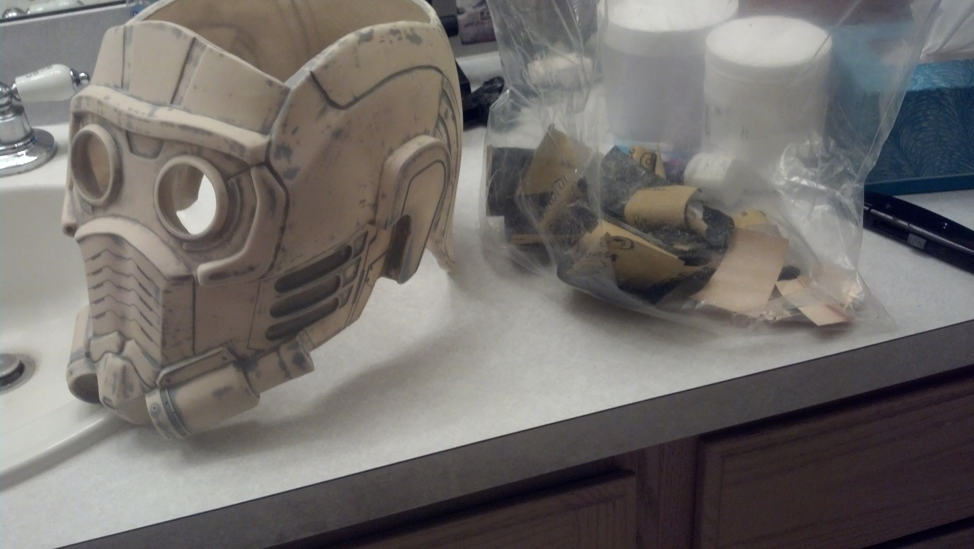

The sanding when as follows.
Started with a quick wet 220, moved to 320, 400, and I went up to 800.
IMG_20140723_244825_139.jpgIt took something like 2-3 hours of sanding to get the final finish.
I used a lot of sandpaper...:lol
The finish turned out great and I'll get more paint in the next few days to paint it. In the mean time I'll get all the little bits prepped and finish up the jets.IMG_20140723_013620_897.jpgIMG_20140723_013541_726.jpg

View attachment 352143I got my Davy Helmet kit! I started working on it about five minutes after it was delivered :D
View attachment 352141View attachment 352142I started cutting the excess off with a dremel and got good results. The toughest thing to cut was the space in the ear section. To cut out the eyes I used a sanding wheel on the dremel and it worked awesome. The dust was really annoying, I'm glad I had a air compressor near by because the dust made it hard to see the lines I needed to cut so I used some air to blow it off every once and a while.
View attachment 352144View attachment 352145There are going to be a few all-nighters in my future with this thing :lol

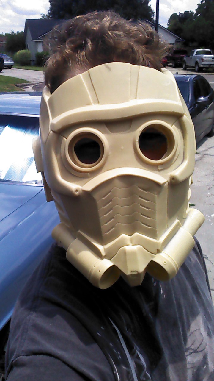

How did you find the fit? What size is your melon?
I though the fit was good, it will need a little bit of foam but all helmets do. and my head is 22.5 inches (57.15 centimeters) in circumference.
