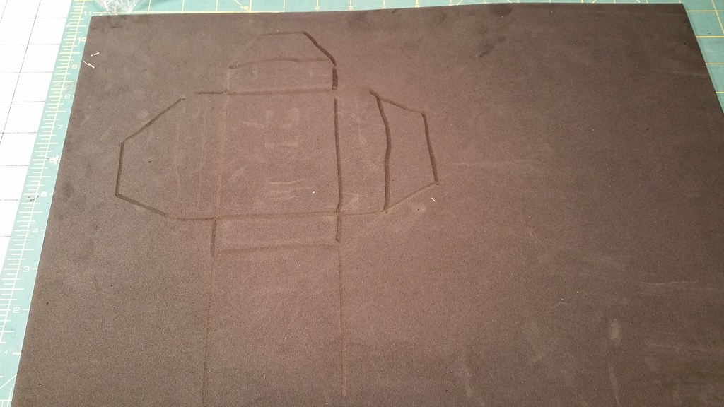

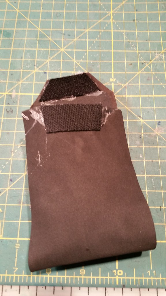

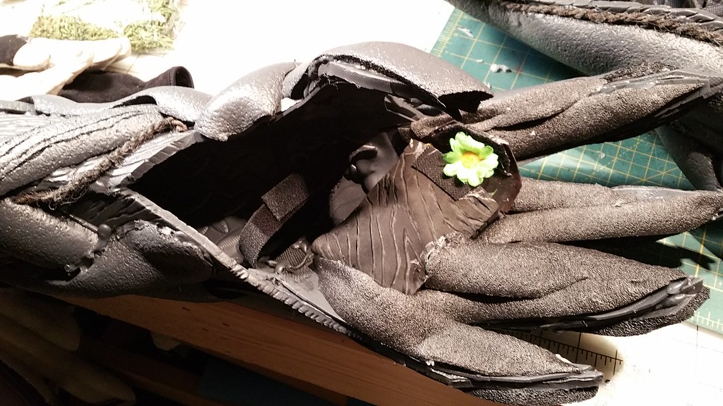

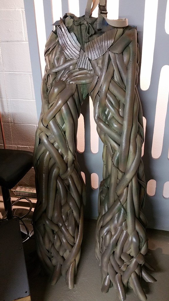

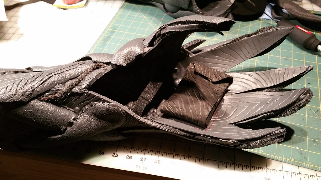

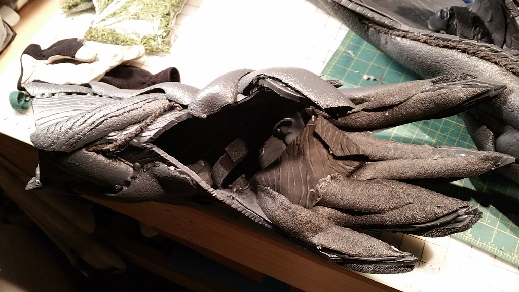

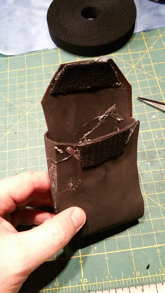

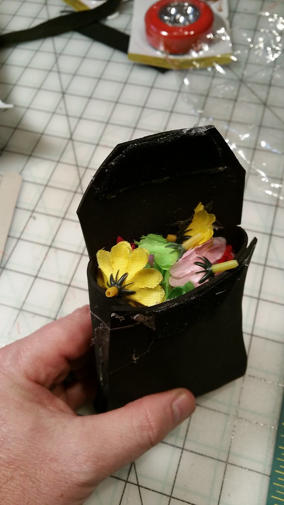

I have mentioned before (in other threads) that I do appearances with a group of cosplayers in the Western New York (Buffalo, NY) area for charity. Since I know that I will eventually be interacting with children, I wanted to add a bit of a wow factor. To achieve that I added a small pouch made of 2mm craft foam. Within this pouch I can store up to 50 mini flowers. This will allow me to hand them out as Groot did when he interacted with the little girl in the film.

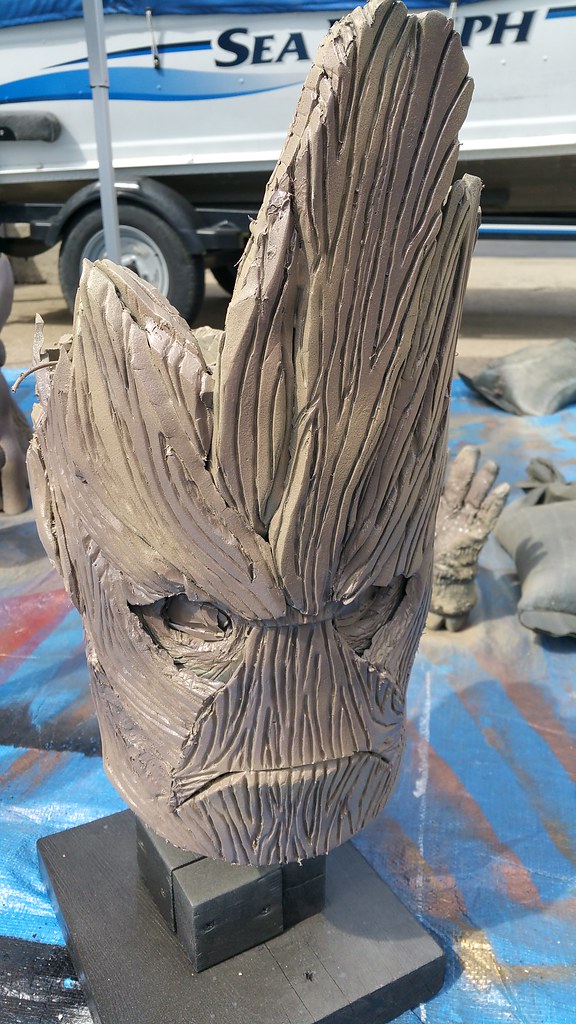

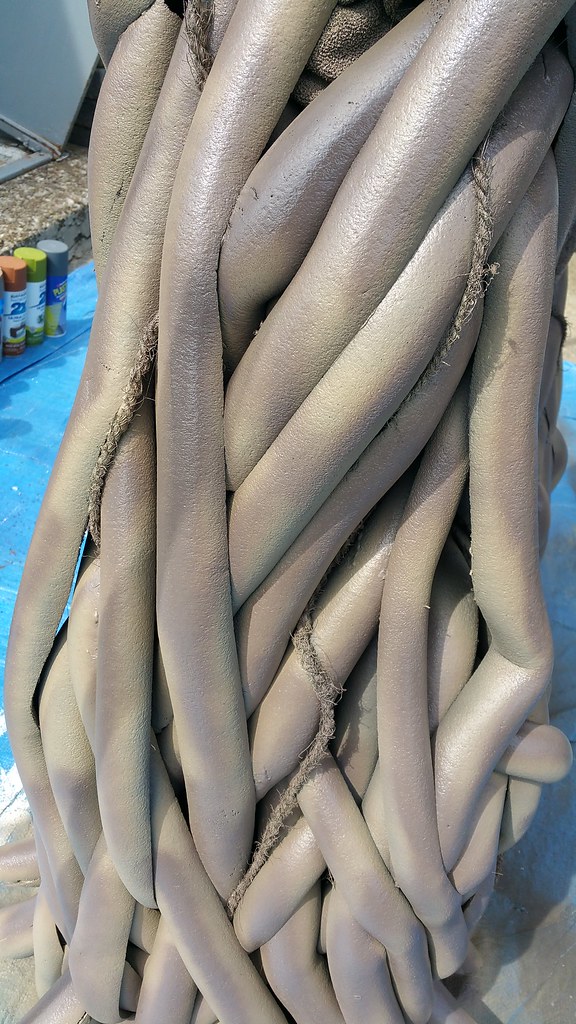

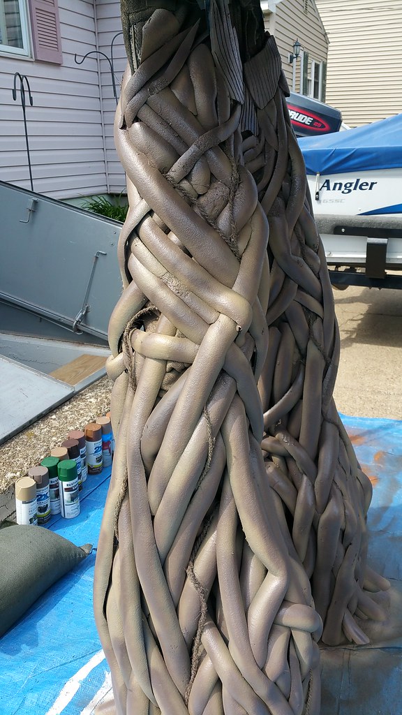

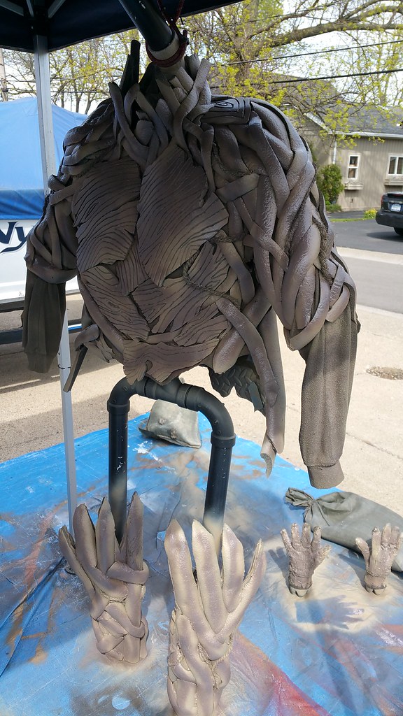

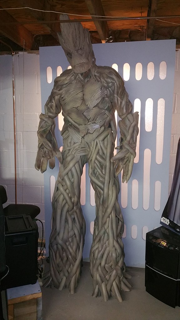

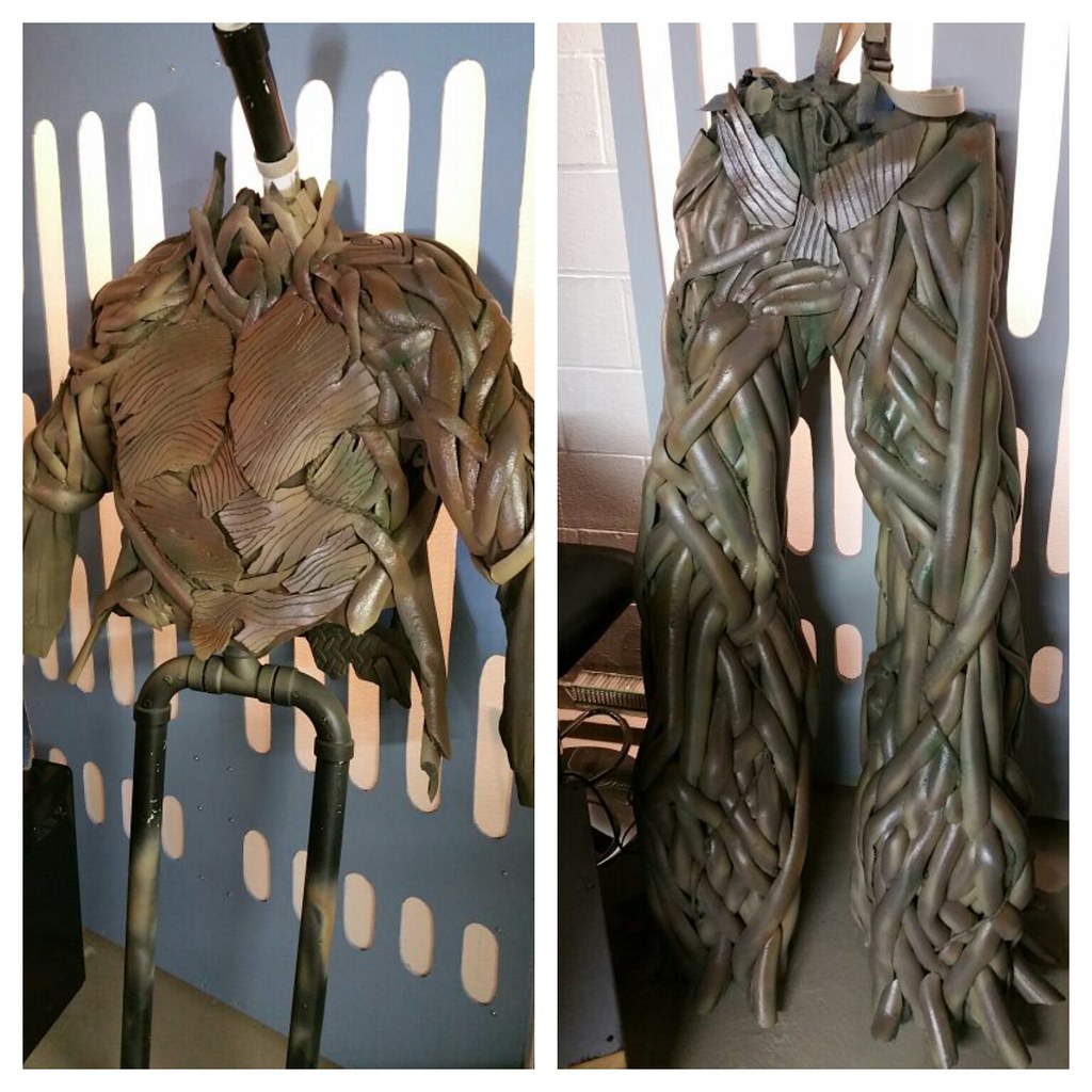

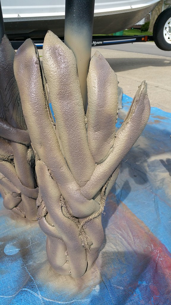

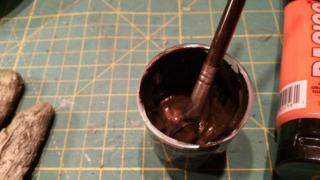

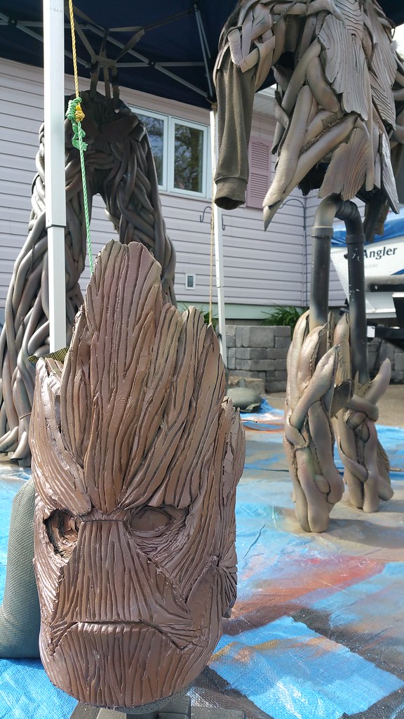

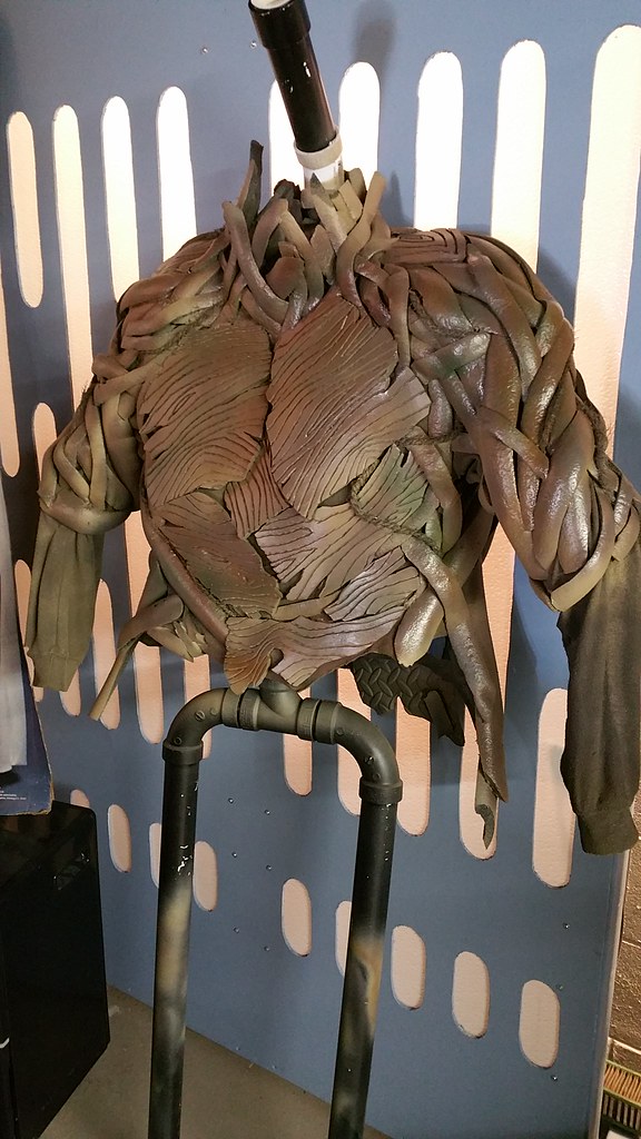

BobbyFromBUF

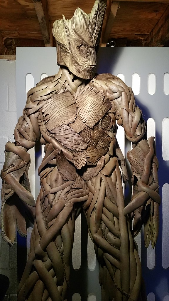

Okay, back to paint. I'm sure that I used an overabundance of paint. However, I am happy with the final look. So, maybe it was all worth it. My advice is to be more efficient. I would recommend using darker colors first, and then finishing with a light tan color. Also, use paints with shiney finishes first, and use a Matte or Flat finish last. Groot is organic, and really shouldn't look shiny....

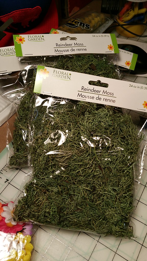

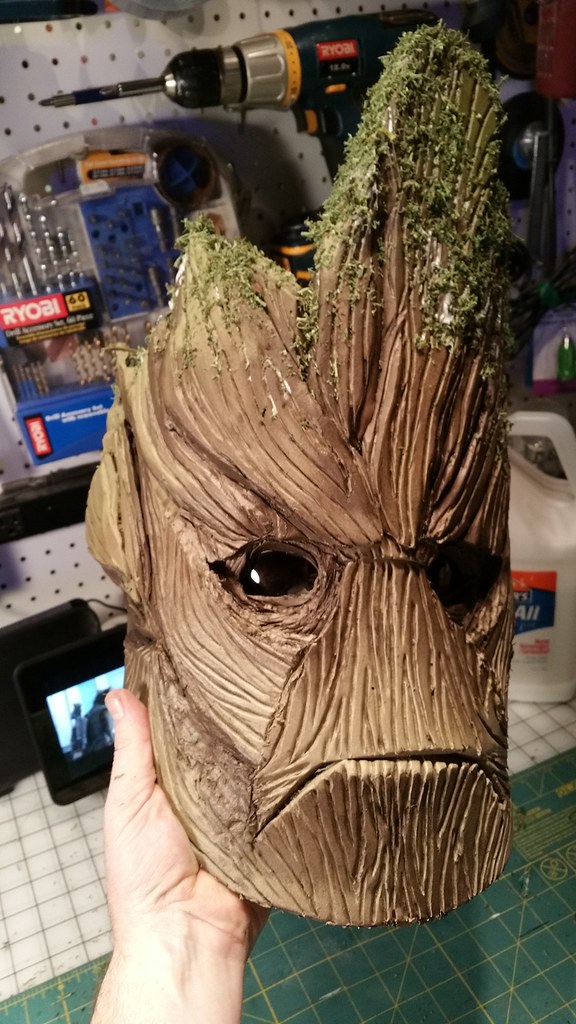

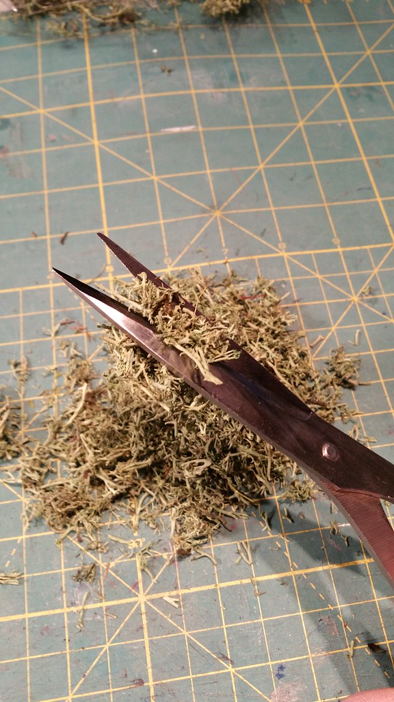

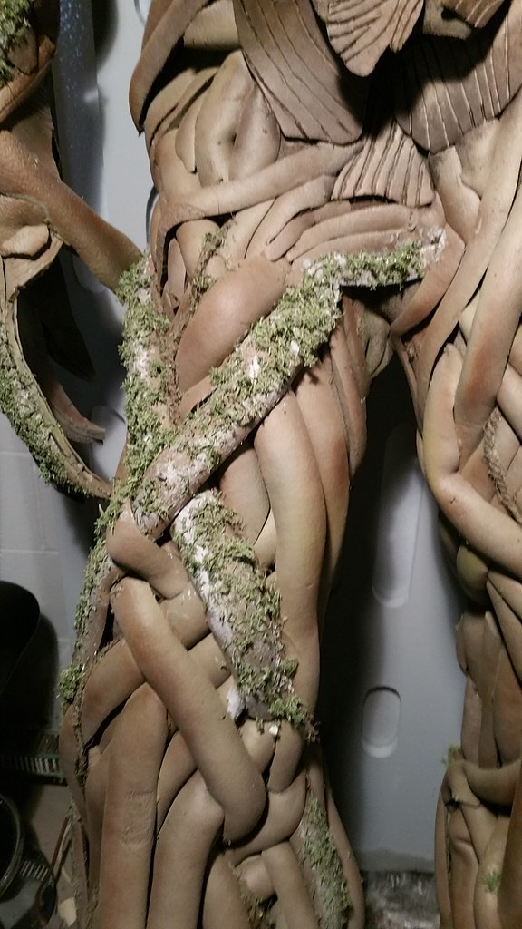

After the paint was complete I wanted to add some moss. Dollar Tree sells small bags of "Reindeer Moss" for $1. I ended up using a total of 5 bags.
20160517_125042 by Robert Whalen, on Flickr

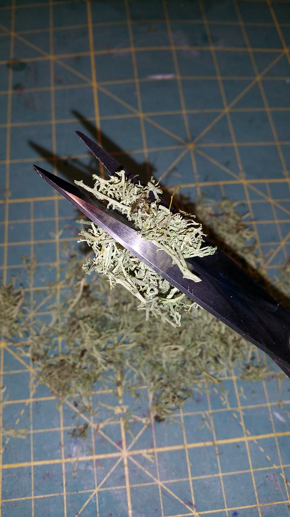

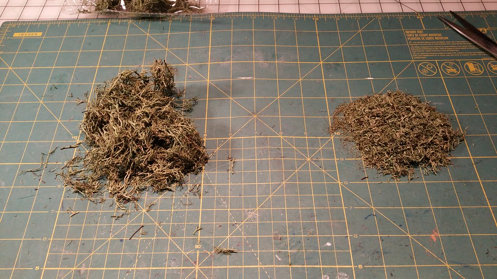

The moss comes out of the package a little bit bigger than I would prefer, so I used a pair of scissors and just kept clipping through the bunch until the pieces were much smaller.
20160519_172527 by Robert Whalen, on Flickr
20160519_172536 by Robert Whalen, on Flickr
The bit on the left is straight out of the package. The bit on the right is after chopping it.
20160519_211856 by Robert Whalen, on Flickr

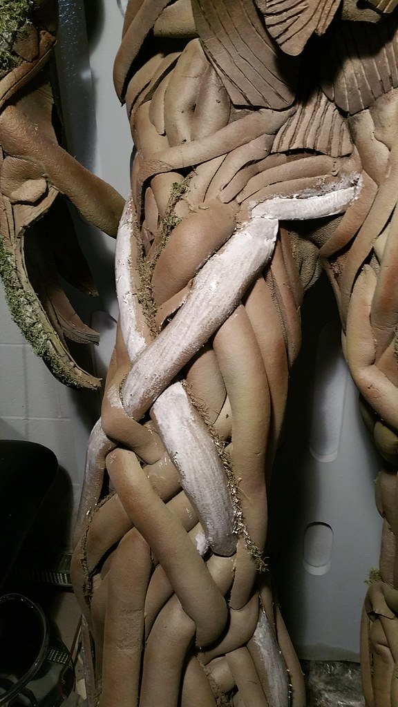

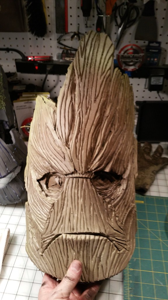

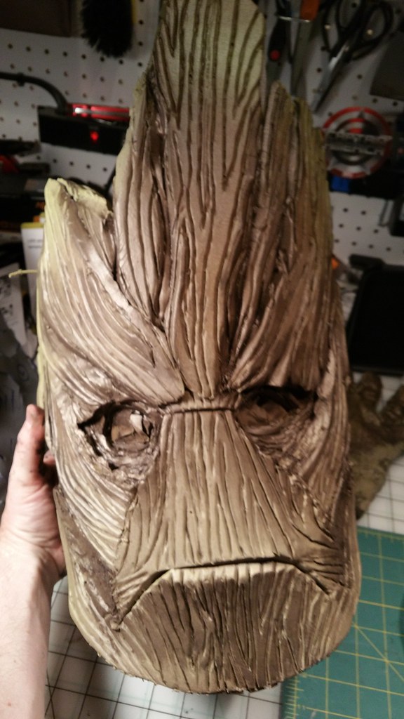

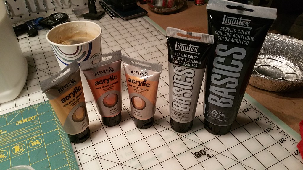

Before I could begin applying the moss, I needed to just touch up the paint on the face and bark to bring out some of the depth even more. I just mixed up some acrylic paints I had laying around until I achieved a sort of brownish/rust color.
20160519_223405 by Robert Whalen, on Flickr
20160519_223408 by Robert Whalen, on Flickr

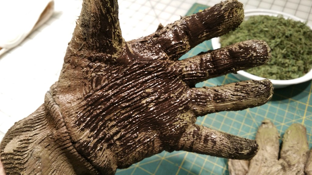

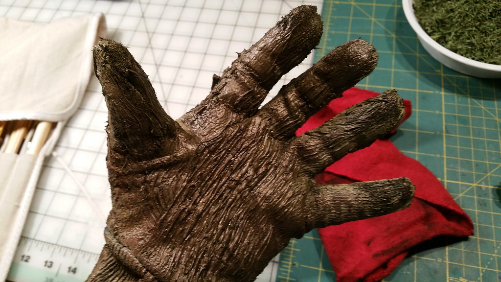

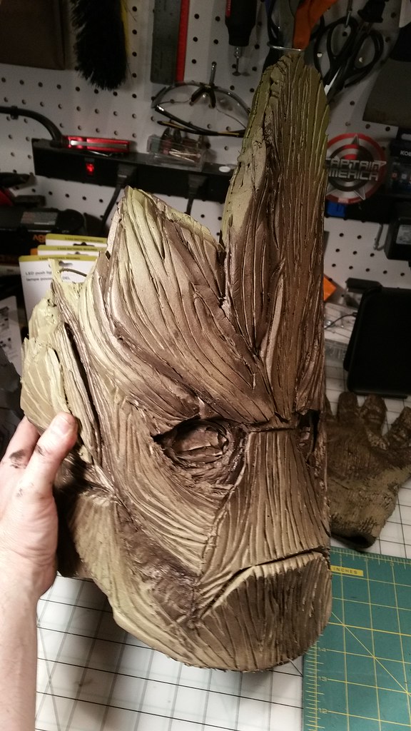

I then used a weathering technique I learned when building my Mandalorian. You paint on the the acrylic paint, and then immediately wipe off as much as possible with a rag. The part that gets left behind is the weathering.
20160519_223419 by Robert Whalen, on Flickr
20160519_223504 by Robert Whalen, on Flickr
20160519_223543 by Robert Whalen, on Flickr

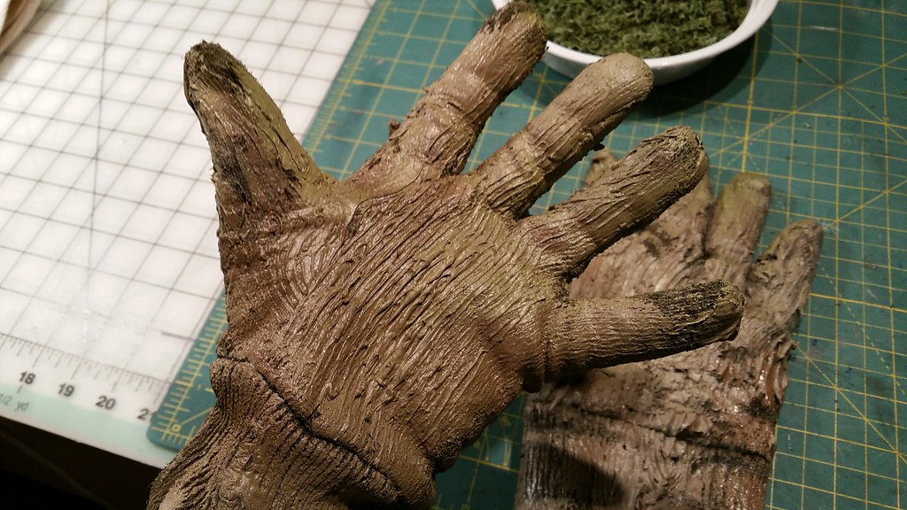

Before...
20160519_224052 by Robert Whalen, on Flickr
After...
20160519_225130 by Robert Whalen, on Flickr
20160519_225135 by Robert Whalen, on Flickr
20160519_231814 by Robert Whalen, on Flickr

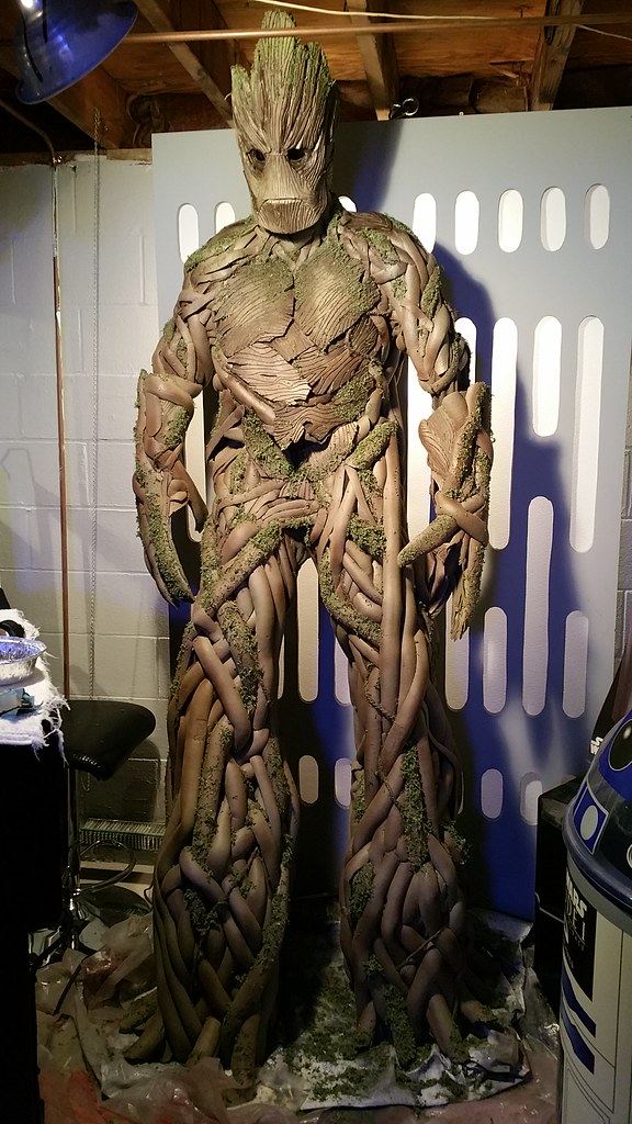

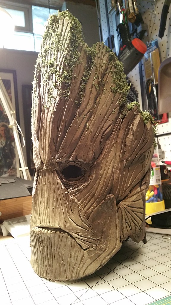

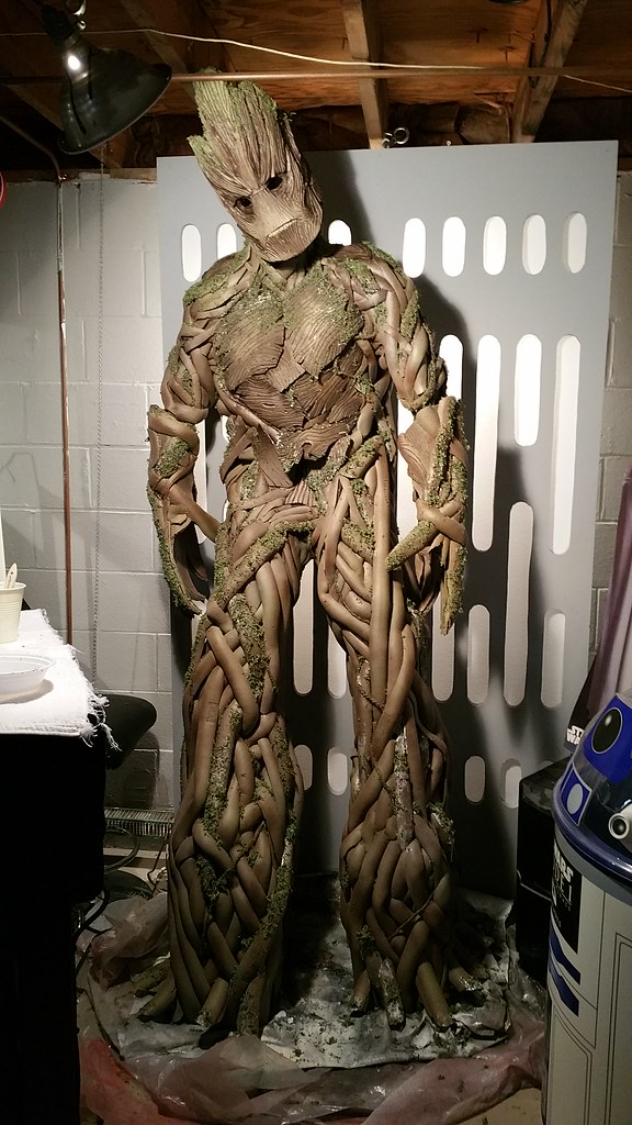

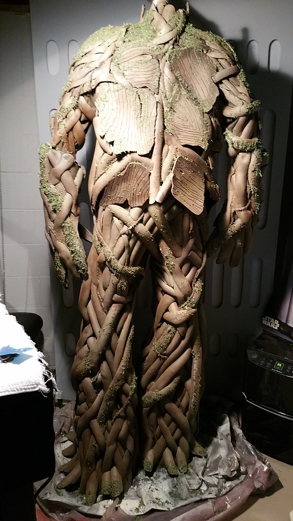

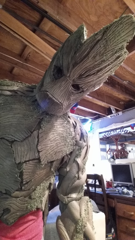

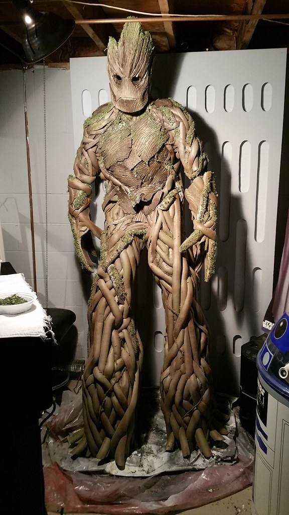

Okay, back to the moss. I just used "Elmer's Glue All", and a cheap paint brush, and "painted" glue on the areas where I wanted the moss, and then just pressed little bits of moss in place. I used what I would consider and excessive amount of moss in this process, with a plan to "rub off" much of the loose moss the following day. I think this is a good strategy.
20160520_000714 by Robert Whalen, on Flickr
20160520_113309 by Robert Whalen, on Flickr
20160520_113419 by Robert Whalen, on Flickr
20160520_114845 by Robert Whalen, on Flickr
20160520_120523 by Robert Whalen, on Flickr
20160520_120651 by Robert Whalen, on Flickr
20160520_122342 by Robert Whalen, on Flickr
20160520_125429 by Robert Whalen, on Flickr
20160520_223359 by Robert Whalen, on Flickr
20160520_224745 by Robert Whalen, on Flickr
I hope that my build serves to further the knowledge of this community.

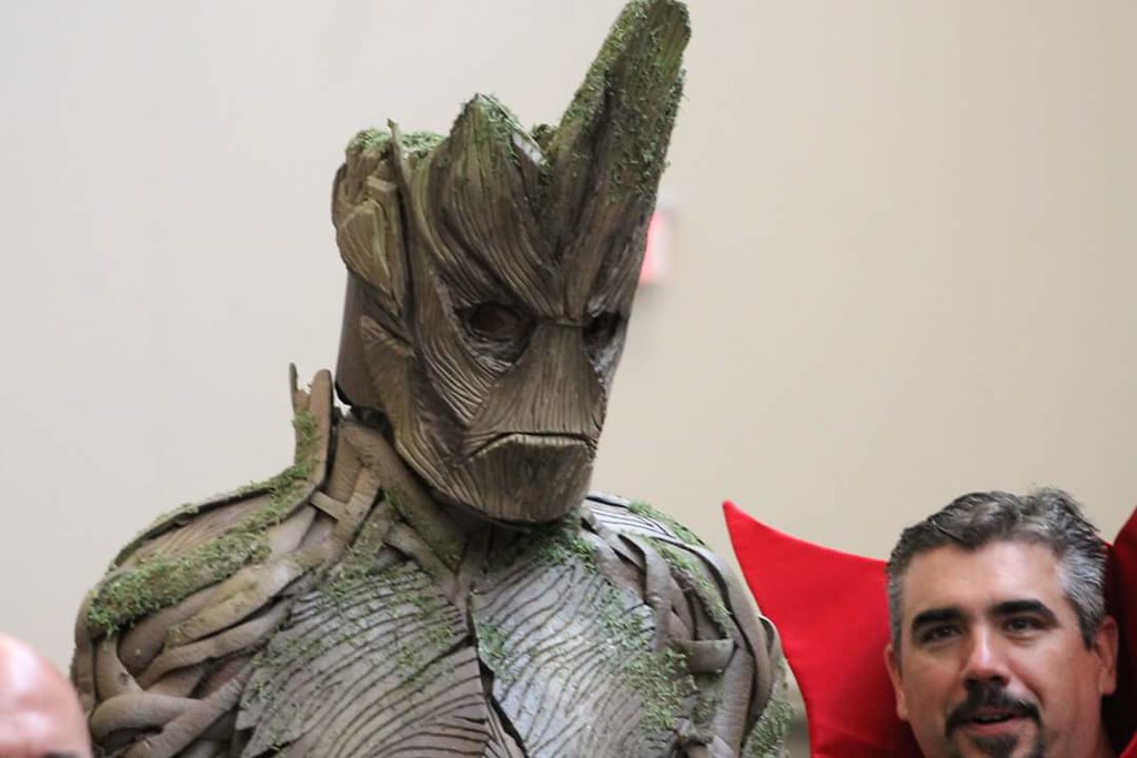

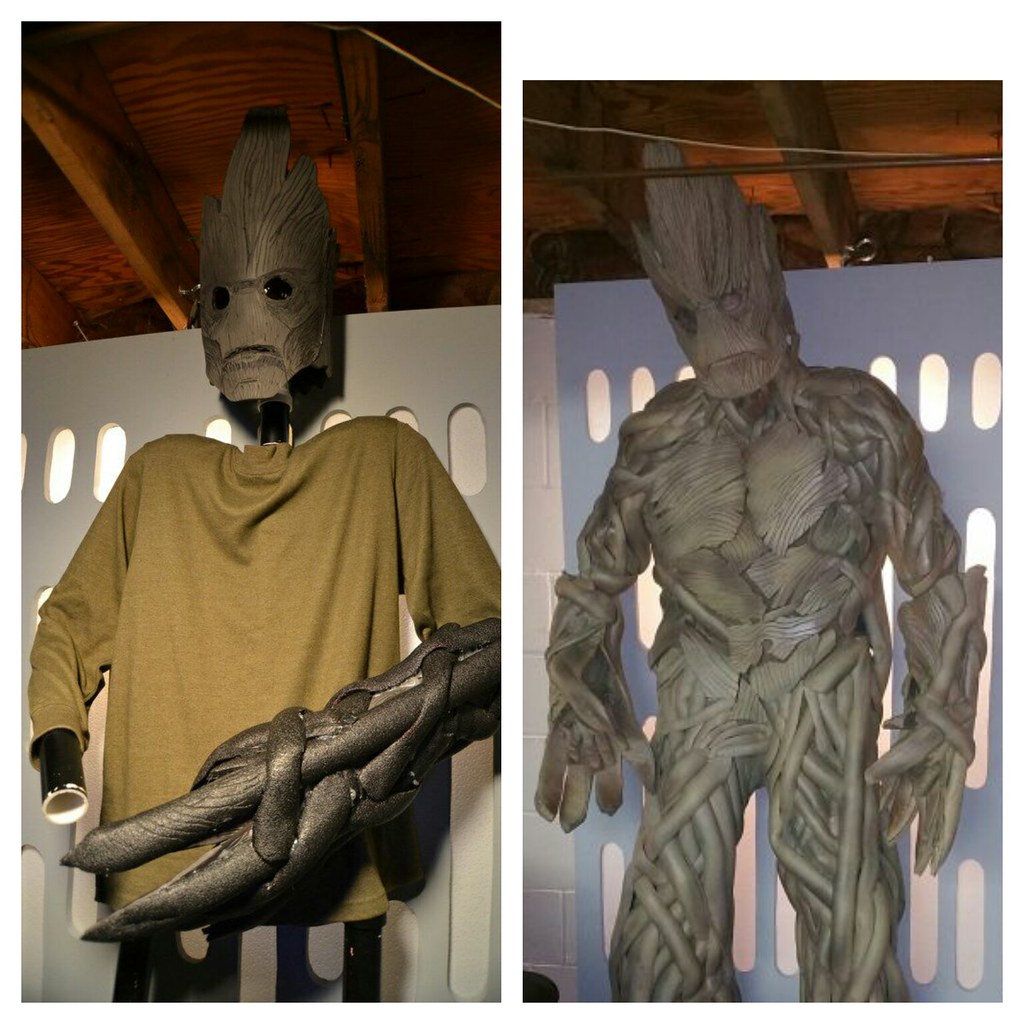

Hi everyone! I just wanted to post an update. I attended Niagara Falls Comic Con on Friday - Sunday, and I had a blast! I went with a bunch of friends, and we spent the weekend having fun with our various Cosplays. I ended up wearing Groot on Saturday and Sunday each time for approximately 3 hours. I find 3 hours to be my personal limit for this costume. With each stilt weighing nearly 10.5lbs, and the entire costume coming in around 30lbs total, 3 hours is plenty of time to spend behind the mask.
Regarding the stilts, the biggest take-away I can express about my design is that it does not handle slopes very well. Flat level ground works great. Inside the con, I moved quite fluidly. Outside on the sidewalk was a bit more challenging. An incline or decline in any direction other than the direction of my path was a challenge. I did manage to walk probably a distance close to 1/2 mile in the costume each day without incident.
I will say however, that I am excellent at roller skating. I referee Women's Flat-track Roller Derby, and coached the sport for a few years. I would rate my balance as exceptional.
Here are some pics I was able to find online through searches... Hopefully, a video of me walking emerge. If it does, I'll post a link.
1465062679998 by Robert Whalen, on Flickr
1465065383753 by Robert Whalen, on Flickr
