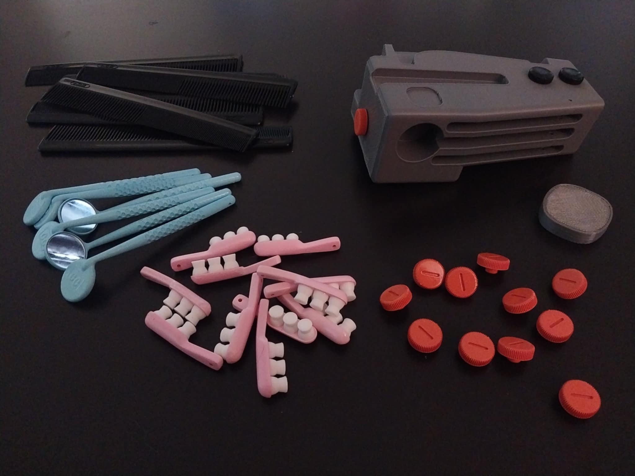

This popped up in my toothbrush eBay search and I just thought it was too stinkin cute. I miss my kids being so young.:
Well that's a horrible pic... :lol: When the rest of the next shipment comes in, I will get proper pics.

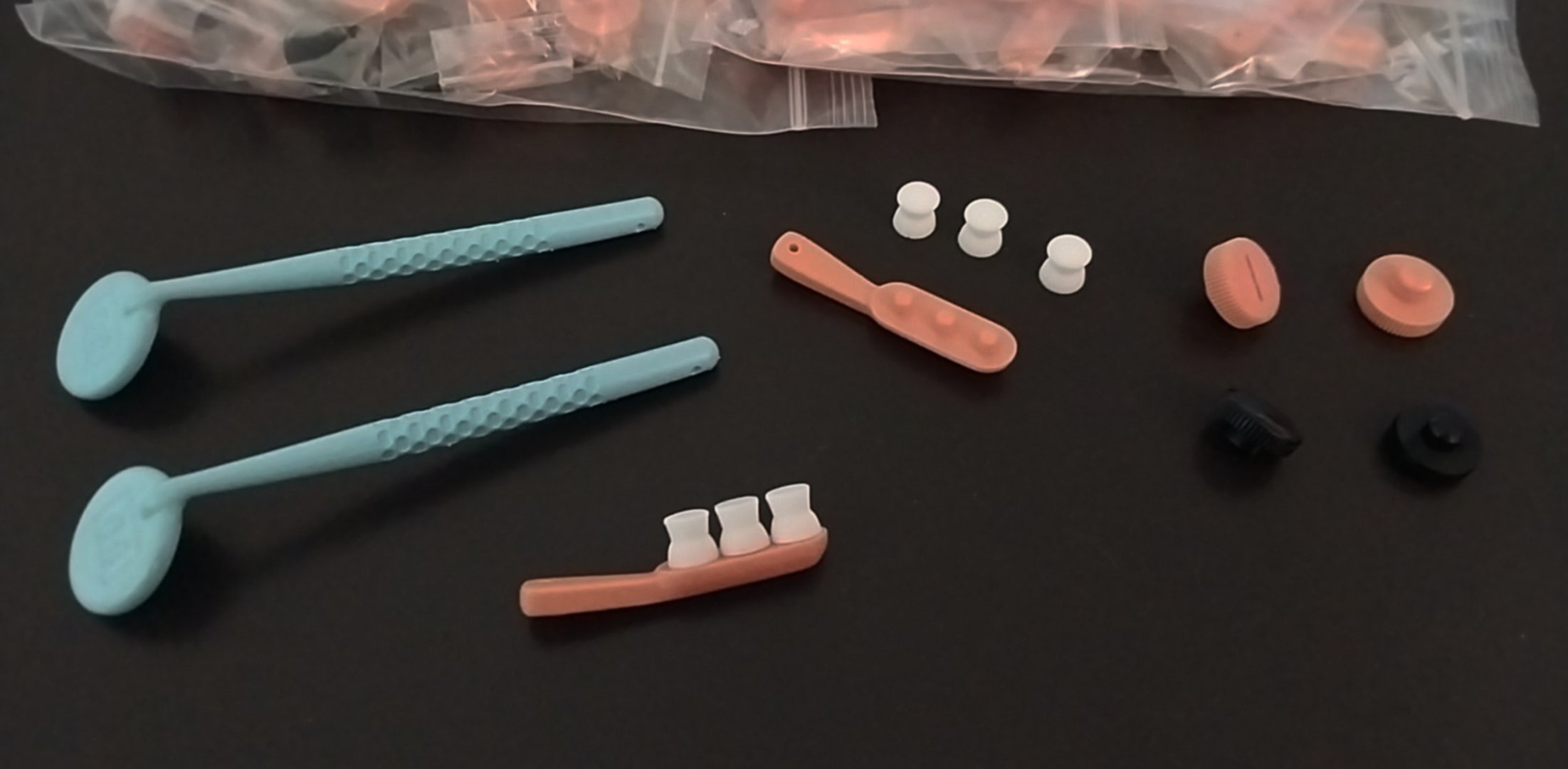

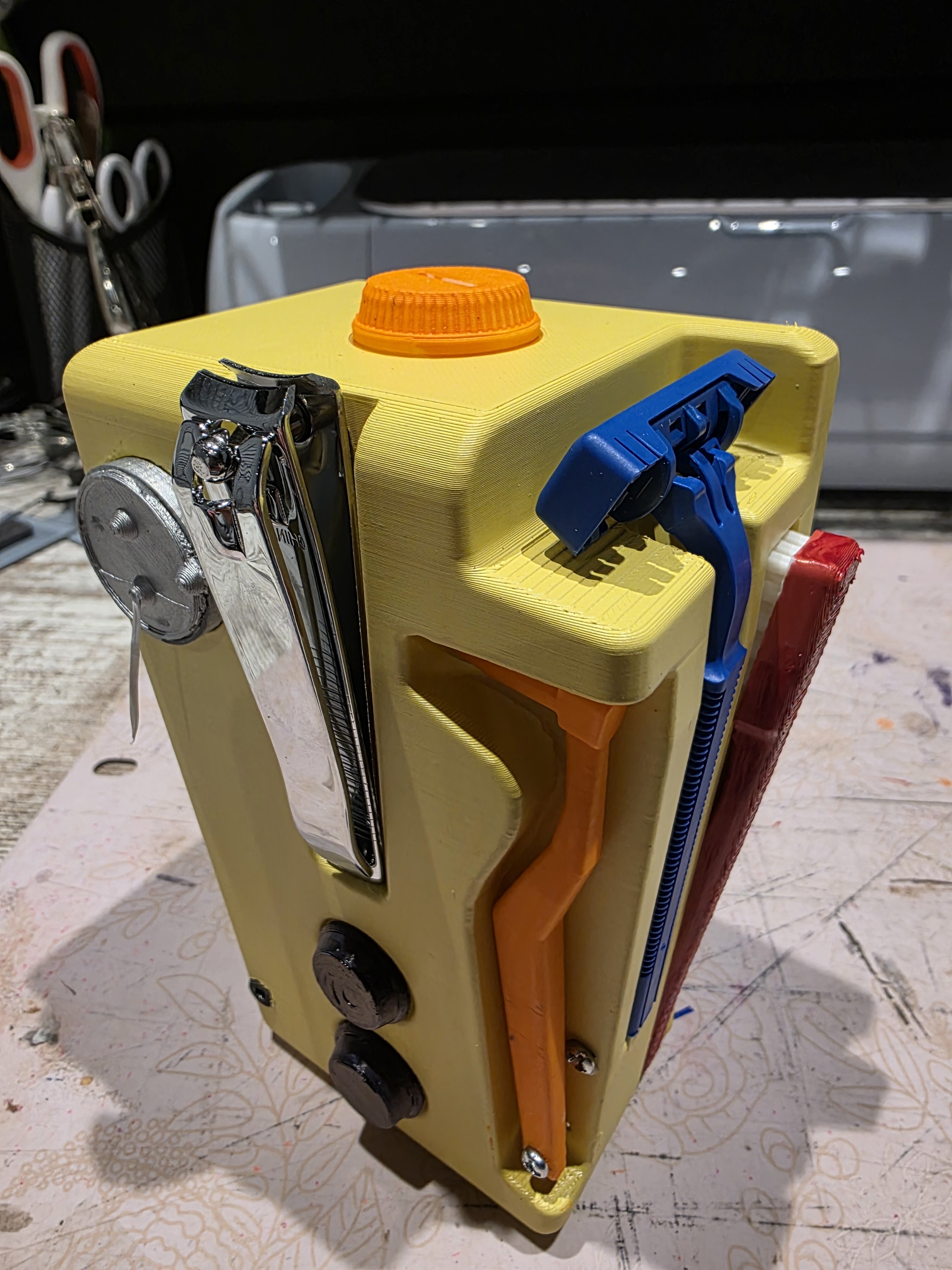

Just a quick update, I've now got orange buttons, black buttons, and prophy cup brushes in hand. Overall I'm very satisfied, although the prophy handle and orange buttons need recoloring. Not a huge deal, the dental mirrors were re-colored as well so I am confident I can get great results.
Also on the way are the 22mm mirrors for the CC mirrors, that outfit also cut me the thicker vanity mirrors for the door. Hoping to see those by next Monday.
For the zebra fur, I settled on a white velboa short-pile that looks very good. I worked up acrylic stencils to match the original zebra patterning, and will hopefully have a couple dyed by next week. I can't foresee any problems as these are all processes I've done before, but I'm looking forward to having physical pieces done and in-hand to be sure.
Last hurdle, the correct toothbrush. I do finally have several correct models in-hand, although they are not in the transparent red-orange. I considered modeling them and having them manufactured in tinted clear resin, but I think I'm better off molding and casting them here in the shop instead; I can adjust tints and finishes on the fly to get the results I want, rather than paying a not-insignificant amount for maybe 20 manufactured pieces with no guarantee of the color, transparency, and overall quality. The new toothbrushes will be pre-drilled to accept the tubing, and also have fresh bristles installed in the heads. It's probably going to be the biggest pain in the a$$ of the whole project, but I am actually looking forward to putting these together.
That's all for now, I should hopefully have another update next week. (y) If anybody is looking for 20mm round mirrors, let me know. I have THREE HUNDRED of them to go with the 80+ wrong nail clippers, cuticle clippers, files, and various other casualties of the parts hunt :lol:

SO.... WHERE ARE WE? For custom parts, here's where I am sitting:
- Proffy 'mystery' tool handles are now correct pink shade
- Orange buttons done. I didn't like the dull finish on the orange buttons, so they are now an improved orangier lol
- Dental mirrors are done, finally got correct mirrors custom cut and fitted into the handles. They look badass :)
- Vanity mirrors have been custom cut
- Vanity zebra fur is here, it's white Velboa. Just experimenting with dyes for the stenciled-on black patterning
- Vanity doors are templated and I have 3d printed versions, but I think I will just upgrade to laser cut wood.
- Black buttons are done, although I may re-paint them (the manufacturer's paint is OK but could be better)
- Toothbrushes are set to be delivered in less than a week, then they get tinted and re-bristled
CREST TOOTHPASTE CAPS
I can either cut down caps, or also partially fill the caps with resin to make a solid 'bottom' (so they have a good mating surface to the body). We've always assumed these caps are just cut down, that seems like an easy way to knock these out.

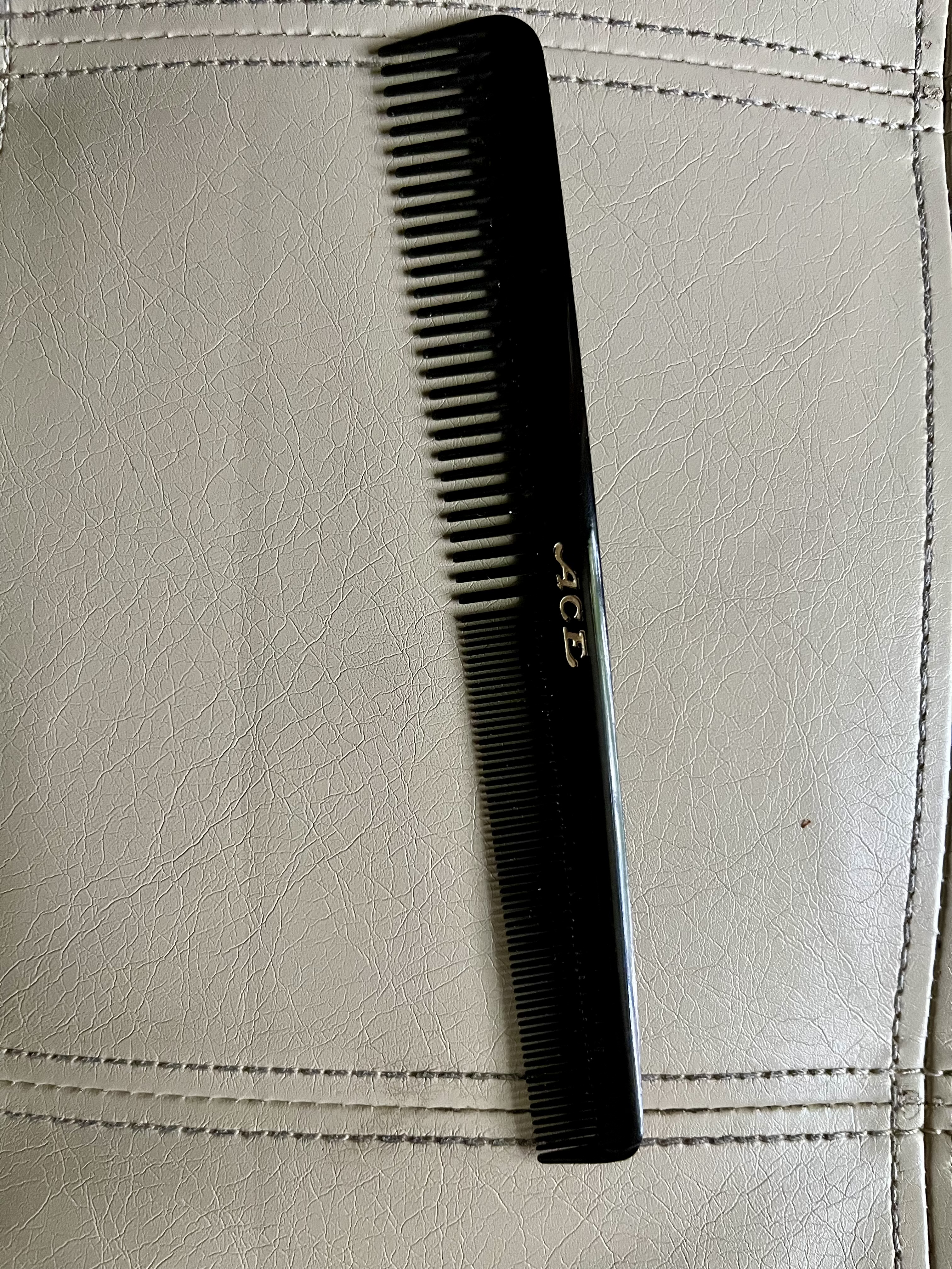

ACE COMBS
I've got a dozen, but they have the 'ace' logo on one side. I don't think it's a deal-breaker and I believe I can just sand it right off. Otherwise it would be visible on the 'nail clipper side' of the Buddy.
THE BUDDY BODY
I've mentioned this before, but the Buddy is smaller than you'd initially think. We do have known measurements (everything from the razor to the proxbrush, clippers, toothbrush, floss, etc) that I was able to apply to the body size using photogrammetry. Having said that, I have reached out to anchoredprops to see if he can confirm my sizing. I'll get the base finalized, and also work up a more 'routed' version that has the rough rounding out of the cutouts that the original shows. I had originally thought to just supply a base body with all the cutouts in resin that the owner could then hand route more, but that seems like a dumb idea in hindsight now. If I can knock out those steps on my end, then people don't have to do that stuff on their own. I DO plan on casting the finals in a tinted resin, so any additional wear or routing could be added if somebody wanted to customize it more without worrying about exposing a finish/etc...
I'm probably forgetting a bunch of stuff, but yeah things are moving along well. Outside of the hard-to-find items like the EXACT clippers, the last hurdle will be that toothbrush. I don't want to be too confident, but I think those are going to be amazing (well let's check back when I am dying them and gluing in 500+ bristles lol). Paying to have them manufactured on industrial equipment still saves me money in the long run, never mind the time, money and headaches associated with transparent casting.
I'll try and get some more pics up before the end of the week. I can ALMOST see the finish line lol.
I should have put a V1 pink proffy handle and orange cap next to these, but I think you get the idea. A million times better looking. Also there are my Ace combs... They are supposed to be re-popped "88"s, does anybody have any measures on a their 88 just to be sure? These are just listed as 7 iinch combs, max width is right over 1 3/16" with a max thickness right over 1/8".
(Ignore the prototype body, as scarf man had to remind me, that is the 'parts-fitter', so there is little to no shaping/routing)
