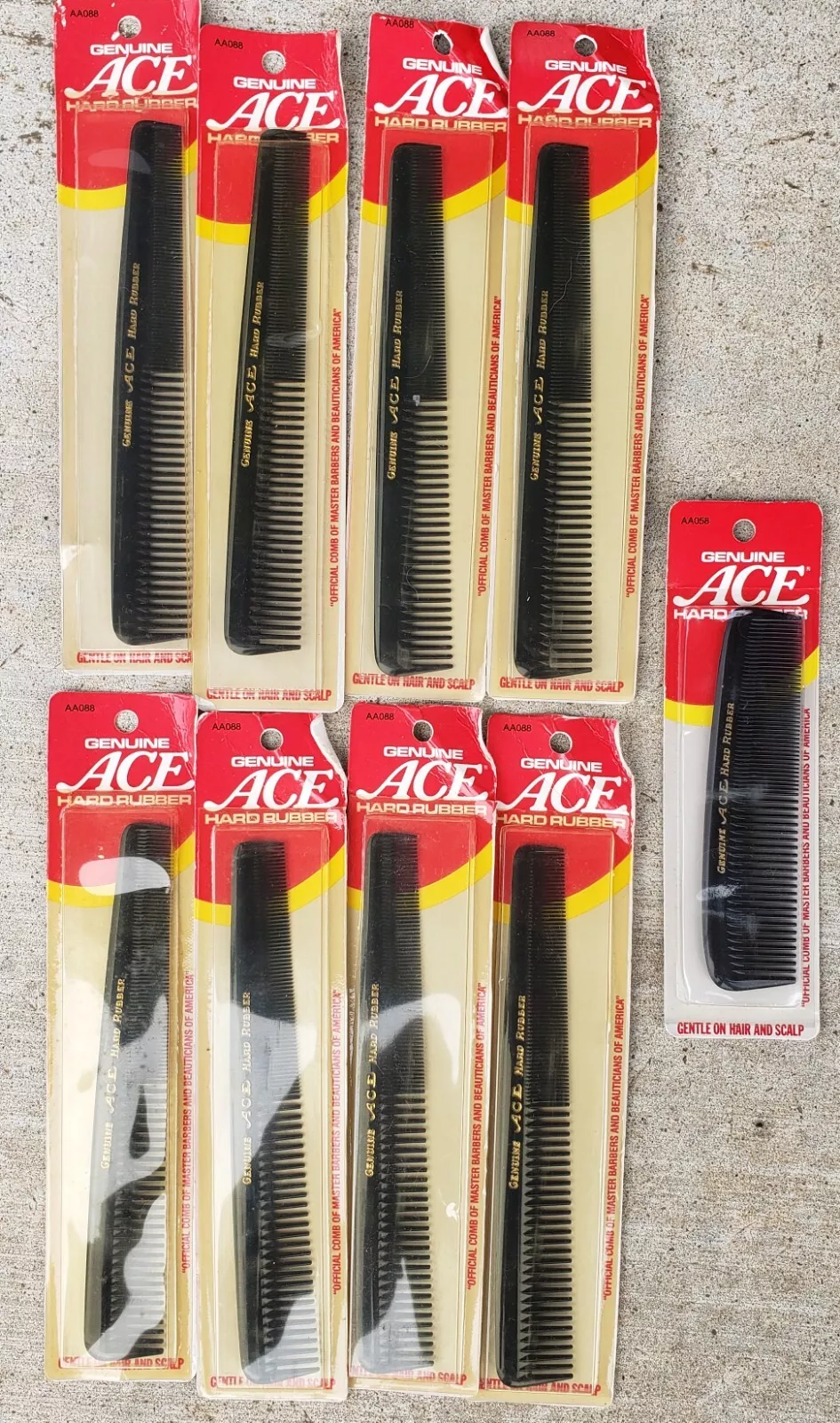

I will have some spare combs soon!
I picked up a lot of eight Ace 88's!
I think this might be the correct variation. The seller says these are late 70's or early 80's.
Now I have all the main parts.
I would like to upgrade my toothbrush and mirror, but they're really close so I'm happy.

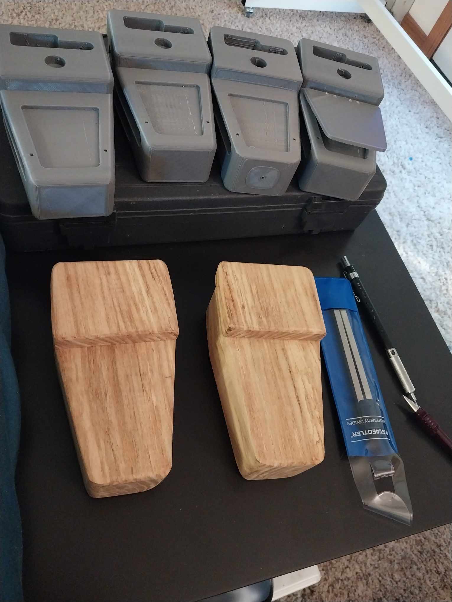

Quick update... I had a couple of wooden bodies made locally (just the base without the routing work), and it was, relatively speaking, a bust. Thankfully I figured out that he was not going to work out early on, but it reminded me that Screen Accurate Prop building requires a different mentality than most understand, and making things ACCURATE is always going to be more work than what is easy/convenient. :)
A quick overview of problems: My wood choice was substituted to save me money (NOT WHAT I ASKED FOR, won't work), the angle of the side cuts was slightly changed to make the cutting jig easier to use (that really won't work, now the vanity door doesn't align properly), and each body was made of two pieces of wood and glued together to make an extra cut easier (I AM LOOOOSSSSIIIINNG MY MIND WHAT ARE YOU DOING AT THIS POINT!?!?!?!)
So needless to say, these won't work. And this is exactly why I am willing to pay someone the extra initial $ to make me a prototype or two first before committing to 10 or 20 of something; I'd rather be out a few bucks to see something isn't going to work than be out hundreds on pieces I can't use (or have to get into a dispute with a person or company over the work).
I've already lined up a new place for the work, I just wanted to share (complain) about the experience. The first guy still doesn't understand why I'm buying all these used nail clippers and dental floss for $$$ :lol::lol::lol:
Silver lining? I now know a Bathroom Buddy solid body in hickory without any of the routs done weighs 9.8 ounces :)

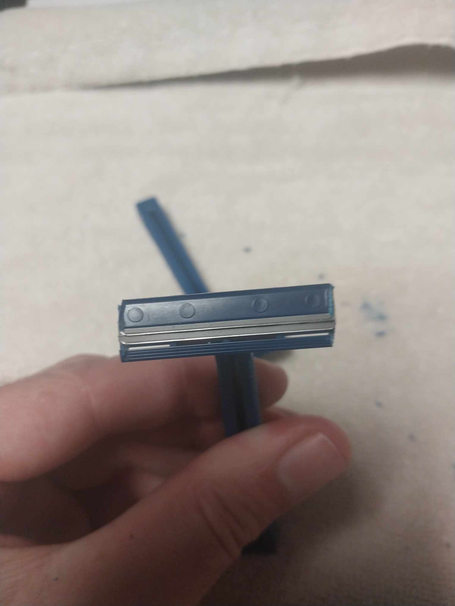

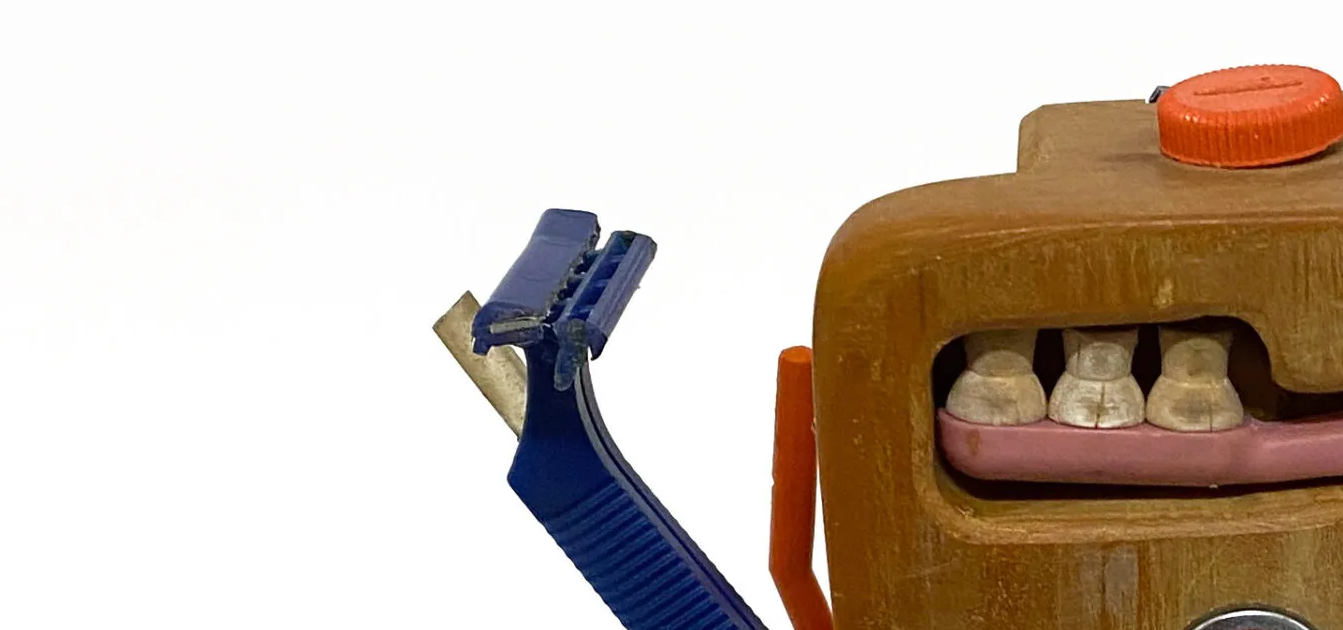

TRIMMING THE DISPOSABLE RAZOR
Here's what I did, TL;DR: use a Dremel :lol:
As scarf man pointed out a bazillion years ago it feels like, the original razor head looks like it has it's ends trimmed off. The razor's end caps have been taken off on both ends, and you can see the end of one of the two metal inserts. I think the maker misjudged the width of the razor and had to either modify the head or the wooden body to make it fit. The end in the foreground below had to be trimmed for it to fit in it's niche in the body, trimming the other end just cleans it up and makes it protrude less.

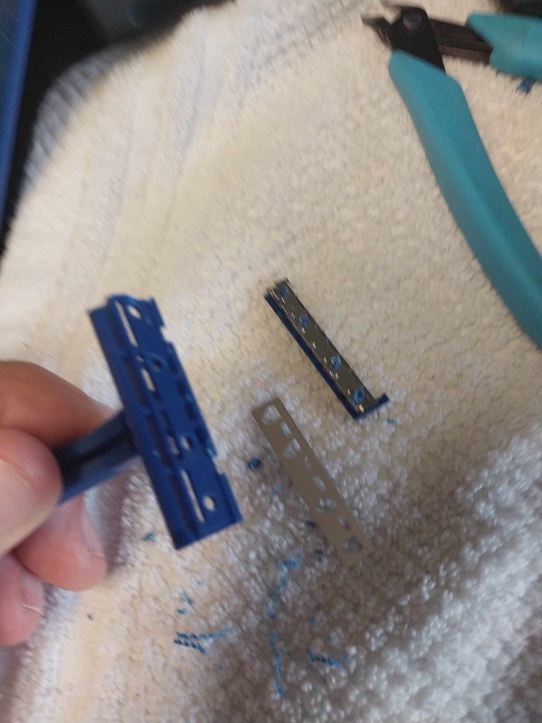

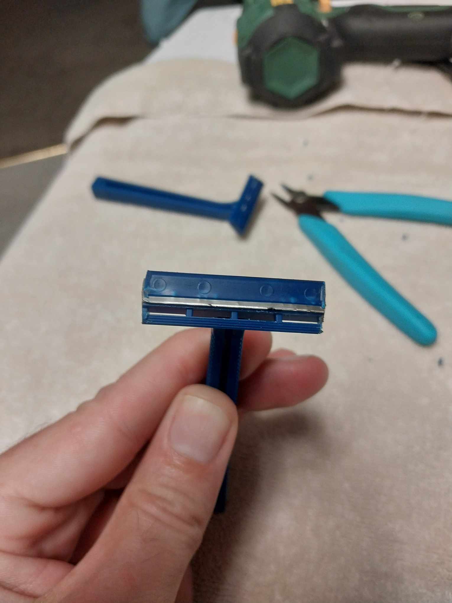

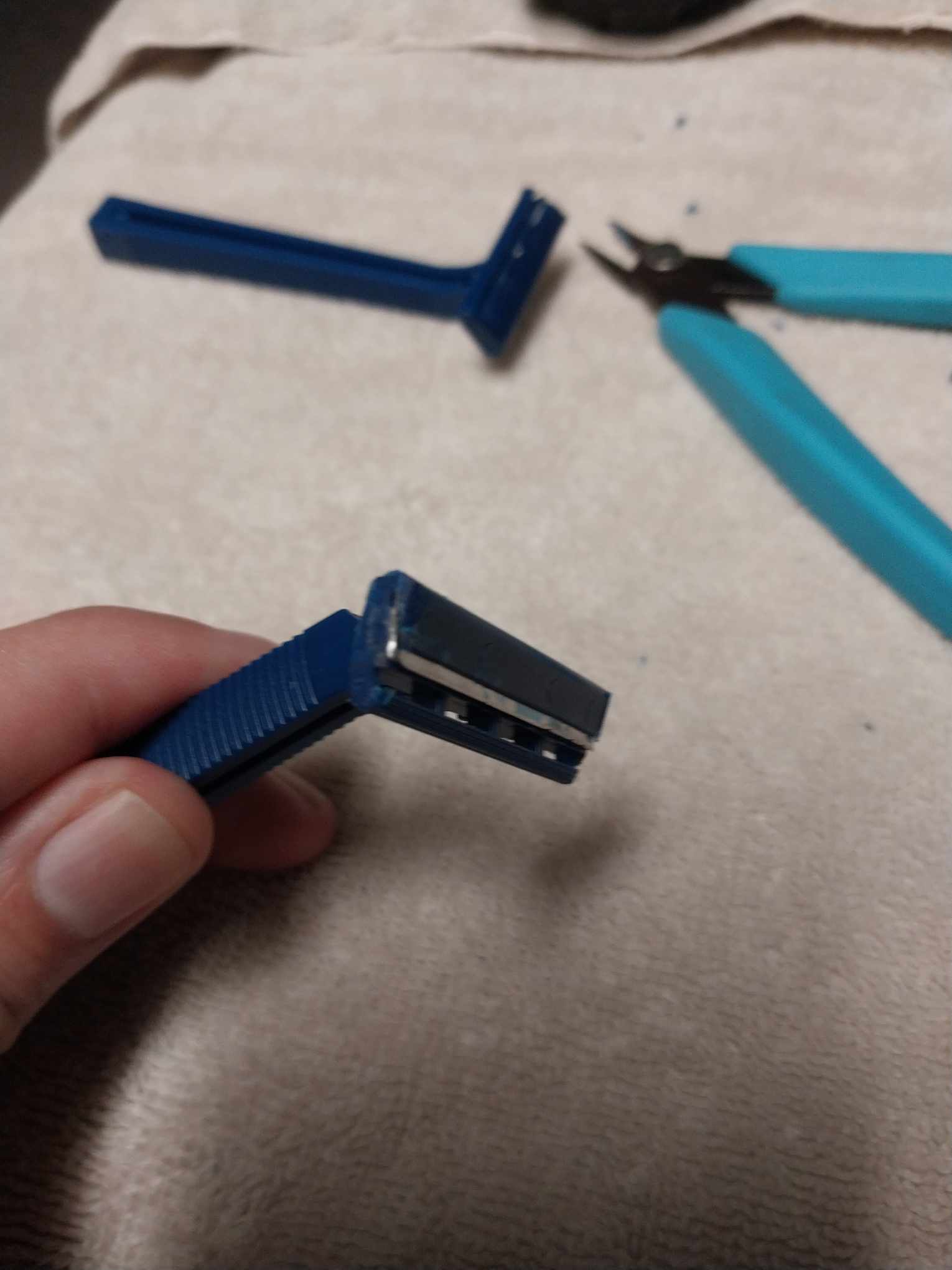

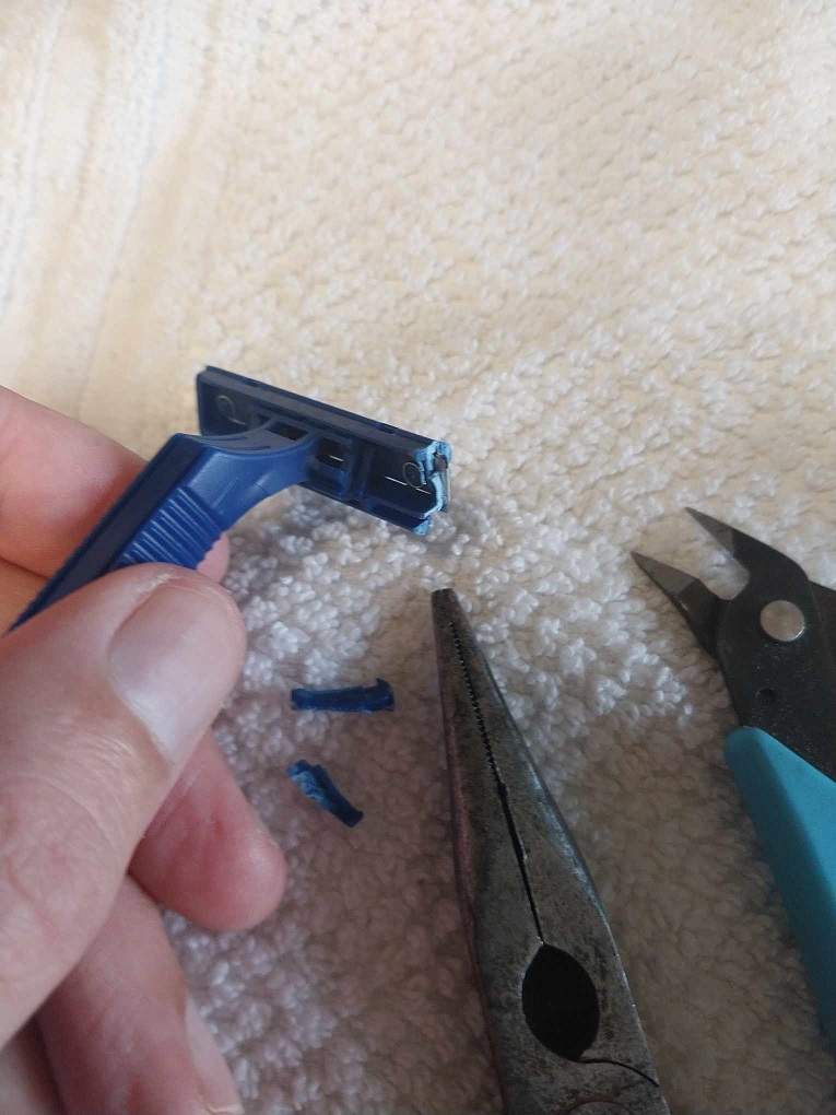

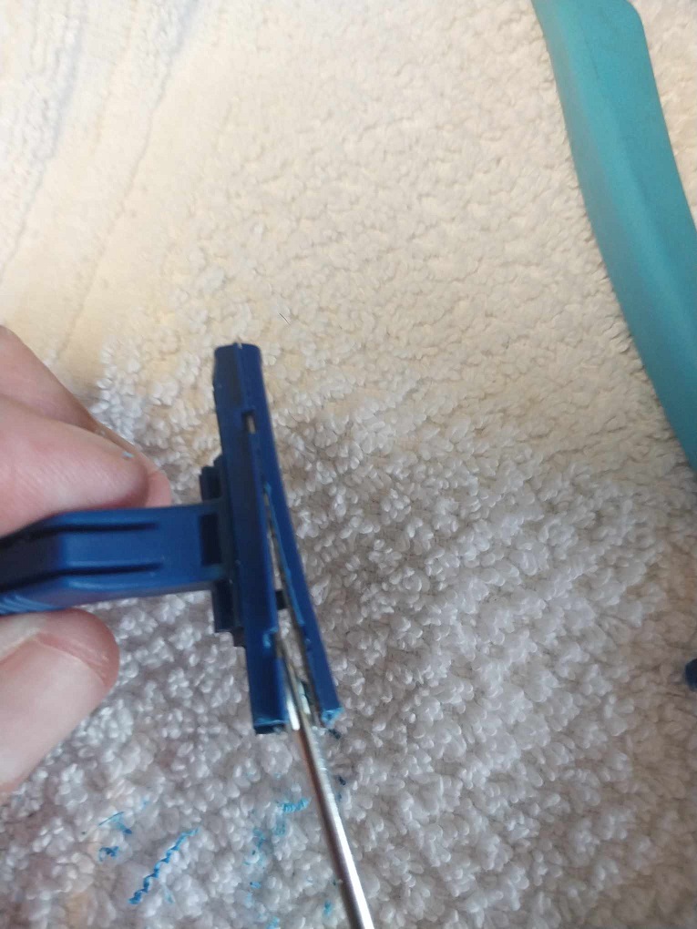

RAZOR #1 MODIFICATION:
I'm just going to document this in case it will help somebody else, I don't think it was a great approach but it helped to see how the razor goes together and comes apart.
I went right in with some nips and just snipped the end cap right off. My hope had been that the cap removed would allow the assembly to just pop right apart, but no go. In hindsight, I should have clipped BOTH ENDS and tried prying the top off, but I wasn't thinking.
Besides the endcaps, the razor also has four plastic rivets that are heat-pressed through the two blades and hold the top and bottom halves tog together. I did pry on the halves a little bit, but didn't get much wiggling without the pieces wanting to deform. At this point I should have trimmed off the other end cap, wedged a micro screwdriver between the two metal inserts and twisted to hopefully pop it all apart clean. NOPE, instead I drilled out the heads of those rivets from the back. It worked, and the head and blades came out.
That was a great victory and the blades are out, but for some reason pretty unsatisfying. I spot-glued the plastic cover back on (no blades), ran a lighter over the cut end to remove the white 'stretch' marks in he plastic, and ended up with this:
WHAT I LEARNED HERE: In hindsight, I would trim both ends, then wedge a blade between those two metal inserts and try prying the plastic head off. I think those metal flats will likely distribute the force like a big wedge, and hopefully pop the head off clean. Then I'd just reinstall the narrower metal flat into the razor to match the prop, and glue the plastic head back on. One could also just trim both end caps off and leave the blades in, but they are sharp off the ends and I want that bottom blade gone.

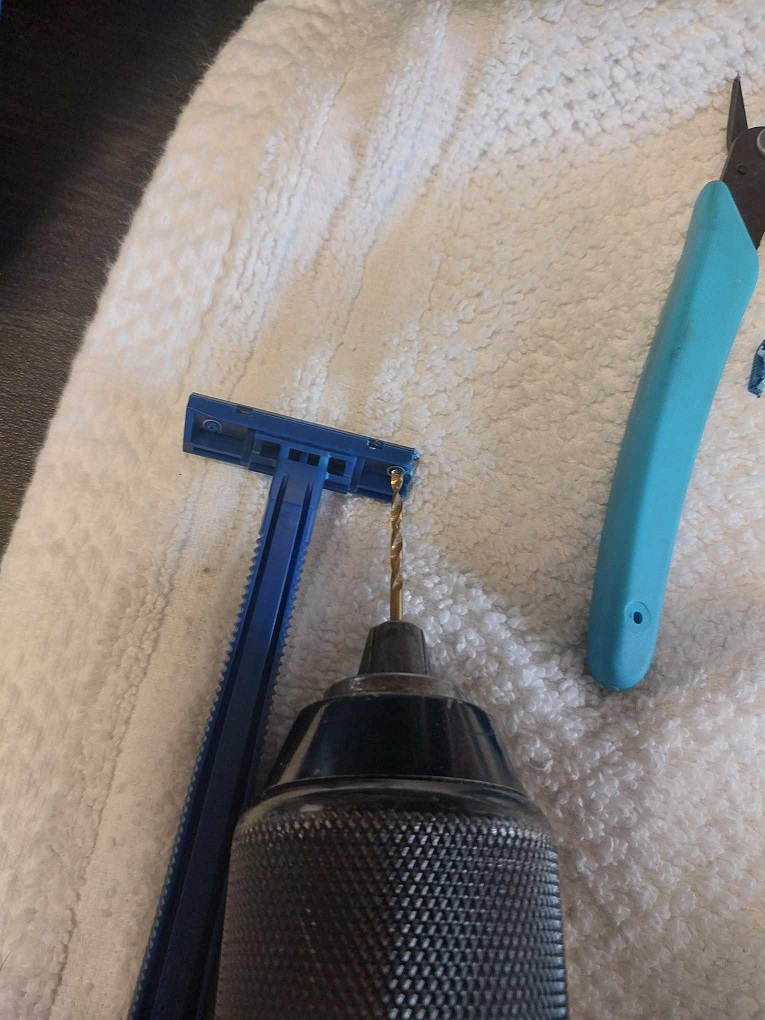

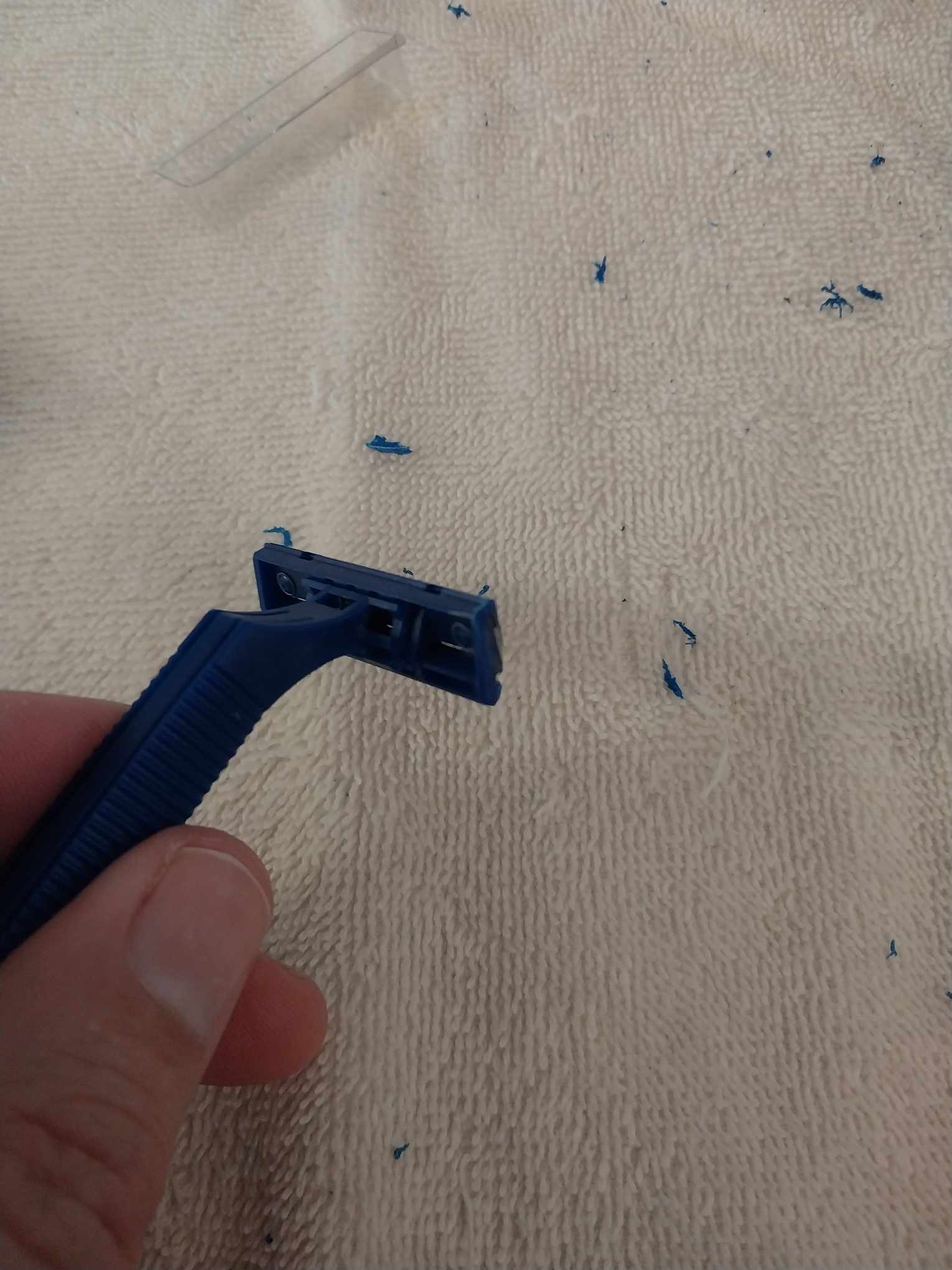

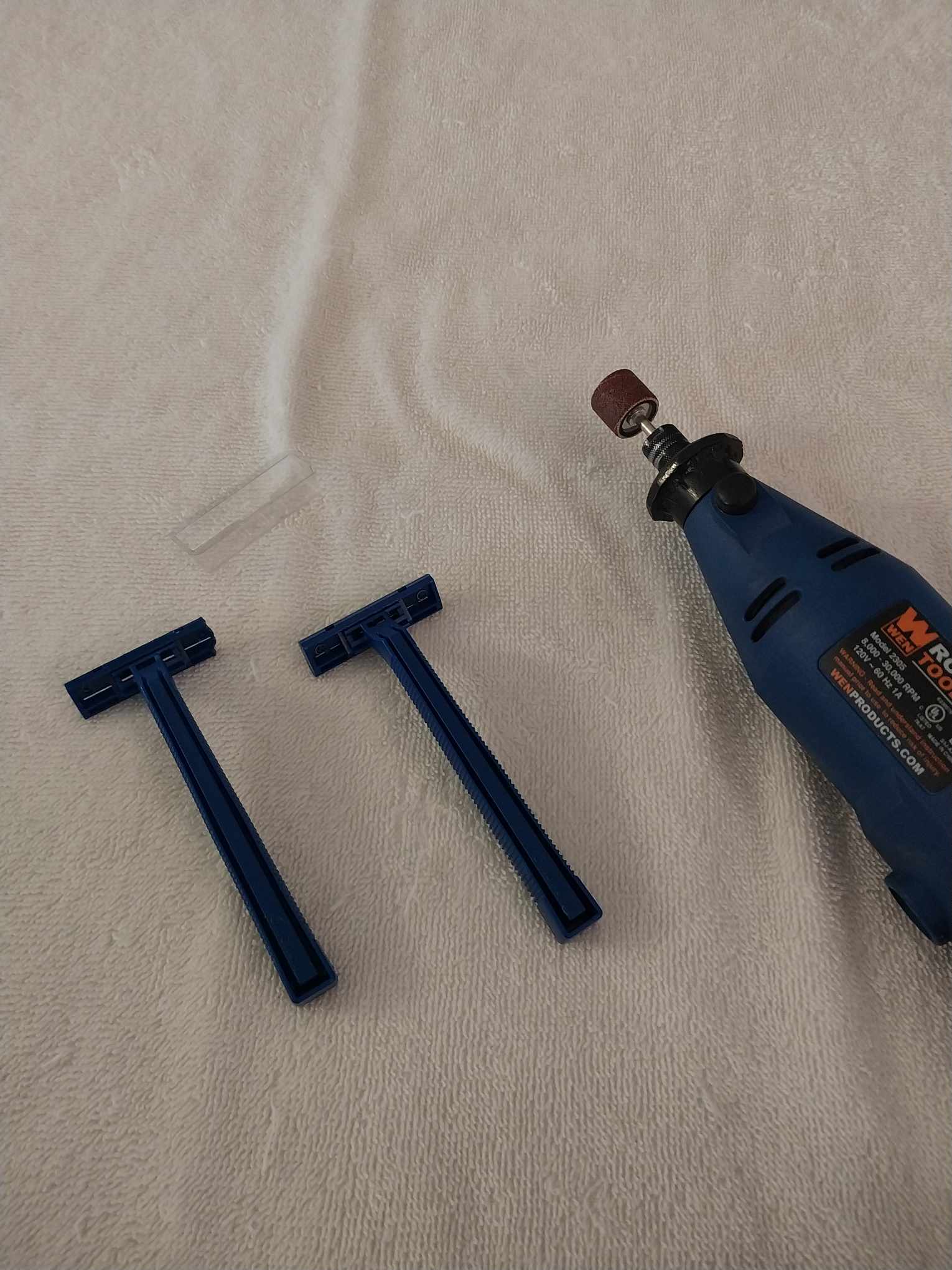

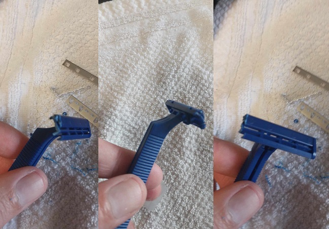

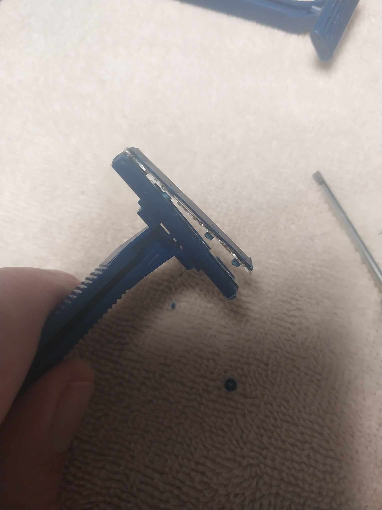

RAZOR #2 MODIFICATION:
Common sense to the rescue.... Pulled out my rotary tool with a small sanding drum and went to town:
Maybe a minute, and the cap is gone, no
...Pried between the blades without drilling any rivets, and was successful (kinda). The top did come off, but in the end the rivet heads are just snapping off anyways after a lot of unnecessary prying and bending.
Popped the top off, pulled the blades, put the top blade back in, and glued the plastic top on:
WHAT I LEARNED HERE AND WHAT I'M DOING NOW:
-Dremel is the way to go! It's fast, very controllable, and pretty easy to clean up
-DRILL THE RIVETS, at least two of them... If you look at the last pic above, the blade has dents and the plastic has some stretch marks in it. That is 100% from fighting the rivets and flexing the head when I pried the top off. A lighter run over the top might take the marks off, but I can prevent all of it just by drilling the rivet centers.
-Not a huge deal, but tomorrow I will see if I can flip the installed blade so it is dull-side exposed, or just dull the edge down so it's not a cut hazard. It's not a huge deal, but I could cut myself on a banana and I have a couple dozen more of these razors to deal with :D

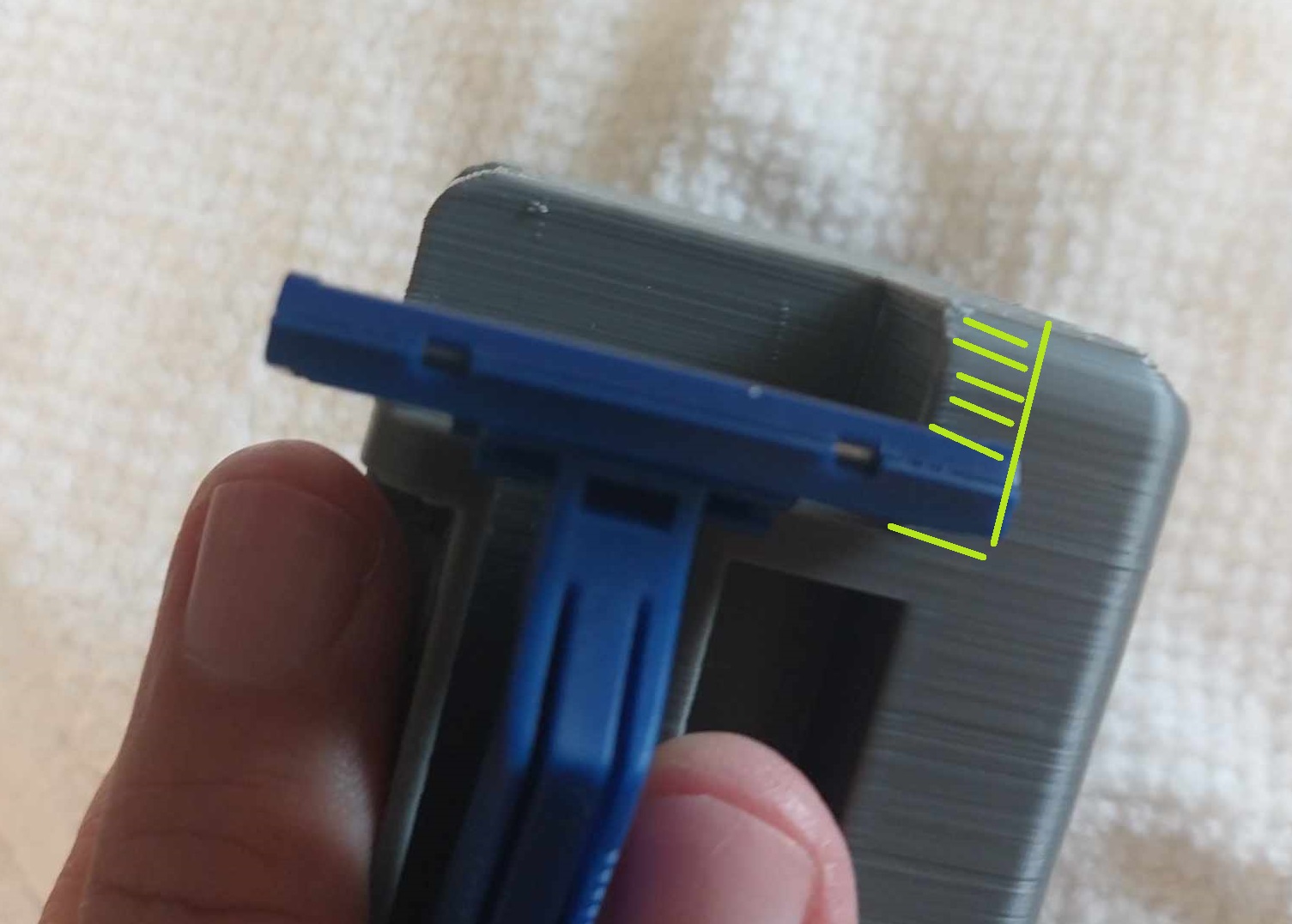

Can we make the wooden body simply modded to fit a unmodified Razor?
A person could rout or Dremel the extra material so an unmodified razor would fit centered in the slot, but the lower slot below can't be moved over without the other slots being relocated and not aligning to the original; the other end of the razor head hangs out a decent amount whether cut or not.
For my part, I'm sticking with with the screen-accurate layout, idiosyncracies and all. :love:
Here's an early-on prototype body with razor and the extra material area marked:

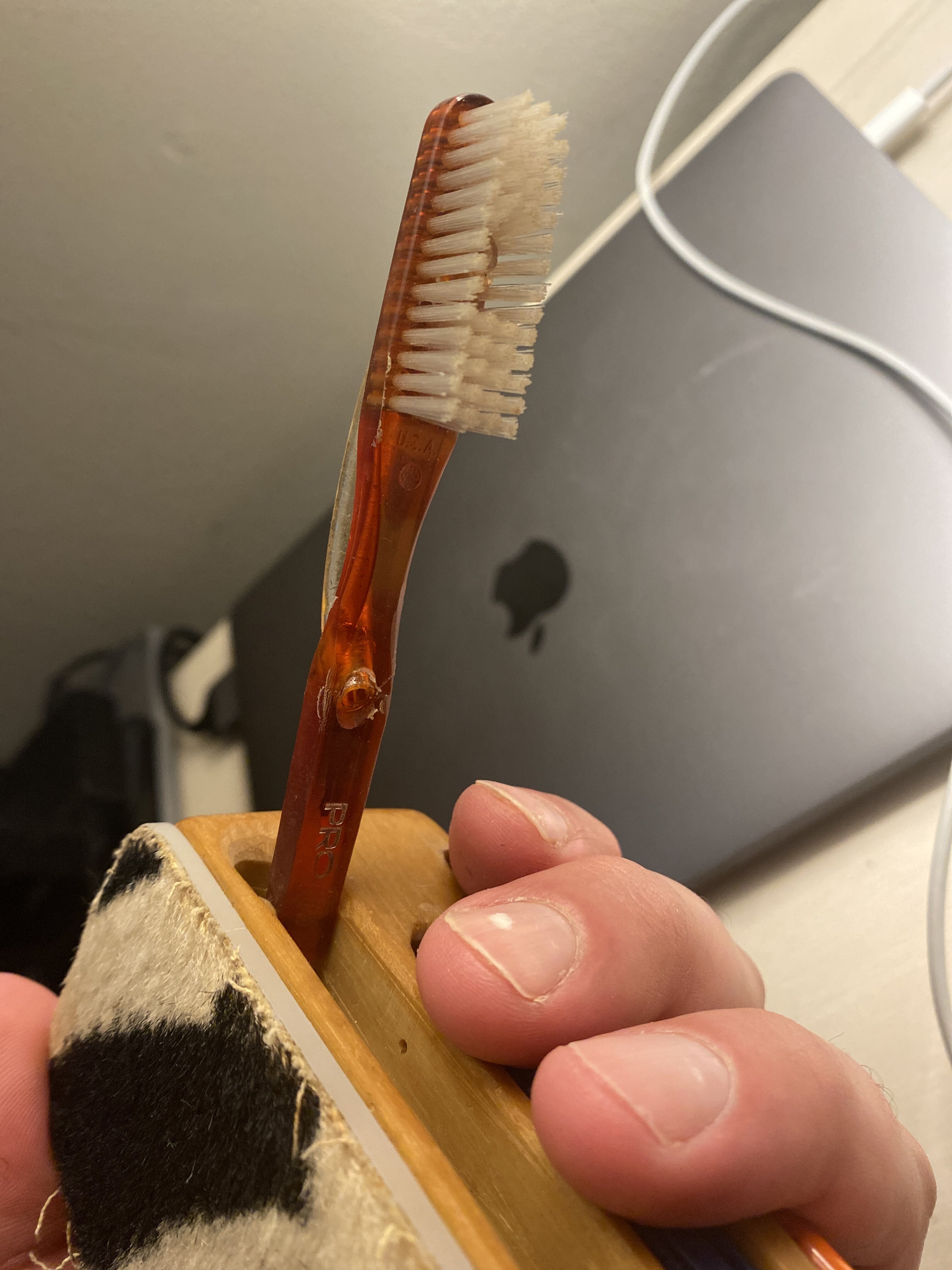

I do have a couple of questions, if you could help it would be more than appreciated. Can you give us any more information about the toothbrush? That (for me anyways) has been the hardest one to figure out. I've got the general dimensions, the number and arrangement of tufts, but we still are having trouble confirming a brand name or any identifying markings on it. A few of us have poured over reference pics for hours (mostly your pics actually), and we haven't got very far outside of a letter 'P' or 'B' on the bristle side of the handle.
