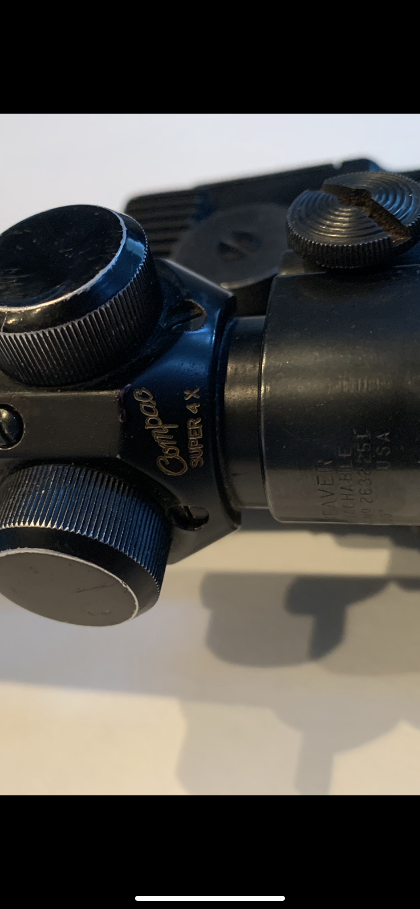

Then recently Chris Trevas listed a Compac 4 x 31 scope on Facebook and well I wasn't about to hold off for a 2 1/2 x 20 so I bought it.

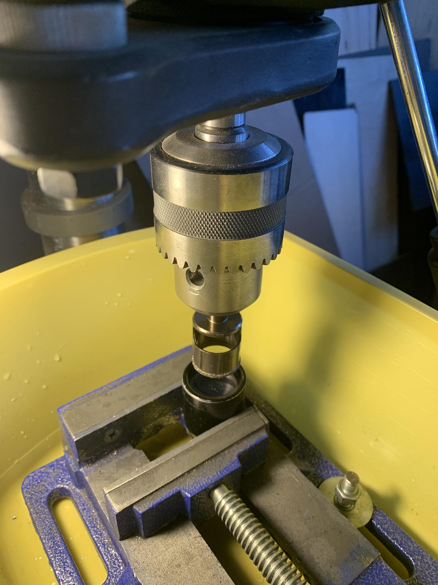

Yeah I'm a little bit a crazy mo fo. I decided to use a diamond bit 1" hole cutter used for tile mostly and drill out a hole that will be under one inch to fit inside the part so I have the same Compac lens only smaller to fit. I simply clamped down on the bell and filled the bell with water and had it all in a bucket on my drill press and very slowly went to town.
wow, did this work? cool! and a bit crazy yeah :lol:

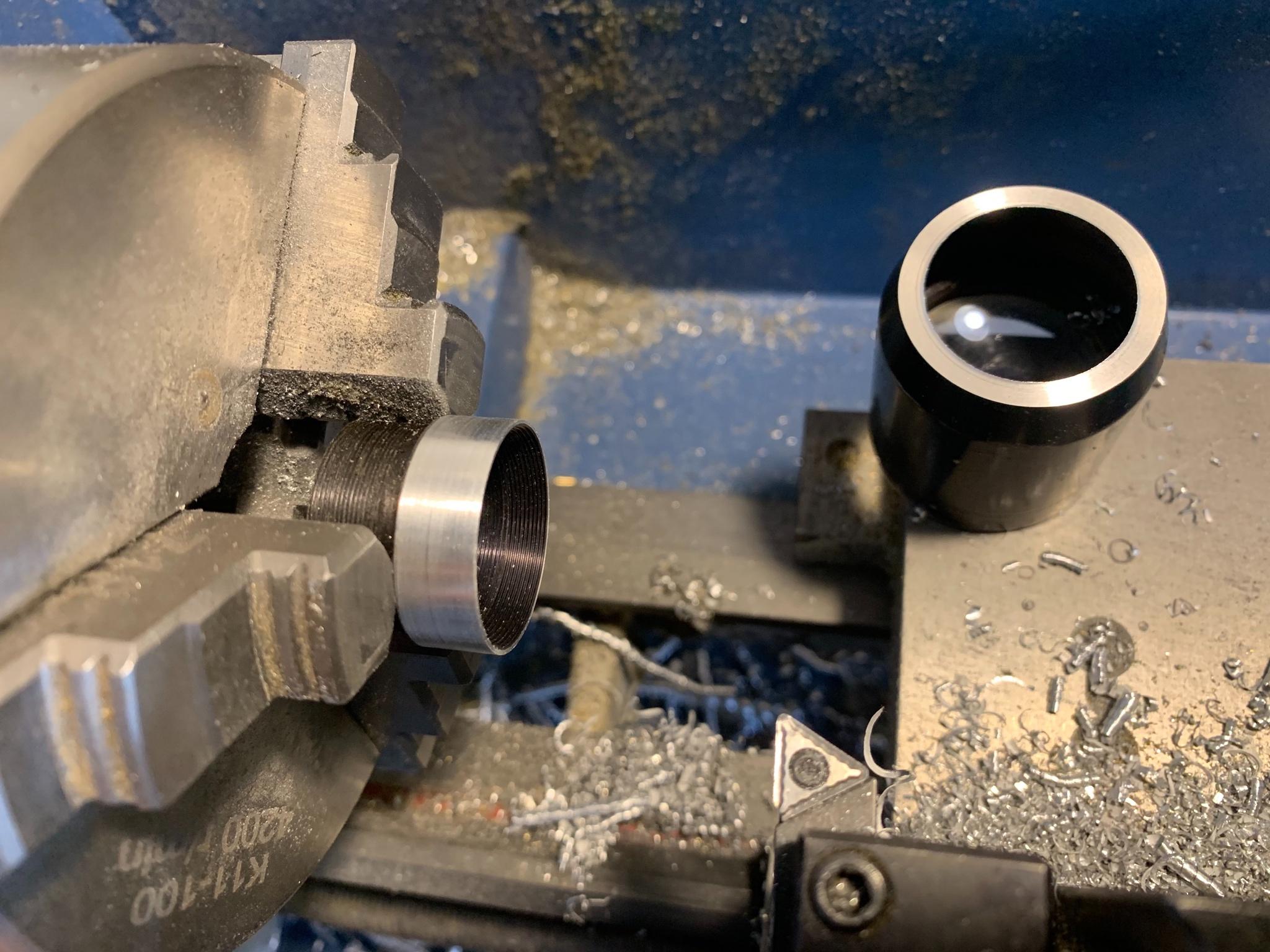

Bwahaha it's is done! I'm happpy how it turned out. I bored out on the lathe as far in on the part as I could to fit the lens without compromising the integrity of the part. I'm happy and satisfied, the front lens is a Compac. My Compac scope is and Greedo Killer blaster is finished. Now I need a stand. Lol
