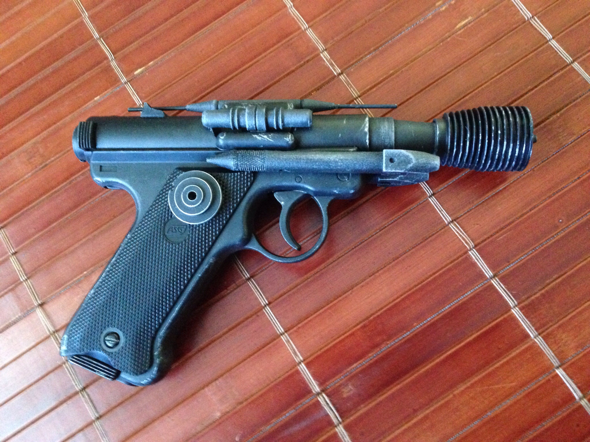

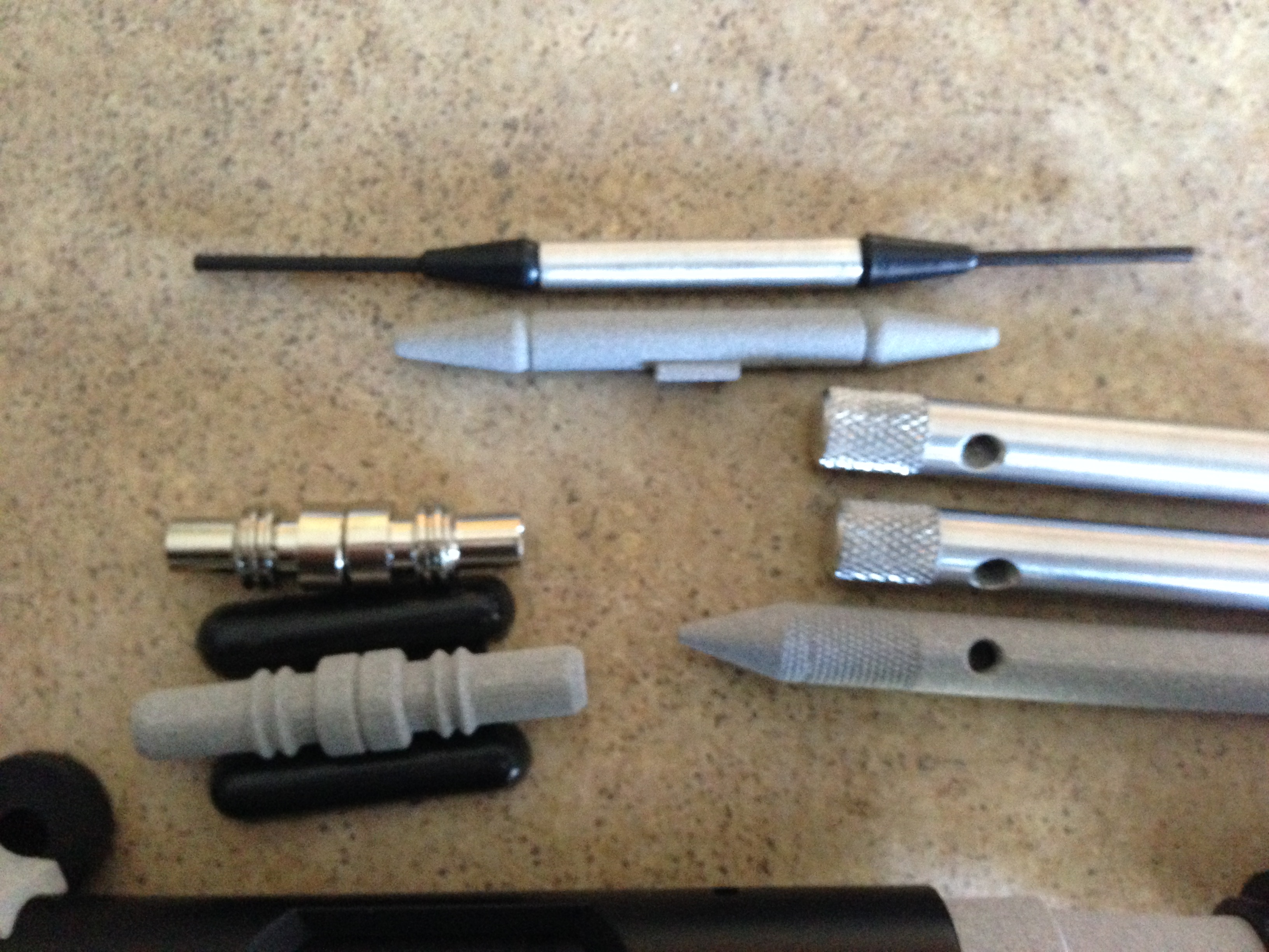

Here are answers to your questions:
(I have no affiliation w/ anyone who sells this stuff, just telling you where I got my parts from)
Mitchell trans rotors: https://www.shapeways.com/product/GRS82439L/pair-of-mitchell-trans-rotor-375-quot?optionId=43837943
Mitchell cone: https://www.shapeways.com/product/S455CVH7P/cone-375-inch-o-d?optionId=40194424&li=ostatus
Mitchell tone arm: there was a guy on eBay who made these in aluminum for Boba Fett costumes; try using those search terms
screw cover (also Ace Hardware): http://www.rvpartscountry.com/Screw-Cover-Black.html
Amphenol RF 83-168 (UG-176/U) reducing adapter: https://www.solidsignal.com/pview.a..._Hz5mda_5SBjLoabY1cGKs17WaNG2yMkaArlREALw_wcB
Reademodels.com
metal pulley disk: Elvis Trooper on the web, he used to make aluminum discs, but can't find his site now
airsoft grip screw = M4 set screw
Ruger grip screw = 6-40
If you are using the airsoft as your base, you will also need to get rid of the bull barrel. Here is the correct barrel:
https://www.shapeways.com/product/SR2MLSBVM/bb-sleeve-mkii?optionId=43620599&li=ostatus
Also swap out the rear sight for the correct one:
https://www.shapeways.com/product/5V3LBUKZ7/rear-sight-mkii?optionId=42099082&li=ostatus
Although I had a lot of real or replicated metal parts to start, I opted to go 3D print as I felt they would be more secure as they are lighter and and in some cases, the parts were made to be combined into one piece. It's just a personal choice on this replica for me.
Here are a list of other parts if you choose in different directions: https://www.shapeways.com/shops/csbprops?section=DT-12&s=0

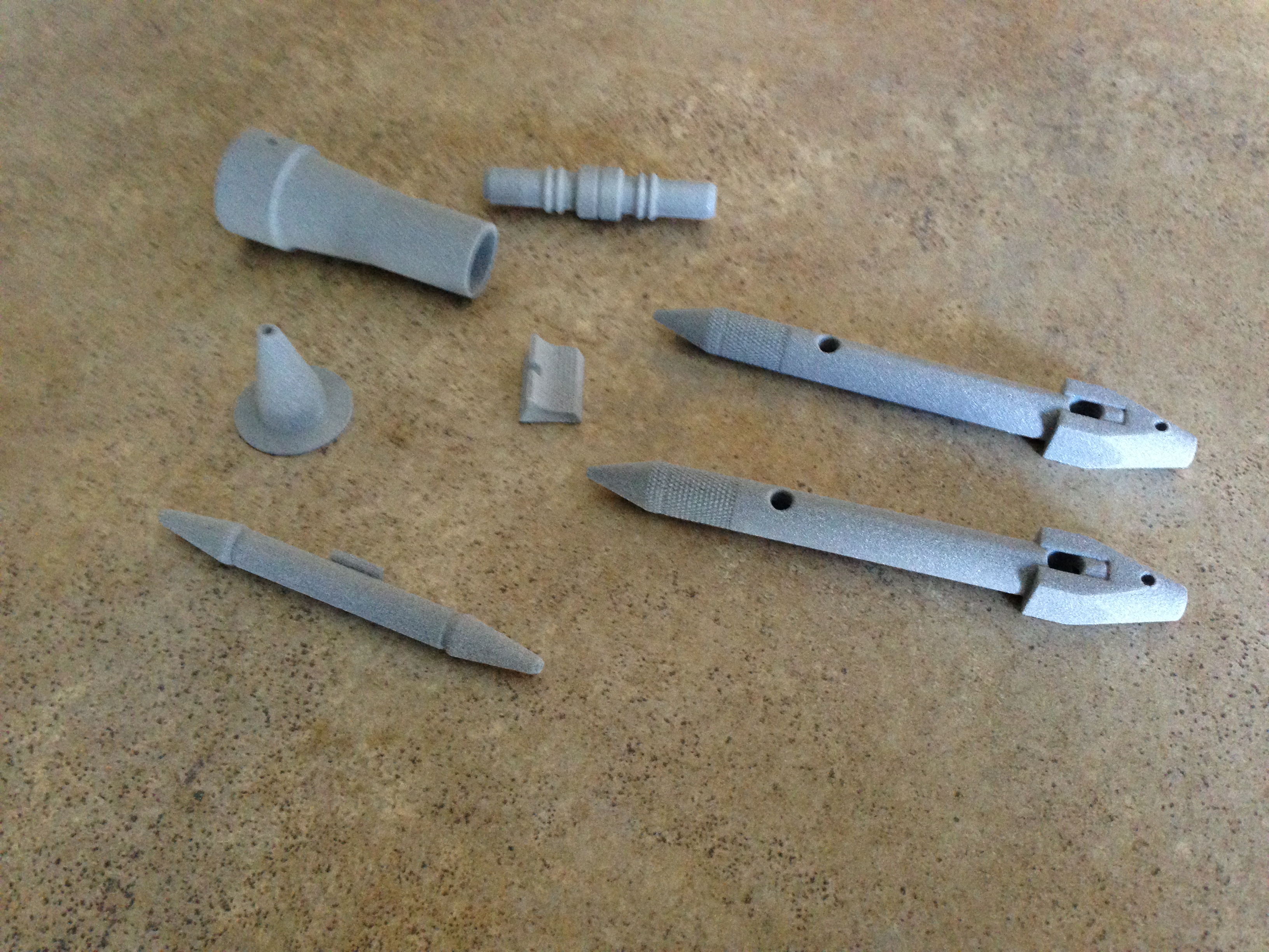

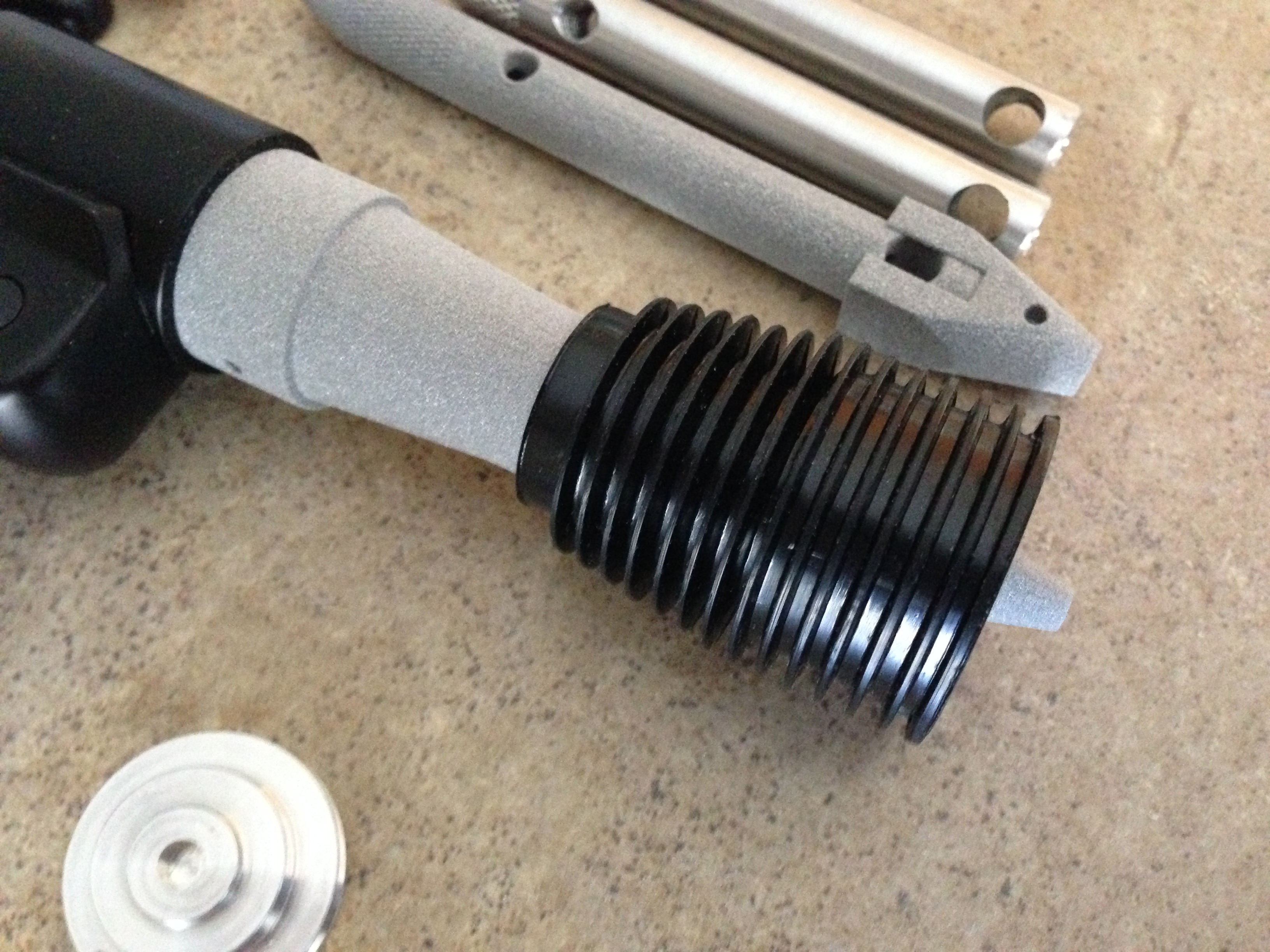

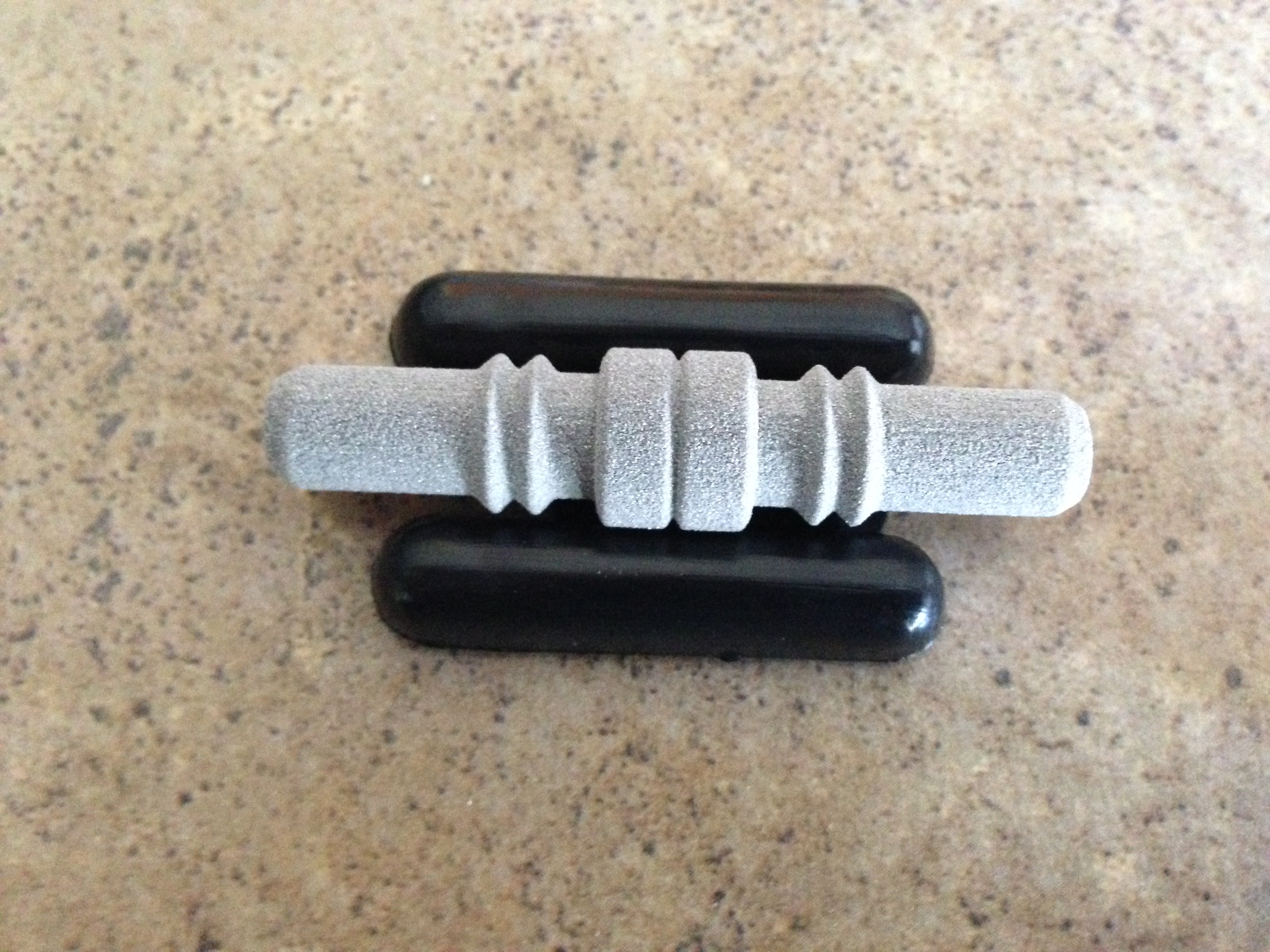

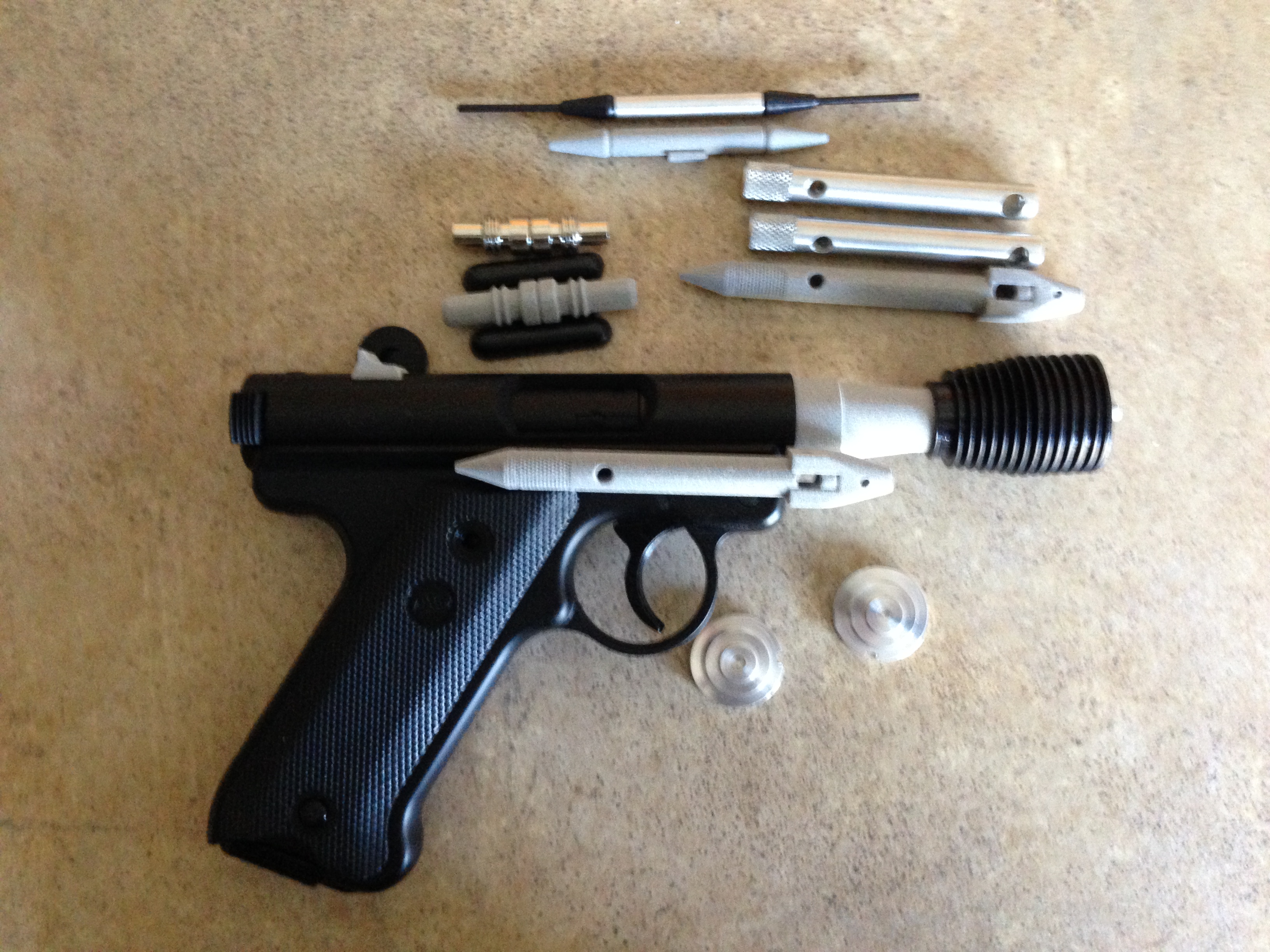

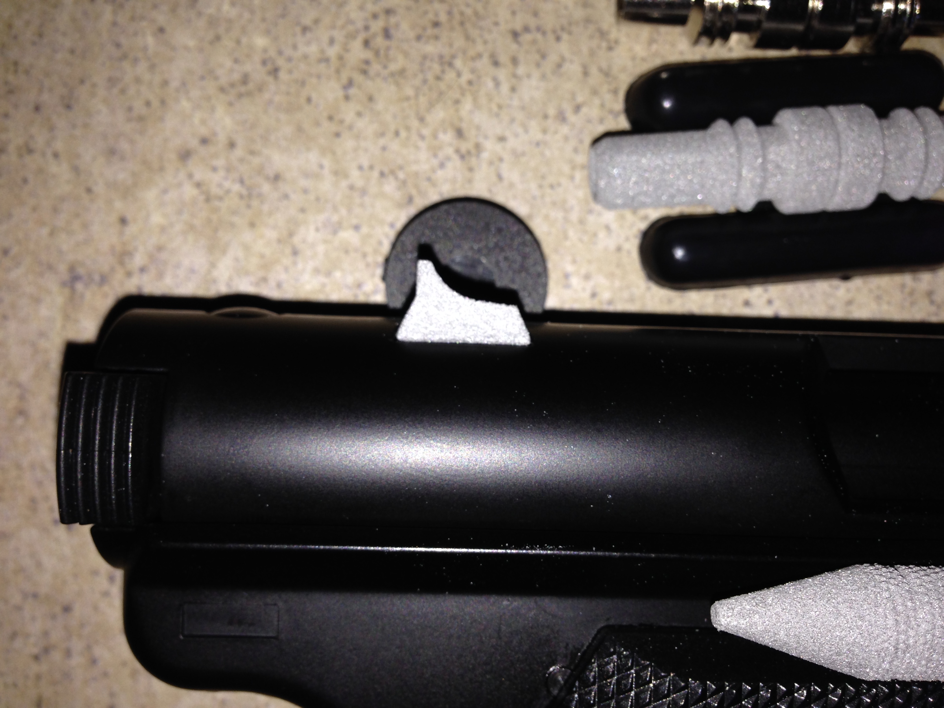

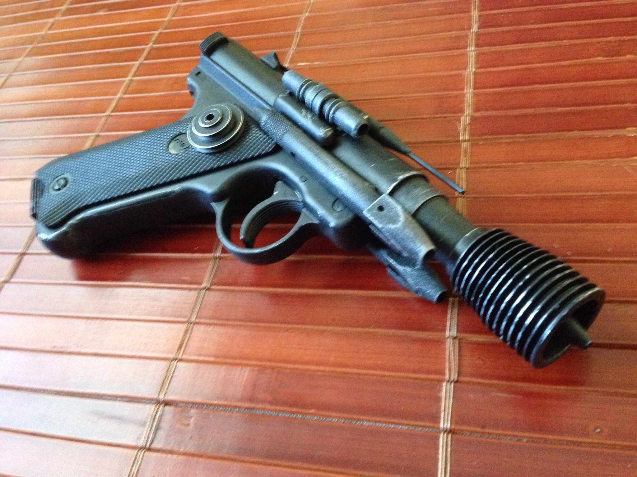

Ok, so after asking questions and reading "some" of this thread ...it's kinda long .... I've started on my greedo blaster .
Having recently purchased a 3d printer ( boooo hisss... yes, I know....) I decided this would be a good experiment with it .
There is a fabulous file on thingiverse of this blaster , so I've printed and half assembled it . I've used a couple of ally parts , just because I had them , but the real thing about the ally parts is how well they match the 3d printed parts ... showing just how good the files really are !!!
Here's where I'm up to now .
Sent from my iPad using Tapatalk
Just a quick update .
3d file on thingiverse is by "straeker" who has some cool stuff on there , and hyper accurate dimensions.
Ally code discs are from " aluminium falcon " on Facebook , who does tie greeblies in the uk.
The two hole sweeper arm , extra hole for bobba fett , from RS Propmasters ...who need no introduction here .

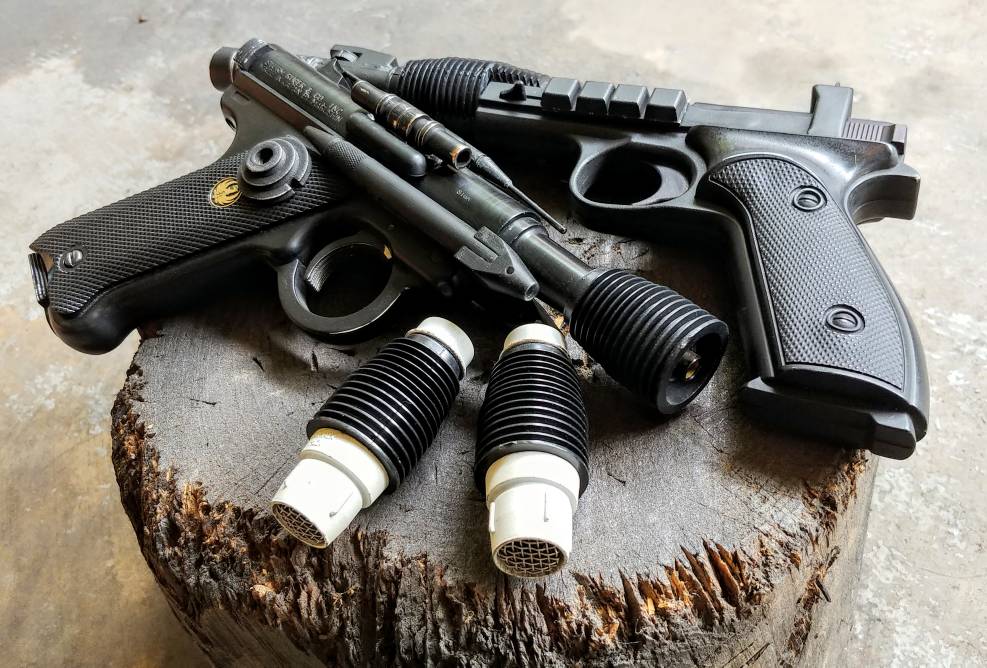

I don't believe so, no. But I can check, since I've got a real mkII as well as the airsoft, although my airsoft isn't a KJW. Mine is a Marushin.
I believe the problem is there are different inner workings and parts underneath the grips on both the real steel and the airsoft. I wanna say I tried to put real grips on the airsoft once before, and wasn't gonna be able to do it without major modifications.
MJF, it was years ago that I thickened that trigger guard, but I think I used a couple strips of .060" sheet styrene, heated with a heat gun so they'd conform to the shape of the trigger guard. Then CA glue, then Bondo. Then paint, of course.
Anything like that should work, like Apoxie Sculpt or JB Weld putty. I've been meaning to revisit that trigger guard and make it a bit more accurate. I'll get to it, eventually. I'll have to look at reference again, but I believe some material should be added on the inside of the guard, probably more so than the outside.
Very similar to the SE-14R, the putty or whatever was used to thicken the trigger guard on that blaster was added solely on the INSIDE of the guard, as far as I can tell.
I wish we had better reference of the Greedo gun, it's been several years, and nothing better has turned up. I feel like we're still missing some detail that'd reveal itself with better pictures!
