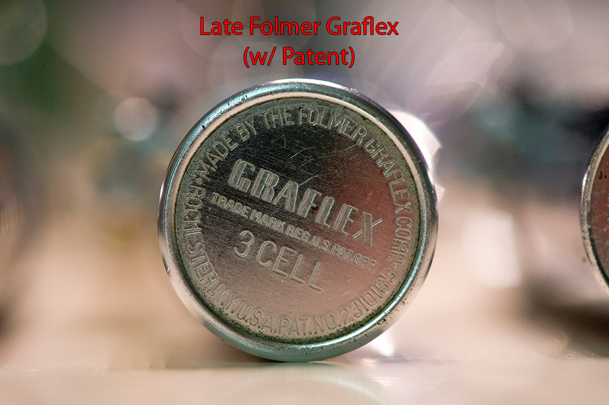

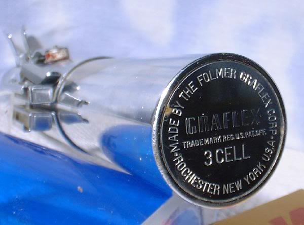

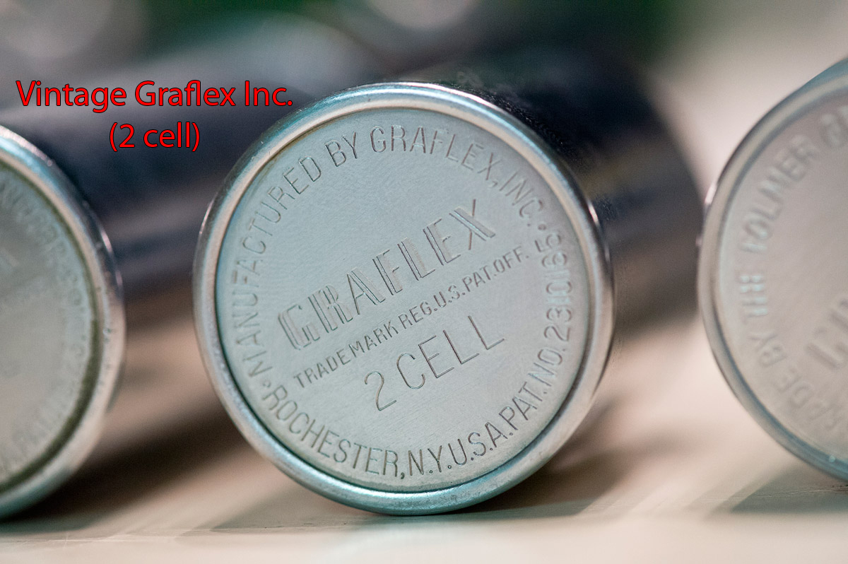

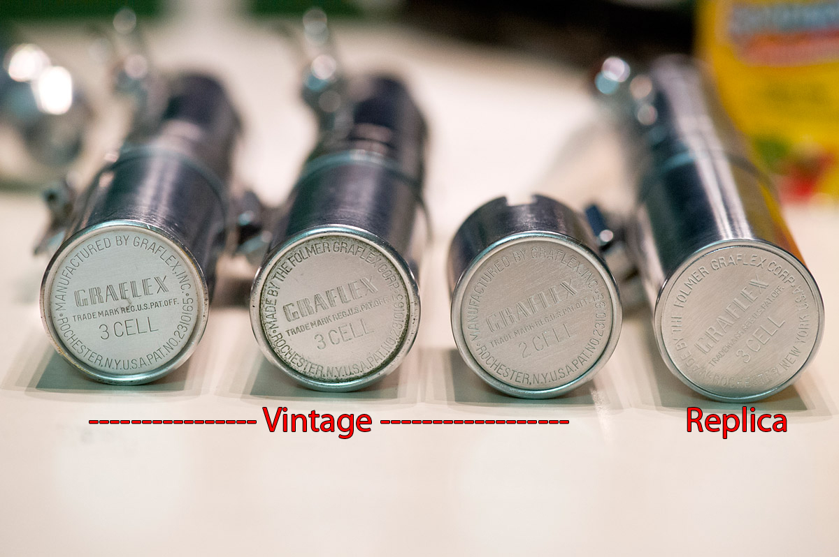

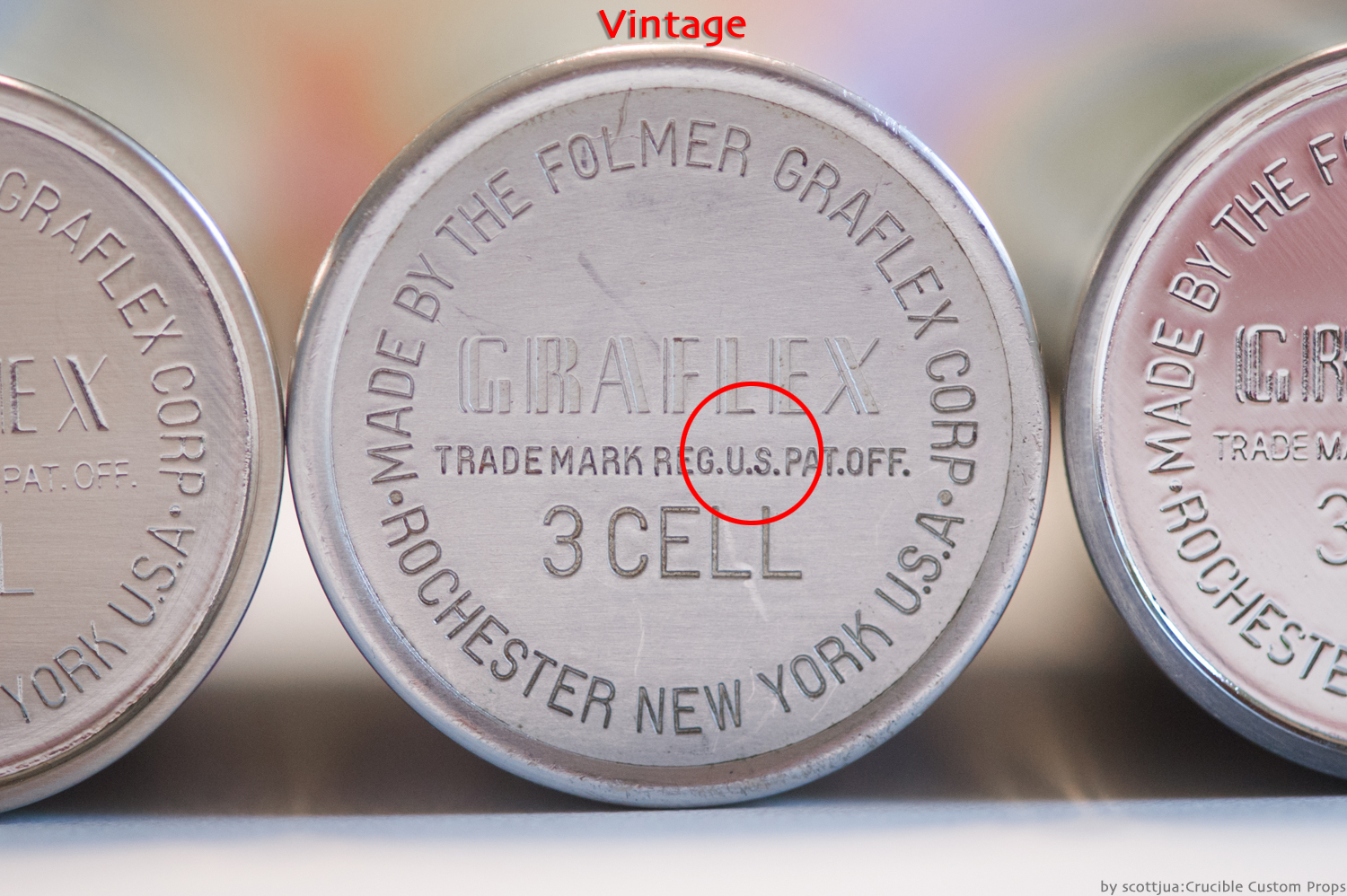

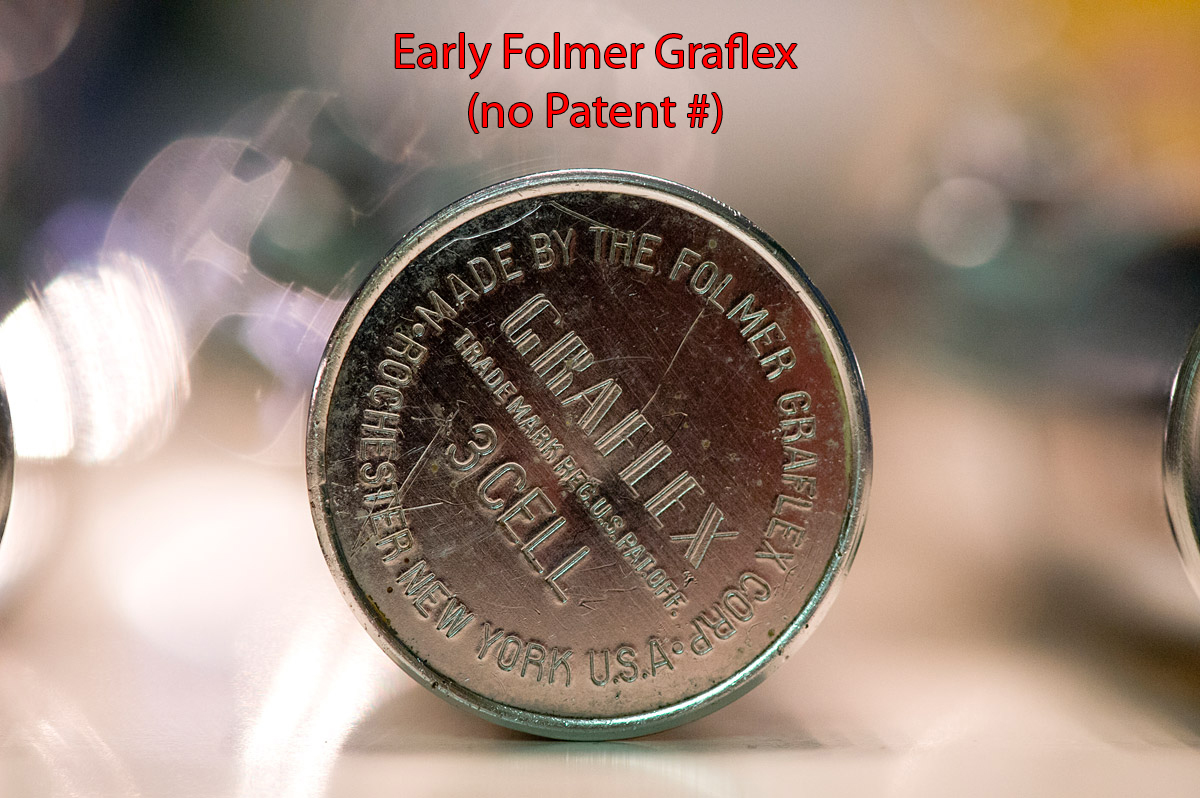

First is my findings on the Bottom Tube Stampings. There are 3 that I have found so far: Folmer Graflex, Folmer Graflex with Patent, Graflex Inc with Patent, and of course then there's the Replica of the original no patent Folmer Graflex
From what I can tell the earliest manufactured Flash Tubes had just Folmer Graflex with no patent number stamped in.
Then with Patent
Graflex Inc with patent

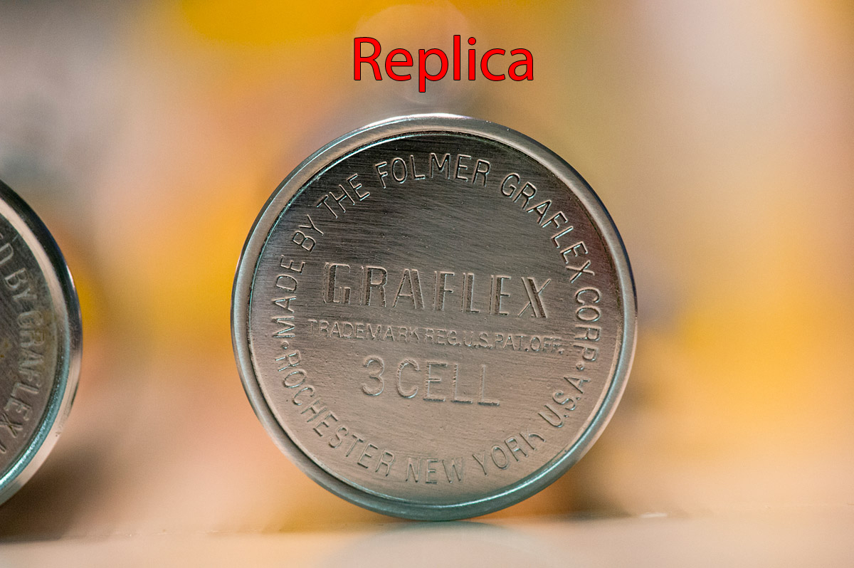

And the Replica. You can clearly see the lack of depth and detail in direct comparison. These photos at 100% really get into the grit of the metal and you can see just how shallow the replica stamping is in comparison to a real vintage.
Here's also a vintage 2 cell

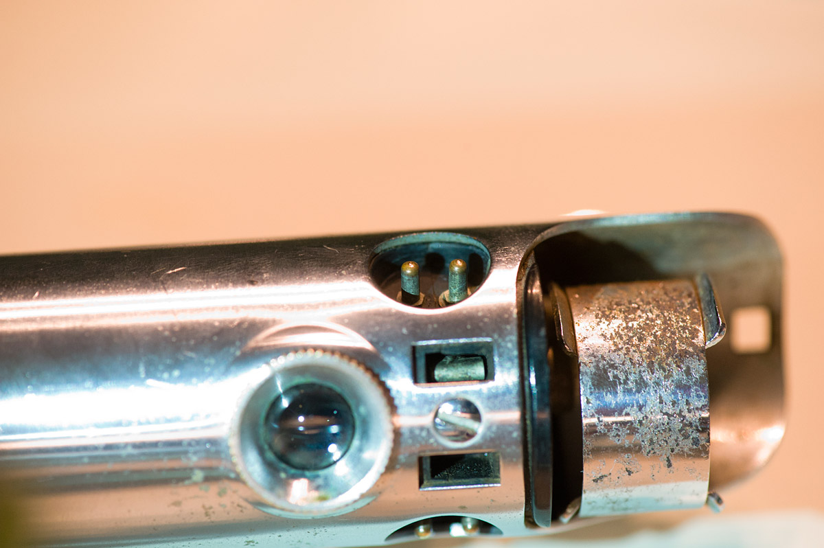

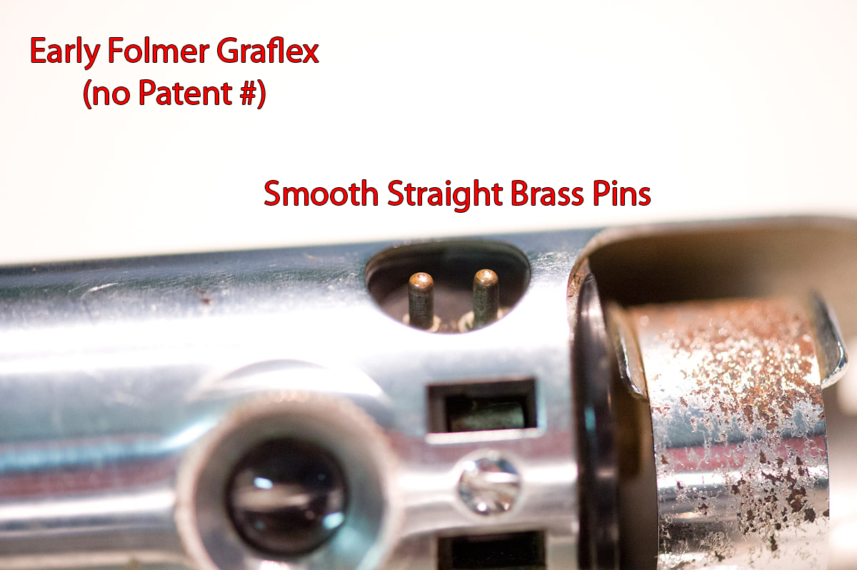

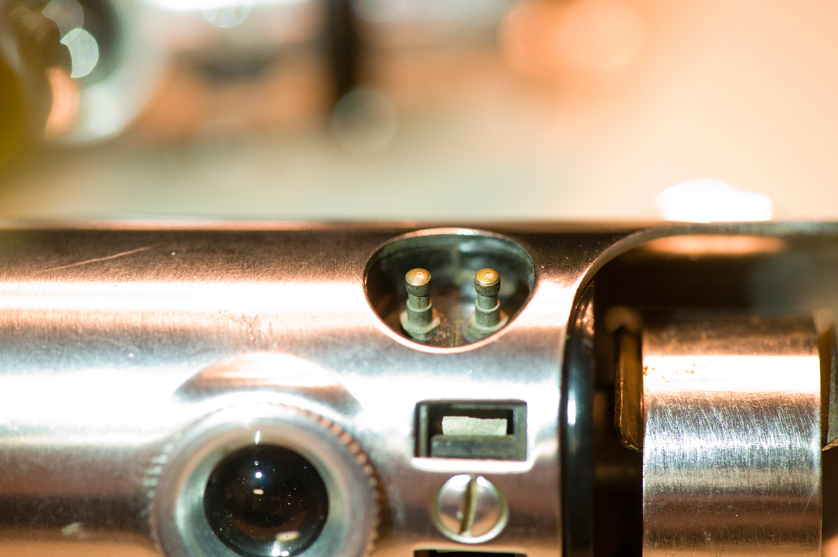

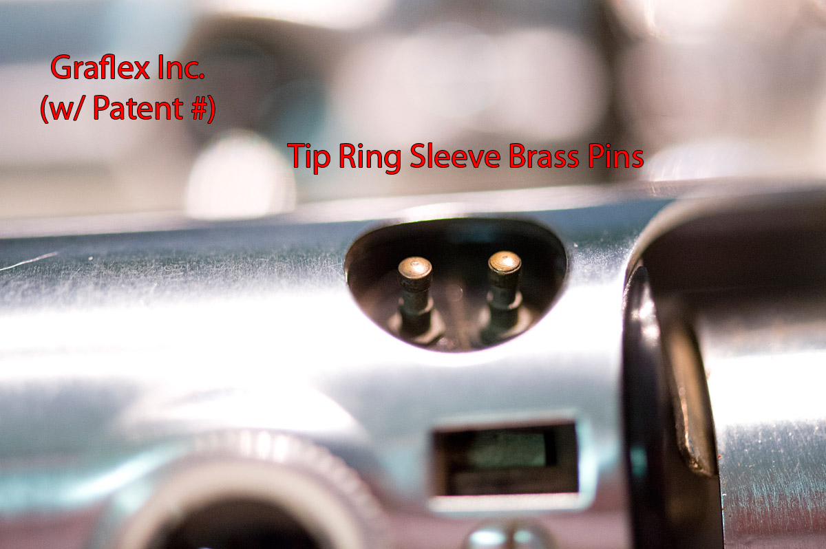

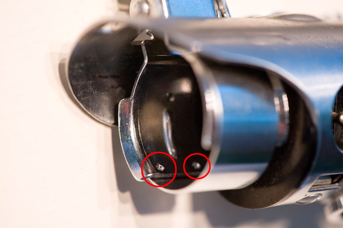

The vintage flashes also seem to have the two brass pins like mentioned earlier in this thread. Here's more shots of them:

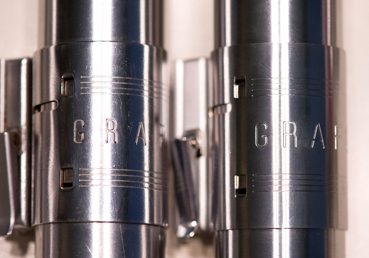

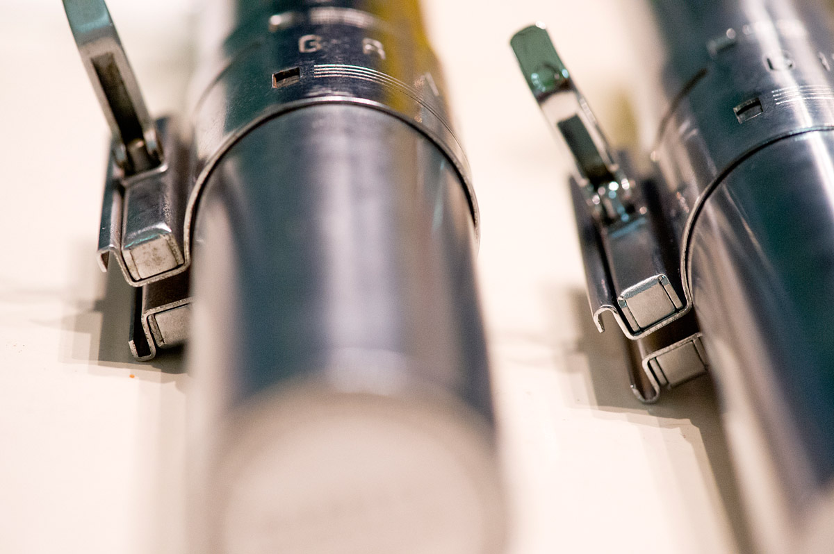

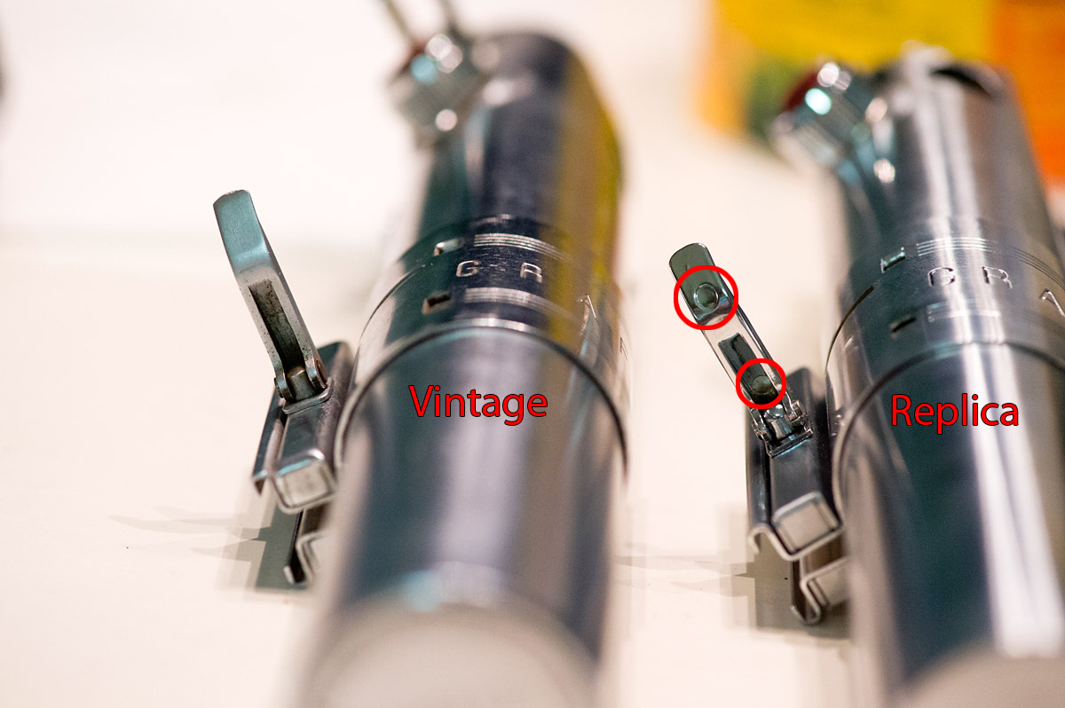

Now the Clamps. The Vintage clamp as far as I can tell has no appreciable design change. Some seem to have black lettering, and others no color to the lettering. Here's a shot of a Vintage clamp next to the replica. The stamping is pretty good on the replica and comes super close. You can tell that there's a similar lack of depth to the markings to the bottom stamp
The lever is the biggest tell... and my replica has some even easier to spot (other than the polished finish) mold or cast lines on the underside of the lever.

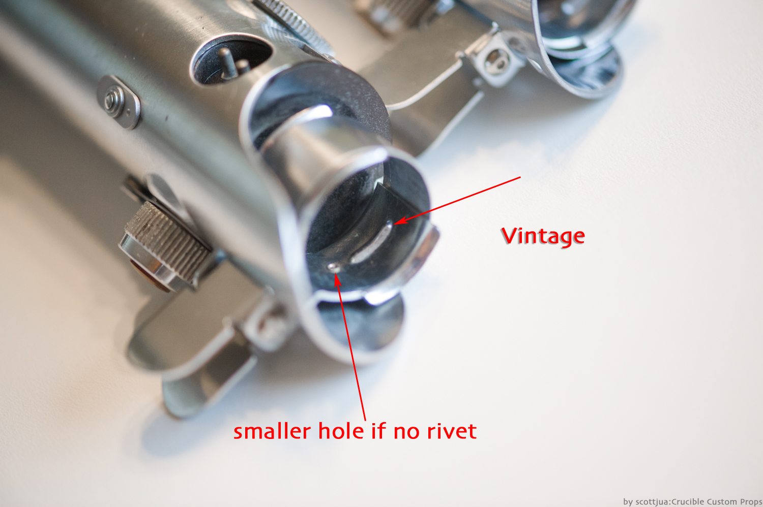

The bulb holder set screw is also different. The vintage has a rounded flat head screw that counter sinks into the tube nicely. The replica has a flat screw that sticks up a little.

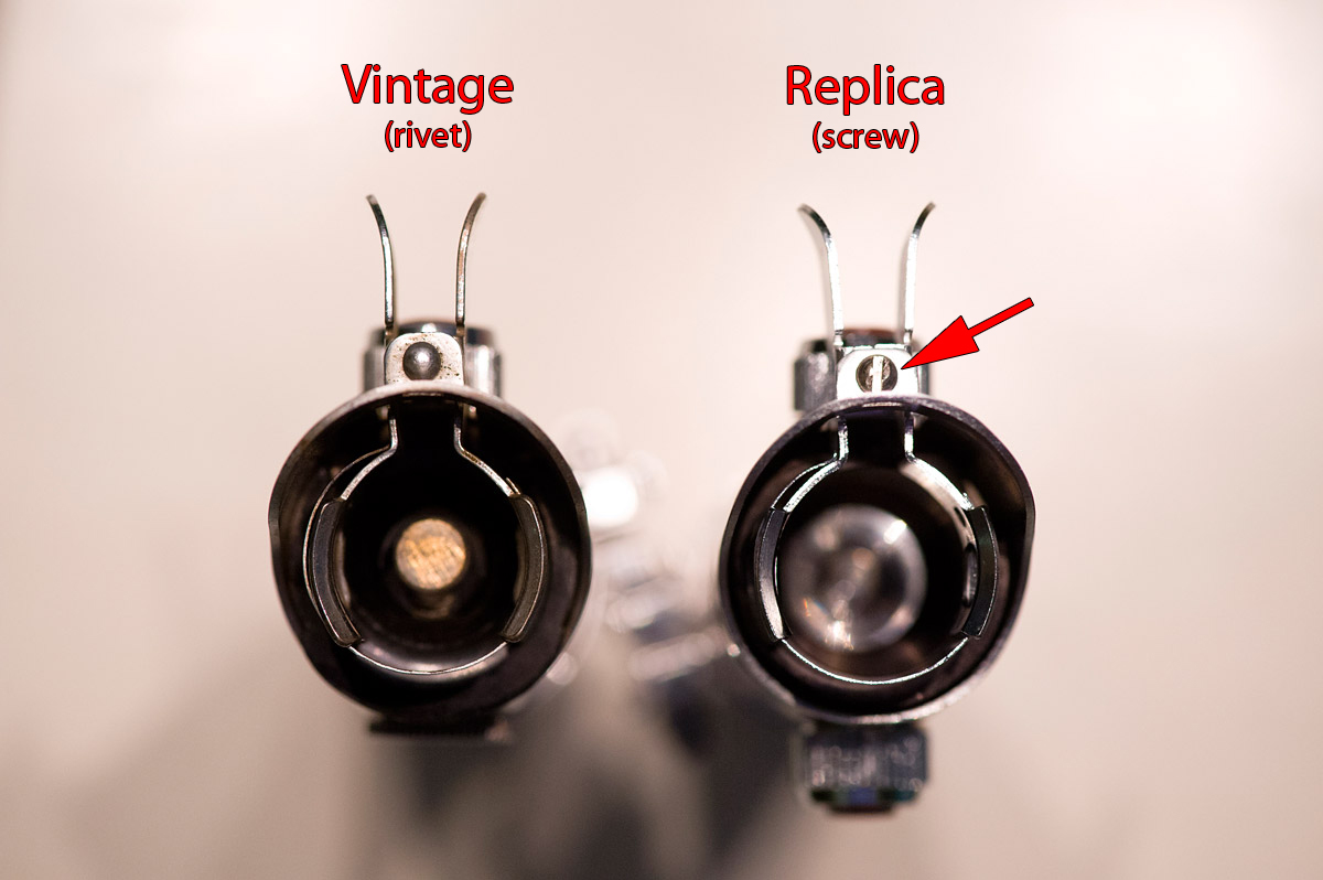

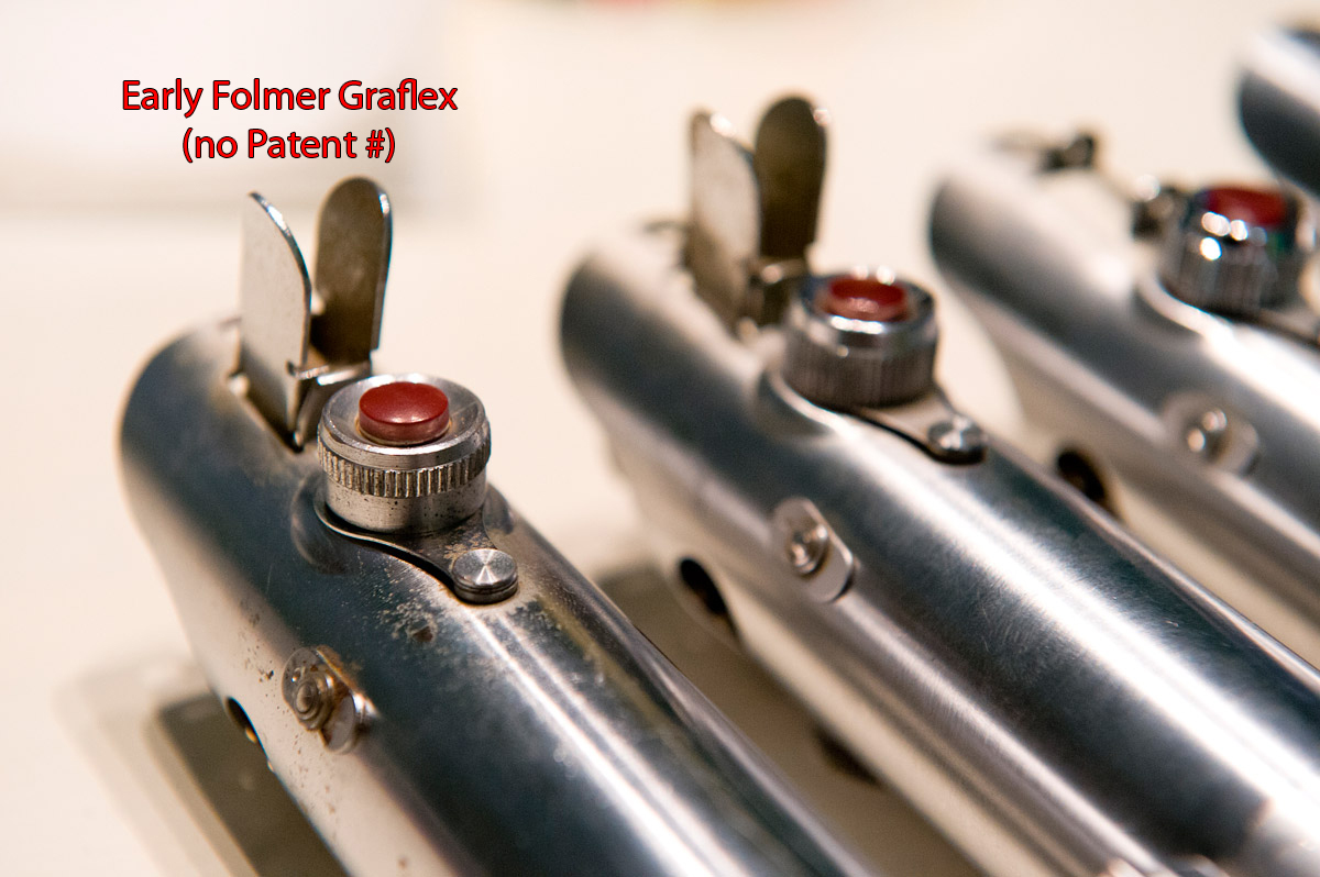

The bunny ears are held on by a rivet on the vintage and screw on the replica

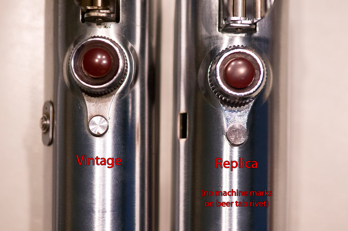

The "beer tab" rivet is also different. The vintage's rivet shows fine machine grooves, and has a chamfered edge. The replica is flat and generally smooth.

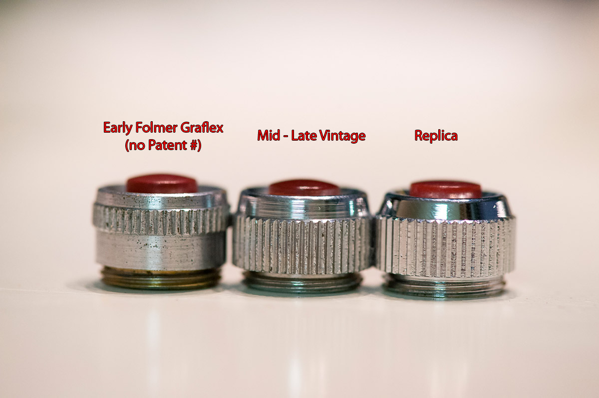

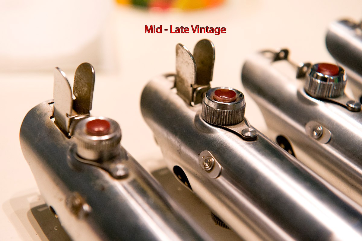

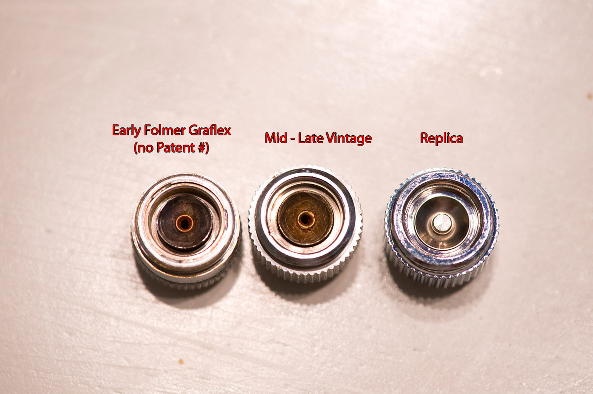

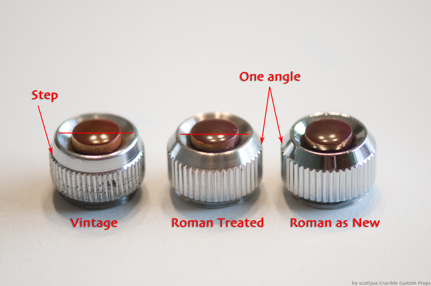

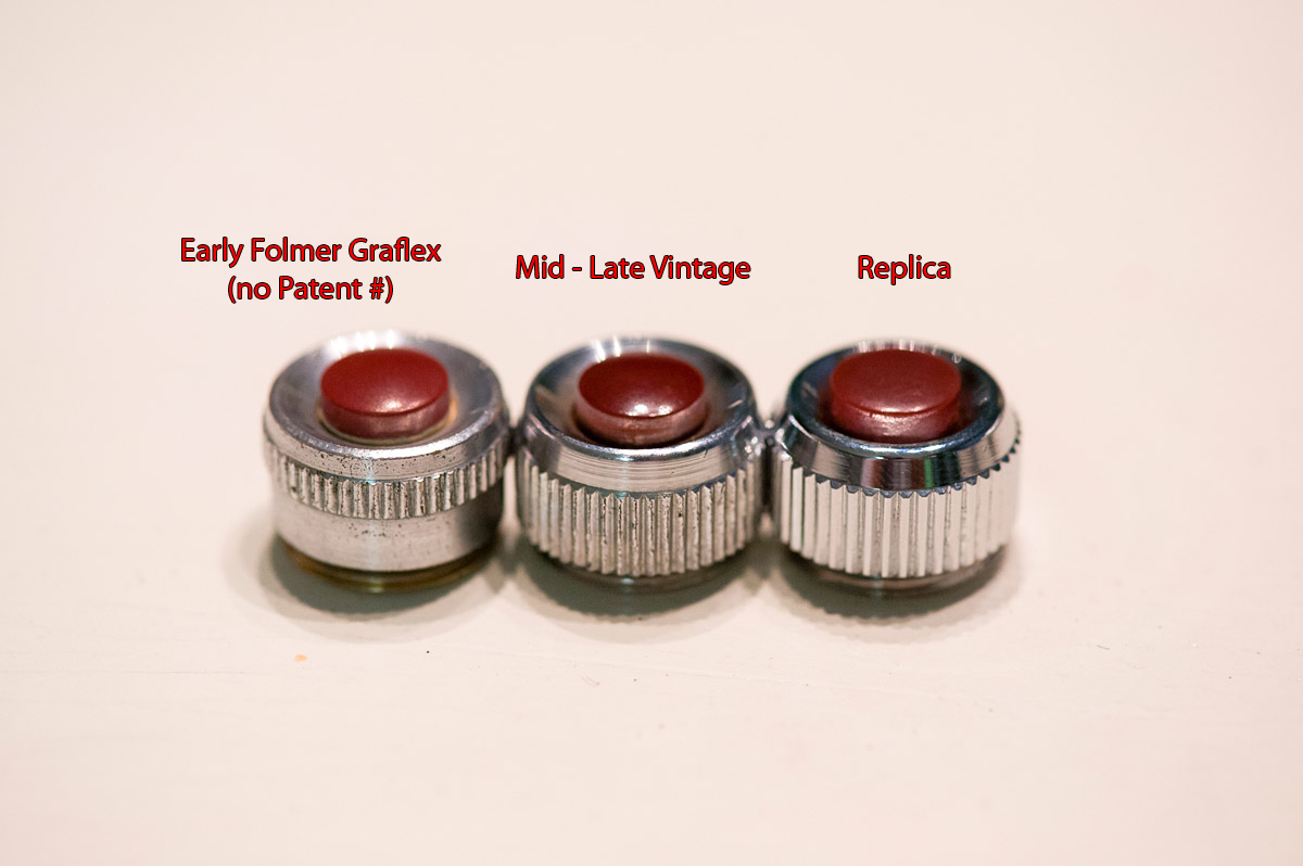

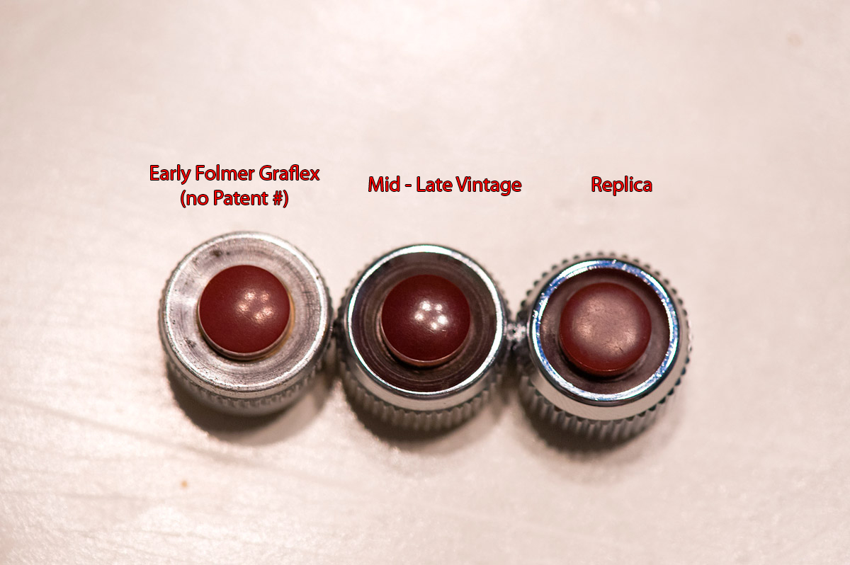

Now more shots of the three buttons I've seen (is there a fourth, parfaitlumiere?)

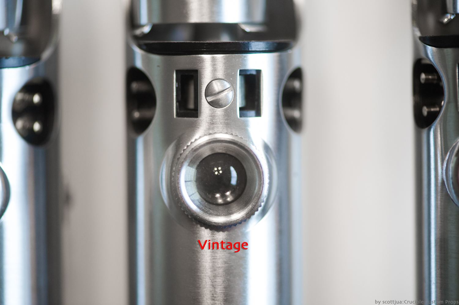

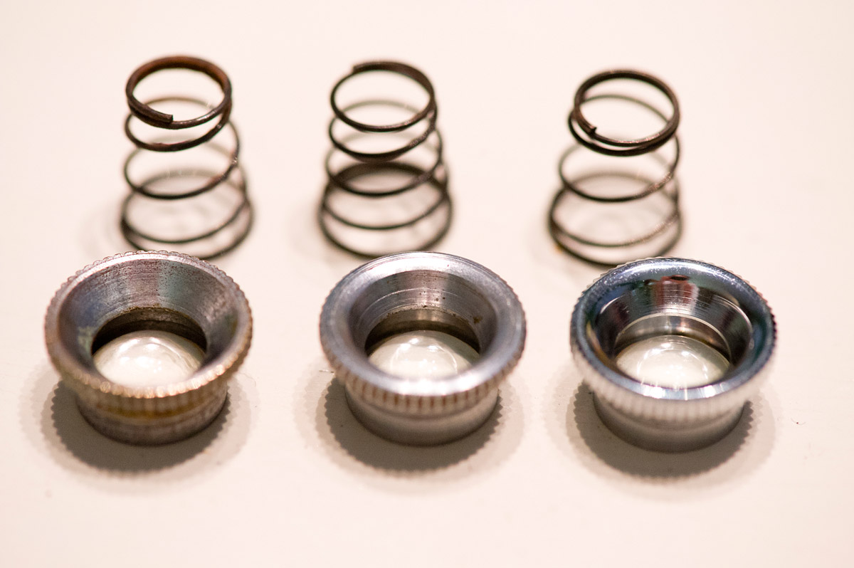

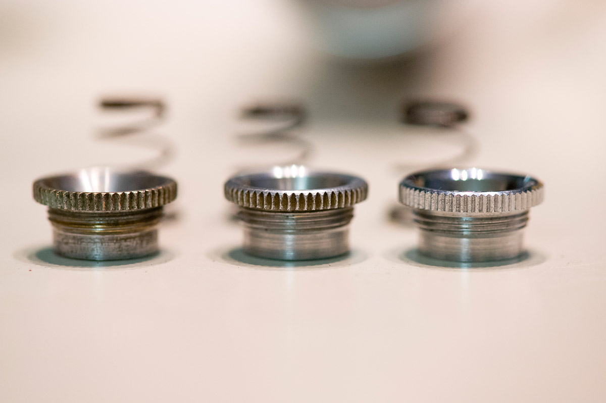

The Glass Eye: I was surprised to find three distinctly different vintage glass eyes. Check these out: The one from the early flash has a very flat top lip with more right angles. The middle, is more curved, but still has machining marks. The third is the later model flashes with a polished inside flare.

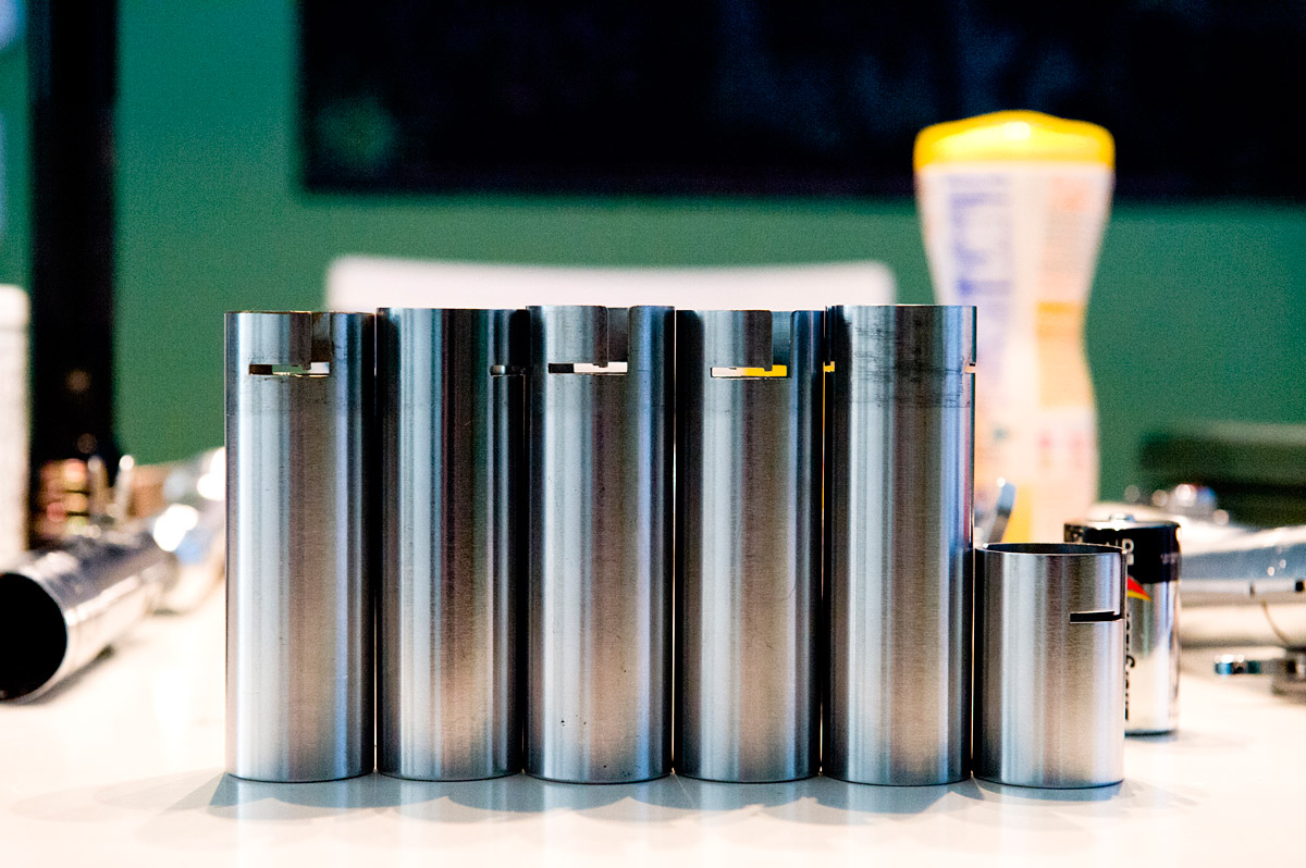

First up... the battery tubes. They're all different...
The Folmer Graflex with Patent is the same size as the Replica, the Graflex Inc. w/ Patent is the same as the Folmer Graflex with no patent. The Anomoly is the one tube I have with the modified clamp. It has a brass edge where the others do no, which leads me to believe it may have been shaved or cut since it is shorted than all of them. Weird.
From L to R: (Shaved?) Graflex Inc. 3 Cell, Folmer Graflex w/Patent, Folmer Graflex, Graflex Inc. w/Patent, Replica, 2 Cell

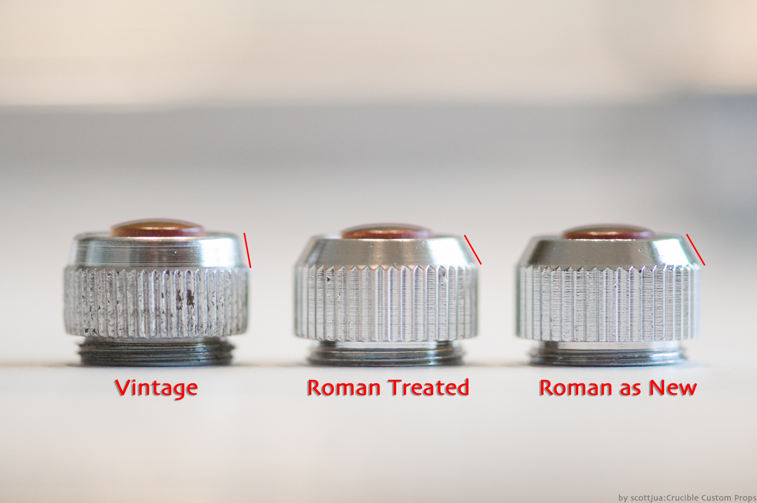

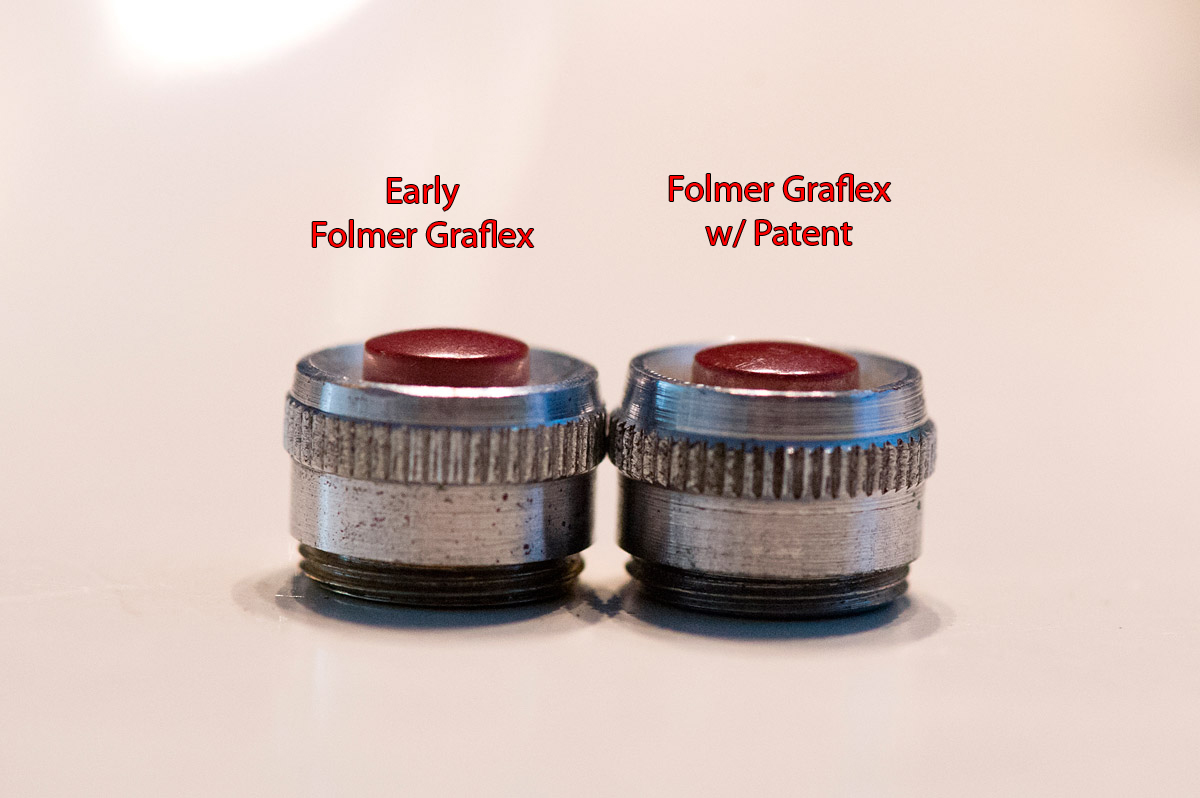

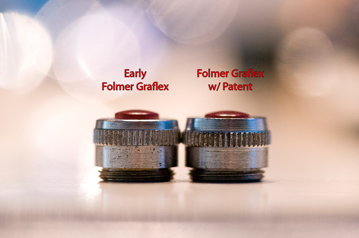

Next when I was looking closer, the early buttons with short knurling are different too. The early Folmer Graflex *is shorter overall slightly, with slightly longer knurling, and a more tapered edge on top. The Folmer Graflex w/patent has shorter knurling, but a beveled edge of the knurling that is more pronounced, and has a flat top.

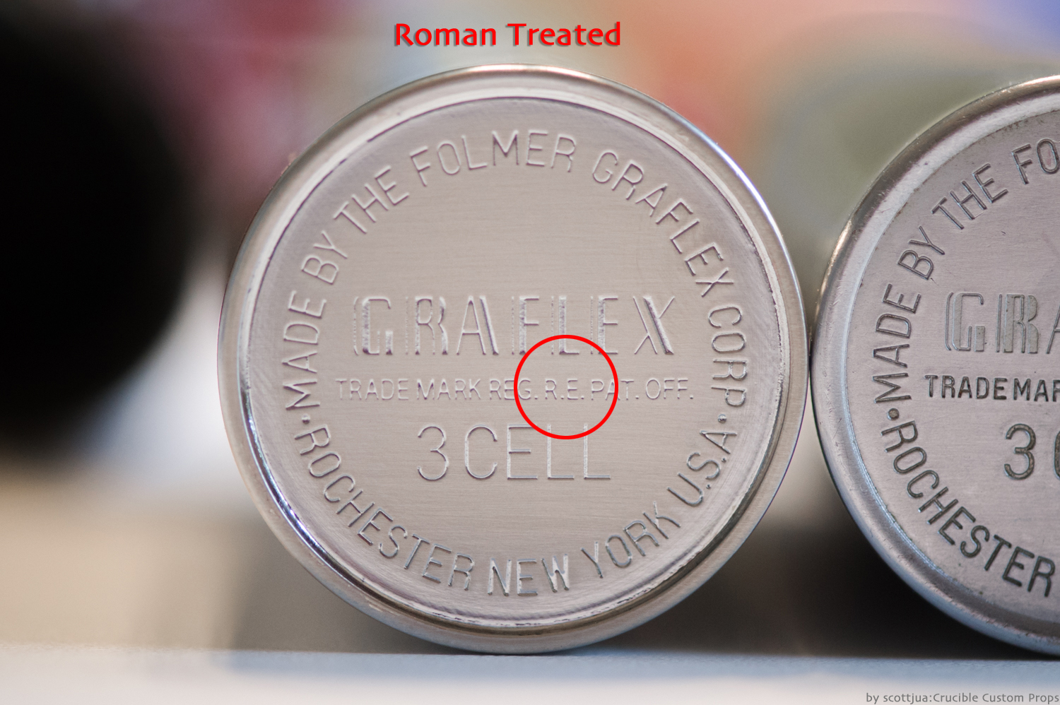

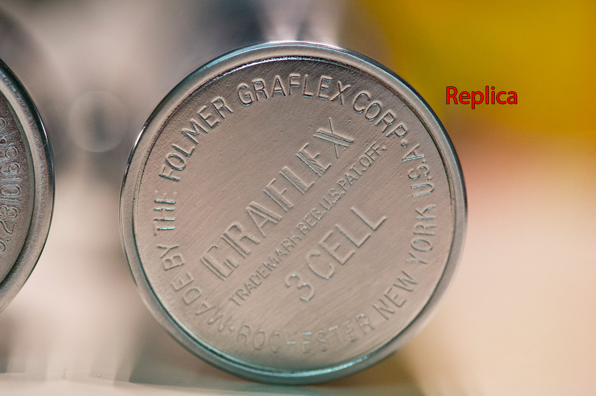

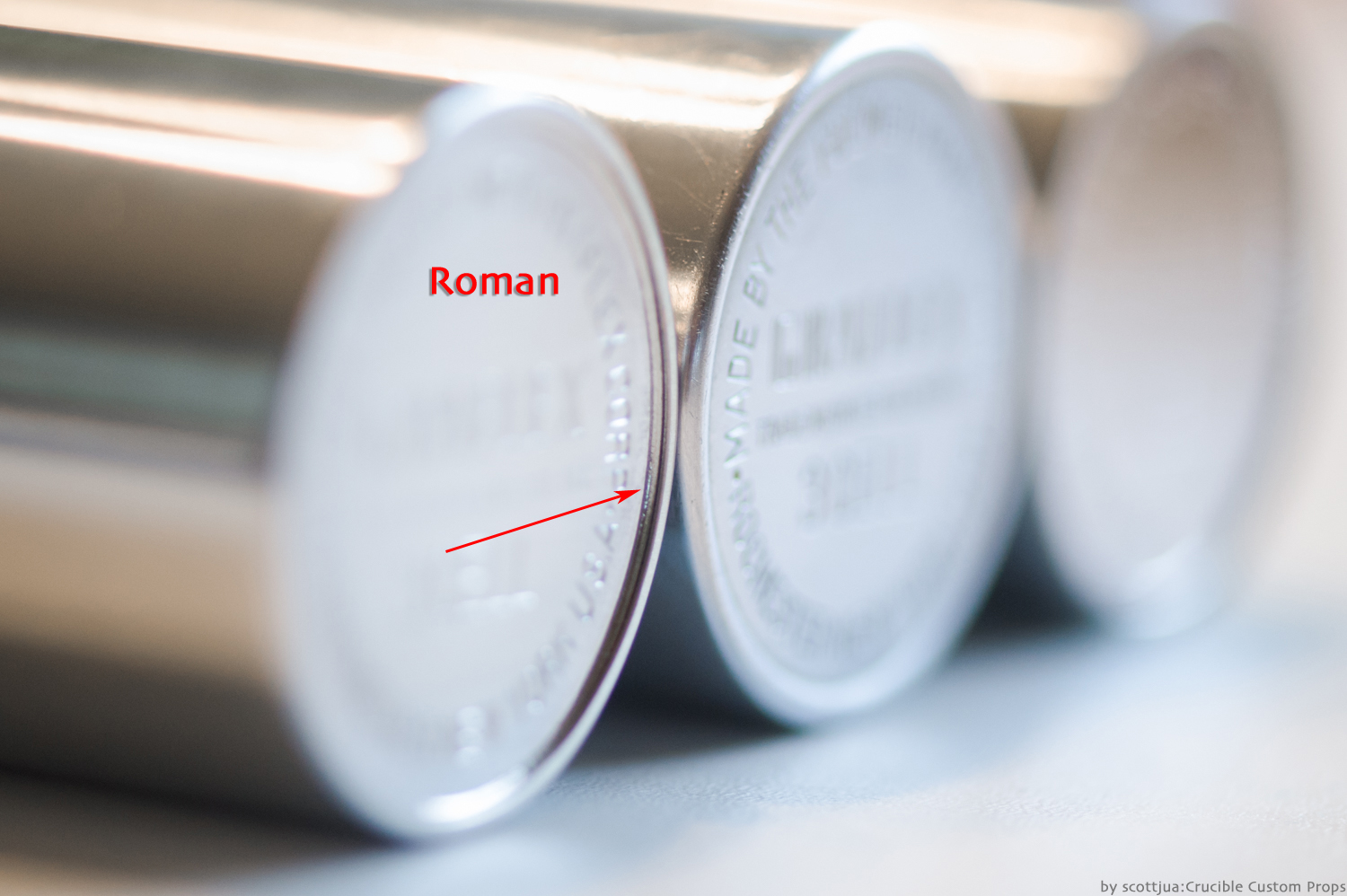

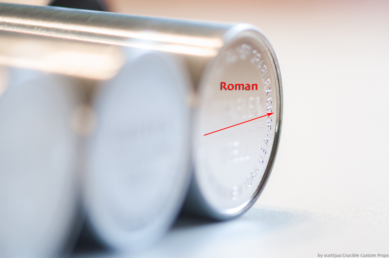

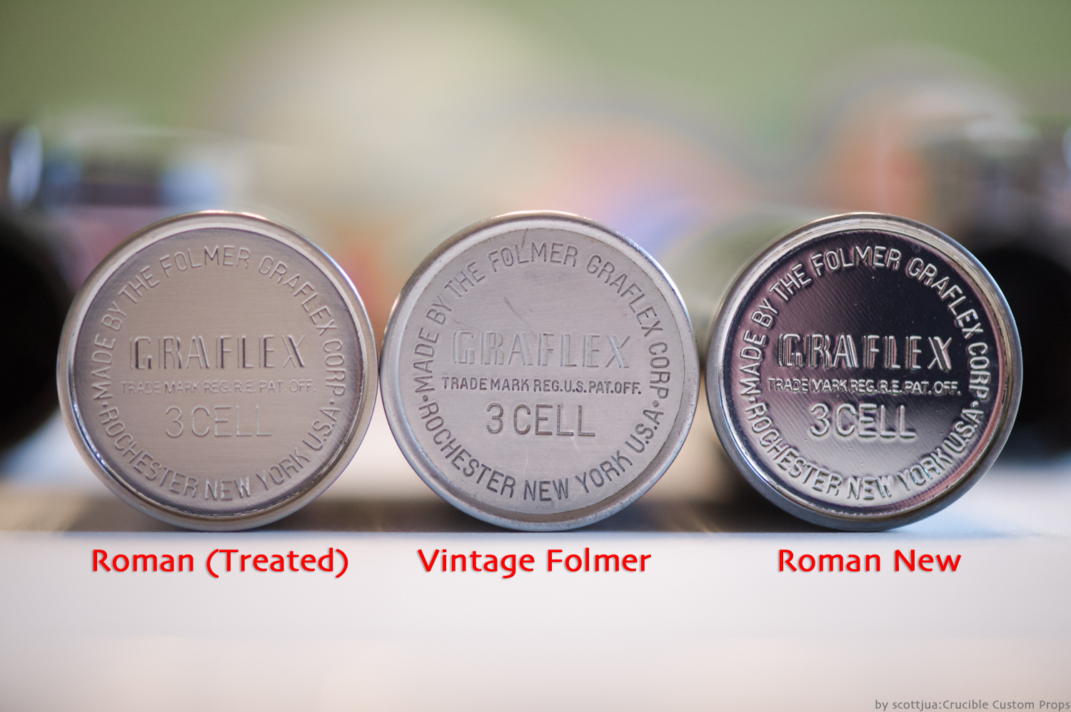

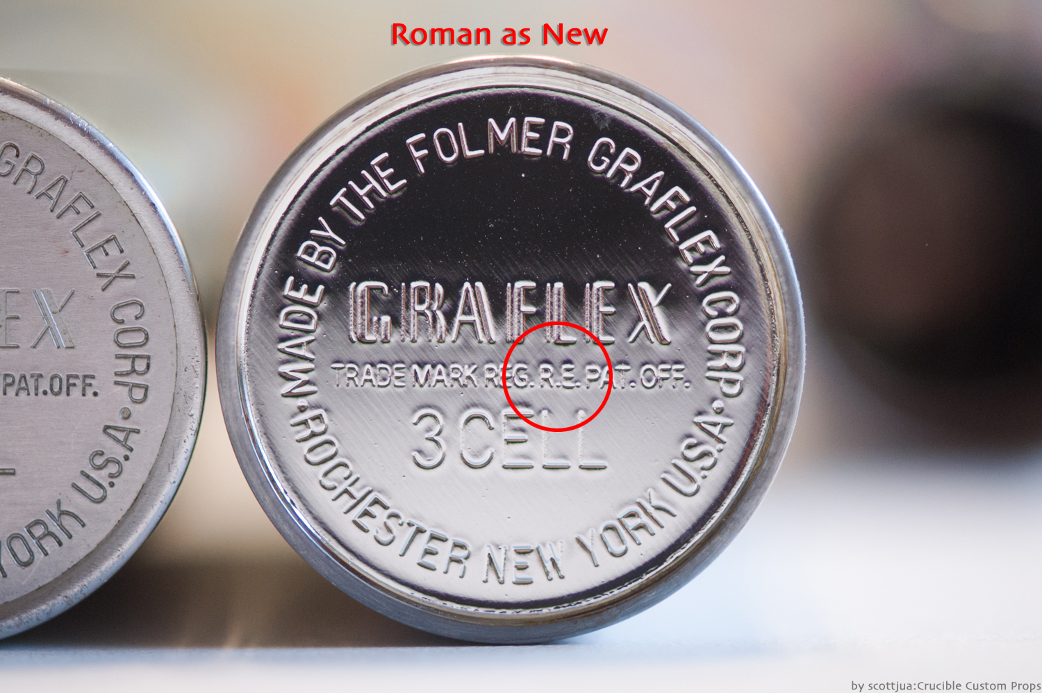

Roman’s new replica is based on the more sought after FOLMER Graflex corp variant. On the far right you see how they have been showing up. With the bottom cap nickel plate in very shiny chrome-like appearance. Far left you see, what a scotch brite pad will do with minimal pressure and work.
You can easily spot the tell for the Roman's Empire replica

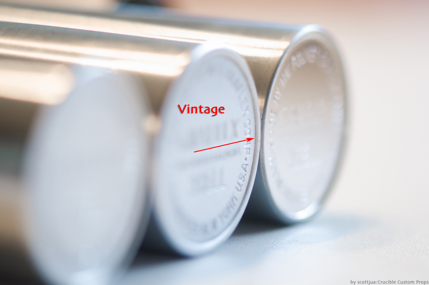

The manufacturer hasn’t completely rolled the crimp on the bottom cap, causing a sharp visible line

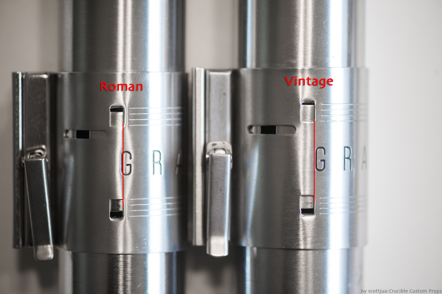

Aside from some obvious finish variances, the new replica clamp with painted lettering has one obvious tell. The “G” and “X” in the word G R A F L E X stamped across the clamp face, overlap the registration bar stamping holes. The real vintage clamps line up with the leading edge. Older Parks clamps come short in comparison. That said, and not pictured, Roman’s summer 2016 stand alone clamp run is DEAD ON to a real clamp… but much cleaner in finish.

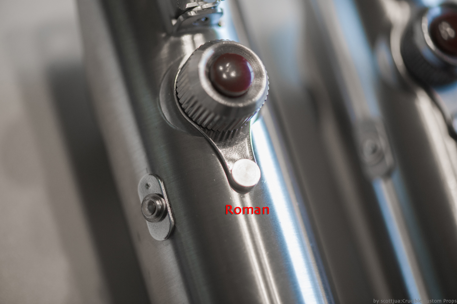

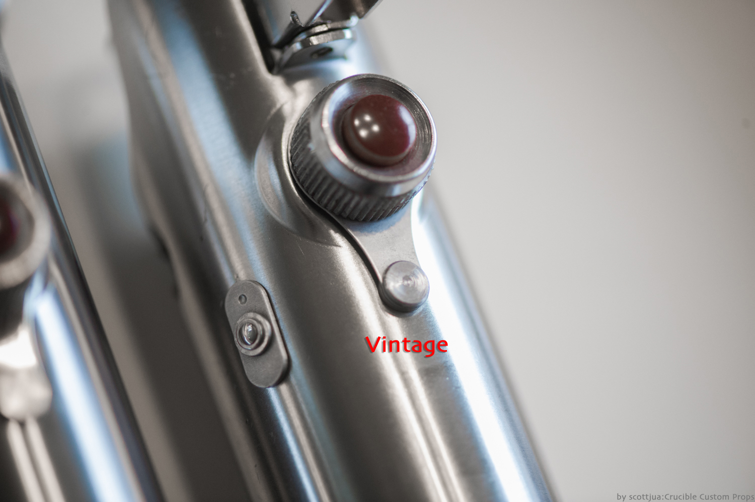

The “beer tab” on a vintage has a more muted, bead blasted finish, where the new replica is very shiny. The beer tab rivet is turned now, and exhibits the turning/machining pattern, but doesn’t seem to have the correct chamfer.

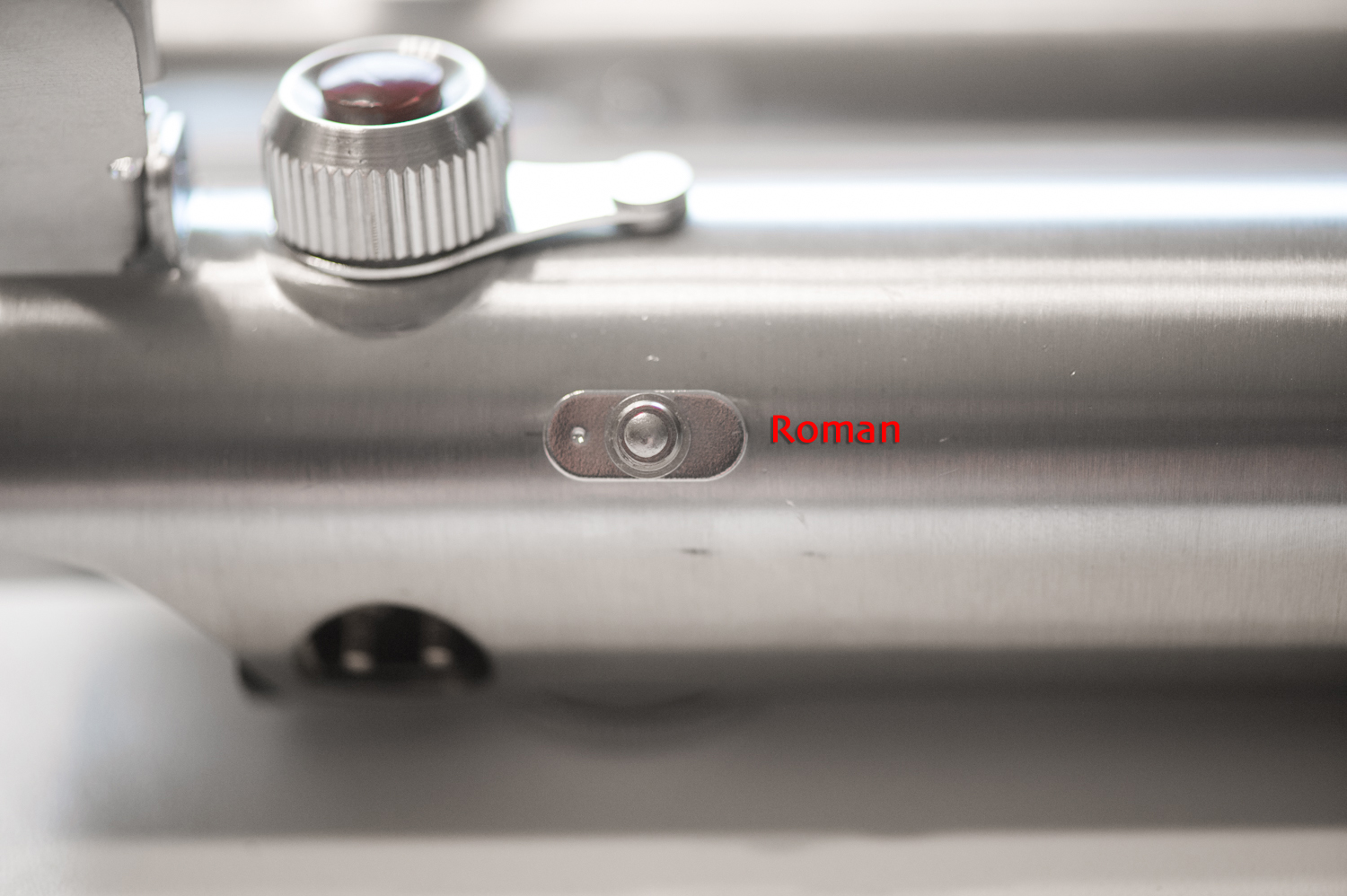

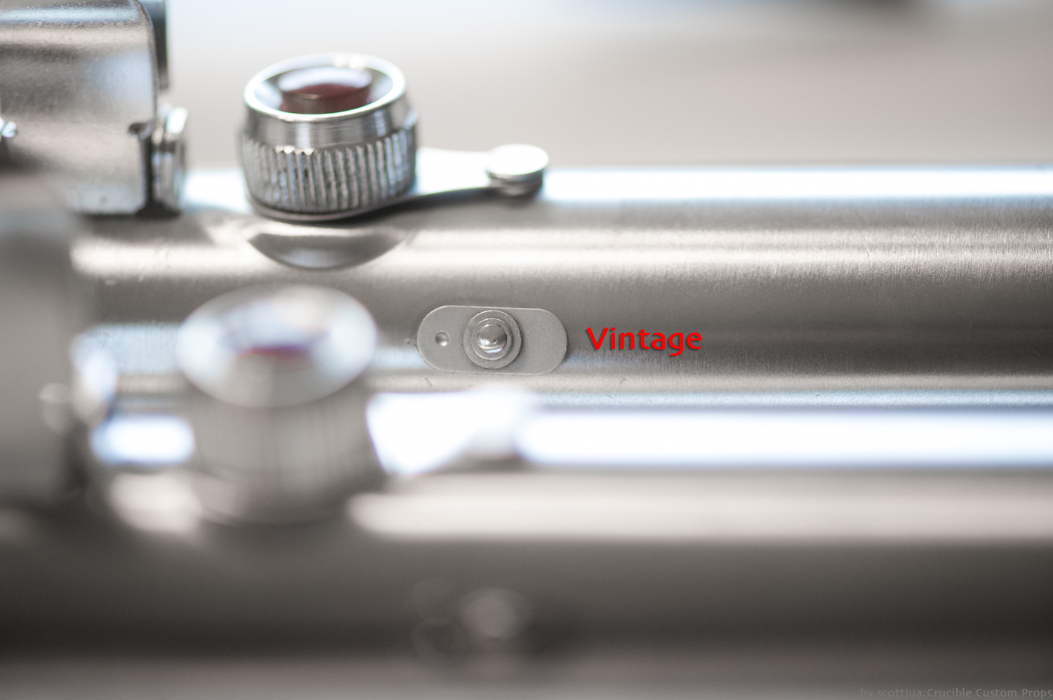

Slight differences can be seen in the slide switch as well

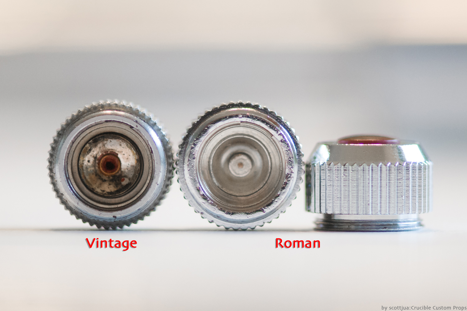

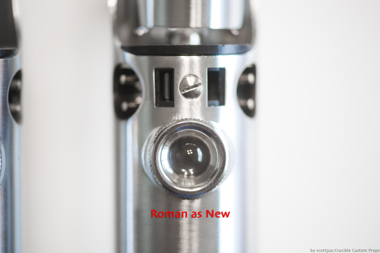

As new, Roman’s Glass Eye, is of the shiny variety, that was more common on later Patent Graflex Inc. Flashes
Vintage FOLMER Graflex flashes had a few variations of glass eye. The more common was a brushed or satin finish to a rounded bevel

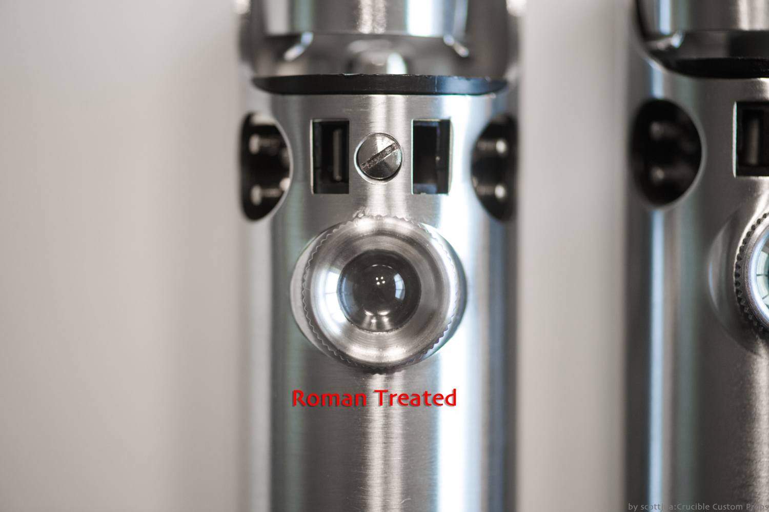

A lathe and light scotch brite pad work can transform the shiny Roman glass eye

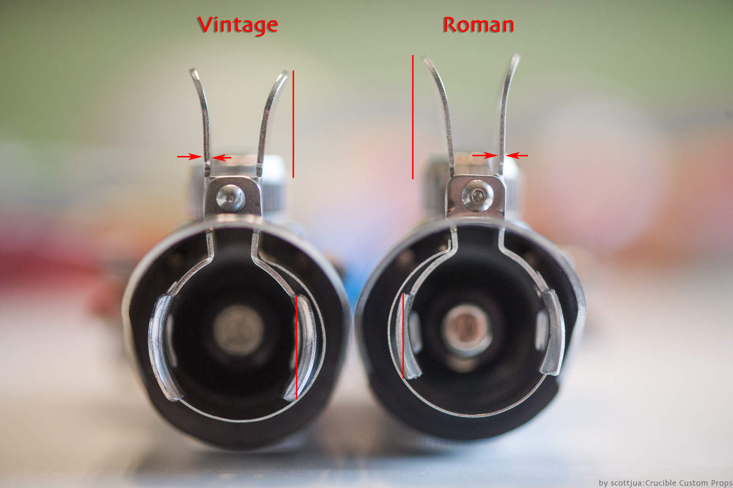

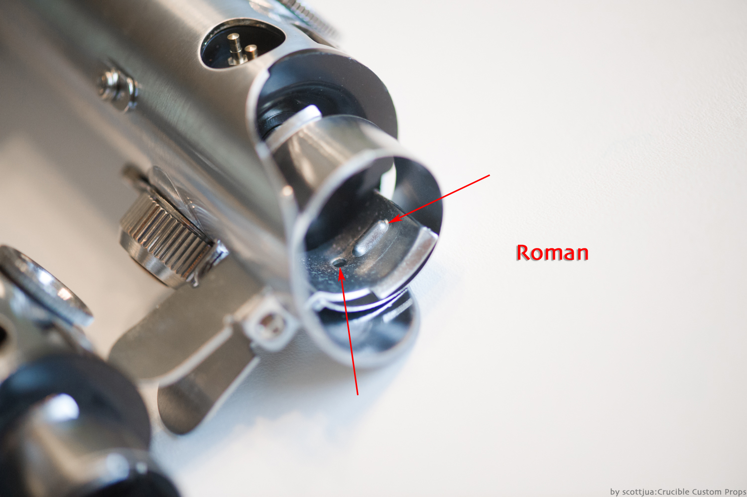

Easily overlooked, but once you see it you can’t miss it… The bunny ears exhibit numerous tells. The Roman ears are taller and of slightly thinner stock. Shapes are different as well.

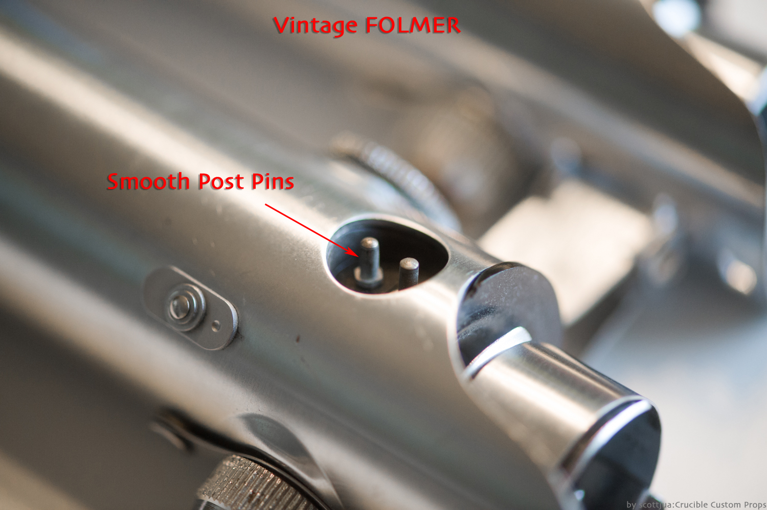

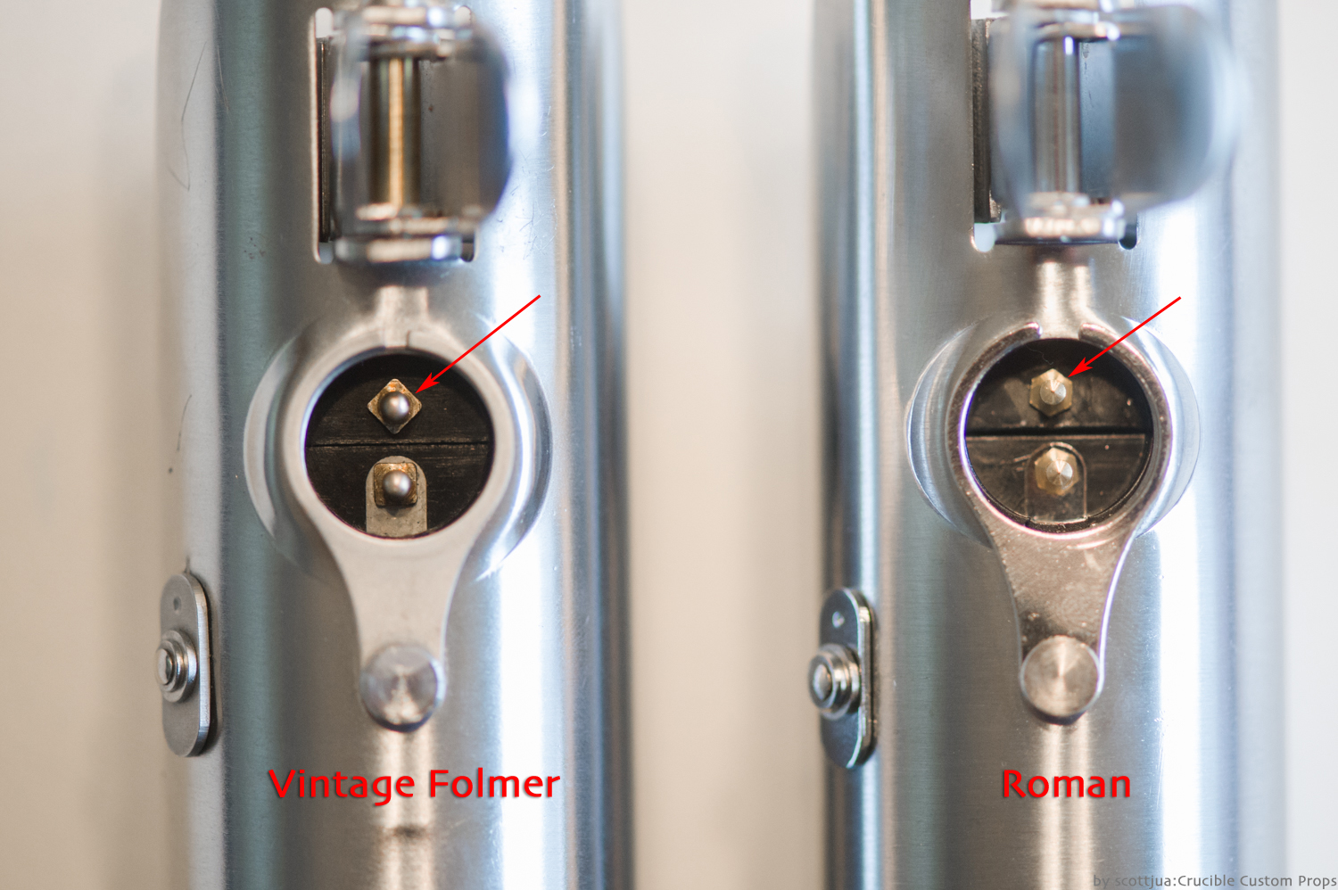

If I remember correctly… ALL of my FOLMER flashes had straight, smooth post sync pins

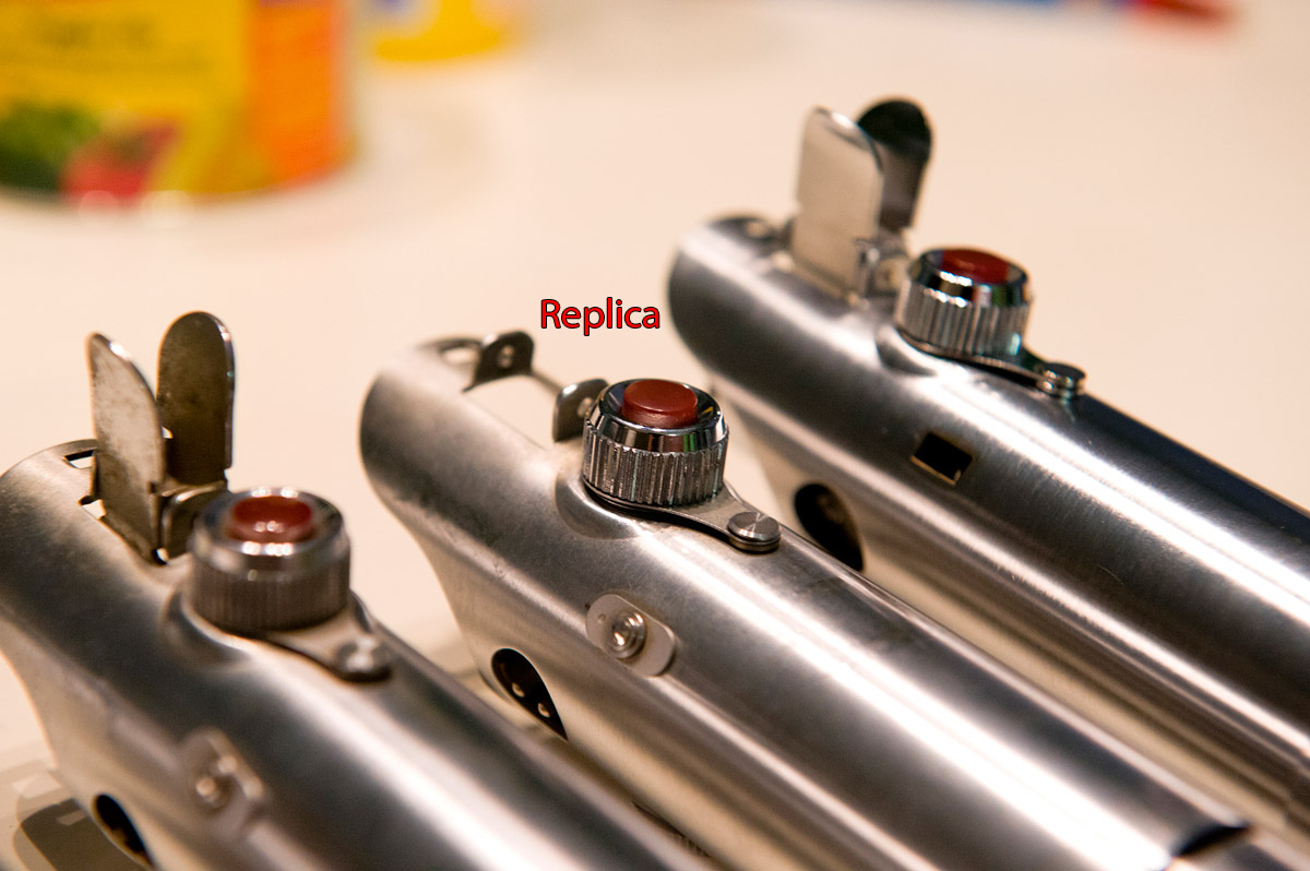

The red buttons on the replica are ALMOST indistinguishable from Parks’ old replicas. But very obviously NOT the same as a vintage. The shapes are different, as are the finishes. However, you can achieve a more vintage look on the very chrome replica button with a lathe and some scotch brite.
Finally… MOST if not all REAL FOLMER Graflex flashes have square based top sync pins.
