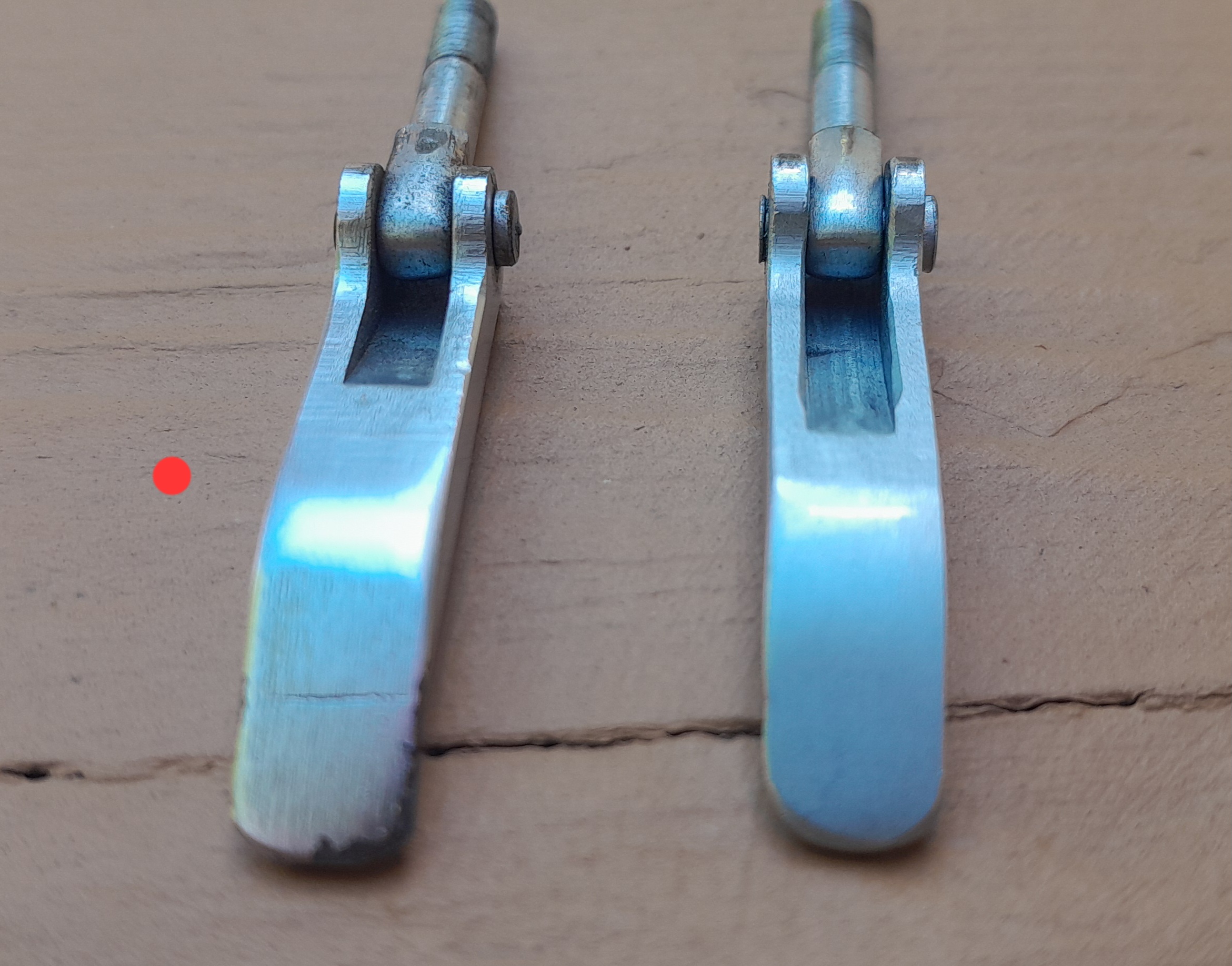

Hey all, recently picked up a Folmer flash from an auction and was curious about the lever it came with. It's shinier than an Inc but has a larger rivet. I'm pretty positive it's vintage but I've just never seen one like this. Here it is compared to an Inc lever. Red dot for shiny 'Folmer'. Any thoughts? Brushed up Inc lever maybe?

Hmm, that's peculiar since the majority, if not all Folmer variants, I have seen definitely have the smaller, shorter rusted rivet head and most often have shiny levers.
I was very confused when I received it, do the Folmer variants have a plating or polished finish? This one seems polished and smooth
The majority of vintage Folmers I have received have the shiny finish. That one could be a rare shiny Inc. hard to say for certain though.
Could be lol. I'm thinking someone probably just brought it over to the wire wheel to clean up possibly. Who knows, unfortunately now I need to find another lever for my flash LOL. It'll look nice on my ANH saber though.
