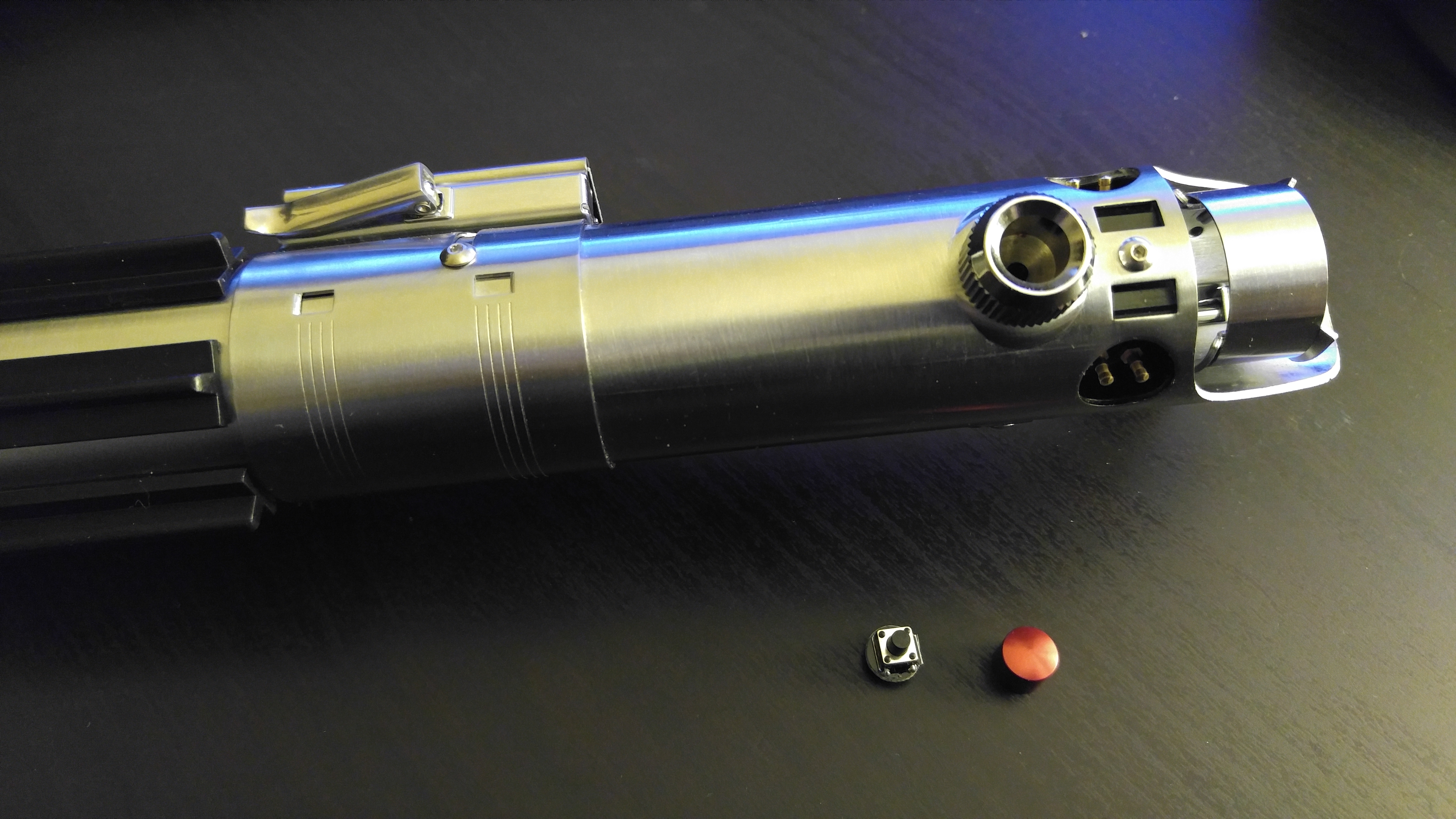

As an aside, anyone know what to do with these? I can't figure out how to get the red buttons to stay in... and the switches do not fit in either end of the switch cavity.
A few tips that helped me. I put a small amount of oil on all parts that had to be screwed in, it fixed the tight fit of the second button attachment. I applied a tiny drop of cyanoacrylate to the switch to get the red button to stick. To get the circuit board fixed in place I put a piece of insulation from a thin electrical wire between the clamp and the board, just on one side.
Oh yes, try different combinations of the switches and red buttons, some of them will not allow for switch to activate, and some will.
I filled the button hole with cardboard discs I cut then carefully chose the dummy plug, and used a few small dots of super glue to put it in place. Saved the two switches for the electronics install later.
That is what figured, thanks!
The unfortunate part that I noticed is that neither of the red buttons actuate the switches I have, so I'll have to stick a small piece in there and MacGyver something to make these switch work.
