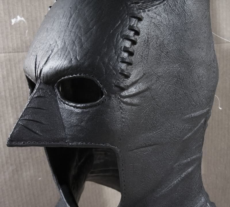

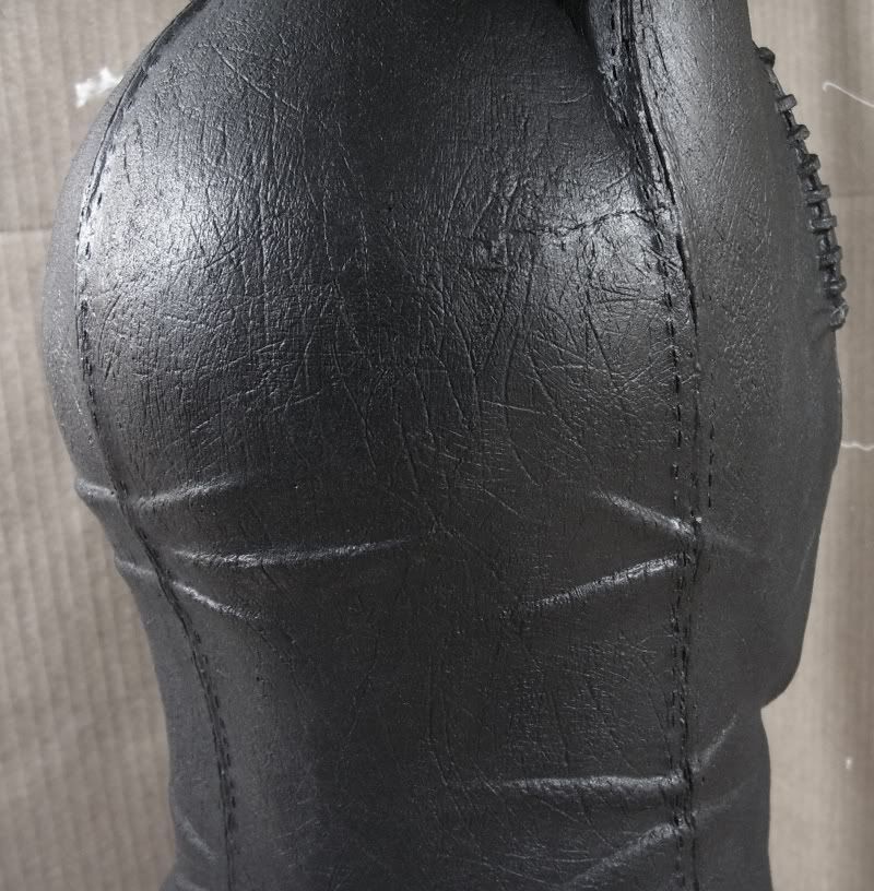

Re: Gotham by Gaslight Cowl FIRST PULL
I finally have the first pull! I got it trimmed, cleaned up and Plasti-Dipped---I have to say, I'm pretty damn pleased with it:
The texture came out better than I'd hoped. Besides doing these in solid black, I'm going to try adding a little color to it to match the comic. I'll leave the face area black, but give the main body a coat of translucent blue and give the large stitches a touch of brown. I'll post some more pix when that's done, and also a few of me wearing it with a gray shirt and black overcoat to get an idea of how it should look.
