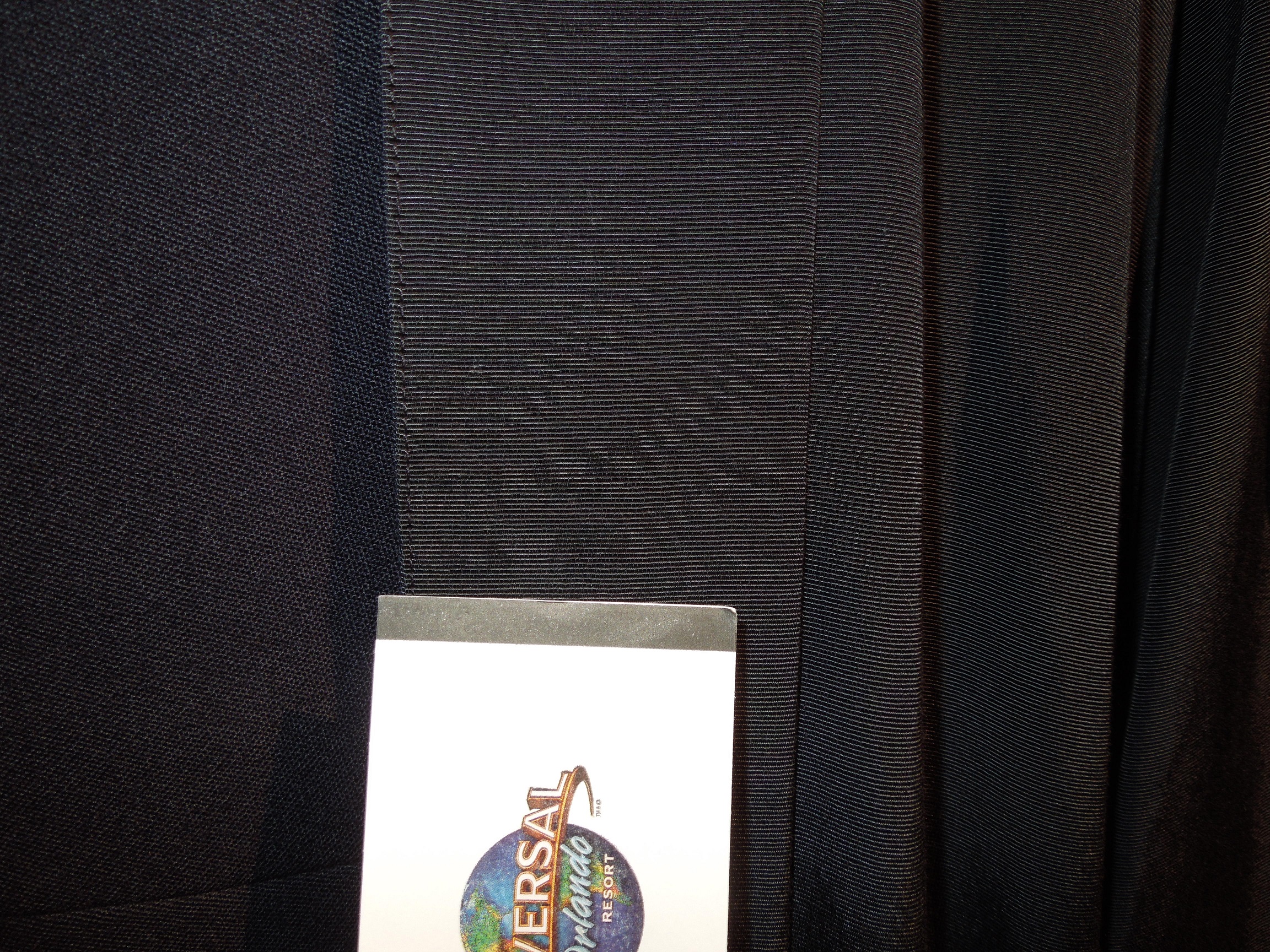

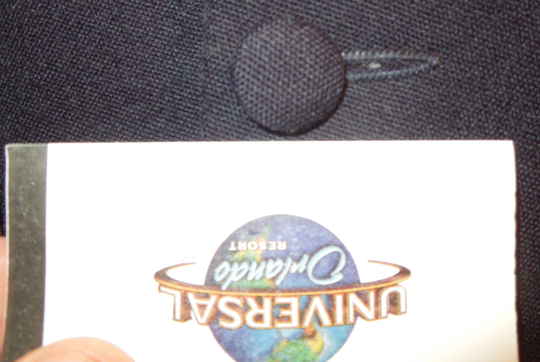

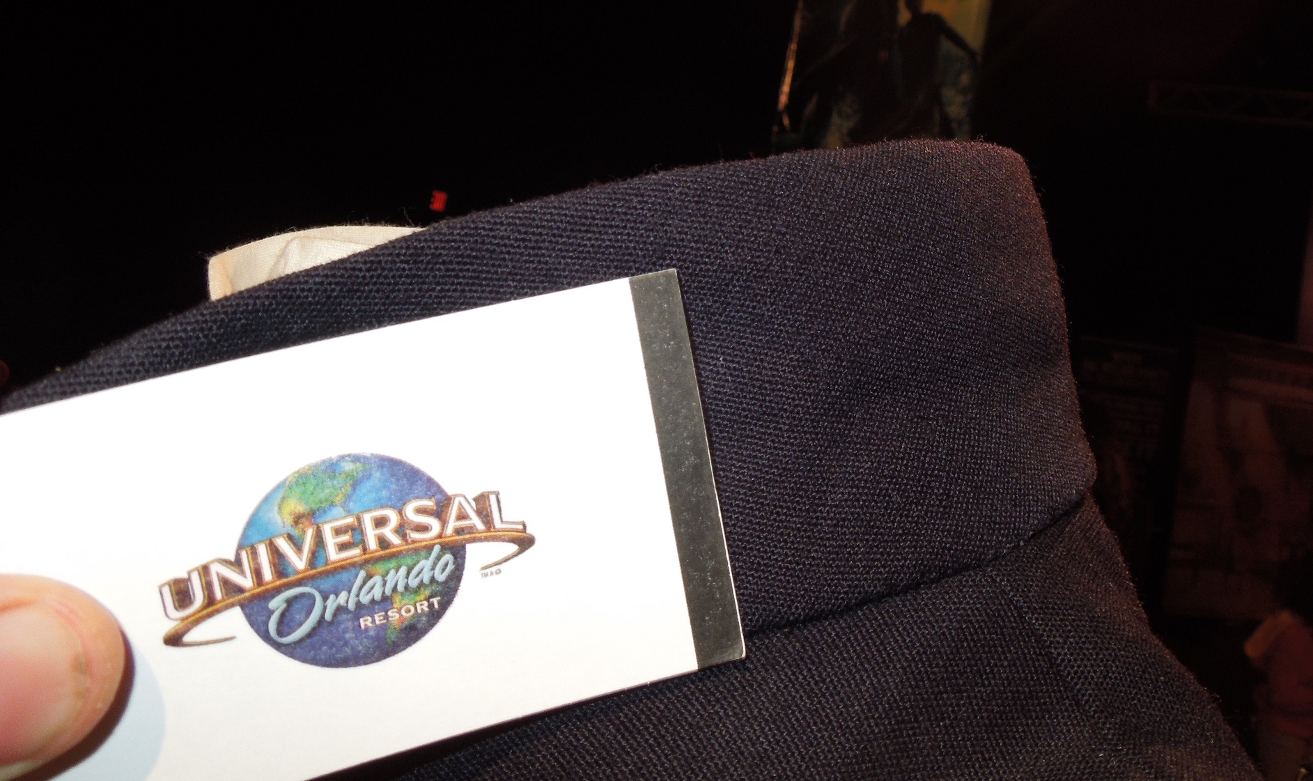

I used a 2-3/32" x 3.375" card as reference. I pulled PNG files into AutoCAD, scaled the images and came up with the following:
The 12 buttons down the front are almost exactly 0.75"
The collar is 2-1/2" tall.
The "lapel" on the cape 2-3/8" wide.
The seam where the front and rear yolk meet is 3-3/8" wide.

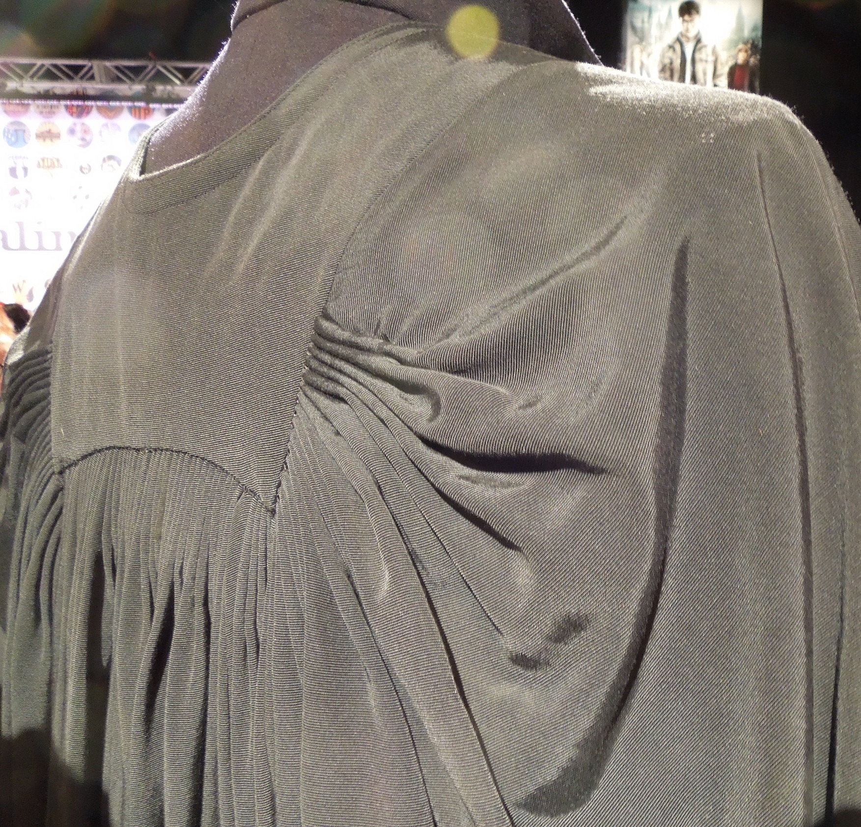

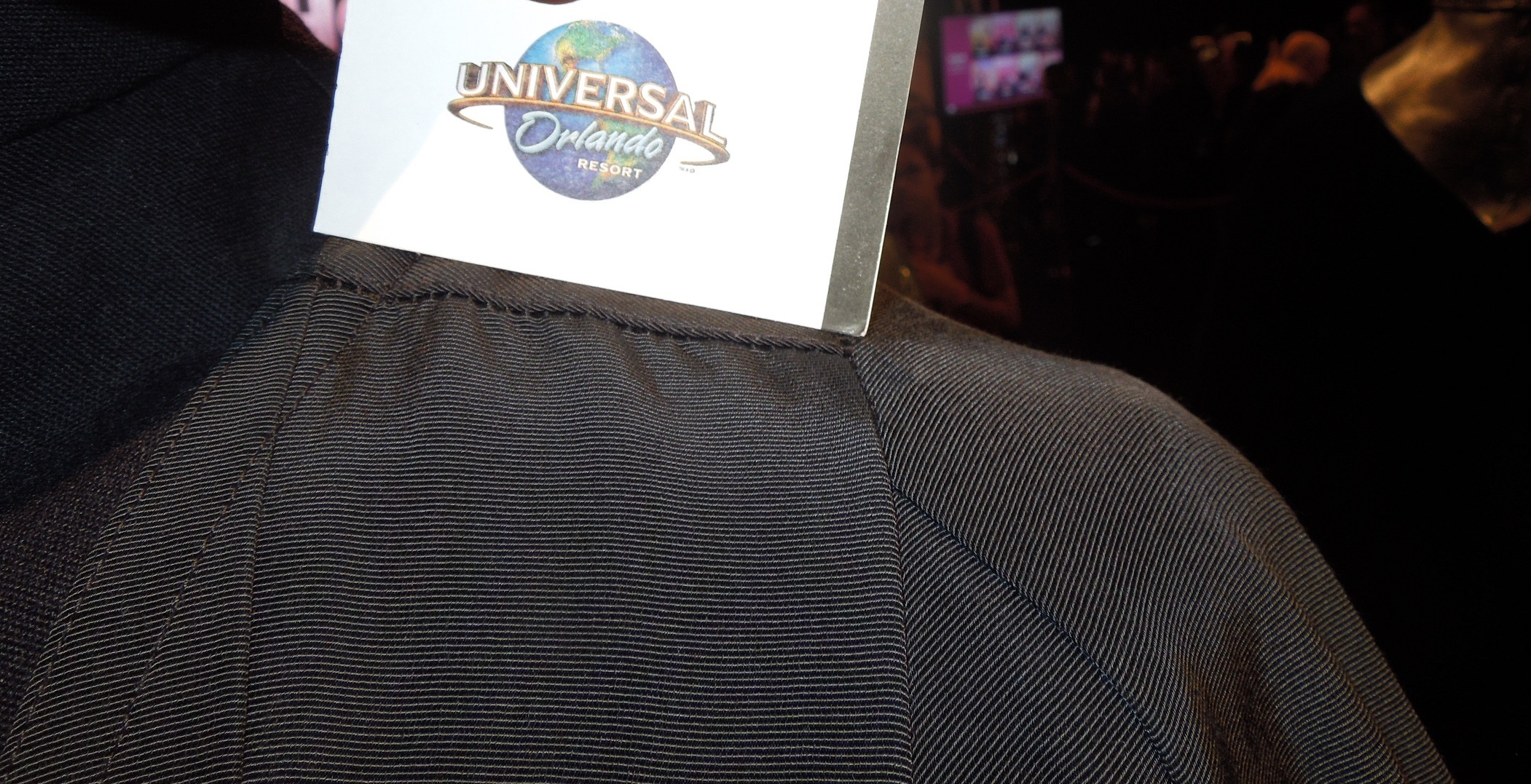

Here's the rear yolk and the gathering of the cape body.
A close up showing what looks like hand stitching at the top of each gather - may be it's pleated?

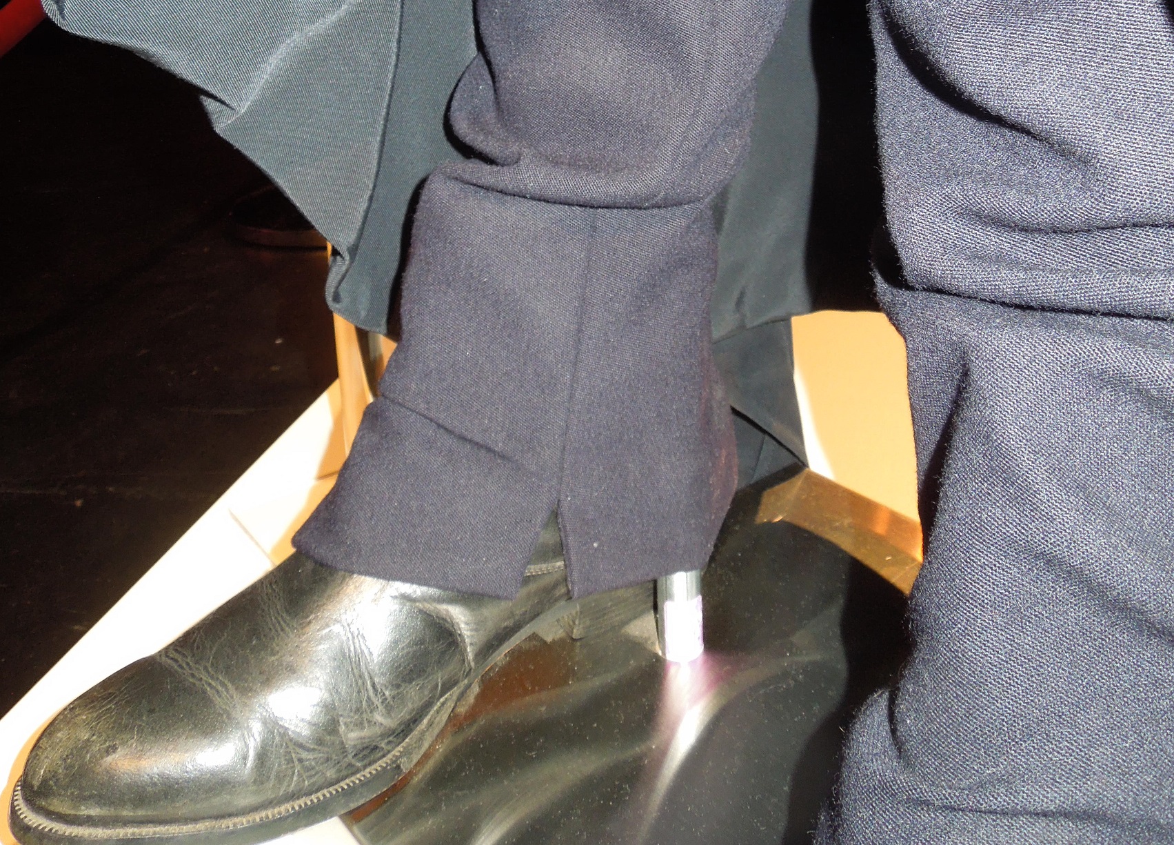

The pants leg is bunched up (I noticed this in the movie also). Also, where the cuff meets the shoe, it is actually slightly pointed. I may have a better picture of that.

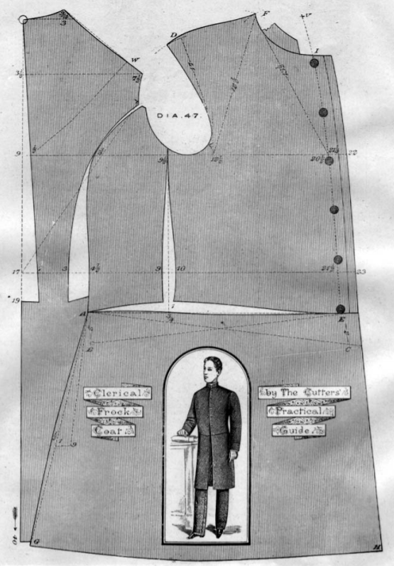

I realise I'm many years late to the party, but I've just started rereading HP with my 8 year-old son and my crush on Snape has been completely rekindled. I may never actually do it, but I must at least mentally create a perfect replica of Alan's costume, so I'm binging on all information I can find. This thread has been heaven -- kudos to all contributors! -- and I'd like to share a little tidbit of information I stumbled upon. In The Cutter's Practical Guide To Cutting Every Kind Of Garment Made By Tailors, Part II I found this diagram of a fittingly named "Clerical Frock Coat":
In the illustration, the collar and sleeve cuffs are slightly different (collar variations are mentioned, though), and the skirt doesn't have any pockets, but everything else seems to match almost perfectly, from the length of the skirt (reaching to the bend of the knee) to its backwards moved side seam and the double vents-or-whatever-they-are in the back (although I do feel Alan's version has a lot more material there). The description on pages 36-37 mentions adjustments to the arm scye so as to allow maximum range of arm movement with as little as possible "lift" or distortion, which seems a fitting adjustment for a wand-wielding wizard as well. Snape's costume has double the number of buttons at the front and sleeve closures, but otherwise is just as austere and fits the theme to a t.
This is basically the pattern I used for my Snape frock coat. You are right about the pockets. I don't have any on my Snape costume (just sewed on the flaps). The sleeve vents are very deep but that shouldn't be too much of a problem as they are just deeper versions of what you would have anyway. However, if you wanted an exact copy of the costume that back side seam that goes from the waist to the armscey would have to be moved from so that it met the shoulder seam instead. I didn't bother modifying the pattern as most people wouldn't even know it.
Good to know I'm on the right track! :D
Ah, I didn't know that about the side back seam, thanks! Sounds a bit unusual, especially for historically inspired (or even modern) men's wear, but they must have had their reasons. I think I can live with this deviation, though.
If I ever end up making this, I'll probably go with functional pockets, just because I'm a sucker (read: OCD) for functional details -- I made my husband an unintentionally (or perhaps not that unintentionally , who knows? ;) ) "Snape-y" overcoat (slim-fitting, black, and knee-length with a centre front closure) years ago and the welt pockets with flaps didn't give me any problems. The buttonholes did, though ... I obviously will need to get over my irrational fear for buttonholes :rolleyes:
Do you happen to know what's the final verdict on the back pleats/vents/tails, by the way? Are the side back pieces full tails, or partial vents? I've looked at so many clips and stills, but I still can't quite wrap my head around them.

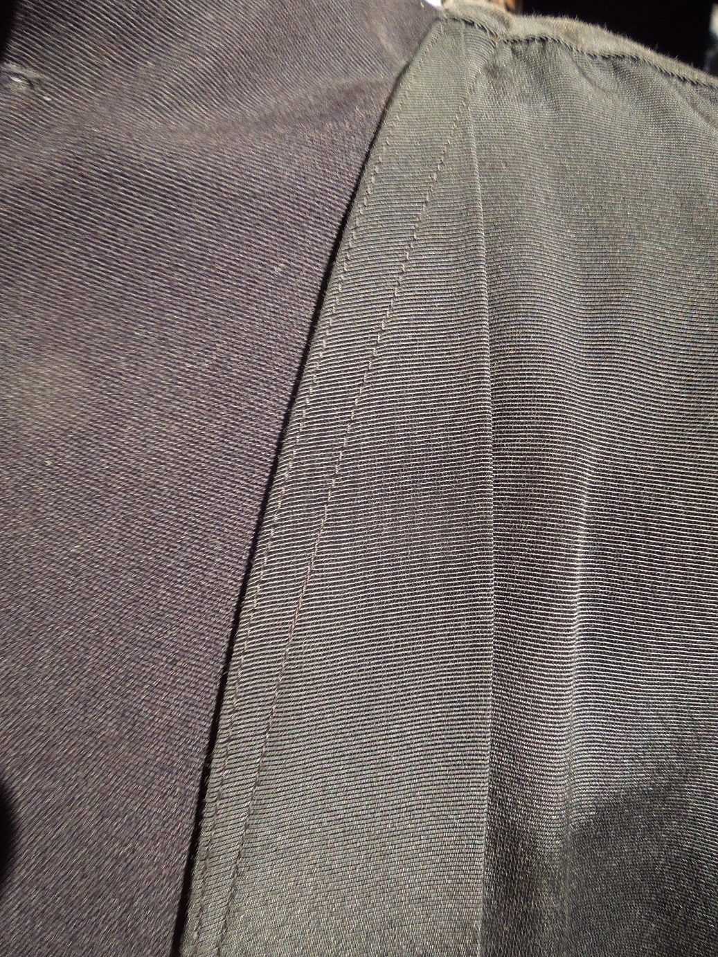

This is a close up of the double stitching on the upper part of the "lapel".

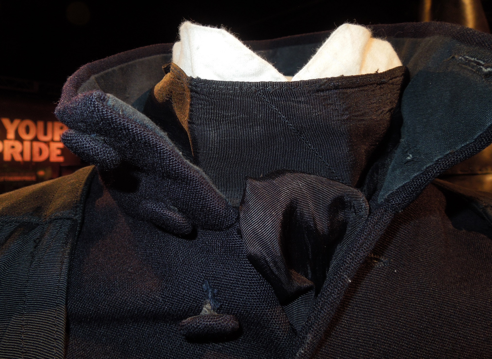

This shows the ascot material and the cassock really is dark dark indigo midnight blue - not black.

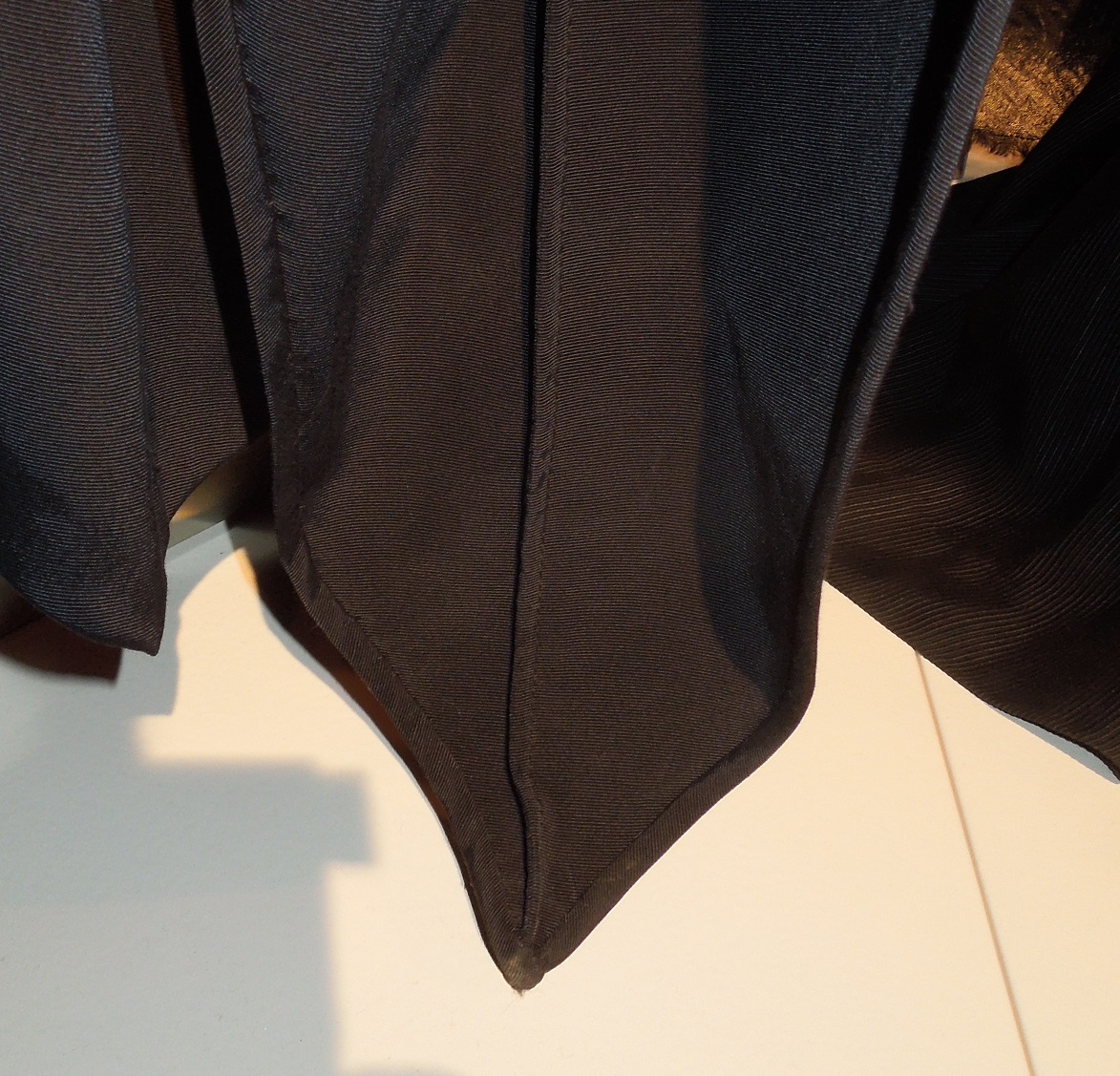

I wanted to lift the cape to get a look at the "tails" of the cassock for width and seaming details, but I also didn't want to get tossed out of the park!

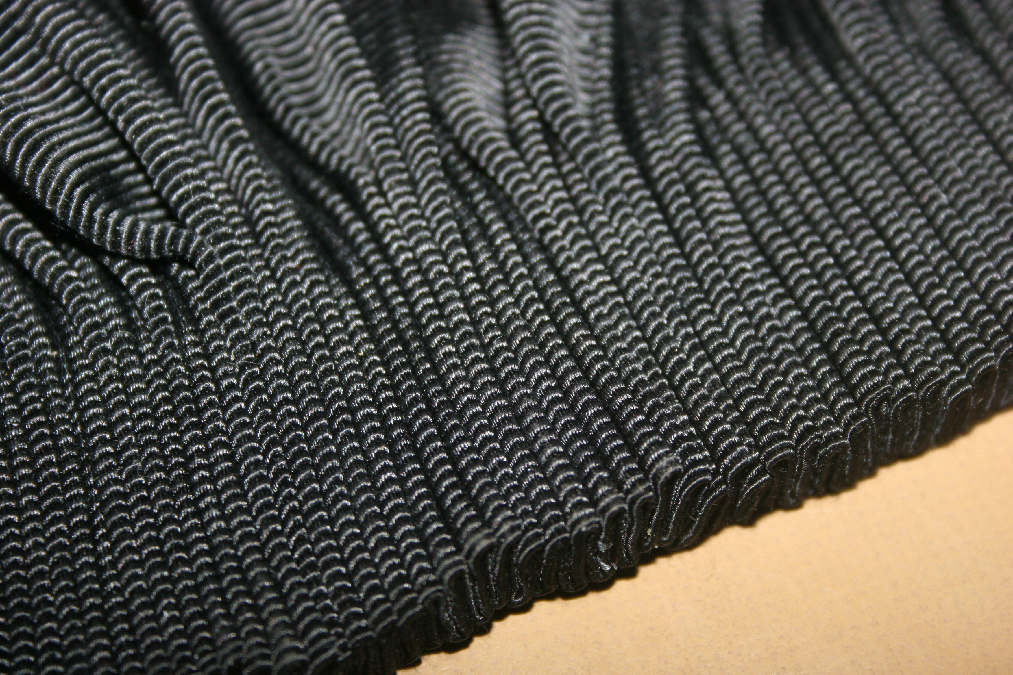

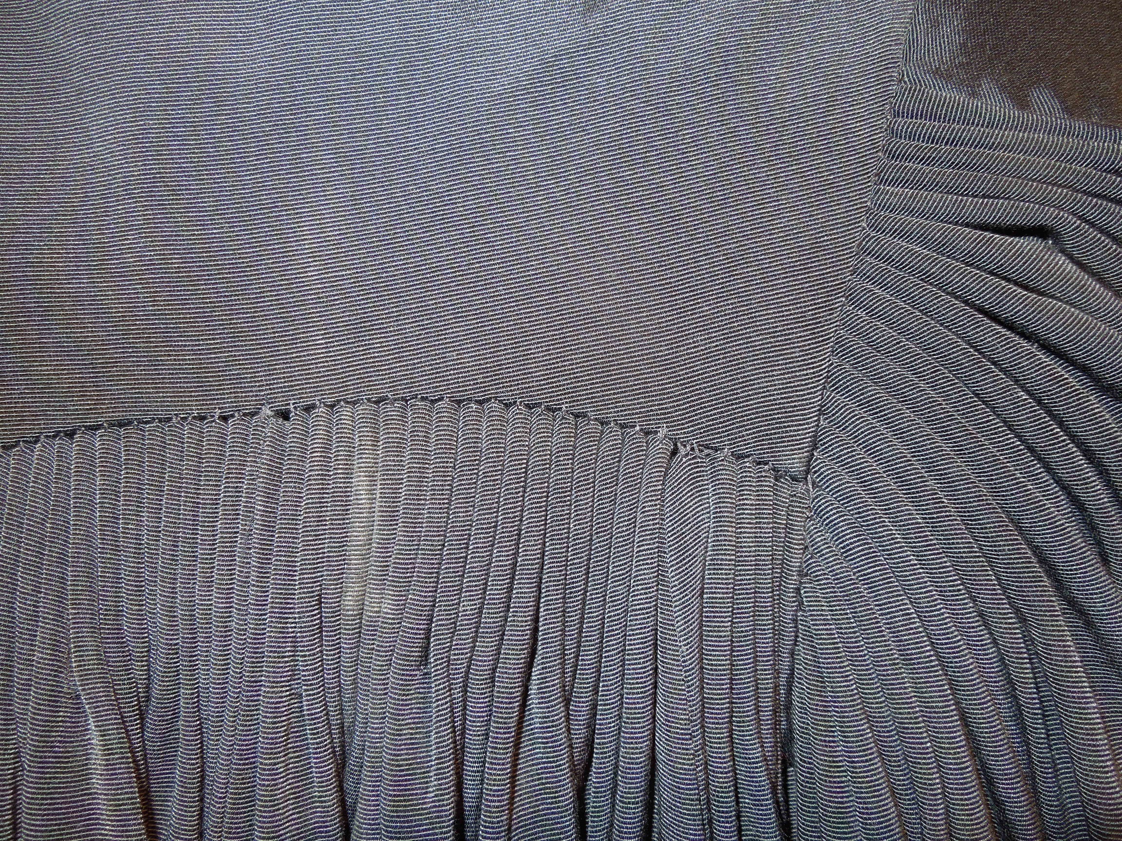

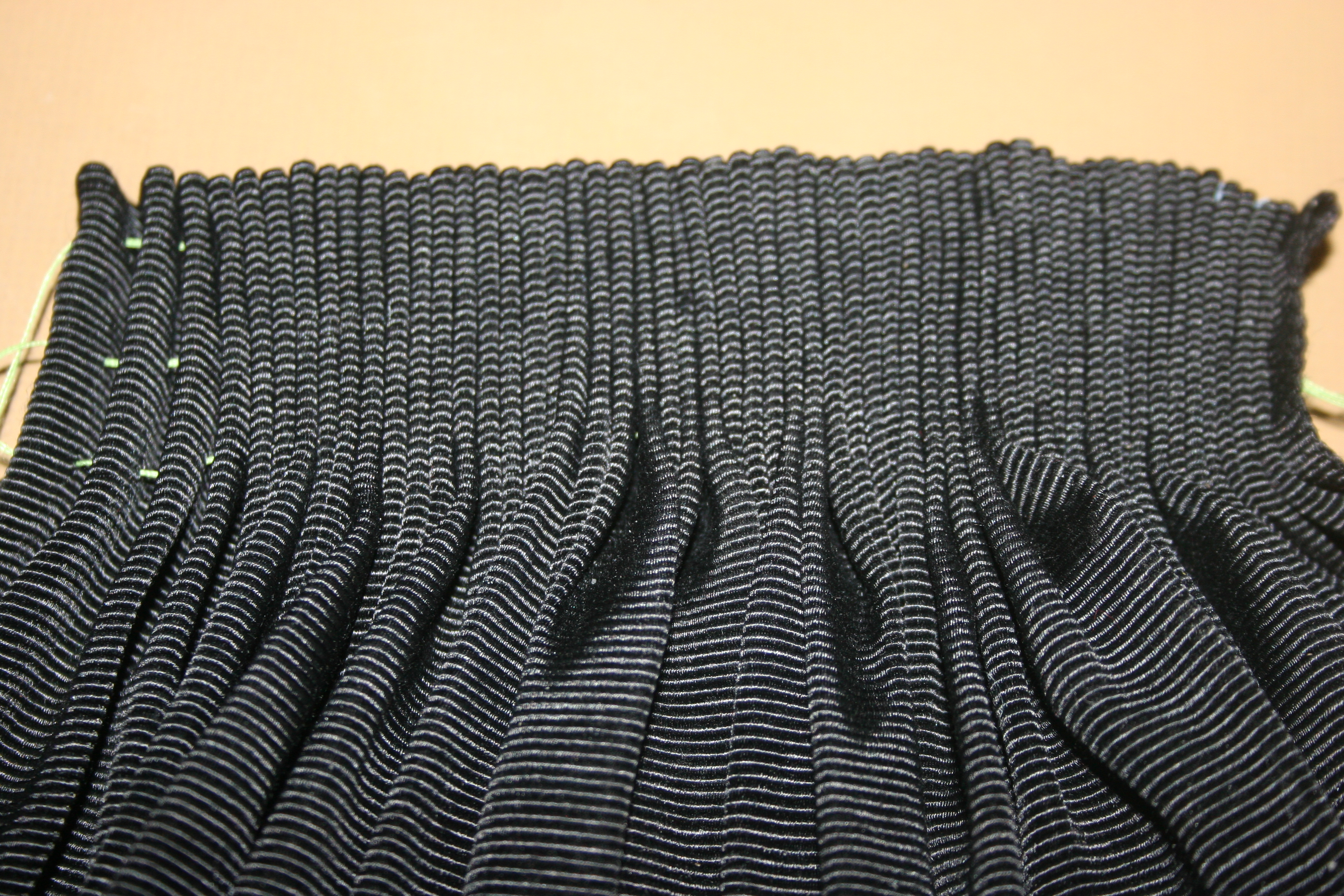

Hi there. Long time since I contributed but I recently found some material in a shop and I thought I had seen it somewhere before. I checked this thread and realised that it was the same thing as the fabric used in on Snape's cloak. So I bought the fabric and have started making a few test pieces. Here is a cartridge pleating test piece I have done.
