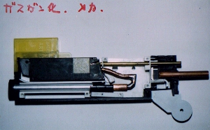

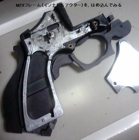

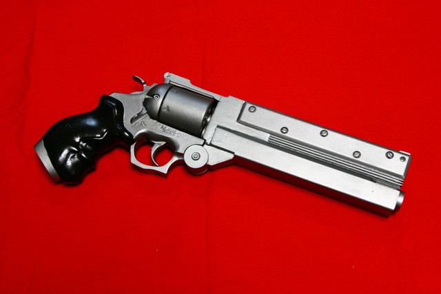

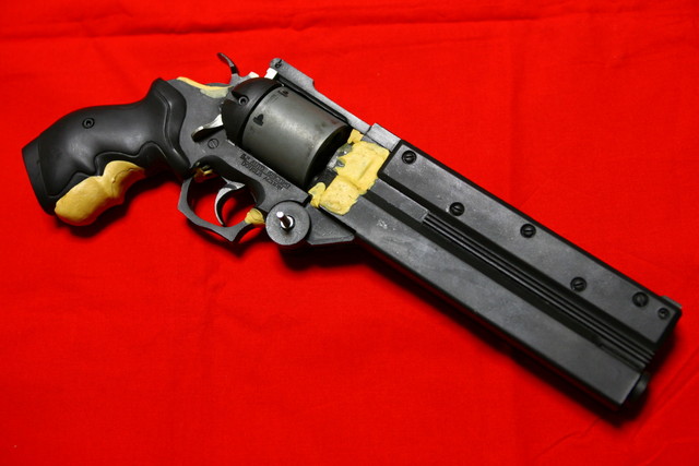

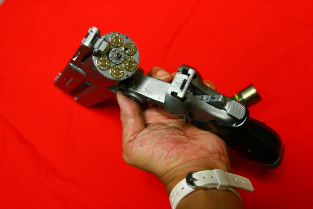

You don't have many options. The problem with the Anime version of the gun is that the cylinder is extended and the grip has a very sharp angle away from the frame. There are airsoft revolvers that use the cylinder as the gas reservoir, but due to the elongated cylinder these can't be used without cutting down the frame of the gun (which has been done). The other option is to modify and extend the grip for a tank, which has also been done. Both scenarios require cutting up the kit extensively. The Manga version of the gun, which Poseidon also made, is designed as a conversion kit for a gas powered airsoft because the cylinder is a standard size on that version.
Getting the gun to fire from the bottom cylinder also requires modifications to the donor airsoft gun. I've attatched some images for you. These are from two different builds, one using the cylinder as the gas reservoir and one using a tank in the grip.
View attachment 360014View attachment 360019View attachment 360024
View attachment 360020View attachment 360016View attachment 360018
View attachment 360017View attachment 360013View attachment 360015
