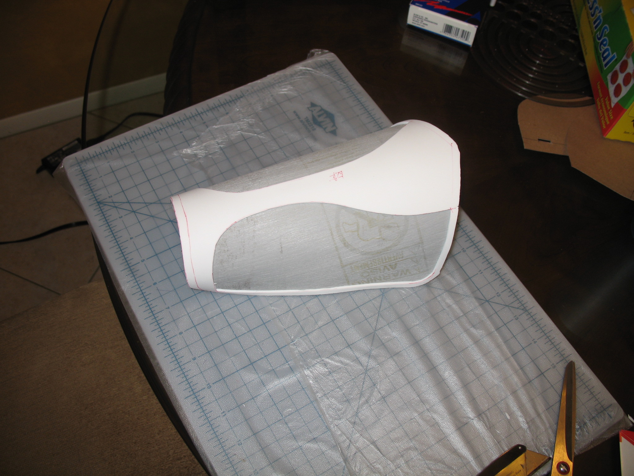

I'm in the process of making Spartan armor. I went dumpster diving and gathered empty 5 gallon buckets and cut the bottoms off with a circular saw,then ripped it, so it was a curved sheet. They're 1/8th inch thick. Wrapped cardboard around a duct tape dummy of my arm, and sketched out a pattern, cut it out, and traced it onto the plastic sheet, and cut it out with Metal Snips. Then, I used Vinmann's technique of dropping them into boiling water. Now, he does it for 20-30 seconds, but I wasn't having much luck so I left them in there for a couple of minutes. I pulled them out with tongs, formed them with my hands (They weren't really that hot) taped them into position with duct tape, and them dropped them in another bucket of ice water to cure them. They're pretty damn rigid, brother. Good luck!
If you can get ahold of a heat gun (I bought one through Harbor Freight for 10 dollars) they work great for heating plastic for forming and heat smoothing edges of plastic...I made AVP shoulder bells by heating the plastic while it was lying on a paint can turned on its side....as they heat the pieces just flop down onto the curve..
