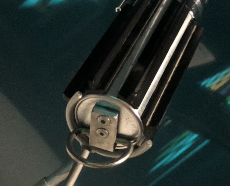

【Having shown up in a couple auctions, ANH and ESB pro - ducer Gary Kurtz has parted with some lightsabers from his personal collection. While billed as being used in the film, evidence points to the fact that they were never seen on - screen.】(by roy 《light saber guide》)
(Picture from roy ,《light saber guide》)
Firstly this lightsabre resembles a hybrid in that it has rounded corners like anh on his grip and secondly it has tfa style riveted fixings.

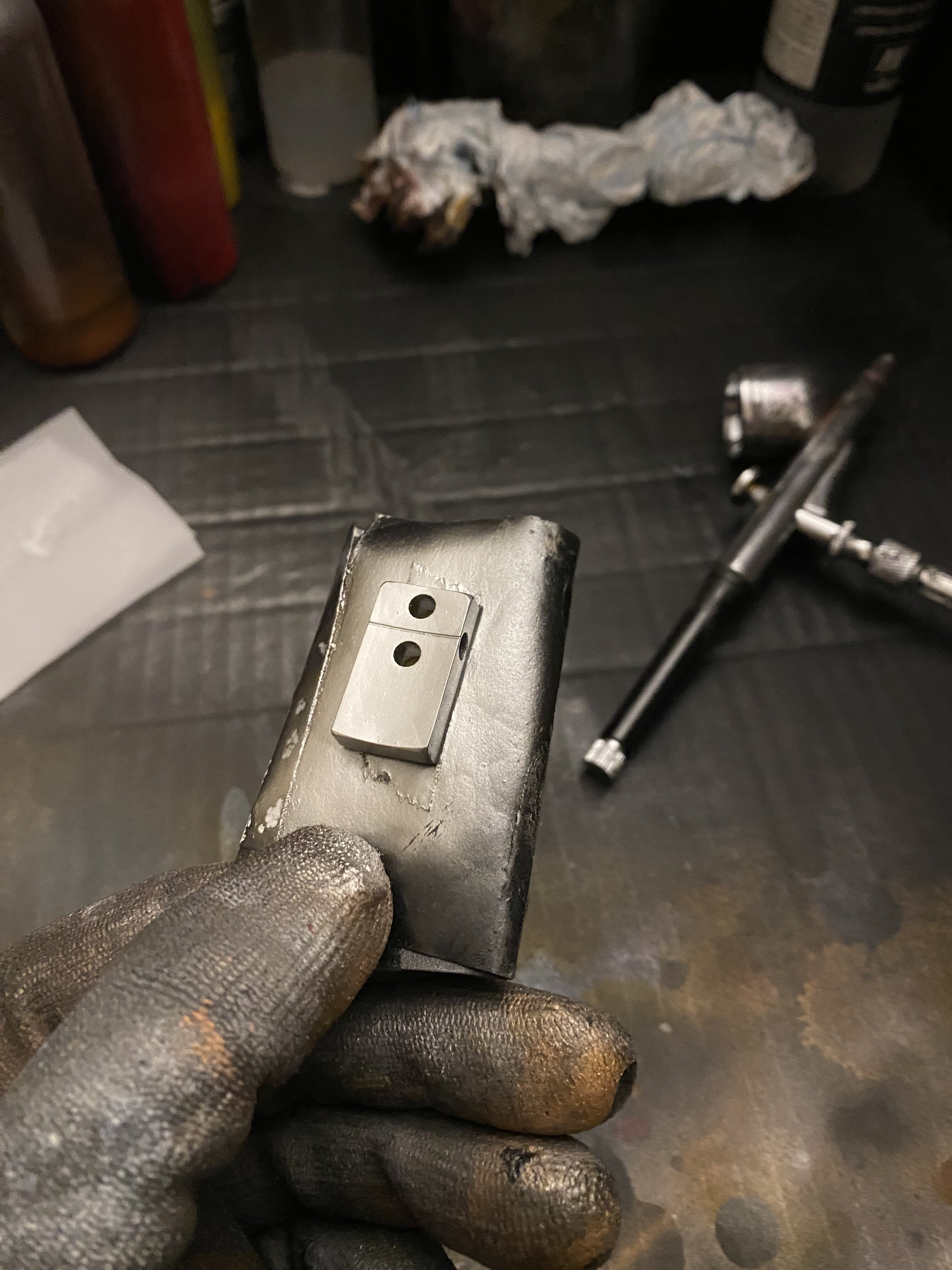

The clasp on the back cover is different from a normal clasp, I assume it is a piece of metal iron. But I opted for the most time efficient method which was 3d printing.

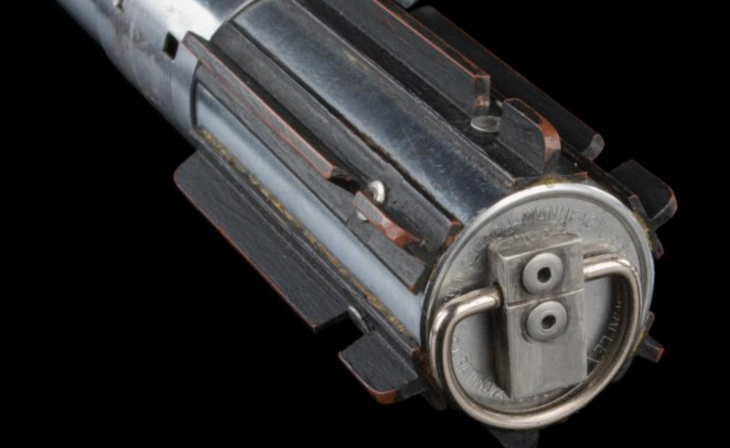

In the area marked in red I noticed a chamfer here, I'm trying my best to restore them through my 3d model.
And try to adjust the size.
Give it a nice lacquer finish.

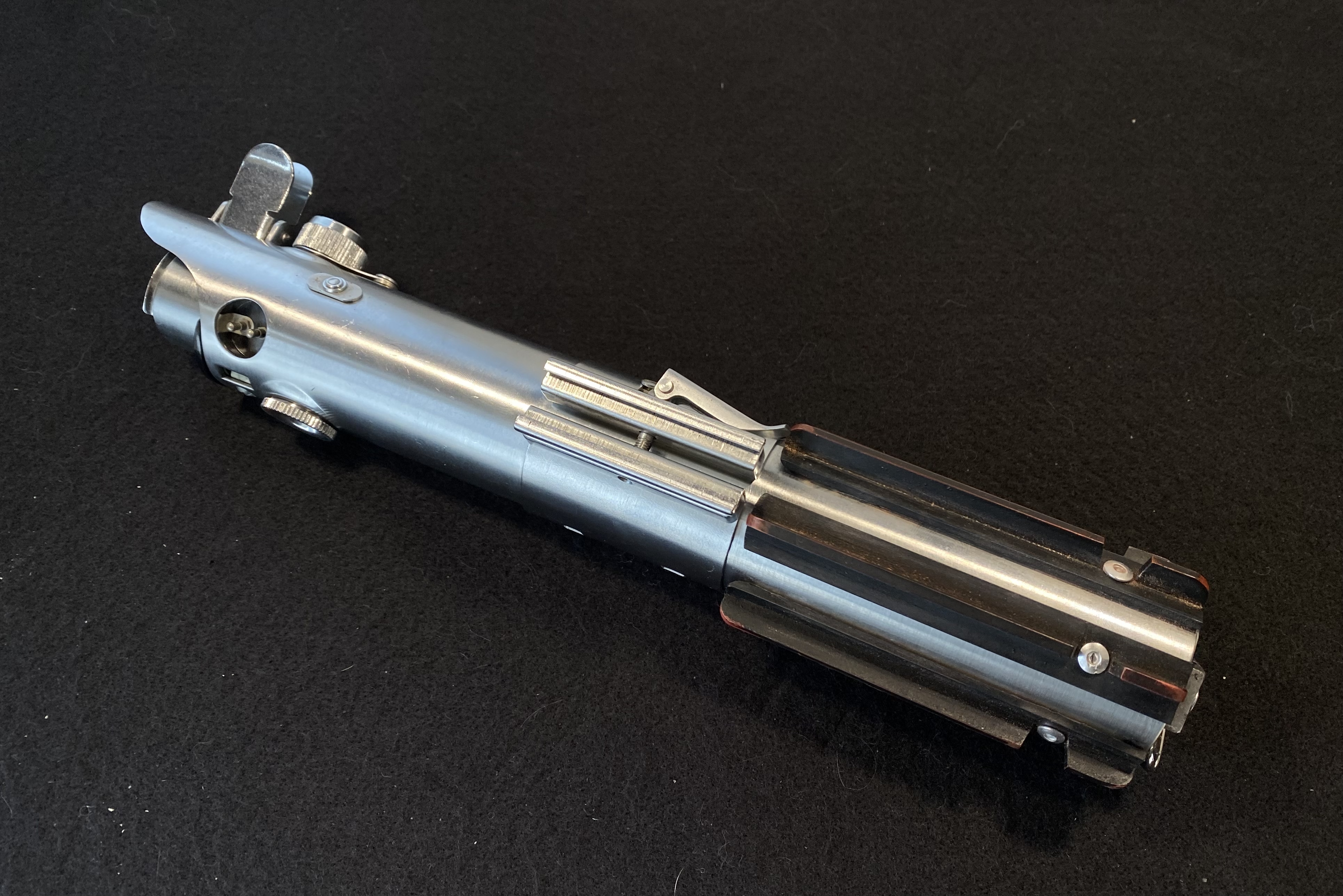

Here is a demonstration of the final result!
I used the original graflex inc upper half and clips, the lower parts I used are accurate replicas from KR sabers. Thanks for watching!

The back end… I’m pretty sure they took extruded aluminum flat bar and cut it to make the D ring block. That squashed look sometimes comes on the edge of flat stock. The groove is interesting, I wonder if they were just mapping out where to drill the rivets and scribed a line

Yes, they should just use extruded aluminum. For that one line, it looks to be between the two rivet ports. But if you pay attention to the picture of origin prop you will see that the left end of the line is deeper than the right end. The cause of this could be that they intended to separate it with a cut metal cutter like Paper cutter but that didn't end up happening. This is just a guess on my part.
