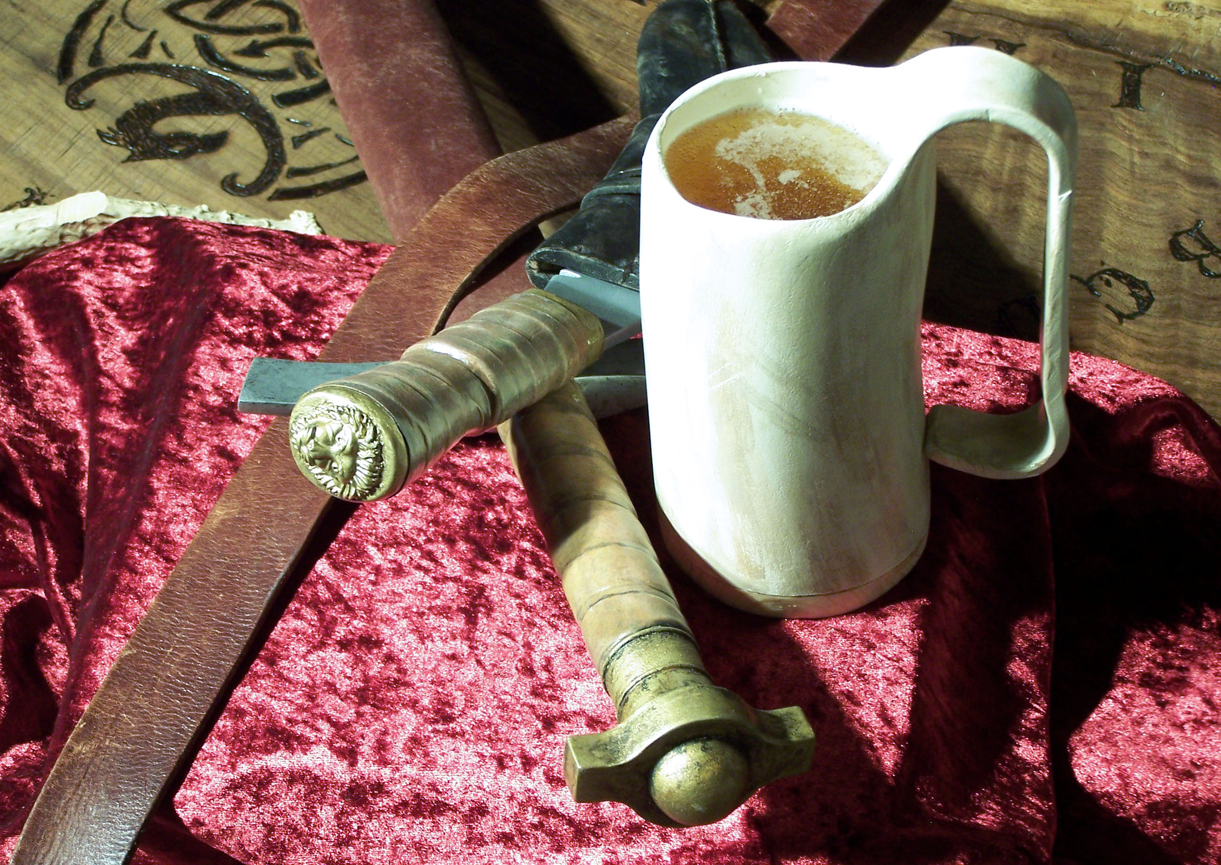

Thanks. Bronn is in full pre-DragonCon crunch time mode, so the build thread will likely appear after the con. Here's a shot of the sword, kukri, and ale horn I finished earlier.

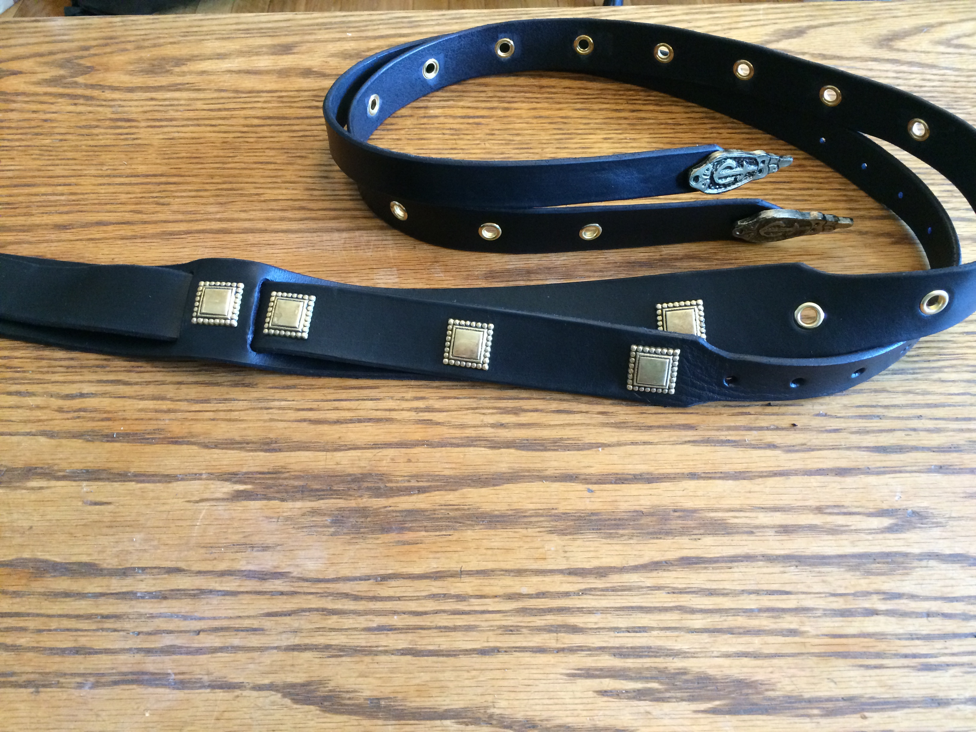

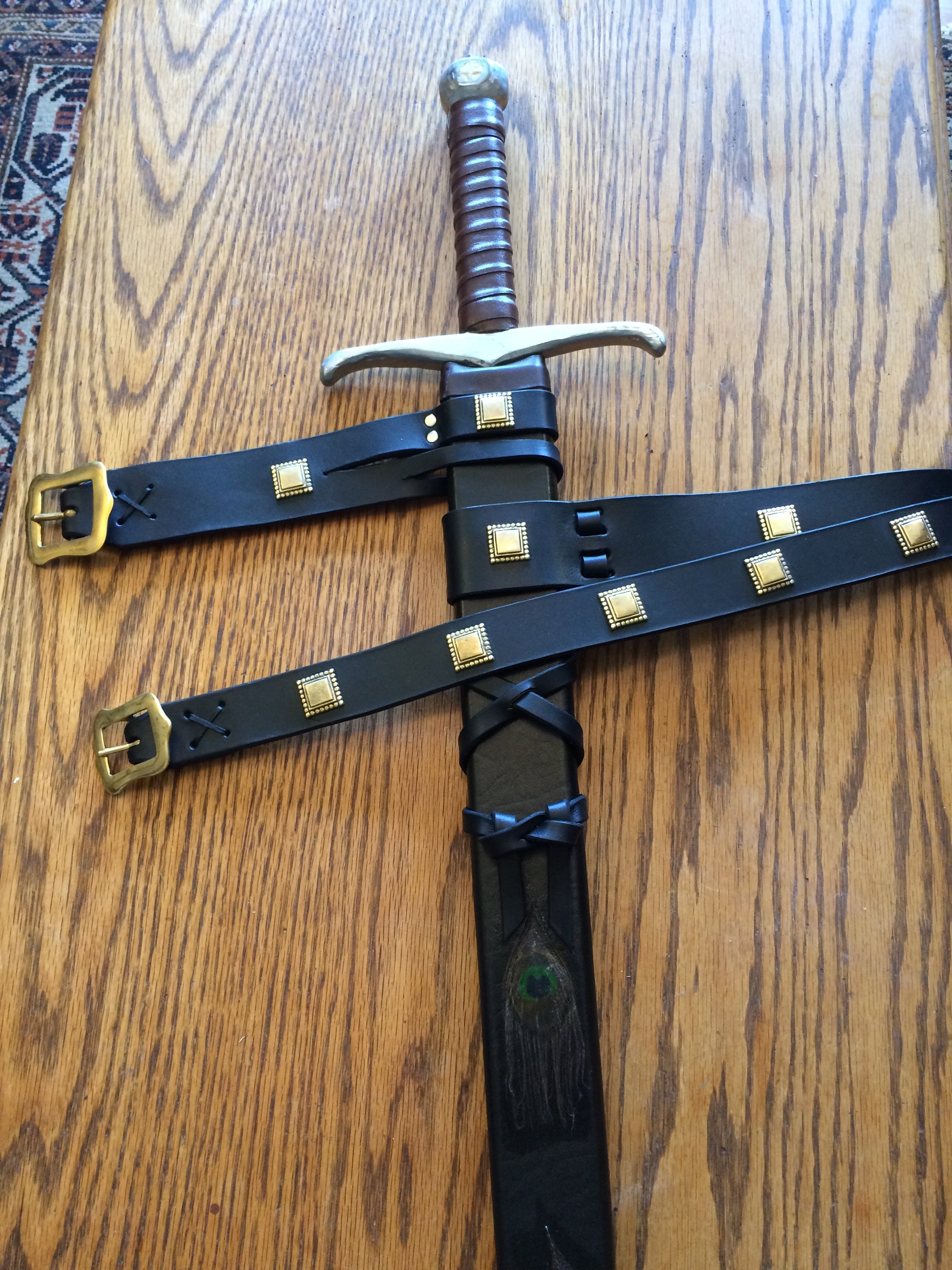

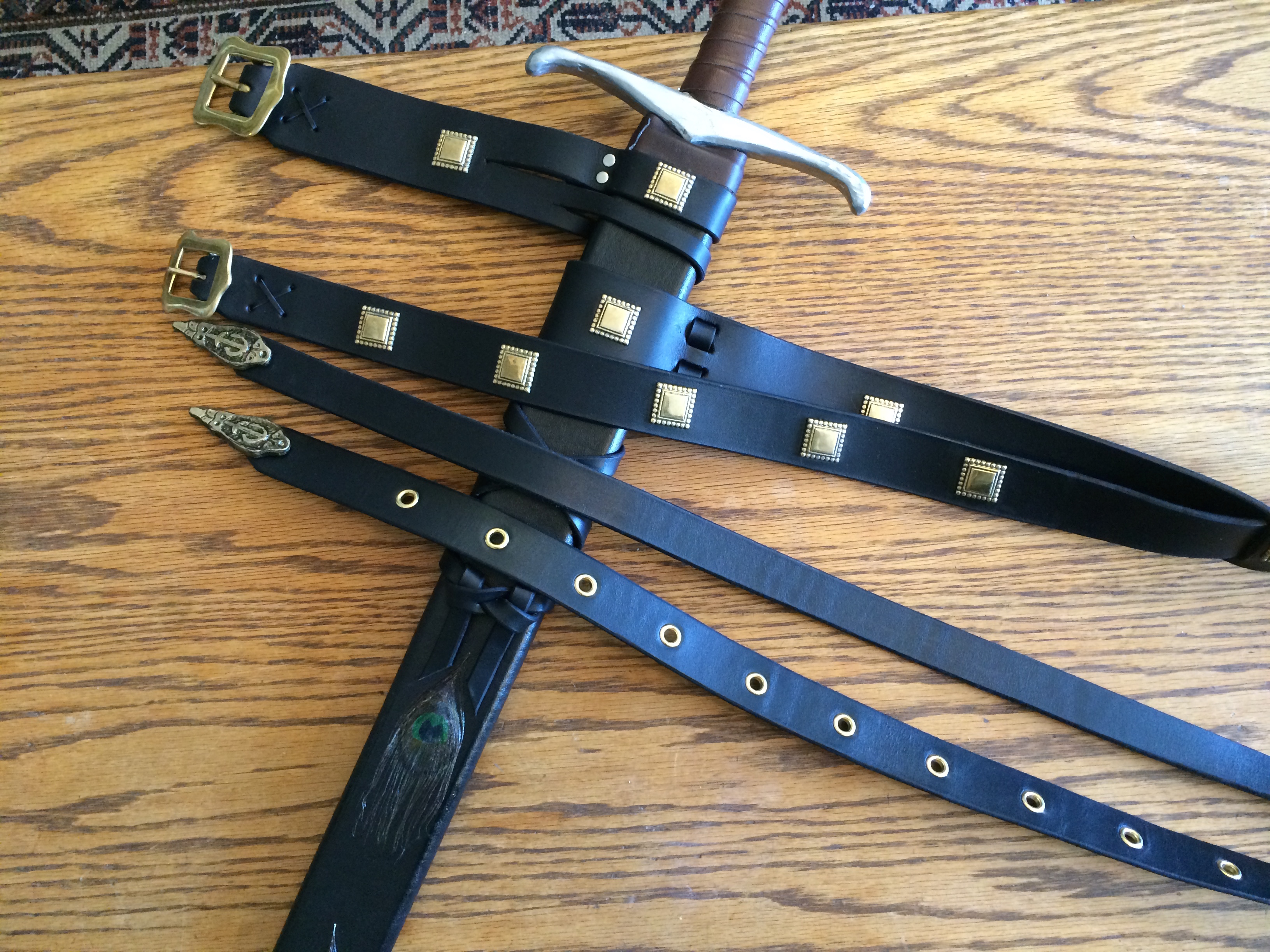

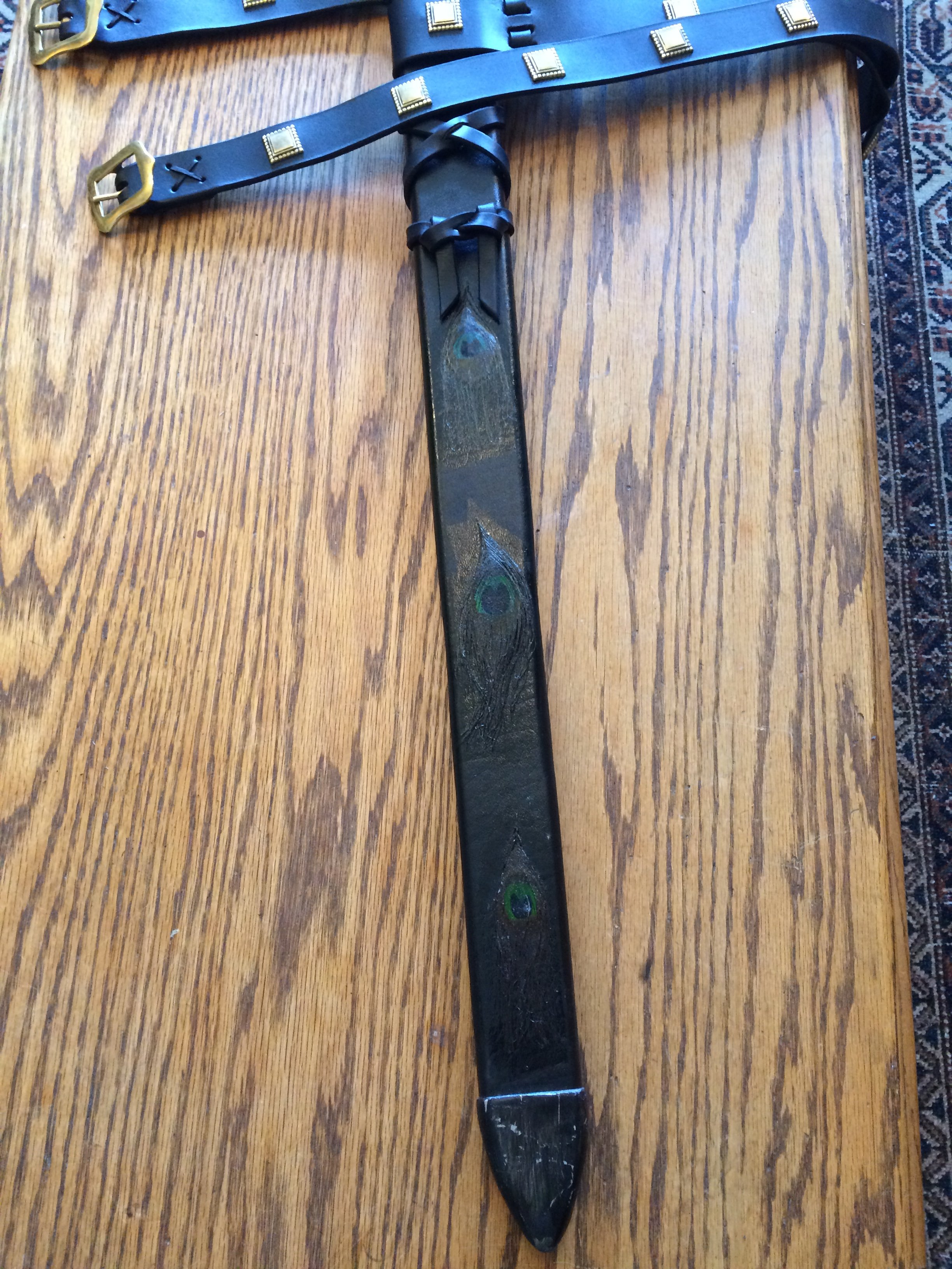

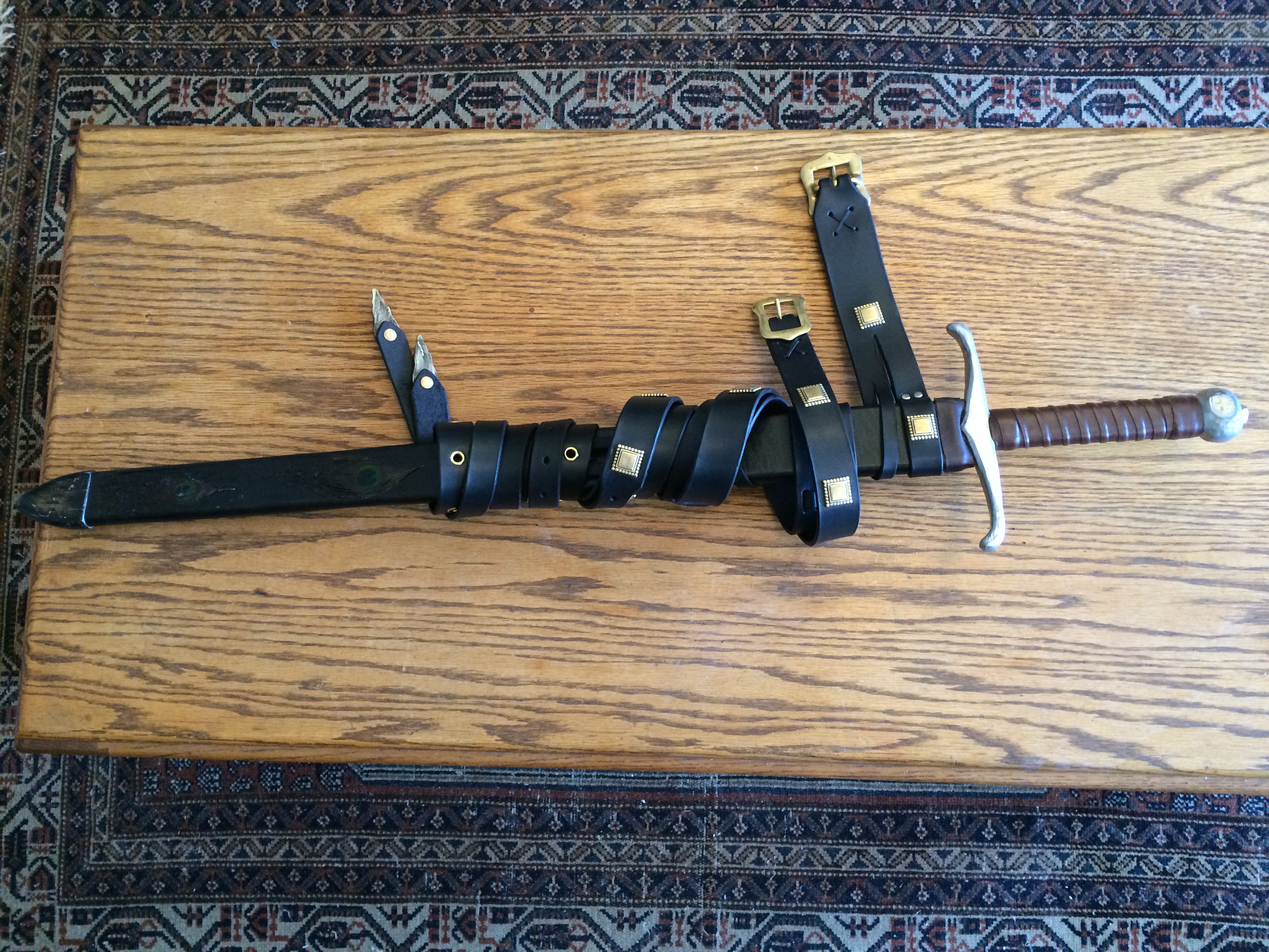

I had some very nice latigo leather and decided to upgrade the entire belt from the ok top grain stuff I was using to top-of-the line full-grain US tanned leather. This also gave me a chance to make some small changes to the layout. Overall this leather looks and feels a lot better and is much easier to work with.
In addition to upgrading the leather I also solved the problem I was having with how to wrap the straps around the scabbard, weathered the details pieces, and officially have it finished. Next up - to upgrade my Jorah armor to leather.

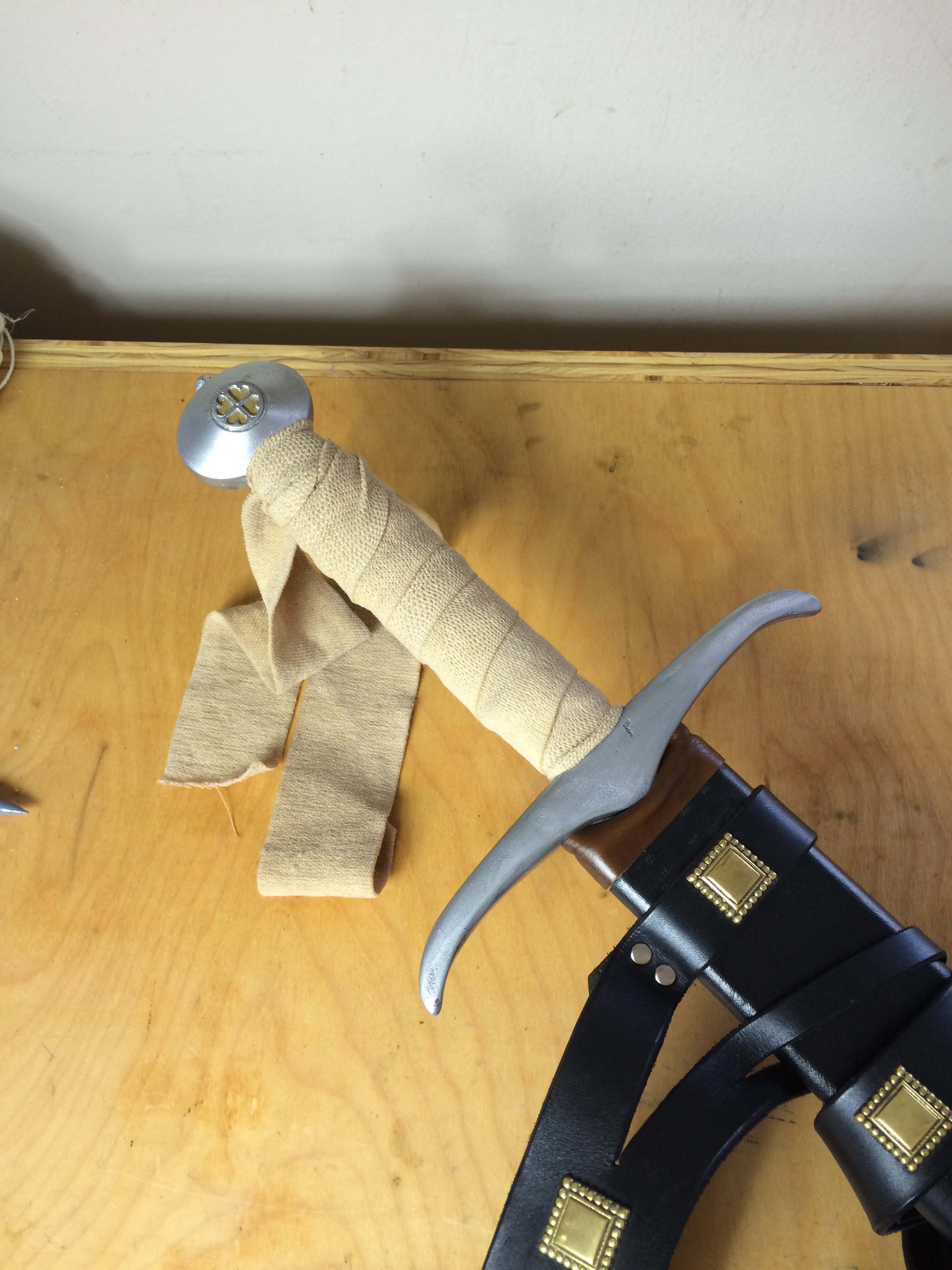

And I actually did tea dye the fabric, it may appear darker in person.

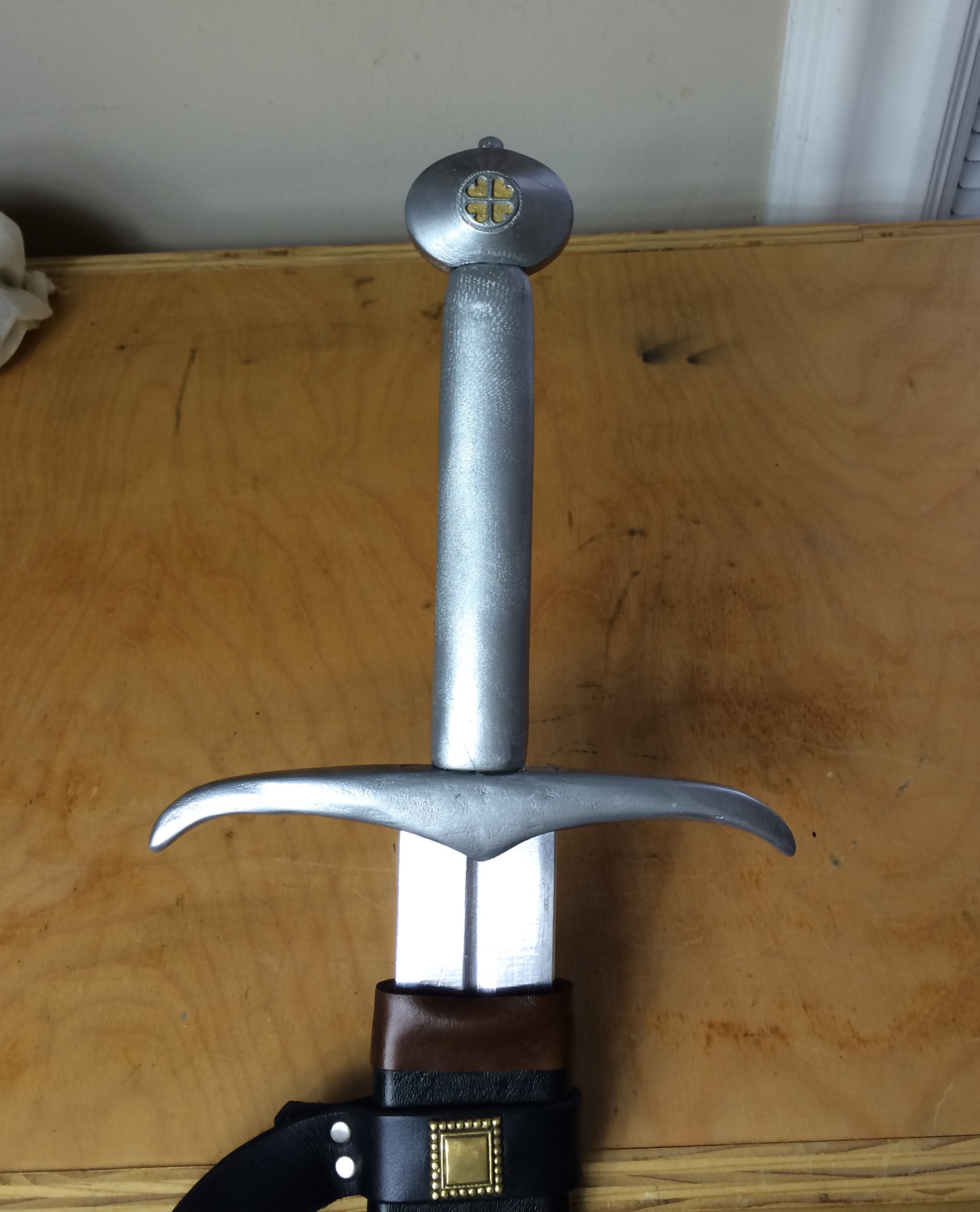

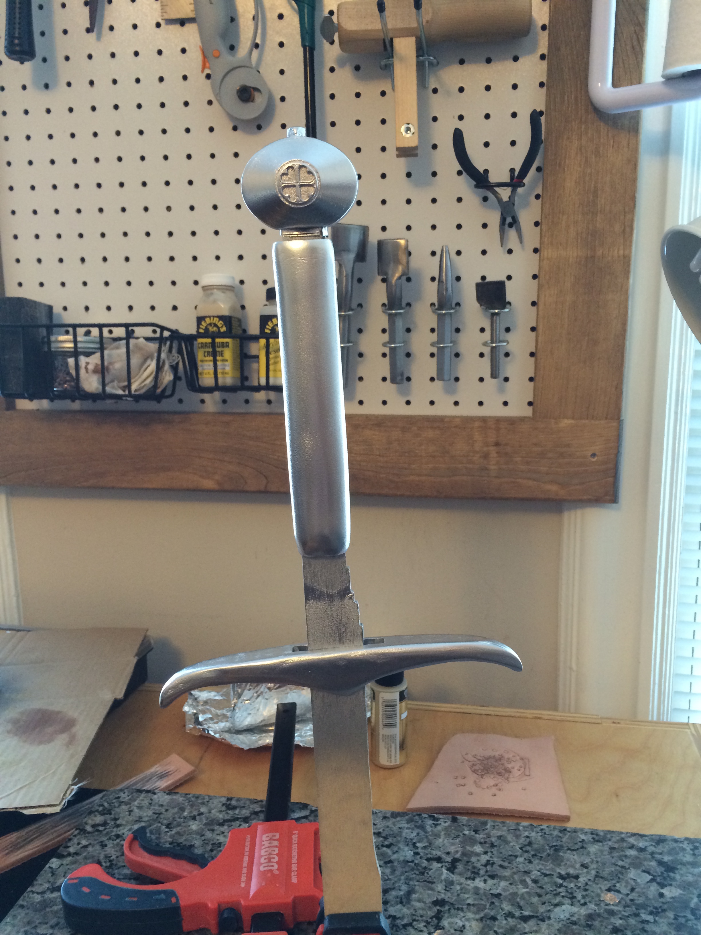

Came across a 3d file for Jorah's sword pommel and ended up having that printed and doing a sword rebuild.
Here are the pommel, grip, and crossguard primed and painted. The pommel is a 3d print, the grip is pvc pipe that was heat bent to shape and sanded. The hilt is a couple pieces of baltic birch plywood laminated together with the gap for the blade. I cut the general shape then sanded it down to the final version. The blade is also brich ply and made with a tang that with fit through at the parts. I made the fuller with a router and finished is aluminum tape.
All attached with epoxy and in the scabbard. I still need to trip the ends of the grip wrap once I decide this is how I permanently want it.

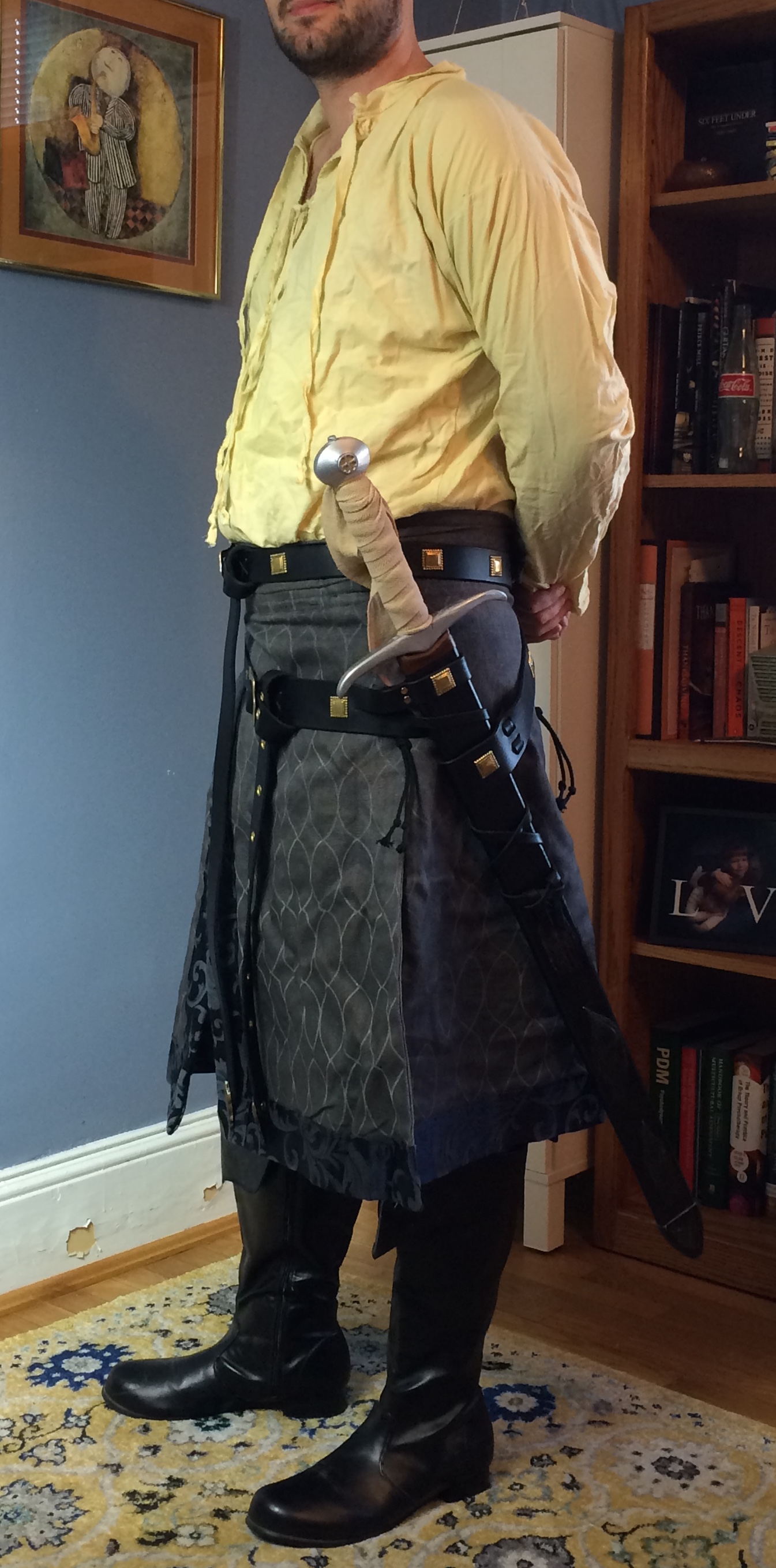

And in the Jorah ensemble. I'm much happier with this sword, definitely a step up in look to match the sword belt.

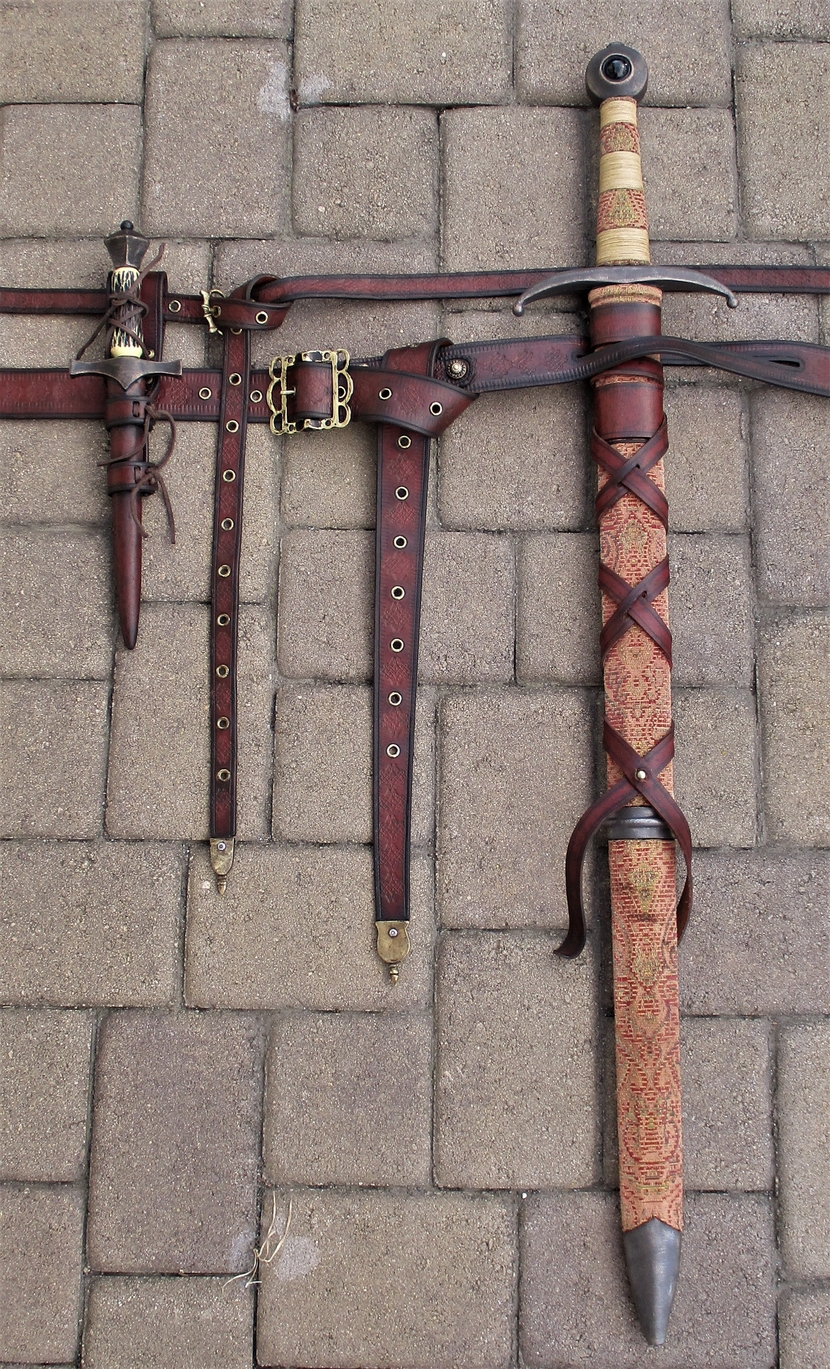

Here's my finished Barristan belts, my reproduction at top, a screen shot at bottom. I've not been able to find the small upper buckle.
I sculpted the dagger out of sculpy. The sword is a modified foam Longclaw.

On Jorah's first costume, which you replicated, the lowest strap goes under the scabbard while the middle strap goes over.
But on most of the other belts- Jorah's north-of-the-wall costume, Barristan, Brienne, Theon, and Stannis from what I can tell, the upper and lower straps go over the scabbard while the middle strap goes under.
The lower strap goes over the scabbard then goes through slots in the rear belt.
But I can't quite figure out where the middle strap, that goes under the scabbard, manages to get where it needs to be.

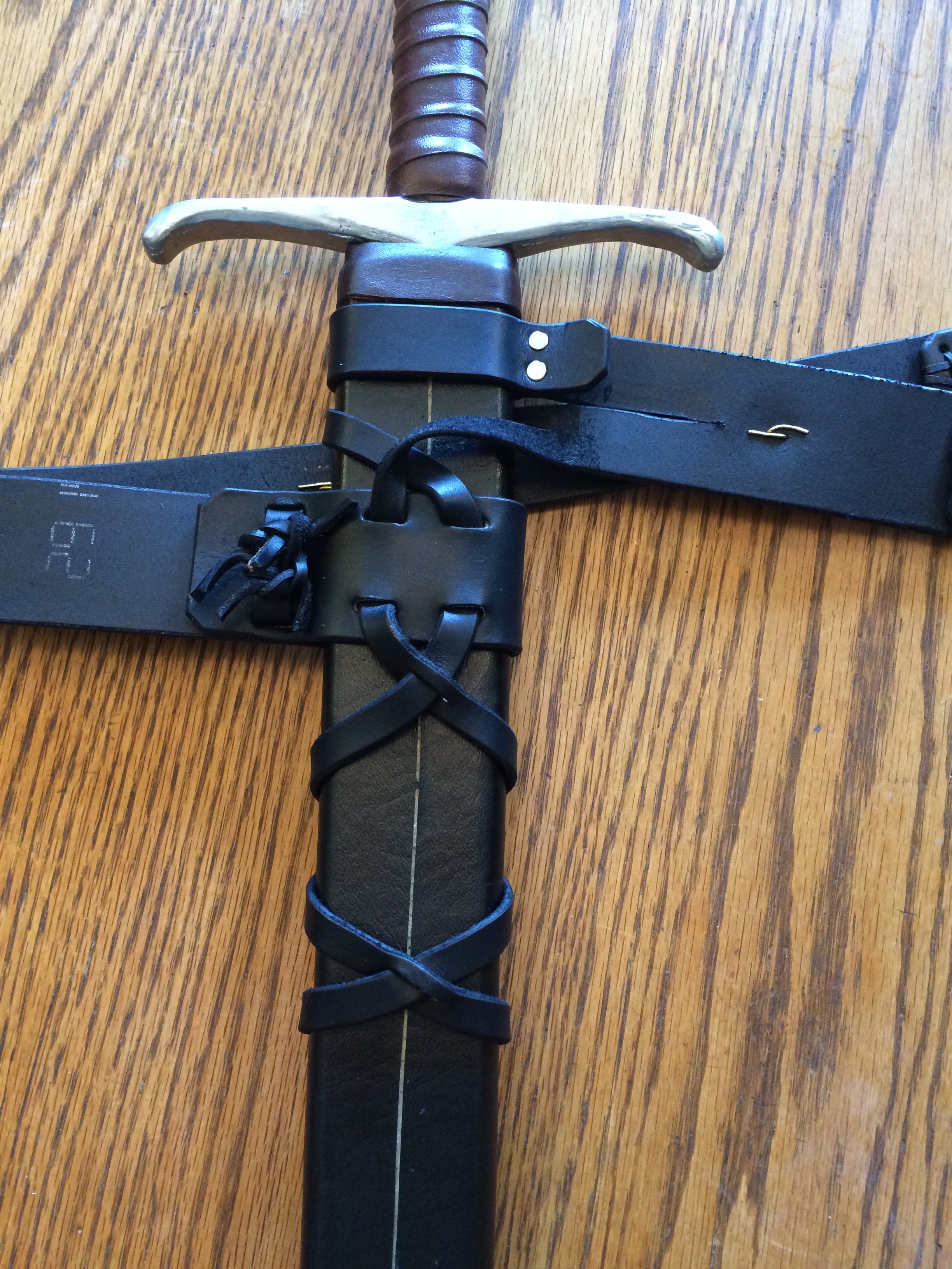

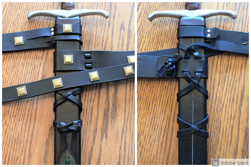

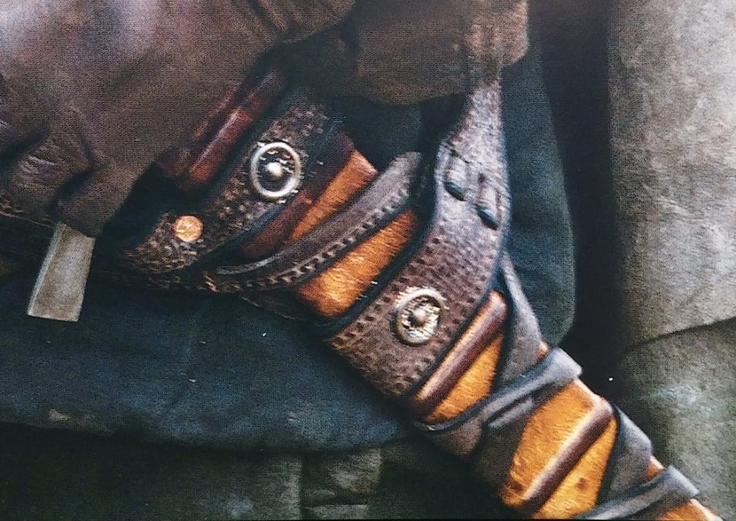

Check out the picture I have of the back of my scabbard. It shows how the straps go on the back. I spent a lot of time trying to figure out how it works and I think I got it as close as possible. The only difference on Jorah's scabbard (though I could be wrong) is that it has a separate strap that closes the larger belt that secures the scabbard. The important thing is that they both thread through the back of lower sword belt and do not cross over.
Very interesting, I've been studying those photos! Hope it's OK, I took the liberty of putting two of your photos together so I can see exactly what is going on there.
I've seen some of the GOT scabbards that look like that. Then there are others that appear to have a different construction, where the two narrow straps are reversed under/over, and the one that goes over appears to go through the slots in the lower belt:
Maybe the clearest photo that appears to show this style is a photo of Davos in the GOT costumes book, I reversed the photo for reference:
I've done a pleather mockup and the simplest solution is to lace both the narrow straps through those slots in the lower belt.
Without seeing the back of one of that type, I can't know for sure.
However Barristan's might have been done, I might follow the Jorah Mormont method which seems to be more symmetrical and secure.
Yeah! Many of the scabbards follow a pretty similar wrapping pattern and once you get a feel for how it works from the back and mock up a few it's not too hard to just see the front and understand how it works. There are also some good medieval references that I came across that explain the many different styles of attaching a sword belt to a scabbard.
