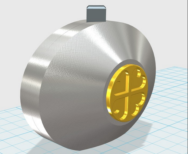

Also, if it helps you (or anyone that may be following the thread) I recently made a 3D model of Jorah's pommel for another costumer and it's free on Thingiverse: http://www.thingiverse.com/thing:977947

Thanks! Nice pommel model. I'll have to use that if I do a sword re-build. Any pics/info on your Bronn build?
