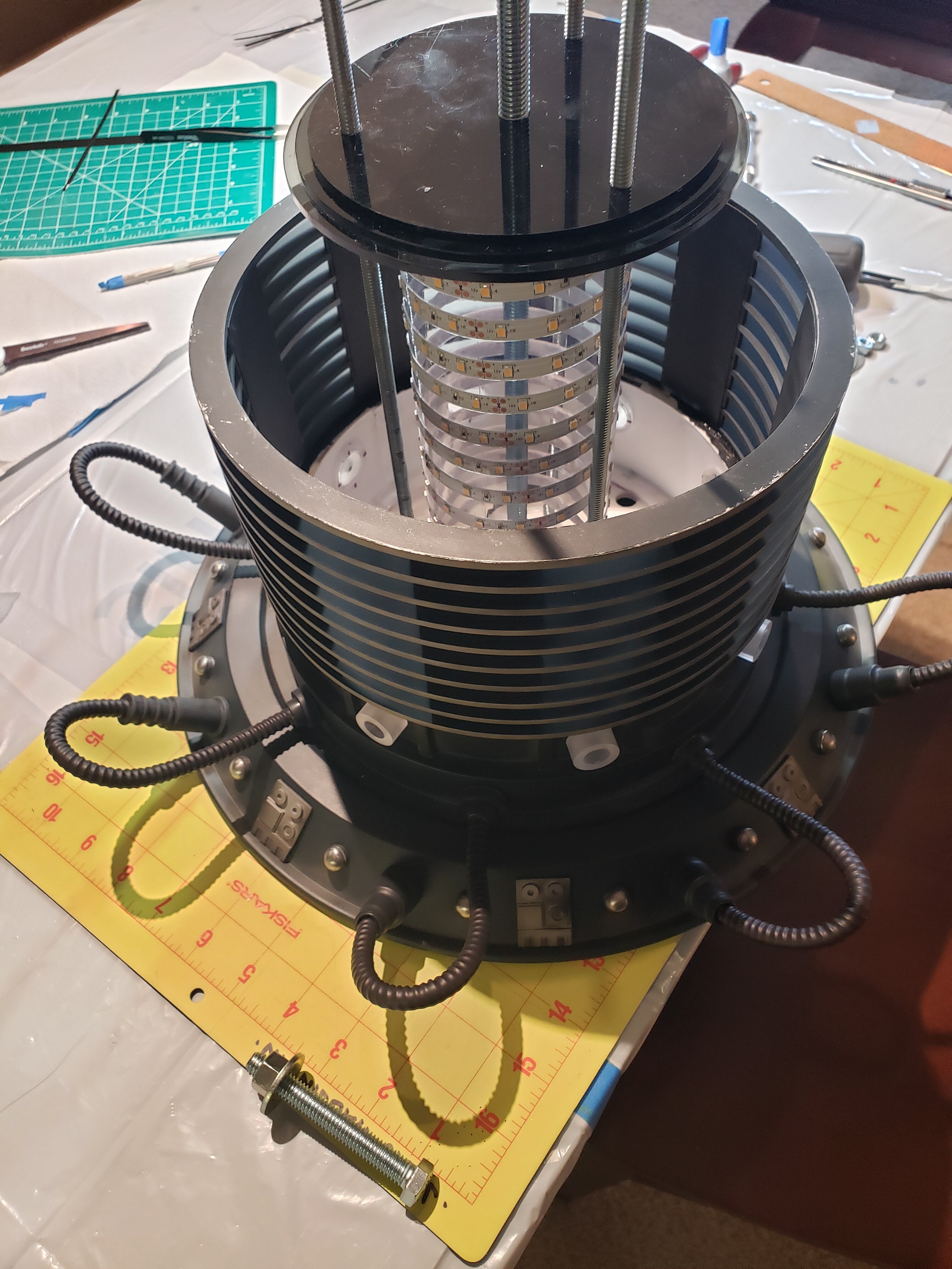

Fusion furnace
Need to do a bit more weathering but here it is so far
For the connector points on the upper base for the corrugated wires I used welding screw bases and rubber grommets. They just screw onto the headless screws I installed.

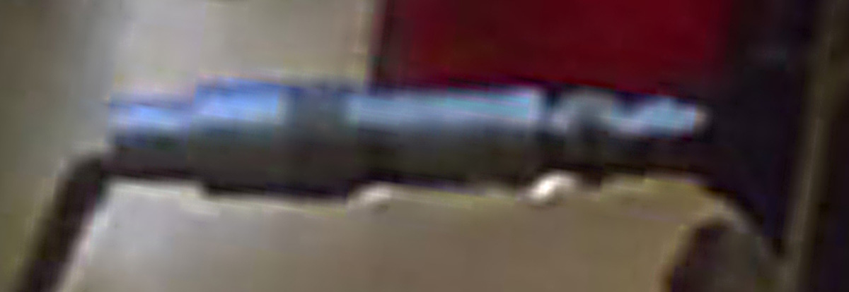

I've enhanced the screengrab image of the connector as much as I can; to me; the right section can't be anything much other than a BNC plug.
I've not managed to find a similar adapter yet; I think?? I probably have one, but it's a decade or more since I used them,

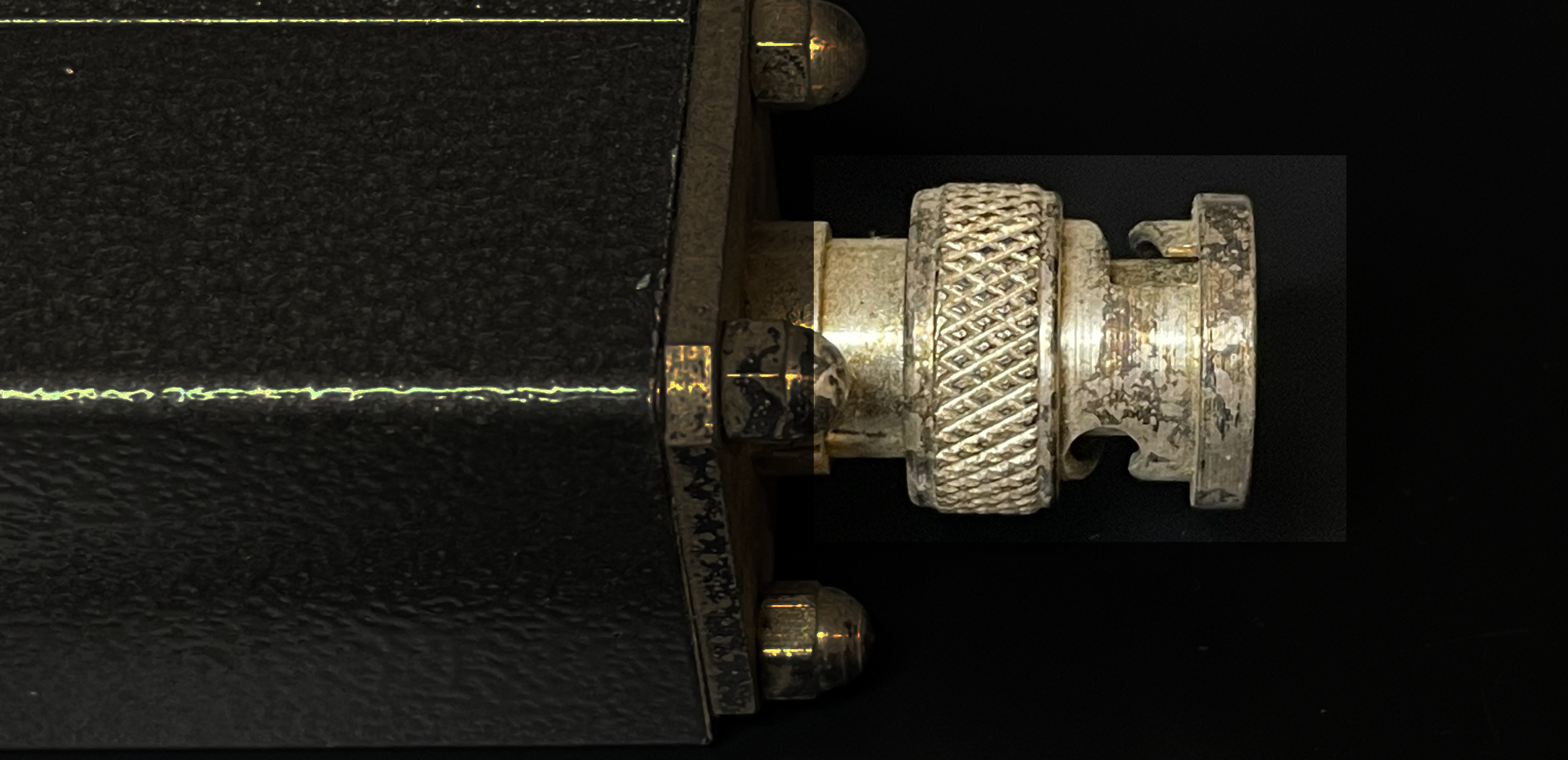

The one I've found so far is on a square body rather than the round style, but you can see how the outline matches, with the knurled ring, narrower section with the grooves for the bayonet pins on the socket, and plain ring at the lip:
I hope this is some use if you do any future updates?
Yeah I agree. I did look at those just wasn't sure and I had a deadline. But yes will definitely update that. Thank you very much for your help
The clear connectors for the clear tubes with copper coils are from an acrylic rod I cut up and dremmeled out the holes. My wife glowforged the clear rings on the back end. They're gorilla glued in place.
Its a bummer to have to ship it off today. Its the first big project my wife and I worked on from start to finish. Its got some sentimental value. If anyone is in Texas you'll be able to see it at the Dark side brick oven pizza co.
The bottom of this thing looks insane. Unfortunately right when I was about to put the first coat of paint on I noticed the layers of acrylic separating. I about lost it because it took a lot of work to get it to that point. The only solution I could think of that would secure this thing was to put in permanent clamps to keep it from spreading if that was even going to happen. I used 8x32 screws and some steel chicago type screw bases to achieve what I needed. Once that was done all the way around, I had to fill all the holes which really killed me trying to meet my deadline. In the end I was able to meet the deadline.
