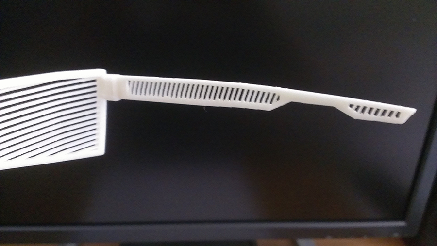

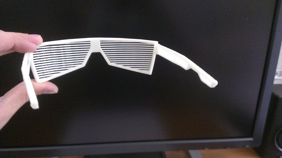

Also, this weekend I designed some glow in the dark party glasses for my little bro! They have full snap in movable joints and are a perfect fit. I am impressed with the resolution and reliability of the Afina for prints like this.

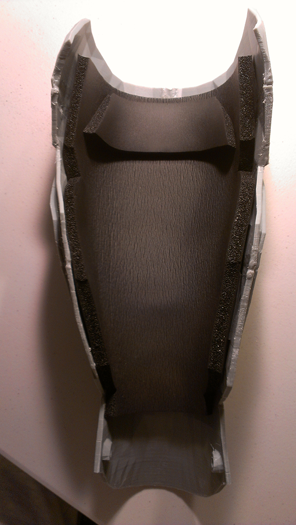

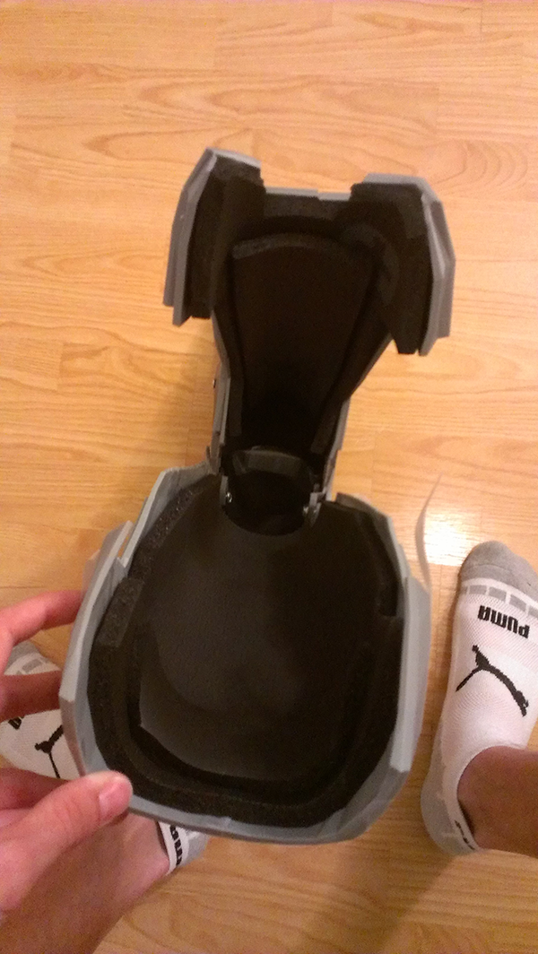

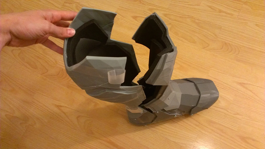

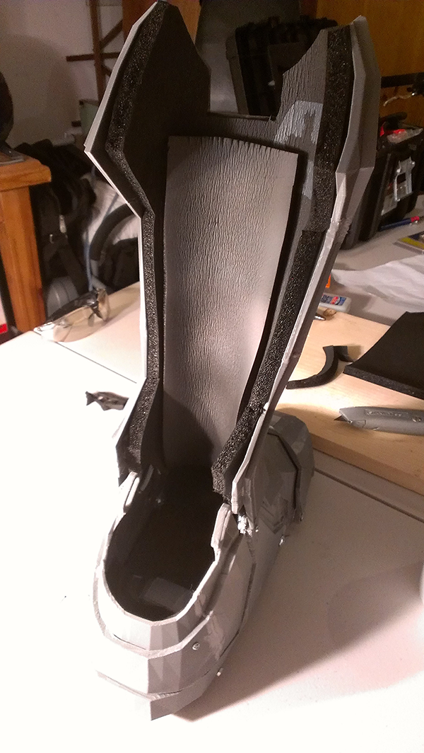

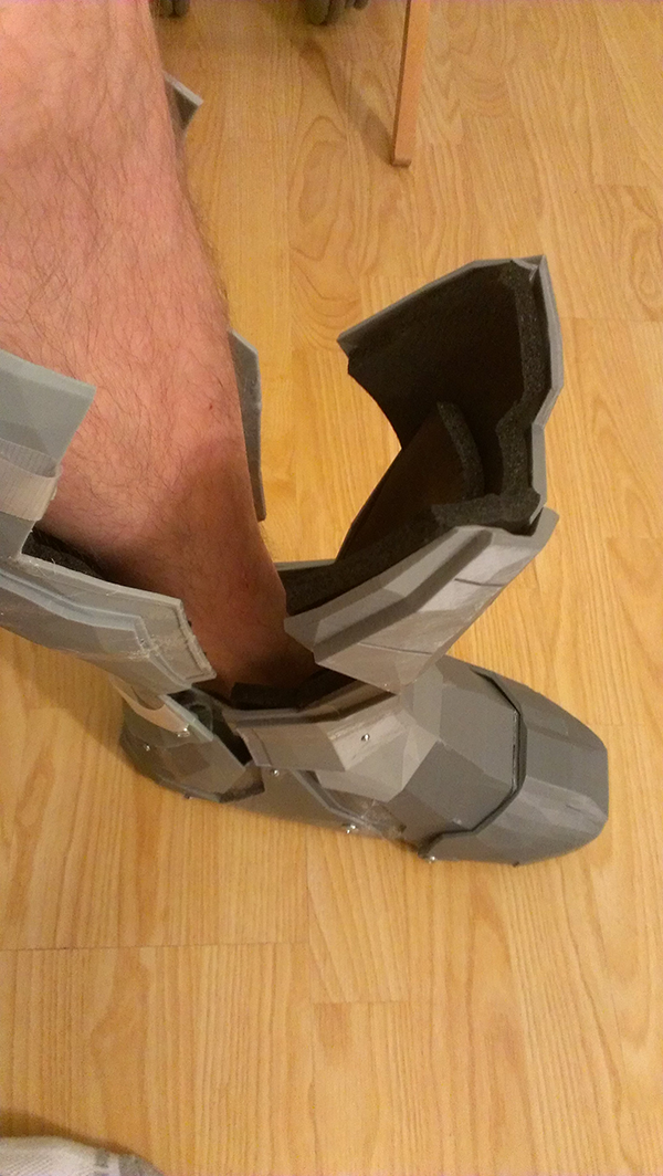

But, I managed to get some progress on inserting all the main matting inside the boot. It fits pretty snug and is super comfy!
Obviously it is taped closed in the video, because Matt is still working on the locking pin setup when he has time.
View attachment 199359View attachment 199360View attachment 199361View attachment 199362View attachment 199363View attachment 199364
