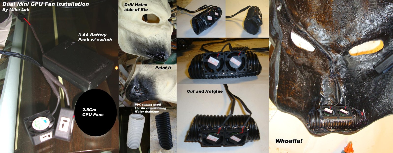

I installed a double 2.5cm cpu fan system in my Bio and it really helps to pull air into the helmet and blowing on the face. It also keeps the helmet lenses from fogging up.
Here's the tutorial:
this is an awesome idea.

When I got into my bio's design I considered where to do fans. I haven't finished them yet but I put slots in my ears to be cut out as an intake and the added ring will be the ducting to the fan in the face.

I nearly always go for a cleverly designed and well concealed half mask for my pred masks and If i have a bio - its gotta have hidden vents - or fit loosely around the lower part of the mouth enough for ventilation. Computer mini chip fans wouldn't be a bad idea if you're making a custom bio helm from scratch and can coceal them and battery pack for that and your lasers
