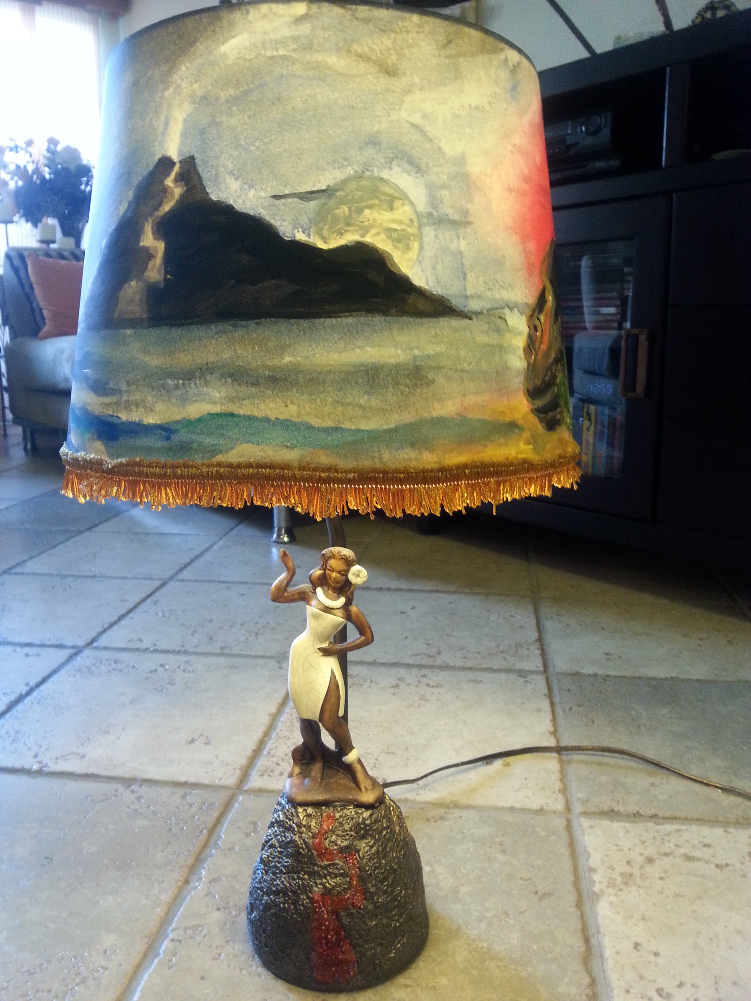

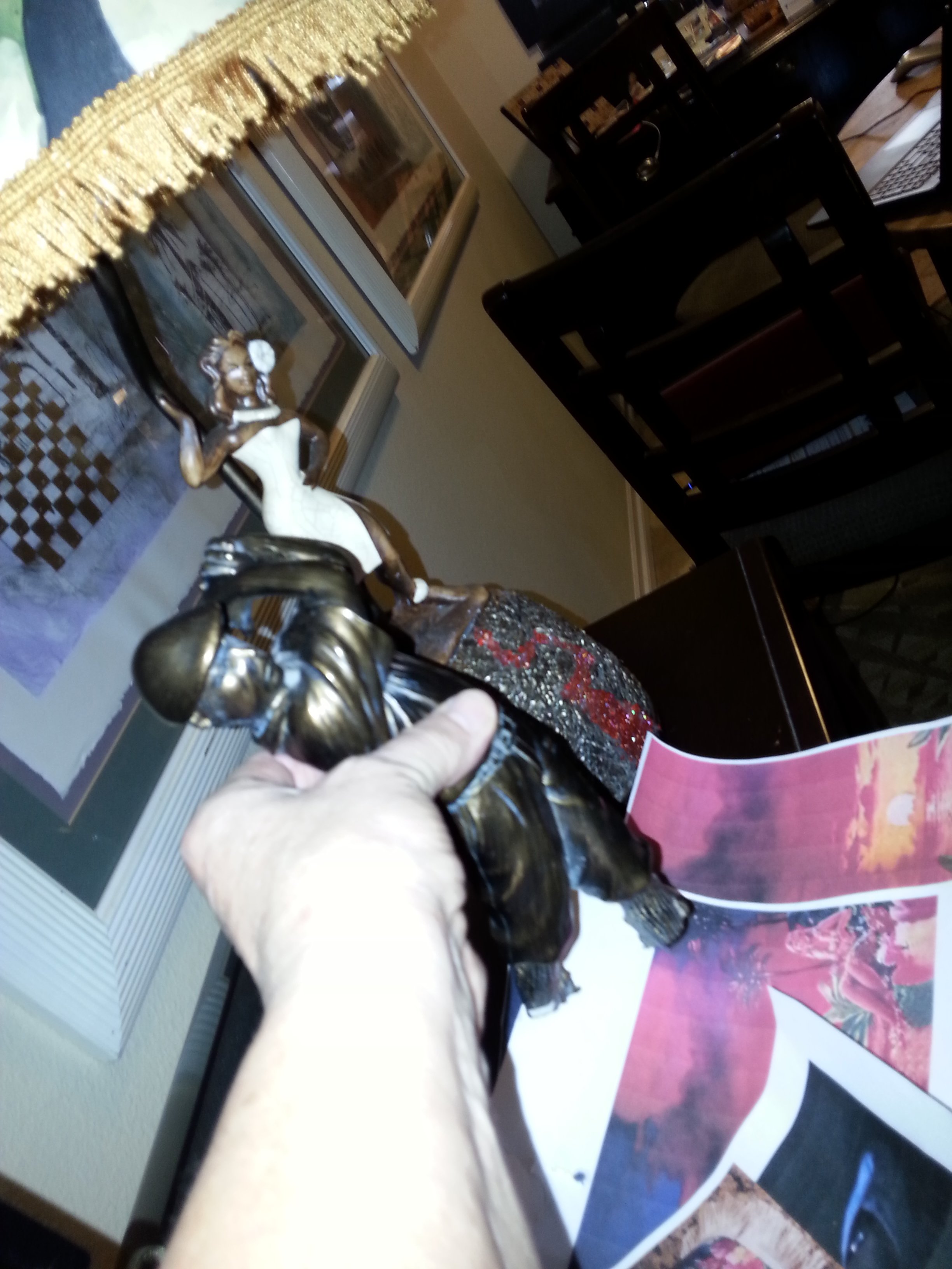

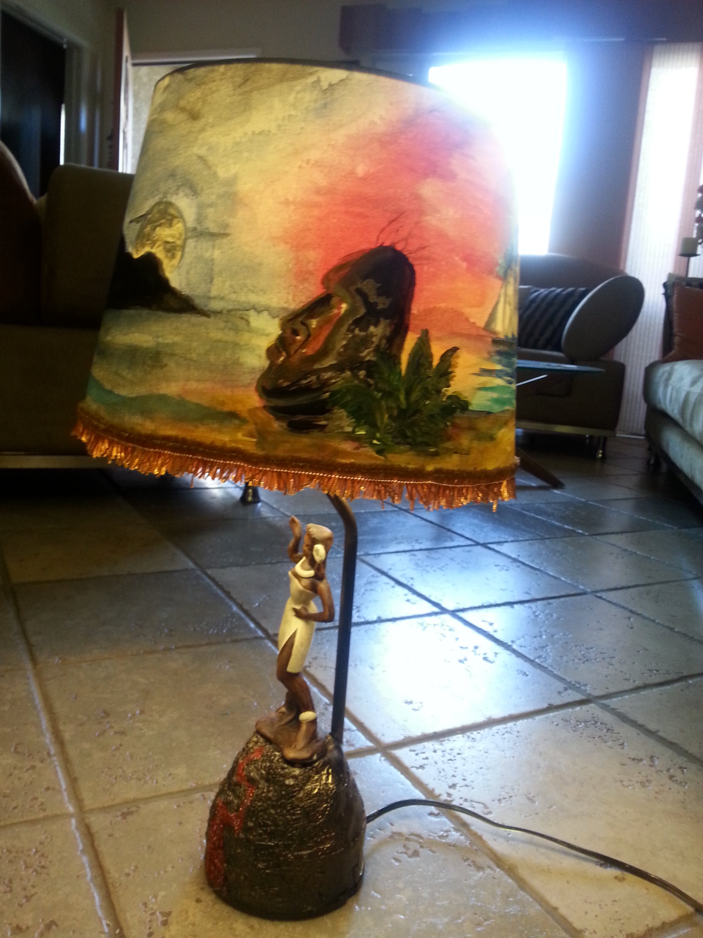

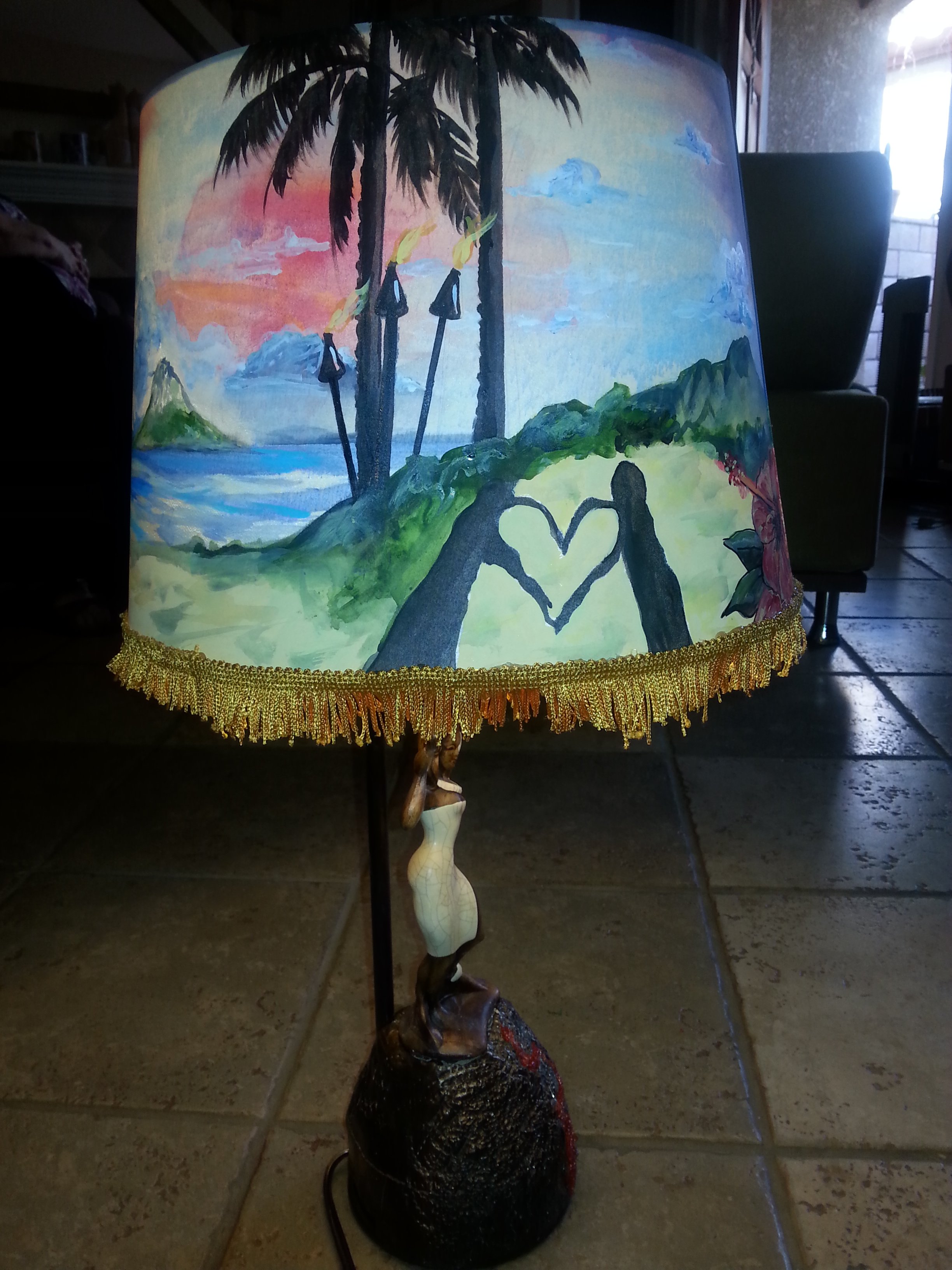

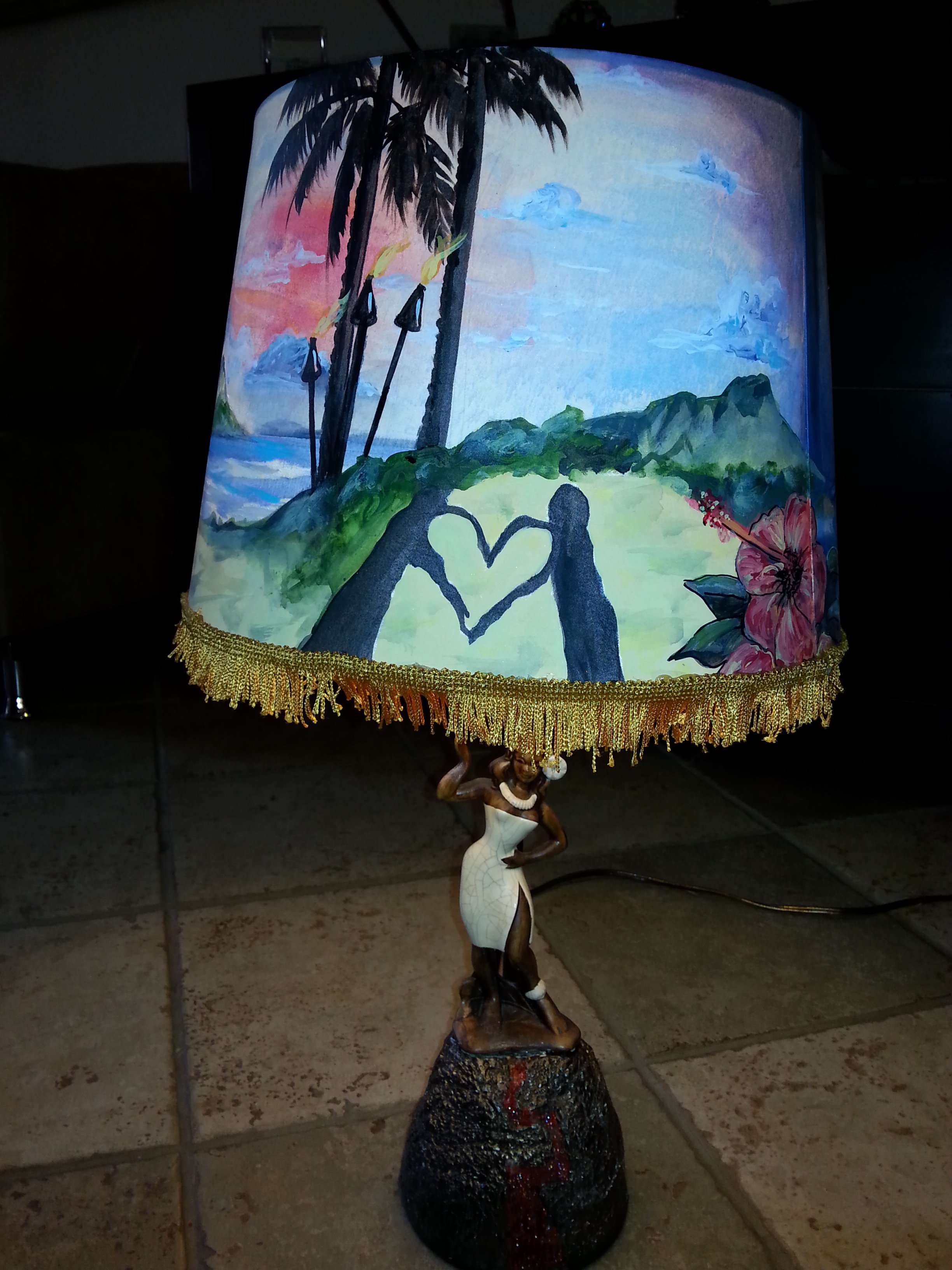

Many thanks to all of you here!!! You were a huge help to me as I was able to reproduce my own Joe vs the Volcano lamp for my boyfriend, who always wanted one! I gave it to him for Valentines Day, and needless to say, he was thrilled!
I started by finding a lamp at my local thrift store...it was a golfer but I just chopped him off at the ankles! I found the hula girl on Ebay. I was worried about painting the lampshade, but it took the acrylic paint beautifully! I found my lampshade to be a bit wider than the original, but that just gave me the opportunity to personalize the back side of it with memories and scenes from our personal trips to Hawaii (I omitted Meg Ryan sitting on the rock). I modeled air dry clay around the lamp base to form a volcano for the hula girl to stand on (I could never really see the lamp base clearly, so again, I just personalized it). On the back I scratched in the words, "AWAY FROM THE THINGS OF MAN".
Hope you all enjoy my version of THE LAMP. 20160214_130858.jpgOK, Now I am just annoyed that I can't make any of my photos upload correctly. Does anyone know how I can fix this???20160214_125945.jpg20160214_130103.jpg20160214_130430.jpg20160214_151143.jpg20160214_130009.jpg20160214_130143.jpgOh well, sorry about the photo orientation...I have no idea how to fix it...but there is my creation!

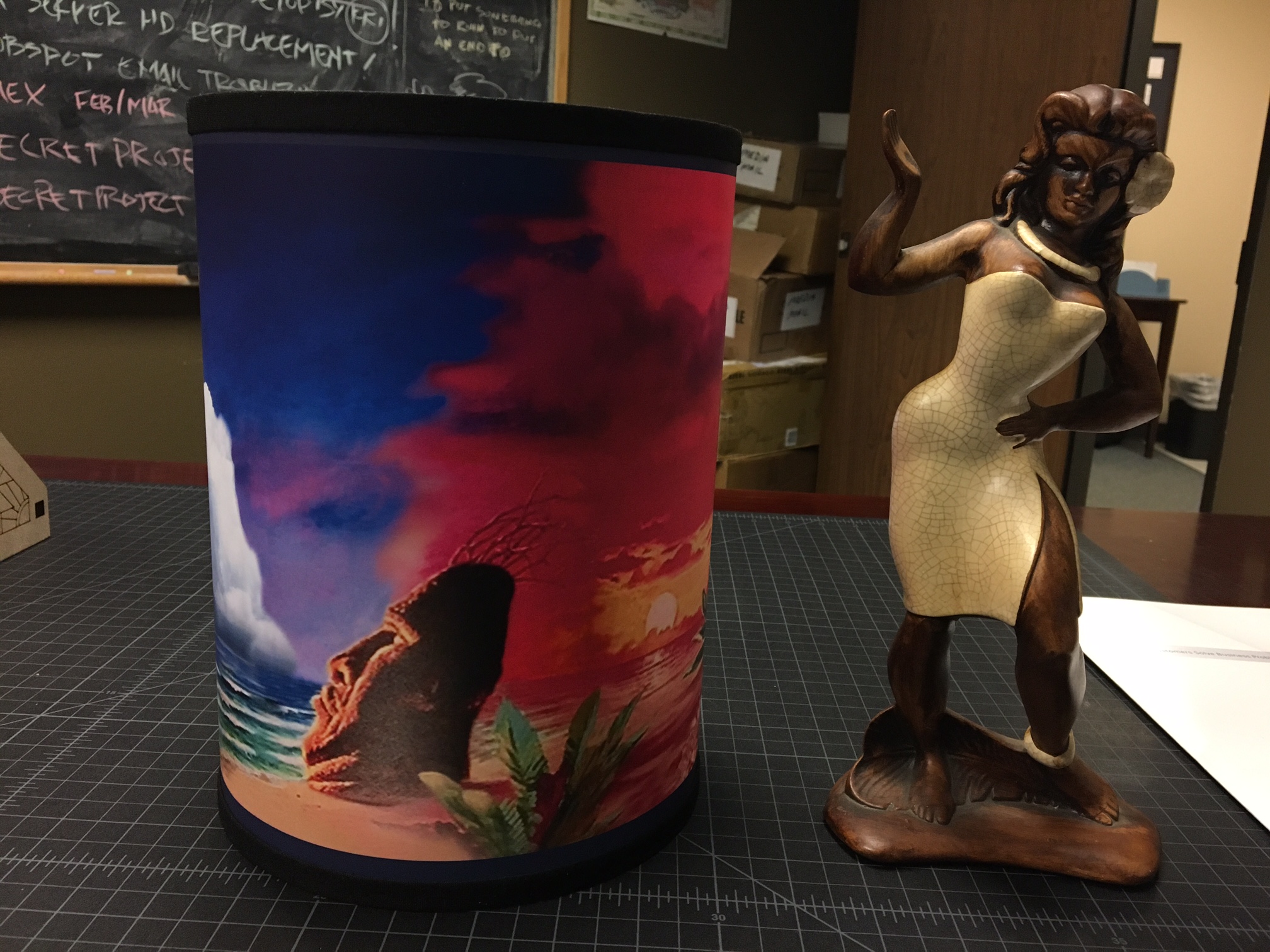

Just got my hula girl in, as well as the lamp shade from zazzle. I'm shopping around for a lamp that will fit this set properly at the local goodwills. When I find one, I'll update. It has begun! -Dave
Don't forget the Fringe material.

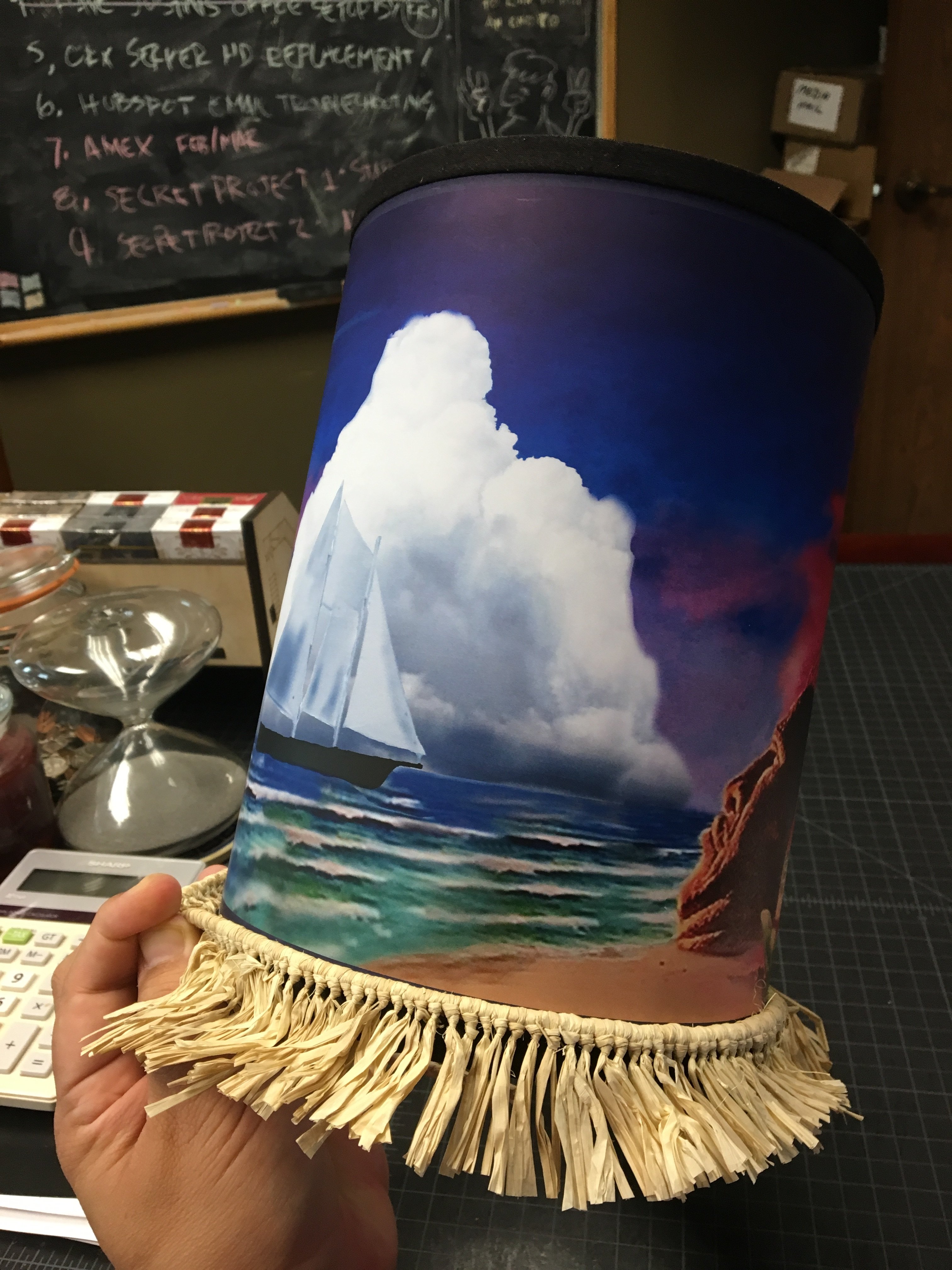

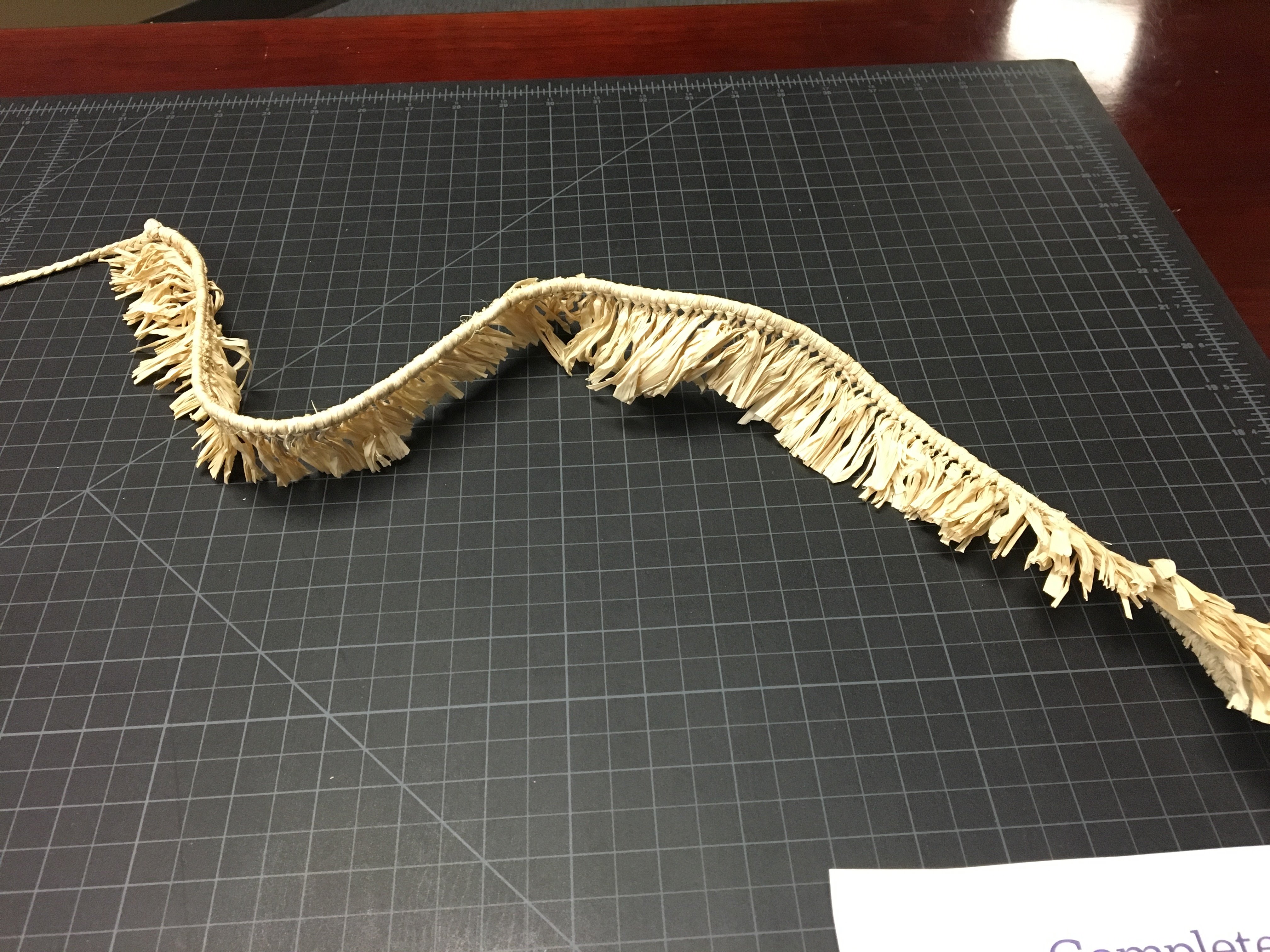

Yup! I have that on order. I'm using a raffia table skirt for the fringe. I plan on cutting it to size as the make shift fringe. I also purchased hemp rope for the top liner of the shade. Hopefully there's not too much difference in the color. Hitting up goodwill again today to look for a proper lamp base.

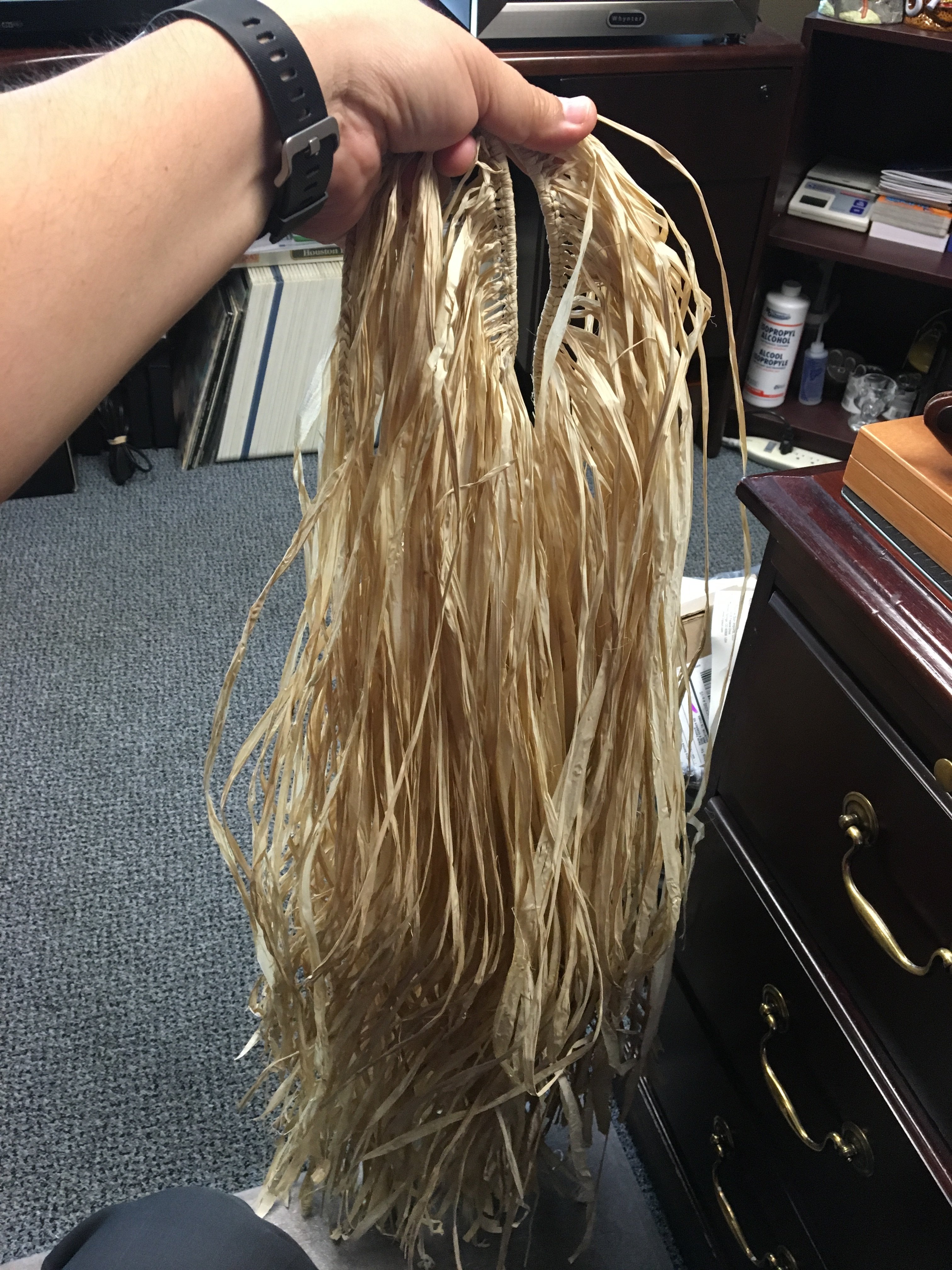

Alright, just got the fringe material and top shade liner in. Again, all of this is makeshift, so I have no idea how well this repro will come out. Surprisingly, the grass table skirt looks like it will work out great for the fringe at the base of the shade. I cut about 18" off the liner, then eyeballed and cut approx. 1.5" of material for the fringe. The hemp rope for the top of the shade is slightly darker in color, but I think it will be fine and not too noticeable. It's a bit thick, so we'll just have to wait and see how everything looks after I glue the pieces on. If the fringe ends up being a success, I'd be happy to point out the item information where I purchased it from. *Also, should I decide to make more of these lamps, I have enough fringe and liner material left over for at least 2-3 more lamps.

Been awhile since I posted anything. This project has taken a bit of a backseat to life. My original lampshade got a bit wrinkled, so I had a new one printed up at Office Depot on glossy poster paper. Need to mount it to some pressure-sensitive styrene to make it more durable.
Also, if anyone is interested in the dimensions, the original lampshade is roughly 28.28 inches long by 9.7 inches tall (should give you a 9 inch diameter lampshade).

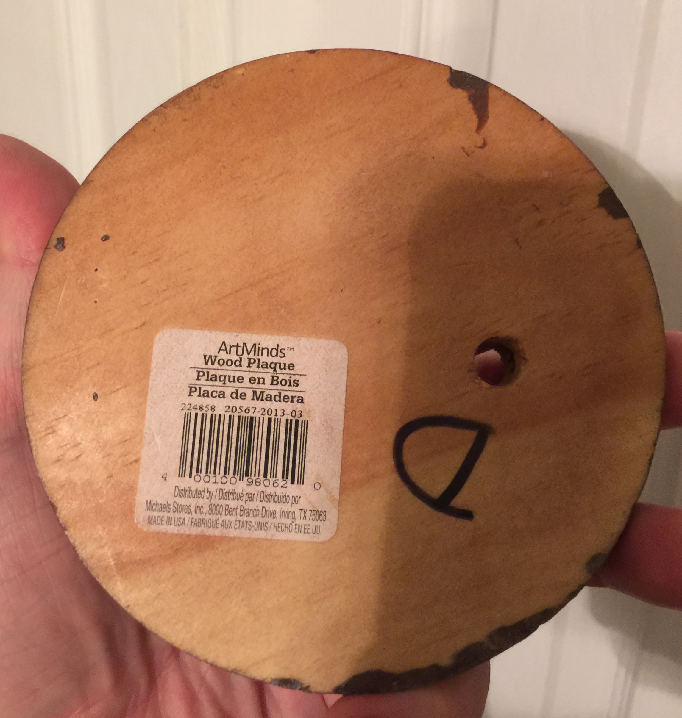

The base of the lamp in the movie appears to be a 5 inch diameter by 3/4 inch tall round wood plaque that you can pick up at Michael's or some other art/craft store. Here are a couple of pics of the base that came with my original lamp (base needs to be refinished badly...). Based on screenshots from the movie, this looks like the right size and shape.

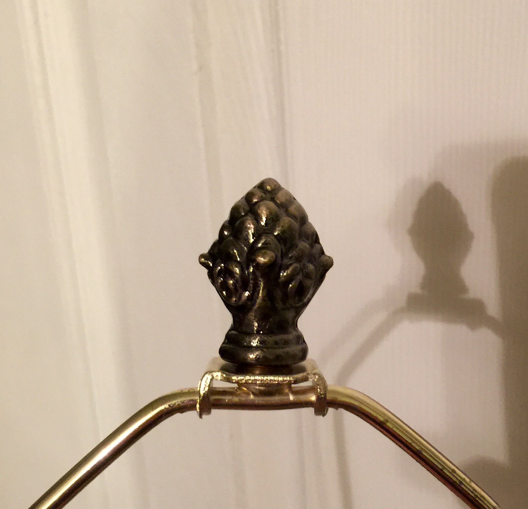

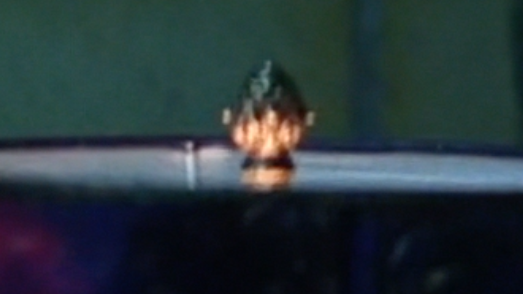

I think I found an exact match for the finial at the top of the lamp, too. Search around on ebay for "brass pineapple finial antique finish". Looking at screenshots from the movie, it seems to be a perfect match. The top picture is from the movie and the bottom is the finial I just got in the mail. Mine isn't lit from underneath in my picture so it's a bit tough to match to the movie, but I looked very carefully at this finial from all angles and compared it to every frame of the movie that showed if and if it's not a perfect match, then it's so close that I'm satisfied.
