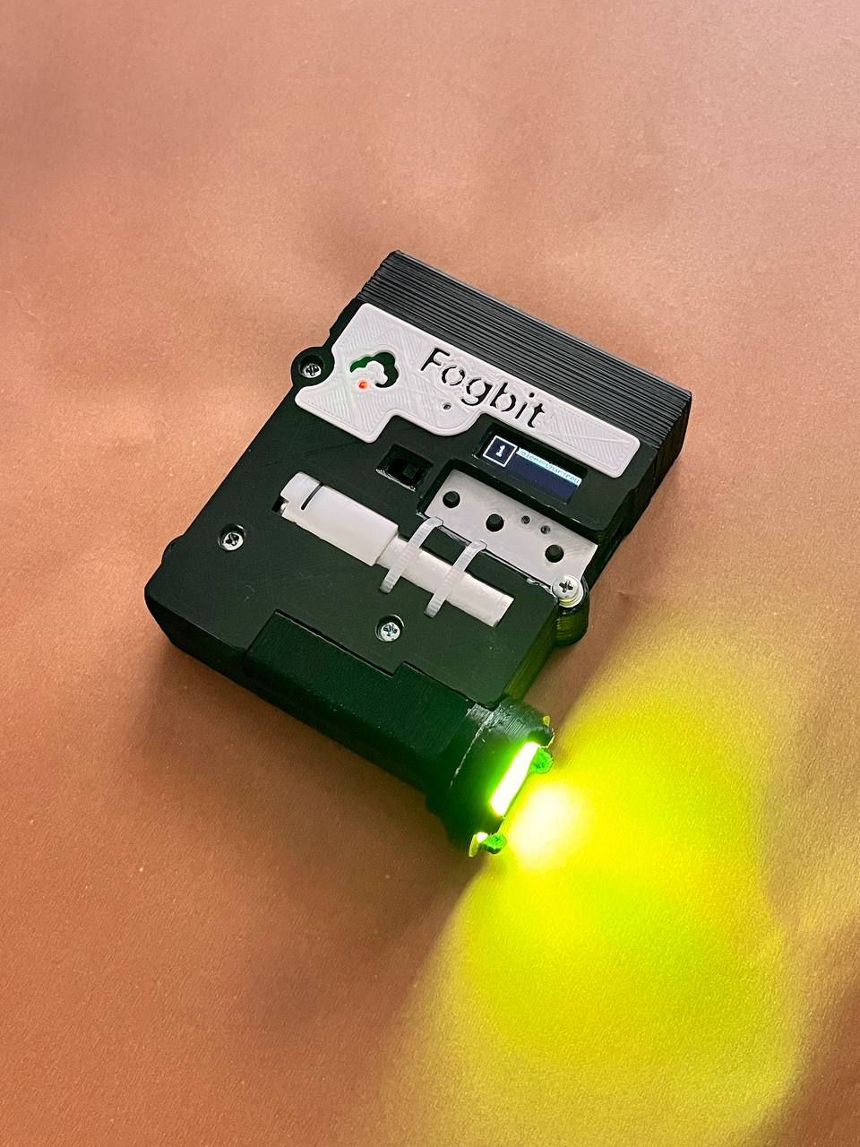

Just wanted to share a prop I've been building – it's called **Fogbit**, a small but mighty fog generator designed for cosplay, photography, dioramas, or even ritual scenes. The whole thing is handheld, rechargeable, and packed with programmable features.
**Main Features:**
- Real fog output using standard water-based fog fluid
- Bright RGB LED at the nozzle tip (millions of color options)
- OLED display with multiple fog and light modes
- Single 18650 battery powered (rechargeable via USB)
- Modular nozzle design – swappable extensions for directing fog precisely
- Compact and self-contained – no bulky tanks or external gear required
Everything from the electronics to the enclosure was designed, printed, and assembled by me. I wanted something that feels like a mix between cyberpunk gadget and magic artifact – compact, eerie, and animated.

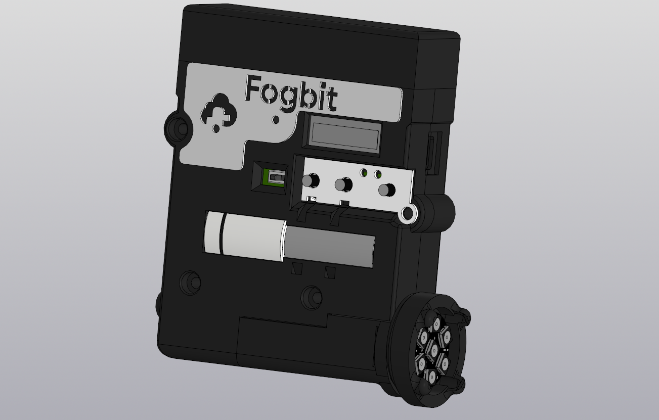

Here’s the original 3D model I designed during development:

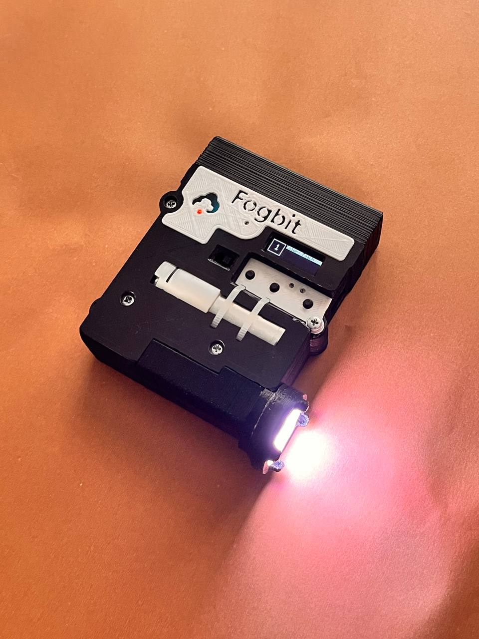

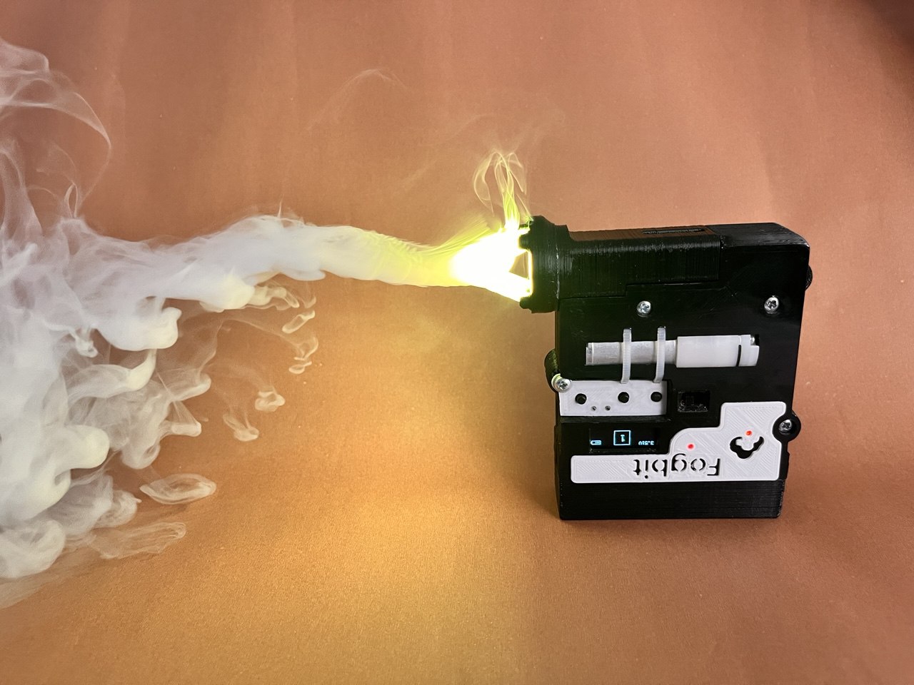

And here’s a photo of the final working device in action:

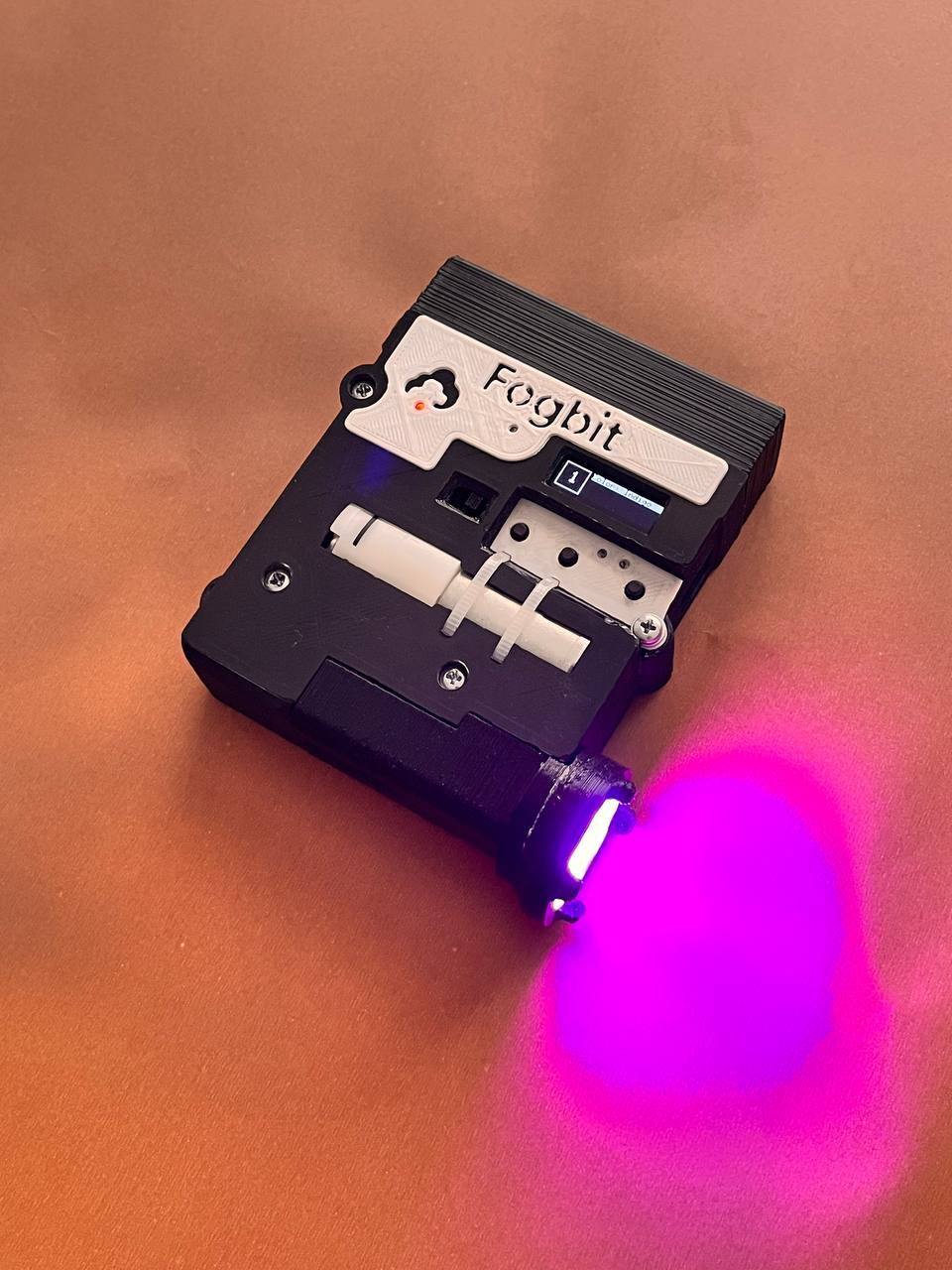

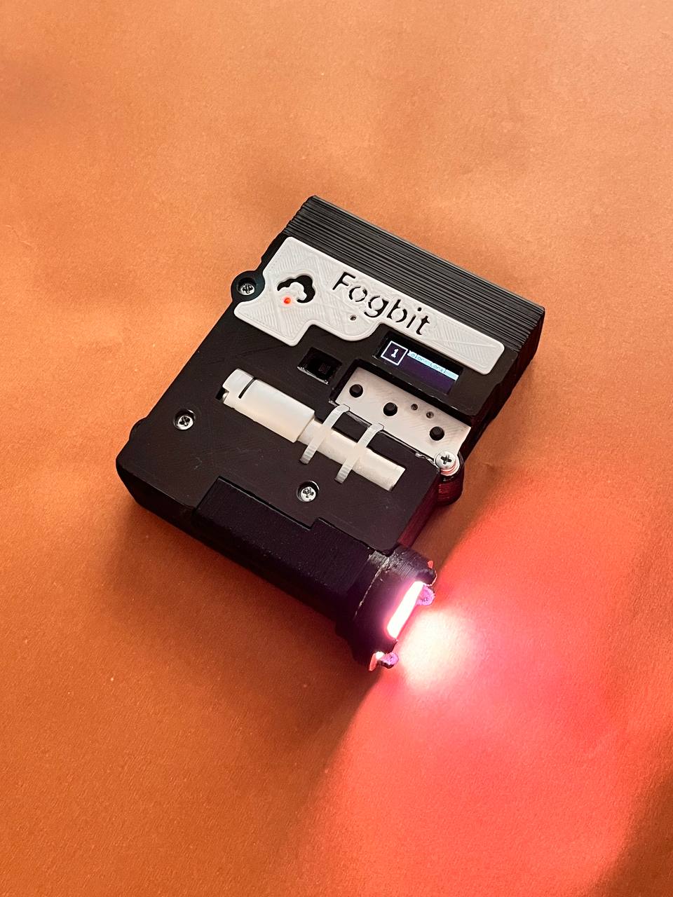

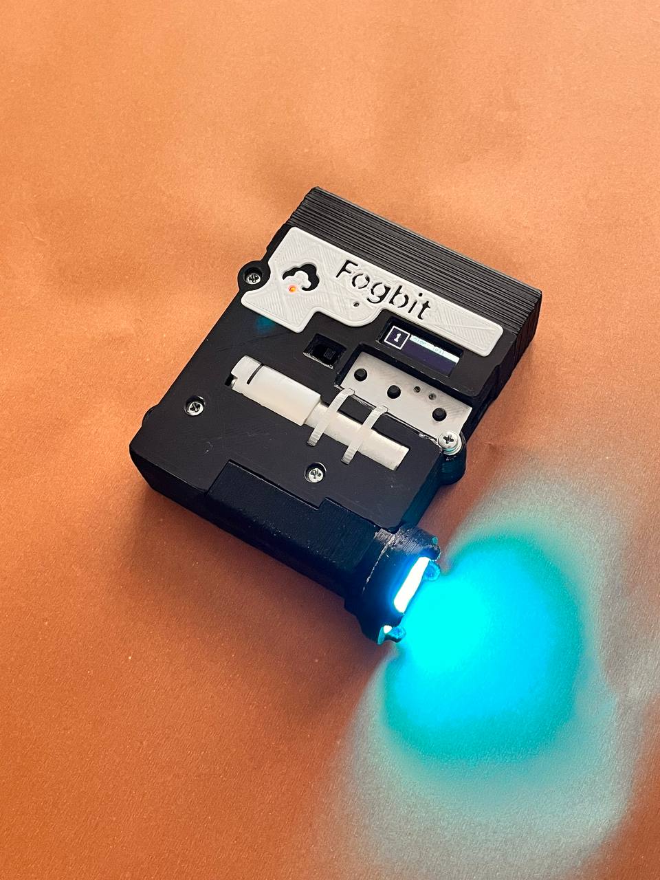

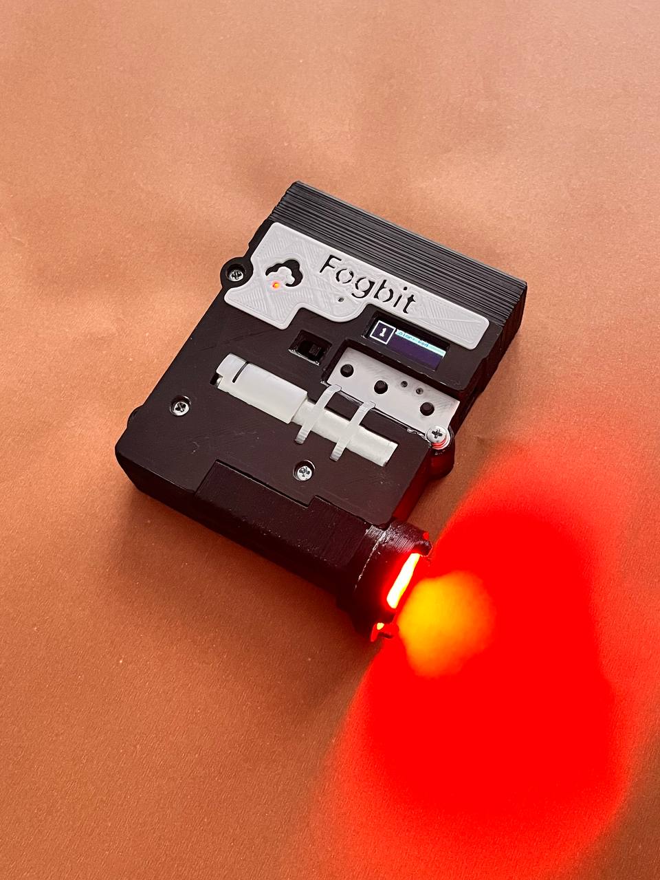

Just wanted to share a quick visual of some of the RGB lighting modes currently implemented in Fogbit.
Each mode can be paired with different fog effects (continuous, pulse, breath, etc.), and the light is fully programmable via onboard controls.
Here's a preview of a few color states from the RGB system:
I’m still experimenting with strobe, color cycling, and interactive light/fog combos — more updates coming soon!

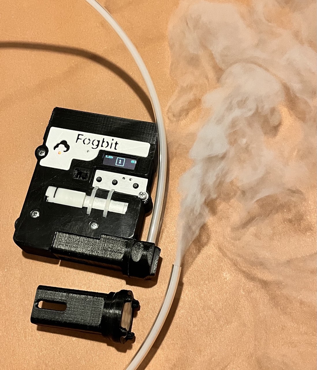

Do you happen to know the internal dimensions of the trap? Or maybe someone else here in the community could share the measurements? I'd love to compare and see if Fogbit could work as a drop-in module.
If it doesn't physically fit inside, there's still a workaround — Fogbit supports interchangeable nozzle extensions with tubing, so it can deliver fog to a remote location. Right now, that extension only carries the vapor, but I’m also working on a version that will route RGB light. Hopefully that will make it even more modular and versatile.

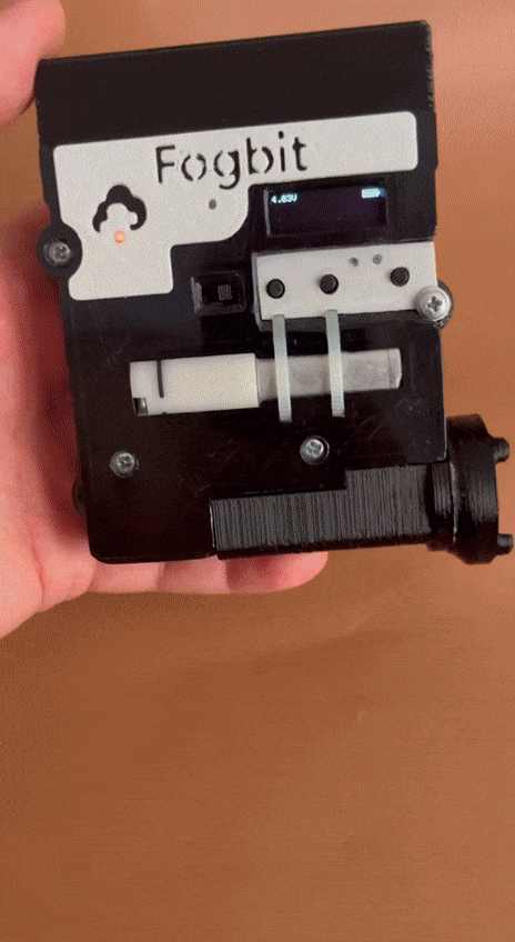

Here’s a short animated preview of the RGB fog and lighting modes I’ve been working on.
This GIF shows how the light and fog interact in real time — currently supporting color shifting, pulsing, and directional fog effects. More modes are in development, including breathing fog, strobe, and synced light animations.
️ The nozzle is modular, and I'm also working on a version with a light-pipe extension for remote RGB output.
Let me know what you think — happy to hear any ideas or requests for specific modes!

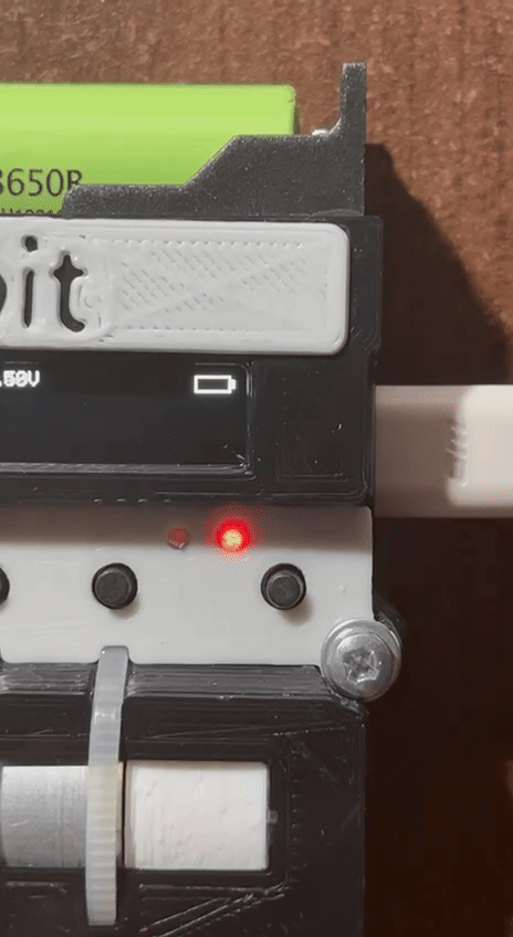

Update: I’ve added a dual charging indicator system to Fogbit!
Now when you plug it in via USB:
A red LED lights up to show the battery is charging
The on-screen battery icon also animates with a filling effect
Once charging is complete, the LED turns off and the battery icon shows full.
Just a small quality-of-life improvement, but it makes portable use much more intuitive — especially during cosplay events, shoots, or mobile setups.

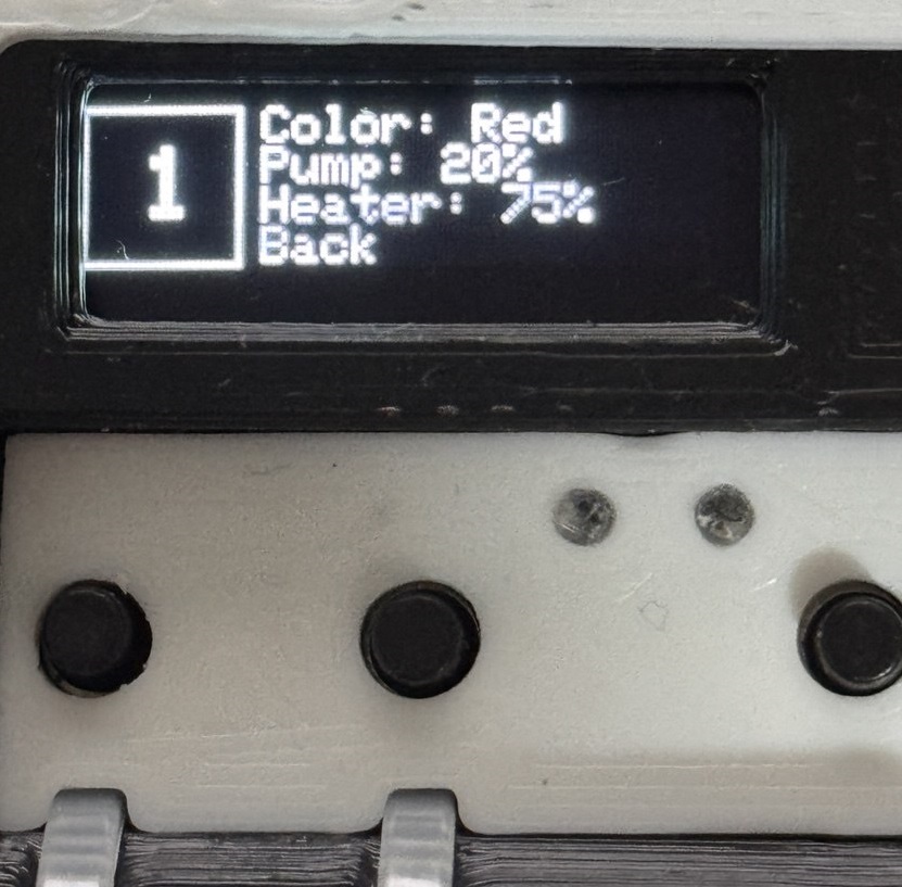

That's a cool device. Can you change the volume/flow rate of the fog output?
Thanks! Yes — in Mode 1 (out of 4 available modes), you can manually adjust both the pump power (fog flow rate) and the heater power to fine-tune the output. You can also select from several preset LED colors for the RGB light at the nozzle.
Once you exit the menu, the last settings are saved — so the next time you activate Mode 1, it will use your previously chosen configuration.
