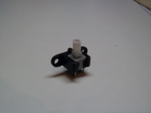

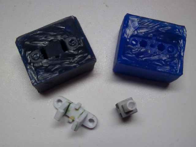

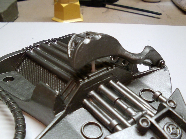

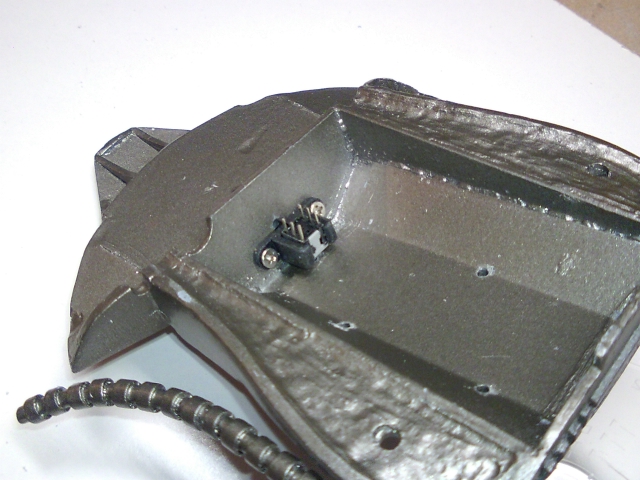

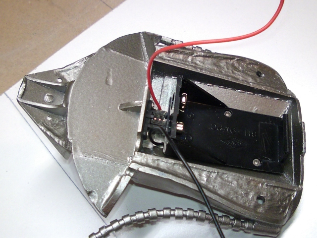

I have made an improvement concerning the switch to turn on the LED/Lasers. The original used a simple momentary on, lever action microswitch. I have searched high and low to find a switch that would latch on when pressed and turn off when pressed again and this is what I came up with but it is a totally different form factor than the original switch so....I had to come up with a way to mount it. My solution was to design a bracket that the switch could simply snap into. To do this I used 0.060" thick styrene plastic and created a model of what I wanted it to be like which I then made a silicone mold of and cast the piece in resin. It worked great and any future Level 2 bio's would be get this mod as part of the electronics options. Anyway, here are the pics of what I did.

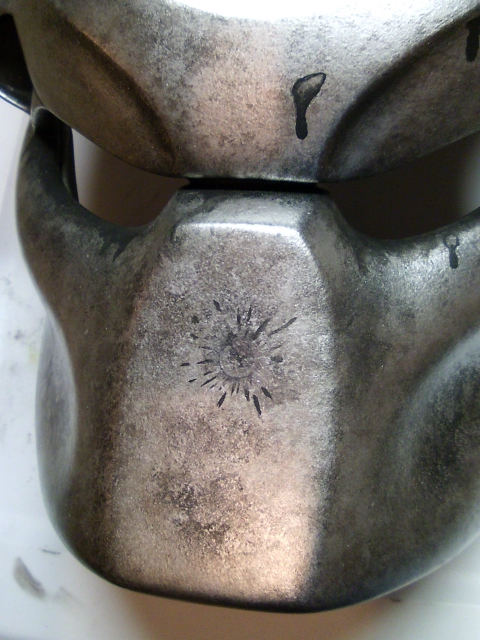

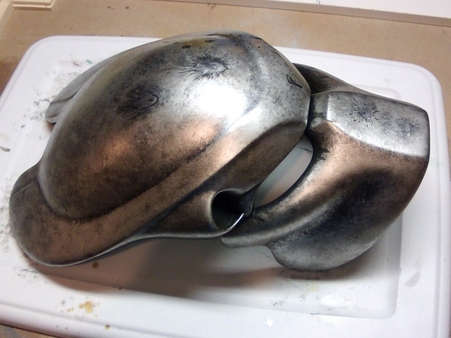

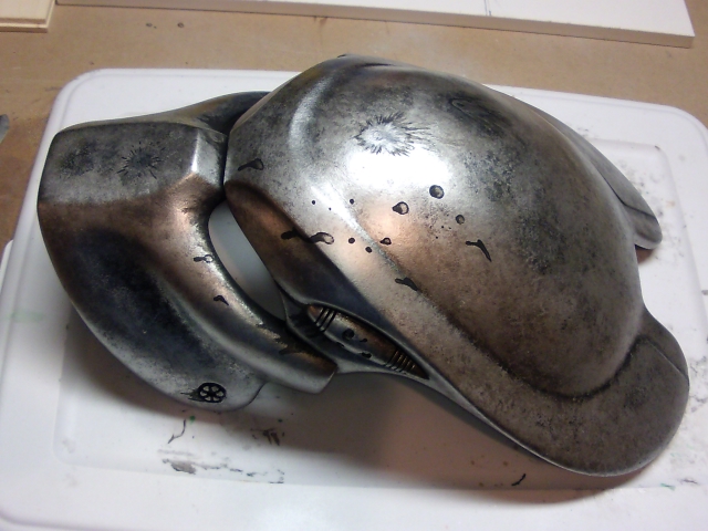

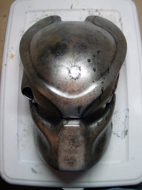

Also, here are a few bonus pics of the paint job on a bio I am working on at the moment.

Thanks Jason. These things are fun to paint as I am sure you  are aware. The new switch actually solves two problems I had with the original design. One that the pin could slip past the lever arm on the microswitch and two, that you weren't able to turn on the lasers and have them stay on without having to press and hold the lever piece in the helmet. Jeff, if you read this and want a retrofit kit let me know and I will send one to you. There is one other change I may make to the new switch bracket to make it easier to install but it shouldn't take long to do. Just part of working the kinks out.

Thanks guys...it is turning out well so far and I am having a blast making it. I have purposefully not been trying to push these things until I can get a little more caught up which is helping to give me some much needed breathing room. The pressure pot works great for making bubble free silicone molds as well and it is helping me immensely to cast the detail pieces. Brian, I love what you did with yours. The clean look, black leather and stand all turned out great. The hoses also really helped to set it off.
