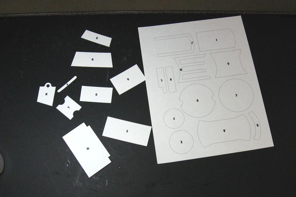

I made the template in Gimp, and then assembled everything out of EVA foam.
Here's the final template: http://www.thefoamcave.com/wp-content/uploads/2015/11/Template-for-Ant-Man-Belt.pdf
And now on to the instructions:

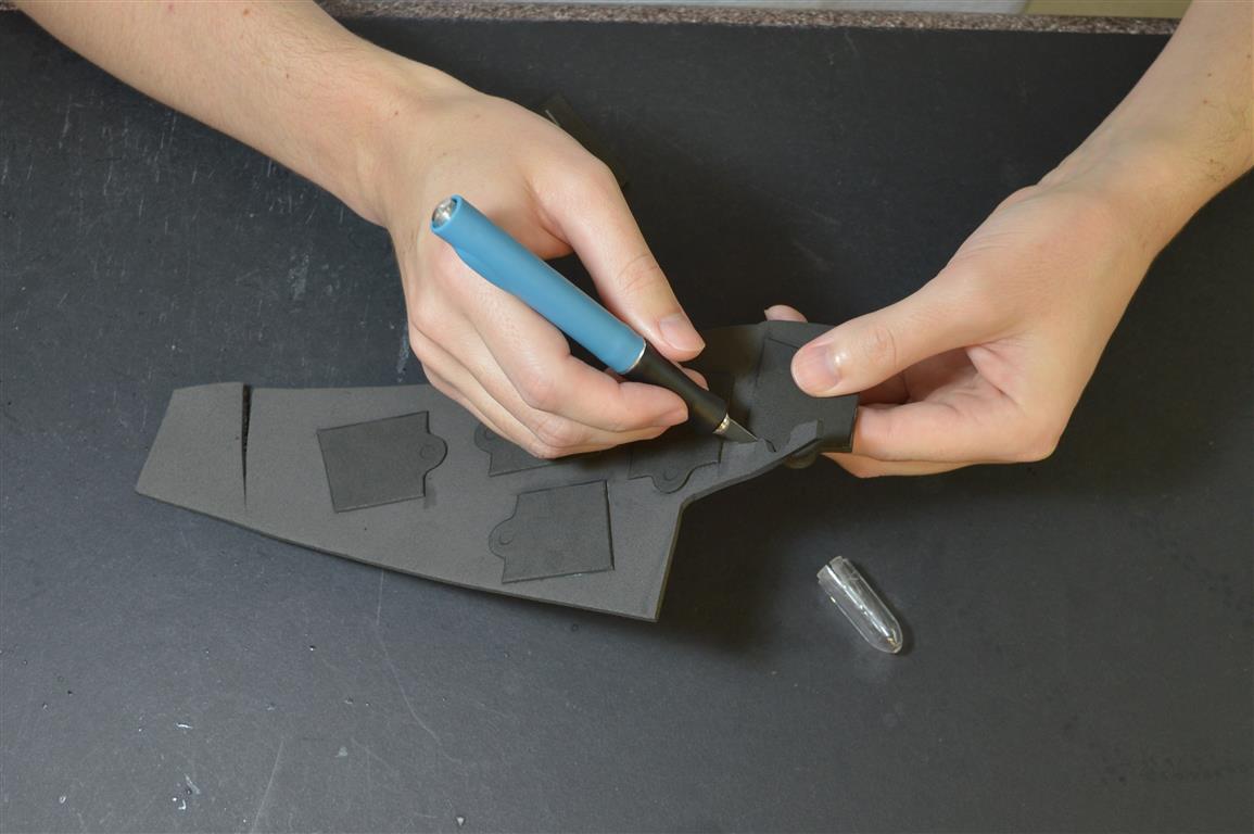

Print out the template onto thick printer paper (ideally a poster board paper) to make it easier to trace. Cut out all the pieces and trace them onto your foam sheets. I get my foam from Hobby Lobby. Use a few pieces of scotch tape to hold the template in place on the foam when tracing. You can use a regular ball point pen; at the moment I like those space pens as they flow smoothly over the foam. I recommend 3mm thick foam for most of these pieces, and a couple will be 5mm or 2mm as noted below.

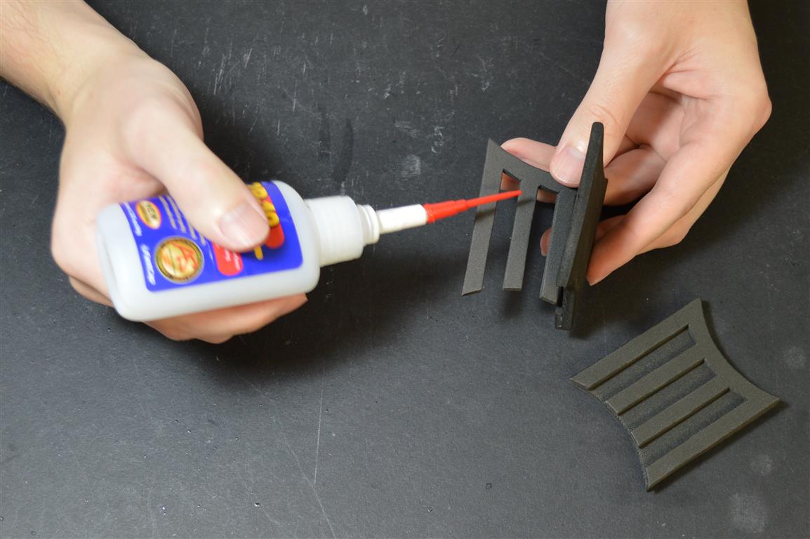

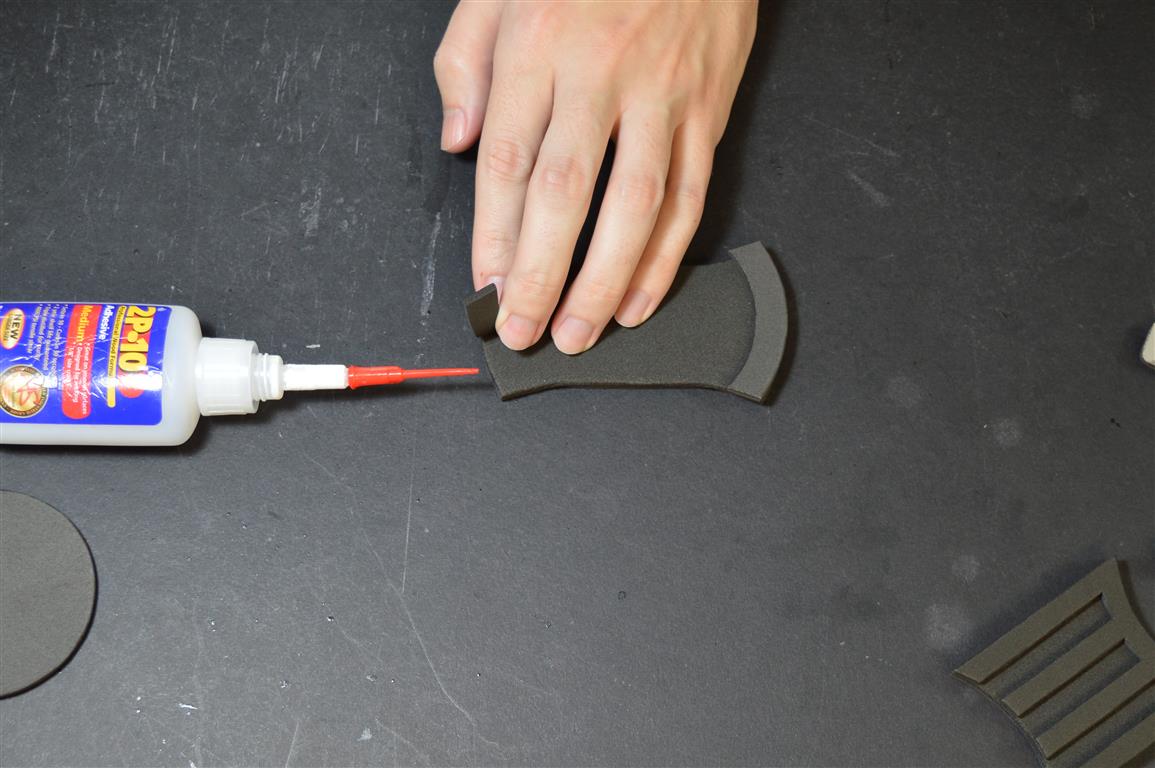

Cut two H pieces out of 3mm foam and two G pieces out of 5mm foam. Glue the H’s on top of the G’s. I like using super glue for all my projects, mainly Rhino Glue and Fastcap 2p10. To help with alignment, lay them on top of each other where they will go first, and then bend back one corner and apply a small amount of glue and then let that dry before finishing gluing the rest of the piece. Do the same with four J pieces (3mm) and four I pieces (5mm).

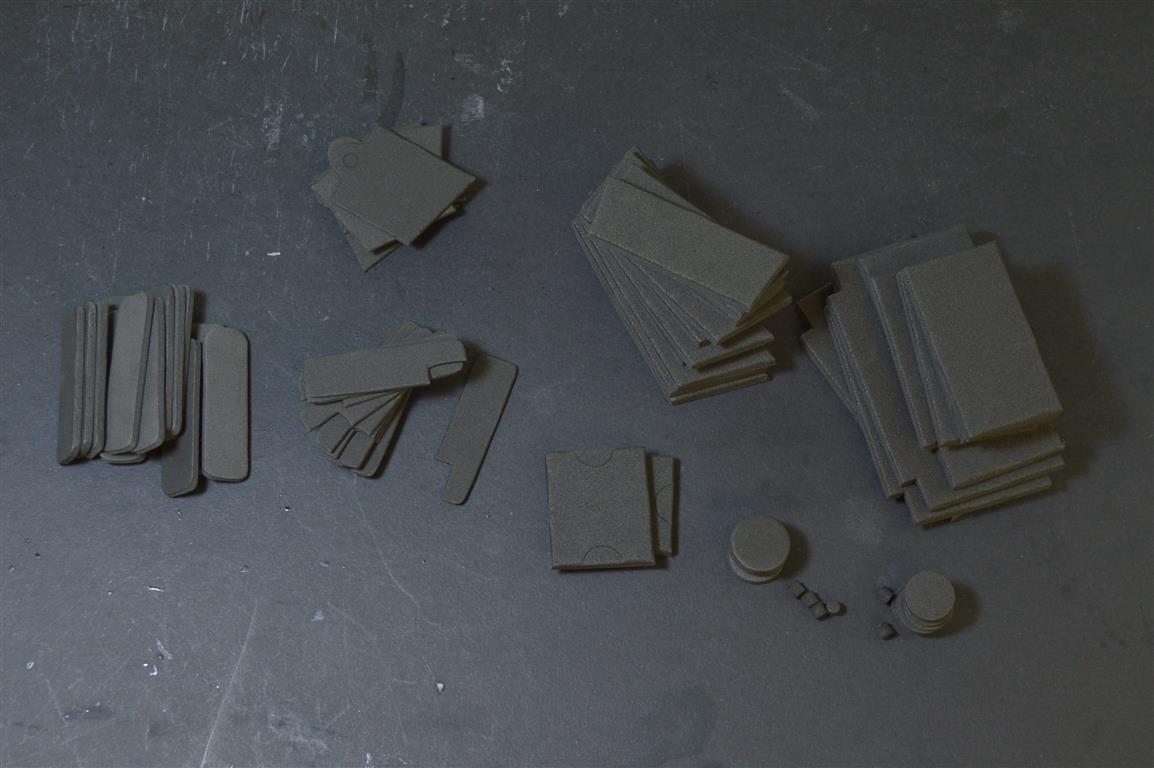

You can use the punch set again to make all the small circle shapes, 8 W’s out of 2mm and 4 V’s out of 3mm. Most of the M through U pieces should be 5mm (except P which is 3mm) to ensure they fit together properly. N may be too difficult to cut out of 5mm due to the tight curves at the bottom, so for that piece you may want to cut it out first in 2mm foam and then glue it to a sheet of 3mm foam and then cut it out again using an xacto knife, to end up with a combined 5mm piece. It can then be sanded as before, and the hole punched.
DSC_0241c (Medium).JPGDSC_0243c (Medium).JPGDSC_0244c (Medium).JPGDSC_0246c (Medium).JPGDSC_0274c (Medium).JPGDSC_0275c (Medium).JPGDSC_0276c (Medium).JPG

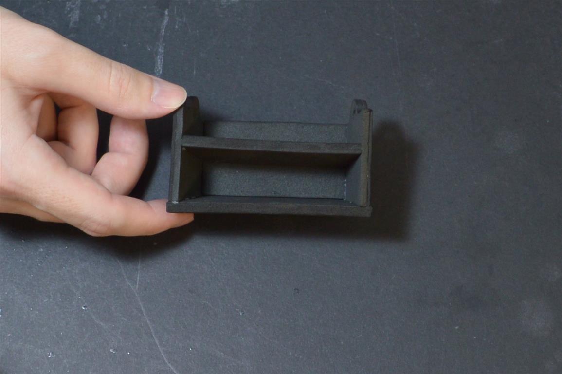

Glue one Y perpendicular to the middle of one O. Next glue an N onto both sides, and finally one Q on top. When gluing, make the N’s and Q as flush as possible with O. Repeat the steps to make one more identical piece.
DSC_0278c (Medium).JPGDSC_0277c (Medium).JPGDSC_0279c (Medium).JPGDSC_0280c (Medium).JPGDSC_0281c (Medium).JPGDSC_0283c (Medium).JPGDSC_0284c (Medium).JPGDSC_0285c (Medium).JPG

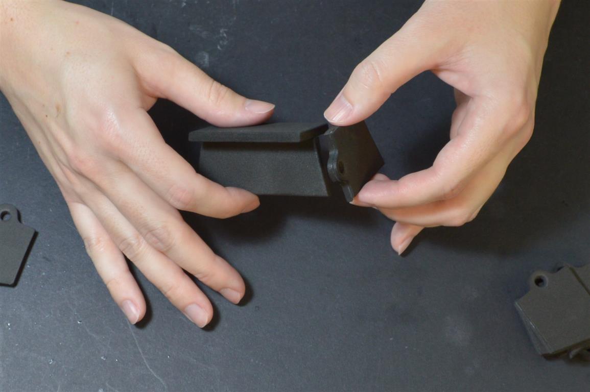

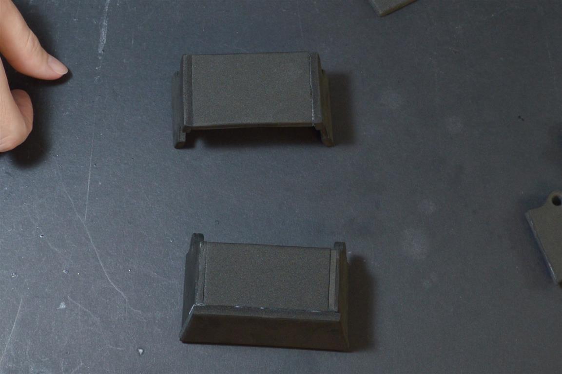

Glue one Y perpendicular to the middle of one U, and two T’s to the sides, flush with U. Use the sanding blocks to smooth out the front and sides of the pieces, as well as to fix the angle of the back edges so they can be glued flush to the back pieces M and S. The more time you spend here with the sanding block using a high grit number, the smoother the surface will be and the better your finish will be later after painting.
DSC_0286c (Medium).JPGDSC_0287c (Medium).JPGDSC_0288c (Medium).JPGDSC_0289c (Medium).JPGDSC_0290c (Medium).JPGDSC_0291c (Medium).JPGDSC_0292c (Medium).JPGDSC_0294c (Medium).JPGDSC_0293c (Medium).JPG

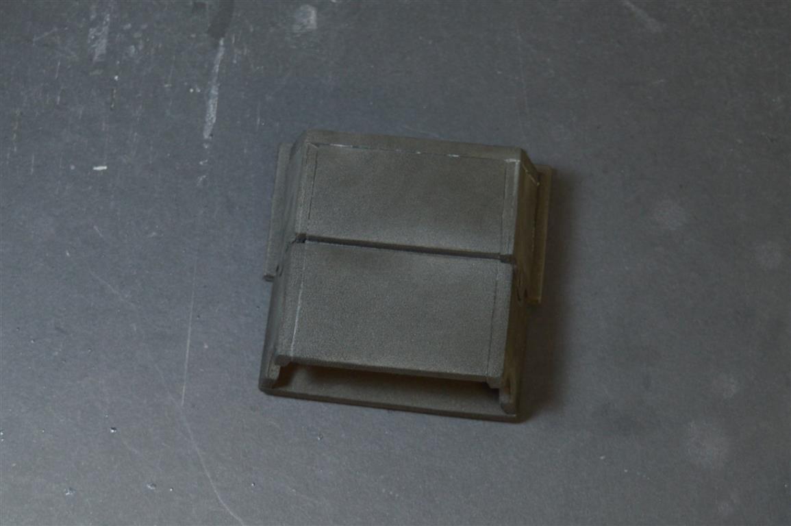

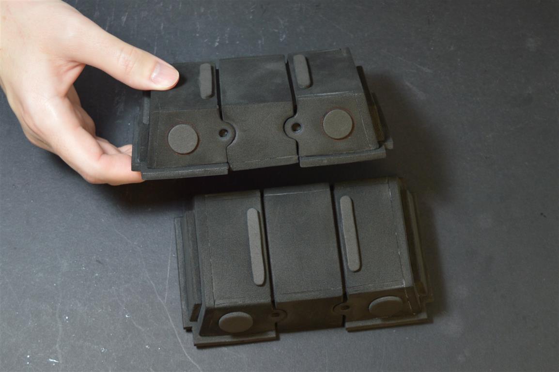

Glue S onto the back of the middle piece, and then sand the sides if necessary. Cut another O piece and use it to connect the top piece to the middle piece by gluing it to the back side of the front of each piece. Cut a couple extra V pieces to use to reinforce the sides and provide a gluing surface for the X’s later. Glue M to the back of the top piece, and R on top of Q. Do the same for the bottom piece, and then repeat the whole process again to make the second whole piece.
DSC_0301c (Medium).JPGDSC_0302c (Medium).JPGDSC_0303c (Medium).JPGDSC_0305c (Medium).JPGDSC_0308c (Medium).JPG

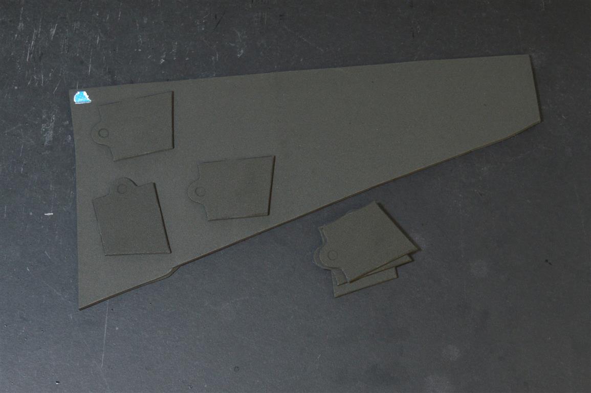

Glue the P pieces (3mm) to bottom center of the O pieces. Glue the four V pieces (3mm) to one side of each of the large pouch pieces, and four of the W pieces to the other sides. Cut the dashed circle lines out of the N template shape and use it to mark where the circle pieces will go to help with alignment. Squirt a drop of glue into the small holes in the N pieces and then drop an X piece (5mm) into each hole. (The X pieces by the way happened to be the exact same size as the largest bit on my leather rotary hole punch, which is a little easier to use than the other hole punch set and makes cutting out the shapes a snap.)

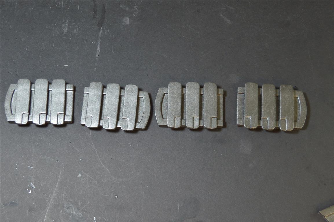

The pieces are now ready for painting. I like to brush on a thick coat of Benjamin Moore Aura first to help smooth out the slight texture of the foam. I used a Dupli-Color gunmetal metallic spray paint for the silver, and a brush on red acrylic for the red pieces, as well as an acrylic black for piece E. (Note that E is probably not actually black in the movie belt. I simply saw it that way in one of my reference pictures and liked that look better.) I taped the pieces to paint sticks to make them easier to paint. I might also recommend spraying on a couple coats of clear Plasti Dip to help protect the finish. Just make sure to practice spraying several coats onto something else first, as it can become cloudy and speckled if applied incorrectly.

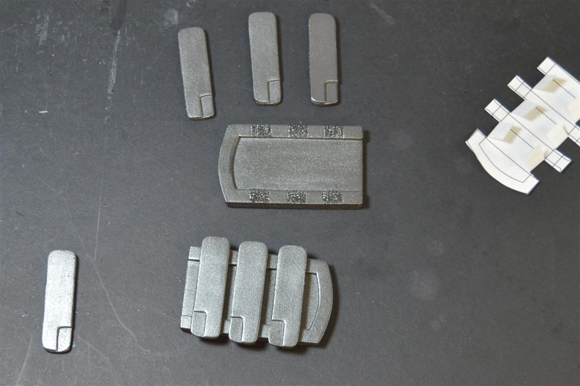

And again the same for the L/K pieces onto the J/I pieces. Note how they are oriented on the final belt.

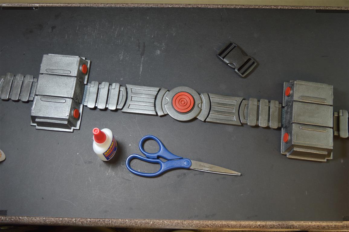

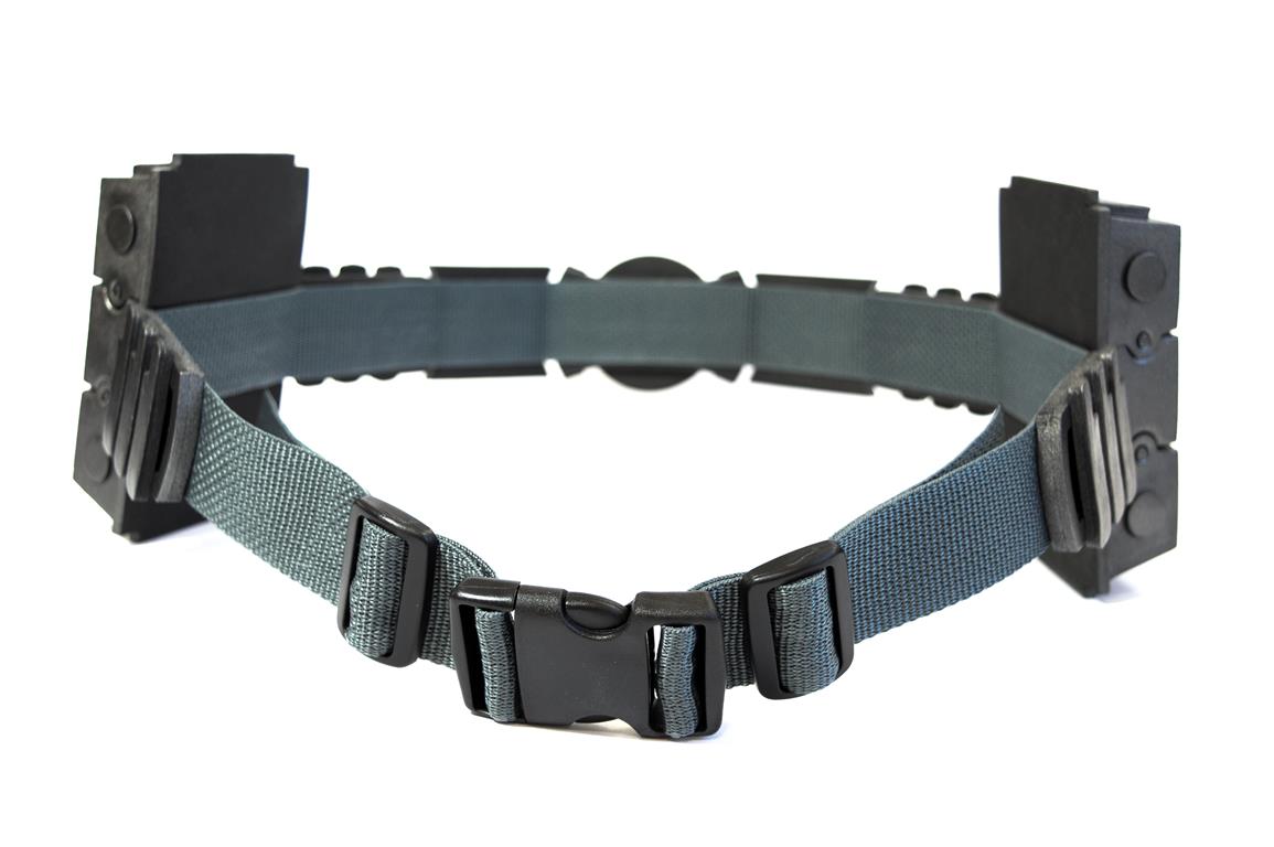

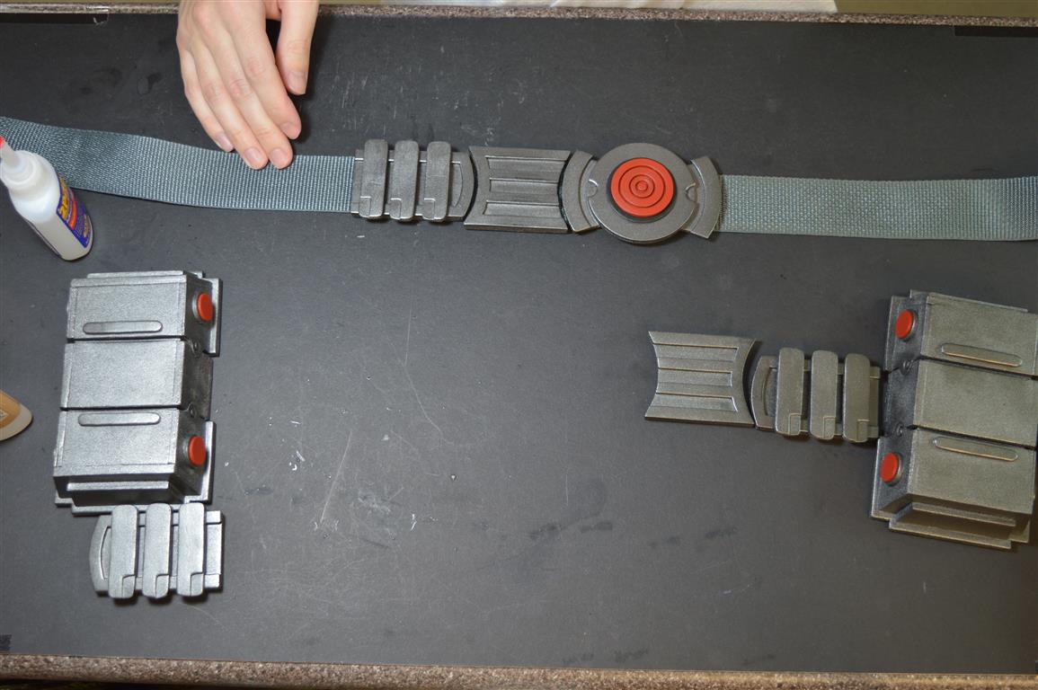

Cut a length of 1.5 inch strap webbing long enough to wrap around your waist and thread back through the buckle hardware, along with some extra length for size adjustment. I used 1.5″ charcoal colored lightweight polypropylene from Strapworks.com. Apply glue to the back of each piece and glue it down to the webbing, starting with the decorative buckle in the middle. Leave a little space between each piece so that the belt can bend around your waist properly. I used a plastic buckle and two tri-glides (all from strapworks as well) to fasten and finish the belt.
DSC_0336 (Medium).JPGDSC_0337 (Medium).JPGDSC_0338 (Medium).JPGDSC_0340 (Medium).JPG3 (Medium).jpg
View attachment 553463View attachment 553464
Cut a length of 1.5 inch strap webbing long enough to wrap around your waist and thread back through the buckle hardware, along with some extra length for size adjustment. I used 1.5″ charcoal colored lightweight polypropylene from Strapworks.com. Apply glue to the back of each piece and glue it down to the webbing, starting with the decorative buckle in the middle. I used a plastic buckle and two tri-glides (all from strapworks as well) to fasten and finish the belt.
View attachment 553475View attachment 553476View attachment 553477View attachment 553478View attachment 553481
