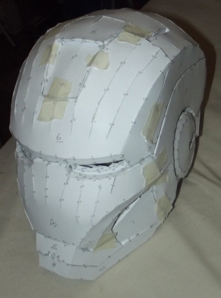

I'm new to the forum and I've been following it adamantly. I got hold of some pep files and I am going to move on to the resin/bondo phase soon.
I just want to find out which mold making product works best - Smooth-cast 300 or smooth-cast 65D? I've seen both being used, but can someone tell me what the difference is? Going to post pics as I progress....my first pep project, so please be gentle. Hehe

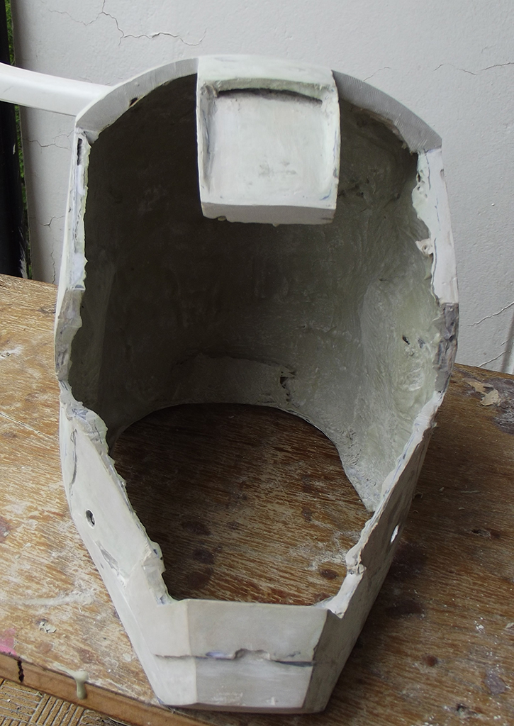

Seems the ratio of hardener to fibreglass resin on my product is a bit off. The pep is still a bit tacky after half a day. Any ideas how to salvage it or must I pep again?
Re: Molding question - Iron man Mk IV
OK guys and gals...seems the body filler in this country is really hard to work with. It's gets crumbly real quick after adding hardener. I tried varying quantities of hardener vs filler with no luck. I was looking at a youtube vid of Cereal Kill3r and how he used rondo to add a part to his halo armor and I was wondering if I can use straight up rondo to cover the outside of the resin covered pep helmet? Here's a vid of what I mean...minus the paint roller technique obviously.

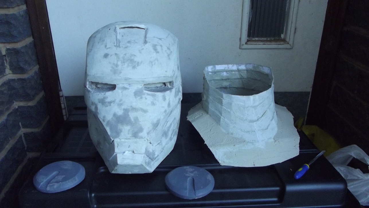

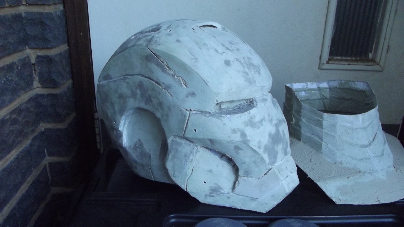

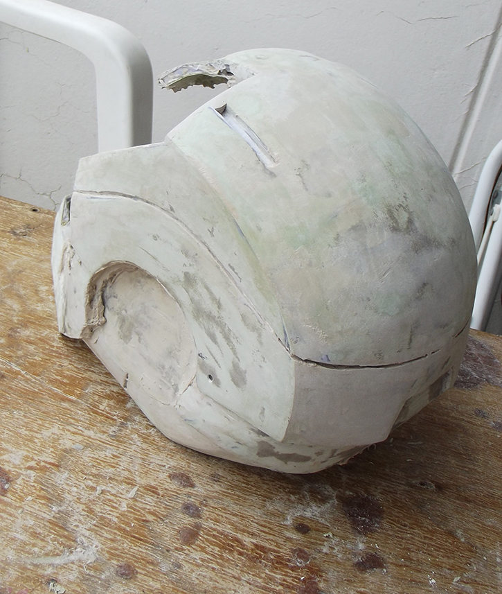

Here's what I have so far. The rainy season is messing with my time frame here cause I can only work on the balcony of my apartment. Still have some sanding and detailing to do.

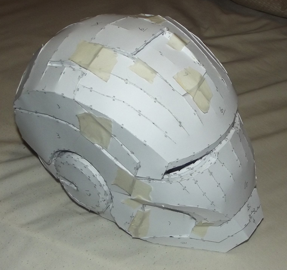

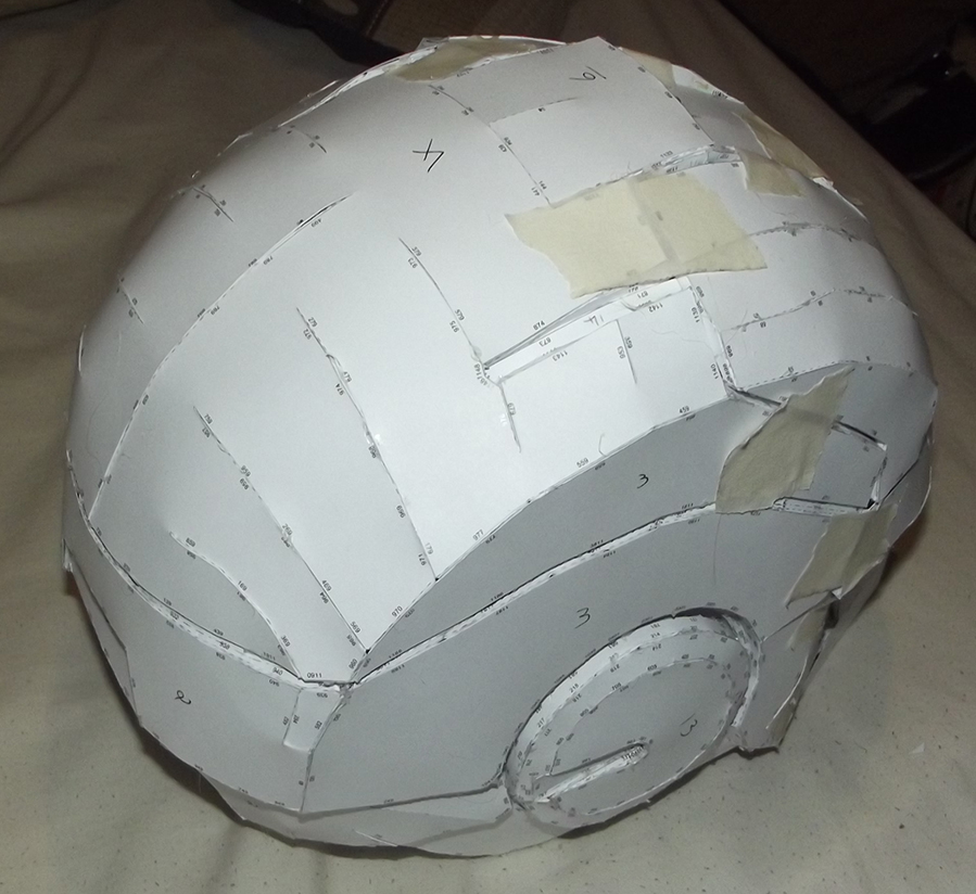

View attachment 232717View attachment 232718View attachment 232719
Hey haha smooth-cast 65D is a more flexible plastic and designed for rotocasting and smooth cast 300 is a very solid plastic more of a pour in.( shorter pot life)

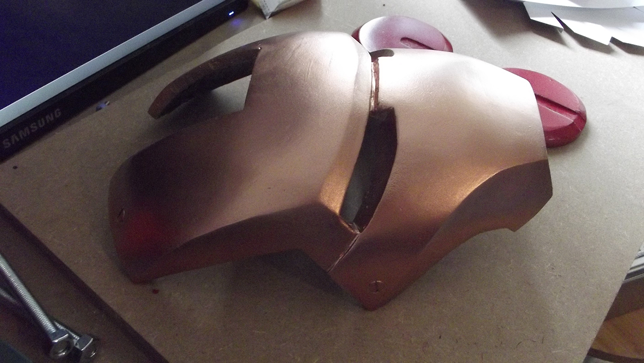

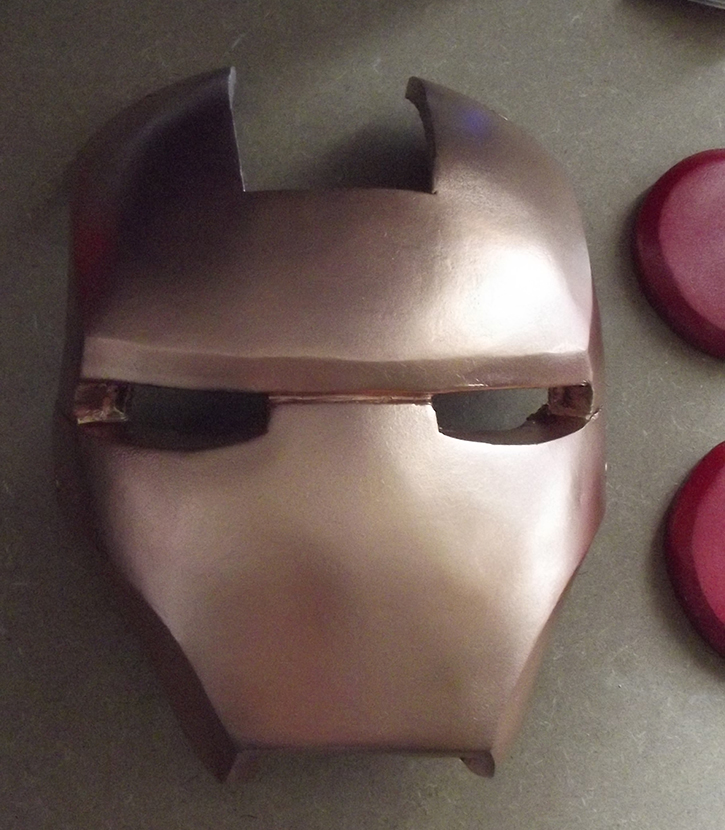

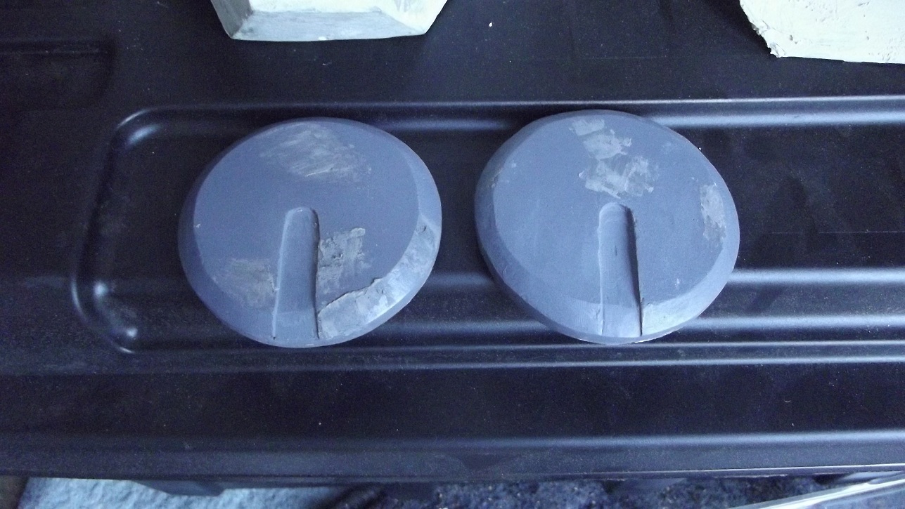

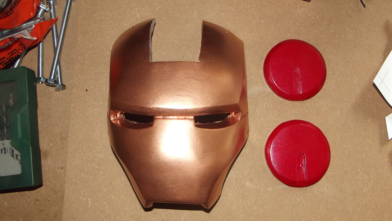

Here's what I have so far regarding color. Not real happy with the gold though...not enough yellow. The filler on the bottom layer on some parts didn't harden correctly due to me being a noob...so refilling will start soon.
Agreed too much of a copper color....
