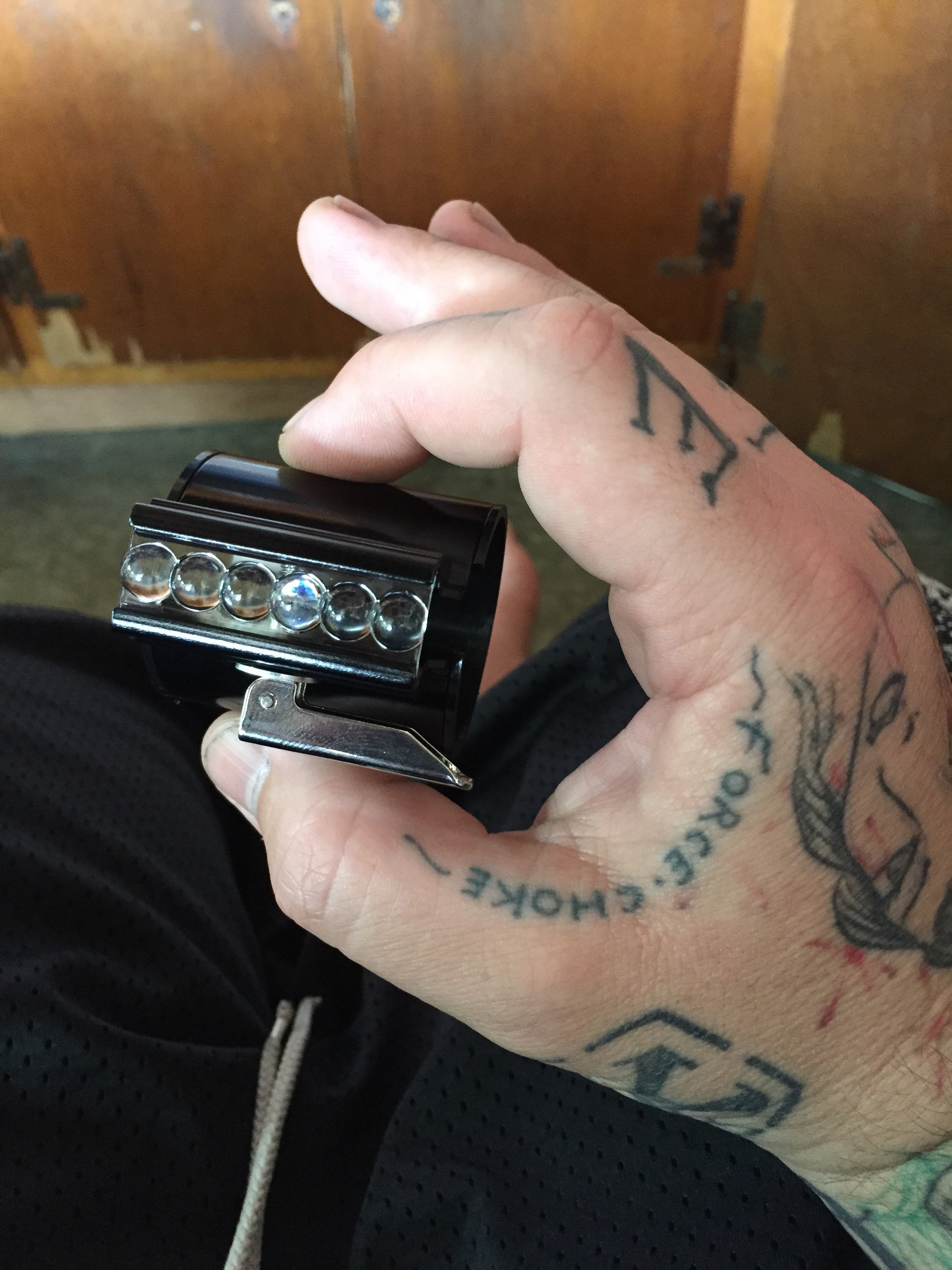

Got bit by the saber bug so I decided to start collecting parts . Have some stuff on the way , some stuff possibly being ordered and one part that came in already . Trying to build a real parts ANH Luke and a kind of real parts ANH vader .
Exactly ! I have a heiland flash coming and another heiland stripped tube all I was missing was the clamp
Yeah, that's Parks'. I don't know if the black could be removed from the sidebars.
It is not that difficult to scratch-build new sidebars otherwise: drill holes and cut from a bar, then round them off. You could also take the opportunity to maybe also make smaller holes in them for the bent nail.

I have a sand blaster at my shop and a polishing wheel too so I can figure it out . Basically just ordering parts and getting it all together to get a good base to tweak on

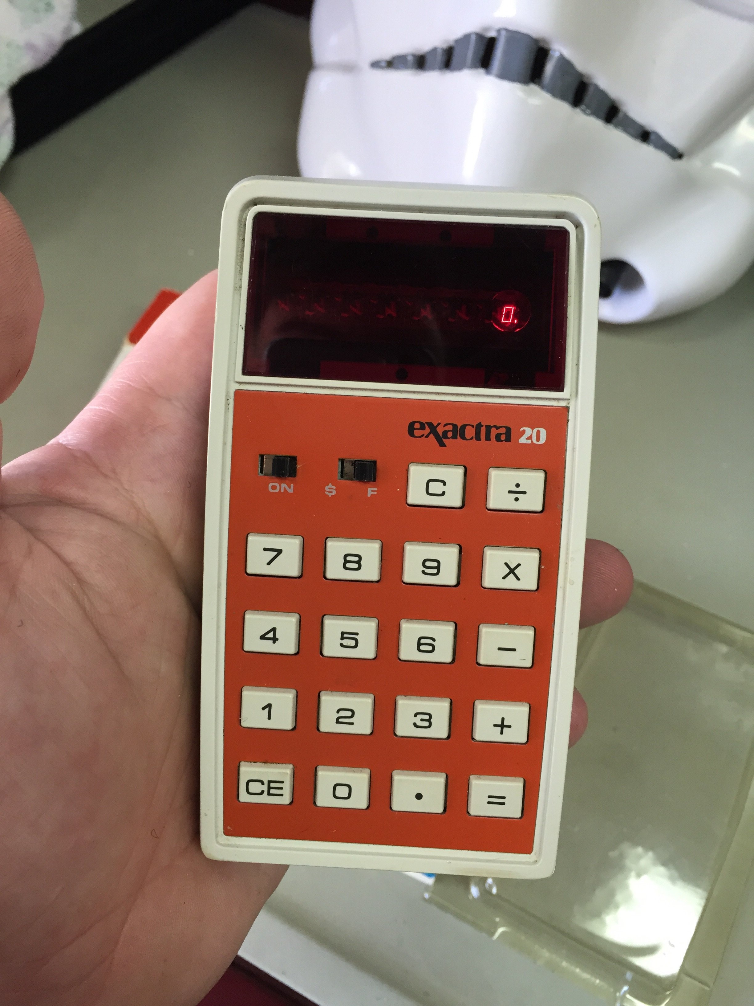

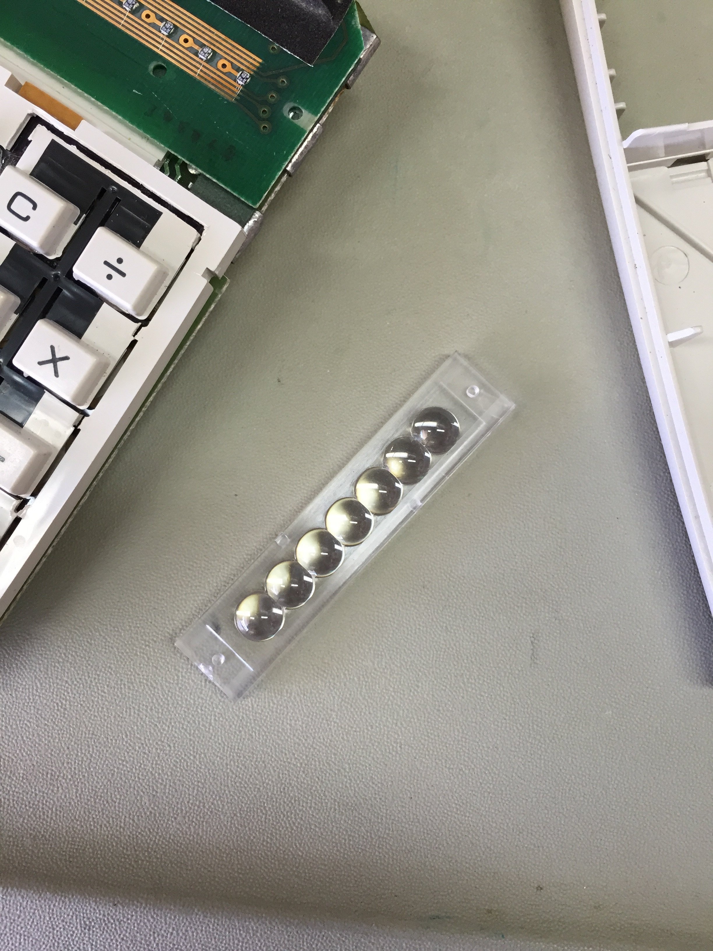

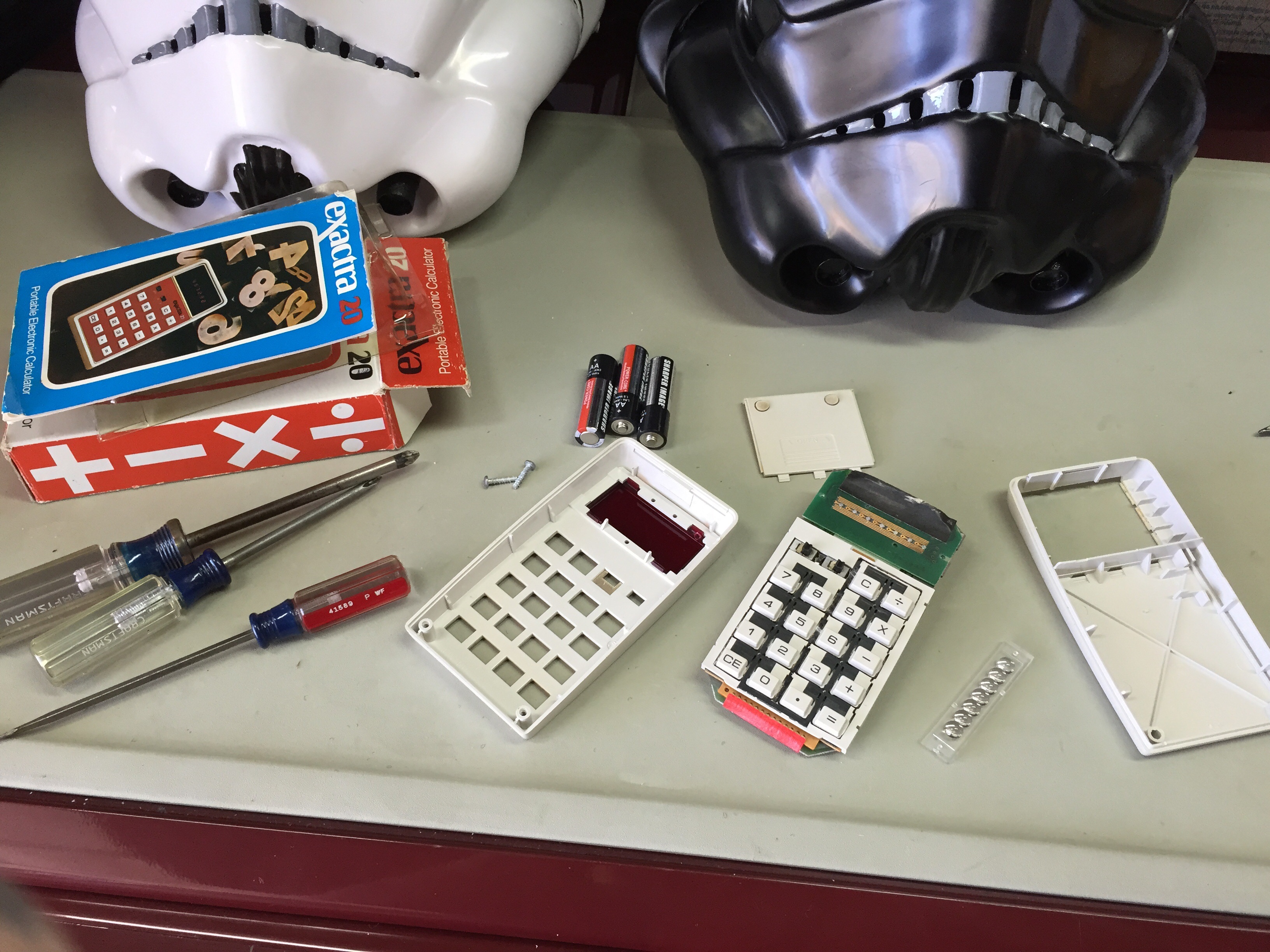

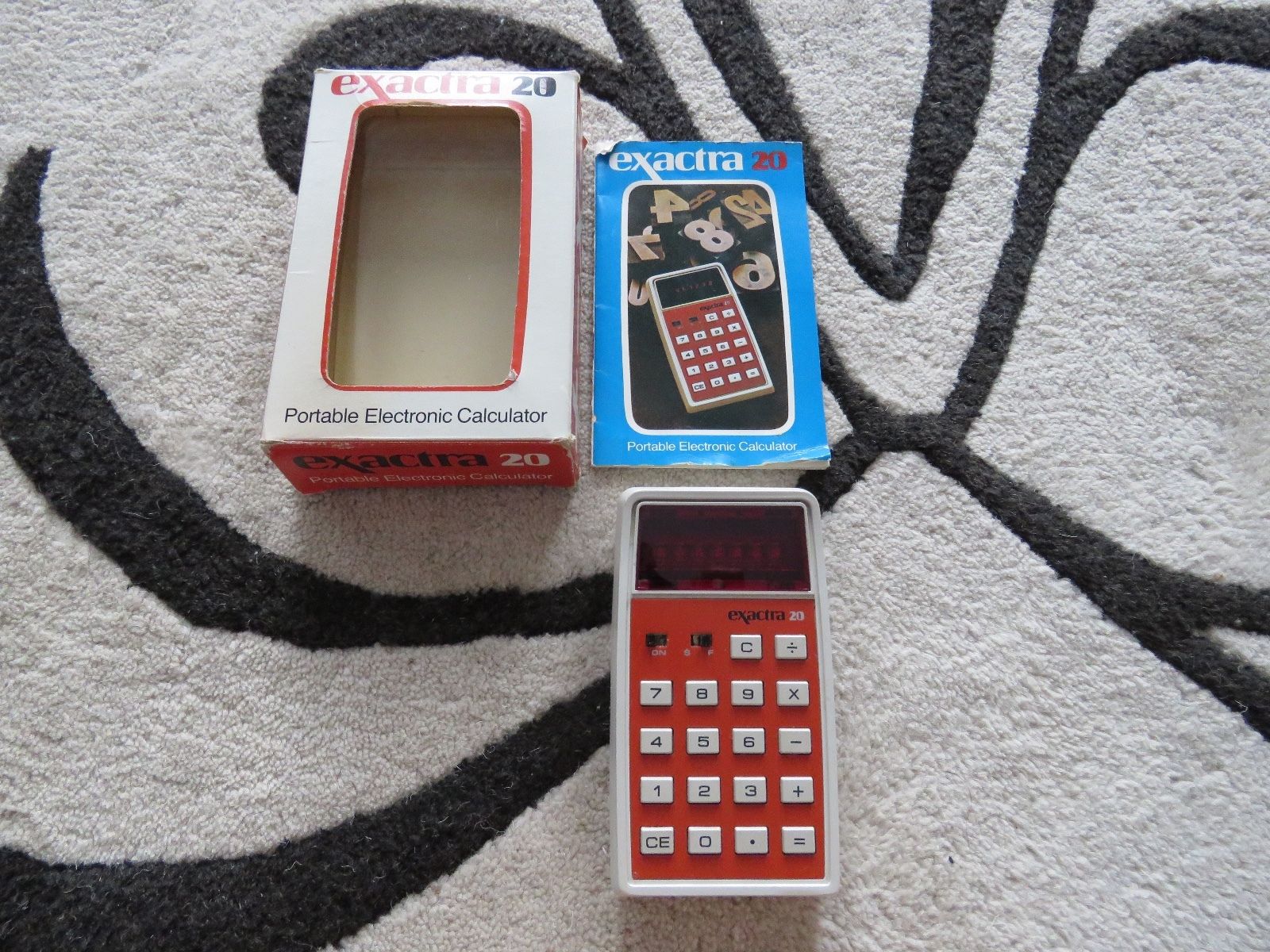

so i won this on ebay the other day. have a question though . if i pop it apart and cast the bubble strip is that bad on me ? i have a couple sabers im building coming up and possibly some friends that might need one or two and casting them myself will save a ton of money on my end .
Rebelscum did the same back in the day ... and Roy is currently having new bubbles made in almost the same way as the original Exactra's were done with a metal mold and injection-casting . . . so it just depends . . . how much time and extra money you want to invest in making your own as opposed to ordering some in a new ANH kit from Roy by the time you need them + D-rings and some T-tracks :)

thats a very good point ! I bought it to make a vintage parts saber ant thought since I paid that much might as well make a couple off of it . But buying everything in kits would save time and money !

I would assume you'd get the same effect casting them yourself- is Roy casting them in the original thickness? Roman casts thin ones so he added material on the sides to fill the space under the edges. With the original thickness you can pinch them! Thinner ones that aren't wide enough will slide around.
I'm doing injection molded acrylic bubble strips. They will be in the thickness that makes sit tight in the clamp without modifications and they will be a little wider (15mm) so they fit nicely. If you want it the width of a real Exactra strip, you can take some of. That way you can choose. The injection molded piece will be far clearer, stronger, crispier and sharper than a silicone mold casting. And the material will be not turn yellow as most resins do. I'll be receiving the FOT (first out of tool) somewhere next week and I expect the first batch in 2 weeks more.
