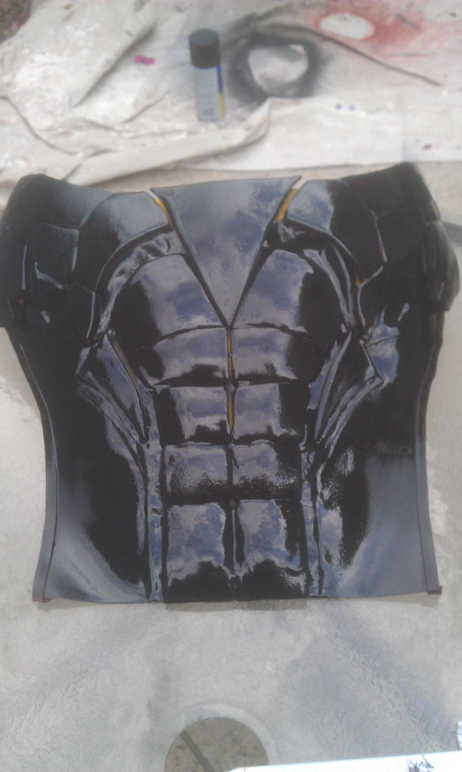

Finished painting one gauntlet. Still need to build the other haha. I think it looks awesome. I used dupli color Toyota stellar blue pearl for the blue.
I also got the blue parts on the stomach piece too. The blue is a little darker than is anticipated, but the under suit will be more of a vibrant blue so I think it will break up the colors nicely.

I'm using two layers for the red portions: Dupli Color MetalCast Anodized Red over VHT High Temperature Chrome Plate. The VHT is an epoxy based paint and the Dupli Color is an enamel based paint.. Apparently that's the combination you use to paint boats (found that out after buying them and doing a bunch of research).
The Blue is DupliColor Perfect Match Toyota Stellar Blue Pearl. On the stomach piece it's put on over the black plastidip. On the guantlet piece, the blue is put on over the VHT Chrome Plate.

Thanks! I too am please with the forearms. It's two pieces. The top piece will be attached to the under-shirt and the thicker piece will be separate. I think it'll keep motion better and help with putting on and taking off. I'm hoping the stomach piece turns out as well as the forearm did. I'm painting the red portions as I type this.

I've hear of people doing that, but to be honest, its already a really fine spray. Maybe cos I live in los angeles and its almost 90 out lol.
The trick is to do a couple of light coats, then a wet coat. Or so the can says. If you go too heavy it drips like crazy. More than the anodized red does. But either way, with both you want a few fine coats and then a slightly heavier coat. I'm doing 4 coats of each: light, light, wet, light. This is all a first for me. Before this i'd only spray painted a picture frame. Once. However, my dad is a professional painter so maybe some of it sunk in being on site my whole childhood

Okay! Red is on the stomach piece. I got some wrinkling. I think I didn't let the Chrome set long enough. However, its pretty uniform, so we'll pretend its purposeful so I dont have an ocd aneurysm.
