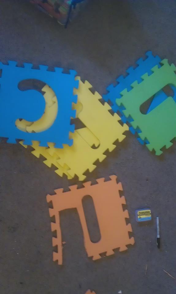

Started out with some of my daughter's old alphabet mat:

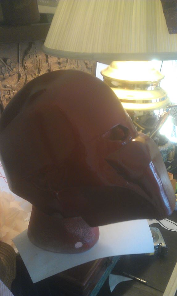

Then I coated it in layer after layer of a mixture of PVA Glue/Water and Black Puffy Paint. I did this for a few layers, then sanded, then more layers, then sanding, then again and again until my coating went from the translucent gray pictured below to a deep black covering the whole thing.

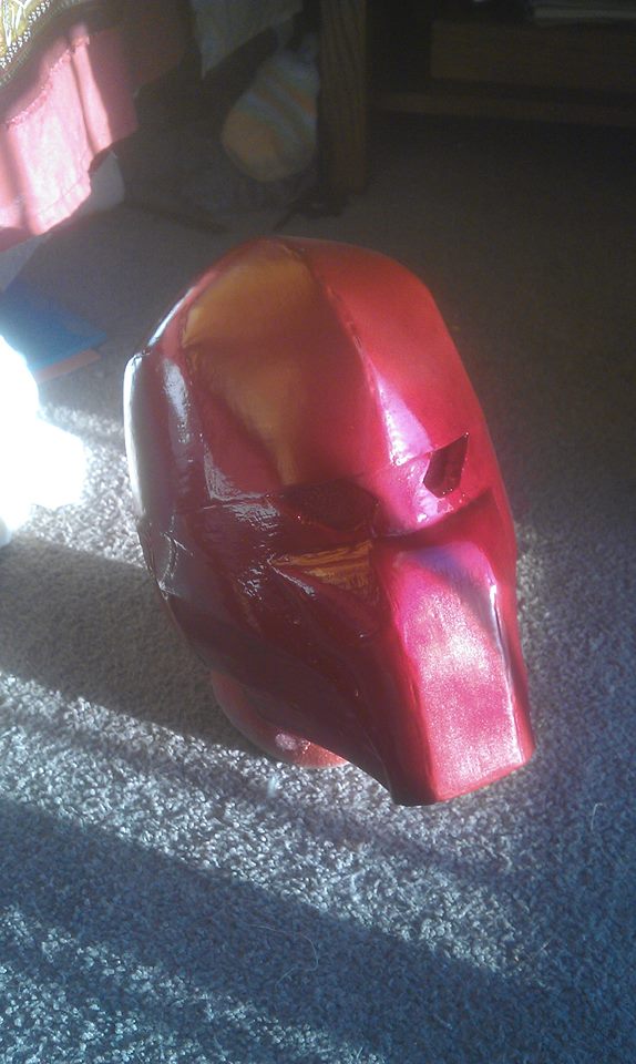

Then I hit the whole thing with a few coats of VHT Chrome Plate High Temp Spray Paint (epoxy based)
Then for the beauty coat to bring it all together: DupliColor Red MetalCast, enamel based (It's for giving metal a red anodized look)

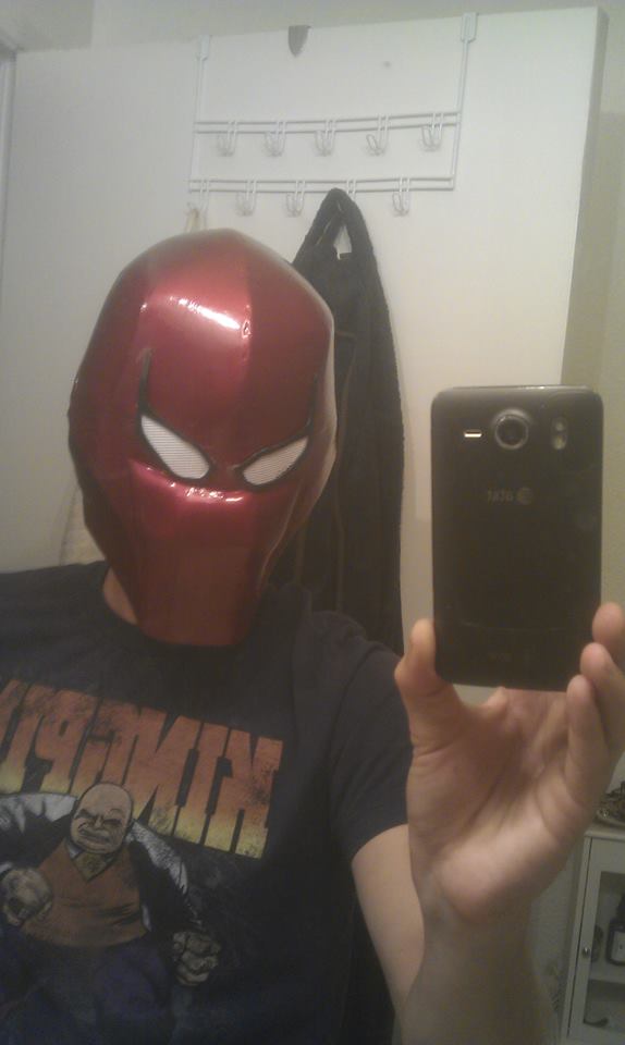

Then I made the eyes. I used a DVD case for the frames. Drew my design for the eyes on some paper, backed it with packing tape, cut out the stencil and traced it onto the DVD case and cut it away. Then I used some thin plastic from a toy's packaging for the lenses and the same white perforated cross-stitch plastic I used for the eyes on my other Spider-Man Costume... And... VOILA! Ends of The Earth Anti-Sinister Six Armor Helmet:
11183463_829896433753697_2487503673318798671_n.jpg11202852_830252220384785_4463717330301391556_n.jpg11218796_830252503718090_6346543219691970979_n.jpgr4zQEWR.png
It's not perfect, but I dig it.

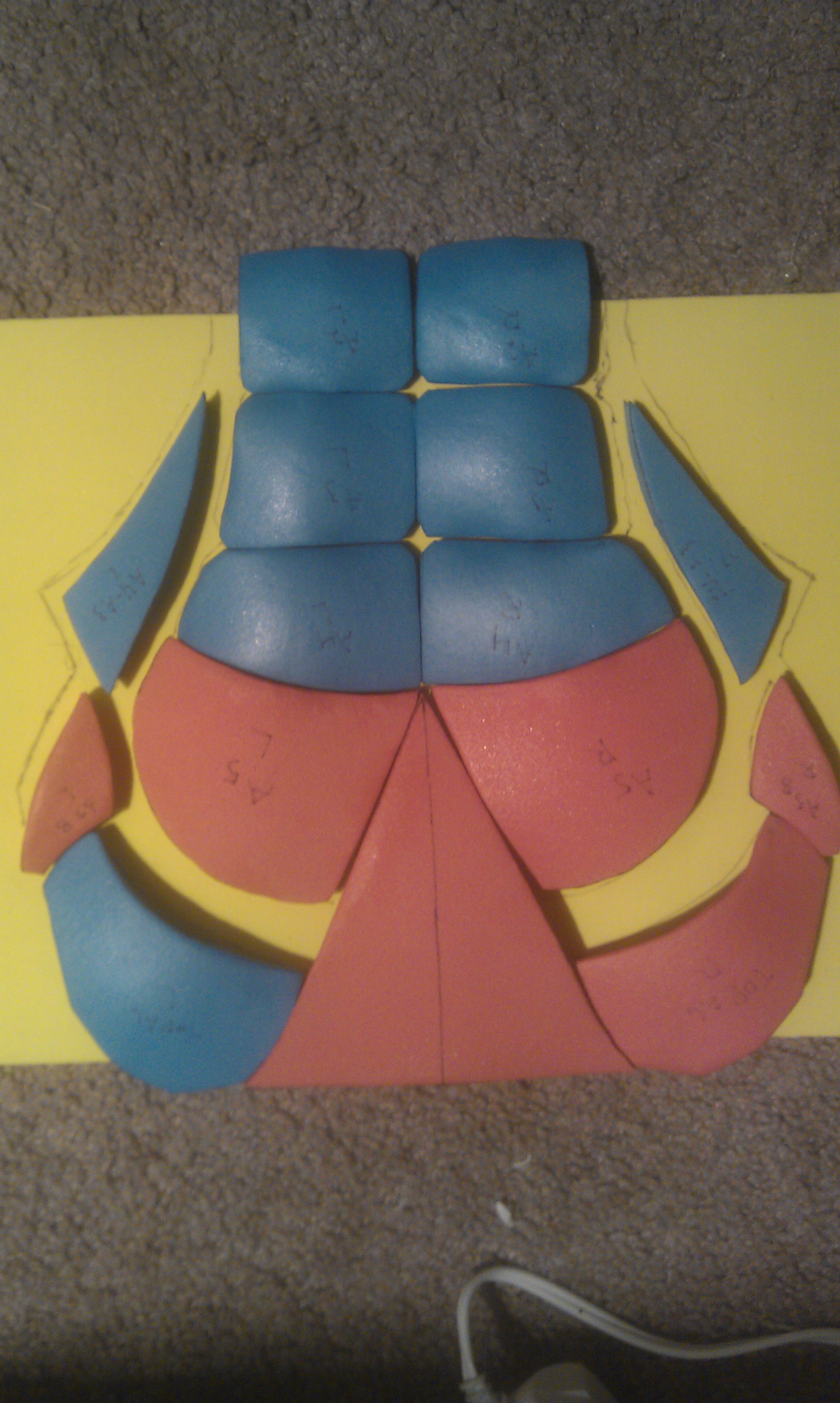

Started working on the forearms.
Here's the sketch of my design for the gauntlets:
And, here's the build for the forearm (the blue plates in the picture)
and, today, I finished drawing out the pattern for the rest of the gauntlet. Which, I might add, has been one of the harder patterns to design--incorporating the 2D shapes into a 3D arm was a bit more of a task than I'd originally anticipated. But I finished it, and I dig it, and I swear, it looks better wrapped around the arm :)
