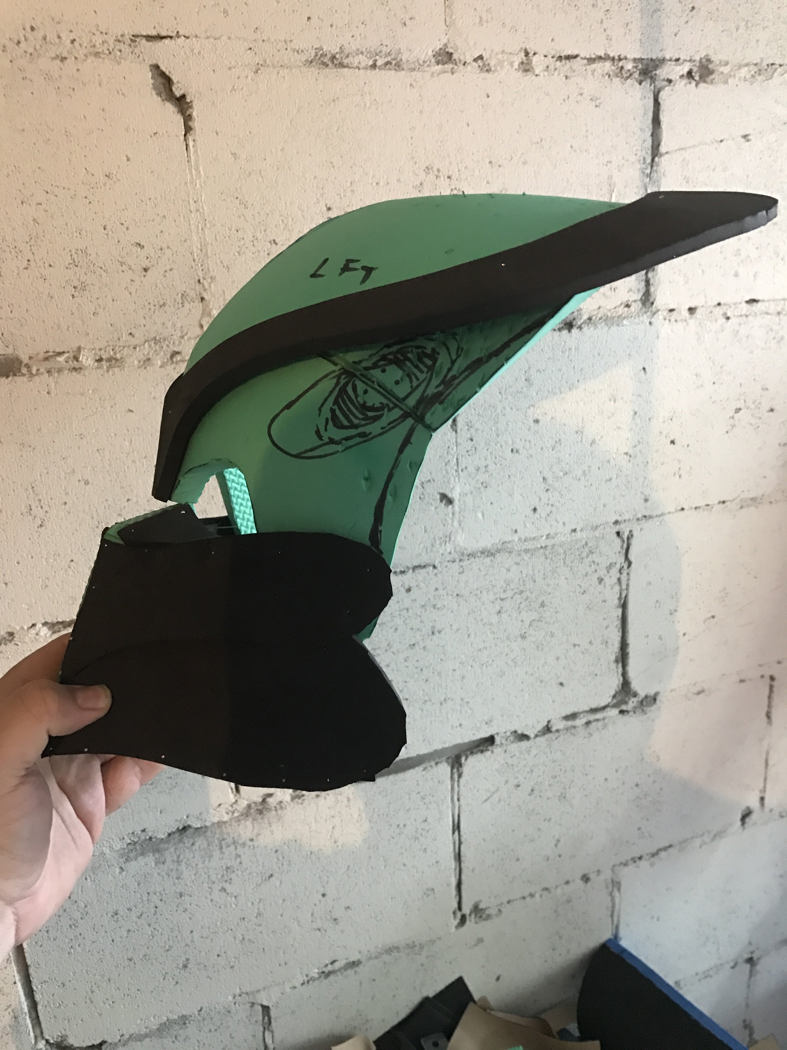

This was a great project. First time building a suit this completely. Used eva foam 10, 12, 6 and 4 mm
Everything is wired with lights on the helmet and gauntlet and there is an auto fire nerf gun n mounted on the shoulder with a firing trigger wired to the left gauntlet
Also used a lot of RPF and Predatorium reference. A big thanks to youtuber Evil Ted
Let me know if there are questions as i didnt take a lot of build pics
