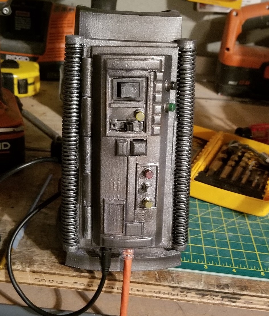

Left Gauntlet - Creation, sound and control.
Continuing with the planning, let's start with the pepakura file and add a hinge in the print so that it can flip up if I need it to. I also made a slot for my Phone below the flip plate.
Let's allow holes for momentary switches and latching switches, cat5 connection and audio out on the flip plate:
Now let's get it printed and loaded up:
I wired it up with an adafruit soundfx board and started wiring everything together. The sound out went to a 3.5mm headphone jack which will plug into an external speaker.
It's actually much cleaner inside now.
Final outside picture of the left gauntlet.

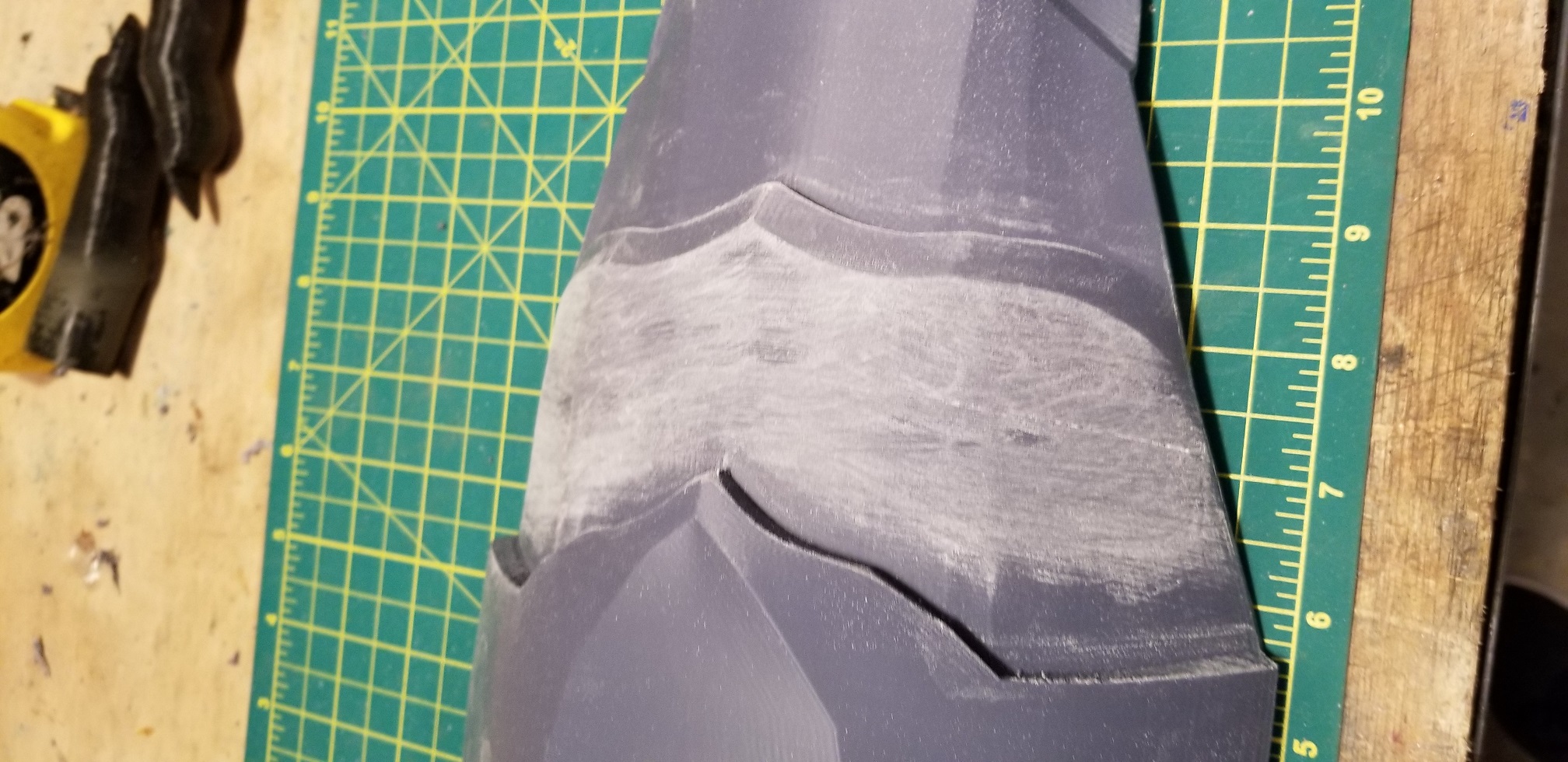

Start with the pepakura file and make it printable.
I made some changes to the original pepakura file and incorporated a latch system to allow the redesigned blades to be locked in an extended or retracted mode. You can see the green piece acts as a pivot point in the gauntlet and the blue stick prevents the claws from sliding too far forward.
