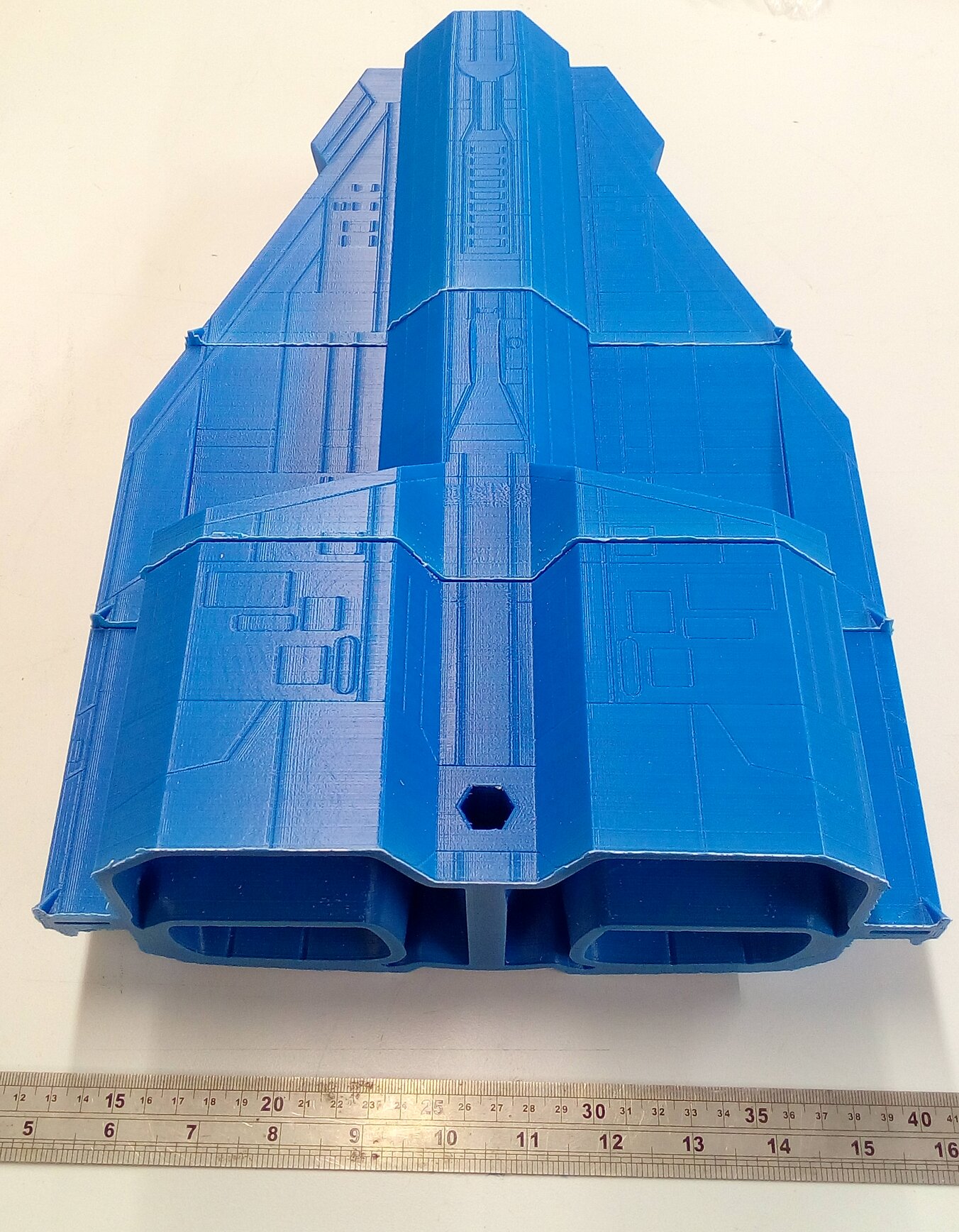

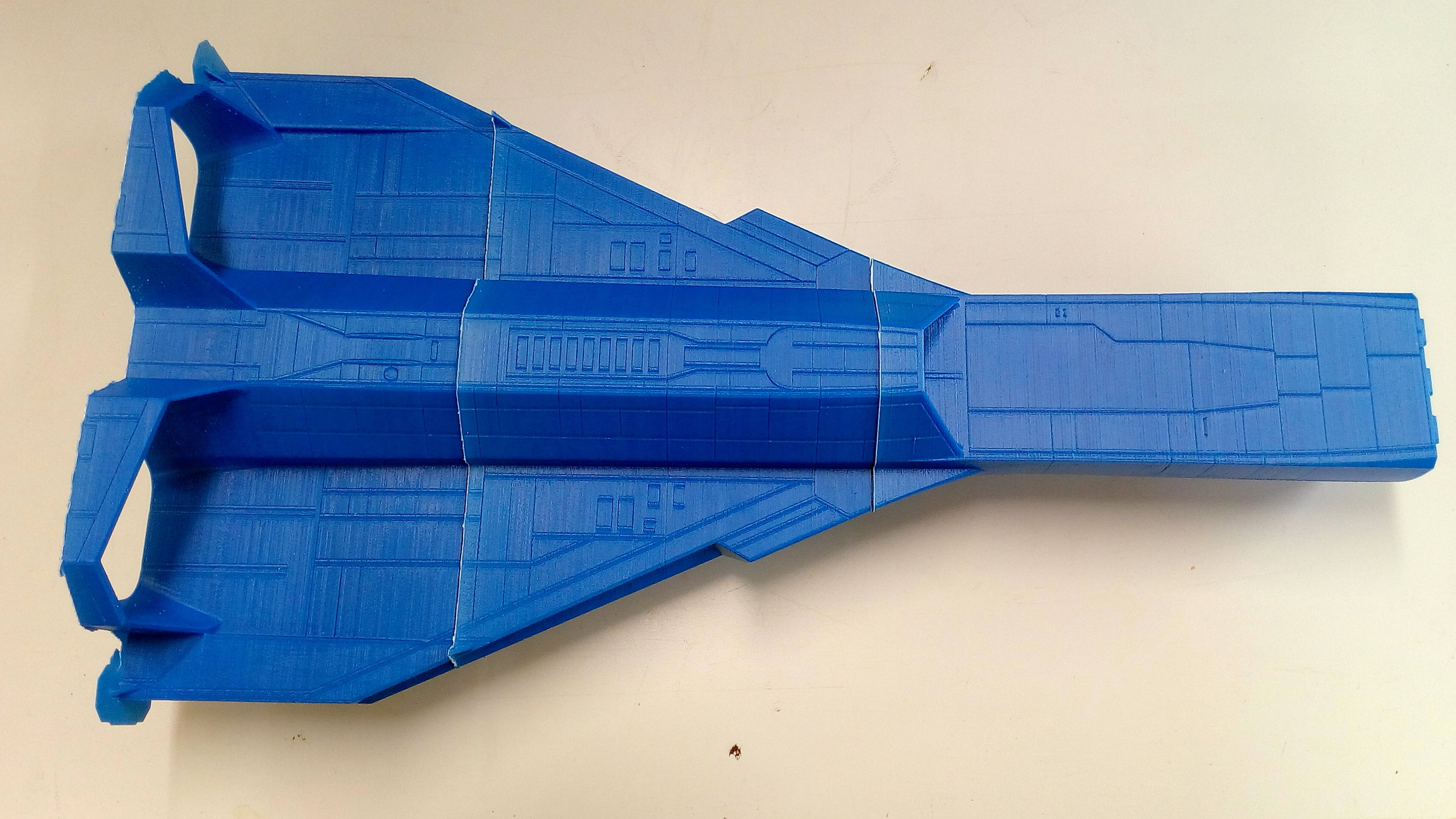

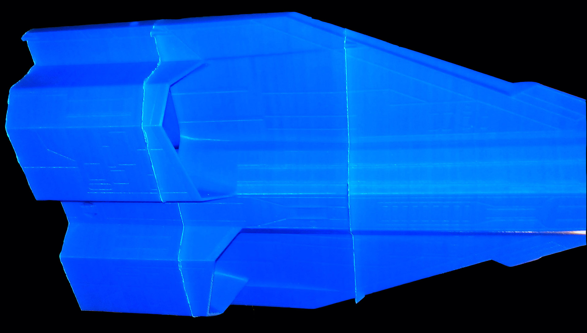

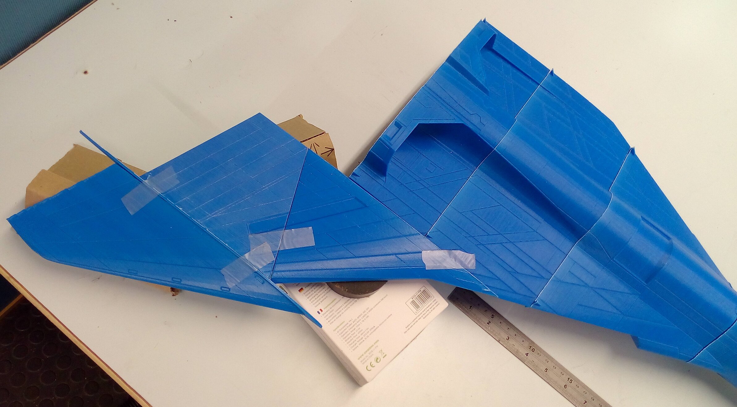

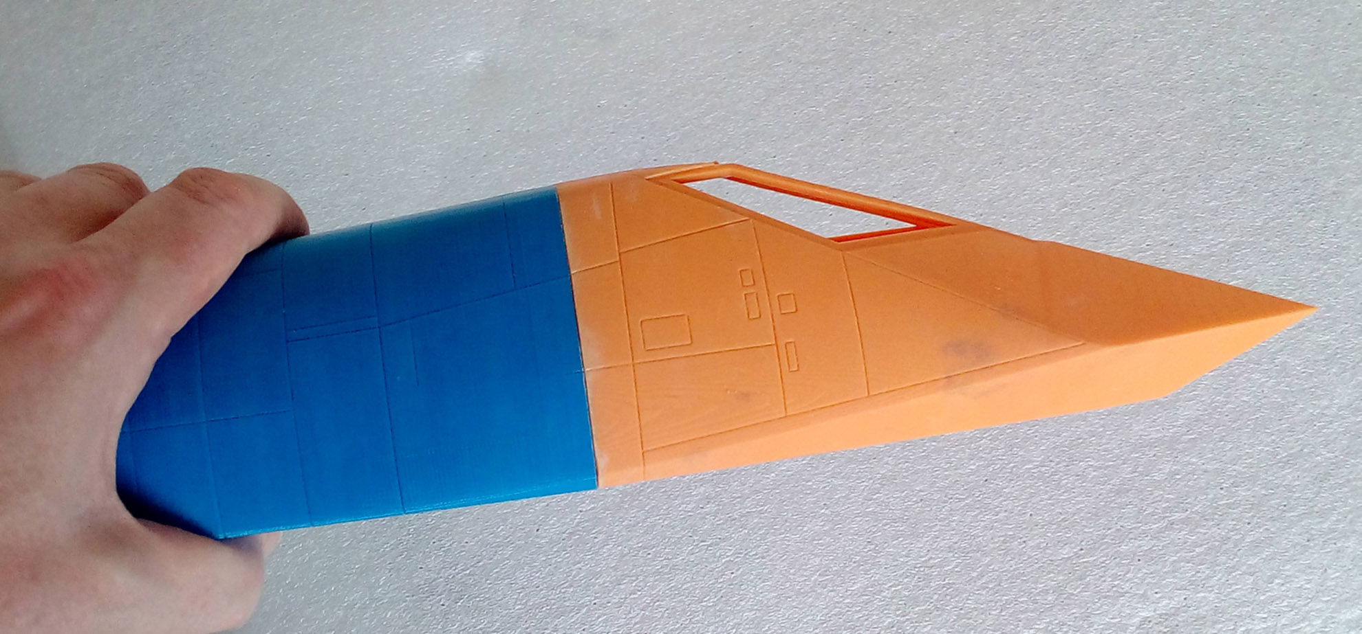

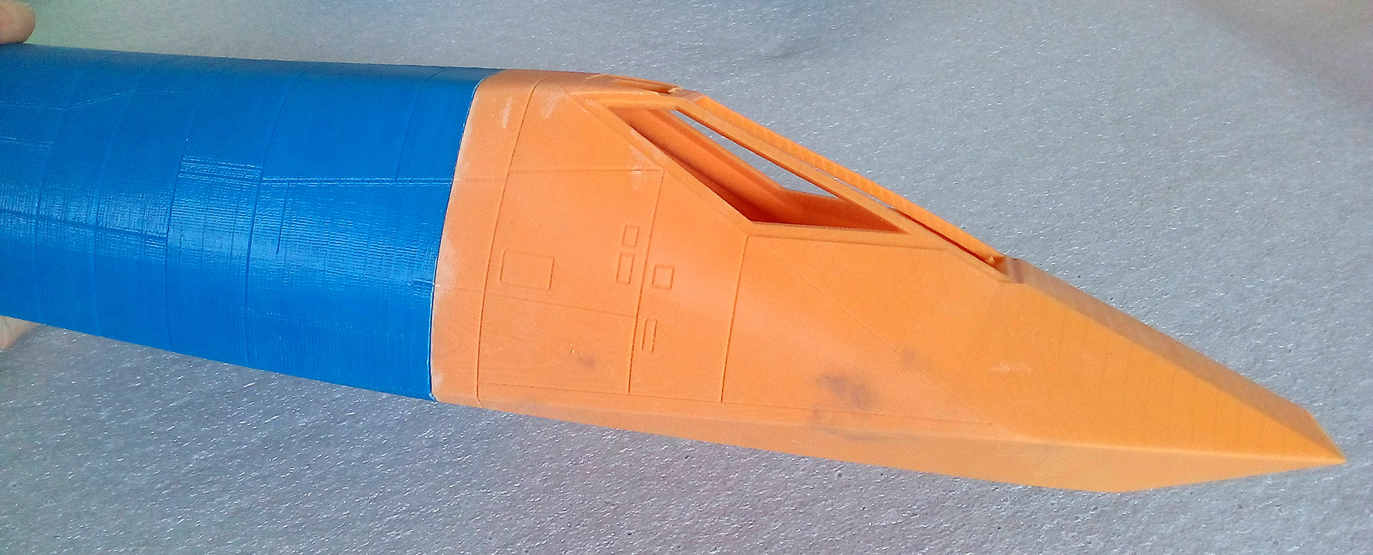

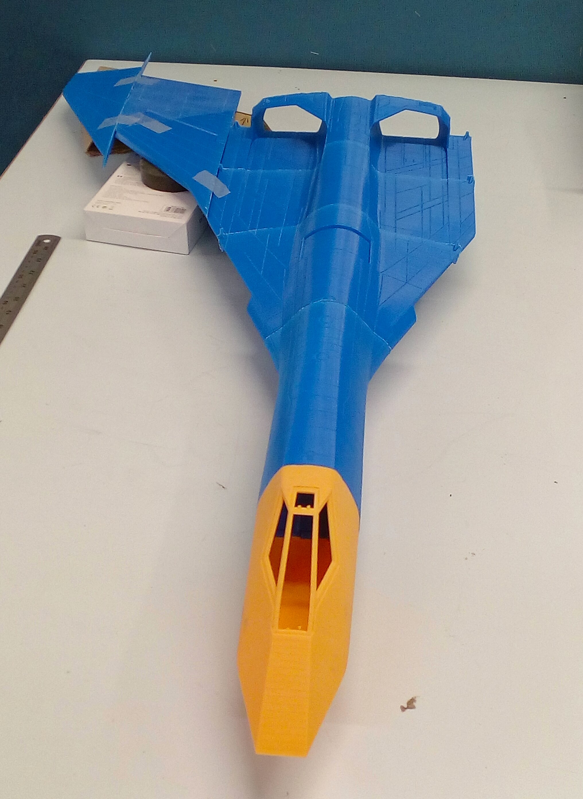

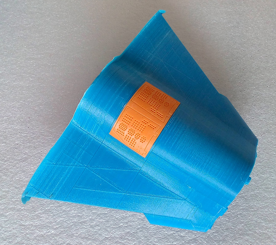

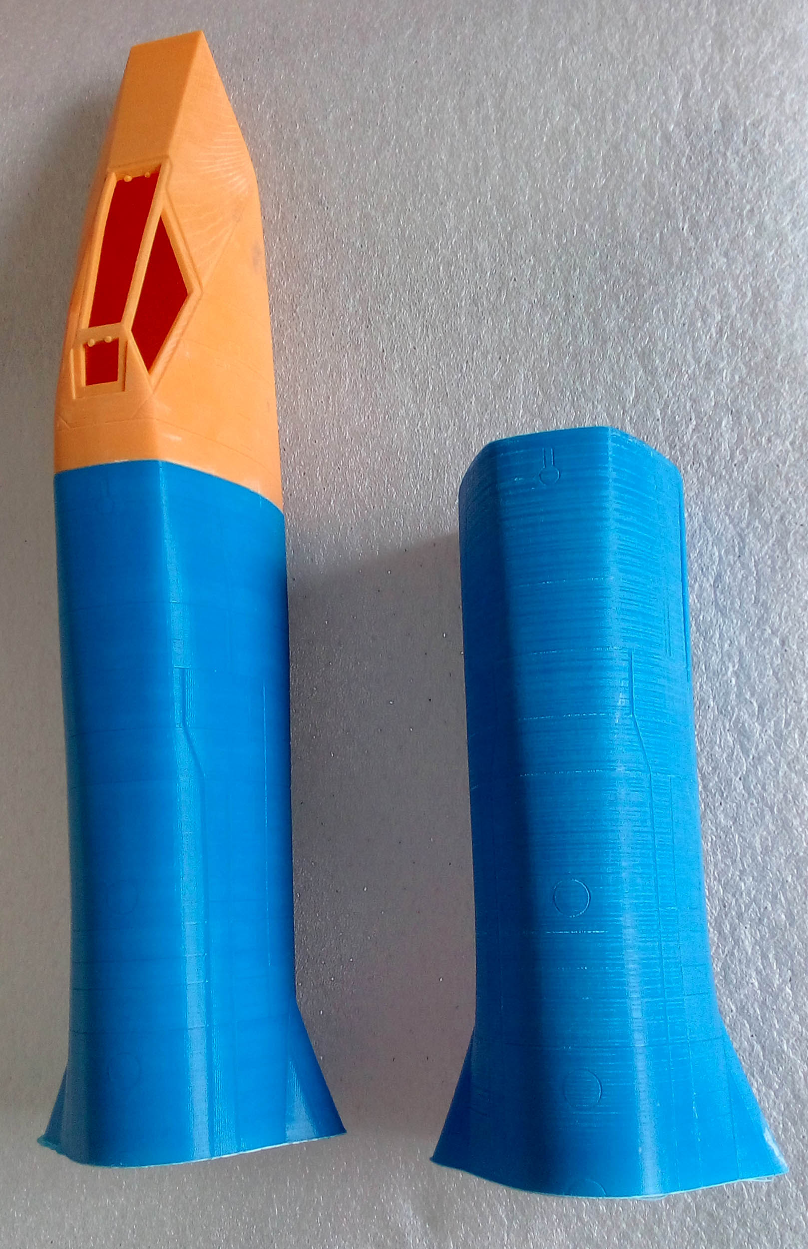

After a bit of Dremel action to cut off the extended support part for the front

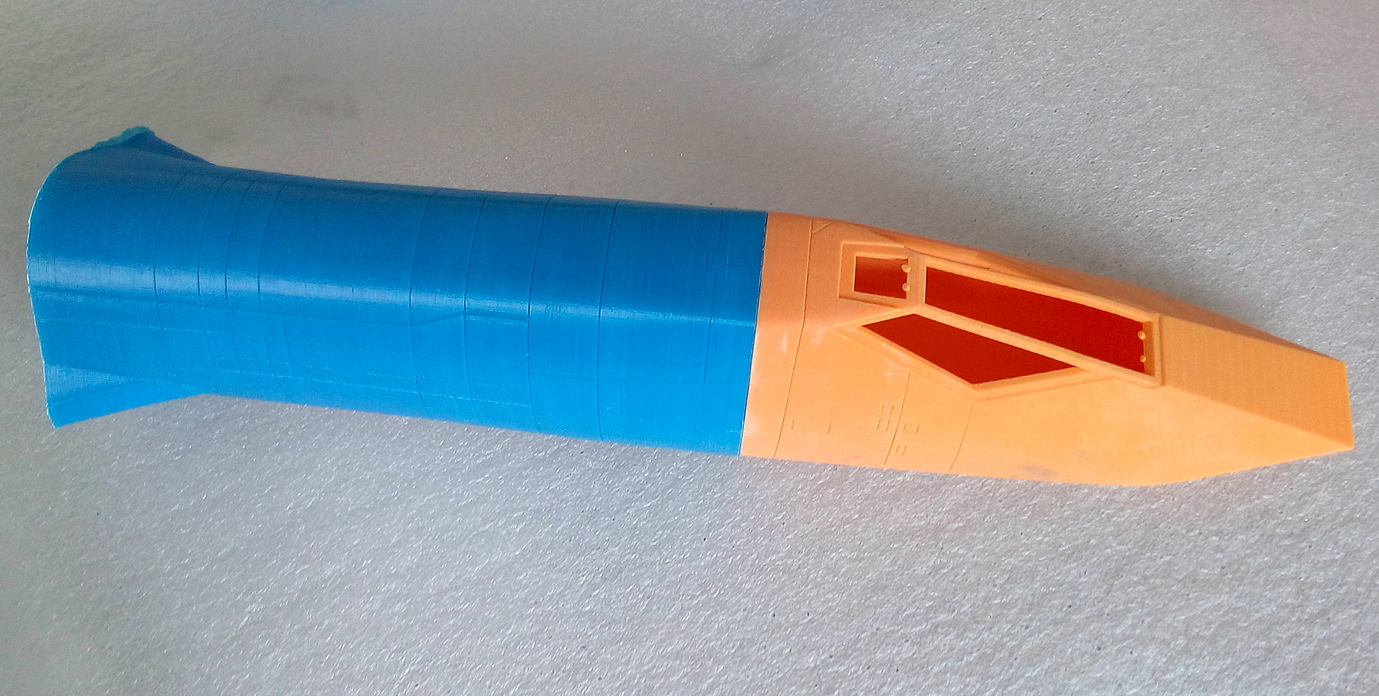

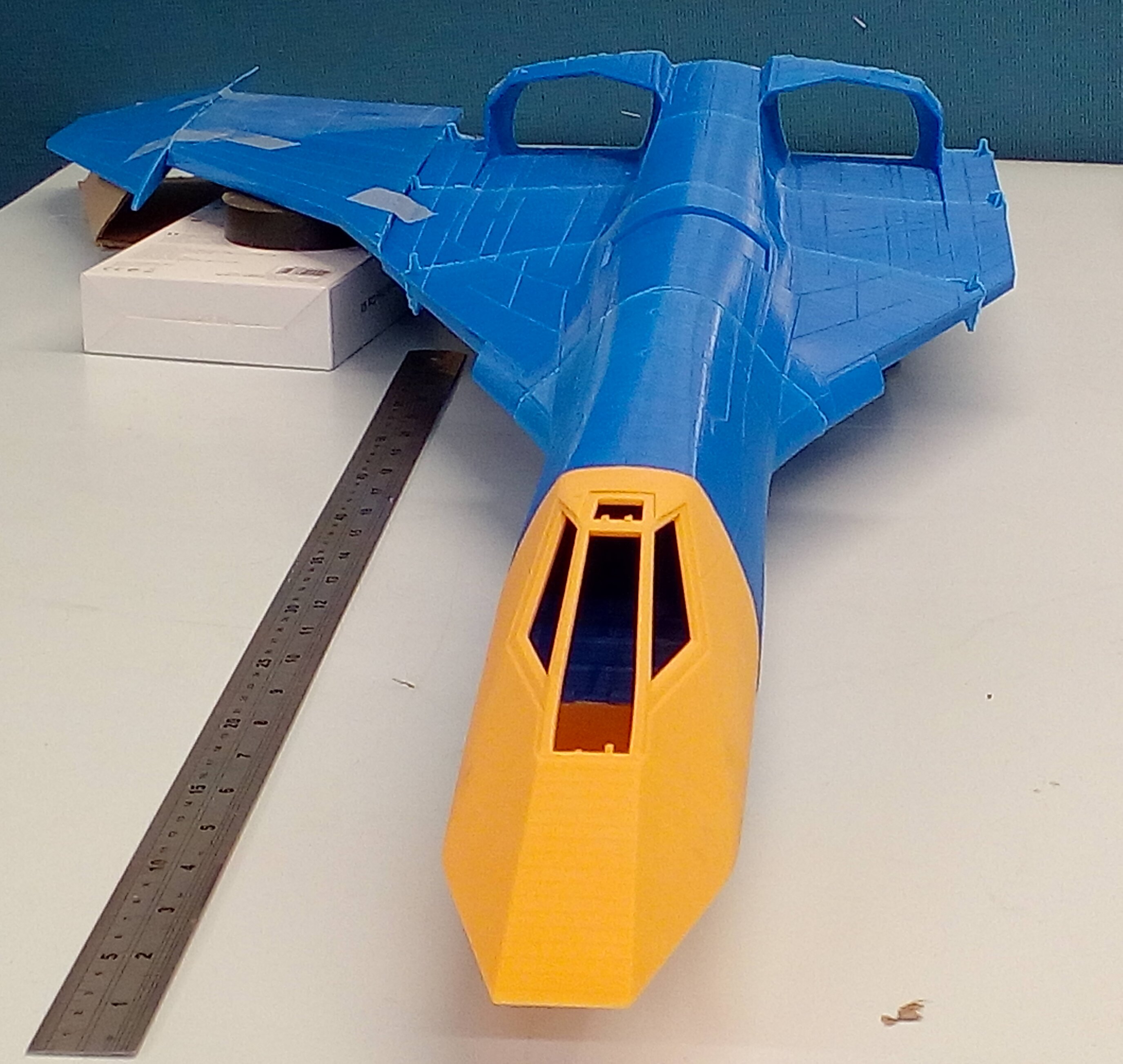

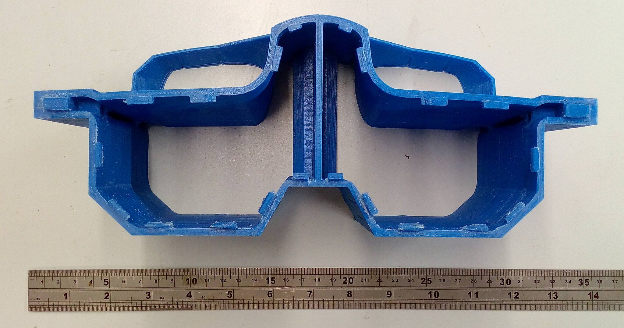

Tabs on the blue ABS part hold the front on tight, there's a tiny bit of distortion on the bottom edge, extending the waste part by 3mm for the next one. Also somehow turned off the slice anti-aliasing in the slicing software so the 0.09mm pixel steps are visible on nose. There is bit of distortion on the front canopy beams where they meet the body, discovered the wall is a bit thin there so that needs thickening. The recesses around the canopy are for 0.75mm acrylic sheet for the canopy glass.

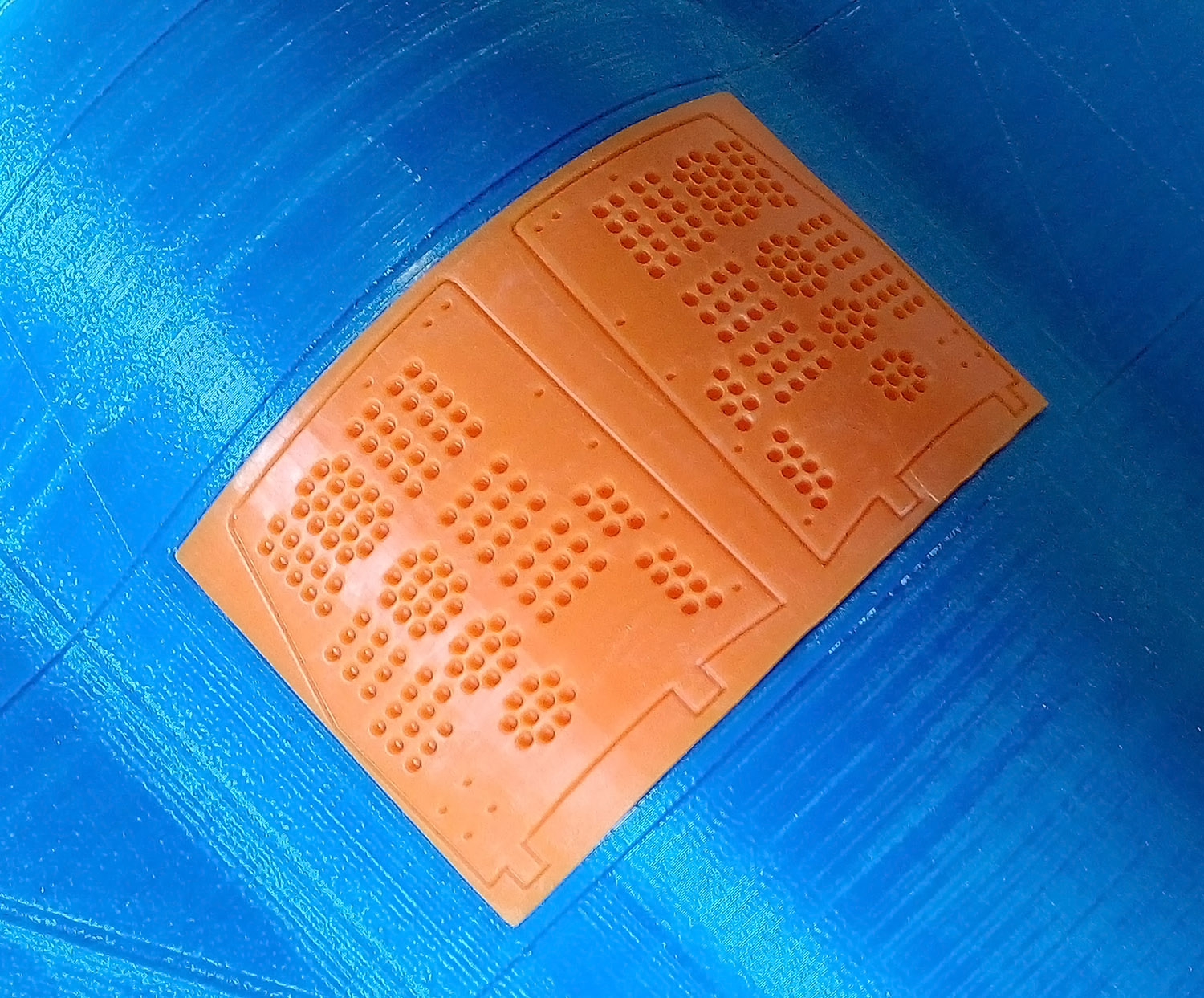

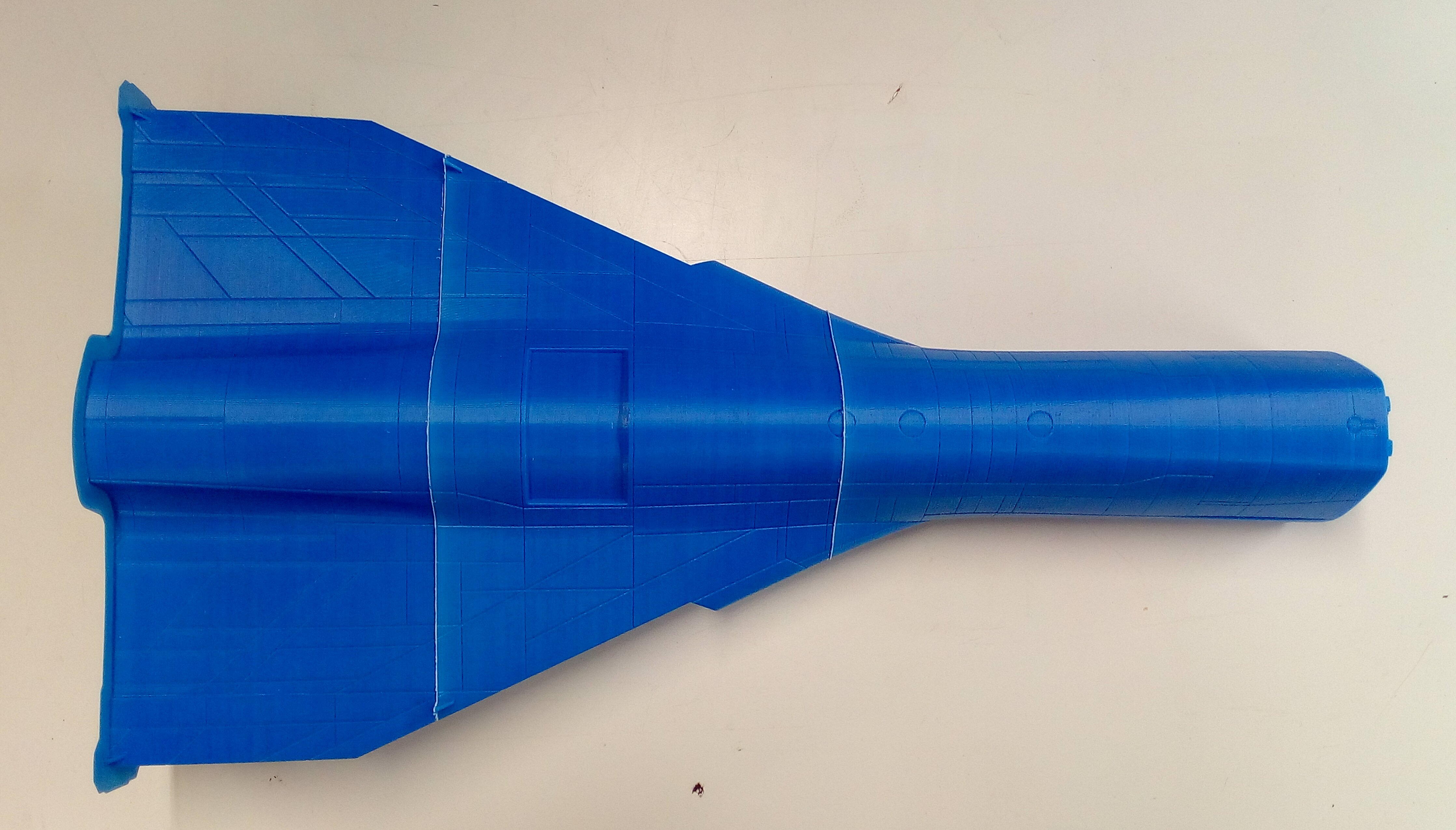

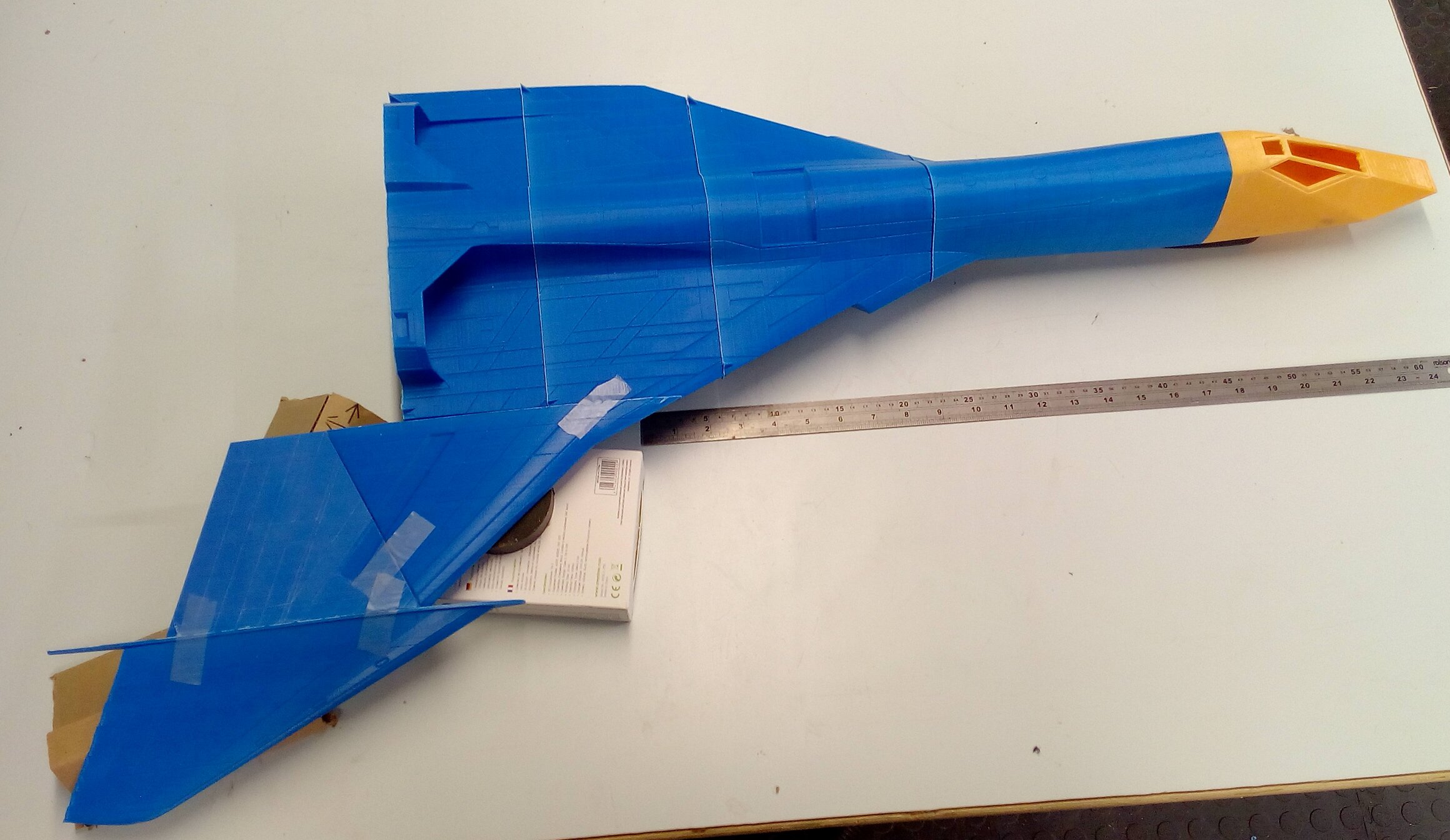

Air-brakes came out nice at 0.1mm layers, thought they might need 0.05mm resolution but doesn't seem necessary. Need to fix a few shallow panel lines on the main body part then get that printing later.

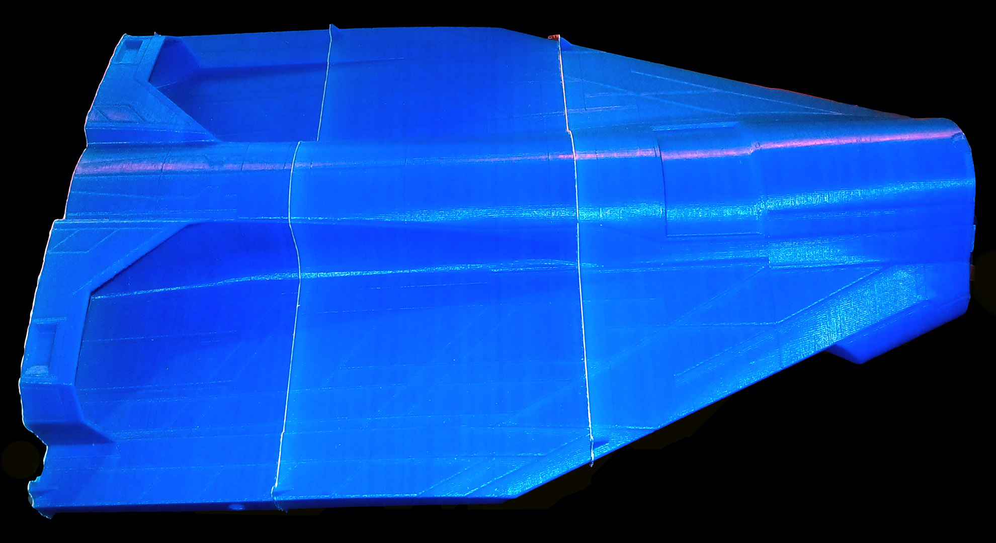

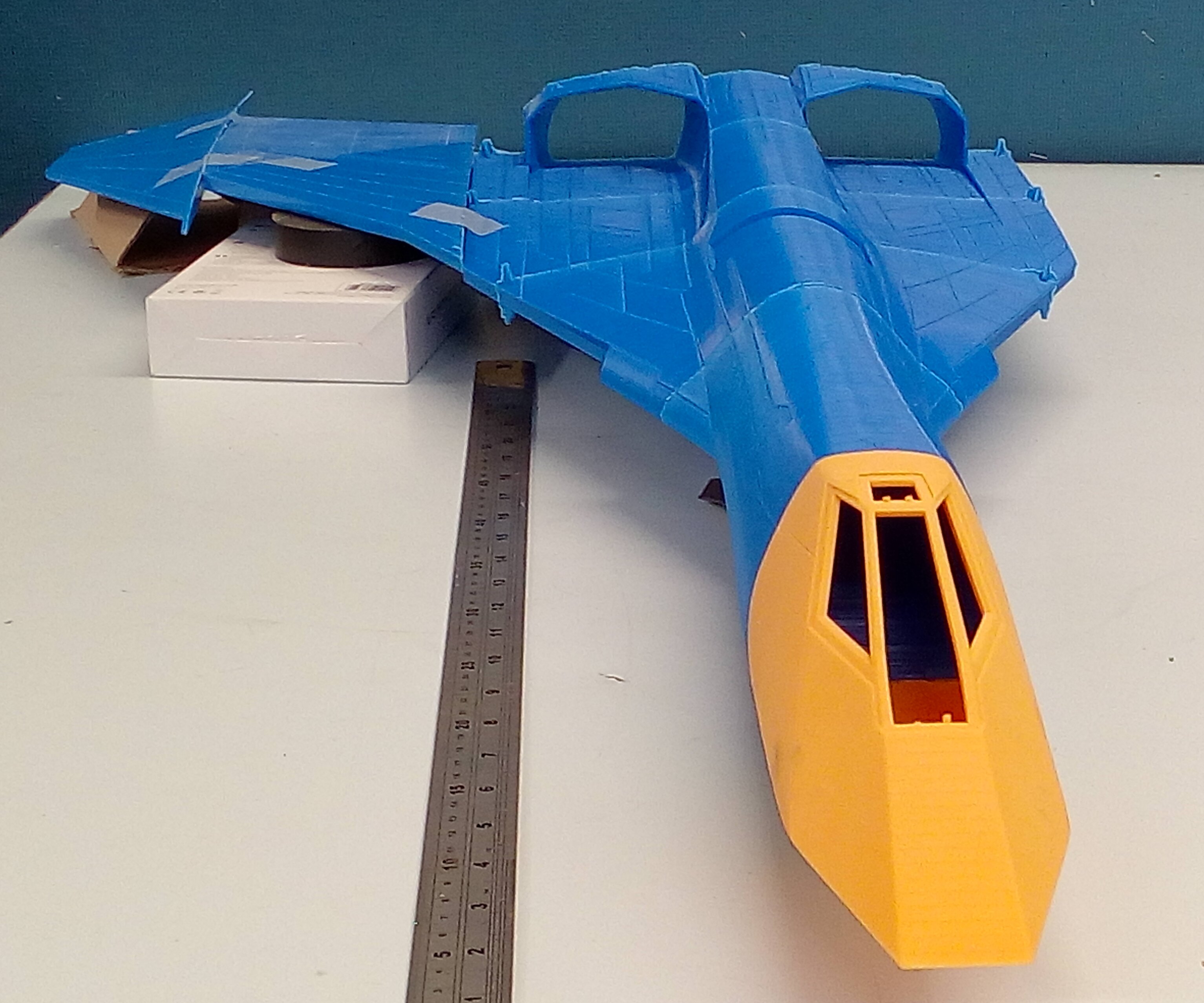

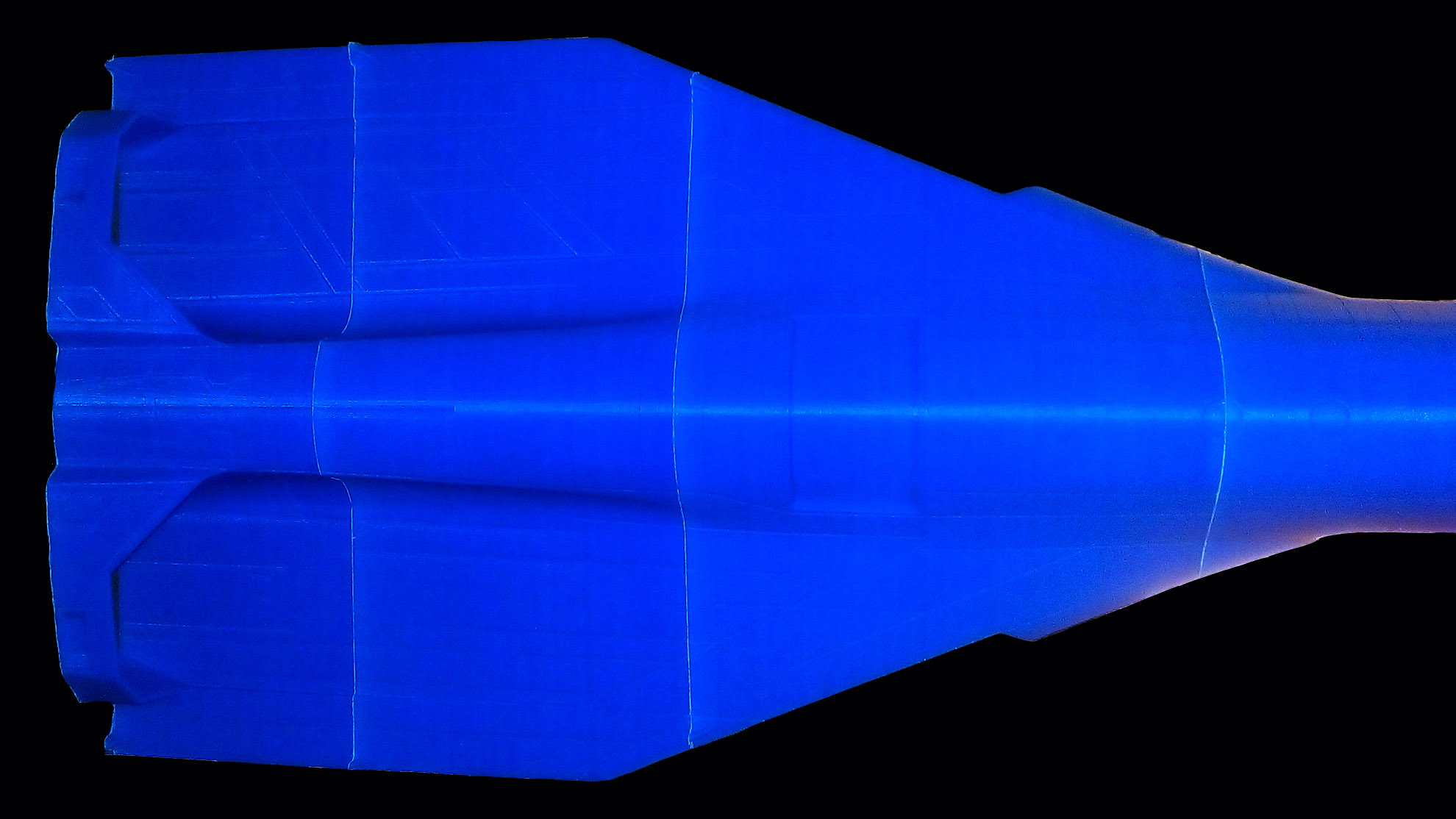

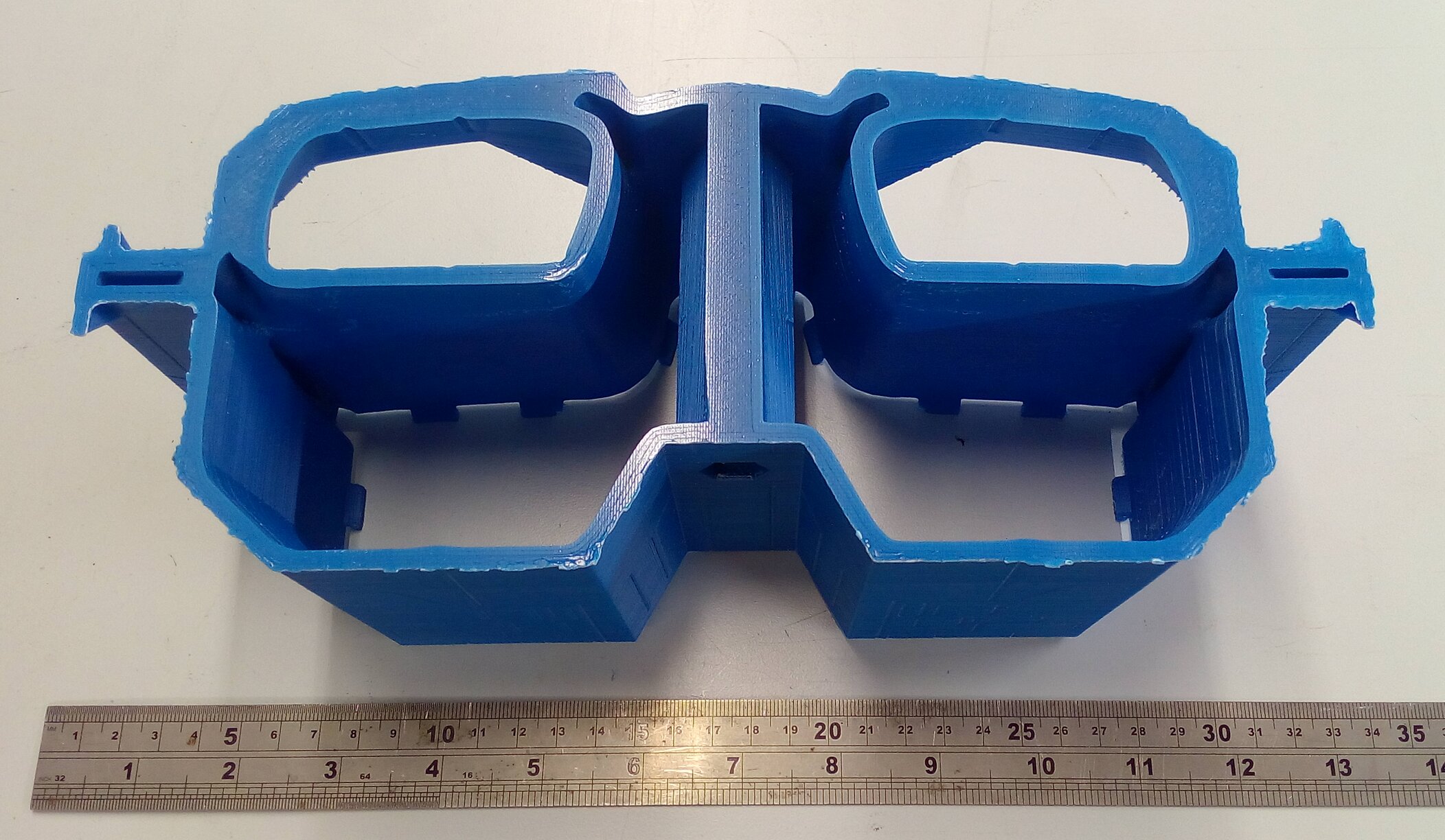

New Z axis drive has improved the surface finish a lot, new left old right, the photo shows the belt noise, but it's only microns deep. Really tight drive belts on the printer improve accuracy and lower noise, but it does show the stepping/ringing effect a bit more.

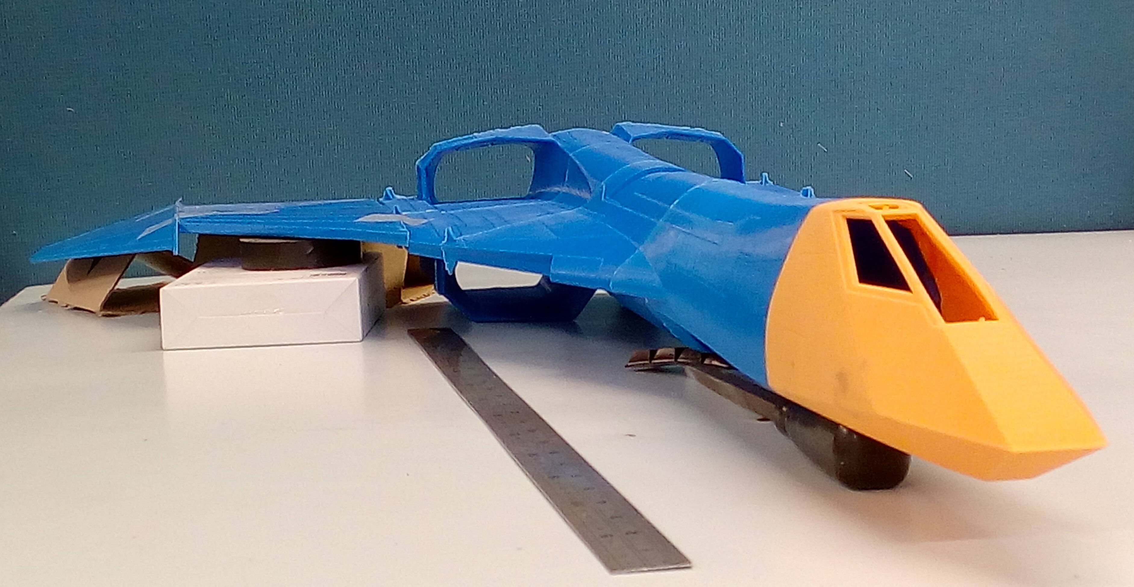

Annoying how the camera makes the surface noise look worse than it really is. Have a built in stand mount for 1/2" AF hex brass. Someone wants gears down so there will be gear bays for this version, have to build them but they are relatively simple, and have the F-4 Phantom landing gear from a free to use model.
Waiting for some filament to continue the engine section and other wing, Working out print jobs for the other high detail bits cockpit, tailplanes, canards, airbrakes, leading wing edges, ailerons, defence pods and rear engine section, looks like 4 or 5 print jobs to get them done.

Just one observation though - is the canopy frame a little too thick on your print or is it down to where the window panels actually sit?
It's pretty much identical, but the large filming miniatures had no physical frame for the front edges as it was holes cut in the thin shell with 0.04" clear acrylic glued on the surface. With the paint and clear coat layers it mostly hid the step, you can just see it in a few shots.
The print has what would be a "real" internal structure, so it's more visible.
There is enough strength that you could lose the front spars and just have the 0.75mm acrylic to be more accurate to the 1/12th ones. The full-size mock-up does have an impossibly thin canopy frame.
