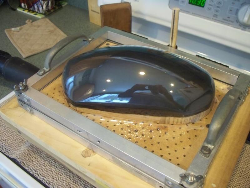

Well I spent some time...... not so much trying to figure out
what i had to do to get a good canopy(Forming), but more of what
goes into getting one. I found out using apoxie sculpt or
ultracal-30 even when finished and sanded down,, is still
filled with small imperfections that you really can't see by
eye. They are fine for regular styrene but bad for the PTEG.
I sanded down the part real smooth then I pulled a
real thin sheet of black styrene over it. Then I sanded
the black styrene super smooth. The black sheet formed over
the pattern just helps you get off that clay material.
It's still not 100% flawless but it's SO much better. Once
you put a little color behind it you can't even see some
of the flaws. So I am pretty sure the cockpit will help me
out
Test pull...
I filled under the bottom because in the test pull I was
loosing the corners down on the platen. I wanted to be
able to slide a riser underneath for later.

Well I got the part ready sanded and a riser for it.
Then i formed it in some thin black.

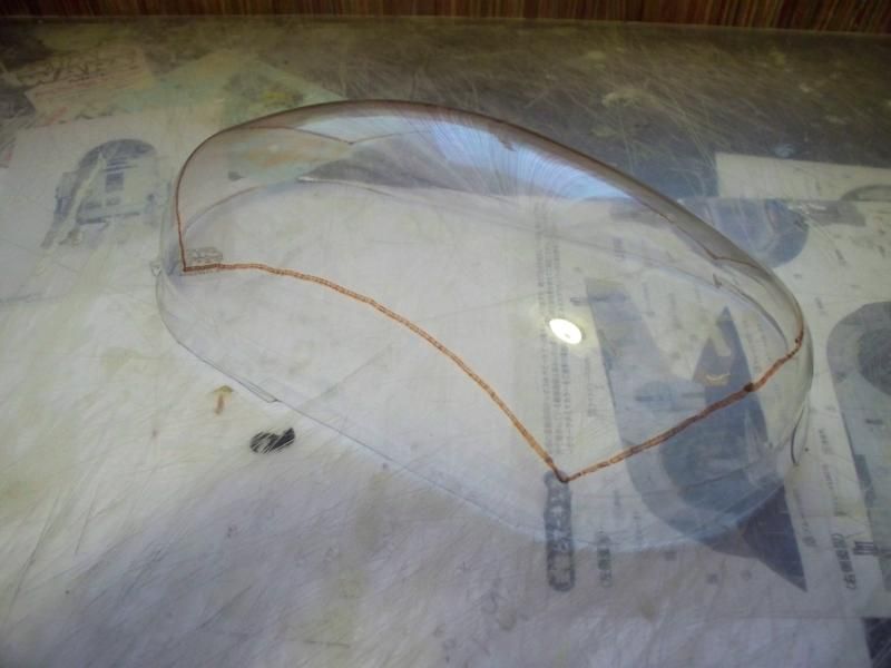

Clear sheet form...
Marking it from underneath the sharpie paint markers are
good tough to mark with other things.
pulls look great! really have been learning a lot watching all of your vac-forming progress. this is going to be a monster when its finished!
