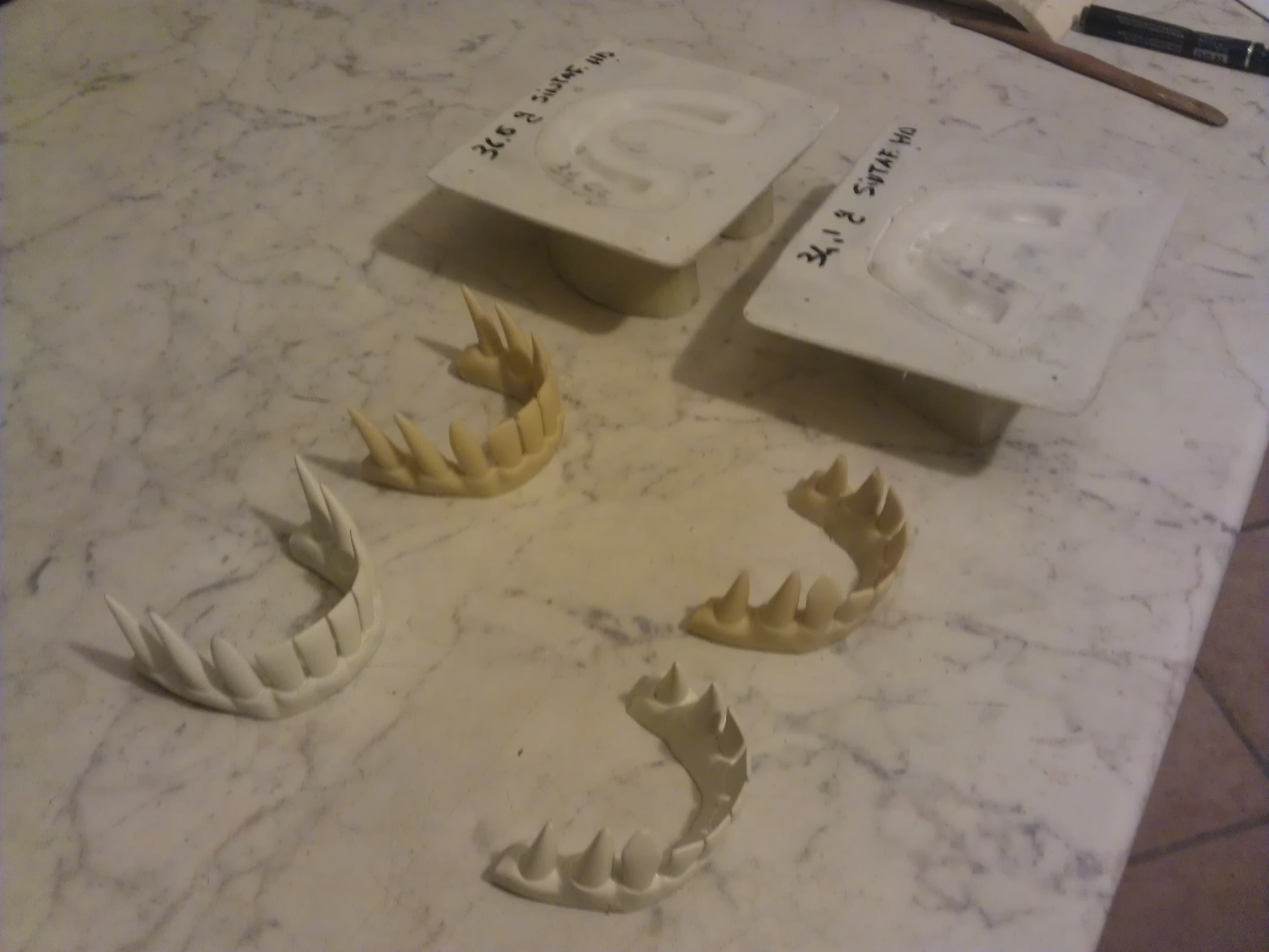

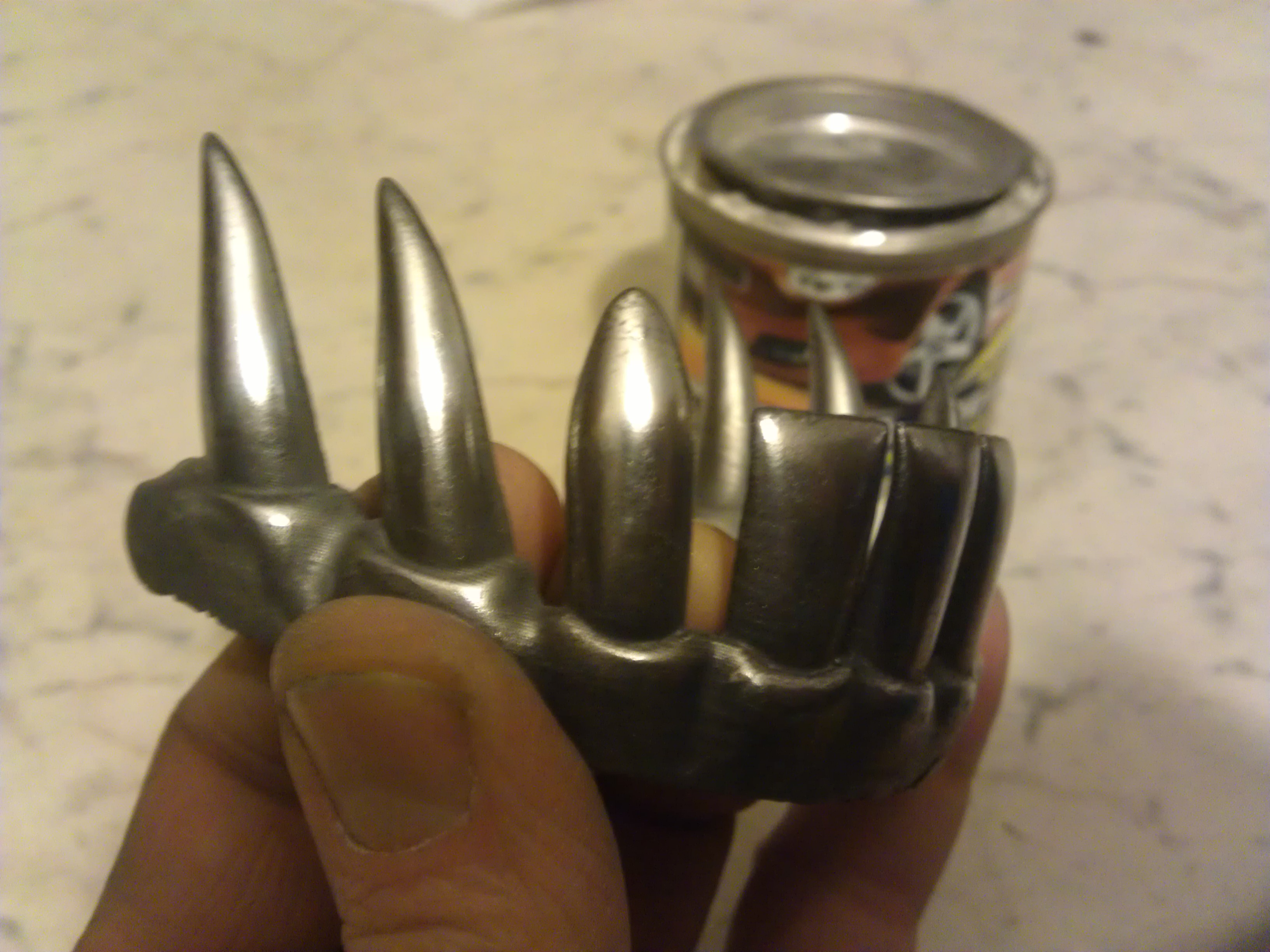

I have tried in making silicone molds, jacketed fiberglass. The product material is a resin which hardens in 6 minutes and has mechanical characteristics similar to ABS. I cast only once. The surface is very smooth, as the model, but the last millimeter the tips of some teeth have failed, because of a small bubble of air. An expert explained to me that must be achieved this tips with a small brush, during casting, to allow the resin to reach those areas.
IMAG1980.jpg IMAG1977.jpg IMAG1979.jpg.
As the teeth of the monster are chrome, I must try a resin with aluminum powder, rather than paint with chrome paint, which is more problematic. This new resin after it has been polished, could shine as a chromed metal. Someone has already tried?

Right, To reduce the chance of getting bubbles in the tips of the teeth you can try cutting the silicone mould part like this:
Use a scalpel & cut right through the silicone from the tips of the teeth. Then before you cast, use talcum powder & dust the inside of the mould thoroughly with a soft brush! including the cuts you've made! Then blow out any excess powder.
This will help to draw your casting resin into the cuts preventing the bubbles from forming. You may have a little flashing between the teeth but its easy to remove & preferable to bubbles.
Its worked for me :)
HTH :)
Re: The Eighth Passenger
For the chrome don't give up on paint just yet :) Have you tried Alclad chrome?
I never tried Alclad Chrome. I saw some videos of this paint. A few days ago I ordered the resin metal to try it. If the result does not satisfy me, I'll try the paint Alclad, because it looks great. I wanted to try the resin, because I imagine that it can not lose the shine, after bringing the metal surface by polishing. While I fear that the paint is more delicate. It could fall out when ALIEN chew bones. :)Maybe the liquid metal does not become mirror how the paint.

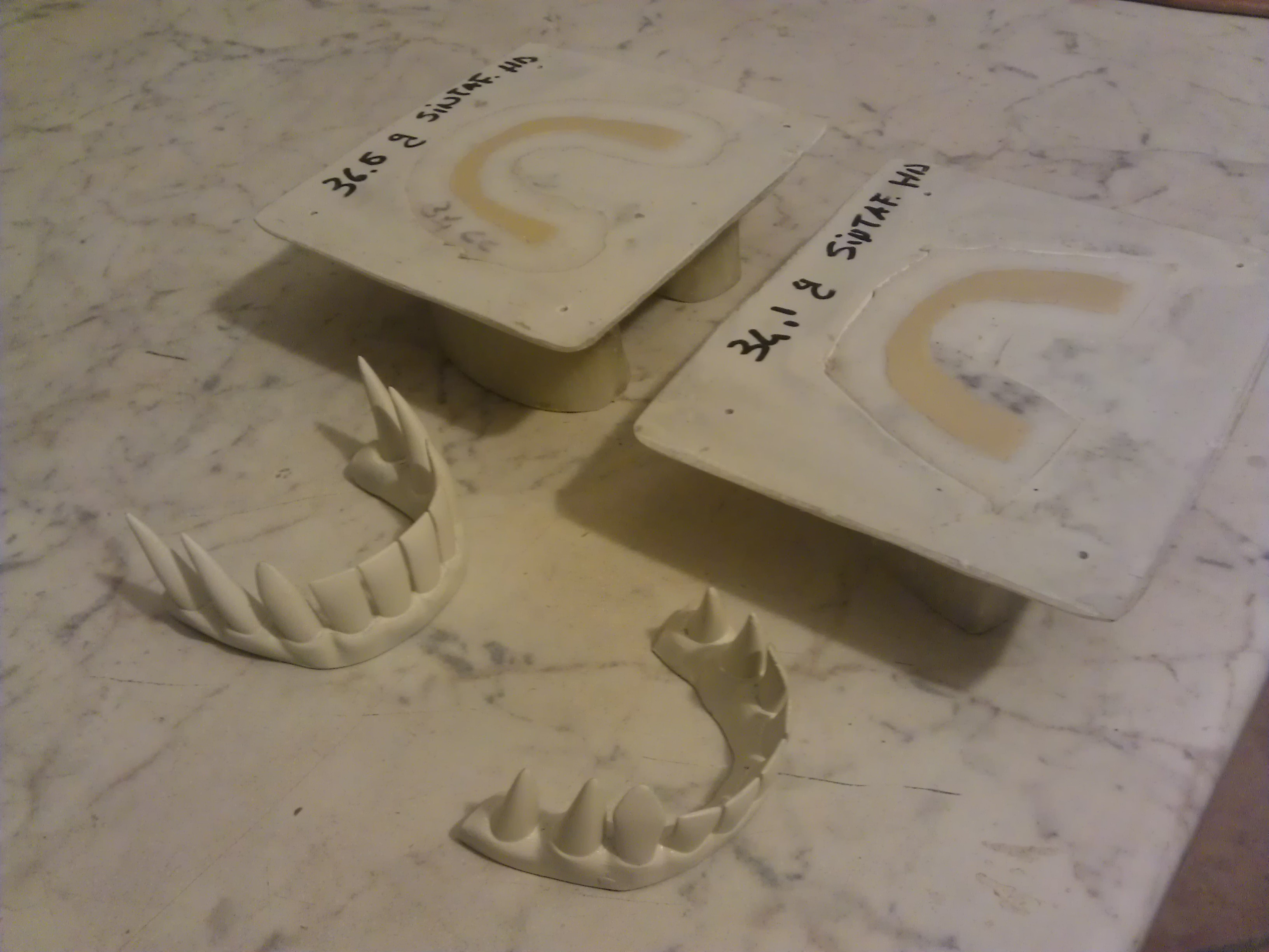

The problem of air bubbles on the tips has been resolved with brush during casting.
This is the result of a few minutes of rubbing with steel wool, done only on the visible part of the teeth. The resin was still slightly sticky. Maybe have to wait a few days to have a surface that sticks less, to get a better mirror effect. However in the data sheet it says that you can polish with the creams for the body, to get the maximum and then protect with varnish. I do not care a chrome exceptional, because it seems to me that the original was more similar to that obtained with steel wool. But the chrome plating adorns and I believe that the manufacturing steps of the painted version, in addition to returning chrome exceptional, are also less labor intensive. A contraindication of this resin is the weight. With the plastic of the molds preceding the teeth weigh 36.6g, while these weigh 90g, that is, the weight multiplied by 2.5.

I've already taken many ideas from you. :) I also own a dremel and maybe I could increase the mirror. Being a metal, it can oxidize. In the data sheet advise to protect with varnish. I have to try what happens with transparent, if it keeps the mirror surface.

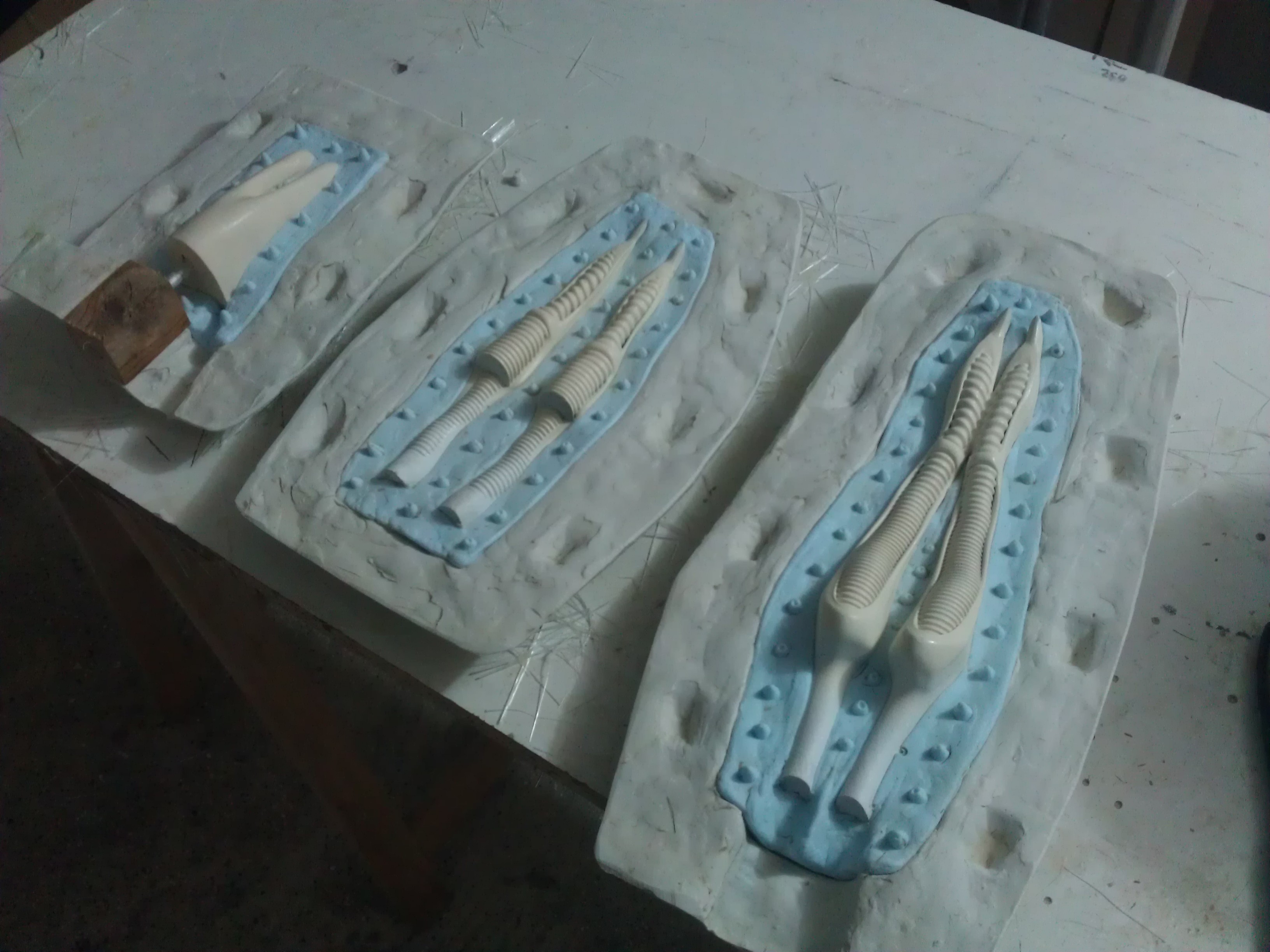

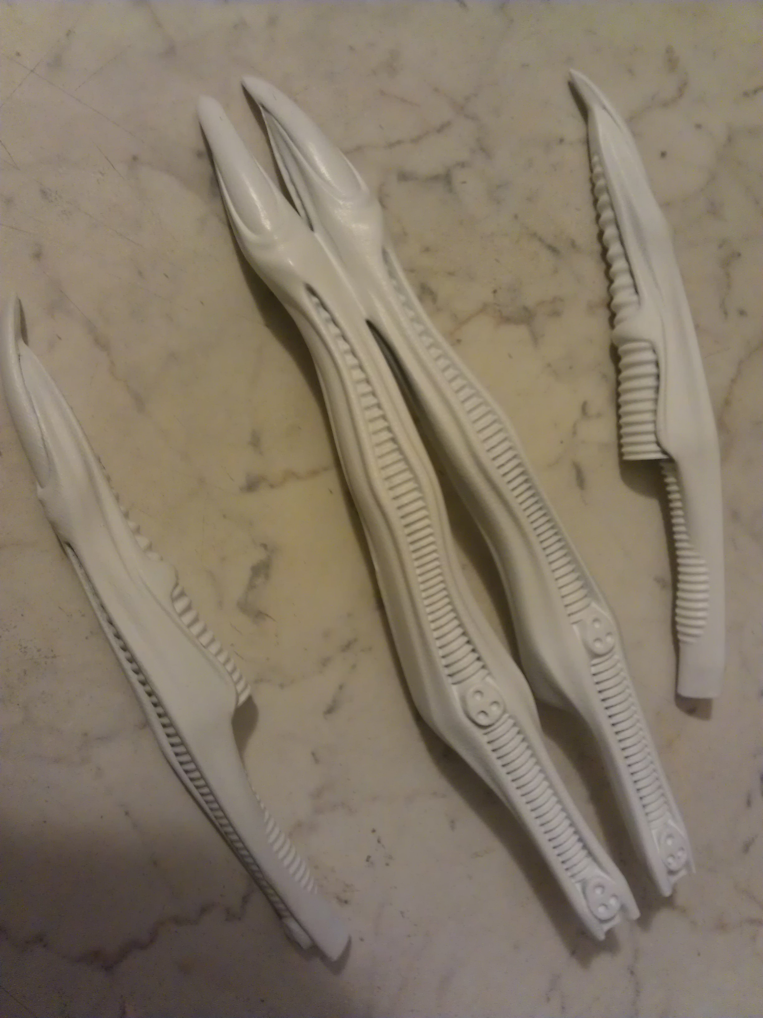

Fingers . They will be made of tough and flexible plastic , casting in silicone rubber molds .
Nails sand and polish with plastic paint.

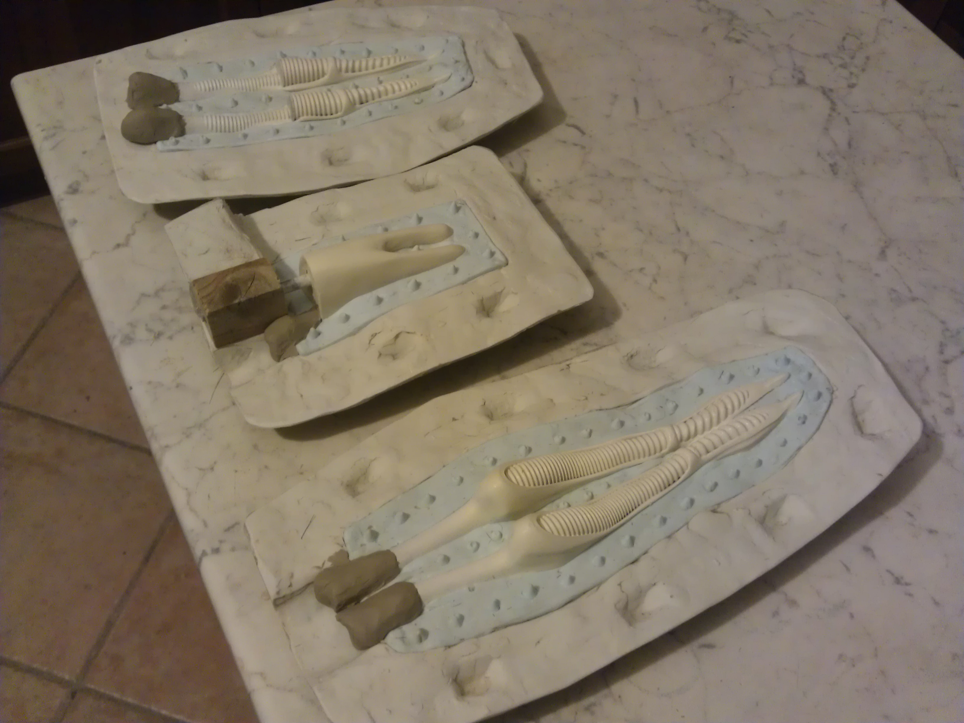

Here the mold to make copies of the lateral head bulbs. I'm not really an ace to do these things, but the important thing is that they work. :)

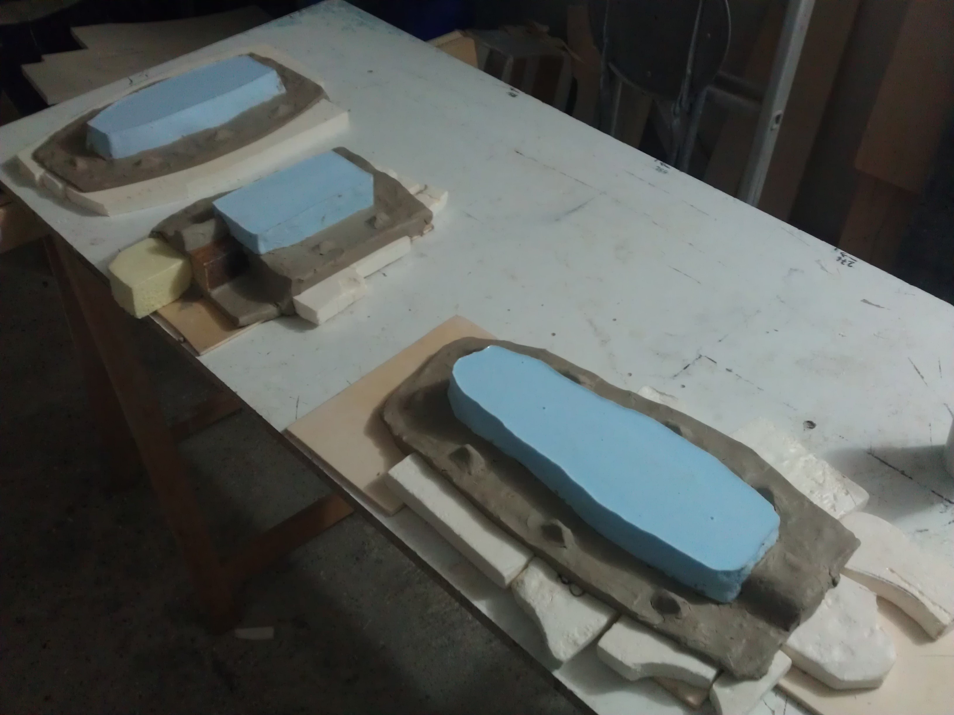

Progress of the molds.

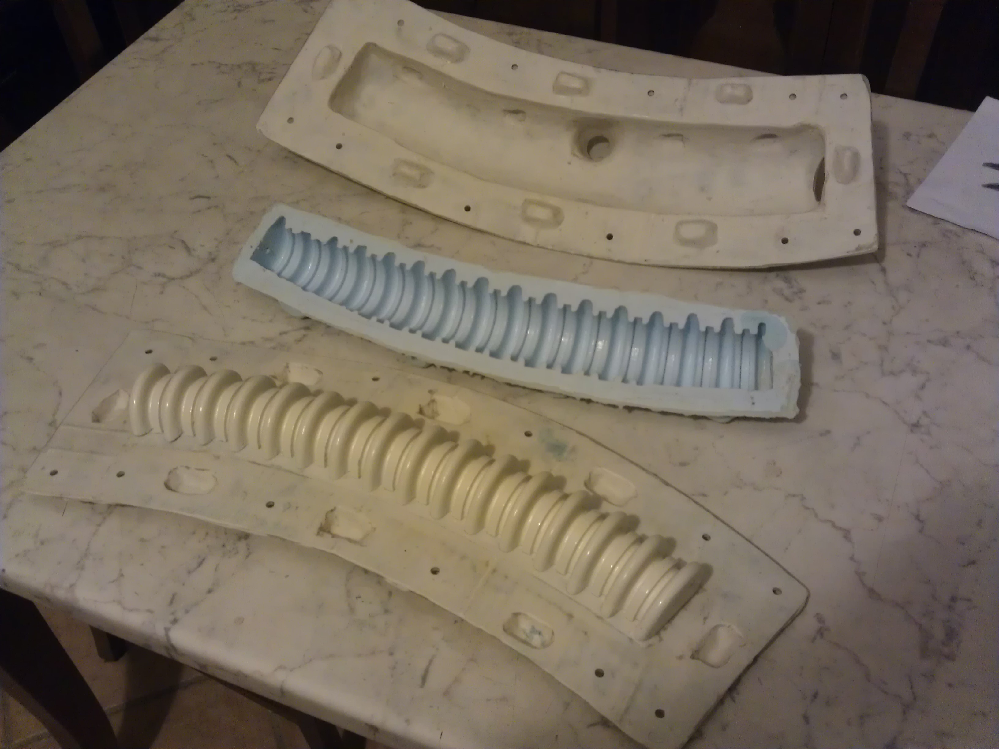

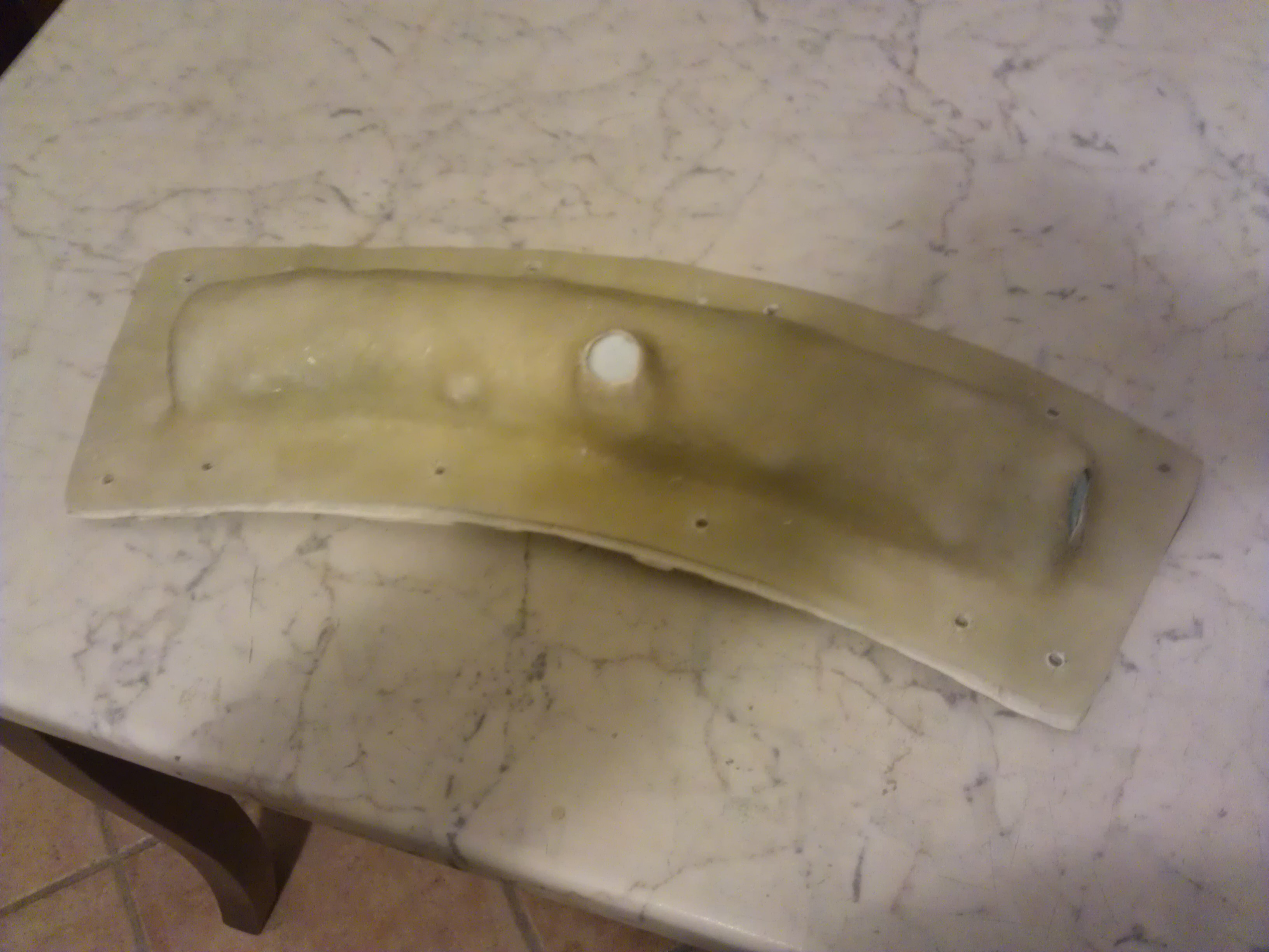

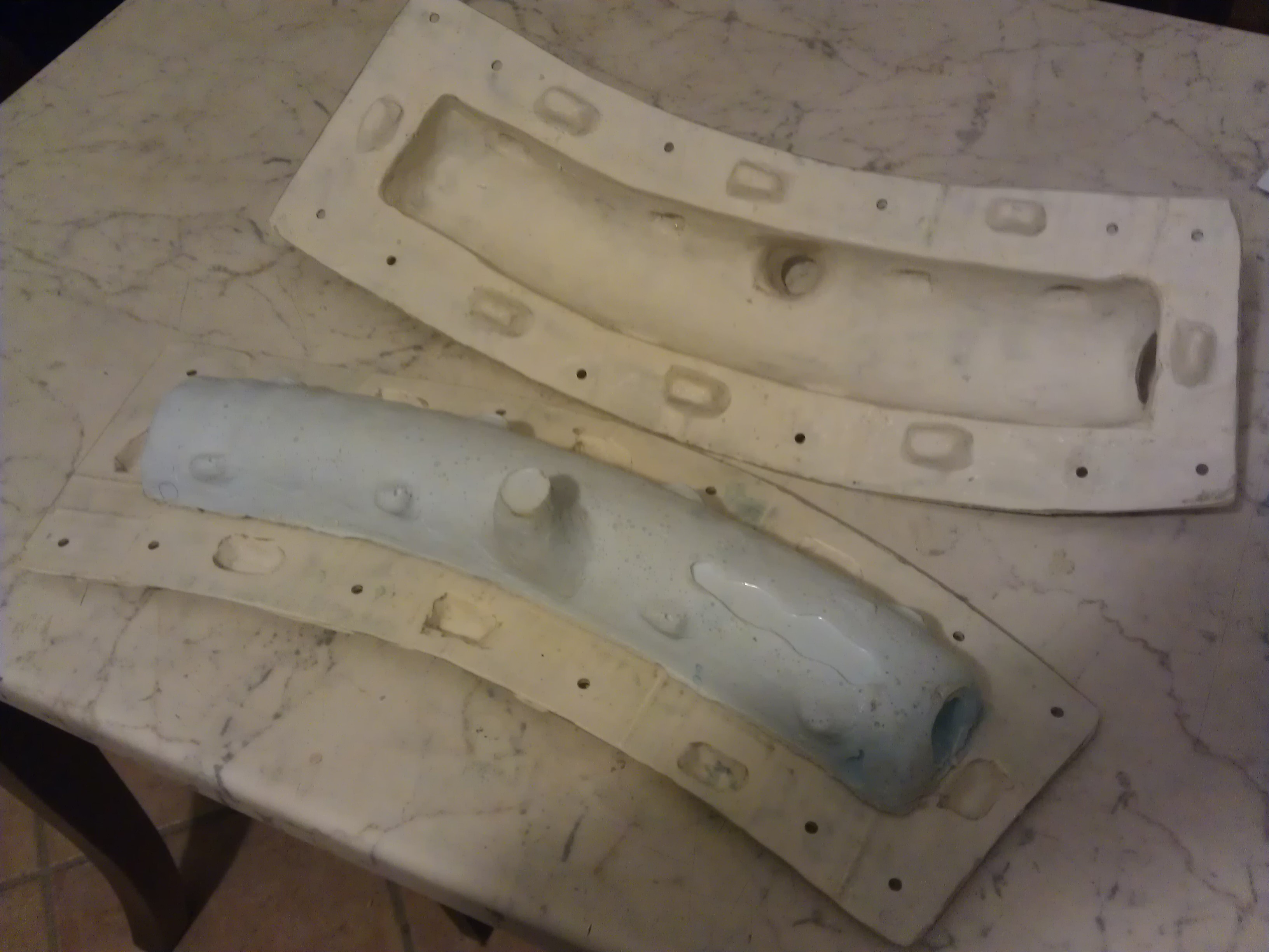

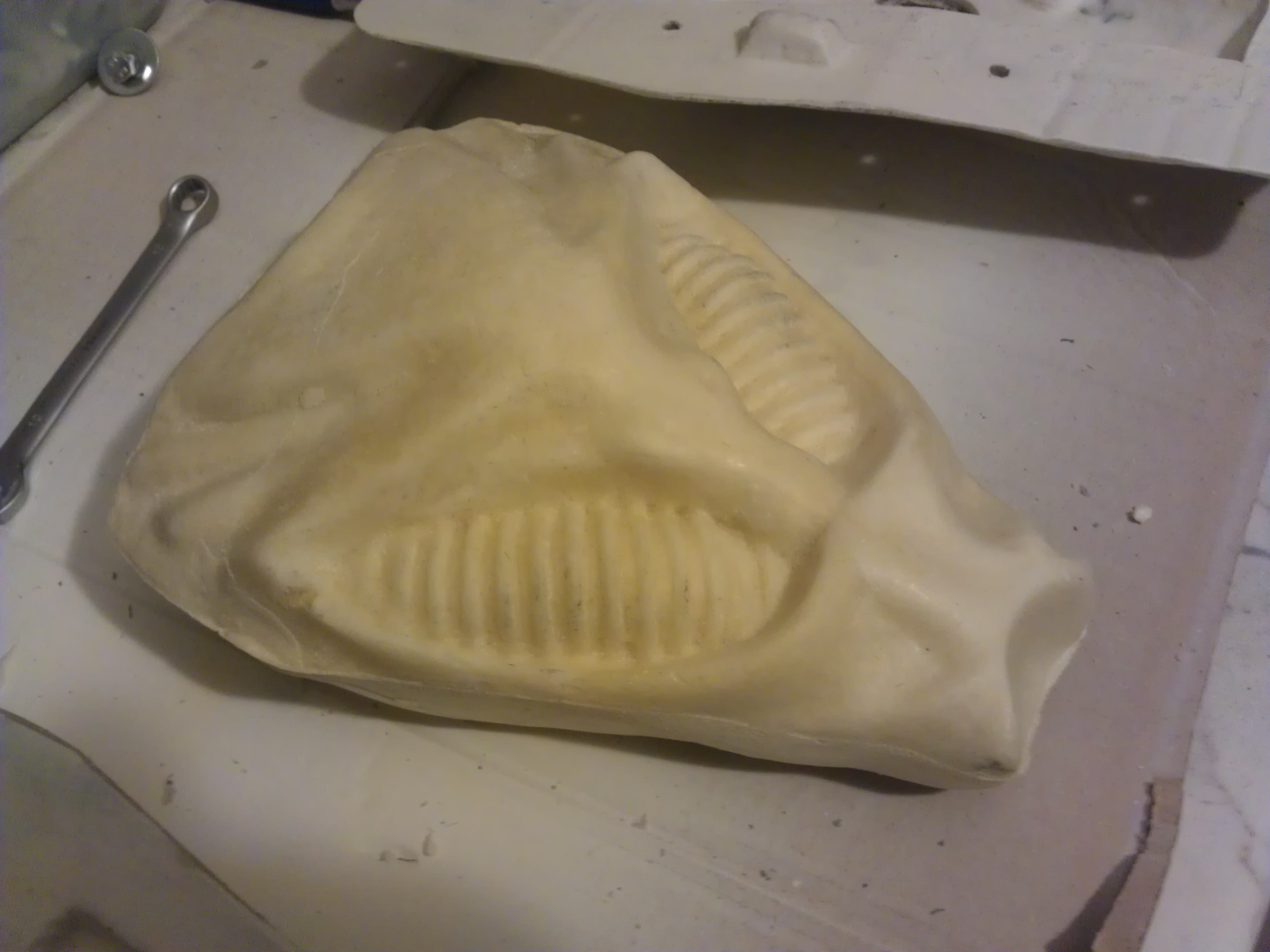

This is the groin. It's my first piece printed with polyurethane. The density appears to be 130kg / m3,instead of 90 free-foam. I got it in two shots,adding foam to the same piece, because the first was not completely filled. This first printed I needed to find the true density.

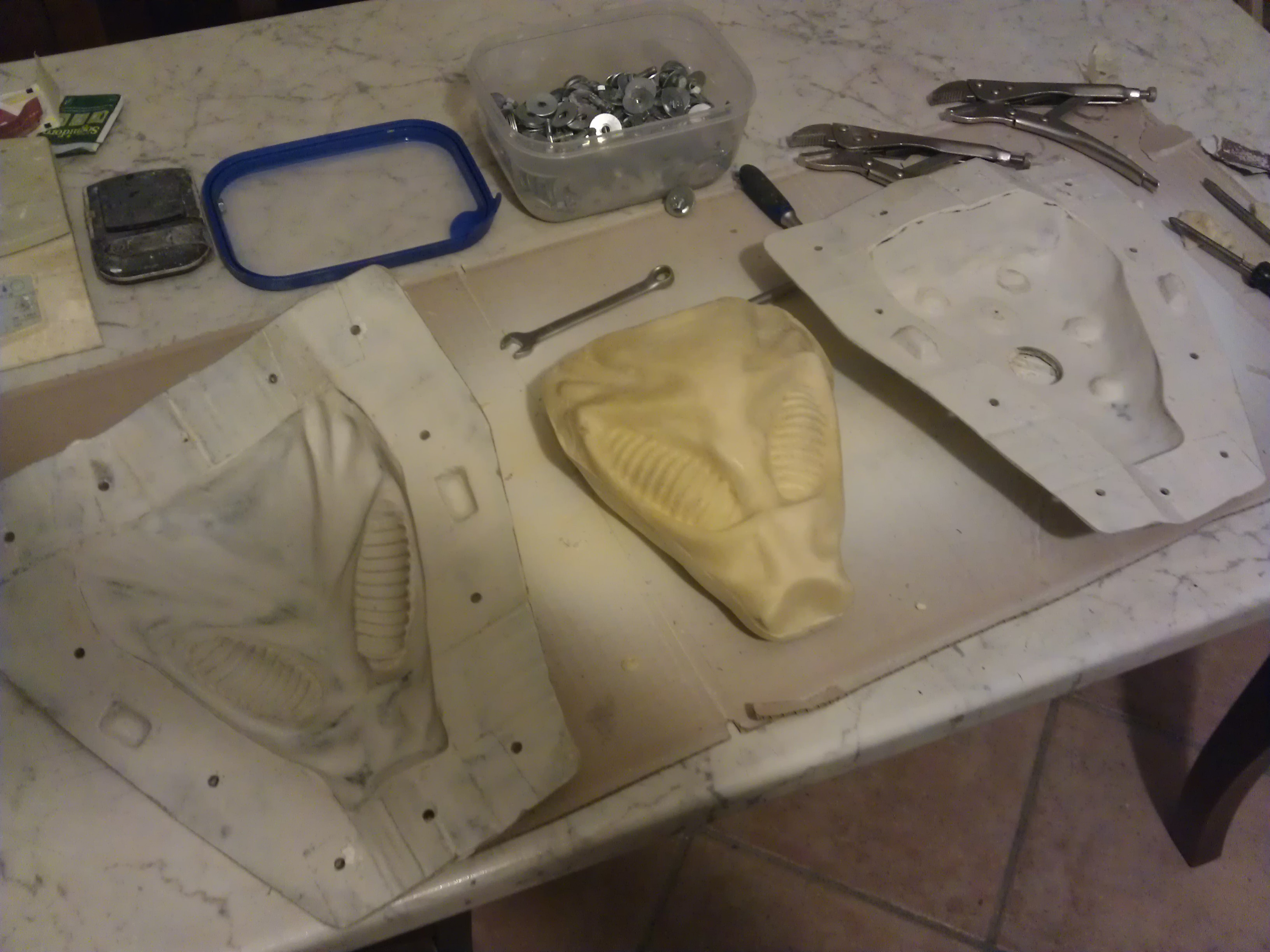

The final print will be even better, because it will be done in one fell swoop and with greater density. In some molds also inject the liquid plastic, to obtain the surface. For other parts I will stretch the plastic, with brush. It is a more robust than plastic polyurethane casting. It is one that is used in flooring. I also have to think about how to get a skin-like surface roughness, alien of course. :)
Yes, all my molds are glass fiber and gelcoat. For reasons of cost, only the molds of the details, such as fingers, head bulbs, pumps, teeth and spurs are made of silicone rubber and fiberglass.
All parties were created as possible without undercuts, trying not to alter the appearance of the original subject. Where it was not possible to follow physiognomy, then I take away with milling or rasp, but they are small areas. In others, I used the blocks, created with gelcoat injections.
The mandible is the last mold to build. I'm still undecided whether to also use silicone. Probably I'm going to see how you did.:p

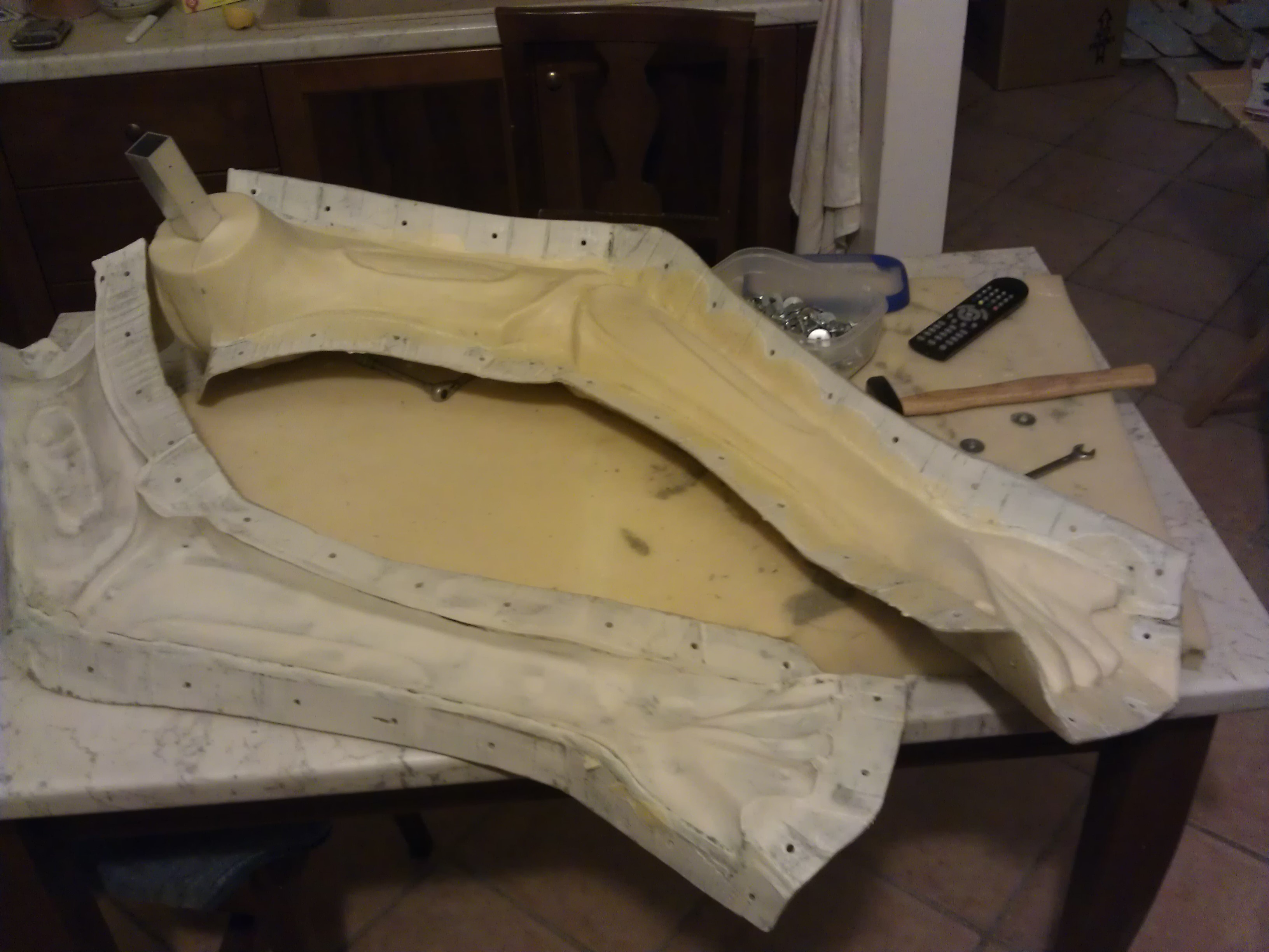

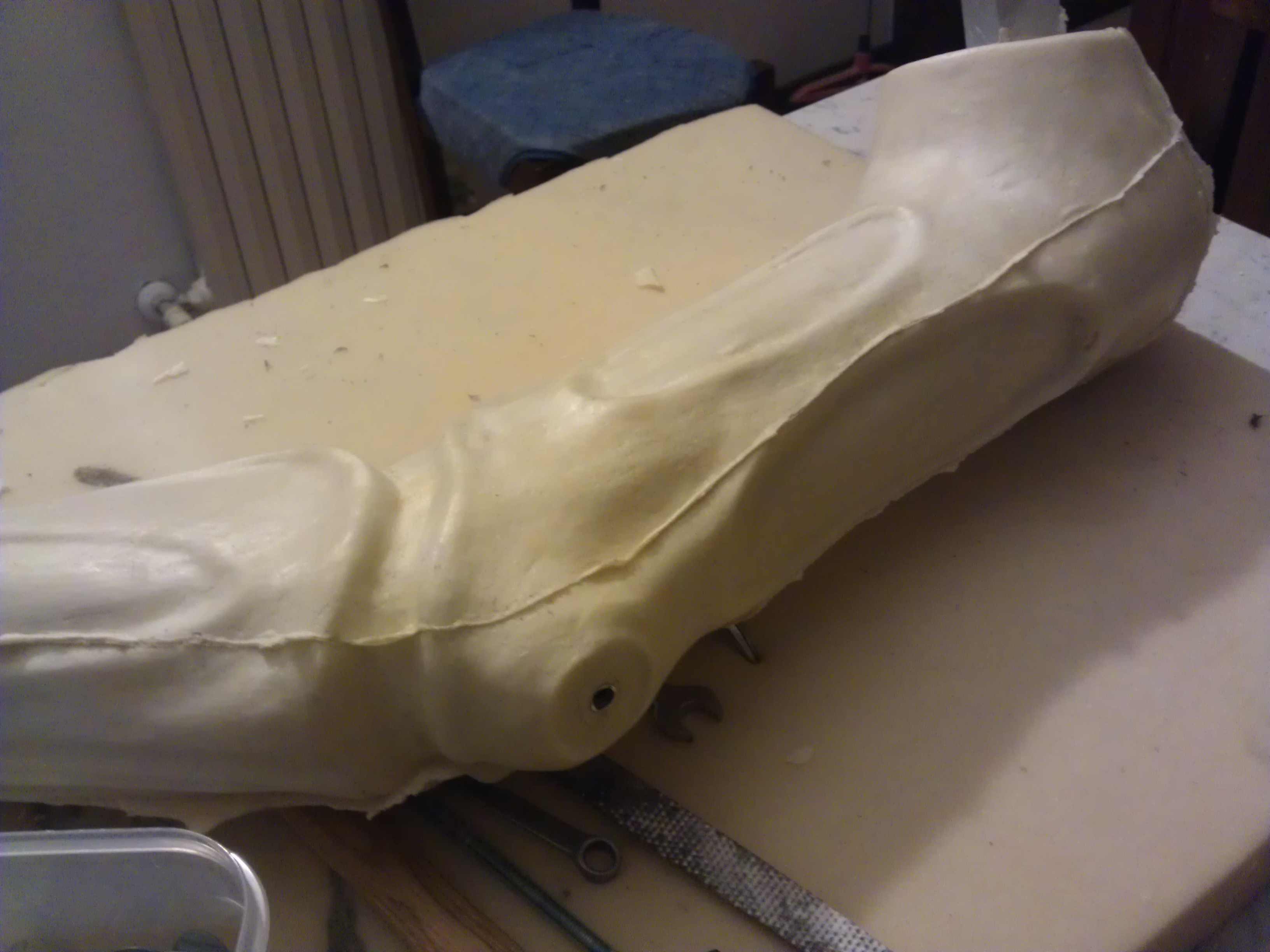

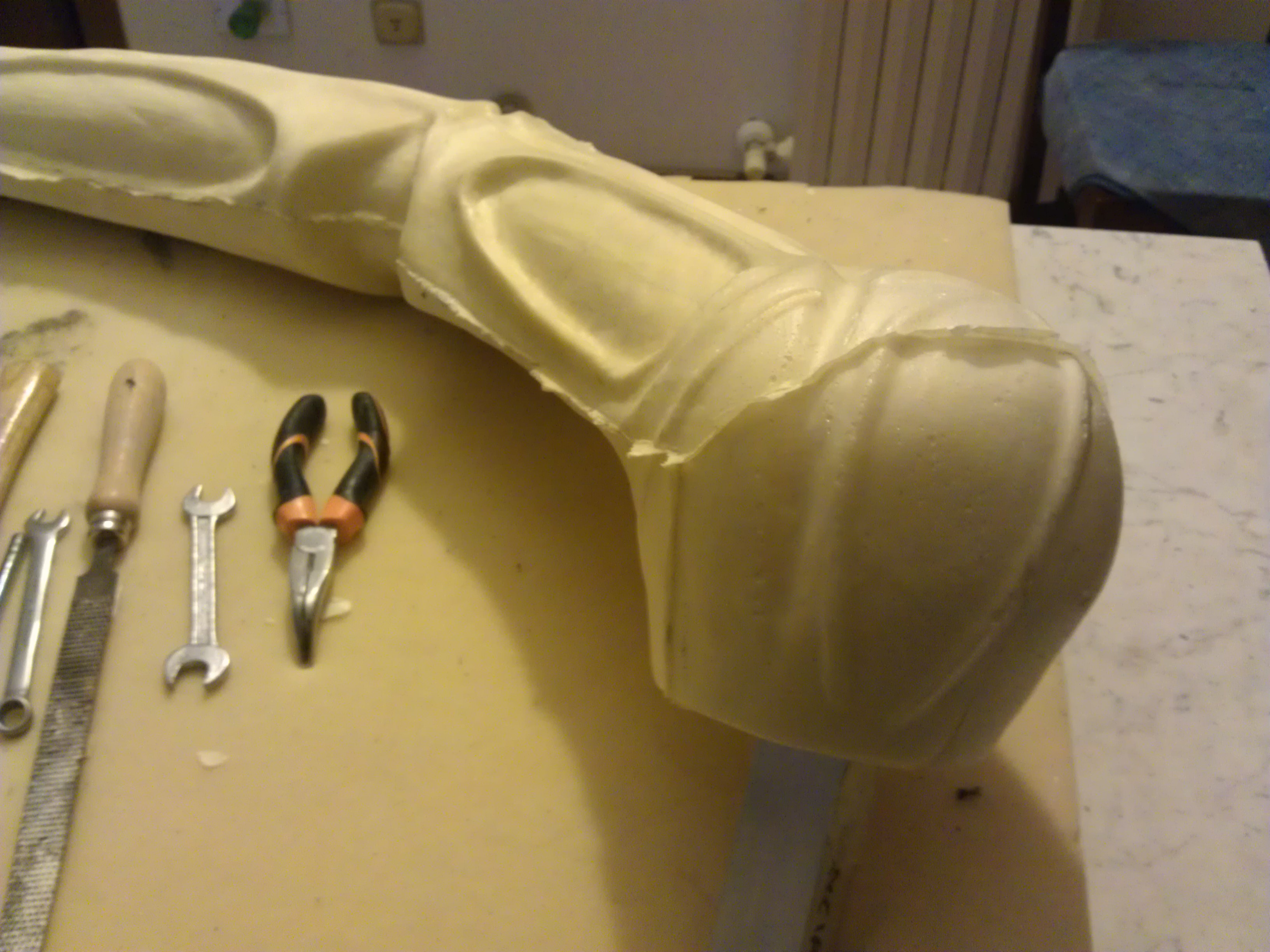

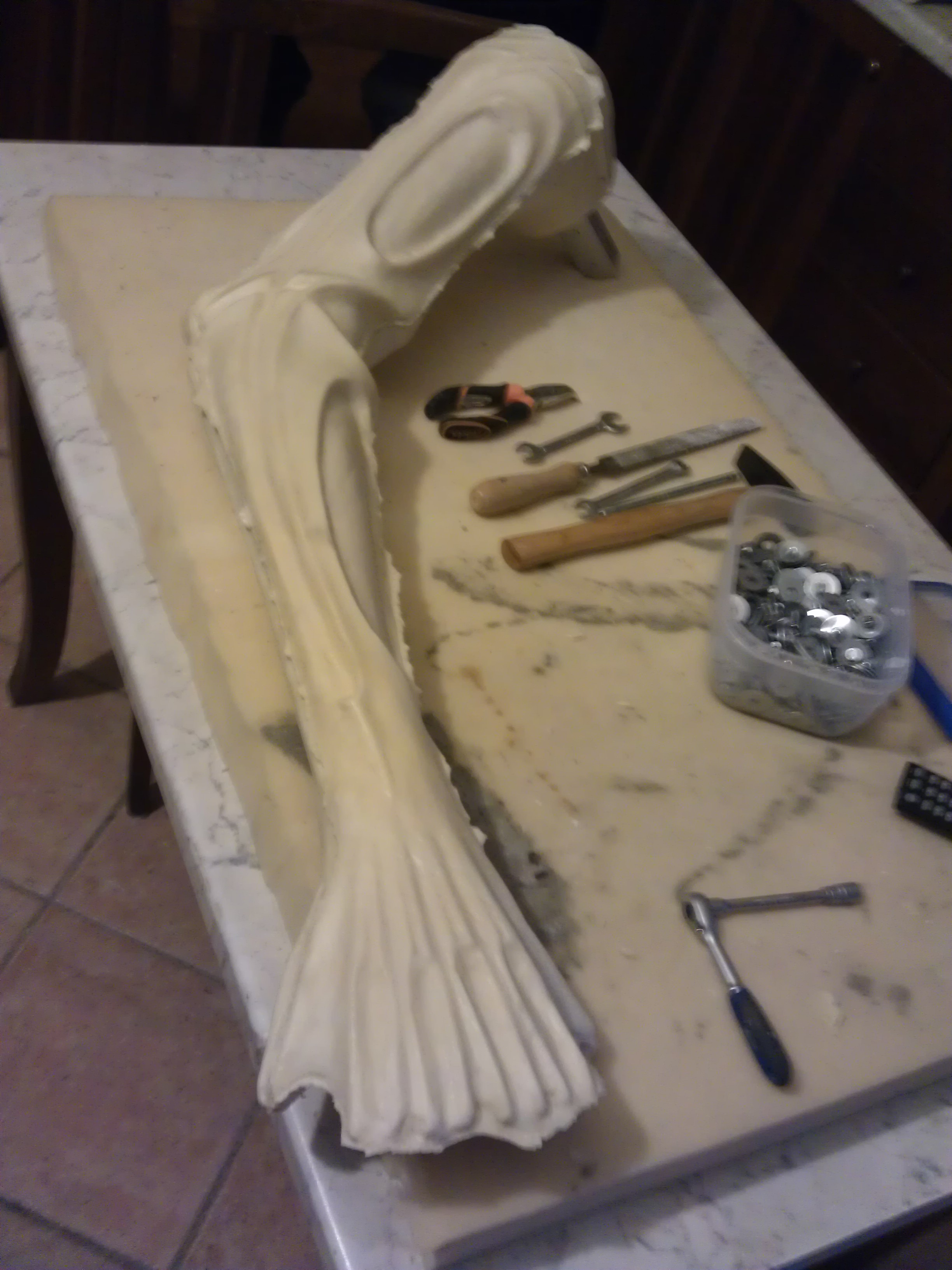

This is the right arm. For safety, I made the density of 150kg / m3. It came very well and very hard. I was afraid that it would be difficult to remove the mold. Instead it comes off immediately without even a gram of effort. With the wax does not even stick a little.
