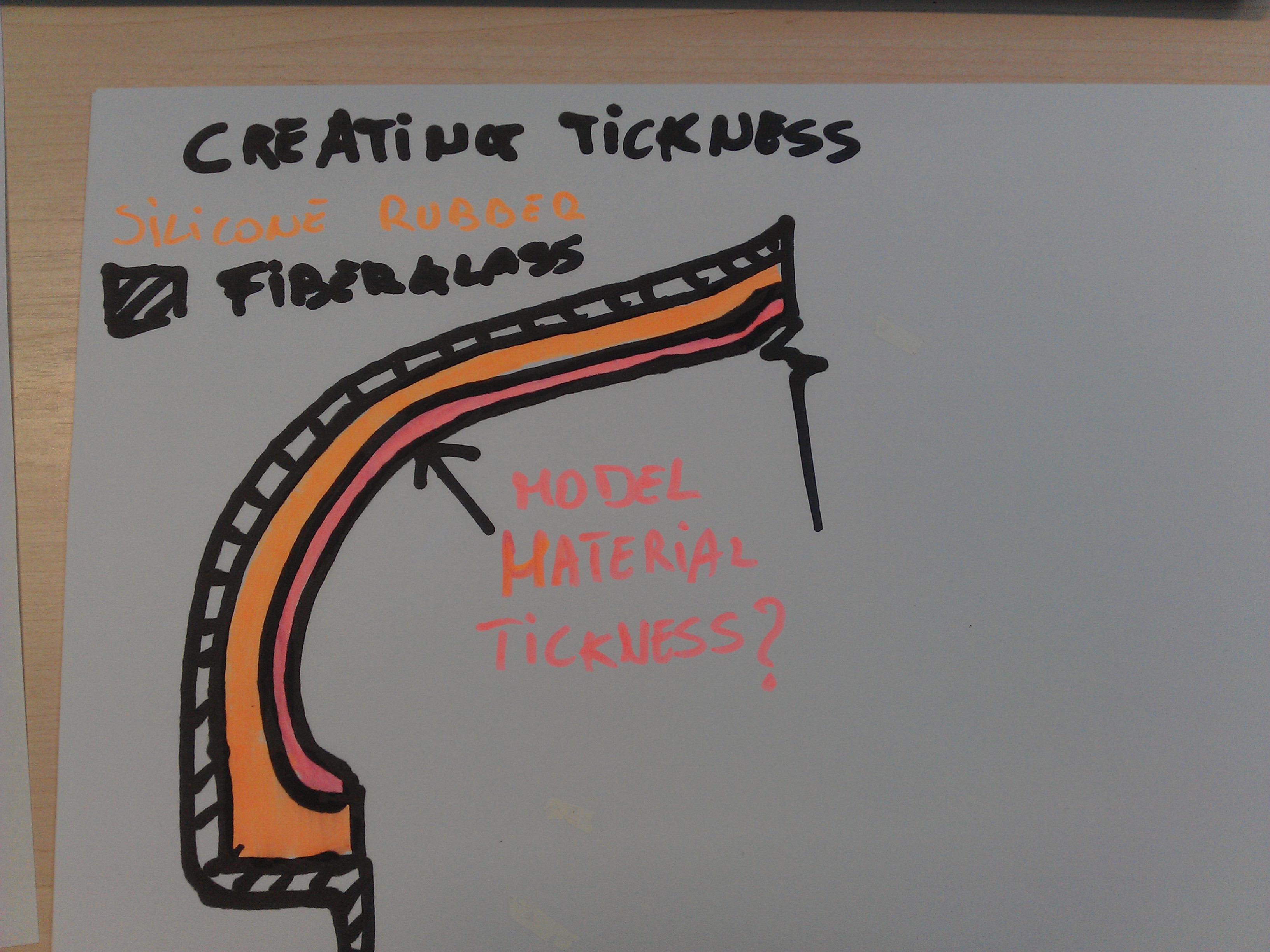

...Or you could make a mold with the silicone rubber and casting a transparent resin? The difficult, would be to get a uniform thickness, because one side copy it with the rubber, but for the other side how would you do? Perhaps layering fiberglass and then sand the very finely, to get the other side with silicone rubber? There is a casting resin, flexible and durable?
I apologize, because I the wrong line of the mold division :wacko

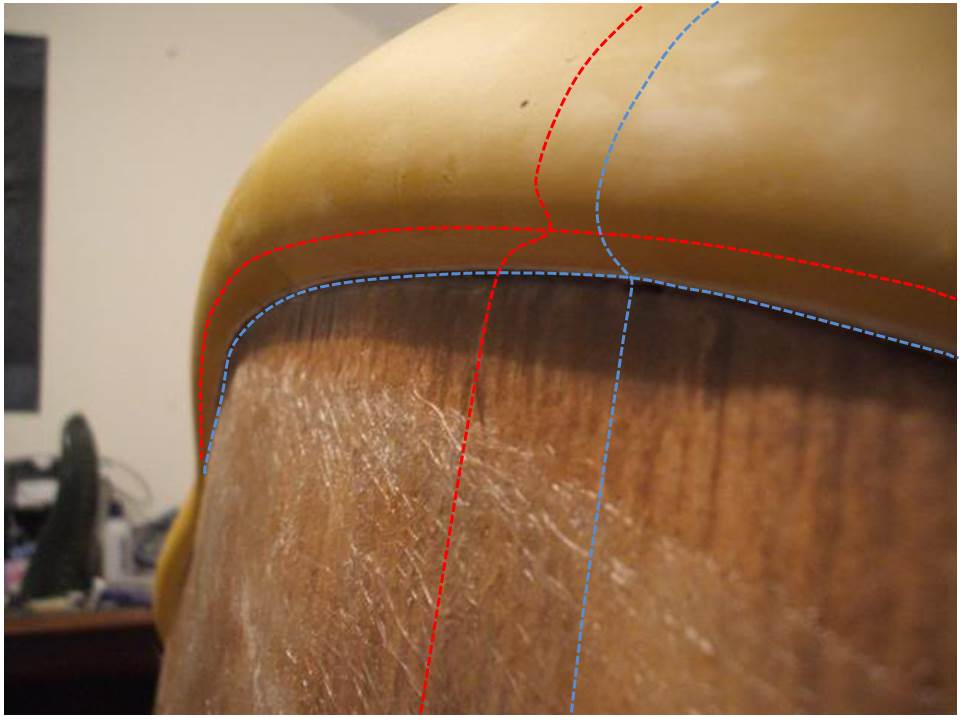

Hello Leigh,
I think you should change the section of your mold, from blue to red, because that as it is now, I am sure that the thermoformed absolutely can not get out from the mold.

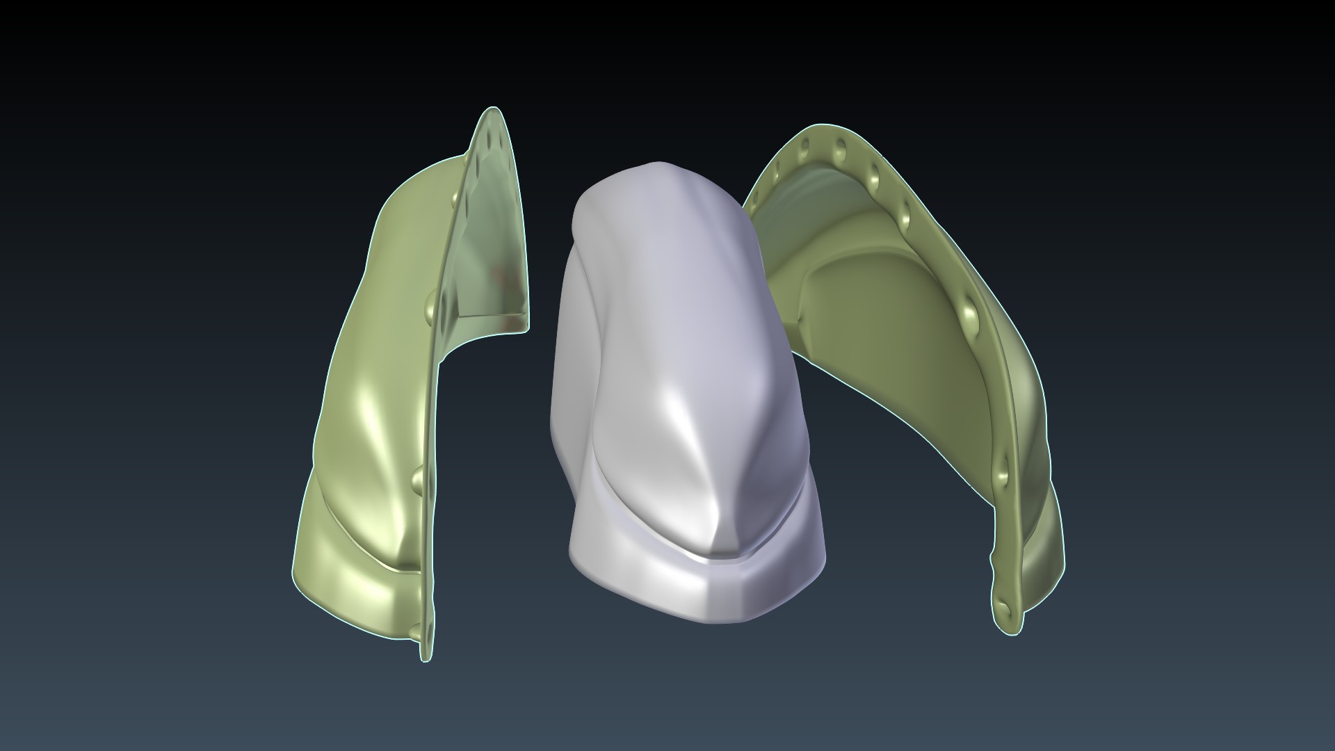

Hey Guys, When i eventually do my dome i will be trying a negative form instead of the positive. Cavx gave me the idea you can see it on pg 2 of my thread. I'll basically am planning to do a 2 part fiberglass mould like you have done to make your positive.
you would need to have small holes around the under cuts and top of the dome to remove the air and have suction. i plan on using small pipes moulded into the fiberglass shell. you could then just separate the shell and avoid the undercut issue. i'm thinking of using silicone sealant on all the seams and flanges to get good suction.
Just thought i would share the idea to help out :)

Hello Leigh,
Basic idea behind it:

i'm planning on bolting the flanges together every 2 inches and also using silicone sealant so i don't think there would be separation issues.

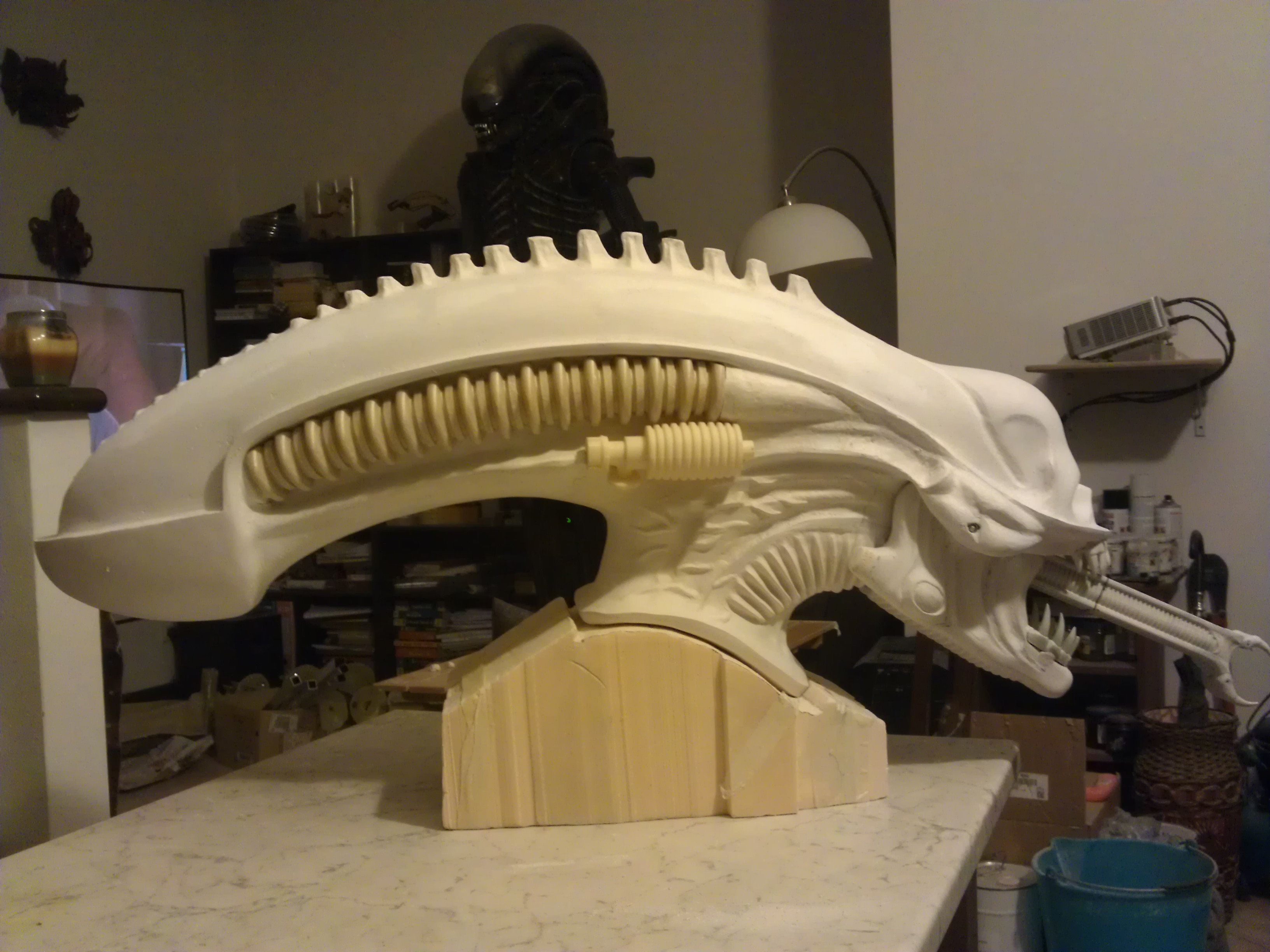

For the first alien, they made the first printed with a departure of 3 mm sheet. I did not like, because in the upper part (where the material becomes thinner), was too soft (question of taste). But the extraction remained a problem. But I never tried to cut the piece, leaving the mold. If you build the machine vacuum, you can do all the tests you want, for both thicknesses, and for cutting. I still doubt if you can not damage the mold along the cutting line. You have to try and take risks. :)
